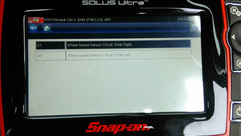

Ok fellas got the codes read today.
And this is what I got.
Front left and rear right. The front one cleared so probably just crap.
The rear right didn't. So I'll start with the back. Now question there doesn't look like there is a lot of clearance to get the retaining screw out. Do I need to disassemble the hub to get the bugger out?
  A special one.
Im sure the rear sensors are only available from Renault. I bought a pair for my ph1 at a cost of £300.

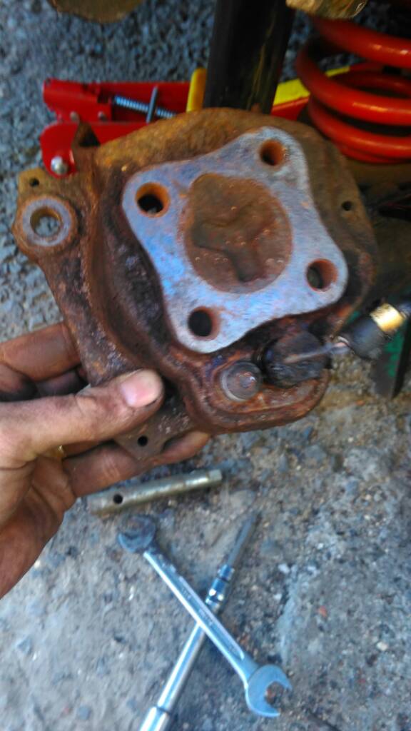

So I tried tackling this today. Didn’t get very far.... tor’s sheered off 🤷🏽‍♂️
assuming it’s a hub off job With a drill and tap? Or is there an alternative it’s a 172 non cup, is there a better replacement or not?

They don’t absolutely need the torx as the push fit holds them in place anyway.
If you get the old one out you might be able to get some mole grips on the thread and wind it out.

Having done a few front ones ...
Use an impact driver on the Torx bolt as you don’t want to round it out.
Where the sensor is on the inner side of the hub as close to the hub as possible hacksaw about 5mm in - you are only cutting into plastic and very fine copper wire so not difficult. Hit the side of the sensor and it will snap where you have sawn it. Pull out all wire. Do the same where the sensor sticks out above the hub and saw under you hit something hard – which will be the hard steel cylindrical magnet that is inside and no need to try and cut through it – which is good as its very hard and will try and rotate making cutting a pain. Once you have hack sawed in until you hit the steel then stop and hit the sensor on the side and the plastic part will shear off. The magnet can then be pulled up leaving just plastic in the hub and use a punch or abuse a small screwdriver and this will come out easily.
All done in a couple of minutes.
  Clio 172

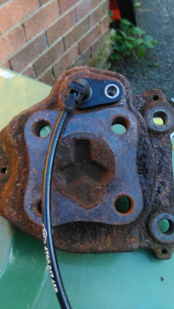

Just read through this post. I have 2 working sensors that I want to remove without breaking so that I can refurb the hub.
Leaving to soak with GT85 and hoping I can tap them out and sort out the thread left in afterwards.
Am I likely to damage them tapping them out?
Any other suggestions?

Just leave them in and mask them?
  R5gtt, 182, volvo...
There really is zero hope, I had a go at getting them out gently and they’re tighter than a virgins queef.
order new ones and smash them out.
theyre almost as tight as pressing the bearings out.
CrashBurnFly
  various
I would be amazed if you could get them out undamaged as the cast iron hub corrodes and grips them in. Mask them for a repaint as Louis suggests. Or replace them as they are really maintenance (long term) items if you have the hubs out. Somebody needs to send Dangerous Dave a woman!
