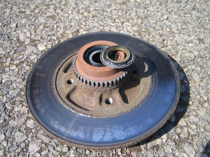

The bloke I bought my Trophy from removed the ABS, apparently by fitting non-ABS rear discs.
I've just had some new discs delivered, which apparently have the integrated ABS sensor. Thing is, they don't look any different - what is the ABS sensor supposed to look like?

  FF Jeden Osiem Dwa
The discs don't have sensors , the discs have " abs rings " with teeth that the sensor picks up on . You can see the ring in the middle of this pic .

  Clio 200 Black and White
that cog-like thing next to the hub part of the disc is the abs ring? cheers for the info!
  PH1 172 Sport
Yeah thats the ABS ring. Do make sure hes removed the abs properly and undone the rear brake bias adjuster.
