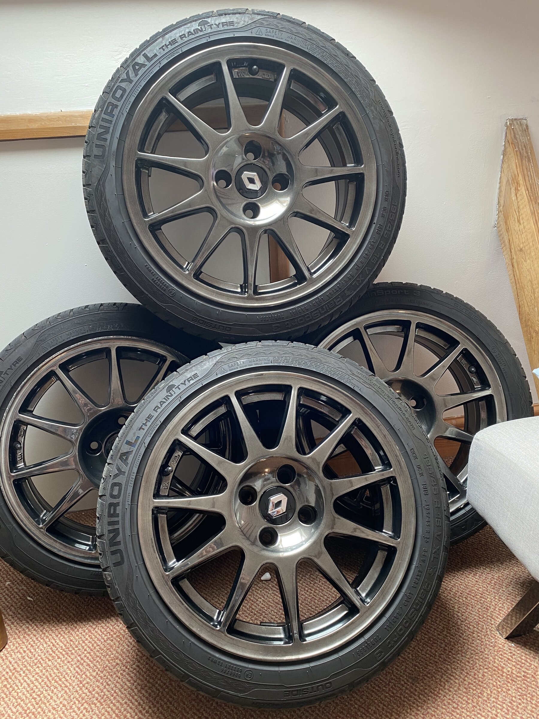

Just got it home. Super chuffed. Only place I forgot to check was fuel filler cap and soda law I need to sort it. But that’s easy fix. Couple of tiny shopping dings I’ll get dent man to sort.
This is the Turini’s I have to go on it!
Excuse the carpet and terrible condition of my office! Now do i continue my old project thread or start a new one?
