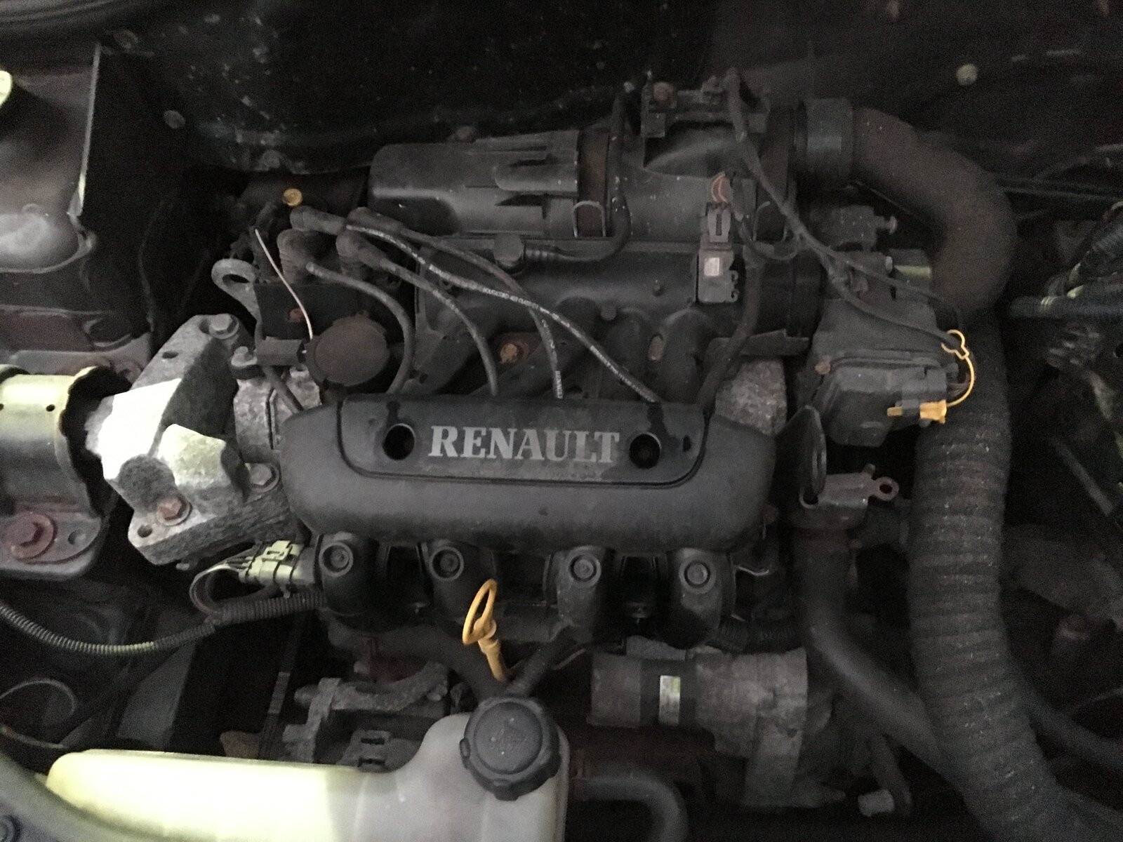

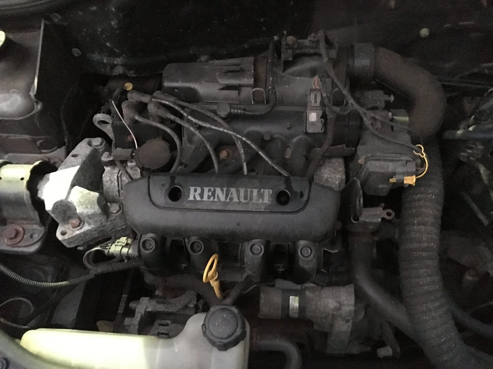

I know this thread is YEARS old but I have this exact same car (8v) and the exact same problem! If anyone could help please 🙏🏻🙏🏻🙏🏻
Hope this helps

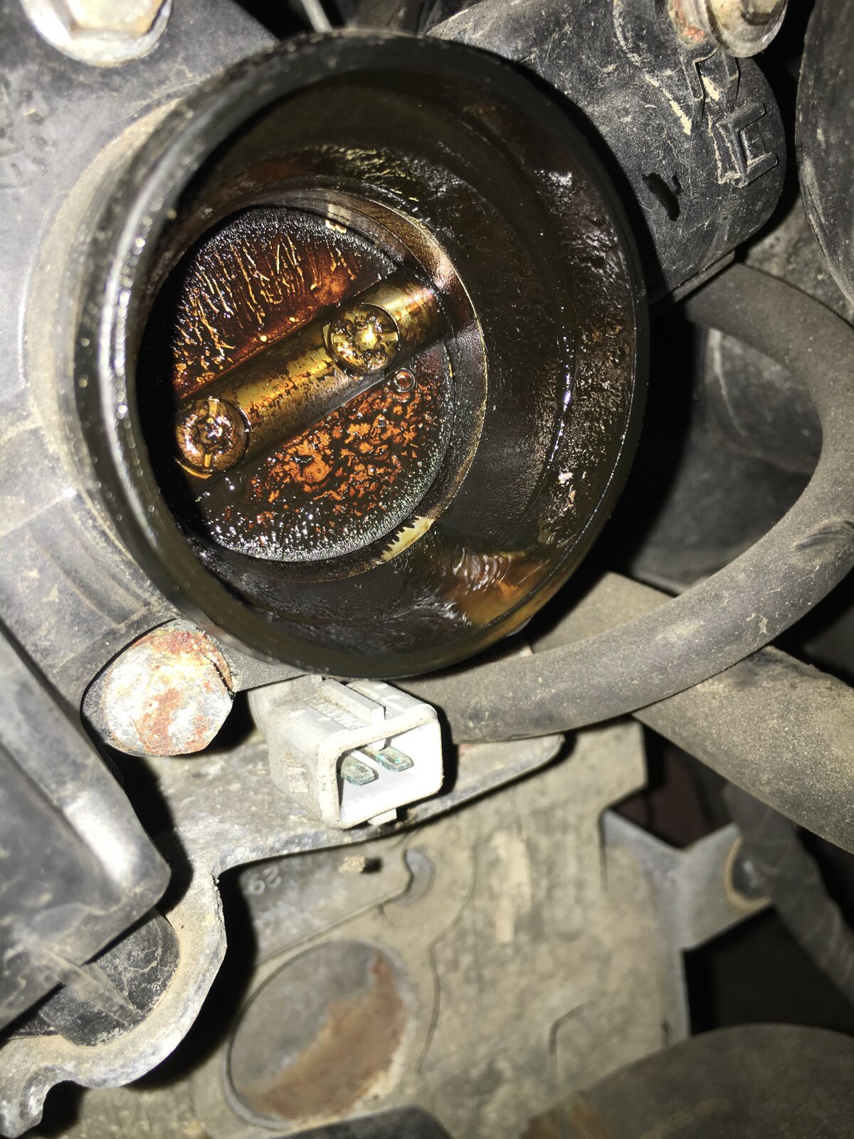

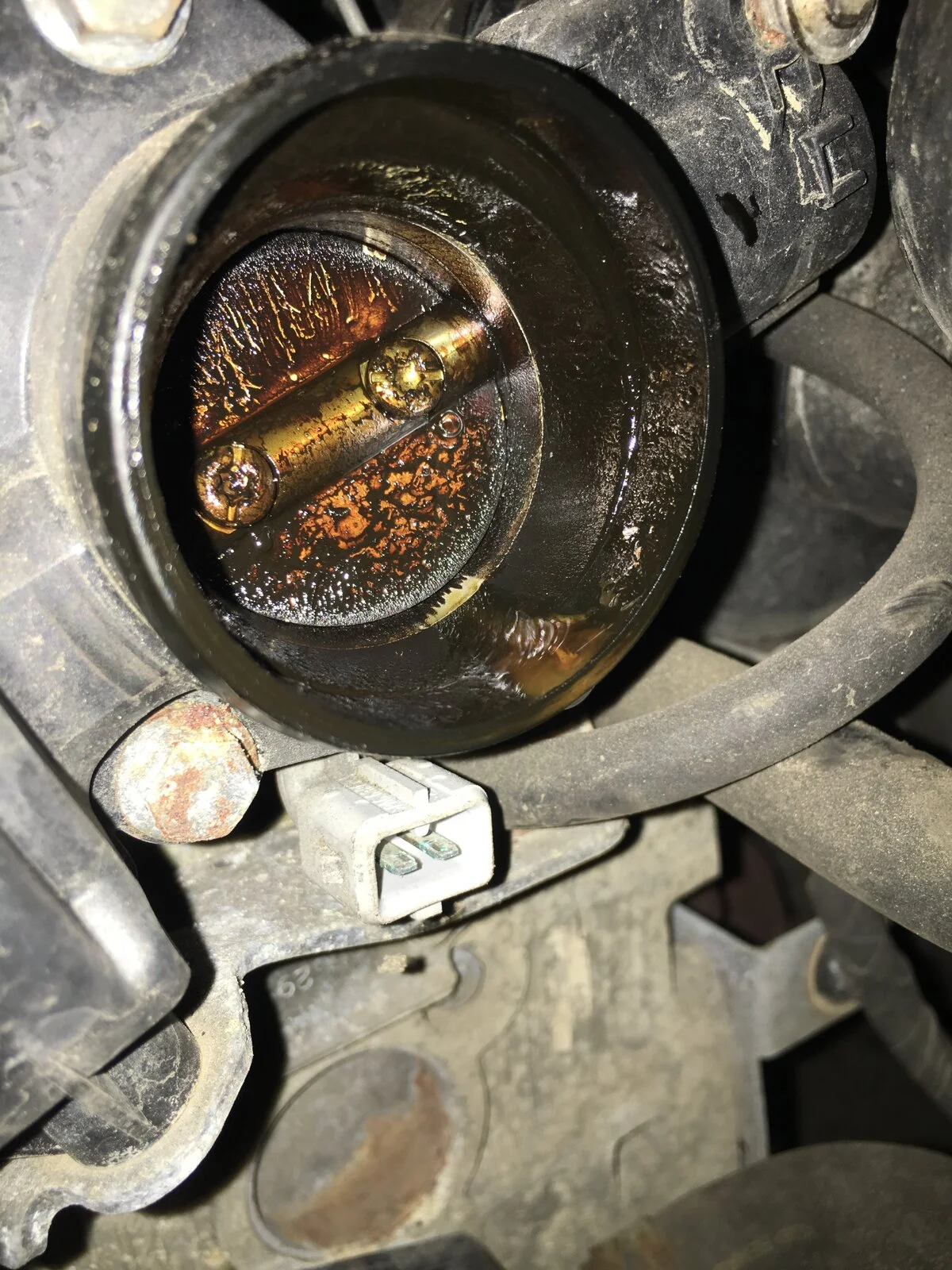

Thanks for help. I think it’s an electronic throttle body (if that’s such a thing) so not sure how I go about cleaning it?
This could be the problem

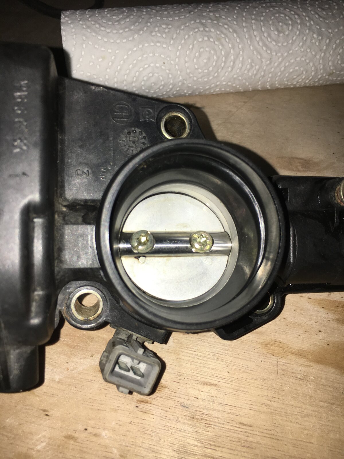

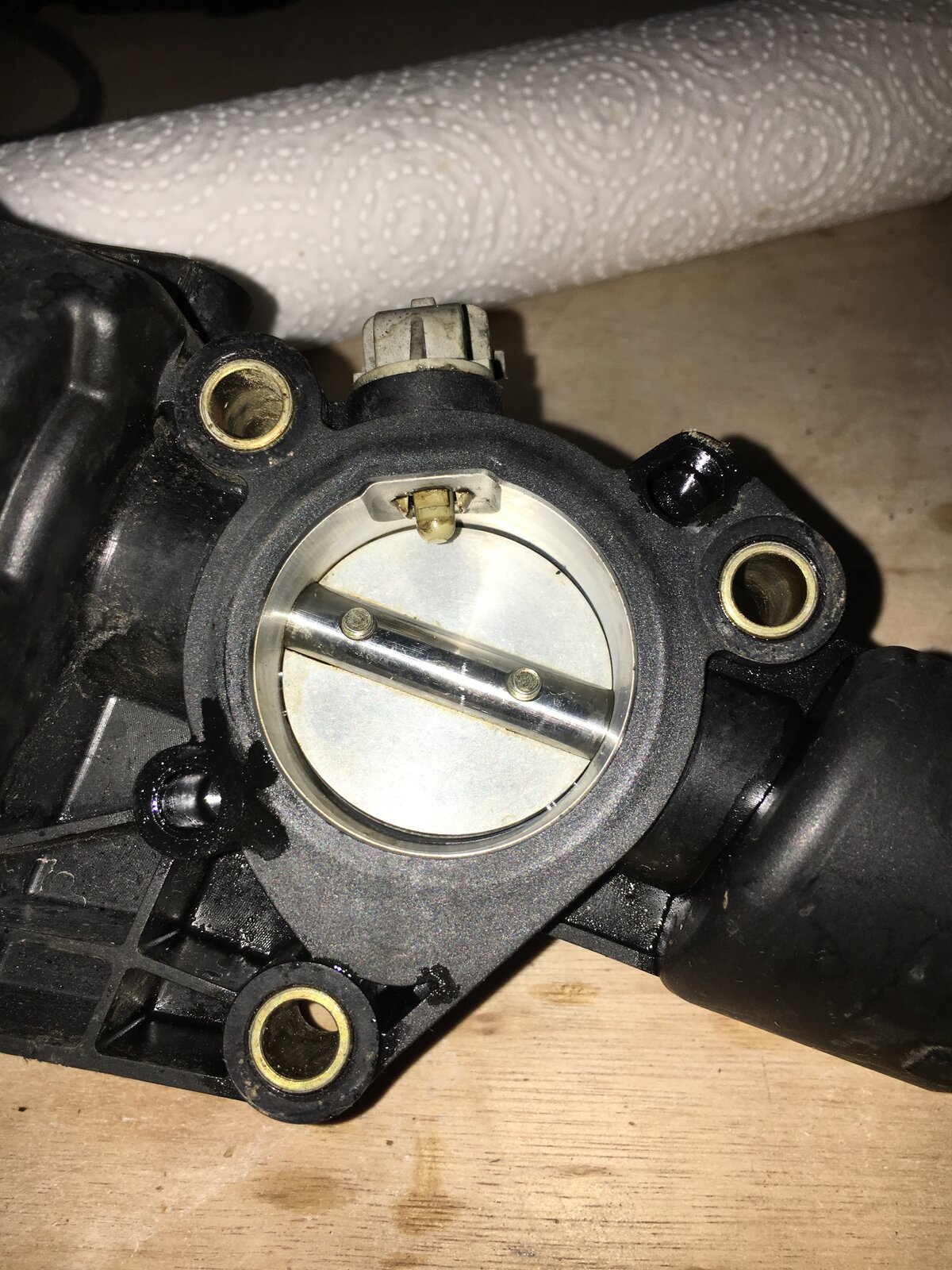

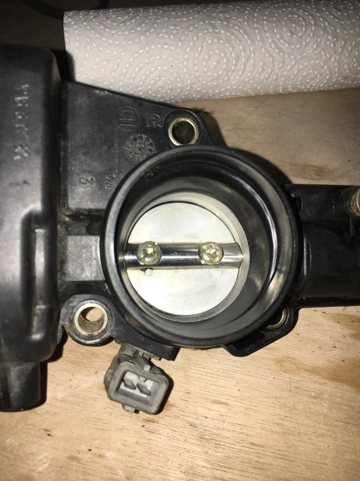

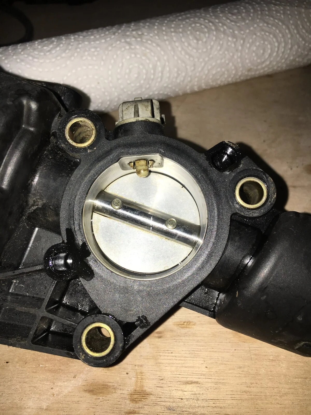

Refitted and the car works. Hopefully that’s the end of this problem!
