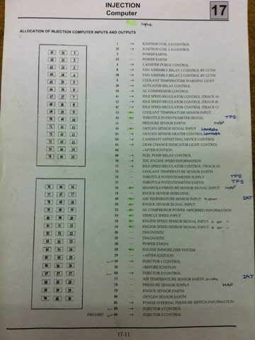

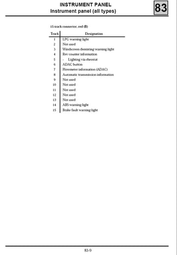

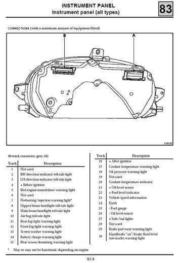

I also have found these.
Can anyone confirm that these are the correct pin outs for a phase 1 Clio 172?
And I would like to know, how is the rpm signal transferred from the ECU to the instrument cluster? Is it a voltage signal? Which increases as revs rise or something?
If the above diagrams are correct, I would have to look at pin 70 at the ECU, and pin 4 at plug B, correct?
