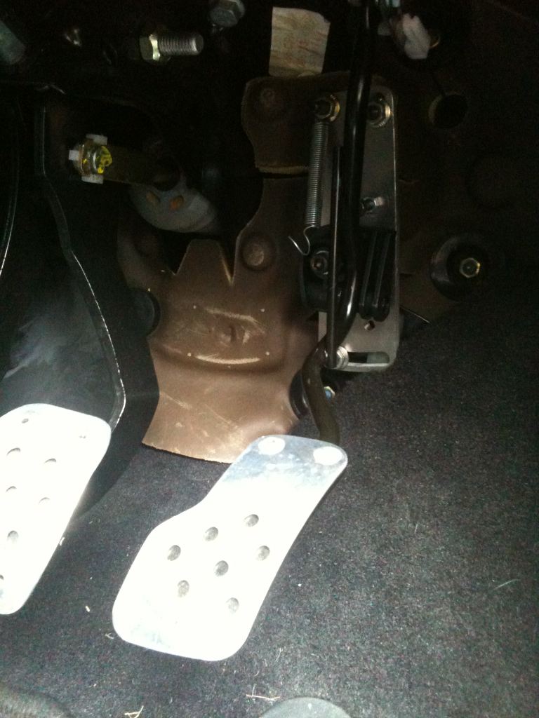

I've been trying to get my head around this for a while now, but it keeps puzzling me. Basically my pedal height is practically in line with the brake pedal which means heal toe is tricky, plus when braking you catch the pedal. It's on cable throttle, so what options do I have? Ideally I'd like to keep the current cable. Pedal travel is completely to the floor currently. I had thought about putting a bracket from the cable to the pedal hole (extending the cable essentially), but I think that will prevent full throttle. Is my only option involving a blow touch and muscles?

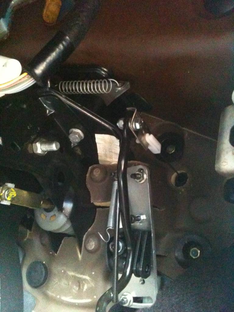

Yup. You'll have to adapt the ratio between pedal travel and throttle opening angle then. Do you have any pictures of the current setup?
  Golf GTD Mk7
Here you go;

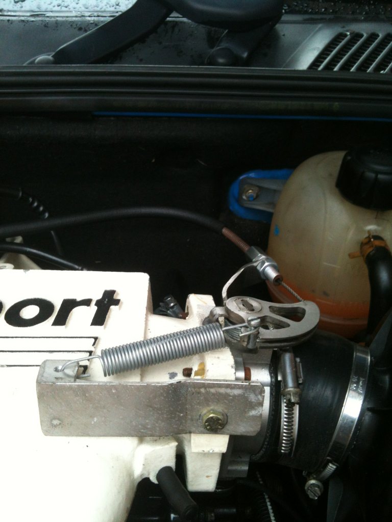

Looks "err" interesting. What kind of throttle body is it? A different tb "lever" with a smaller diametre should improve the ratio. You could use a ph-1 cable throttle aswell.
  Golf GTD Mk7
S2000 spec AT throttle. I spoke to them about changing the quadrant, but was told it wouldn't make a difference
  172/1.2/E30
It'll make a difference. If you reduce the "diameter" of the quadrant, you'll get a smaller perimeter which means you'll need less cable "length" for the same opening angle.

Might be possible to lengthen the pedal arm, where the cable is mounted to and then tilt the pedal further down.
  Lionel Richie
just increase the length of the bit where the cable joins the pedal, simple, i bet you hit full throttle before the pedal even touches the floor anyway
  Lionel Richie
pdeal should hit the stop at full throttle yes, looks like you have a phs1 172 throttle cable that's been "moddified"
