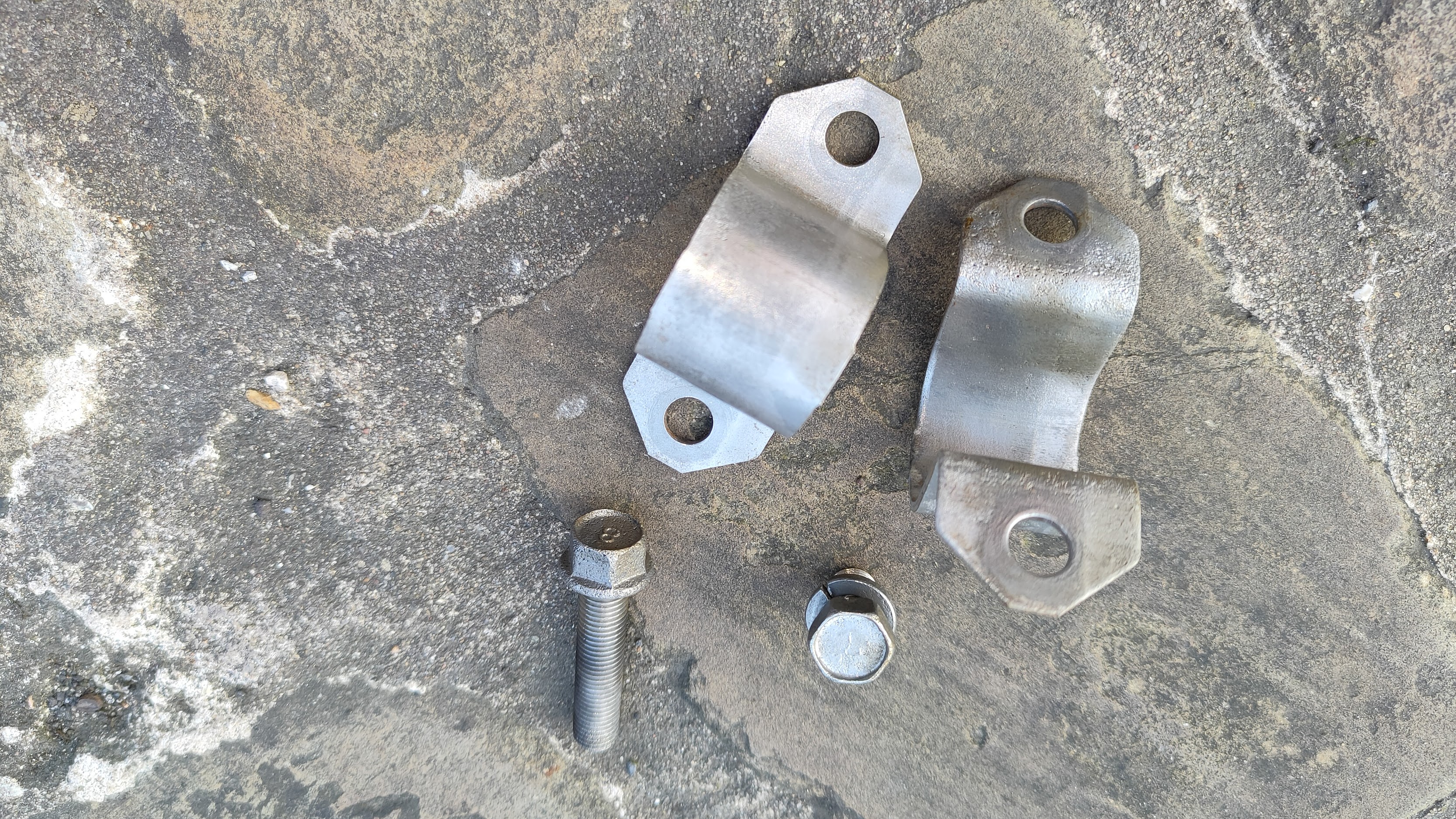

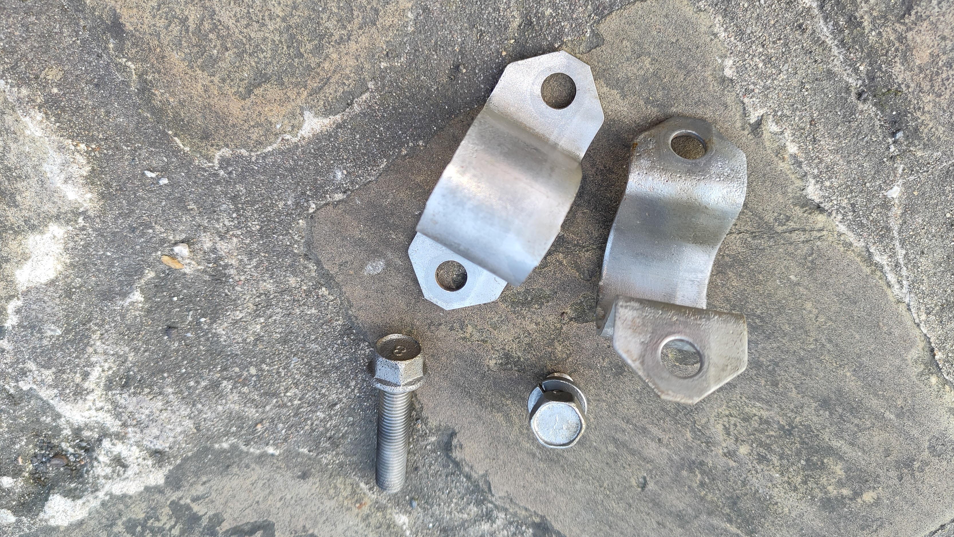

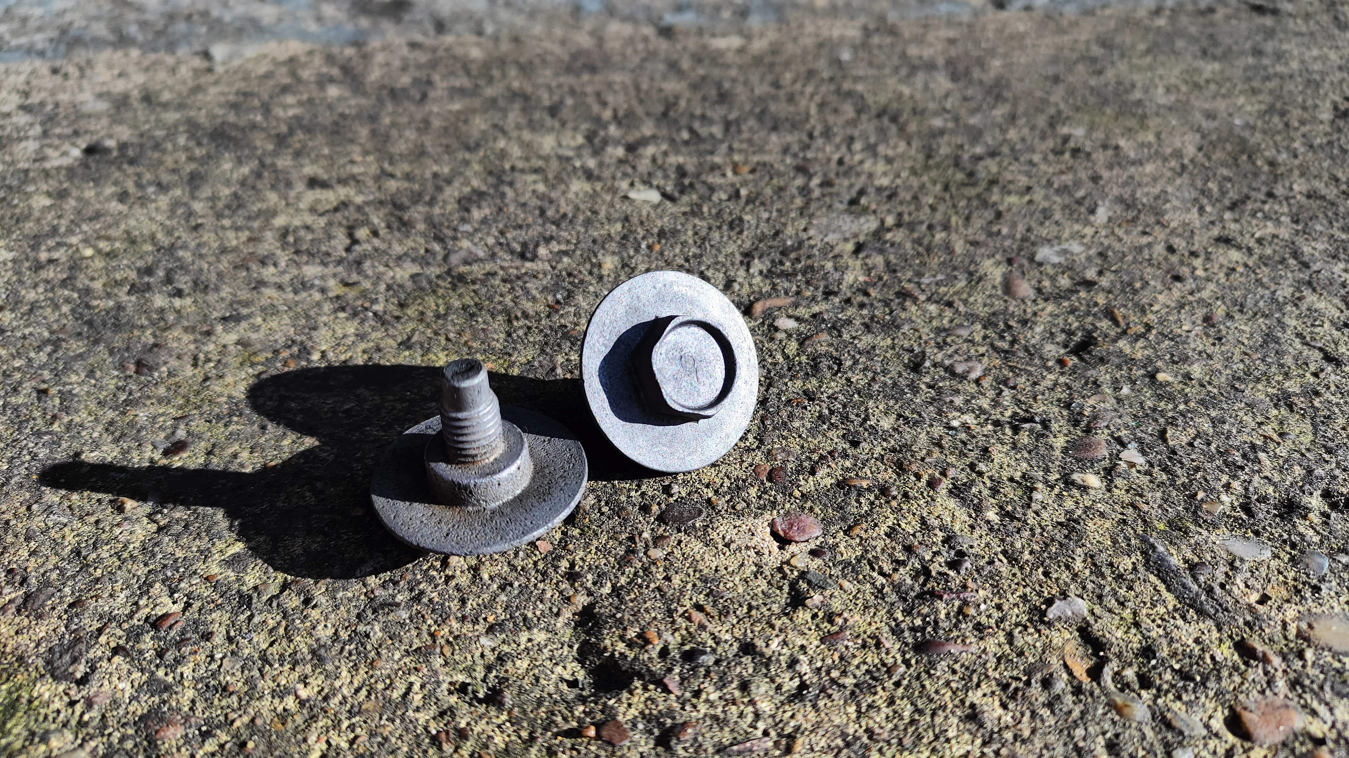

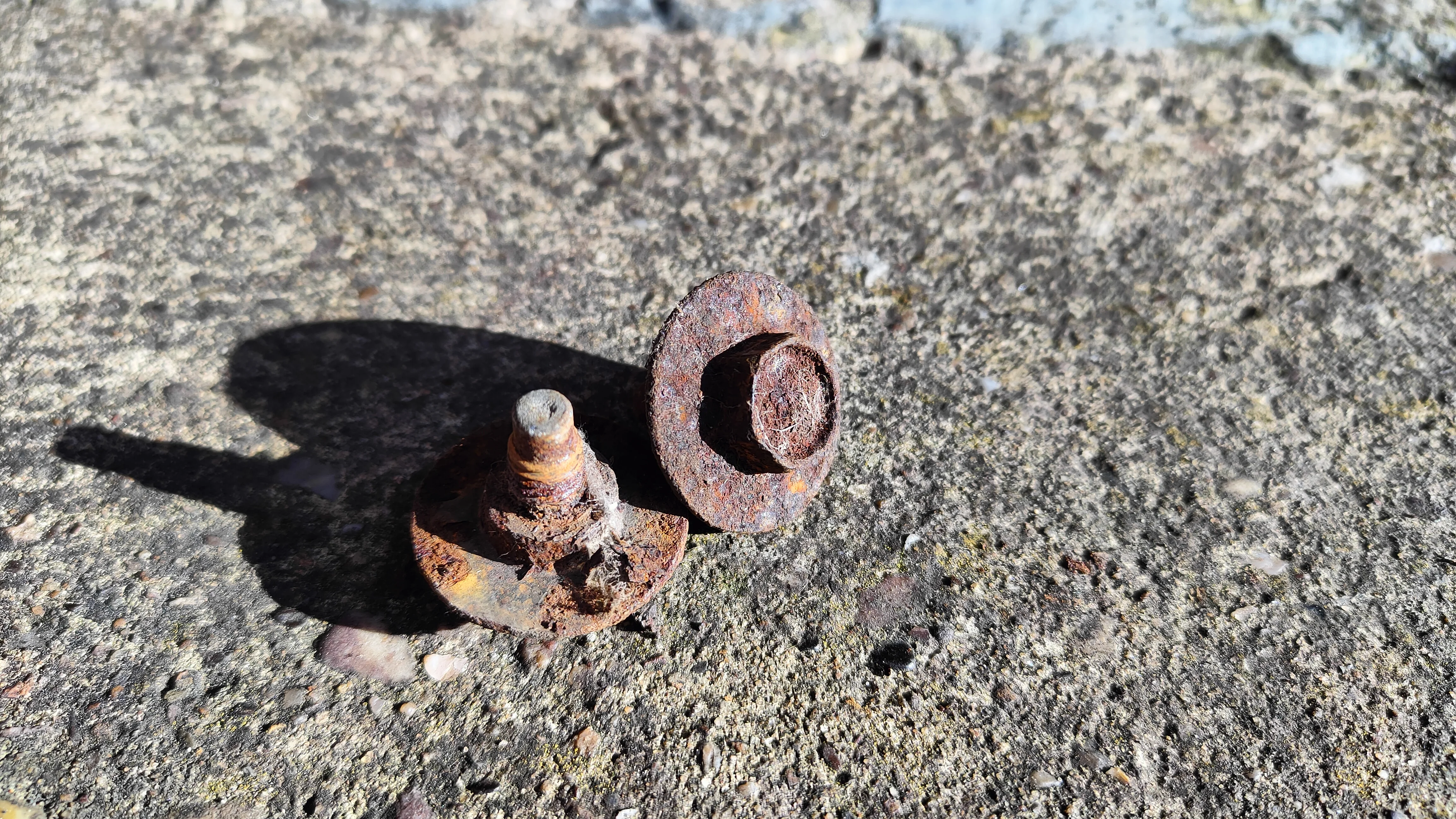

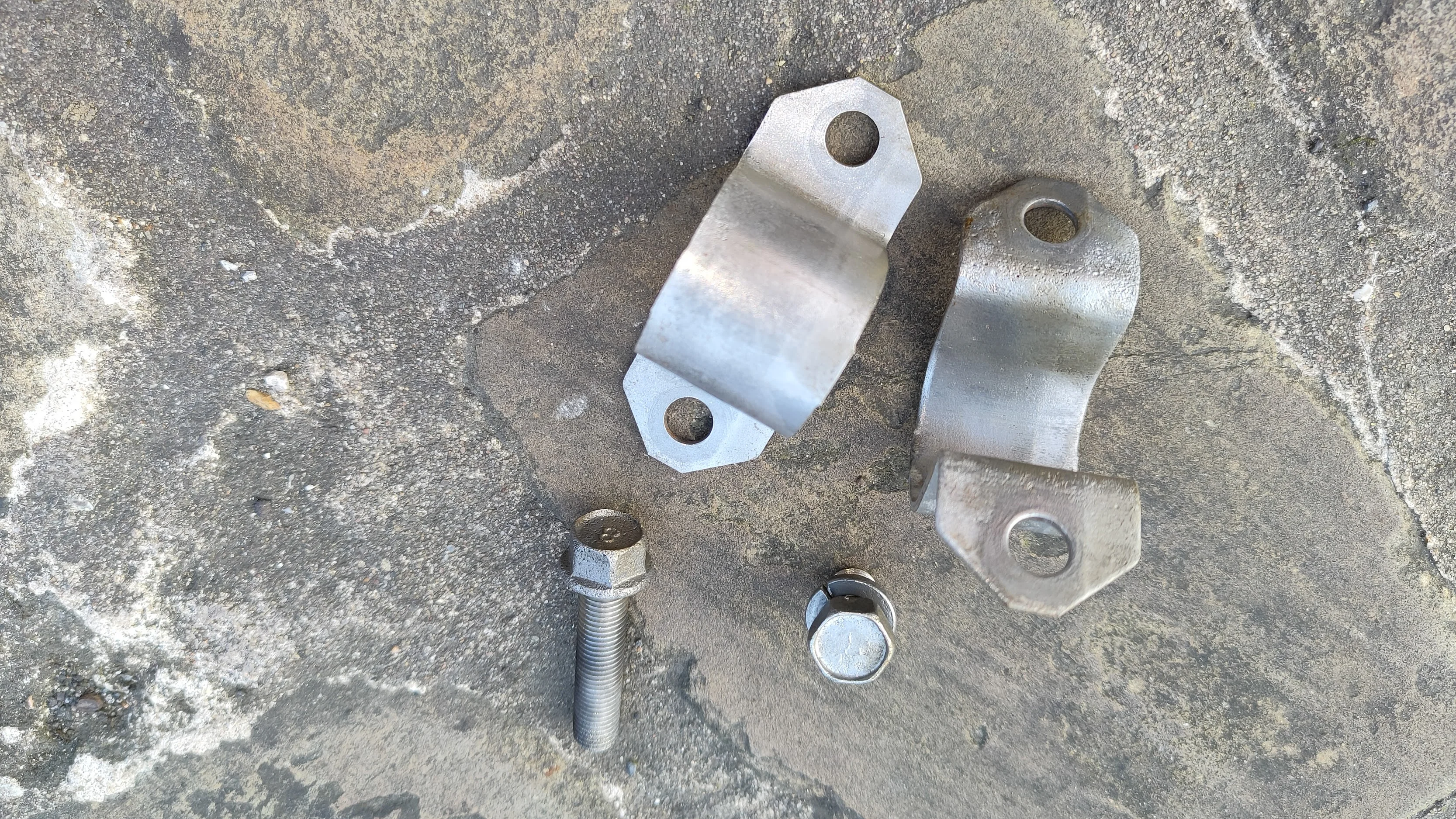

Saw this on TikTok, thought it was worth a shot. Have tried Vinegar/Coke method before but it was slow and results weren't exactly amazing.
This uses toilet cleaner, specifically Harpic (it's 10% Hydrochloric acid) as bleach based won't work.
Obviously I wouldn't try this with anything coated, or ali/alloy/plastic as it could well ruin it, and you'll want to paint them after as it'll rust pretty readily.
I wouldn't bother with basic bolts/fixings, but some stuff can be dealer order only, or NLA, or just kinda expensive for a few stupid bits.
Stuck these in a jar of the stuff and left it for a couple of days

Got some Citric Acid off eBay to give it a go. Results were really good. As you might imagine it's milder than the Hydrochloric acid in Harpic, so it's no quite so critical how long you leave stuff in there.
I found on heavily rusted bolts it forms this greyish sludge, where the Hydrochloric acid just powers right through. You can just pop those bolts into some Harpic and they come out beautiful. It seems quite good at removing residual paint as well, so small brackets and stuff come out very well.
As with HCL the Citric Acid will remove any Zinc plating on bolts, so be aware what you're putting in and how you're going to protect them when they come out.
I made the solution up at 10% weight/volume. A 250g bag of powder was £4.50, enough to make 2.5L.
