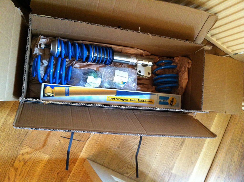

I am going to buy Bilstein B14 for my Clio 172.
Refer to your recent pictures, The rear spring is set to the lowest?

Got the alignment set today as it was terrible after fitting the coilovers and I have to say I am impressed with the bilsteins.

Hi Adamm.
My B14 kit is on the way to my country, it will be installed by myself.
Since the rear spring is set all the way down, do you feel the rear end may have further lowered after driving for a few times?
Is there any recommended pre-set ride height by Bilstein?

Urm it could have dropped a tiny bit more but nothing I have noticed since having them fitted.
Tbh mate I'm not sure if they do but its not really advised to go all the way down, I'm still impressed with them all the way down though.

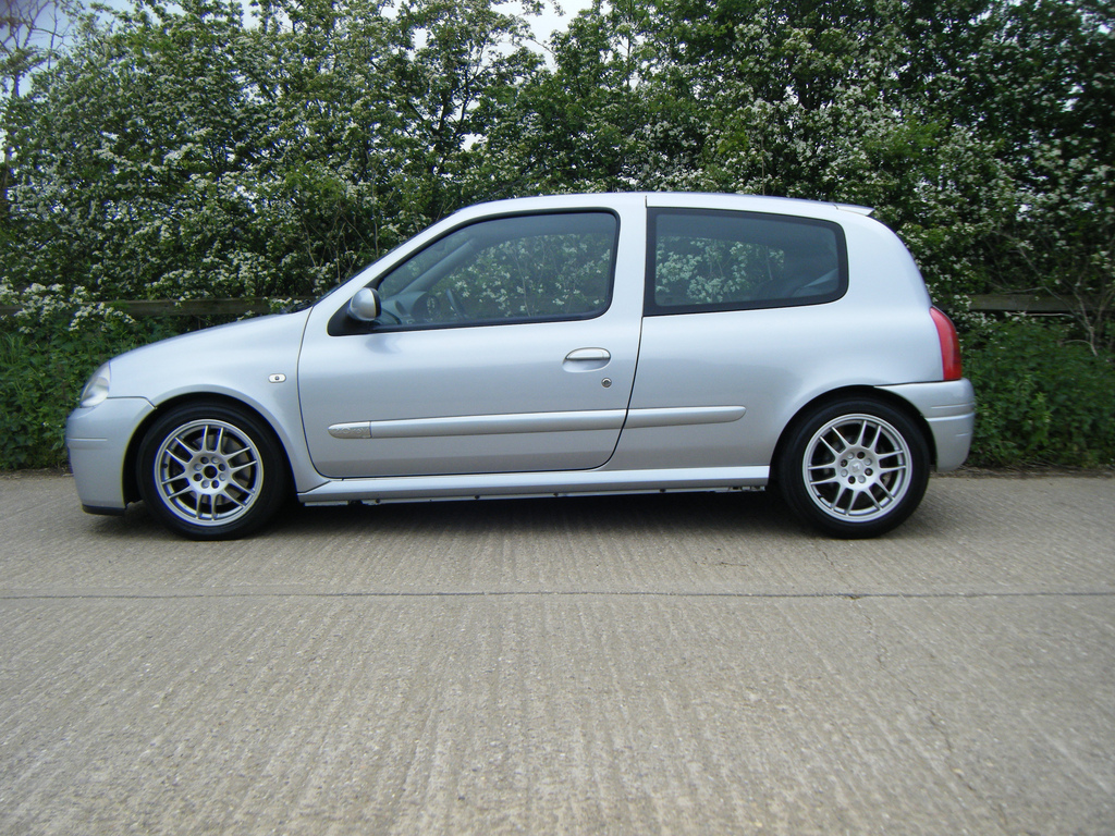

Looks spot on!
