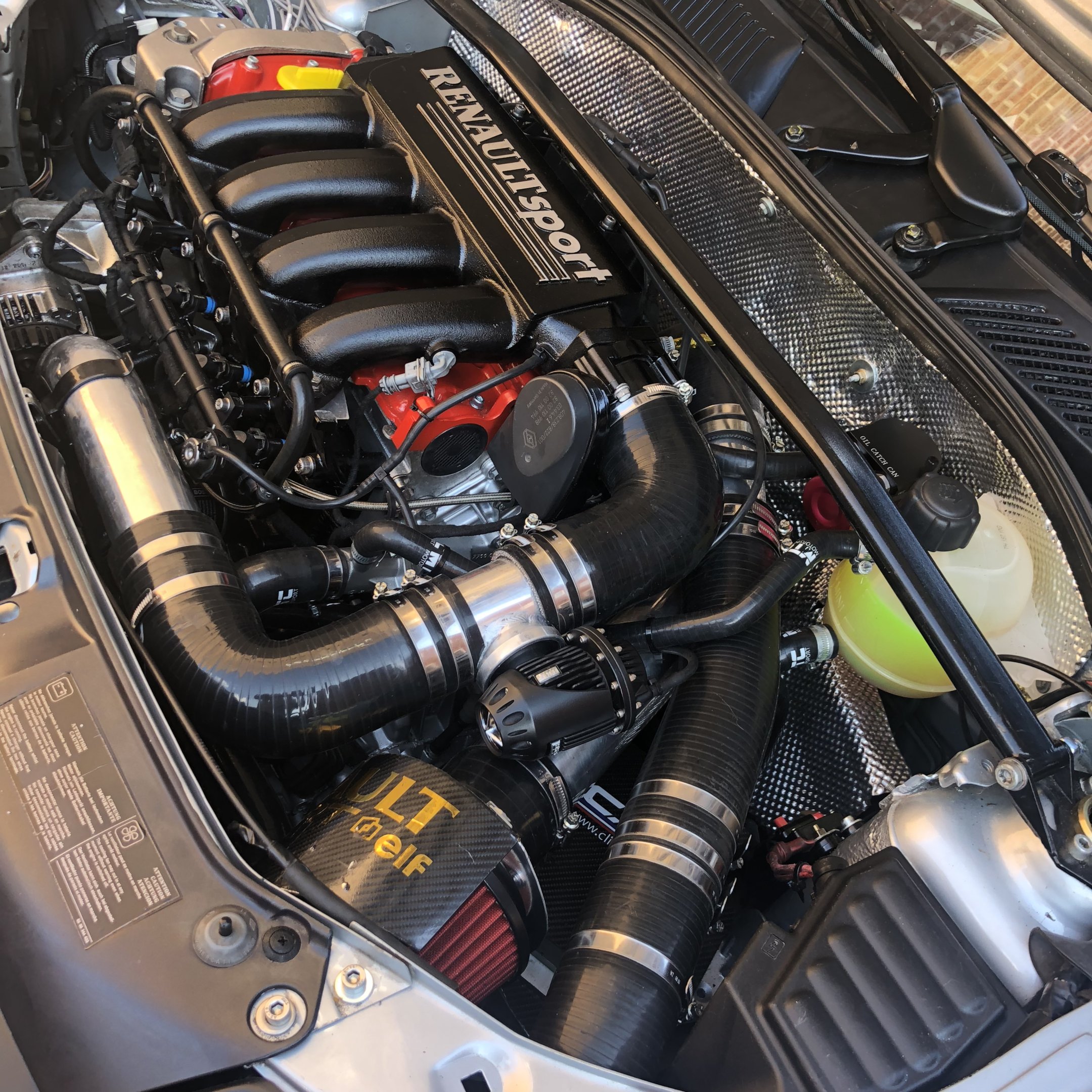

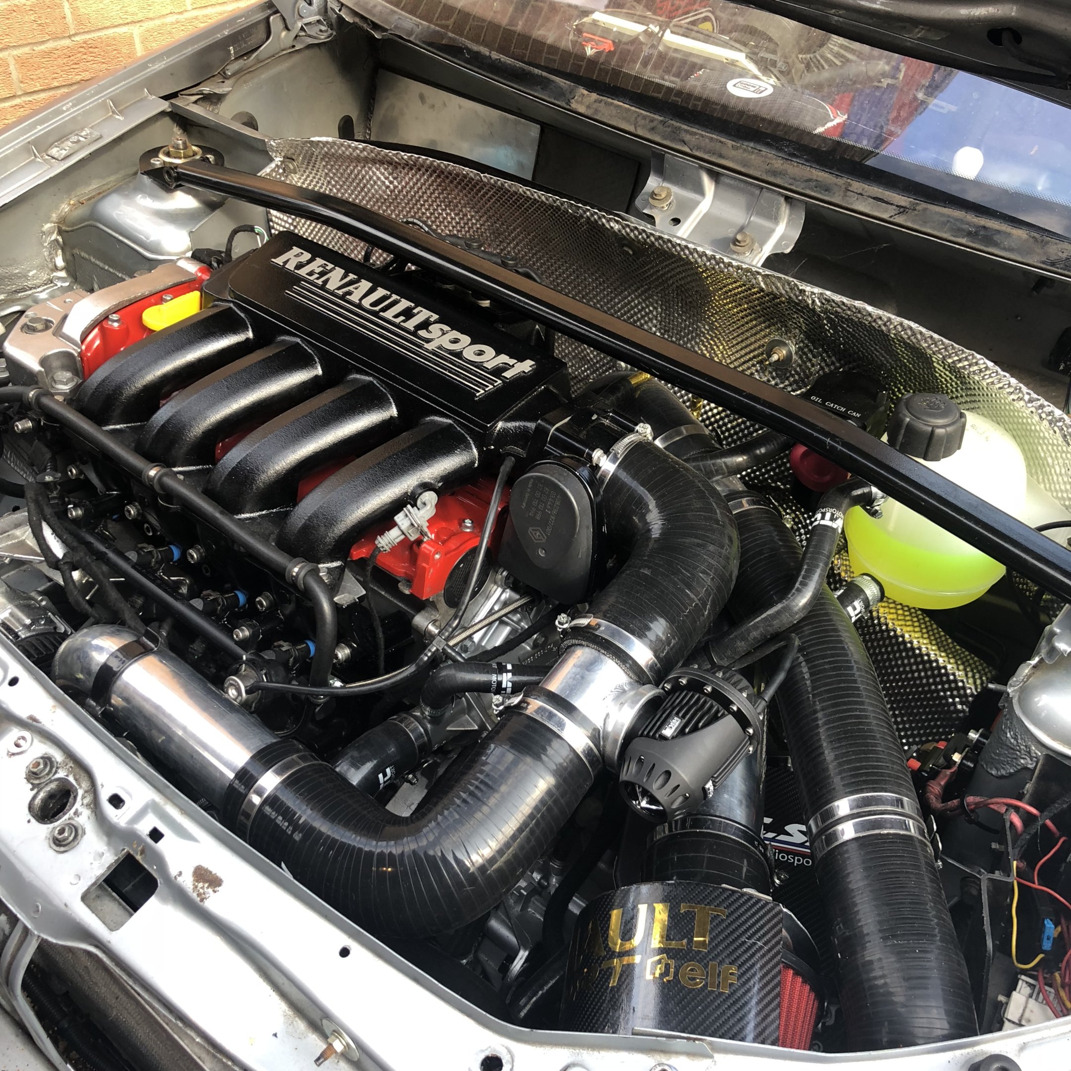

Had a few teething problems but it’s in and running. Completed a 20min break in with the millers running in oil, dropped that out and replaced with the same oil to do a 500 mile run in, just need to mot it now.
Managed to get a 3” intake in, made a massive increase in torque to my mates so hoping for the same.
JezzaMac
Very nice build! What size intercooler pipework is that? 2.5”?
Do you know how many silicon 90’s and hard pipe 90’s you’ve used as I’m about to order an intercooler and pipework mine.
  172
It’s 2.5” I’ll check the bends next time I’m there, some are not standard lengths some are a lot longer then normal, there’s some unusual bends in there to.

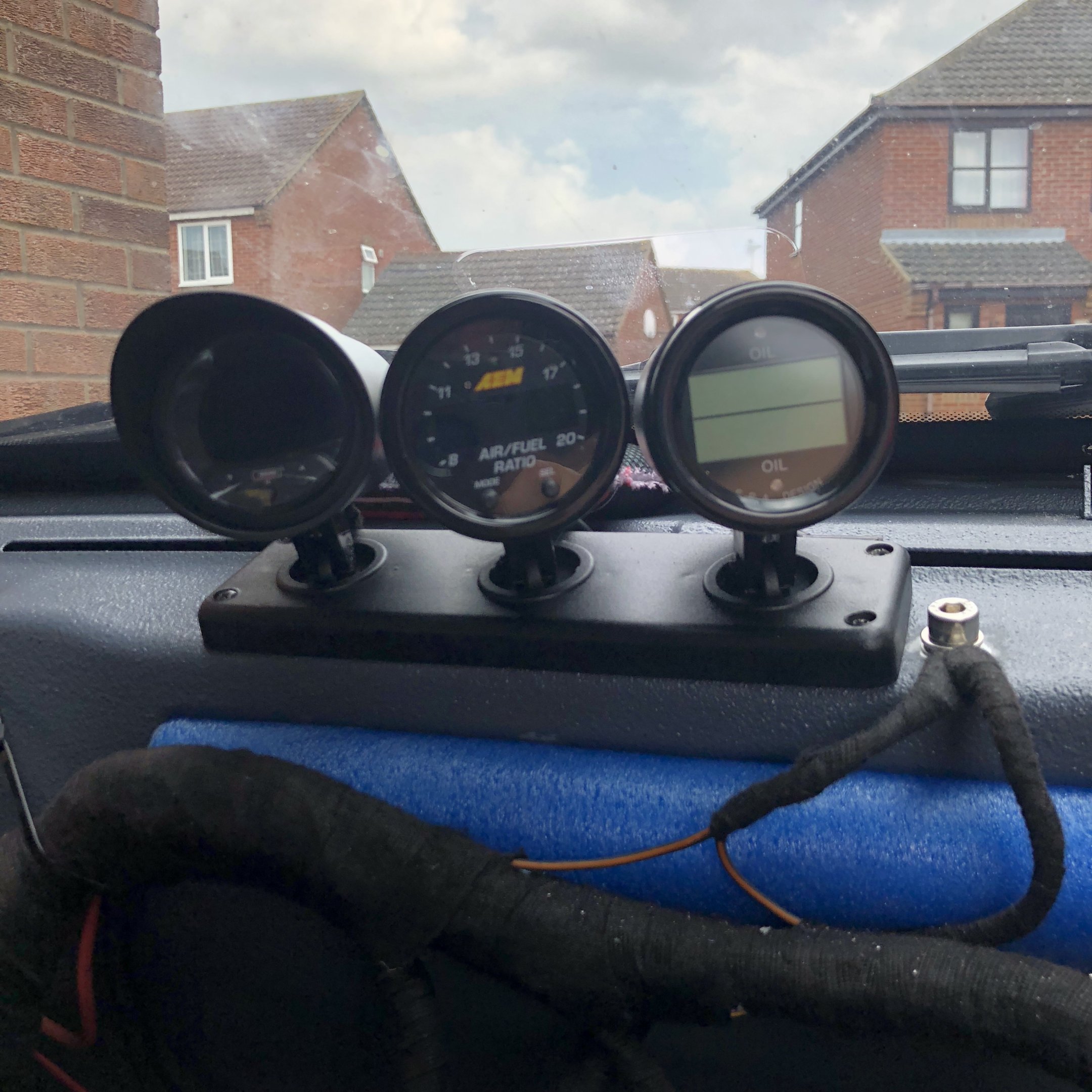

Gauges next.

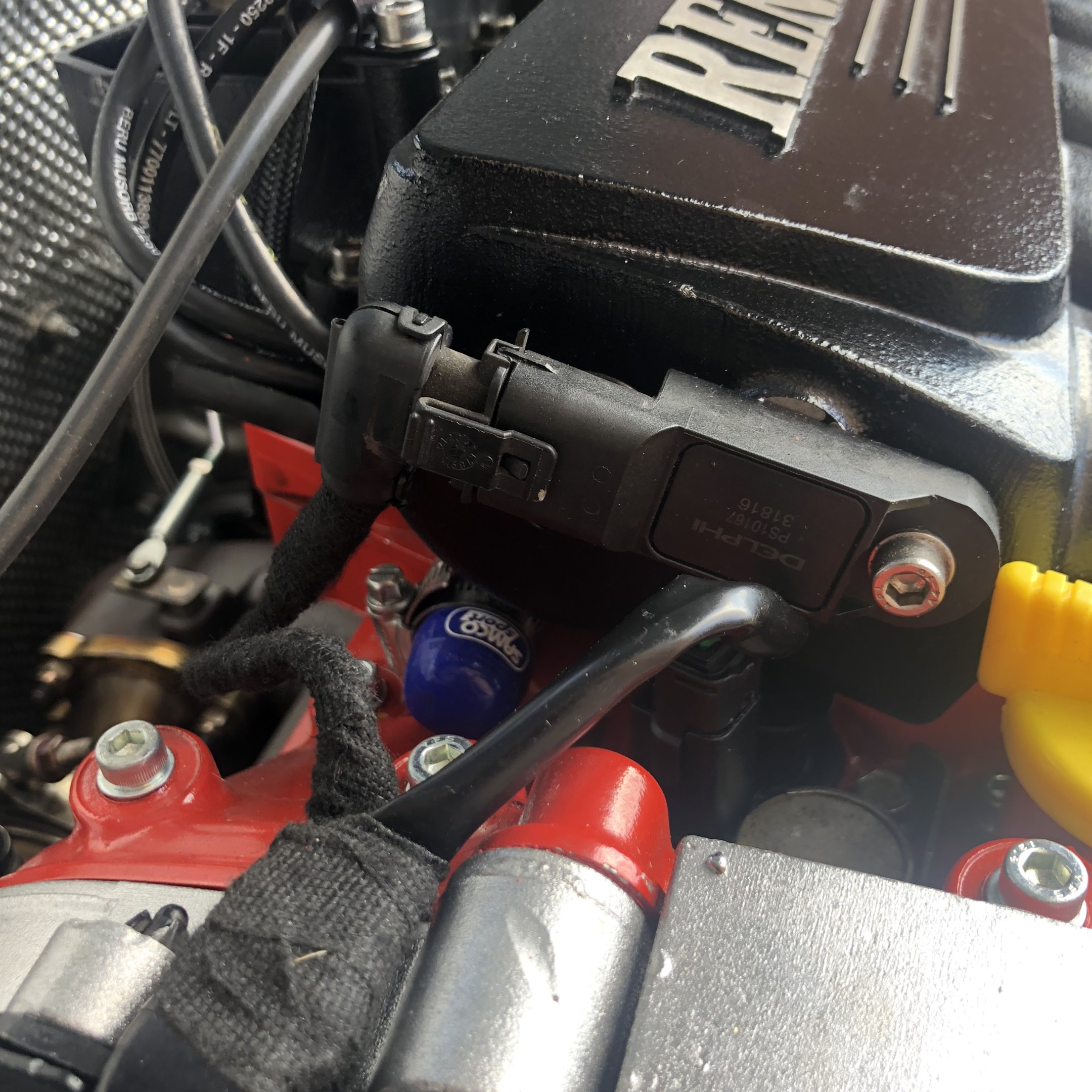

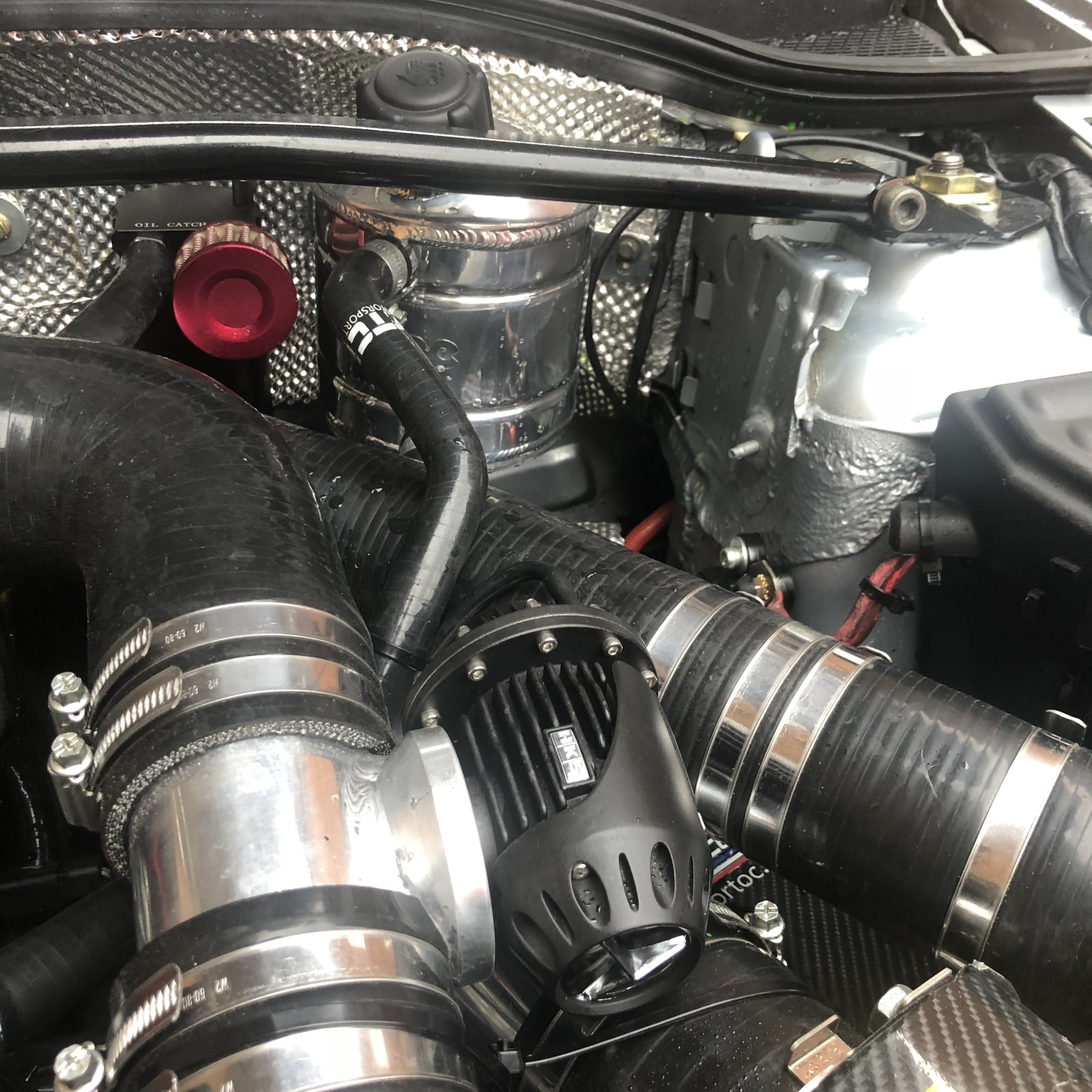

Beeen getting car ready for MOT and generally tidying things up over the last few days, modified inlet manifold to accept a 2.5 bar megane 225 MAP sensor then spliced a megane plug into my Clio loom, much better now it has a bolt in sensor that won’t blow out under boost.

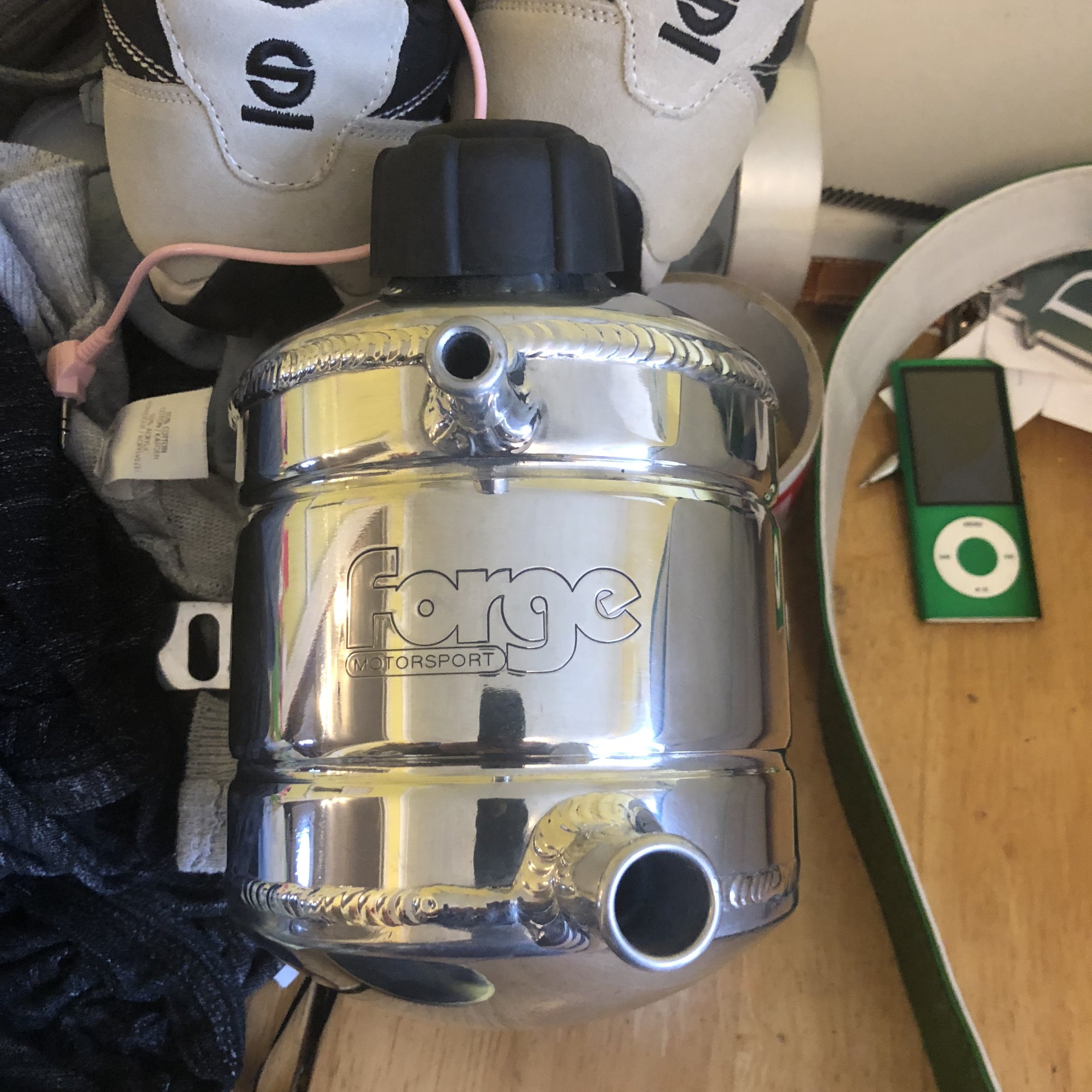

Got my MOT and done my first 100miles of running in tonight, fitted my new header tank to.

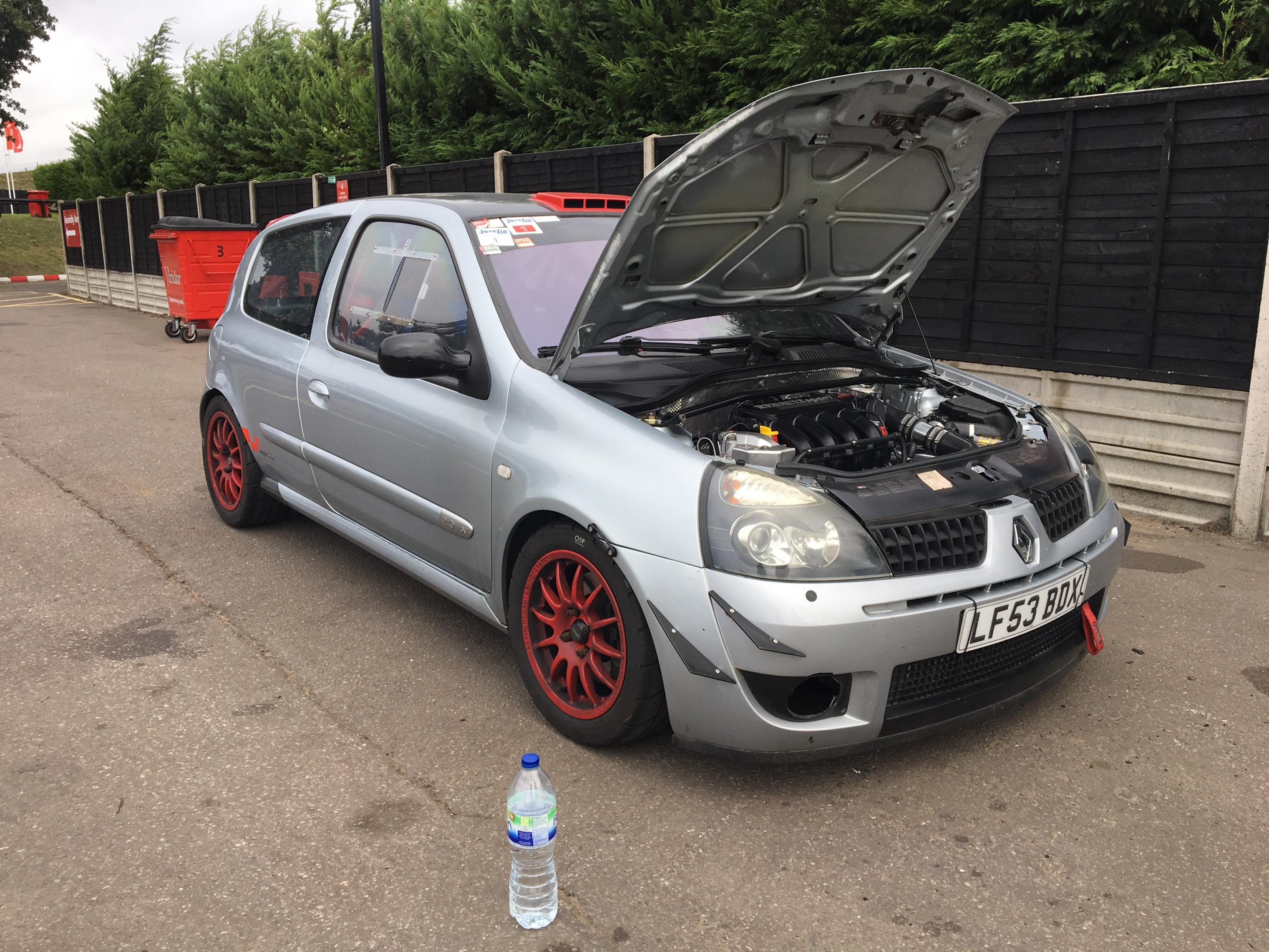

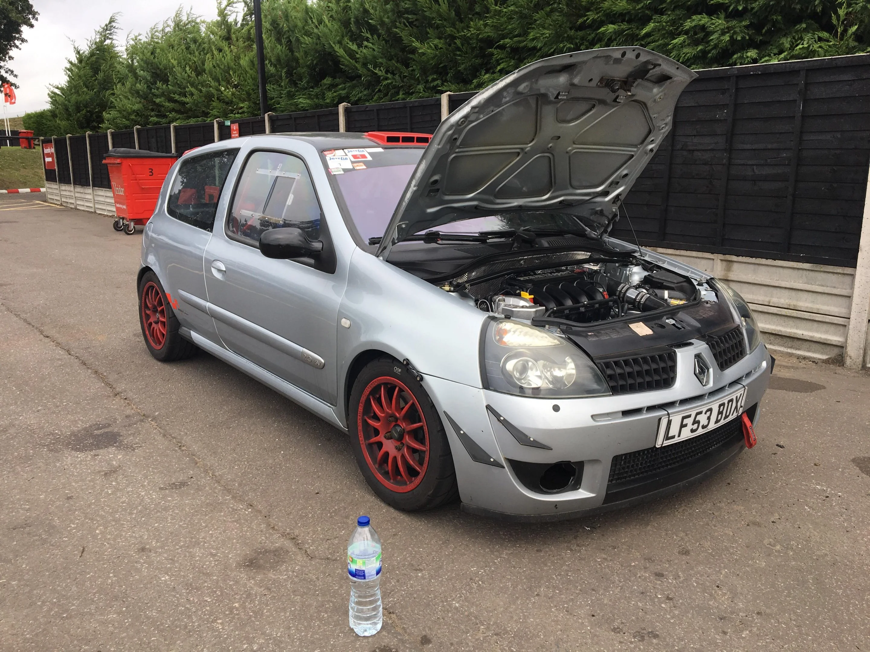

So a mate of mine in his cup was having a little play at a certain venue today and spotted this...
Mental looking project and hopefully a short report back of the days antics soon??

Was your mate in the blue 172? Hope he had a good day . There was a black 182 on throttle bodies to, think he’s also a member.
He is indeed, I've yet to hear the full story from him, but your car definitely left a lasting impression! I was planning on heading there with him but once again mines broken
  172
Ahh! I only went up to put a few more miles on it, didn’t go round.
Let me know if you go there again and I’ll come join you if I’m free.

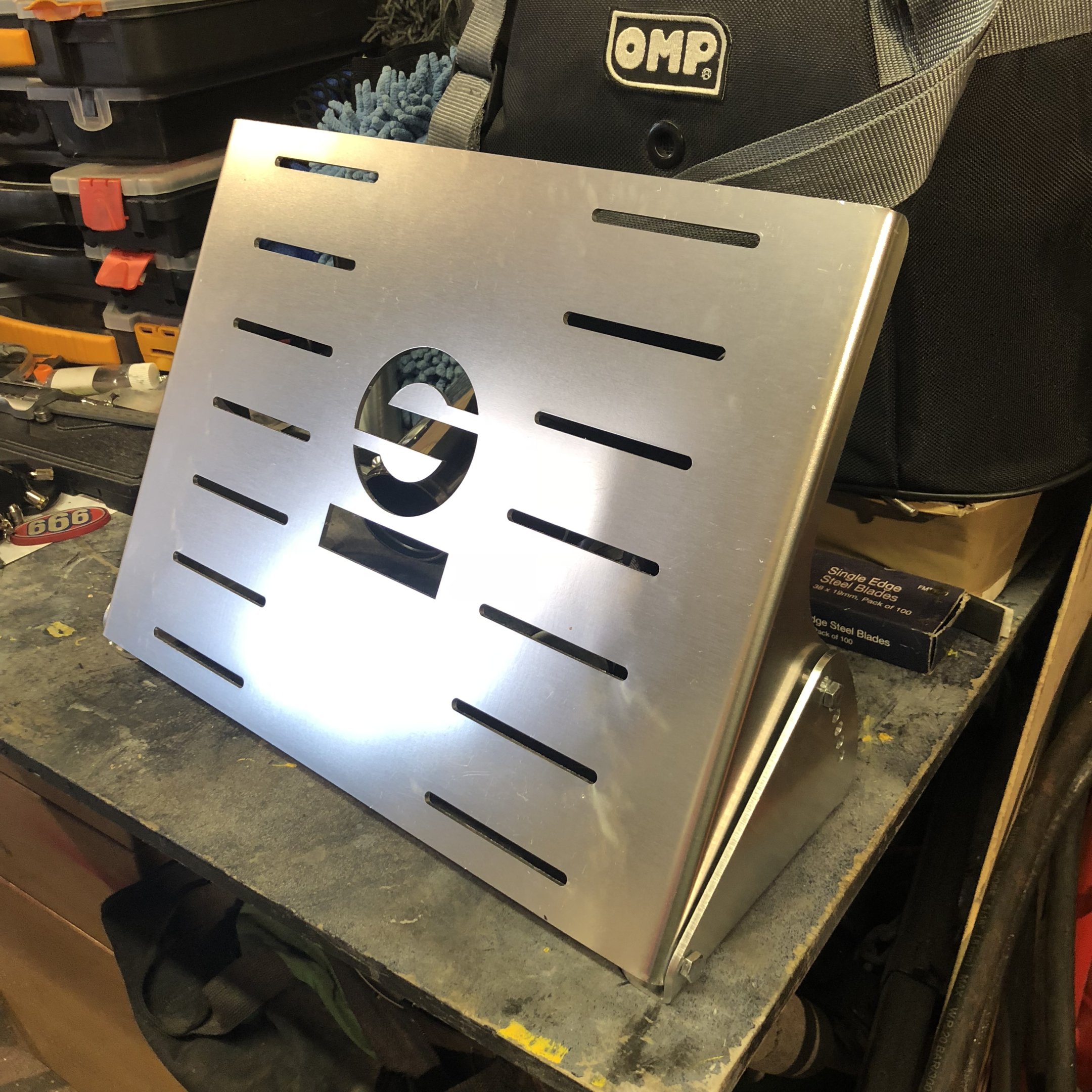

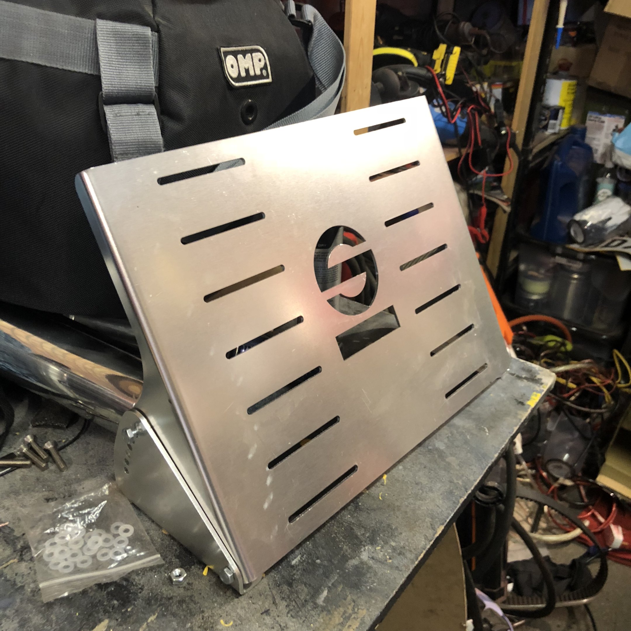

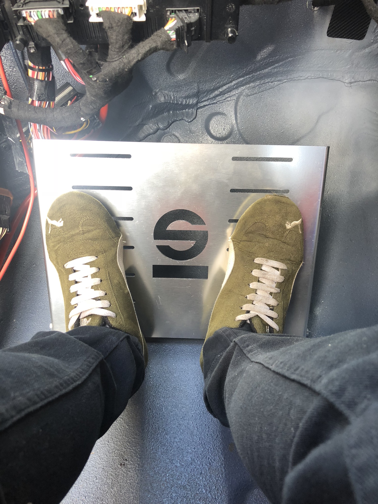

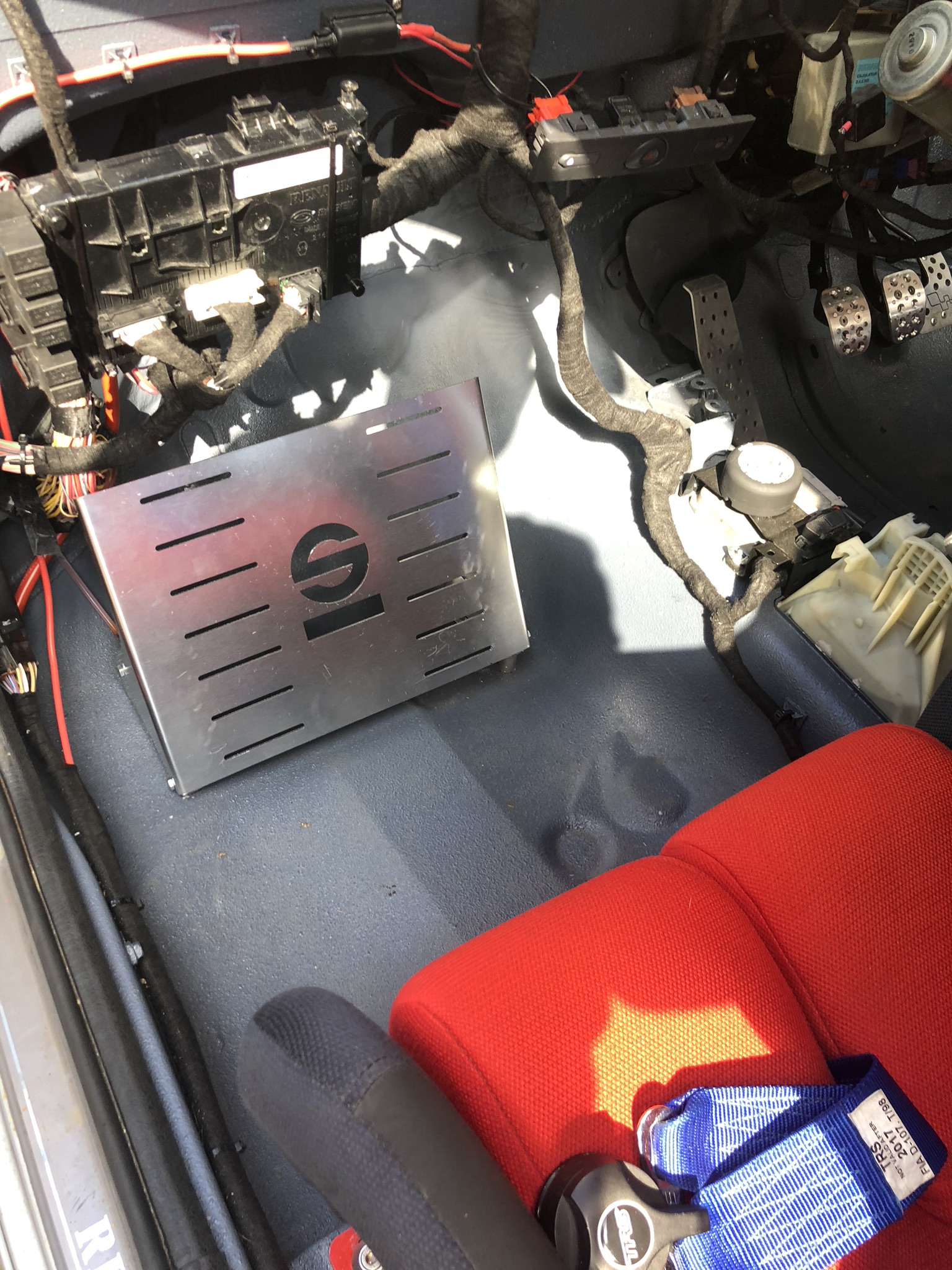

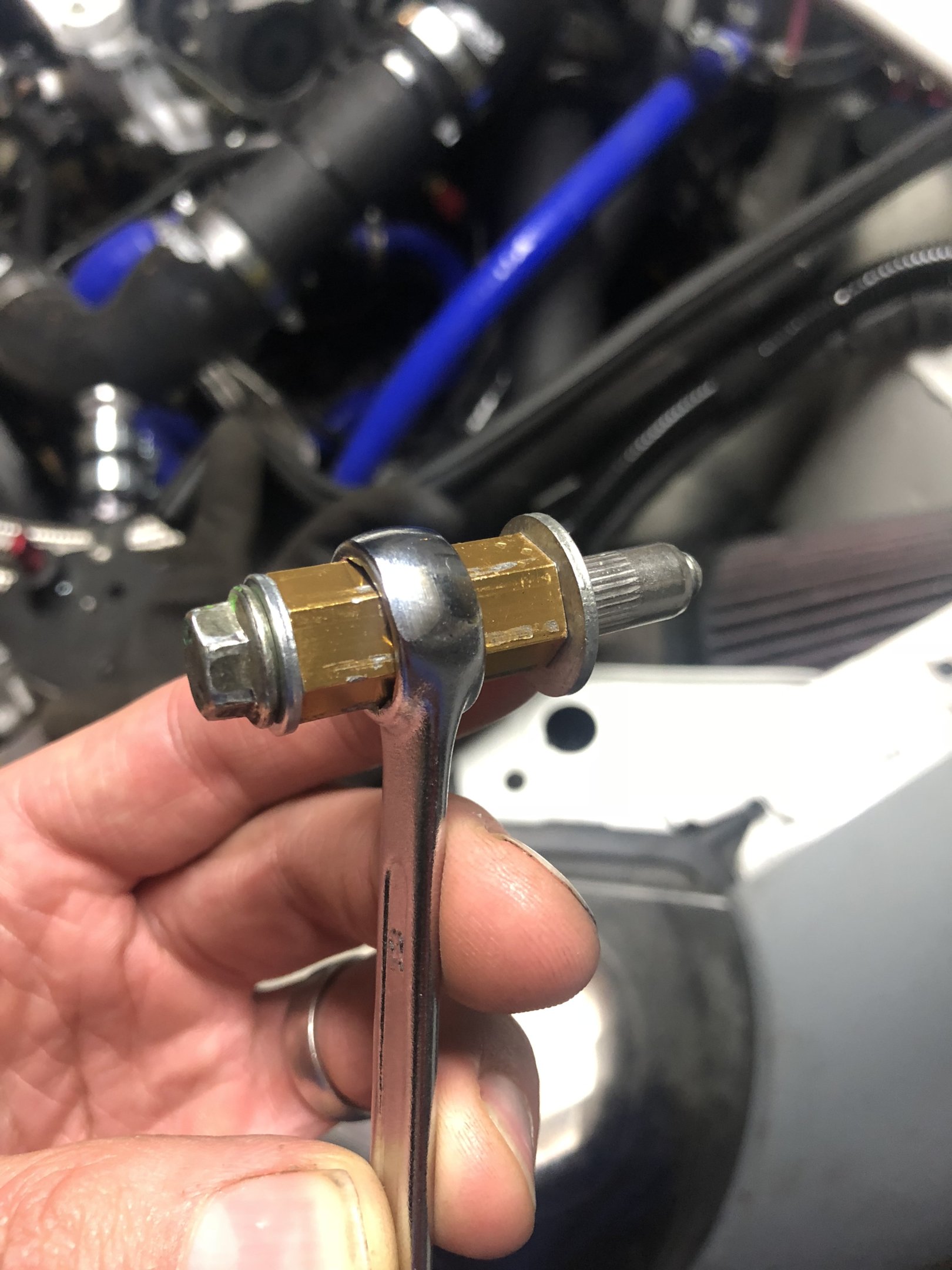

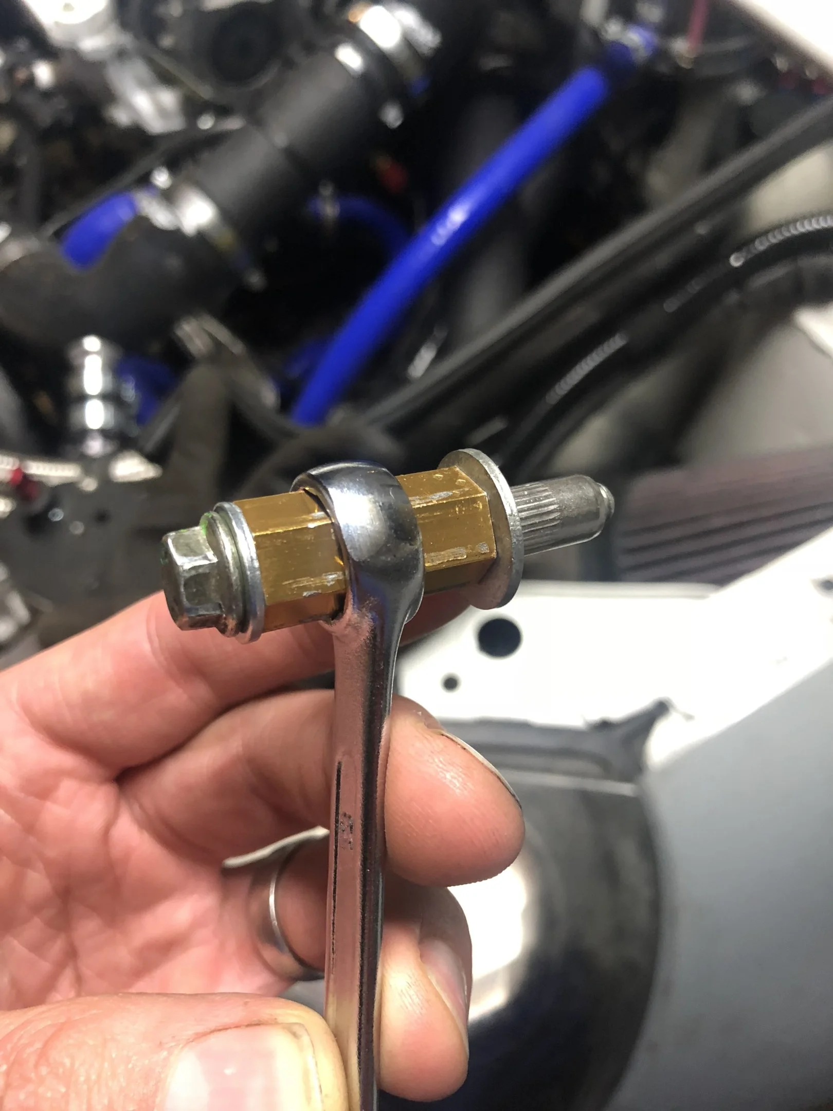

Passenger foot rest, looks a b*****d to fit without welding some nuts to the floor as it’s double skinned one side and big gap between the skins
RuskiWeldFab
  Clio 172, RS4 B7

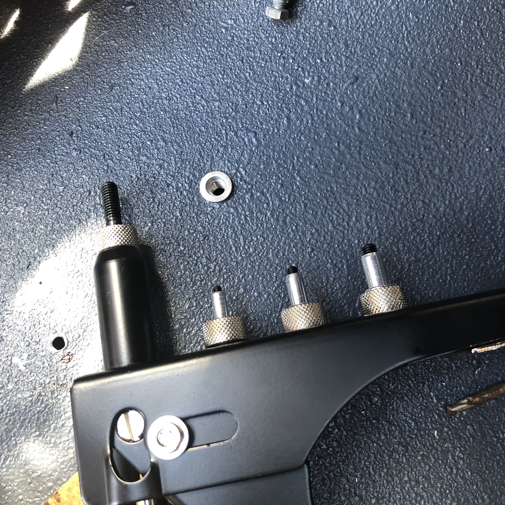

you can make one. don't need a gun. i use this. works perfectly! hold with 13mm and tighten with a torque wrench.
works best with aluminum rivets(softer) but also used stainless. although need a high tensile bolt in the center.

Got a link for the one you got? May as well get one myself hahah
Mbeau
  Clio 172
Bought one for putting the side skirts back on the track car so that I can remove them in the future without having to drill rivits out.
Mine is a Lazer one from Halfords. Gets mixed reviews, but has done what I needed it to!
Get the best one you can find, makes them so much easier. I got a long arm one but if I'd known how much I would of ended up using it I would of gone for a ratcheting one instead.
  172
I bought the laser one as I’ll only use alloy rivnuts, if your planning on steel ones or using it a lot I’d agree with bloke and but a decent one. The sealey, burger and laser ones are the same just a different colour
I bought mine from Epic Tools £22 as it’s only round the corner from me, wouldn’t of paid Halfords price for it.
I didn't pay the Halfords advertised price ?

Was me in the blue cup at snett the other day haha good to meet you mate. Keen for a tear up with everyone soon!
  172
Just read through the whole thing. Amazing work mate
Good to meet you to mate, hope you had a good day.
I was going to do a 15min session between the Time Attack on Sunday but until it’s had the boost limited in the lower gears there’s no point as it’s absolutely useless at the moment.
