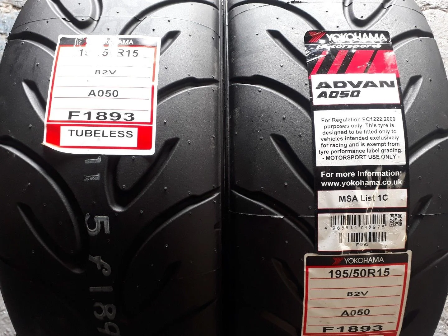

In other news.. I bought some tyres to help with traction, was going to go for full slicks but the rules for Snetterton say you must have a FIA approved cage, although mine is approved it’s only a rear cage which seems a bit of a grey area at the moment.
In the end I went for the next best thing.

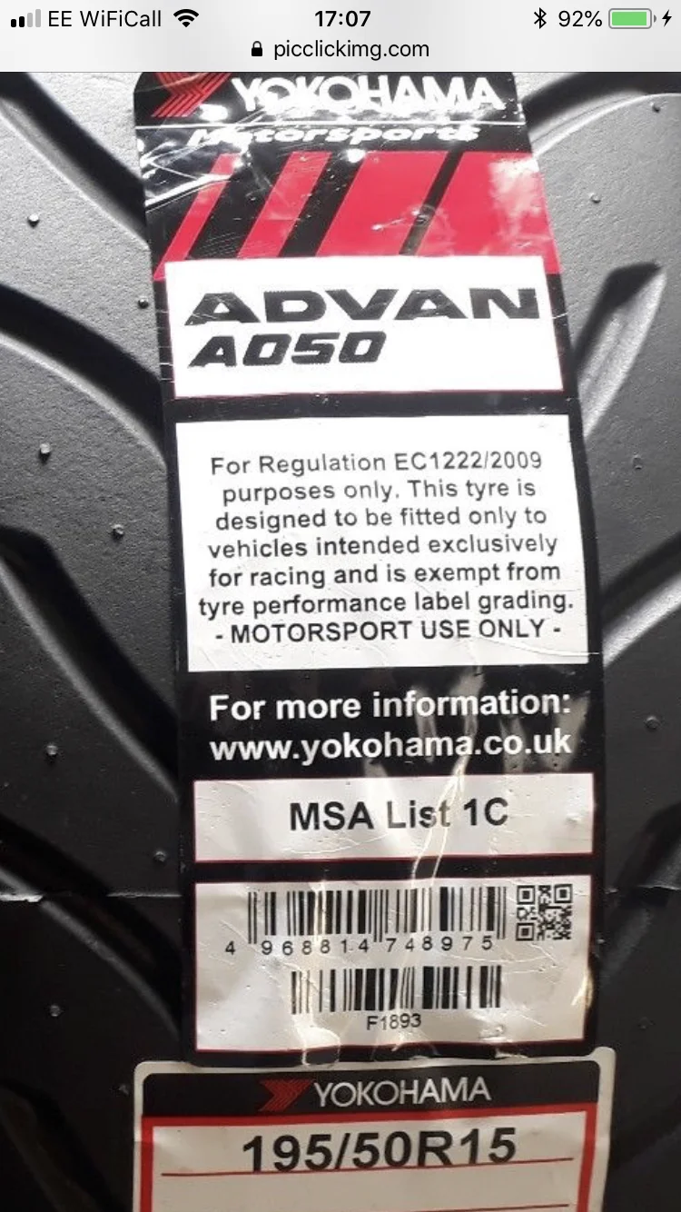

4 x A050’s these have brilliant reviews for grip, although not road legal they’ll not cause me any trouble at the track.
  172
Yeah I’m pretty sure it says Motorsport Use only or something similar on the sidewall. I’ve got another set of wheels with PS3’s I was using as wets so they’ll do for the road.

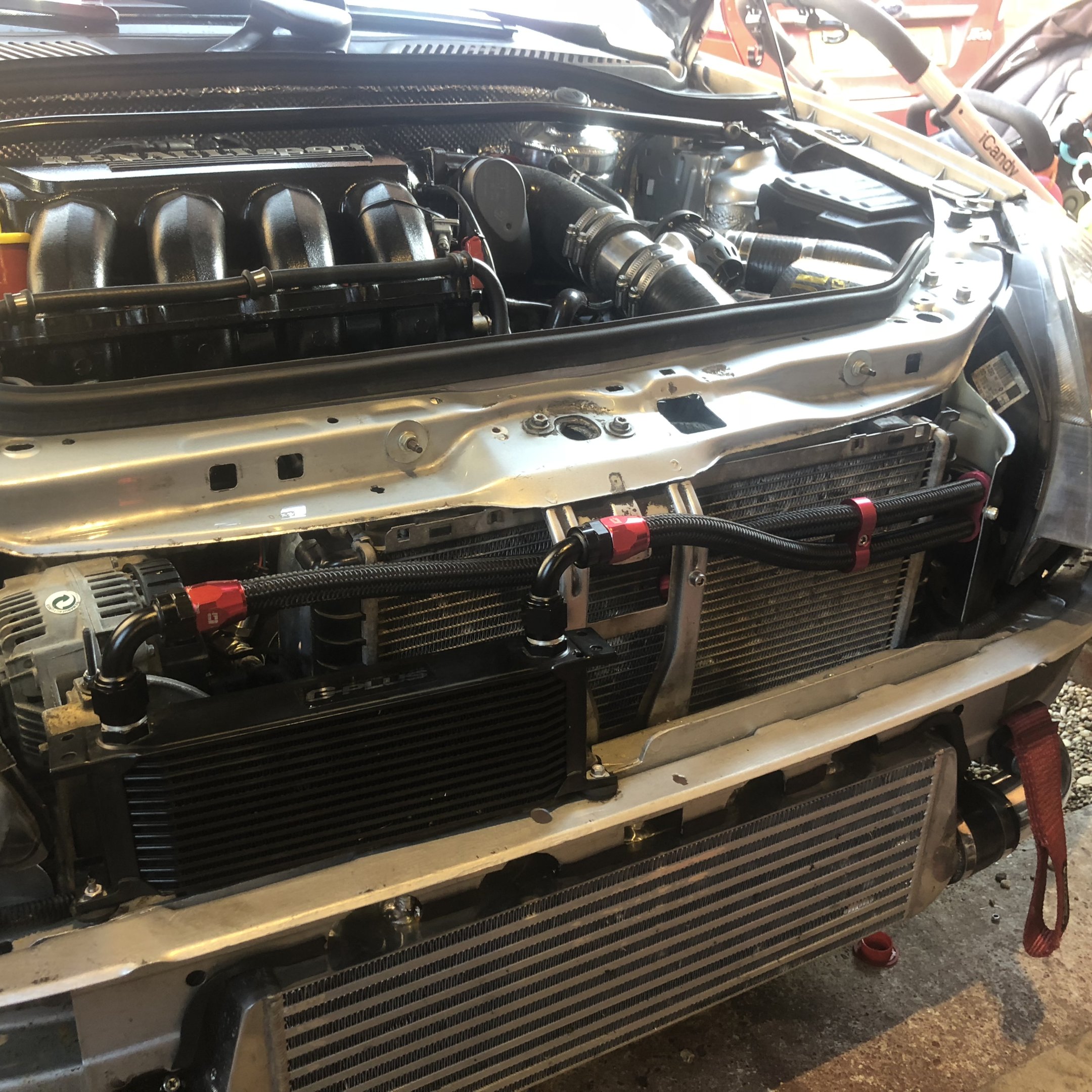

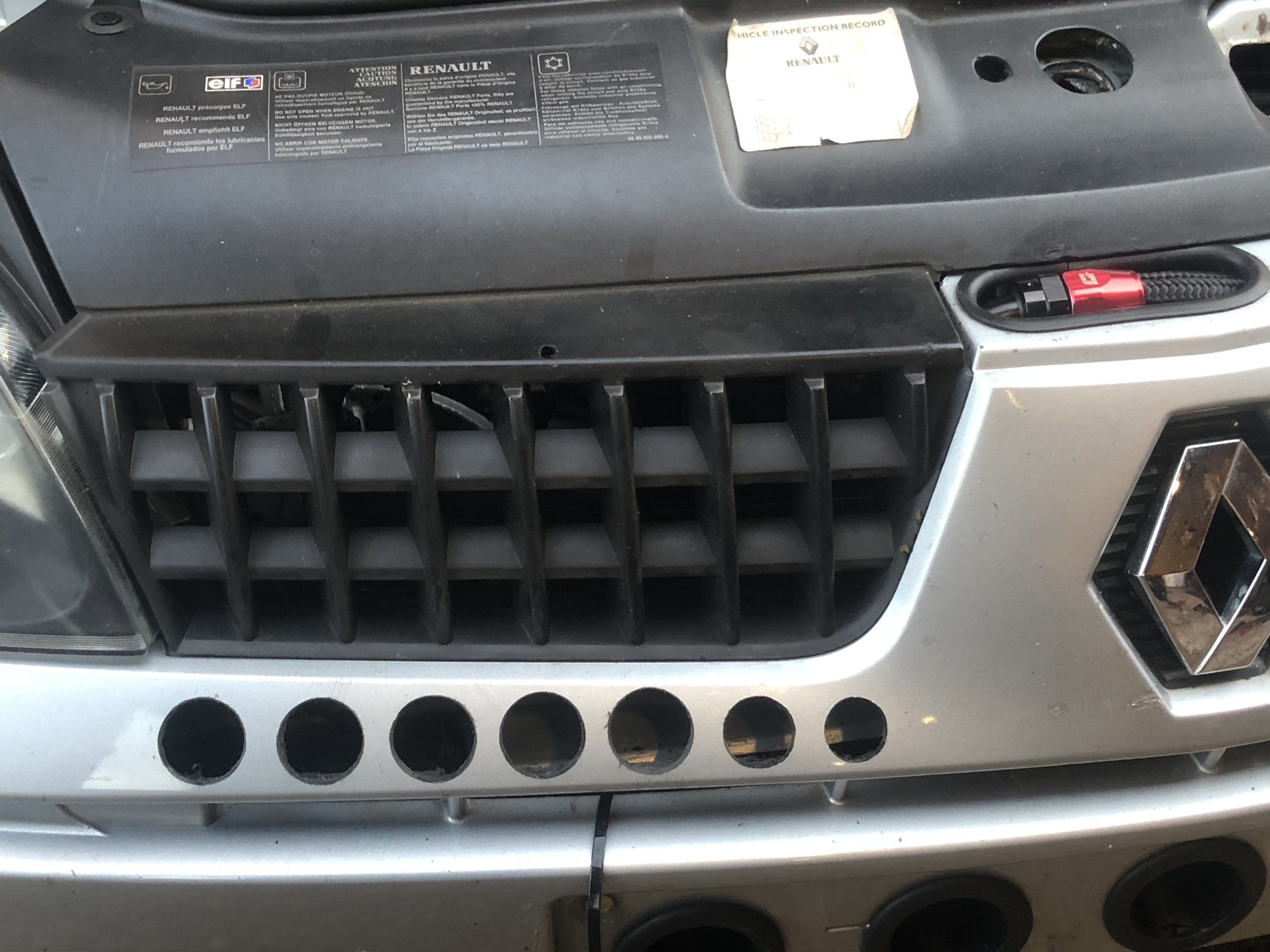

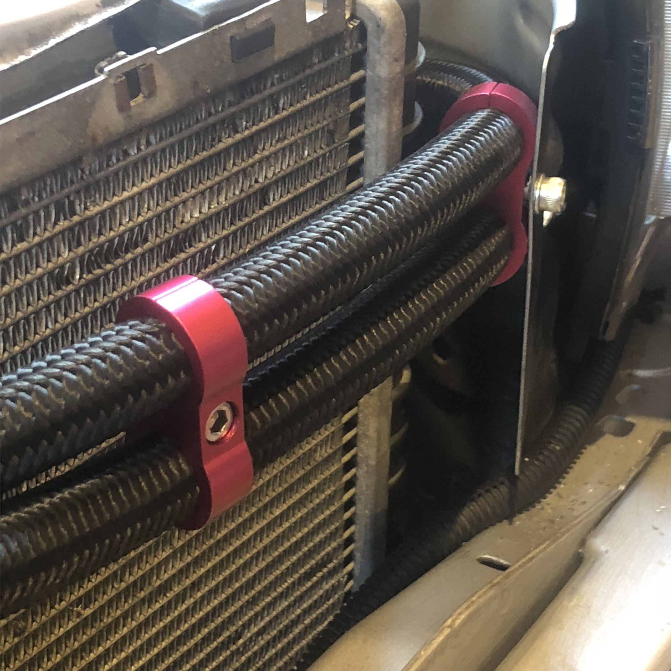

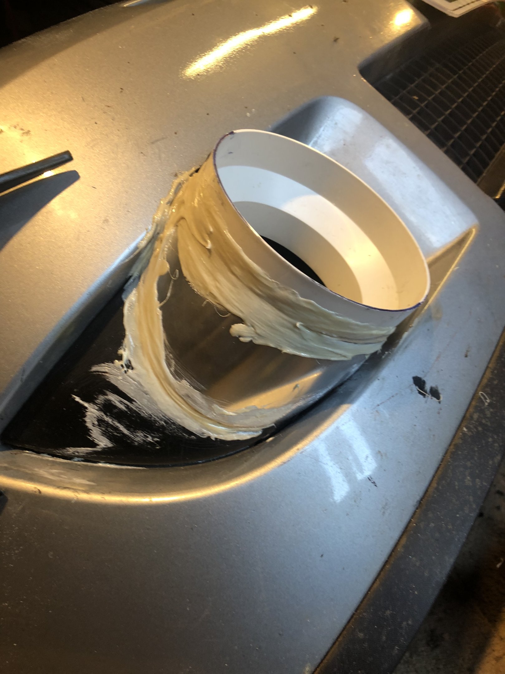

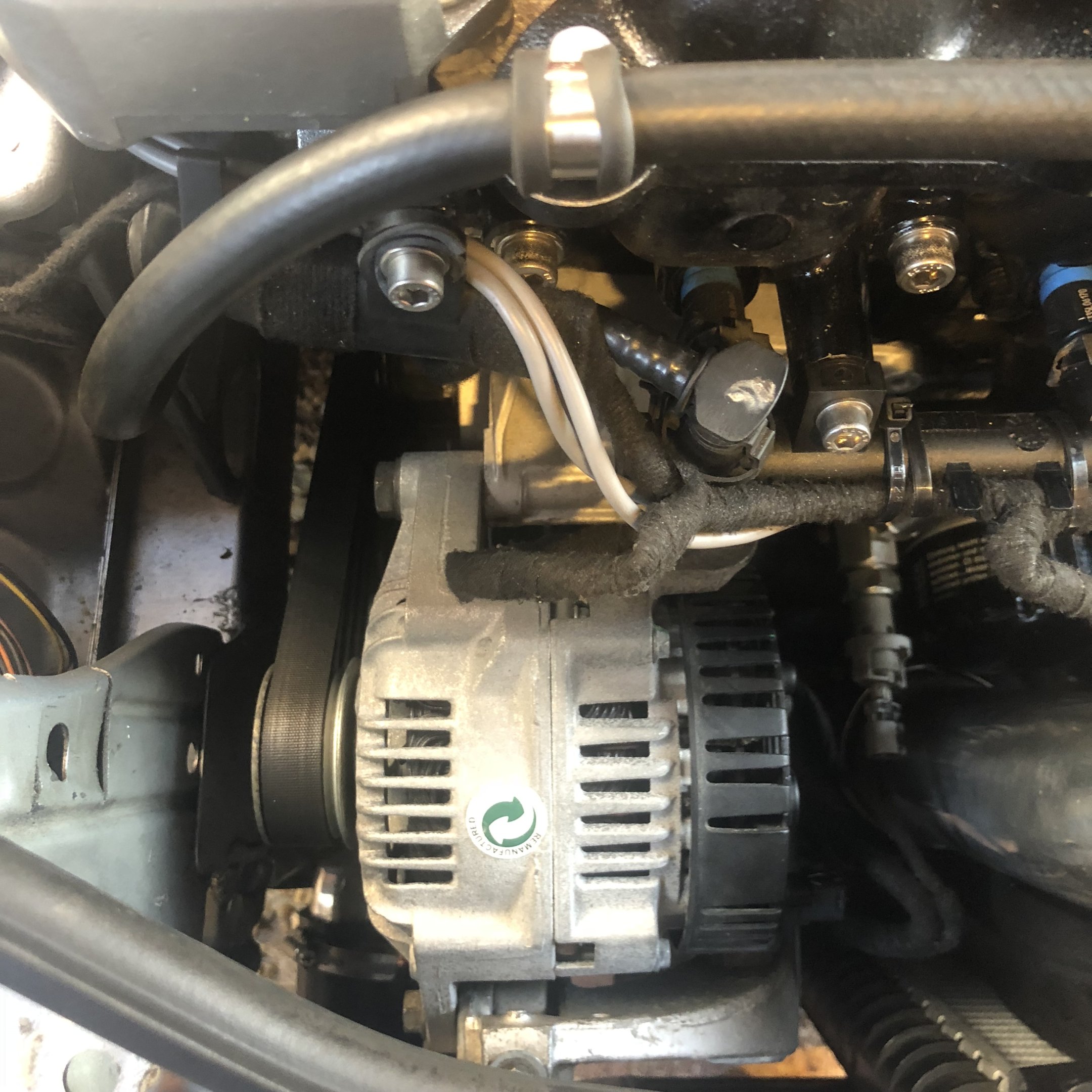

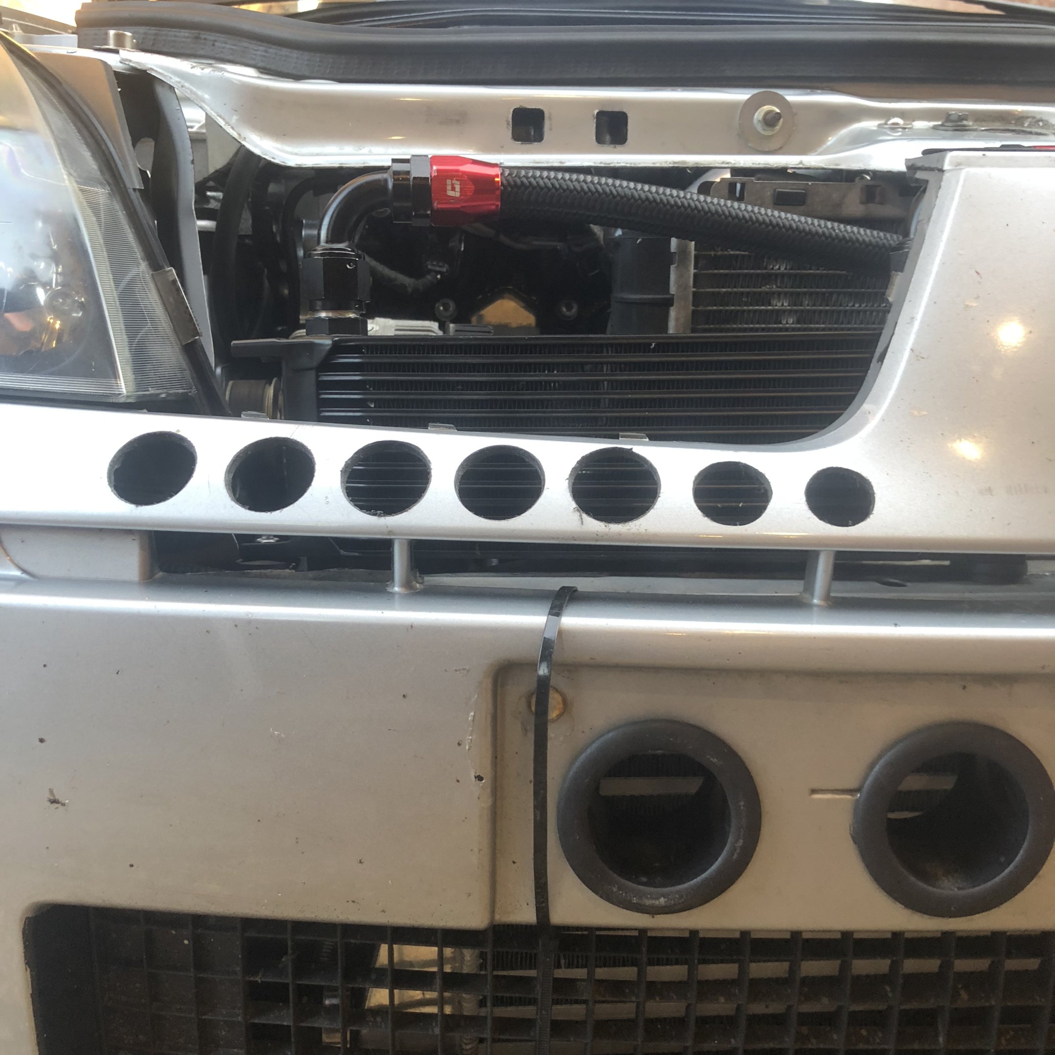

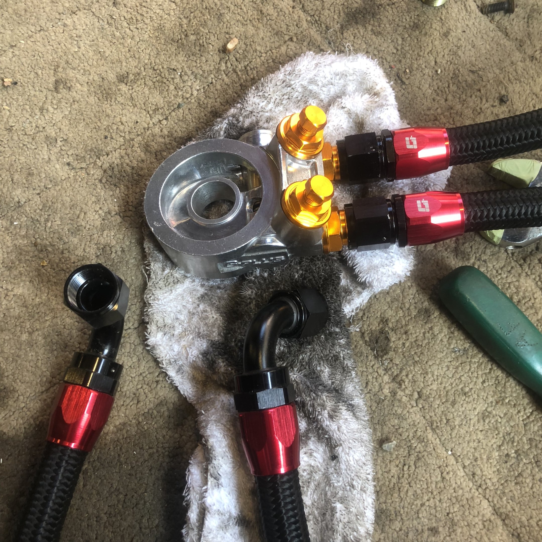

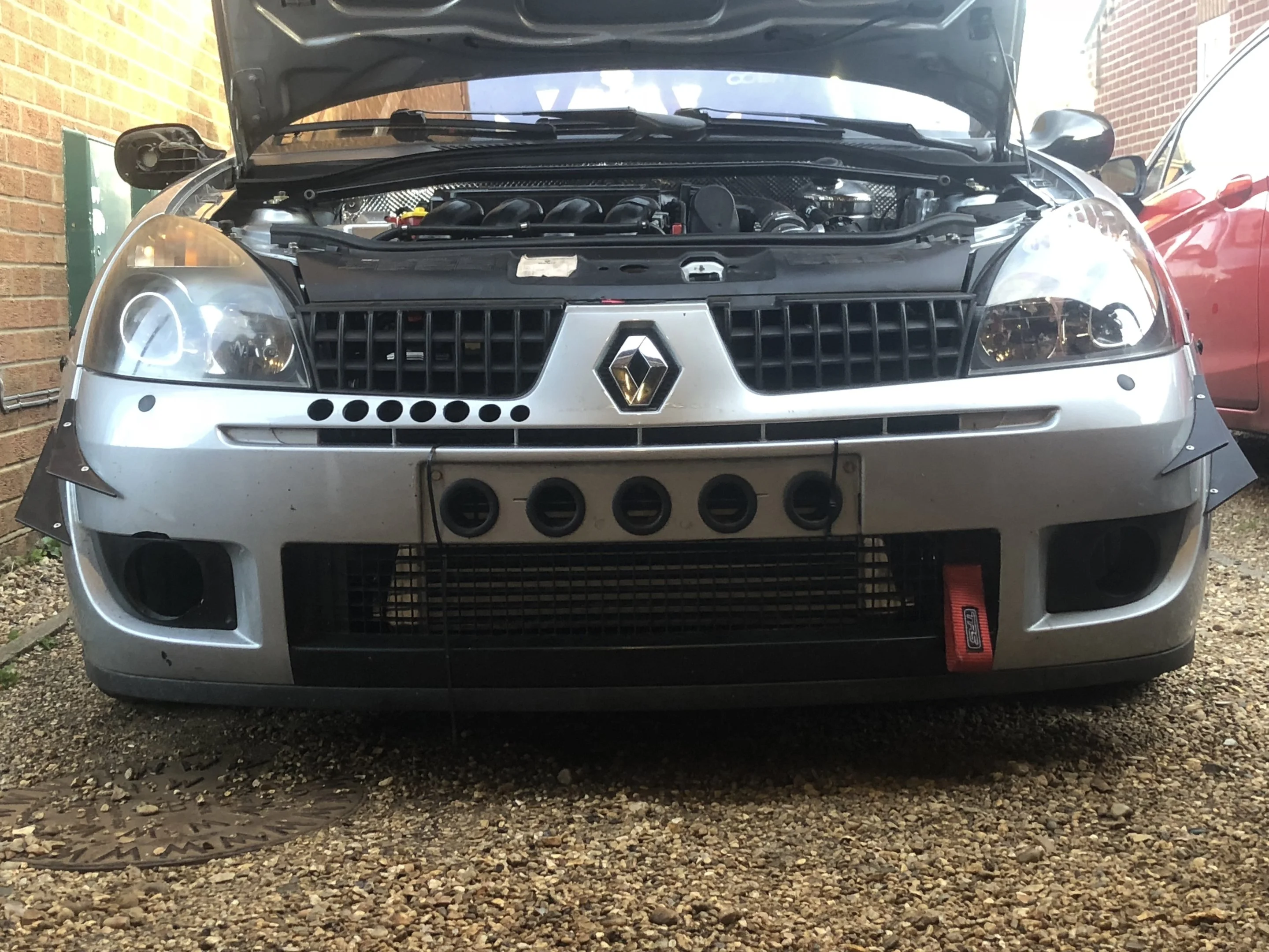

Done 500 miles now, sandwich plate and oil cooler fitted with oil pressure/temp sensors. Bumper modified to allow lots of air through. Borrowed a mates cup alternator setup while I source my own.
npt
  BMW 320d- 172 cup
Coolant or oil? Oil got up to around 90 earlier on quick 15min drive. Coolant sat in middle of standard gauge like normal. It’s the fuel gauge that moves the most [emoji85]
Haha I bet it does, coolant, just with the intercooler etc blocking the path for air wasn't sure if this would be an issue on track

Where did you get the sandwich plate from bud, that looks awesome!
Cheers. It’s G-Plus thermostat controlled one, think it was around £100 from eBay or Amazon.
Sent from my SM-A320FL using Tapatalk
It’s fine mate, well it has been so far ?

Still need a cup alternator if anyone has one ?

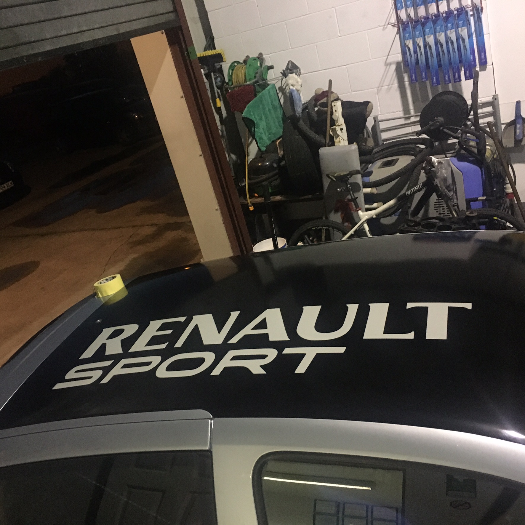

Fitted new sunstrip. My mate makes these with anything you want on, I’ll happily pass on his number if anyone is interested. He did my roof stickers to and we’re currently designing some others.

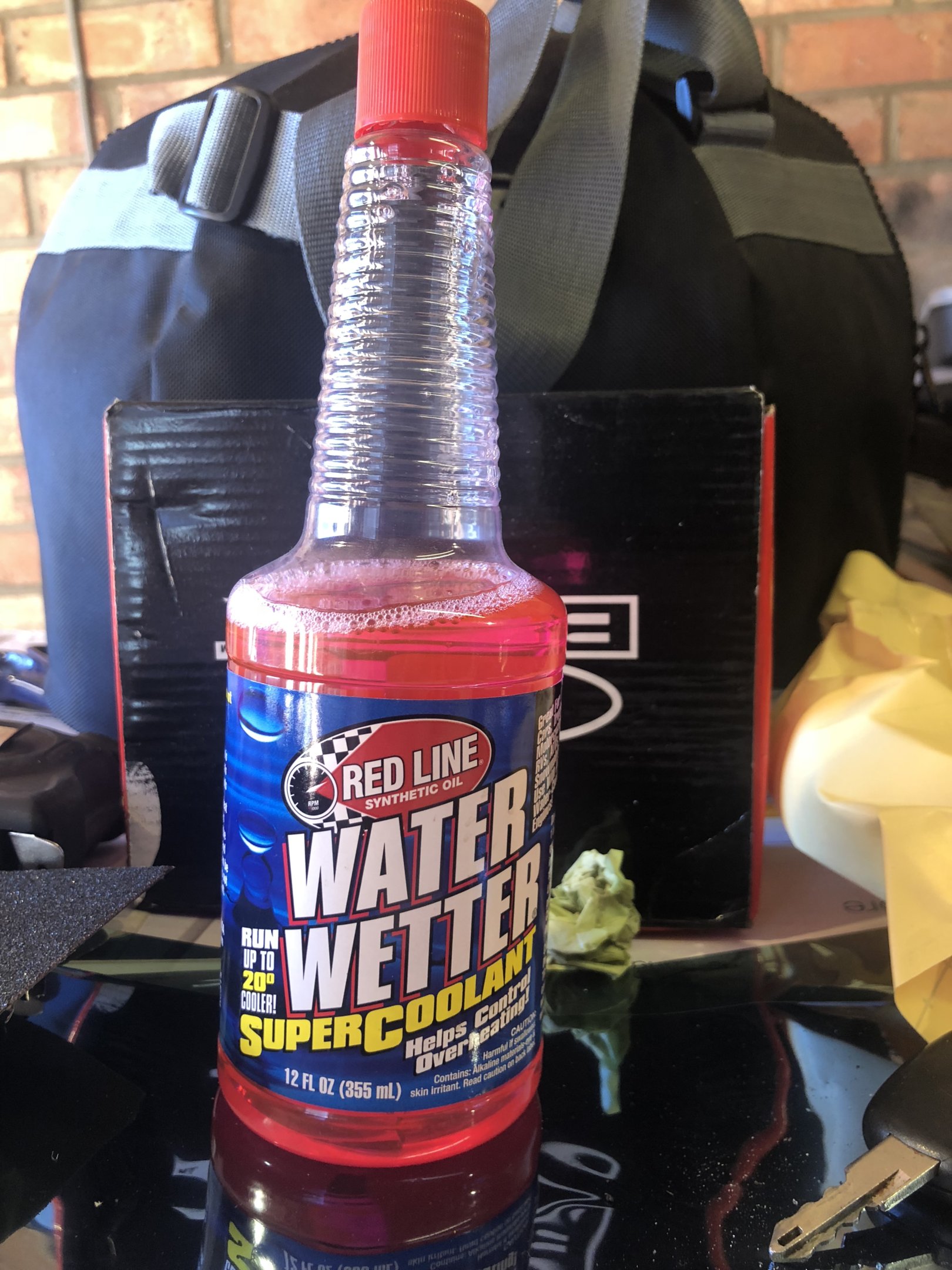

Put some water wetter in, every little helps and all that

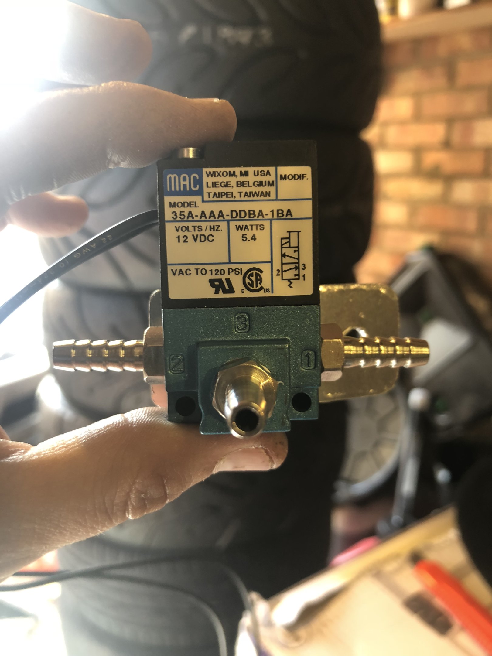

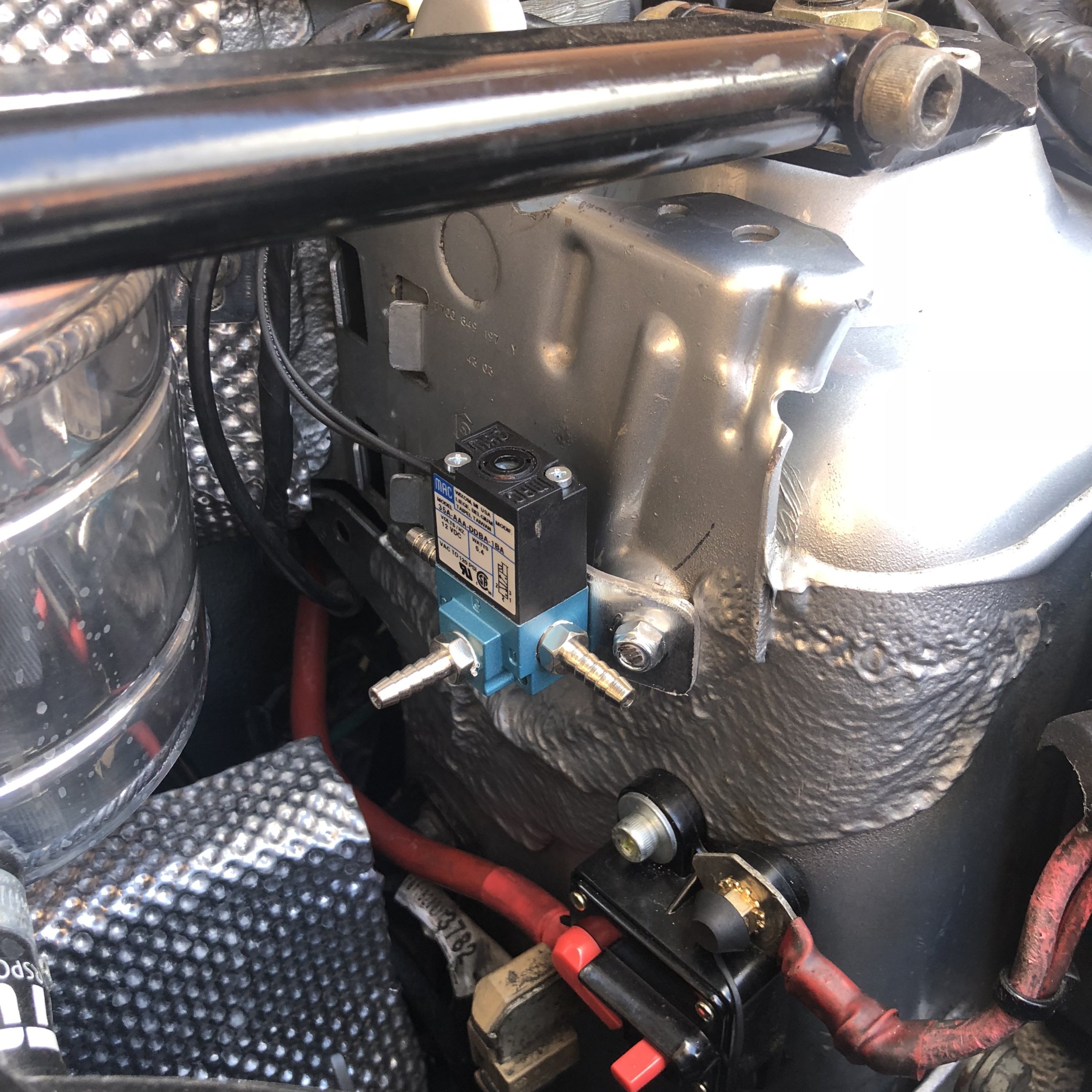

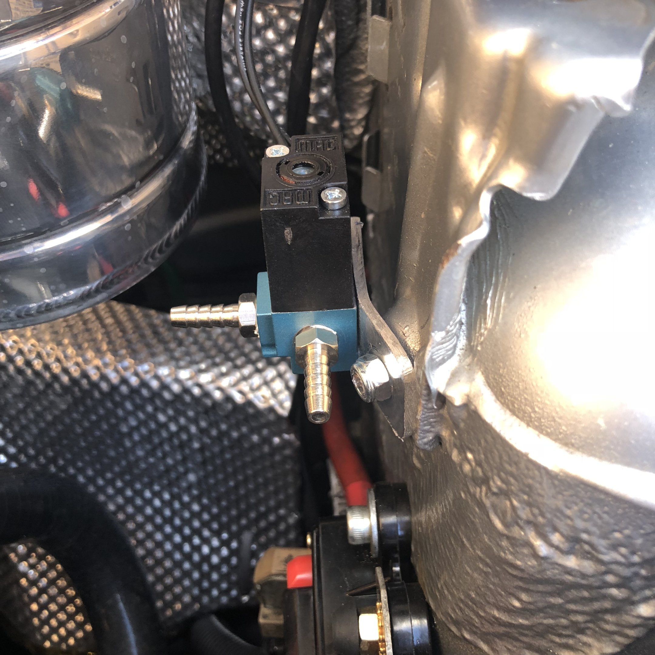

MAC valve turned up today, made a little bracket and mounted it. Hopefully get a reply from EFI soon so I can wire it in.

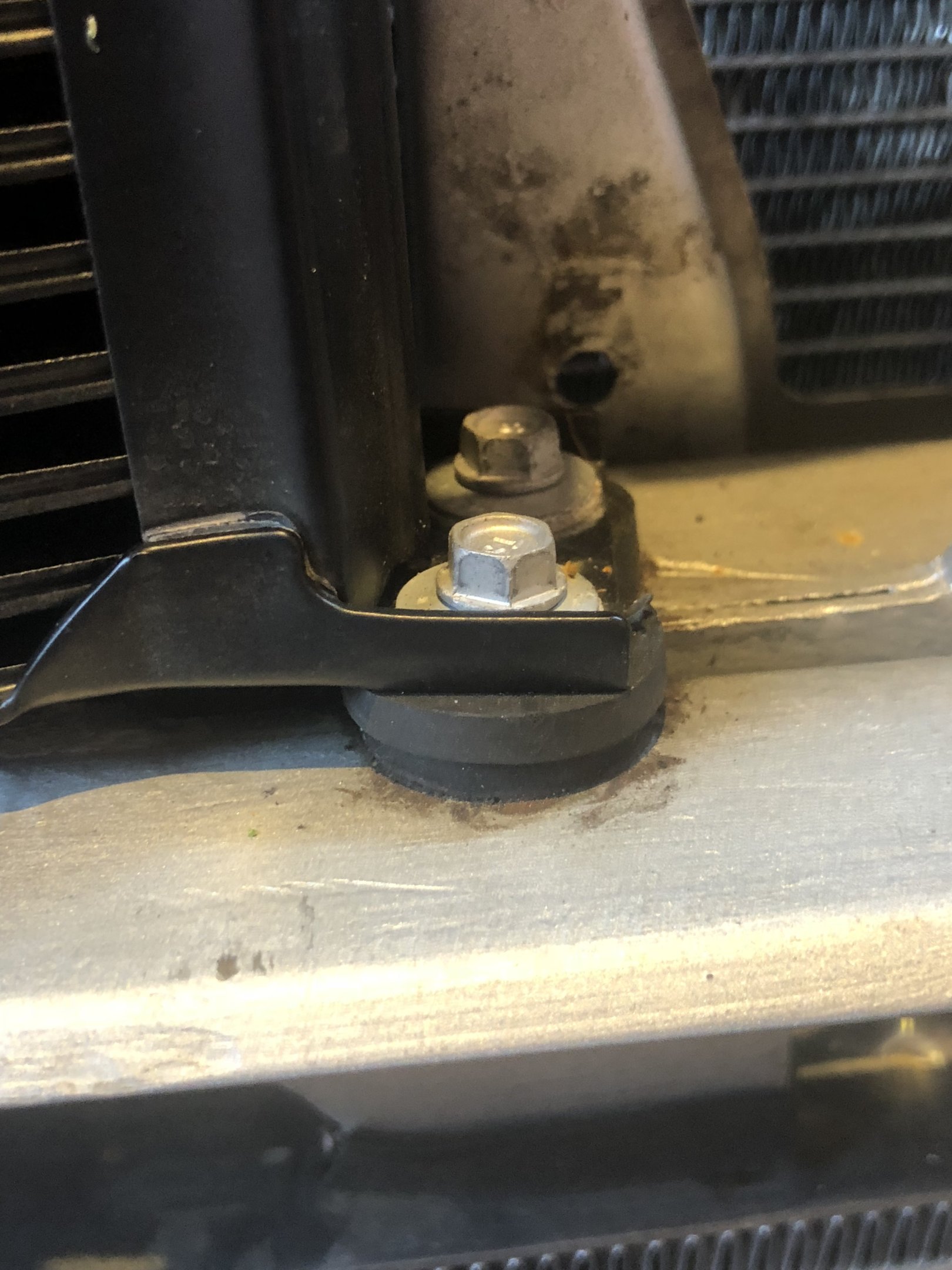

I’d rubber mount that boost solenoid.. it’ll tap like crazy!

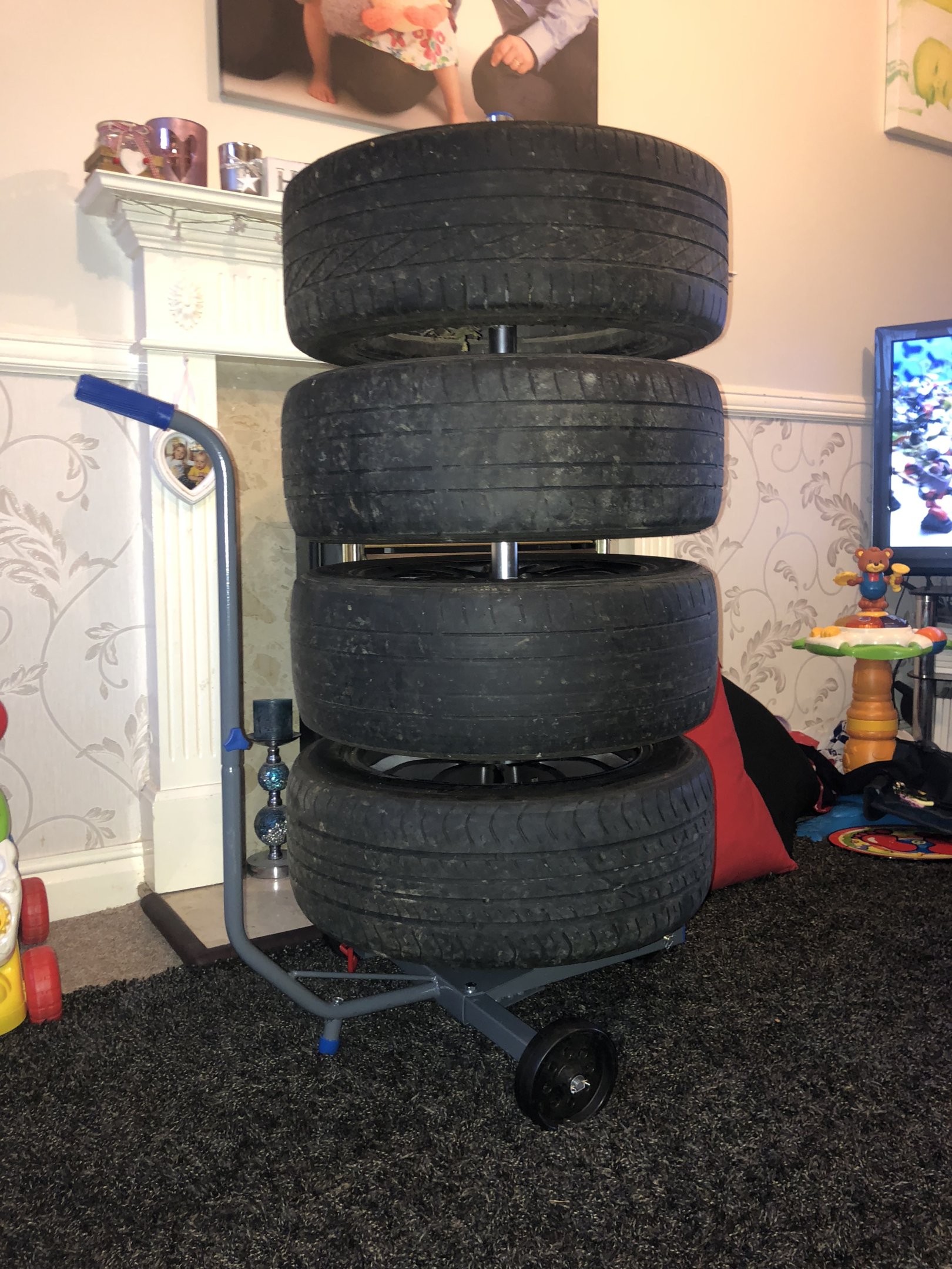

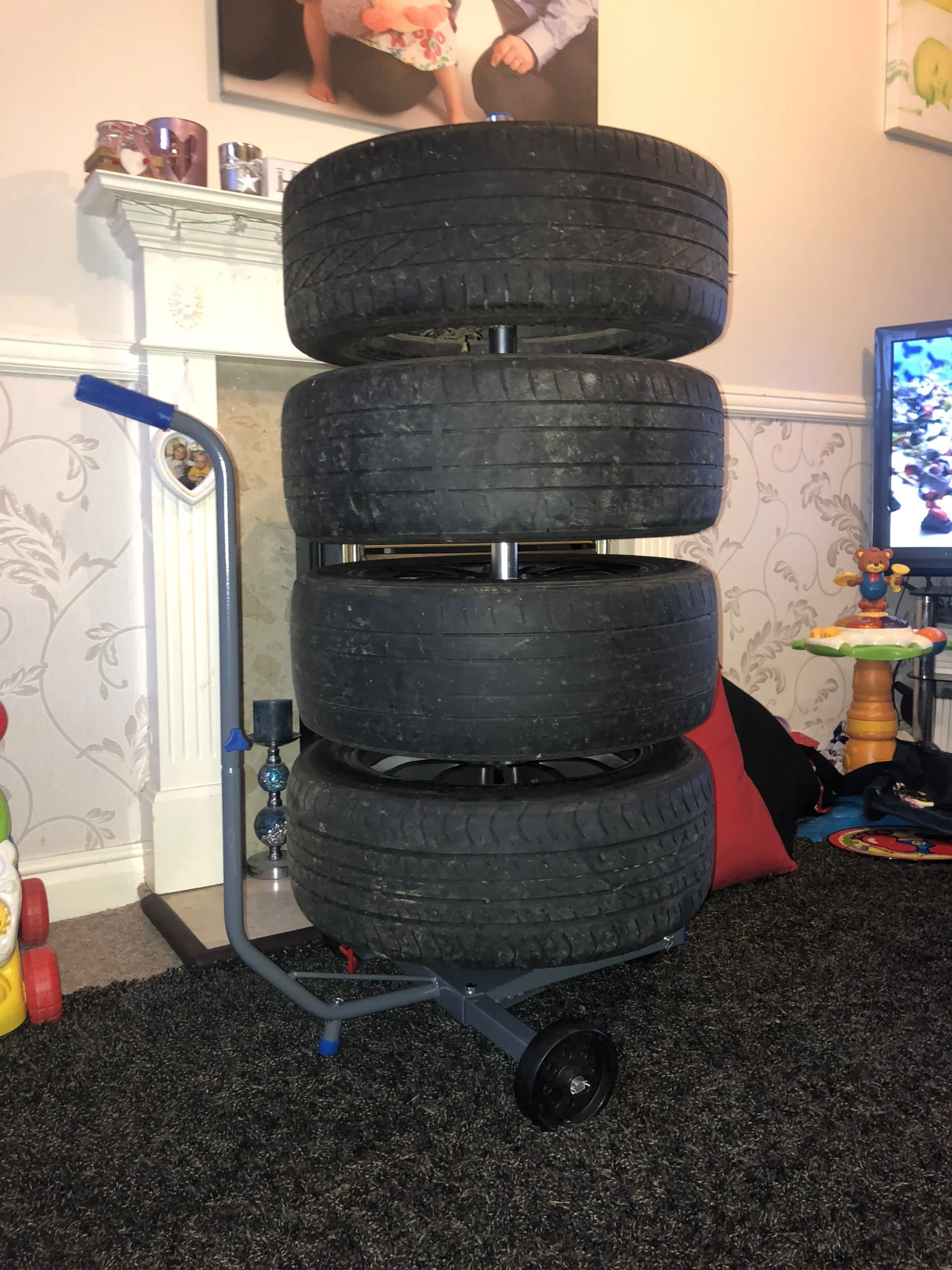

Bit of flat pack building tonight, always pisses me off when I have to move wheels around the garage, this will make it a lot easier, will get another one soon

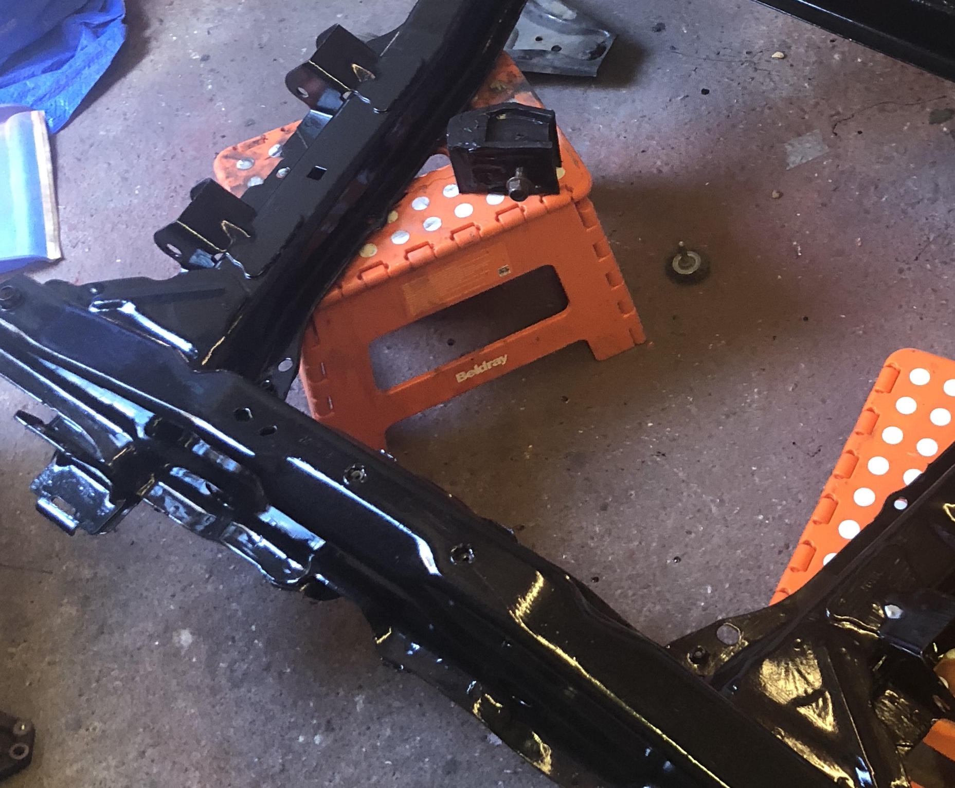

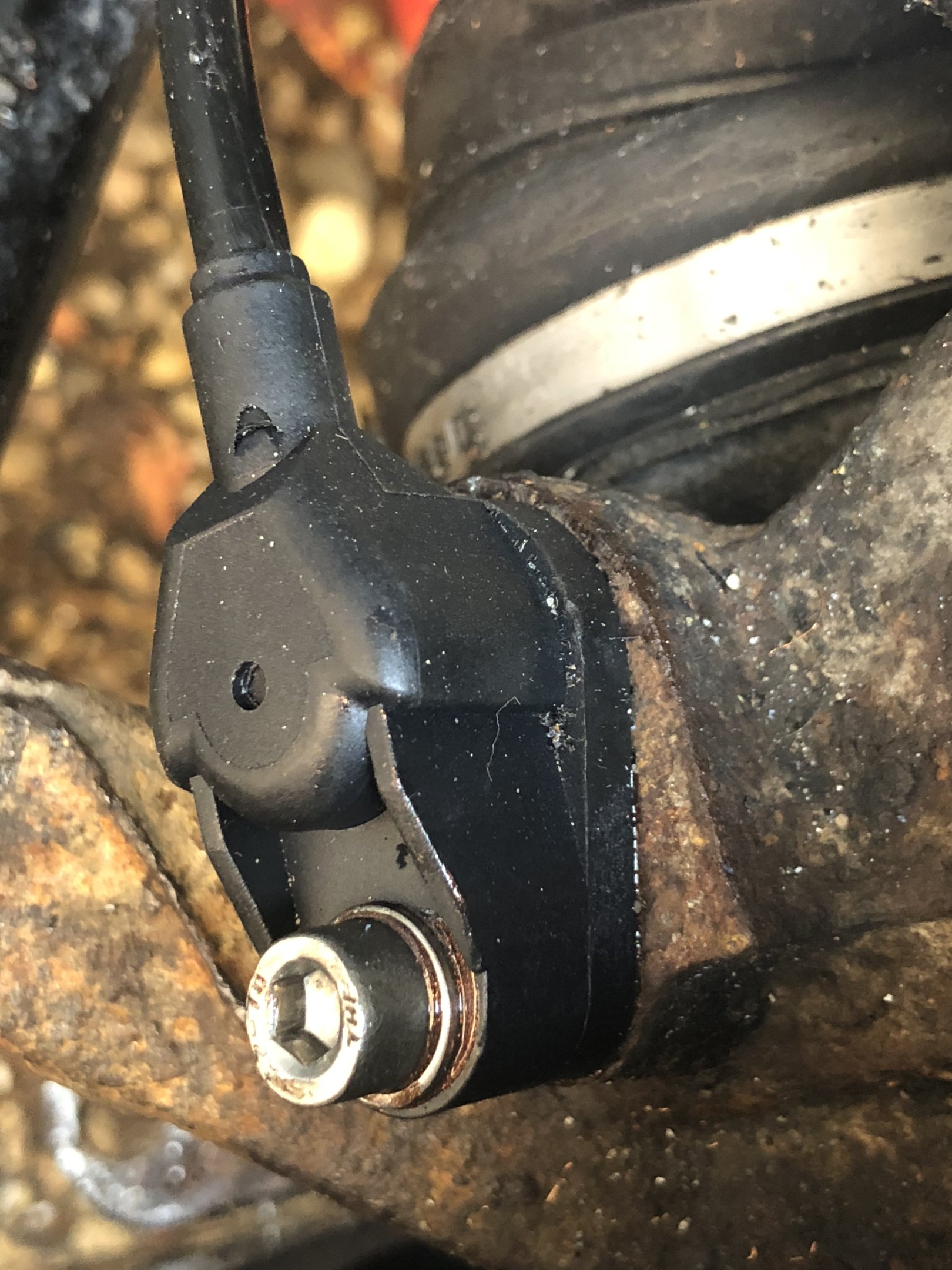

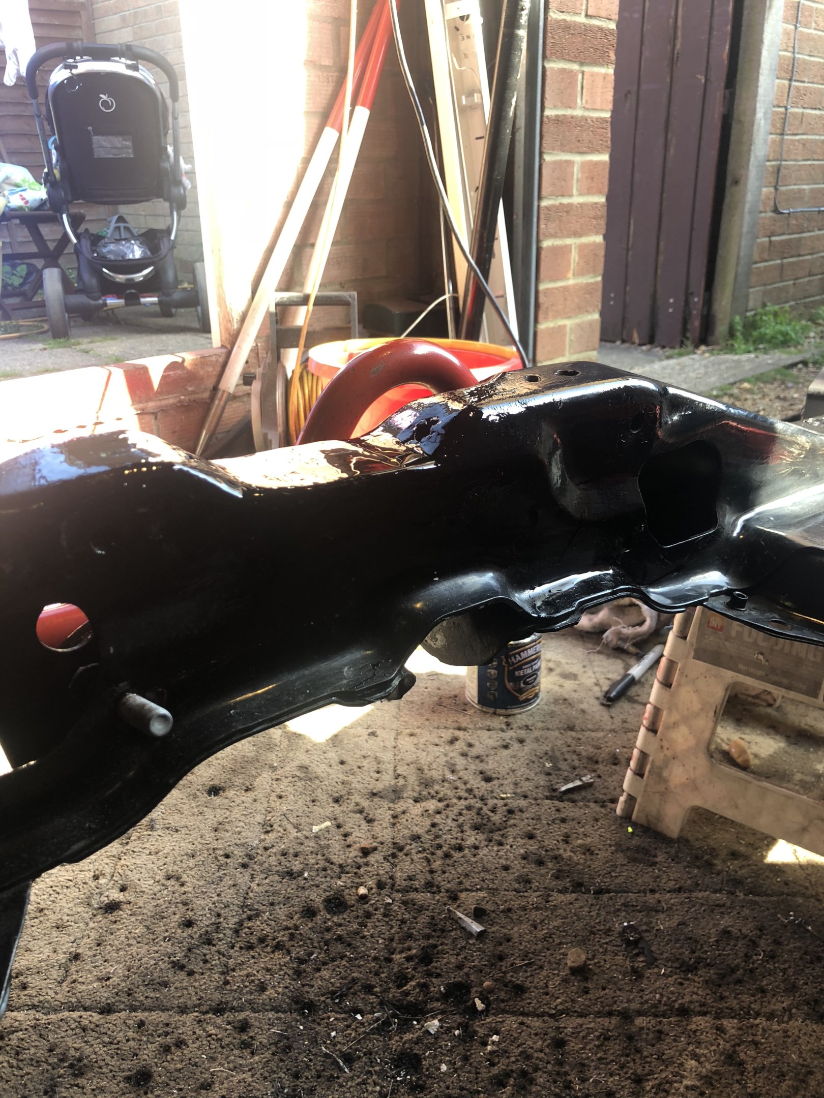

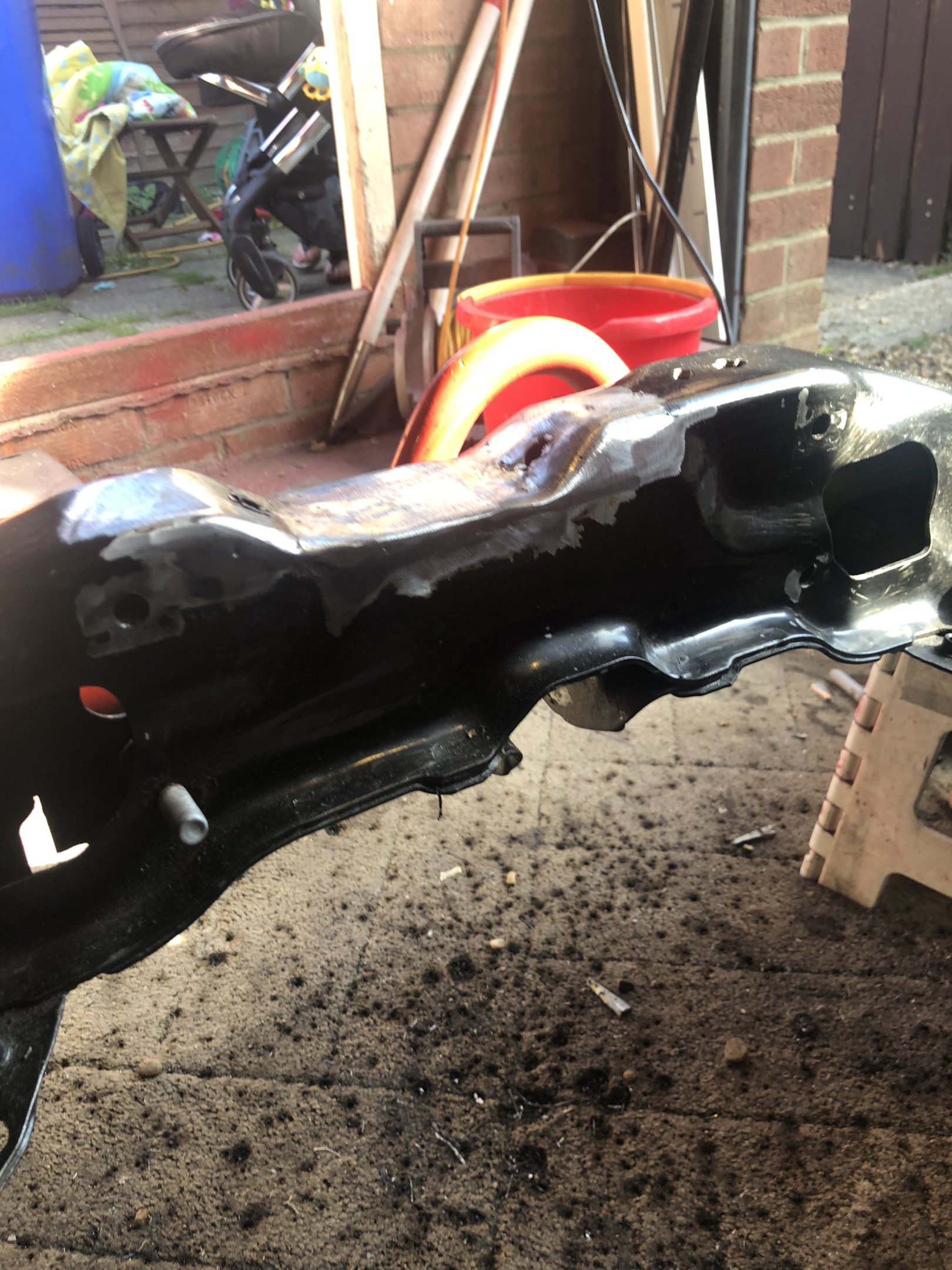

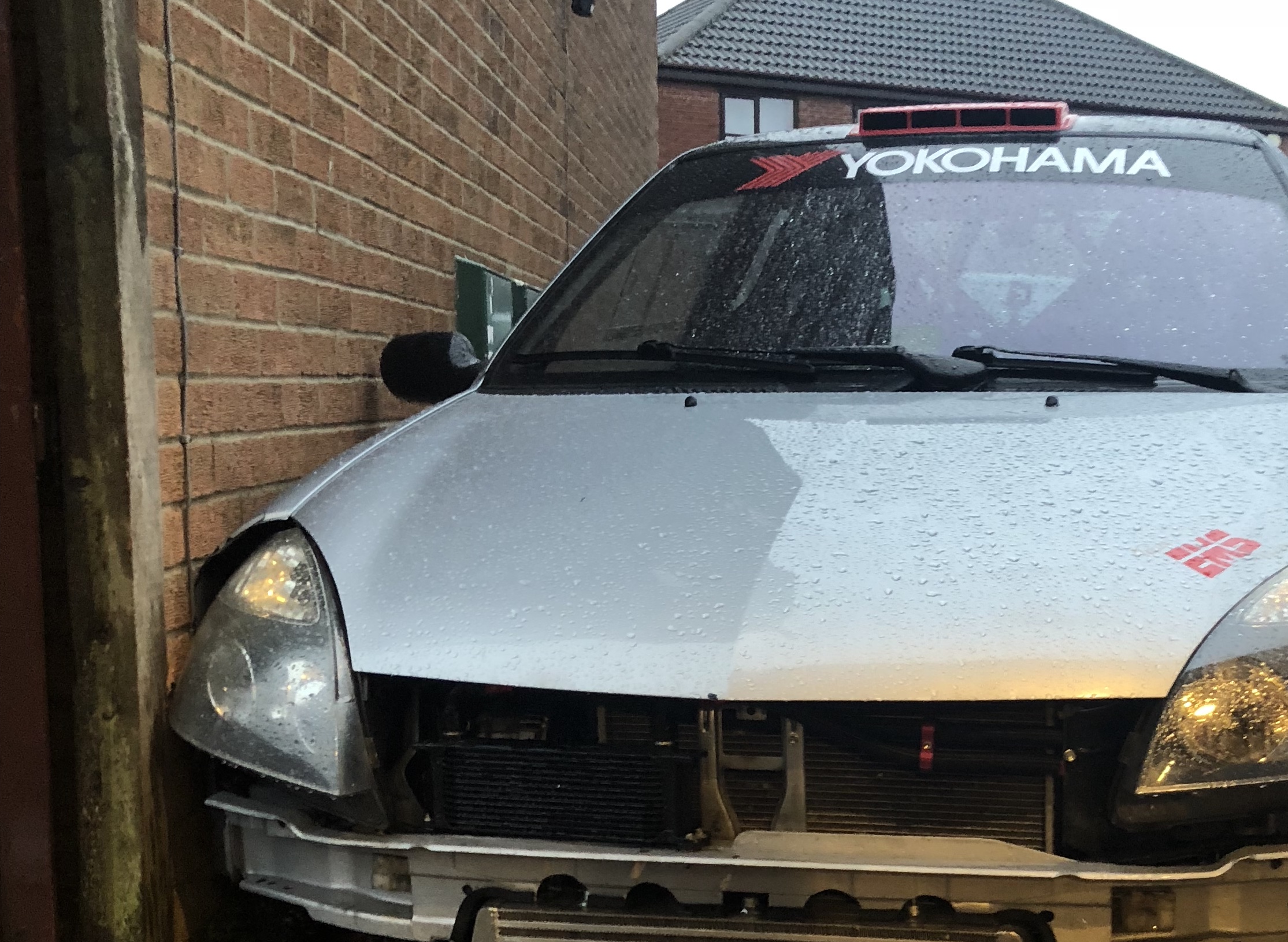

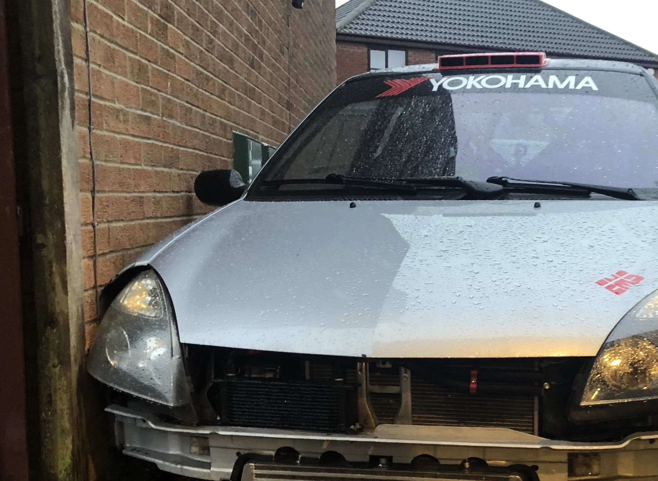

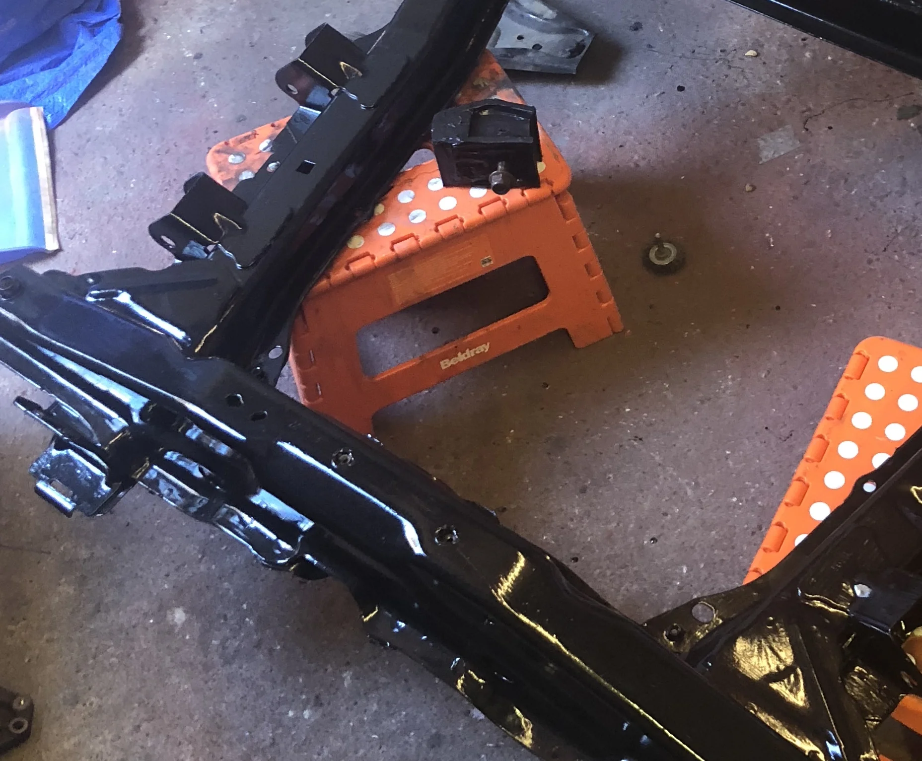

Had a s**t weekend, front of car was on axle stands due to the subframe being off, all the rain we had yesterday resulted in the gravel drive giving way and the car falling into the house ? luckily it wasn’t up very high and didn’t fall far but still damaged the wing, headlight and steering rack that all require replacement, one of the only times I’ve been glad to be a panel beater ? thanking my lucky stars as could have been so much worse.
Got it back up with some help, stripped wing and headlight out, luckily no inner wing or front panel damage.

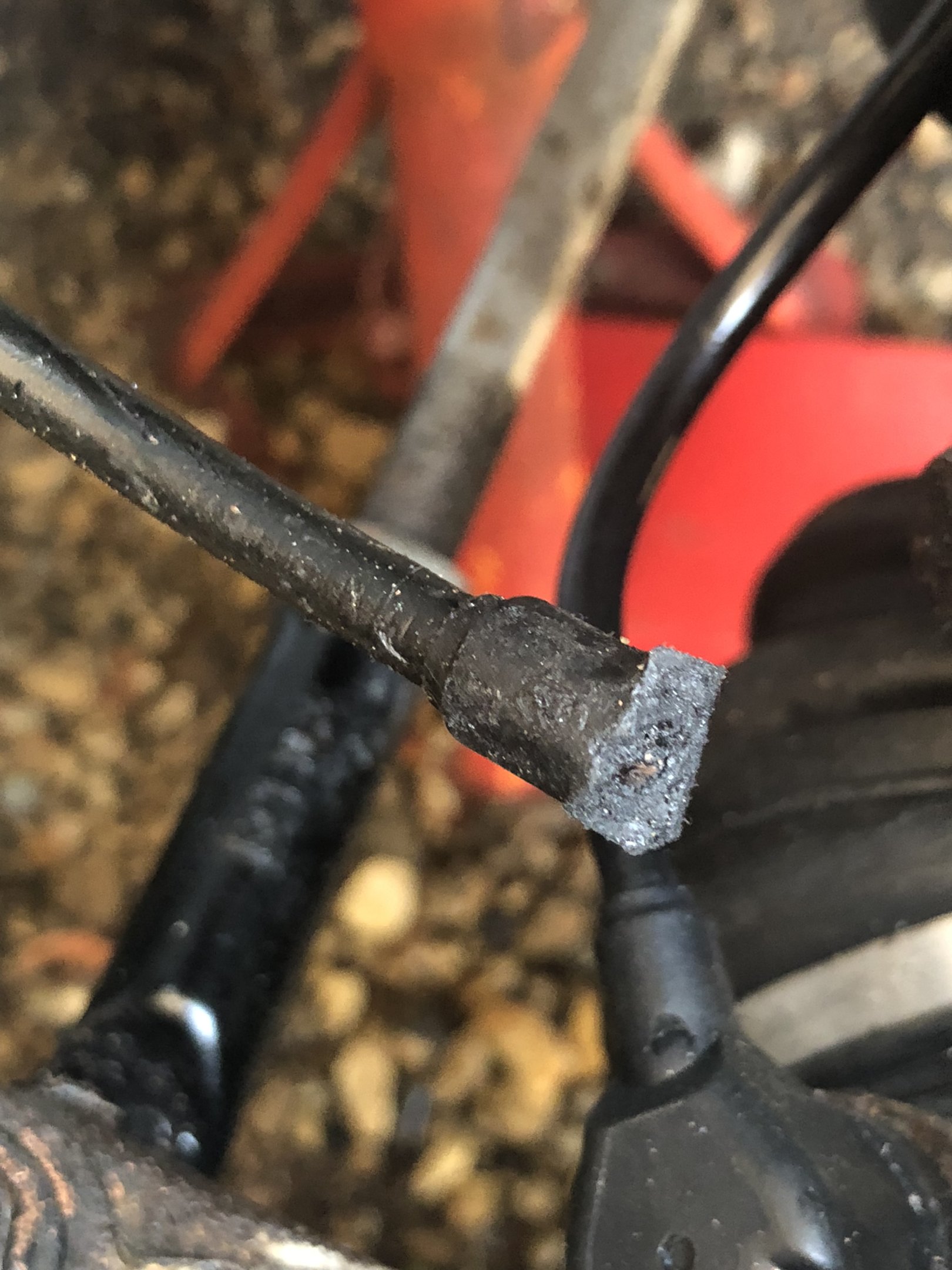

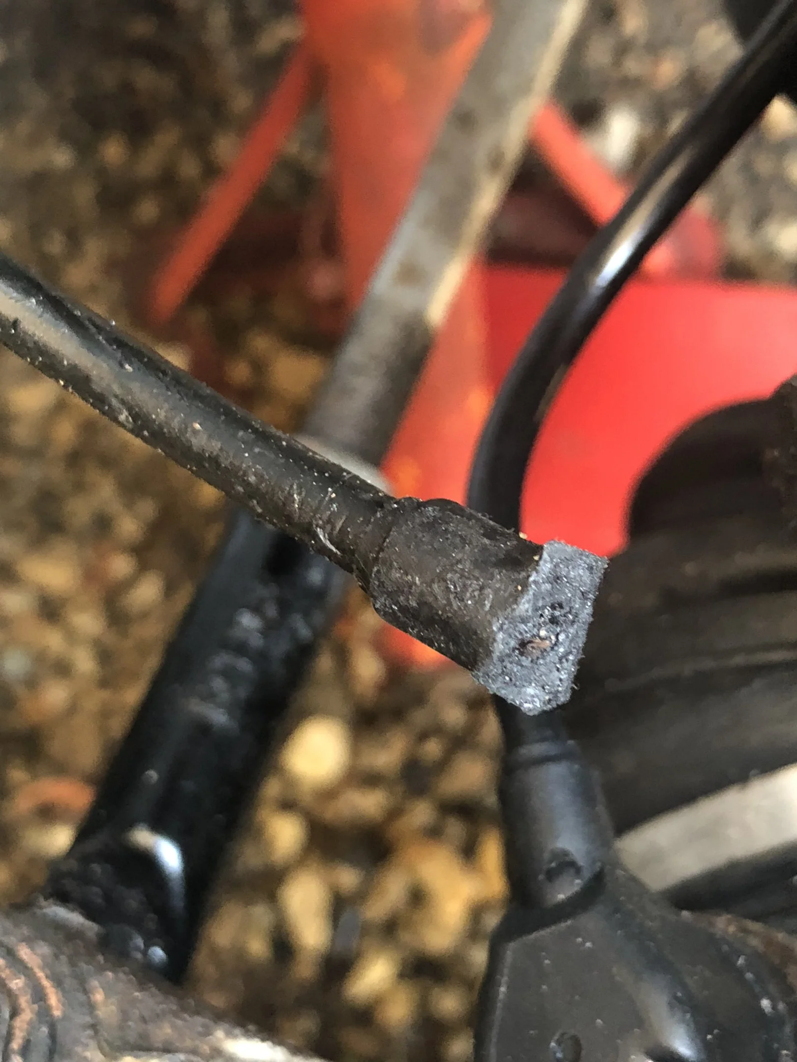

Next was ABS sensor replacement, became pretty obvious why this wasn’t working ? absolute pain to get the old one out but got there in the end.

s**t! At least it didn’t fall on you or someone else though!
So when you getting the wackerplate out on the drive to get your own back?
Haha! Yeah could of been a lot worse mate, even tho it seemed like the end of the world at the time! ?
