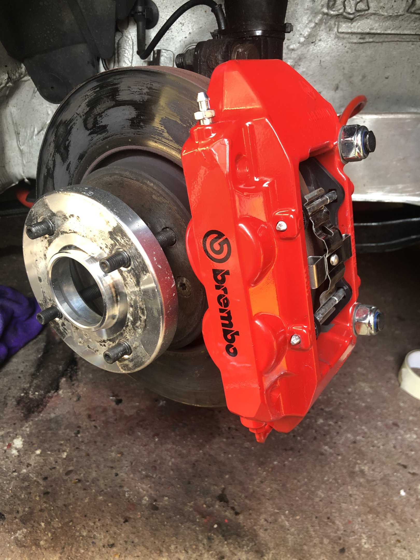

Going for a Brembo Caliper upgrade now. In true Adam fashion I was looking on eBay for some Brembos ................................. and I bought some more wheels ?
I am looking to upgrade to Brembos soon tho, watch this space ?

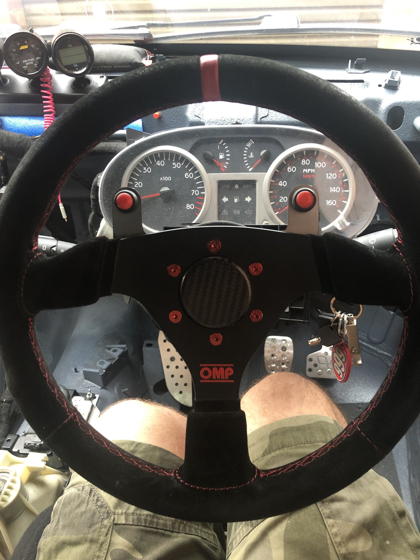

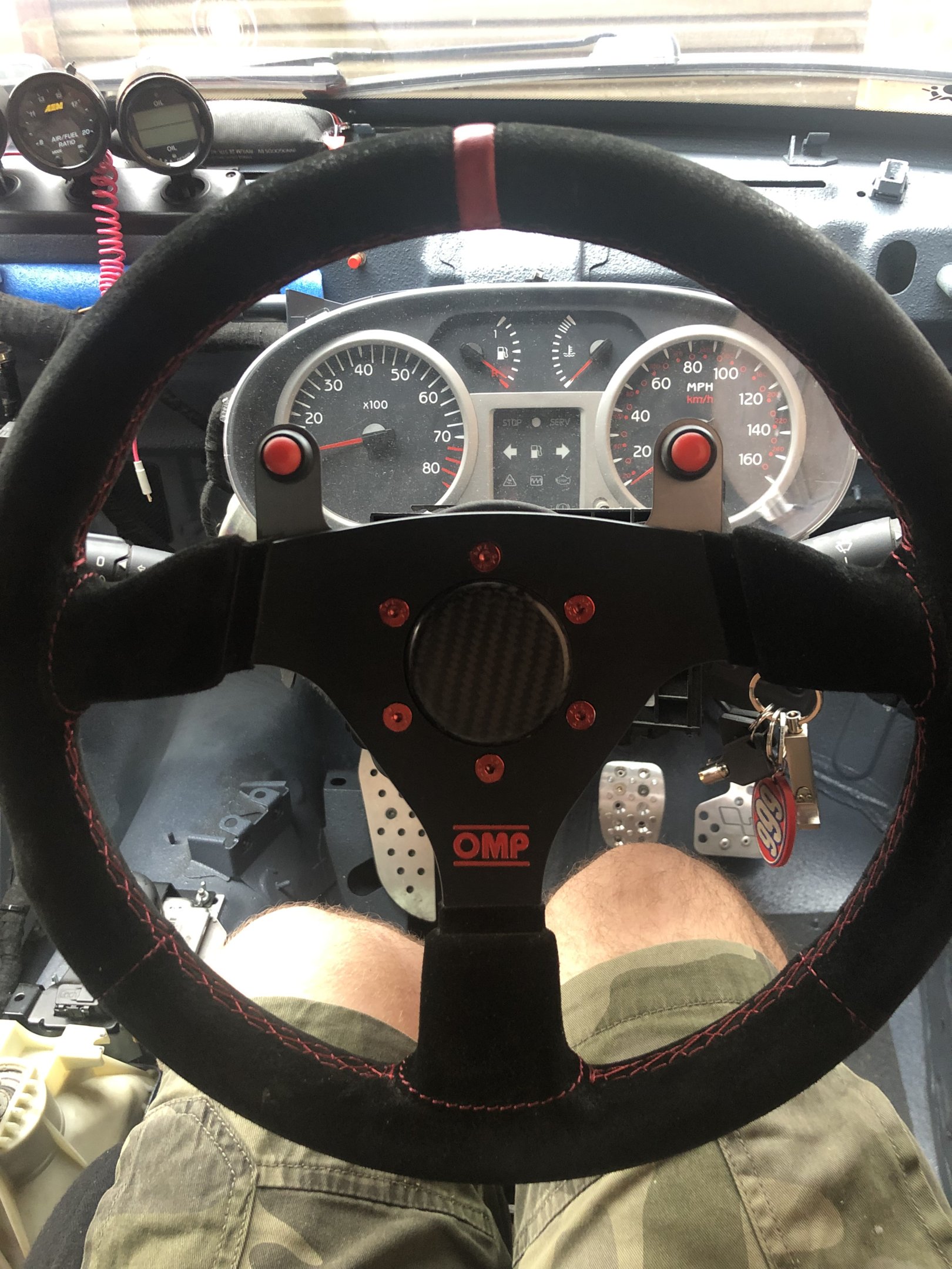

Got some steering wheel buttons and holder today. Going to use the right momentary as a horn switch and the left on/off to switch the boost solenoid on/off, effectively mid and high boost. Does anyone know if I will be able to turn the solenoid on and off whilst driving? Don’t want to damage the ECU.
NorthloopCup
I used to run switchable boost using a ford amal valve, and I used to switch that whilst driving, so I would assume that, yes, you’d be ok to switch the boost as you’re driving. Ultimately, it’s been mapped to run the full boost, so it will make no difference to the ecu imo.
  172
Yeah it’s fine on low boost, think Chris said it was 280-290 and it drives fine on low. I was just checking if I’d damage anything by turning it on whilst the cars running. I think I’m just worrying to much ?

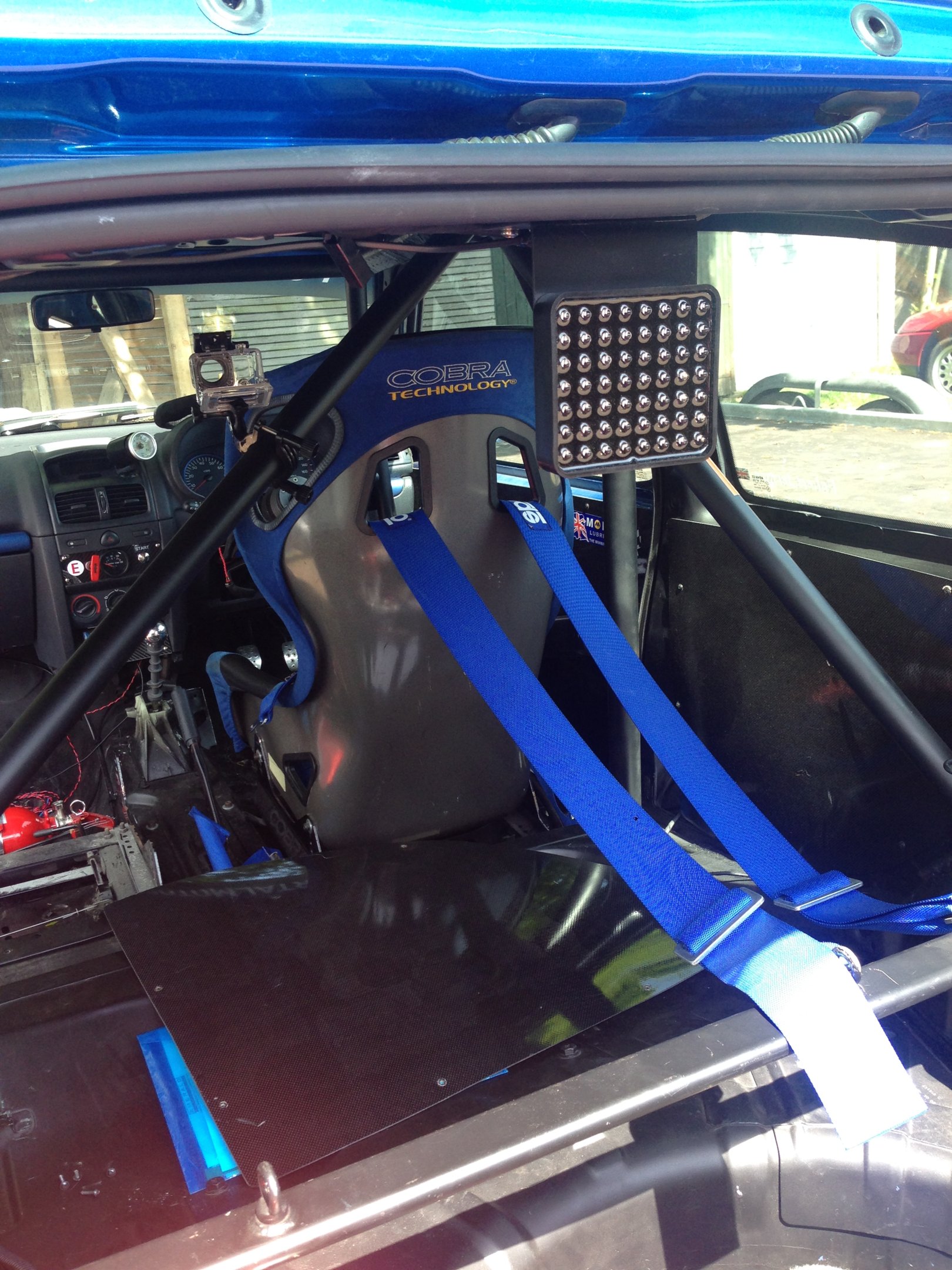

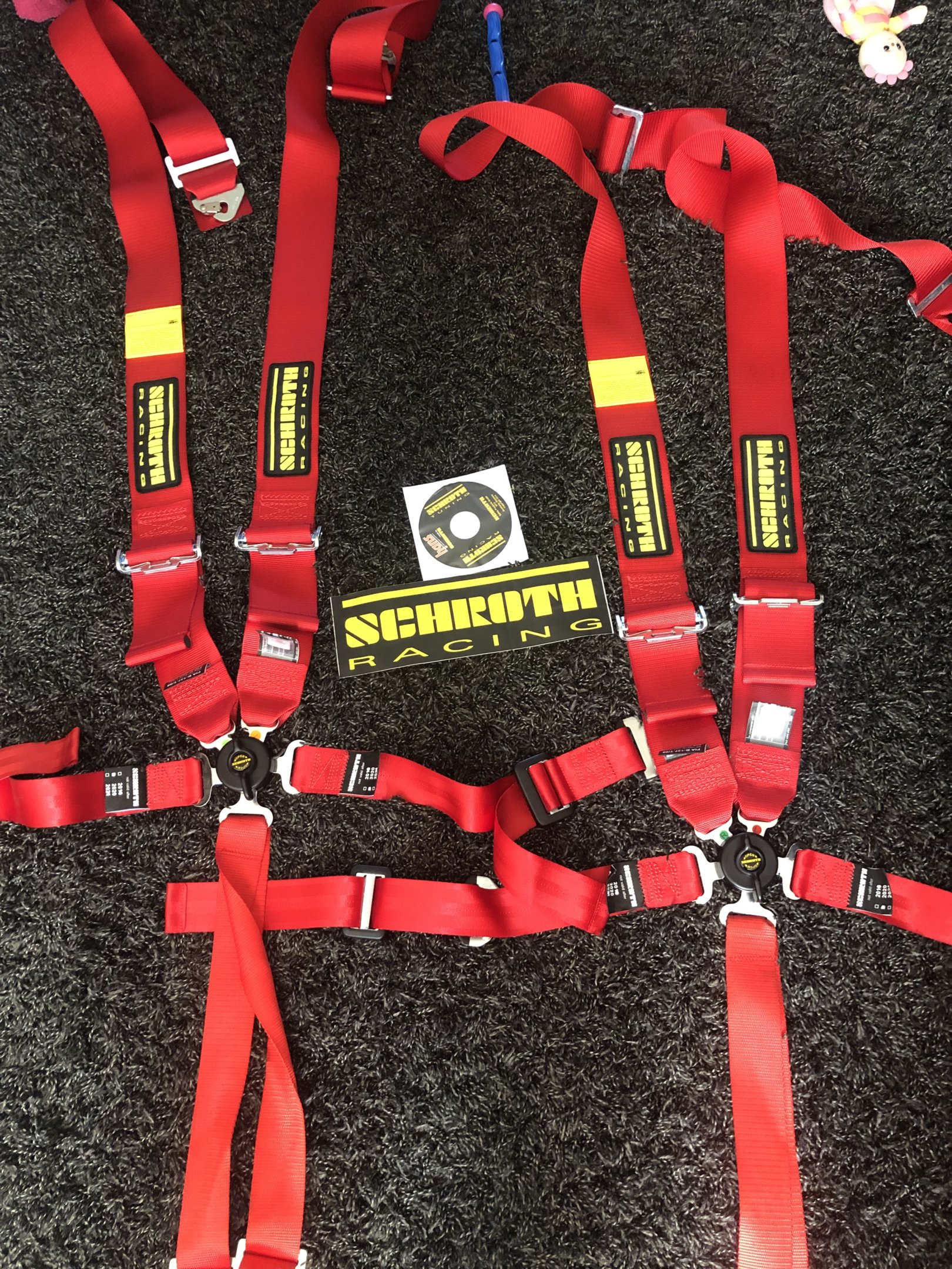

Since fitting my new seats I wasn’t to keen on the blue harnesses so I bought myself an early Christmas present ?

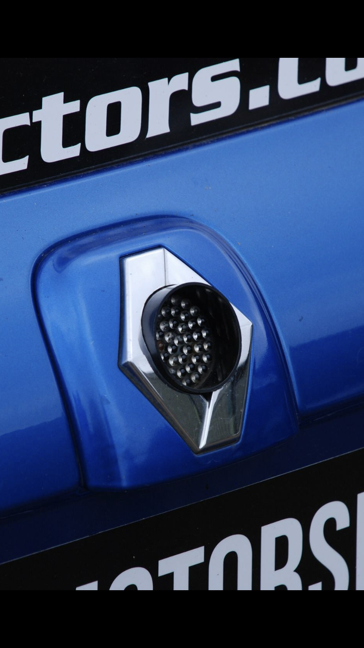

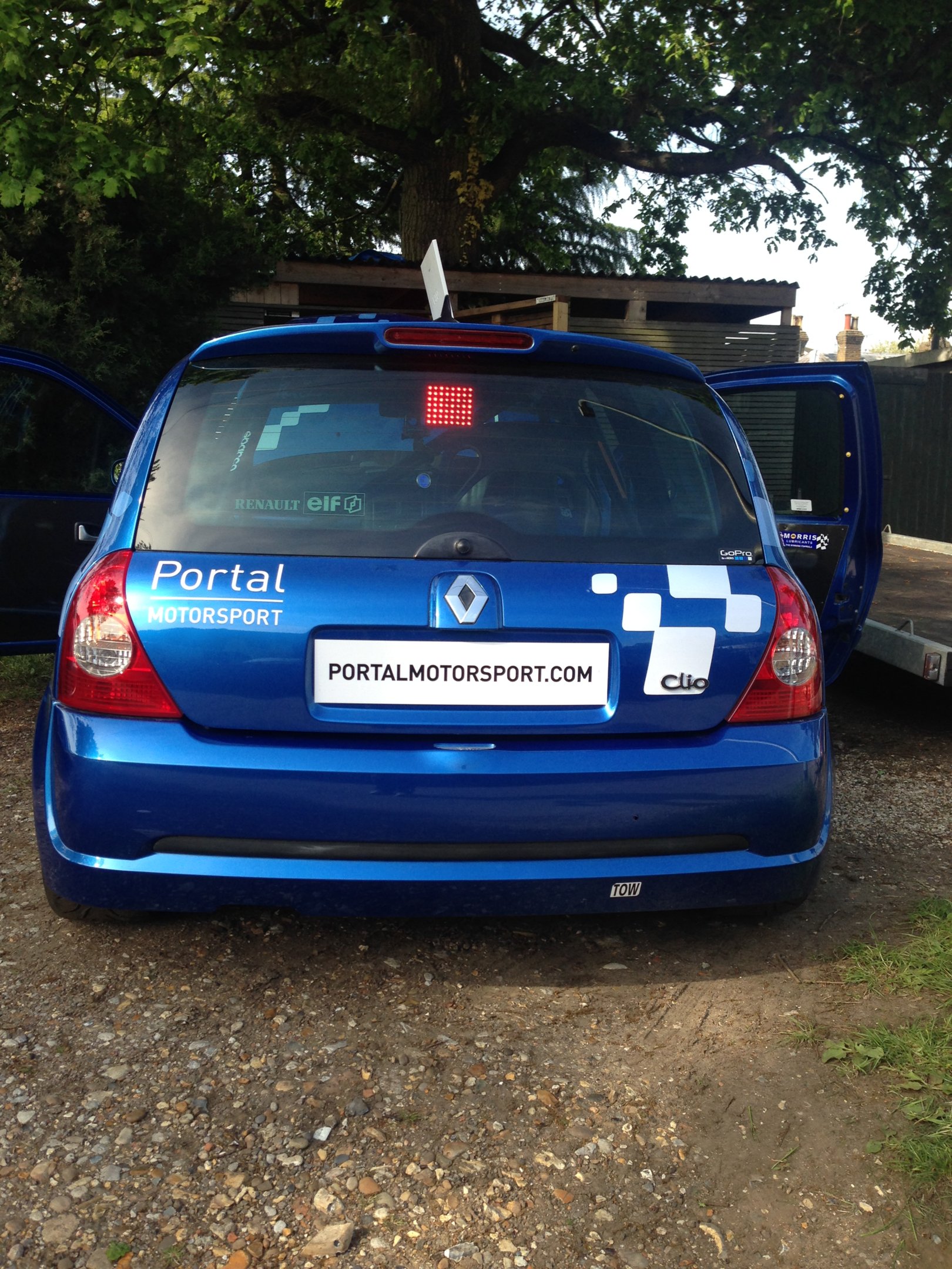

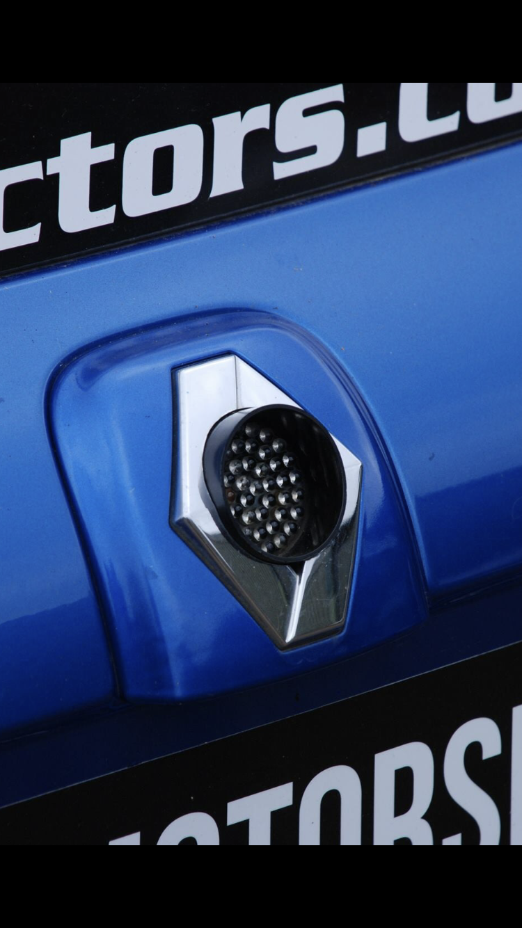

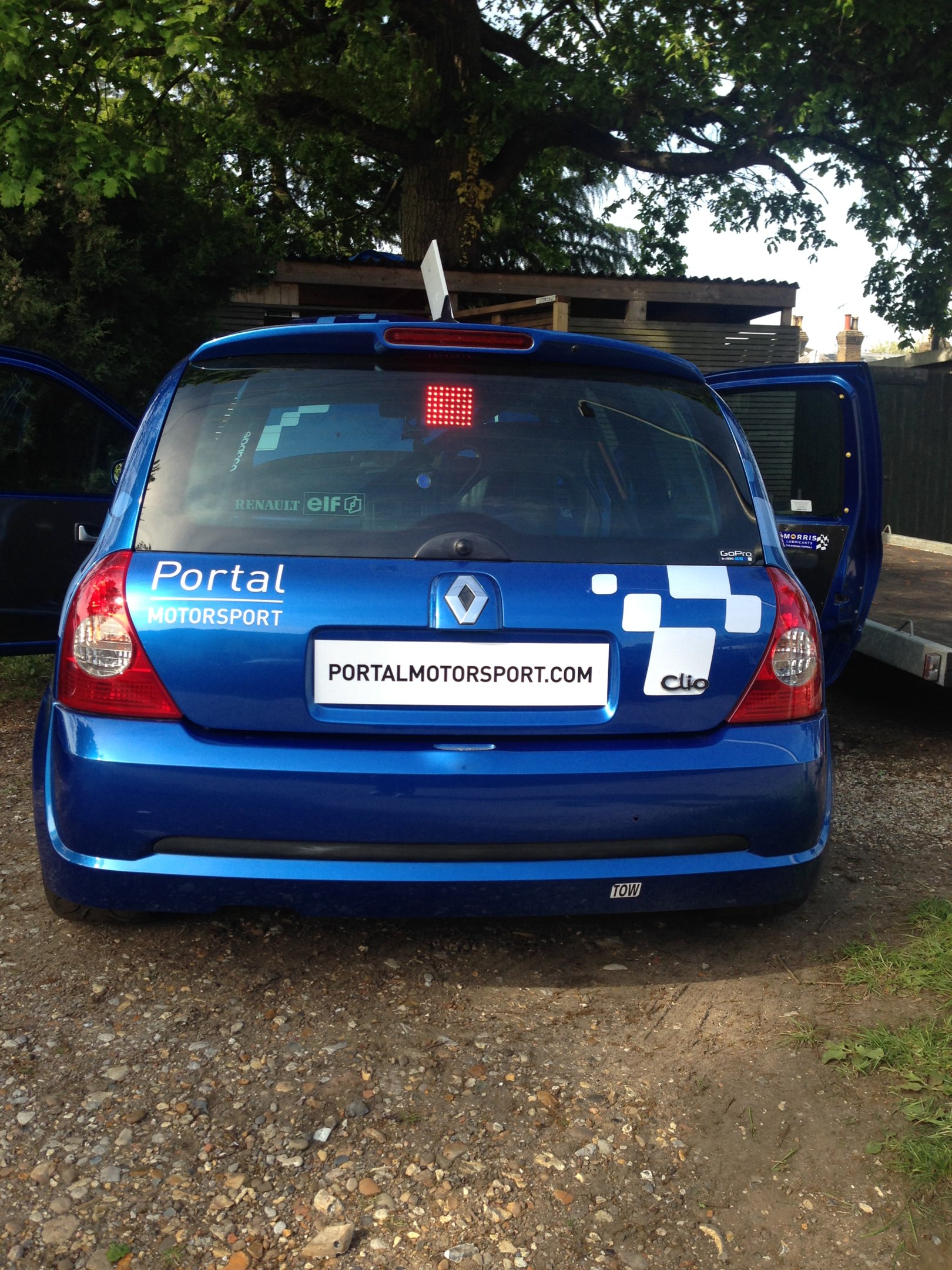

Was looking for a rain light and came across this on google, have ordered one to try myself
That was my old race car! The previous owner had stuck the rain light on the boot with screws and a bit of silicon so I found another boot release badge and drilled it out. Just a bit tidier but I would definitely mount it inside at the top of the rear window which is where I now have the rain light on my current car.
  172
Do you have a picture of how/where yours is mounted please?

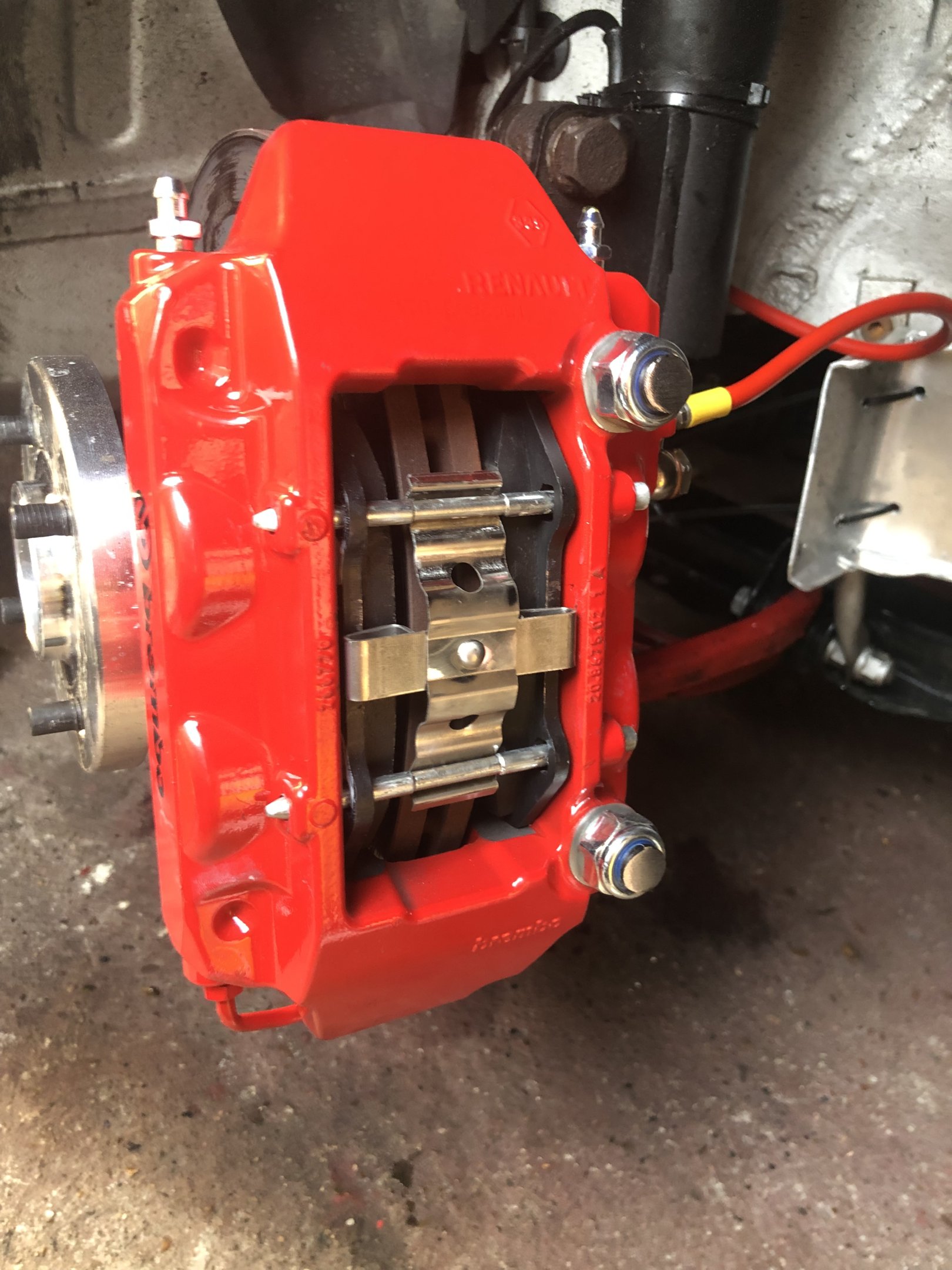

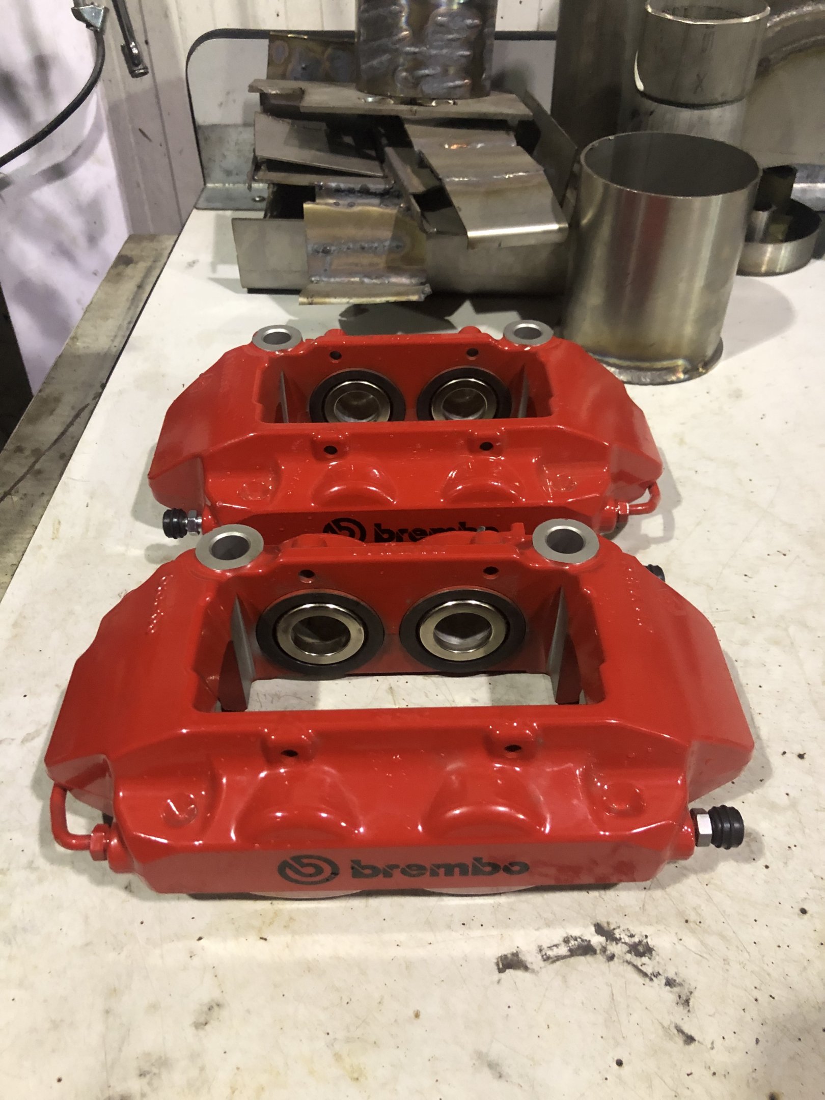

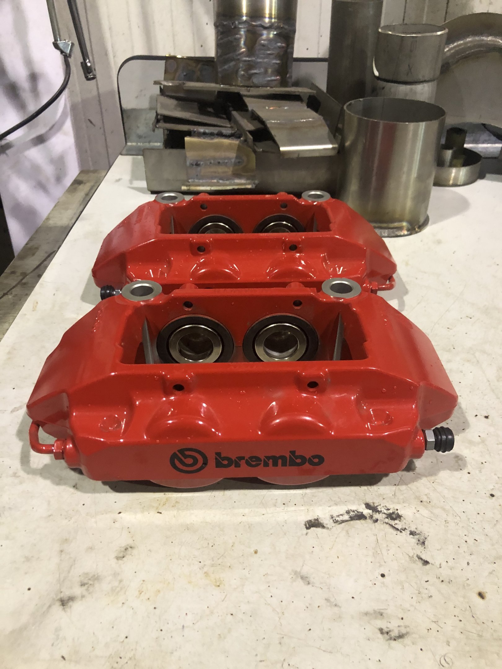

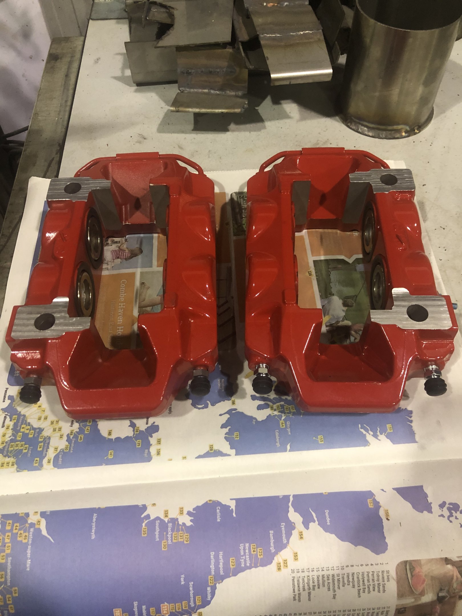

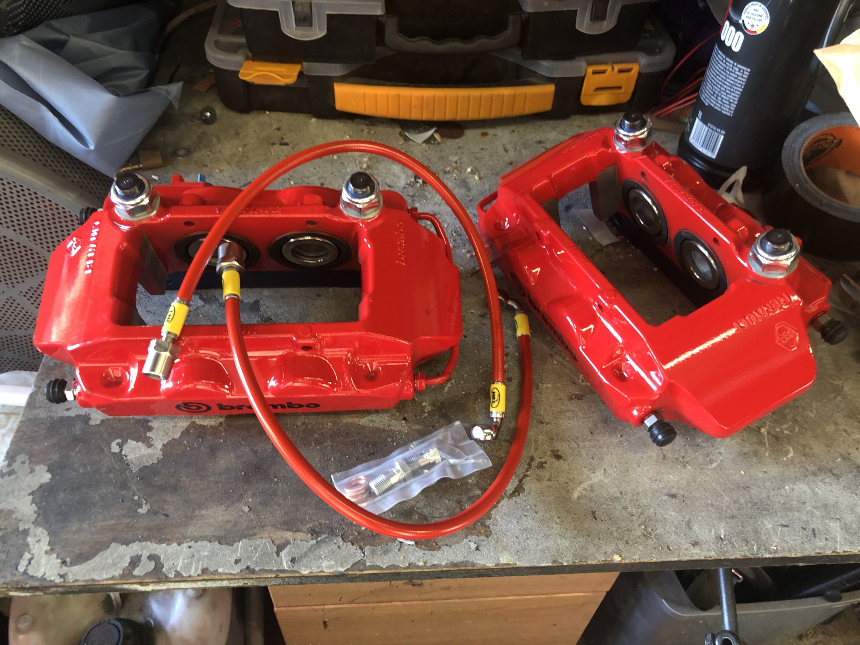

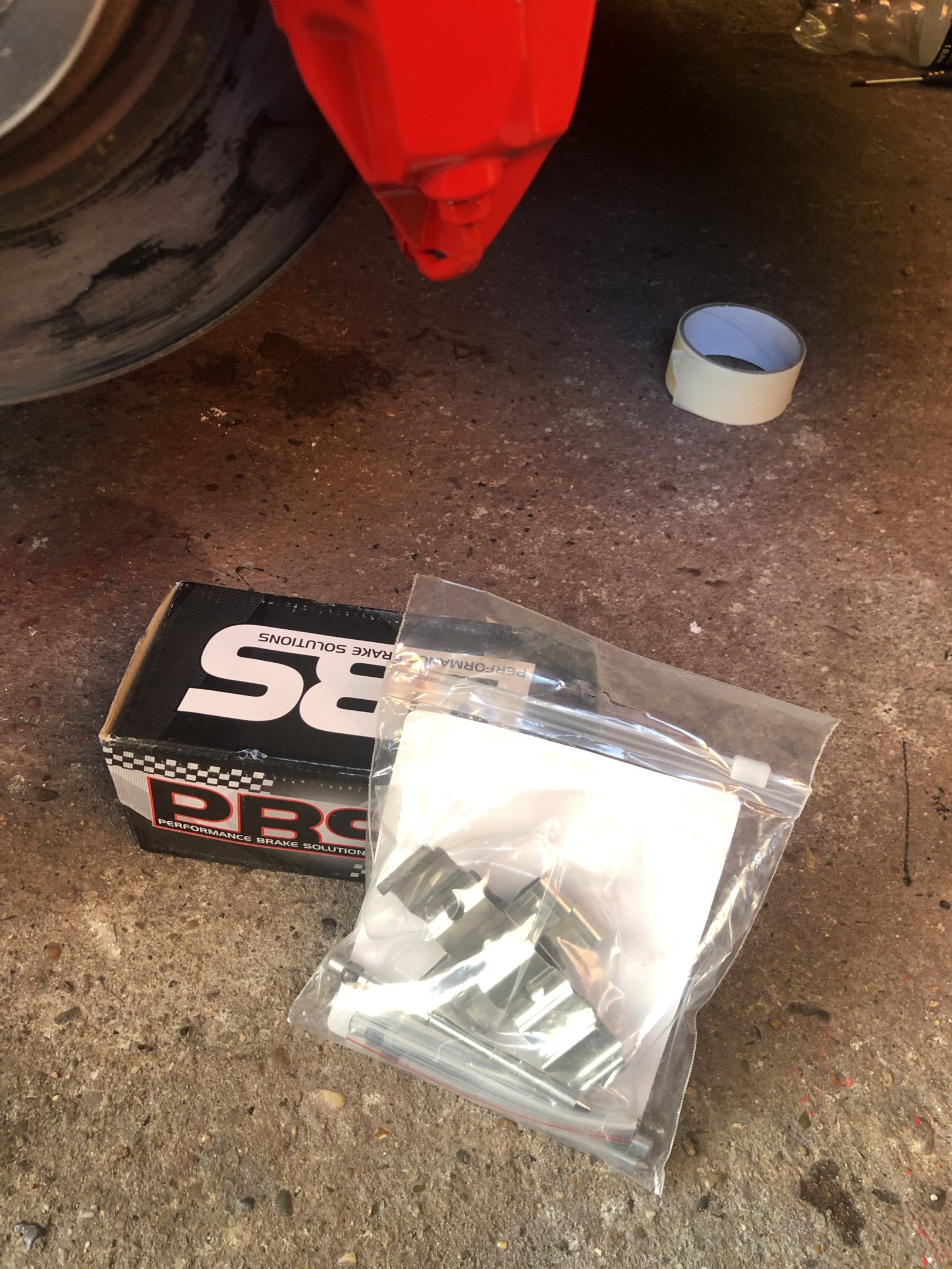

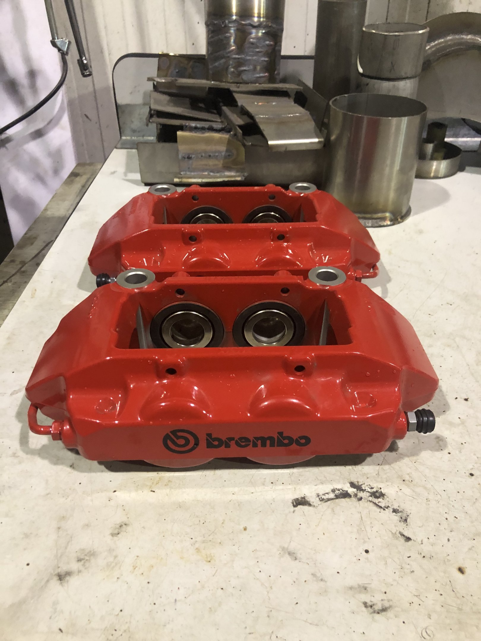

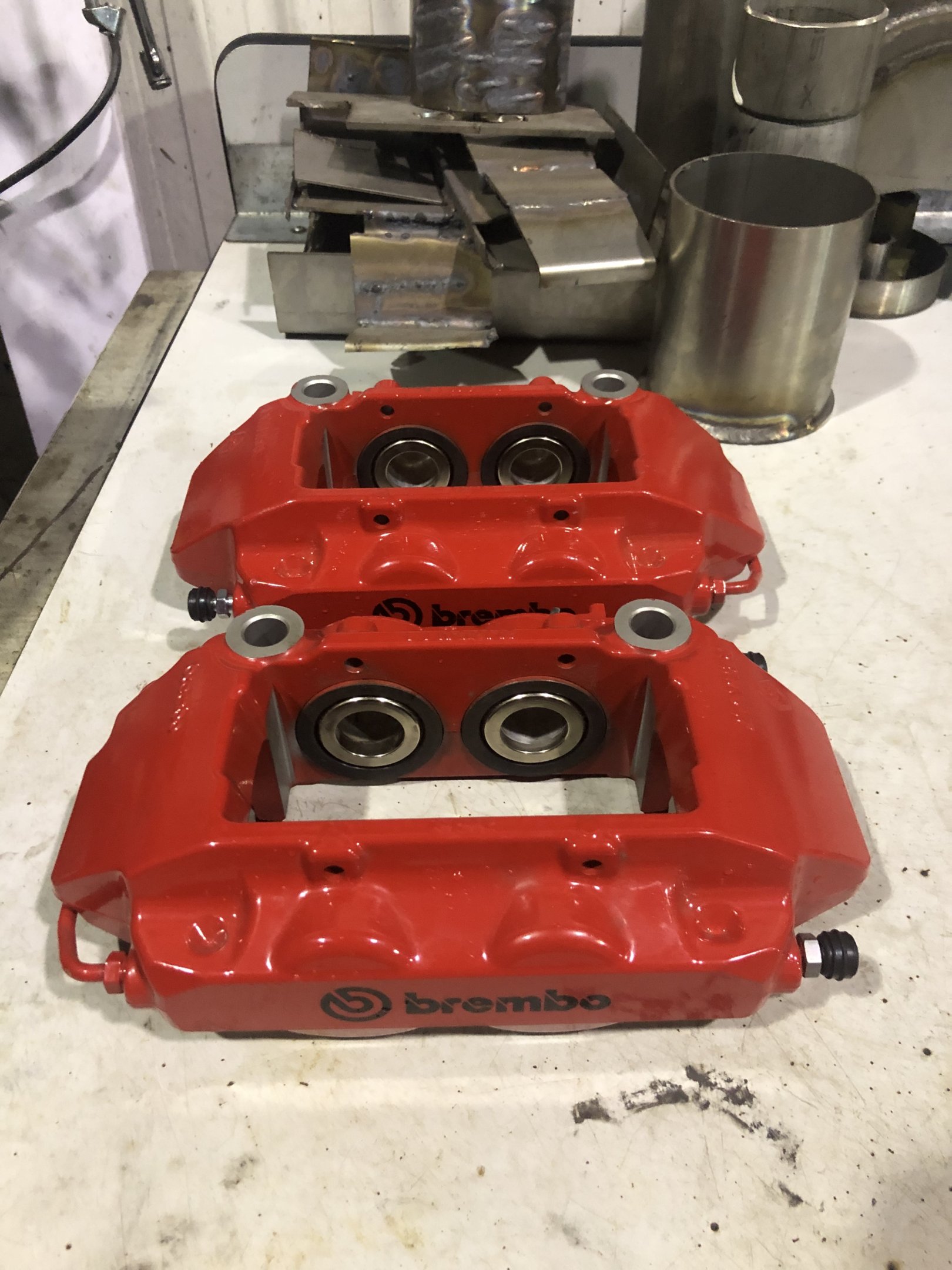

Sooo.. my mate machined 5mm off calipers for me, got new Hel lines, PBS Pads, new fitting kit and a squirt of ultra high temp grease and we’re on. Ran out of fluid so not bled 100% yet but there all on.

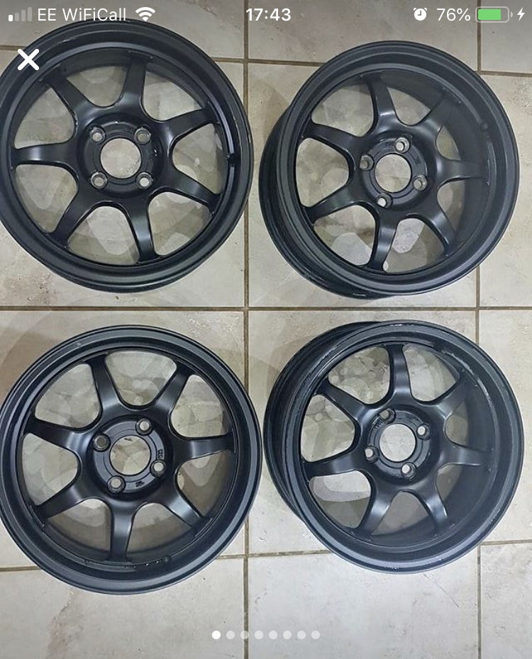

Only 2 of my 4 sets of 15’s fit so I’ll have a couple sets for sale soon including the ones at top of page.
  172
Wow?
I have to remove the adhesive from the weights on my Clio:))

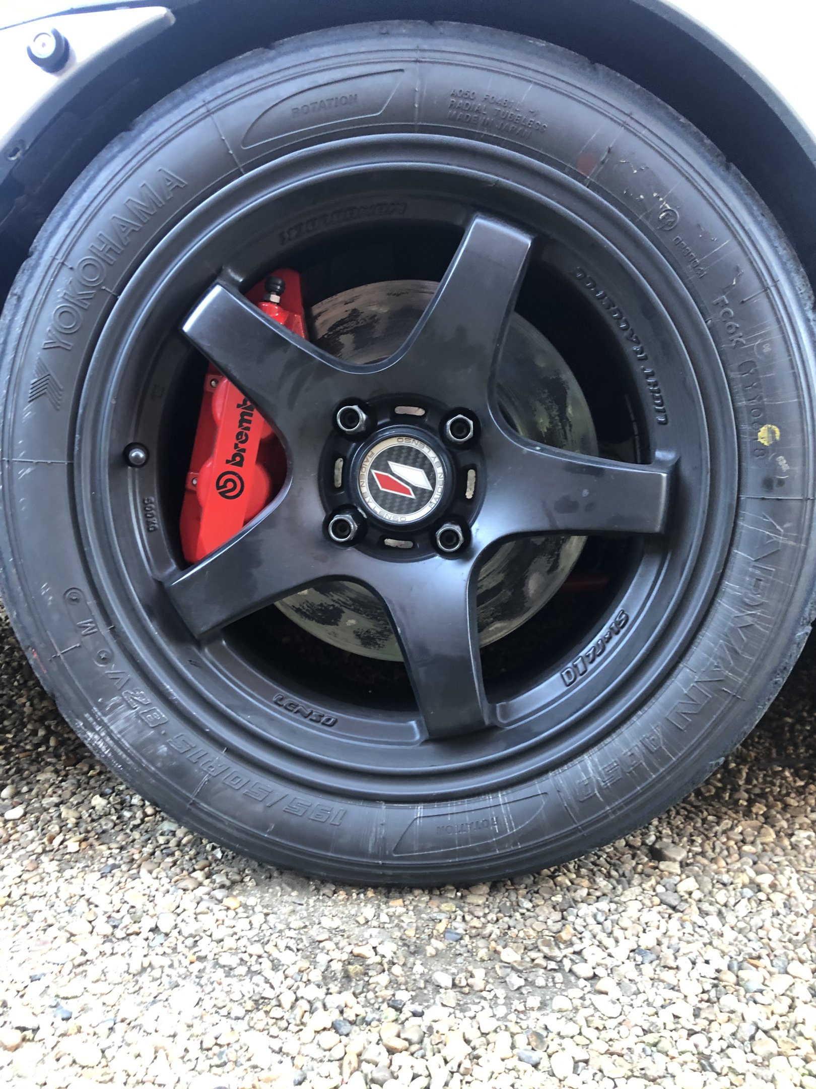

Those calipers above had to be machined to the same shape as the wheel, the discs are 15” the same size as the wheels on my Clio.
My Clio calipers are very close to the wheels that are fitted now, that’s with a 16mm spacer. I’m told my ProRace 1.2’s have slightly better clearance then those so hopefully I’ll be ok.
Could you center balance your wheels? Could be an option.
  Clio 172 (CUP)
Neat job on the machining, I've got exactly the same job to do, find somewhere to do the machining, refurb them, new hoses, same PRS pads fitting under TD 1.2 et38s ... Keeping the existing 280mm discs to ensure they fit.
I’ve not tried my 1.2’s yet but I’m confident they will fit as my mates got them over his and he’s using 300mm brackets with 7mm taken off calipers. I’m pretty sure with my 280 brackets I’ve got 3mm more clearance then him. If you’ve not done it by time I’ve tried them I’ll report back ?

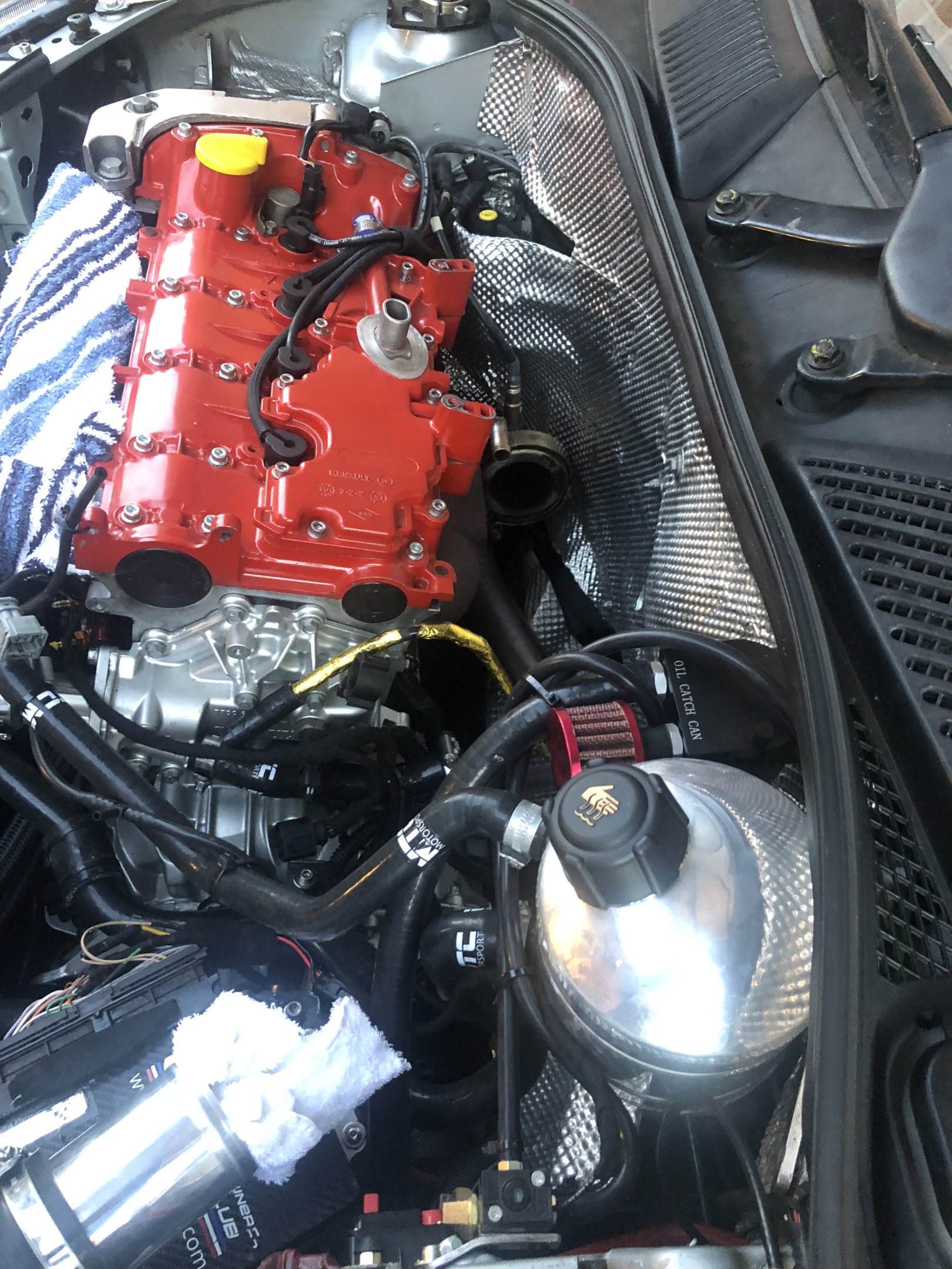

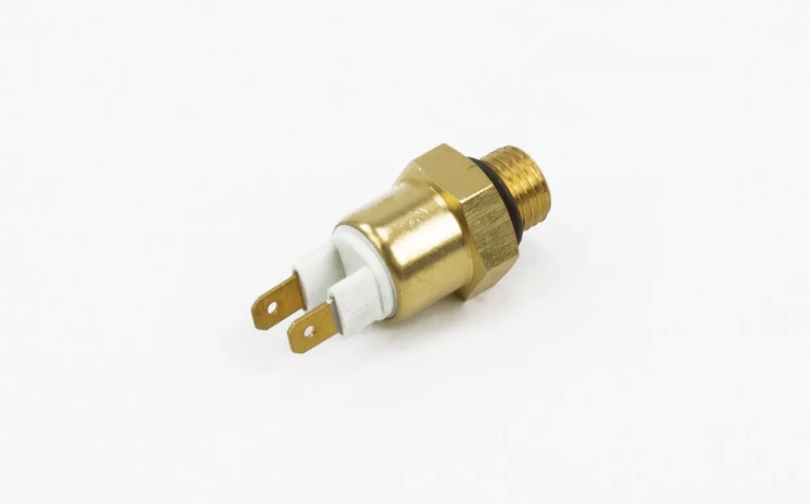

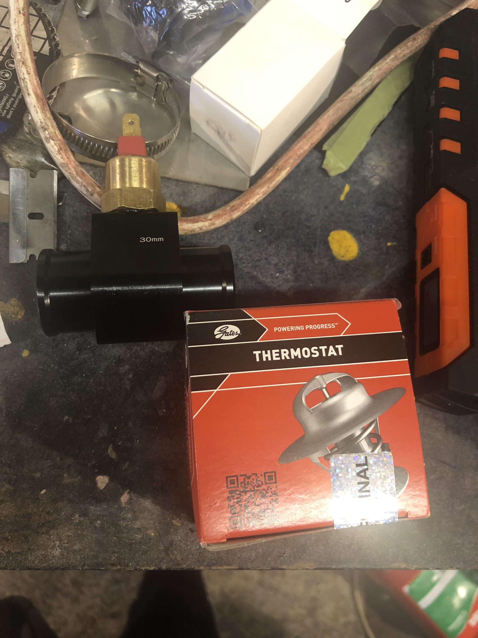

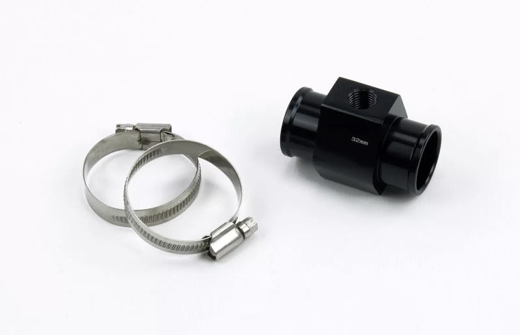

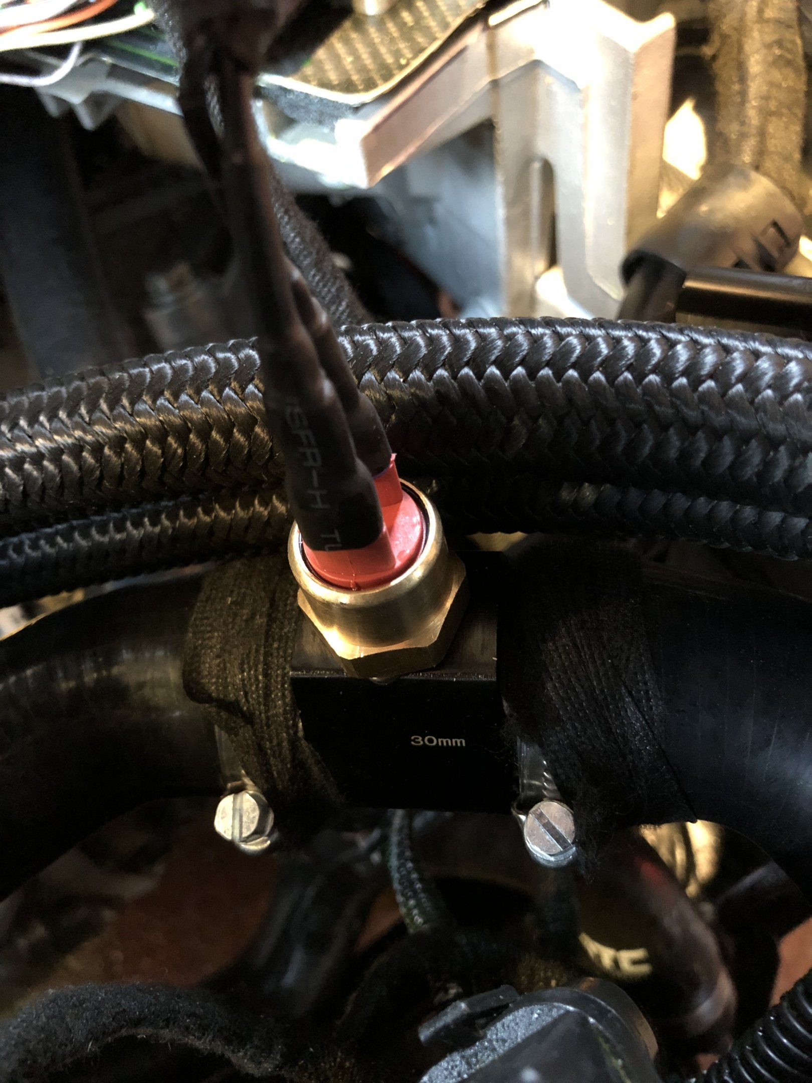

Fitted a low temperature thermostat and fan switch earlier, as mentioned a few weeks ago we noticed the fans didn’t work at all so I mounted a switch in the top radiator hose. I used a 75 degree thermostat and 90 on 80 off switch, ran it up earlier and seems to work fine.

Have you got any information on water feed and return for the turbo? Where did you take it from, what fittings, hose size etc did you use? And any pictures if you have!

I’ve removed the heater matrix and used the matrix feed and return for the turbo cooling. I’ve used 19-10mm reducers (I think they were 19) and 3/8” high temperature silicone pipe joined to banjo fittings on the turbo, these are wrapped in Kevlar heat shielding just to be safe.
