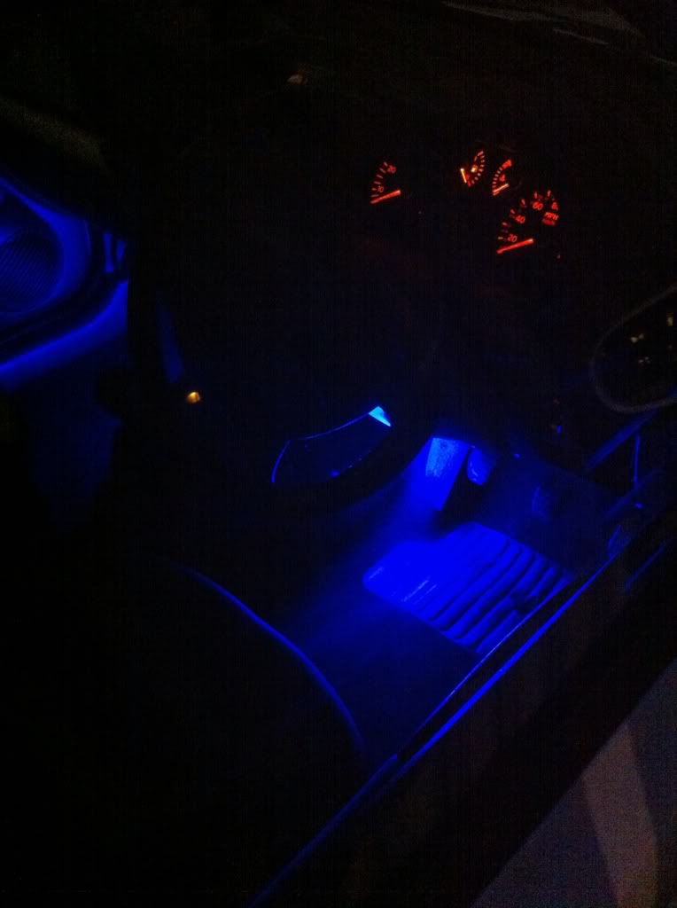

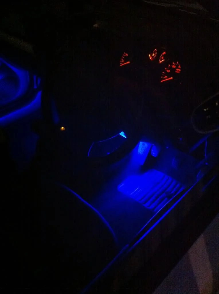

Bought 2 adhesive neon strips off ebay and fitted it today....will put a pic up when its abit darker...looks good and cant notice they are they're

They look nice! But all opinions count....not dark yet so no pictures. Lol my vans gonna look chavy inside when im finished lol! I love blue lights! Addicted!

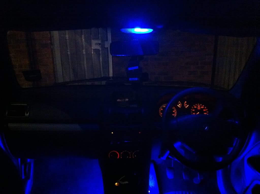

yeah! lol ido like the skyline in the 2nd one! would love to have a cockpit with all blue neons lol! i have blue interior bulb and 2 footwell neons haha! just need rear interior bulb blue and a few neons :p haha! then going to ply out the back and replace the interior carpets and seats!

if its the ones am thinking.. i had them when i was 17 and lasted like 2 weeks max everyone kicked them getting in and out but looking back am glad they did tbh
  Renault clio van
There LED strips, cant be damaged as they are rubber protected. They are flat and un noticable. I wired them
to the cigerette lighter thingy lol. So when i put side lights on they come on.

i dunno why youd wire them up to your lights. if they are bright and you can see them from the outside of the car when youre driving, expect to be pulled!
had mine on a switch so i could just turn them on/off when i liked. rarely had them on but they was UBER handy when i dropped something in the footwell of a nighttime

In all honesty they are the worst shittiest tackiest mod ever, IMHO but each to their own.

Driving....when i open my door the interior light doesnt come pn? (any reason?) and i havnt got a switch to ride them to. Theyre wires in easy so if i get a switch il change it, or if i can make it work when my door opens il do that?
you've put an LED in there. LED's only work when the power flows in one direction. On a clio, the power flows in one direction when you open the door, and the opposite direction when you turn it on manually. So you need 2 bulbs wired in opposite directions, or a rectifier.
  Renault clio van
Its a bulb i put in? Its not LED....but isit because i change the interior bulb why it no longer works bud? (i need you electrical brain)
