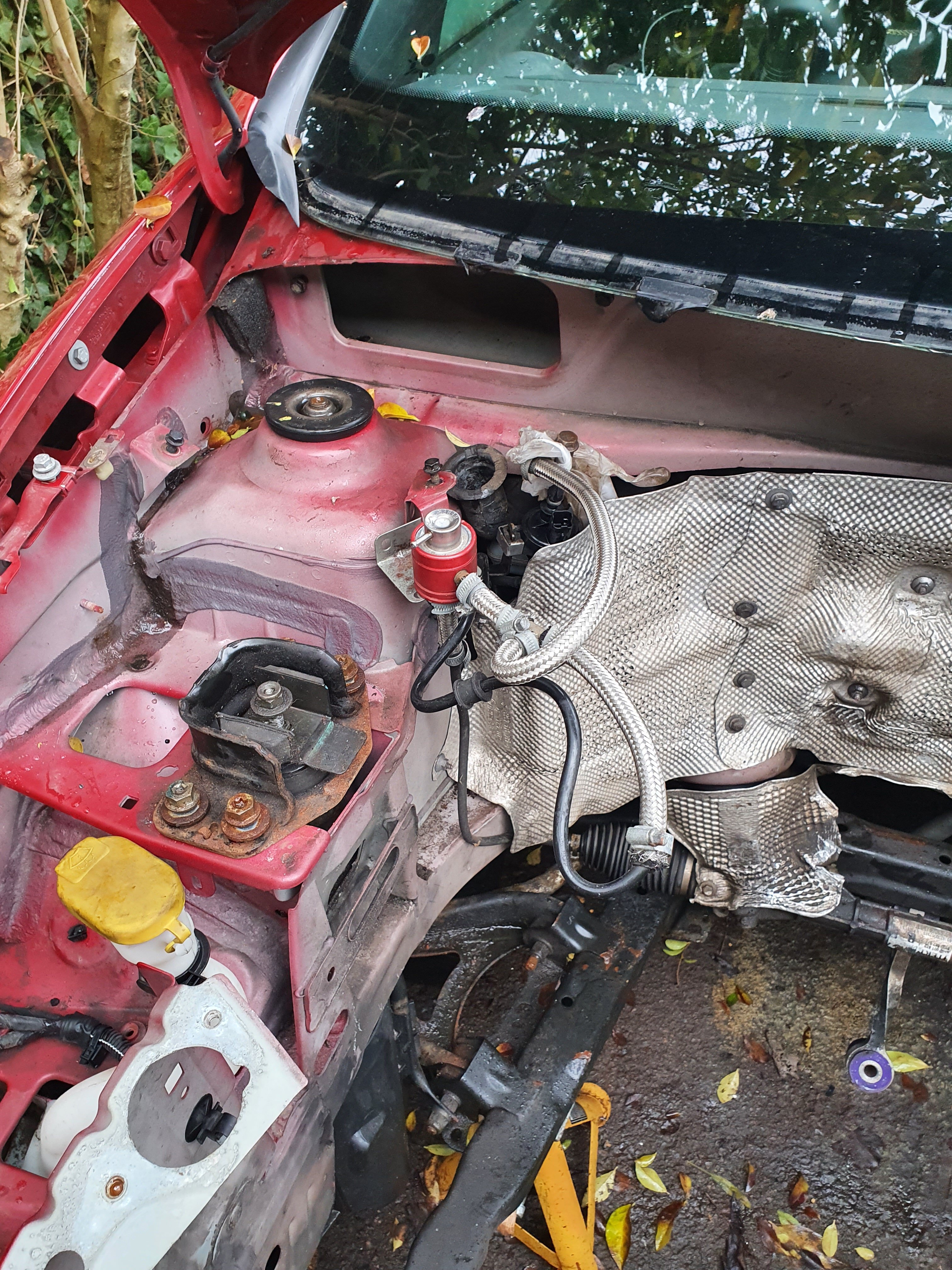

So here's the plan, Some SW PMT work in effect. Using mainly Renault parts and as few custom parts as possible I plan to drop an f4rt engine in the Twingo. The engine was had for a bargain and tbh, if I hadn't found it I wouldn't be doing this swap. Using the parts database I've been able to look up a fair few parts and cross reference them with others to see what will/should fit. And using my previously acquired pikey skills I plan to make it work. Now there are better ways to go about this but I'm doing this on the cheap and keeping it relatively simple and easy to fit. Many many hours have been spent seeing what should fit though and keep the costs right down.

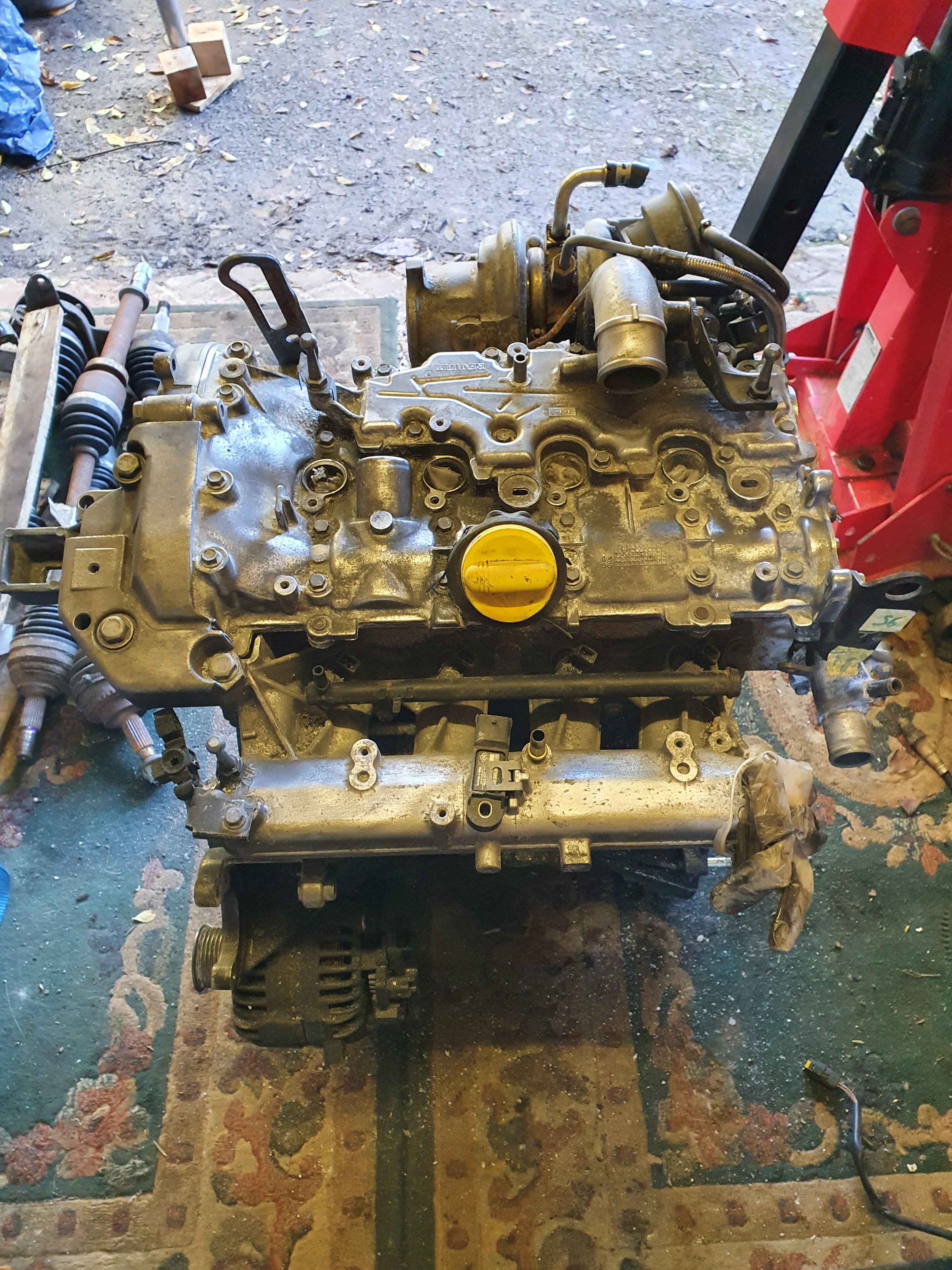

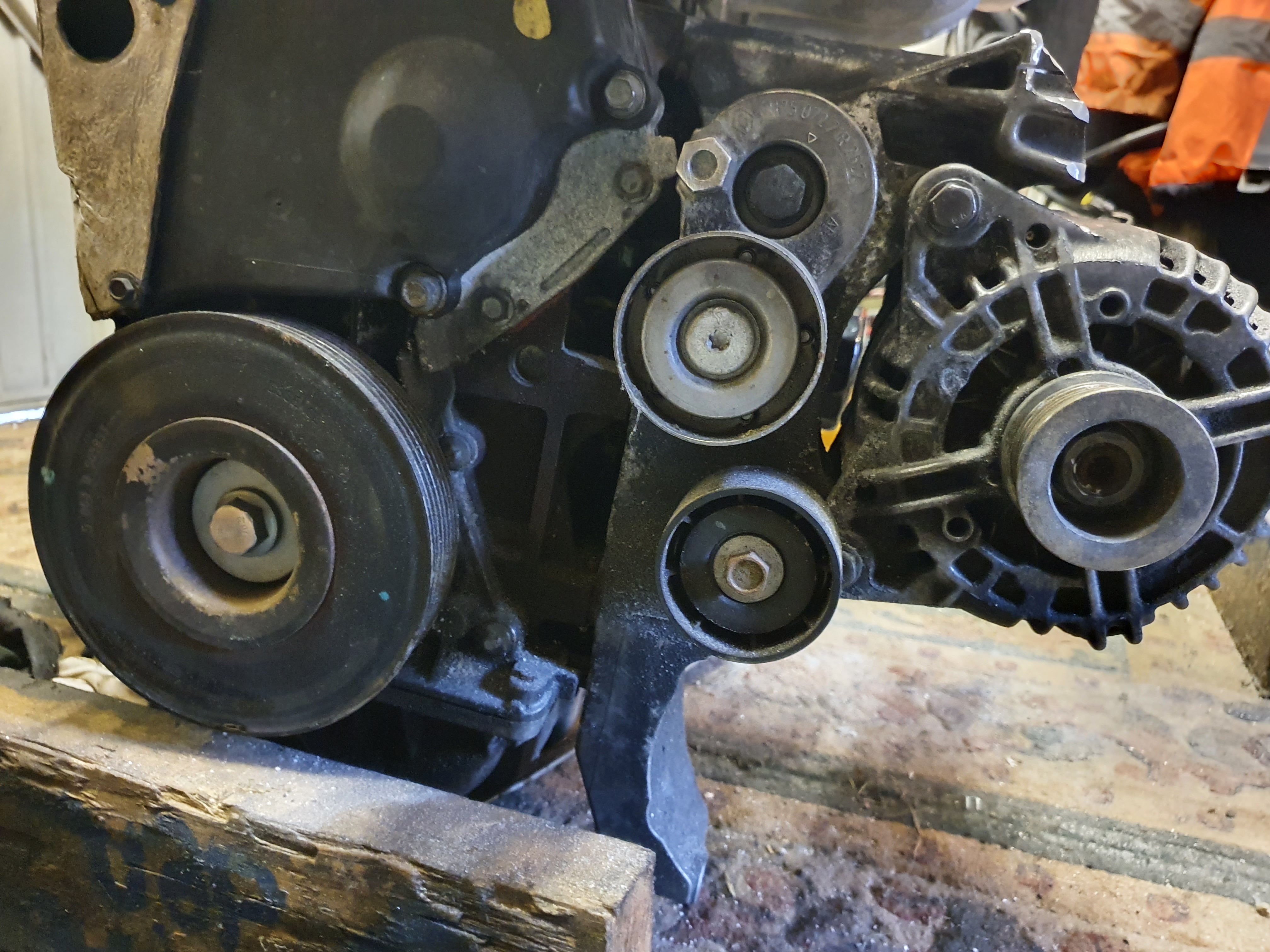

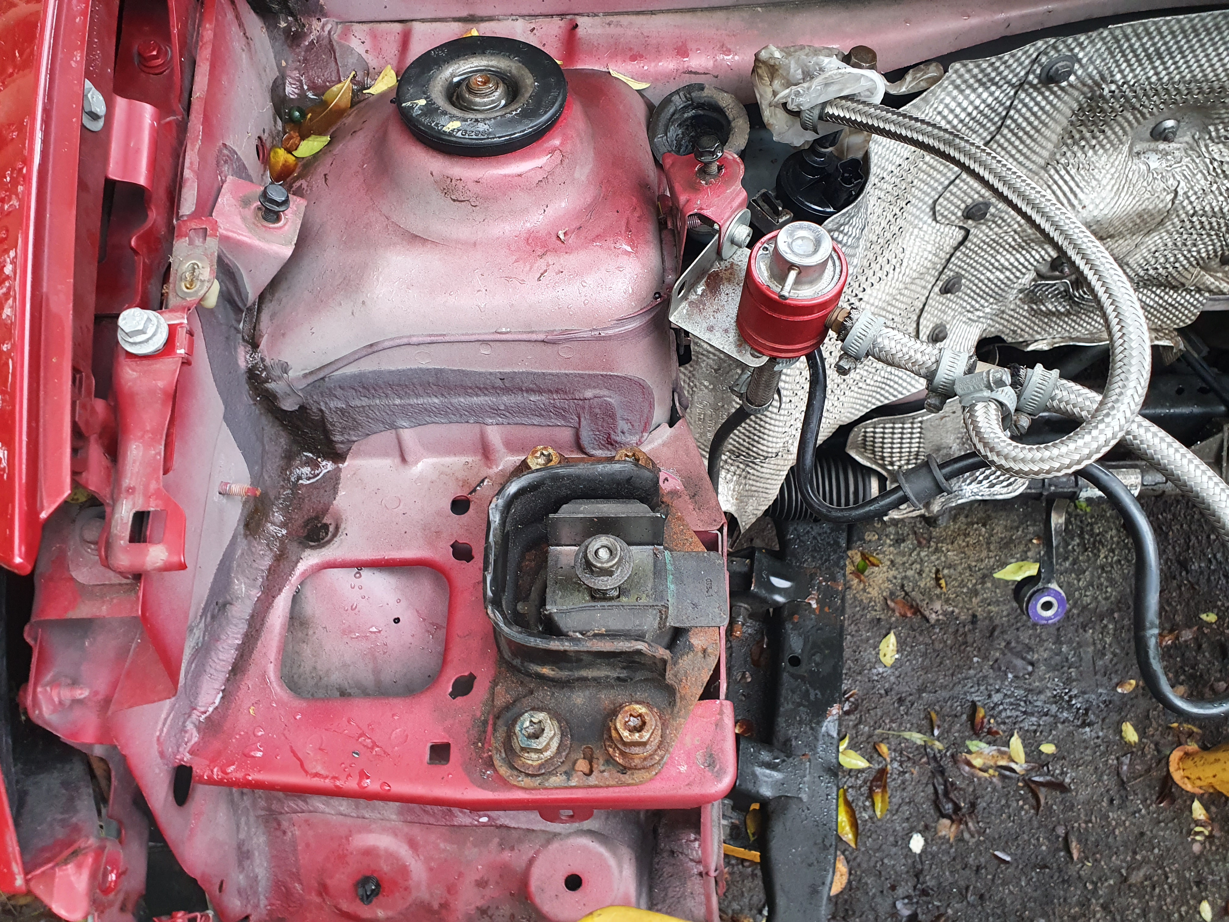

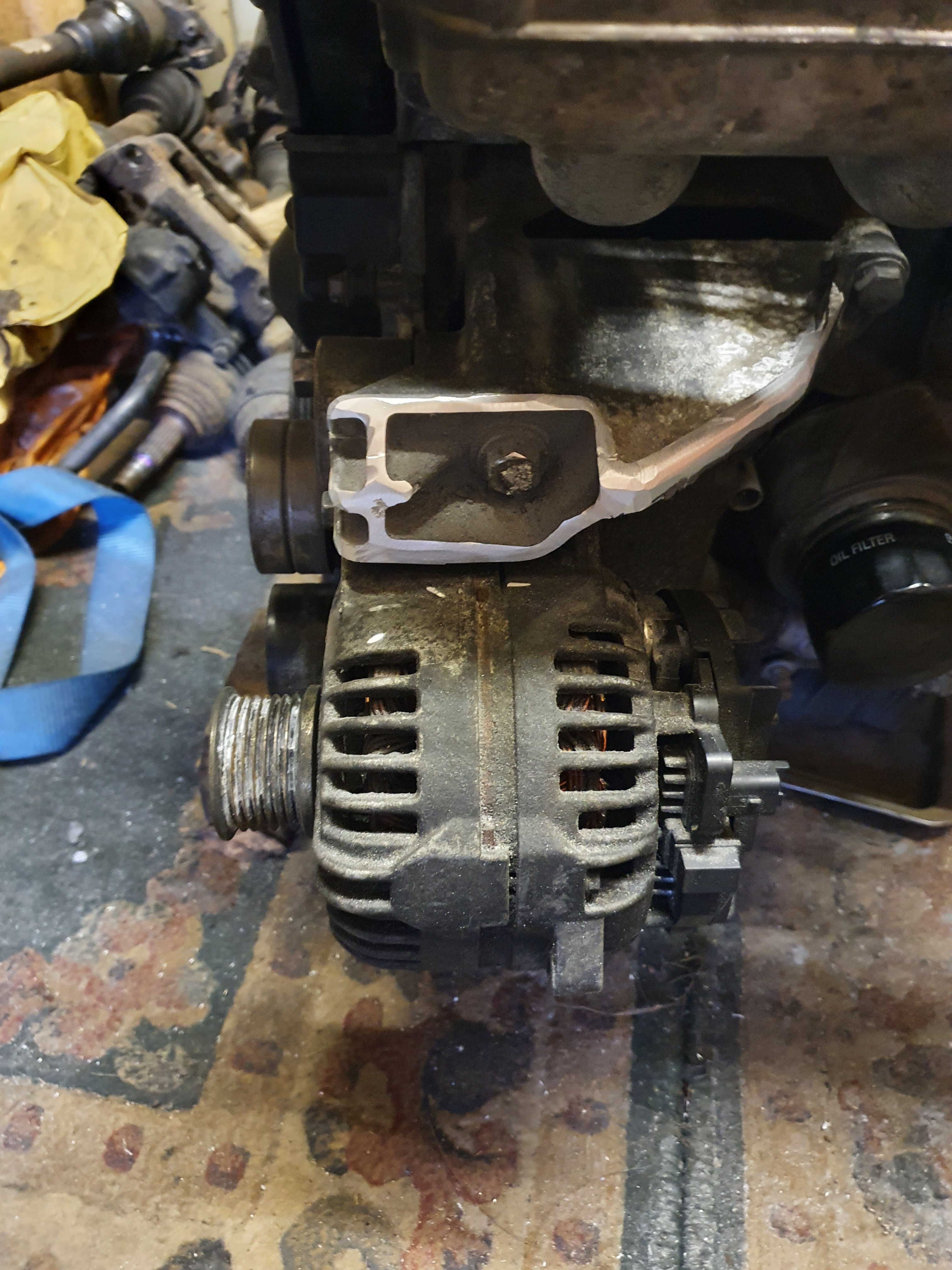

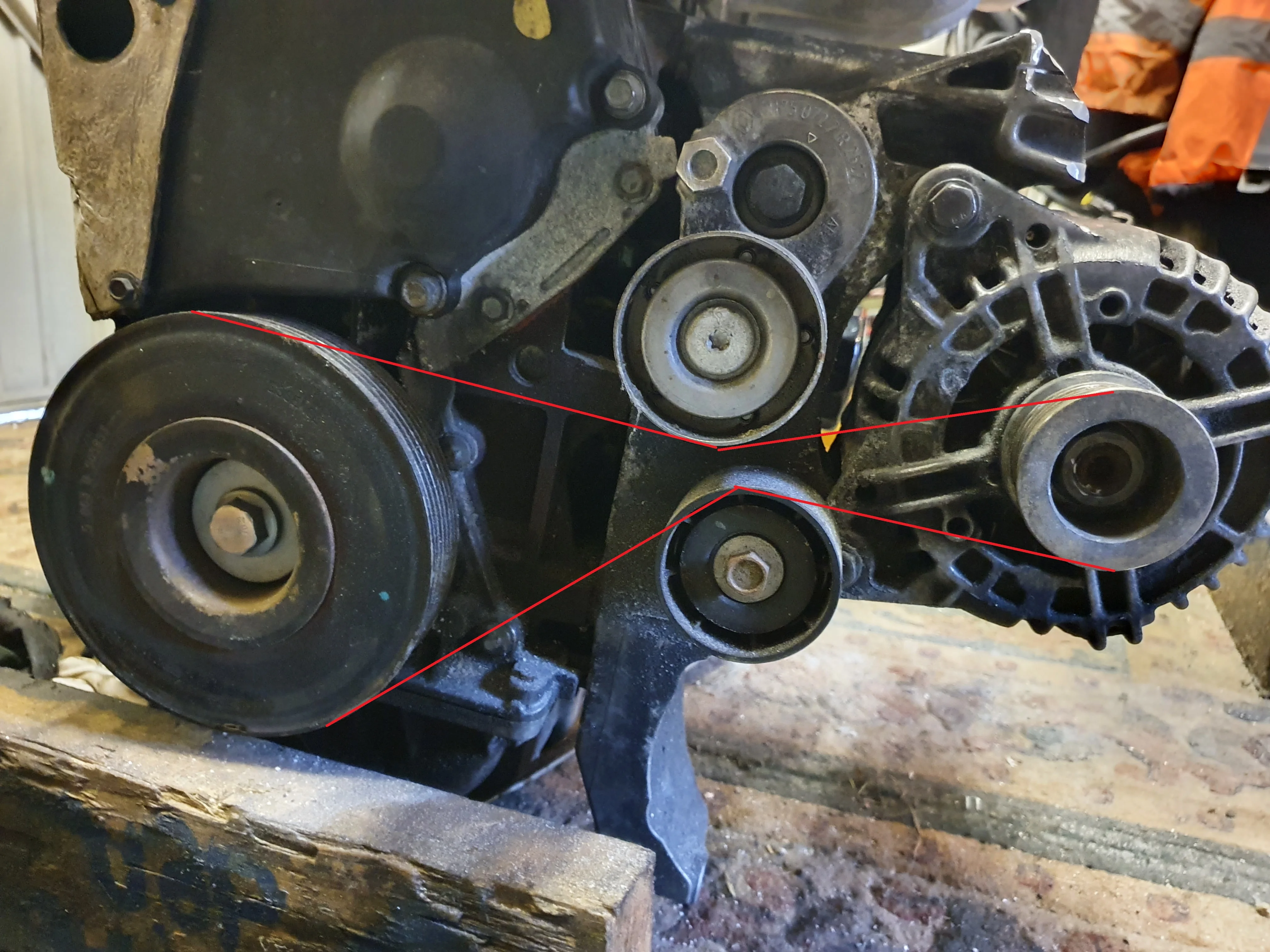

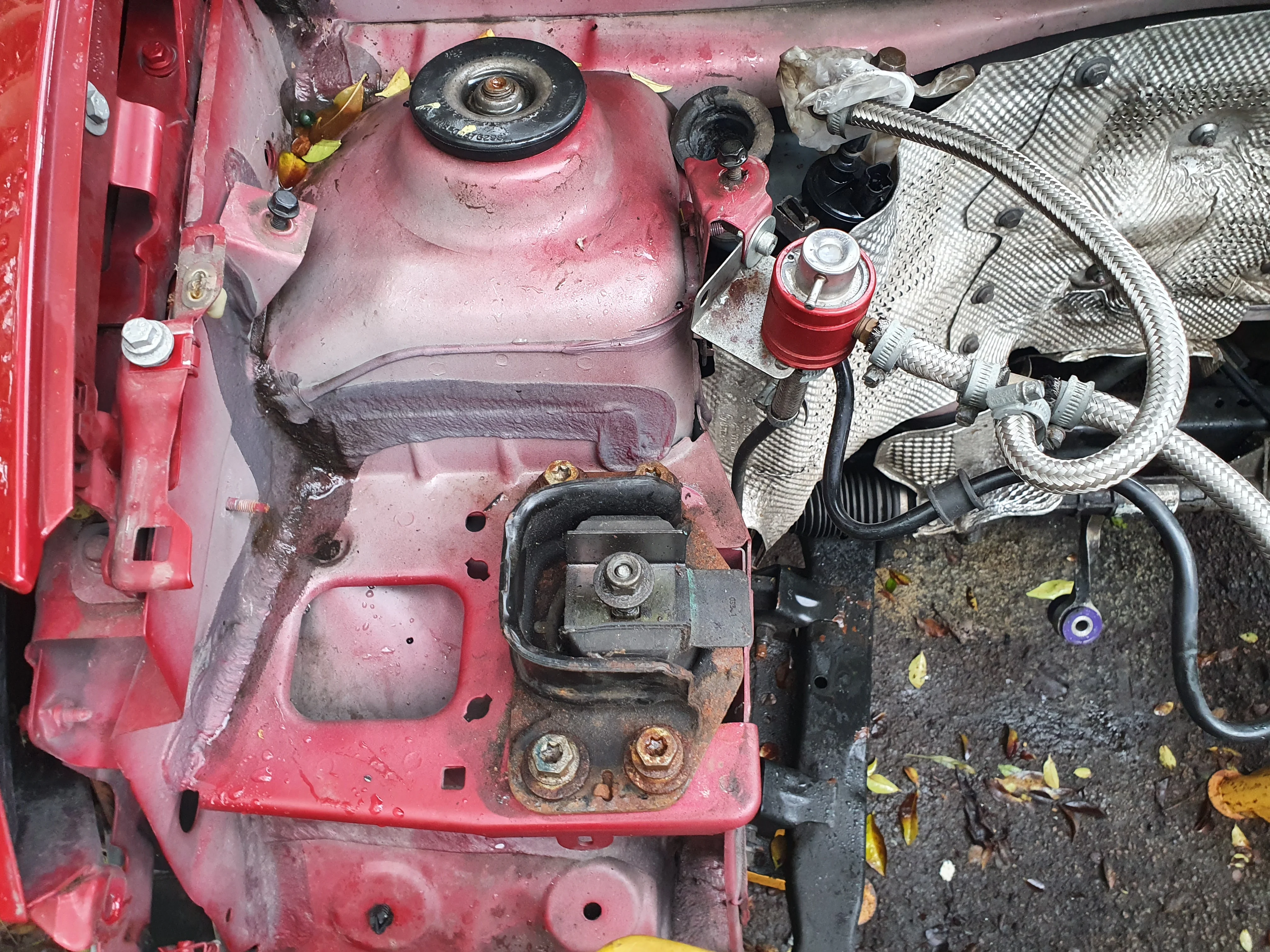

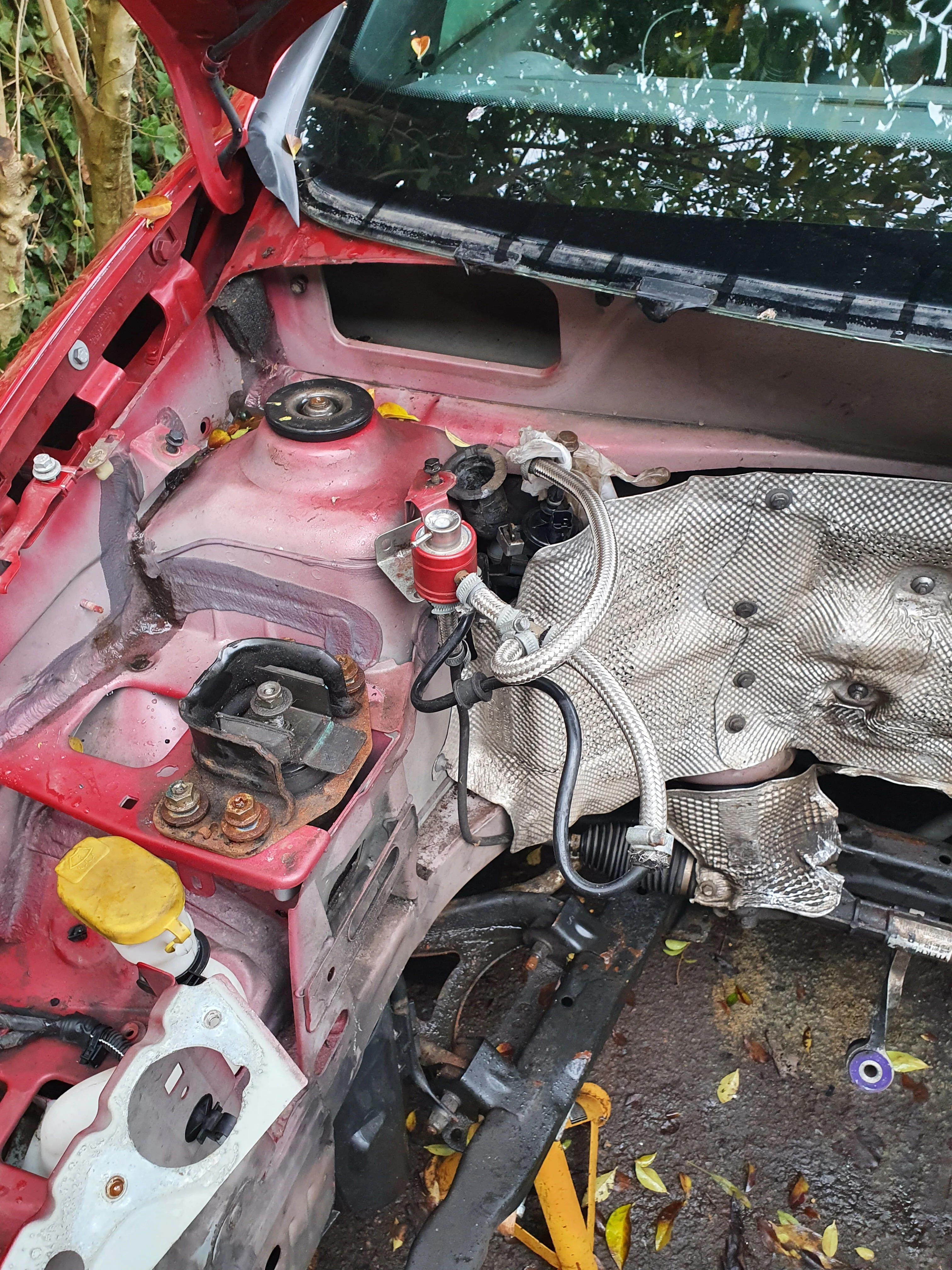

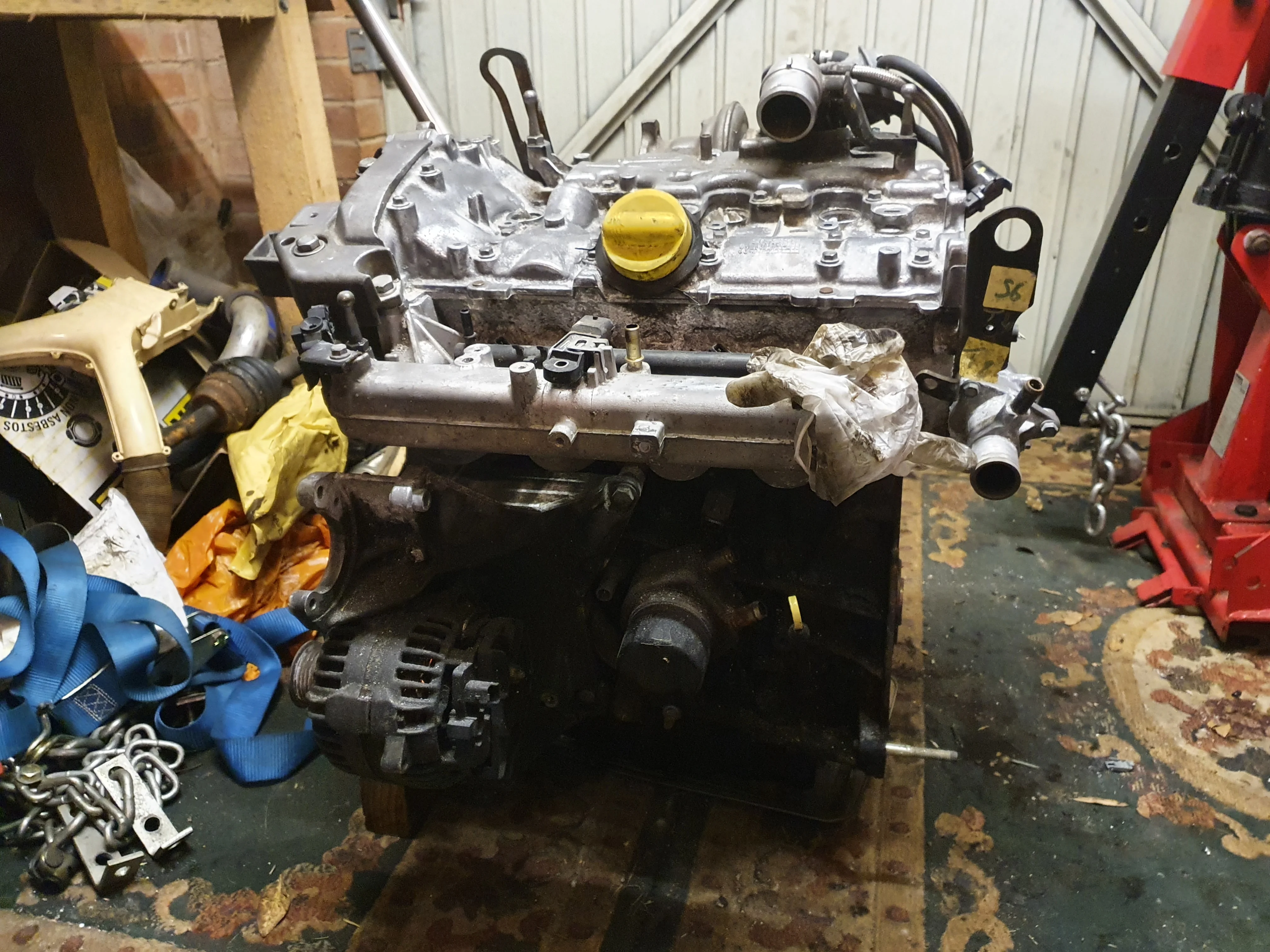

Take one f4rt turbo engine, modify a 172 cambelt cover to not fowl the belt and then fit the 172 upper engine mount as per the pic. The meg cover is wider and the 172 upper mount doesn't fit it correctly.

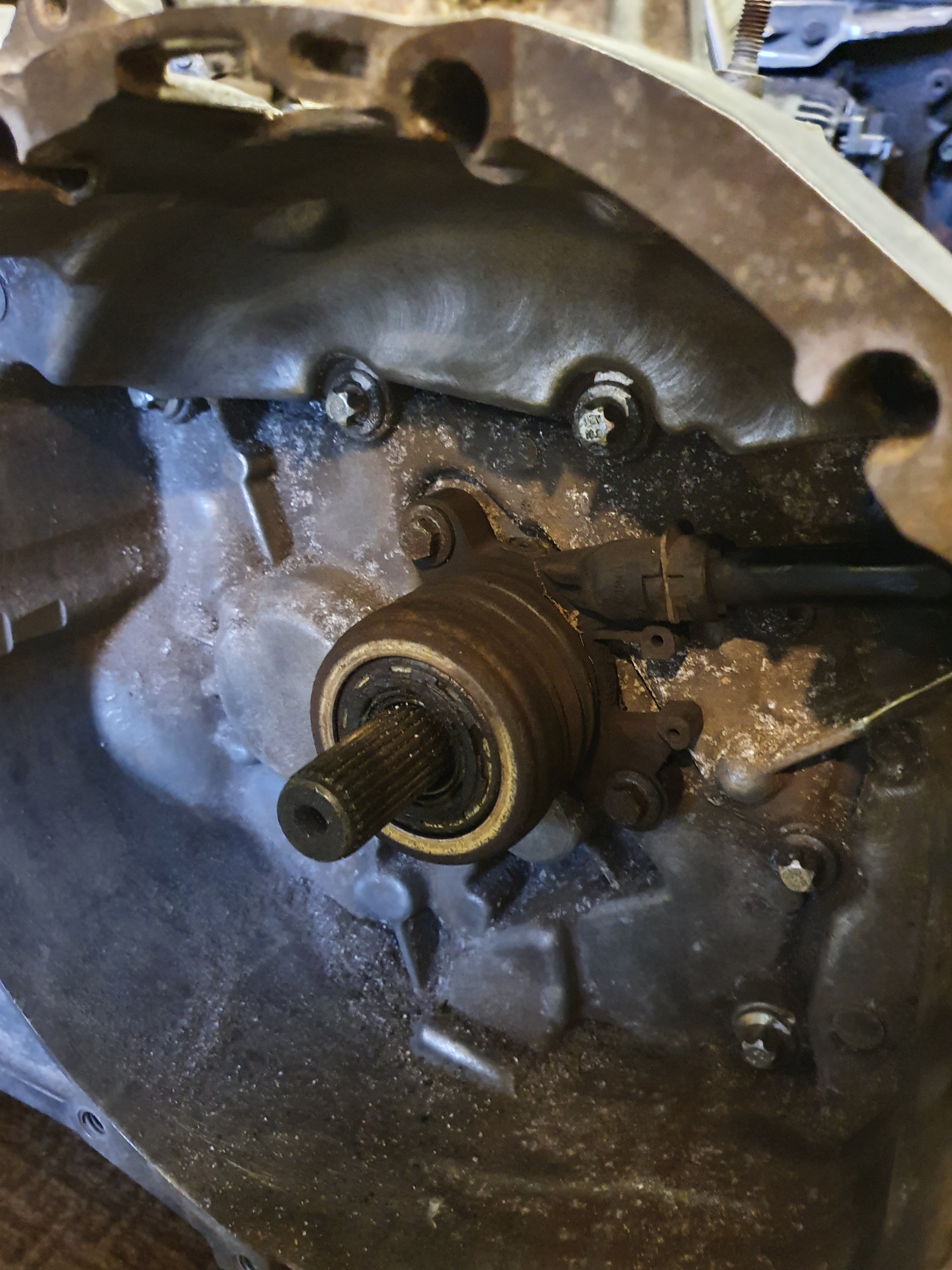

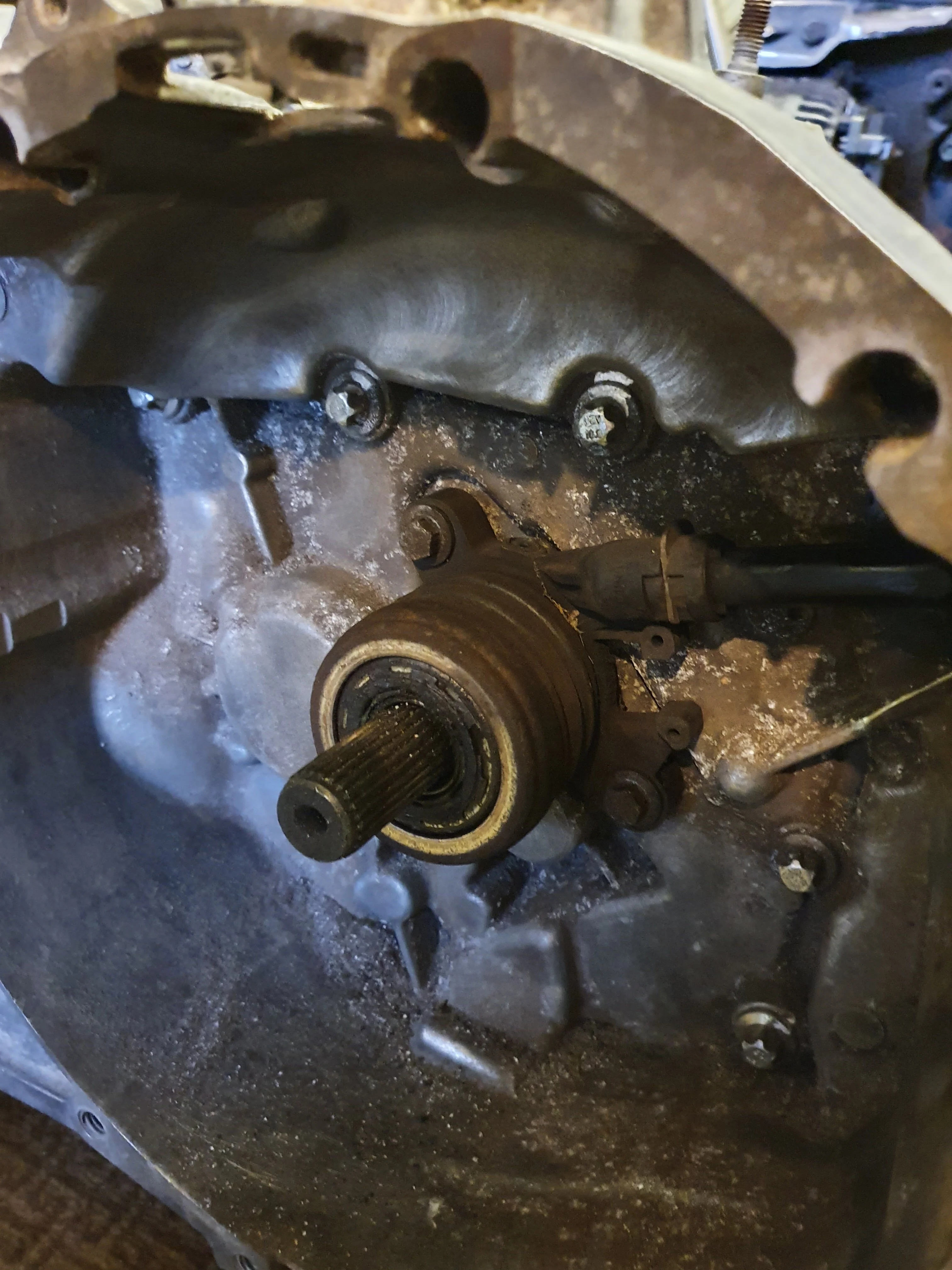

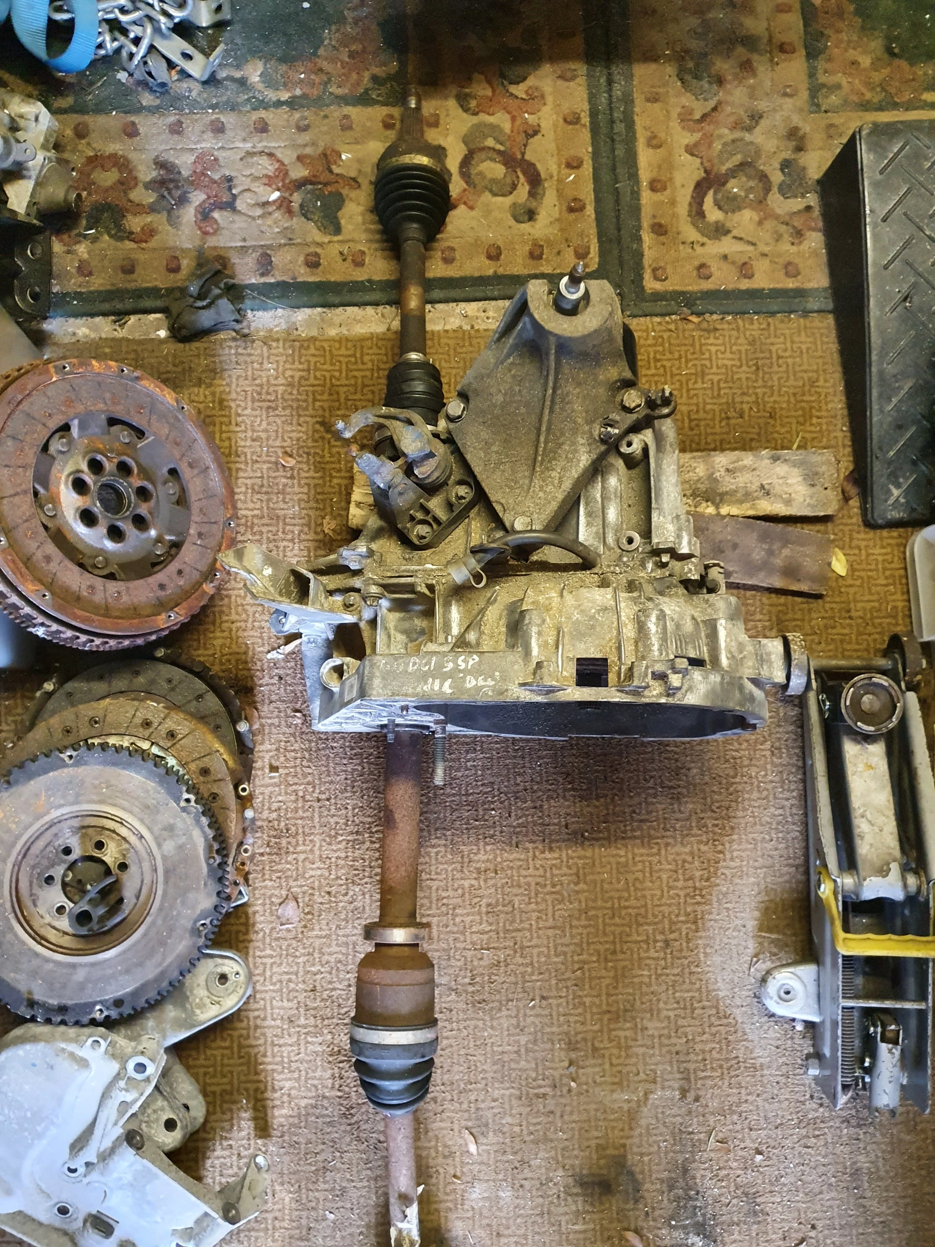

Next will be fit a flywheel and clutch (for alignment) from a clio3/megane2 1.5dci, this looks like it will fit up to the crank fine and looks like it uses the standard Renault 215mm, 26 spline clutch disk. This should allow me to run any Clio 172 uprated friction disk. This should also mate up nicely to the JR5 DCI 5 speed gearbox.

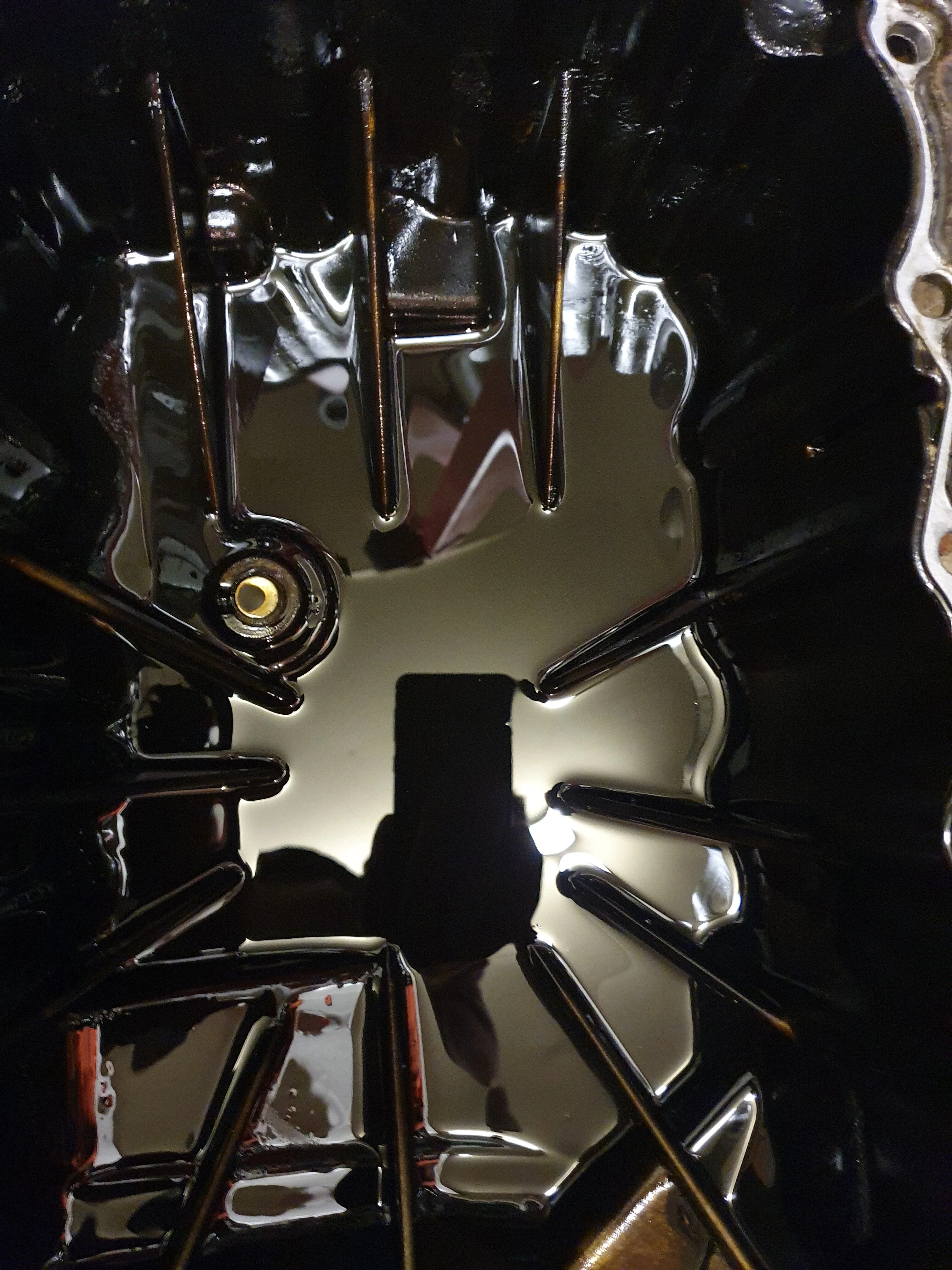

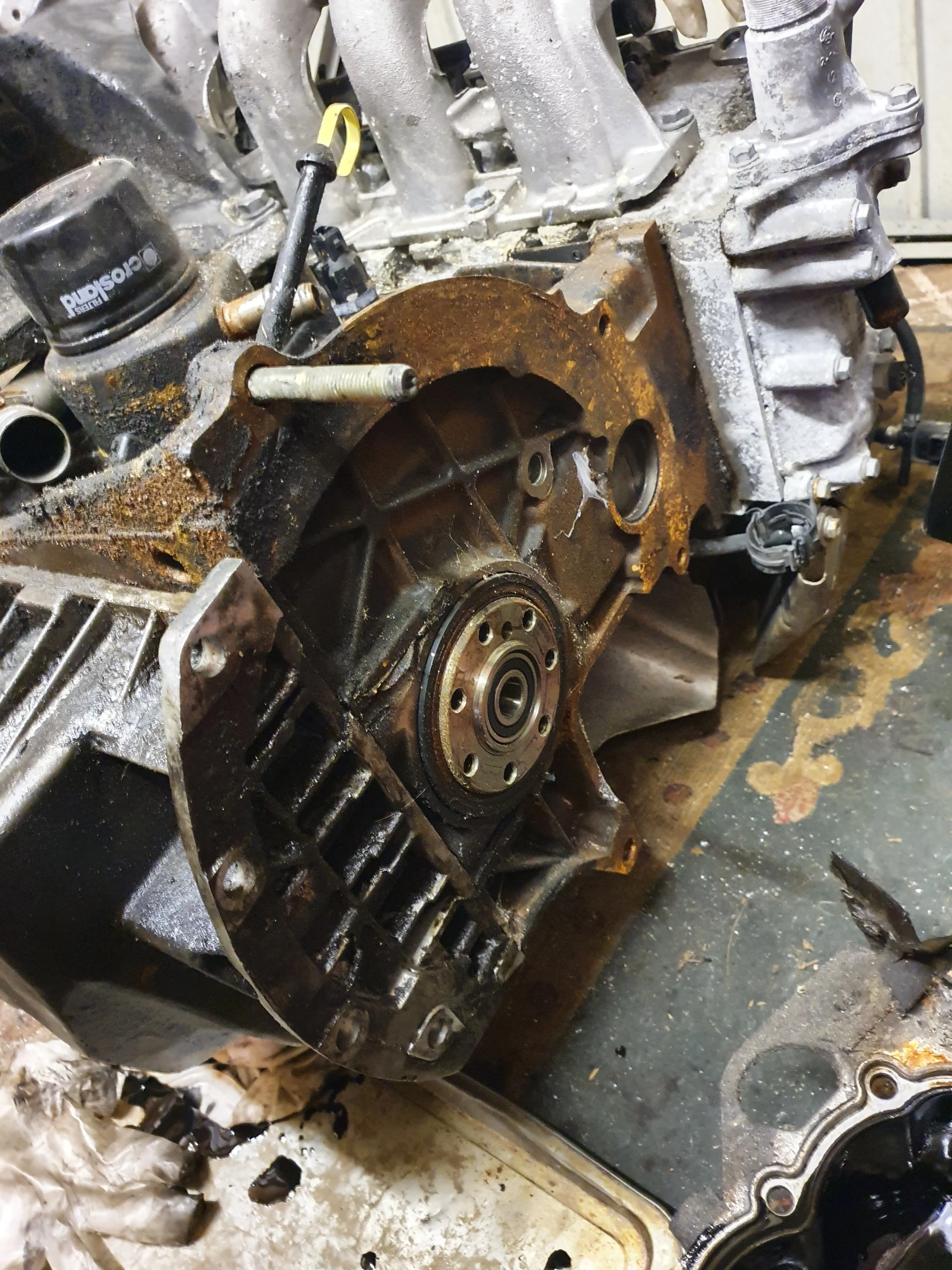

Now as I have done previously I will be fitting a 172 sump and re drilling the block to accept the 5 speed box. The JR5 box looks to be a newer/updated version of the old JC5 except it has a cable shift and hydro clutch arrangement. This should mate up to my current Twingo GT setup

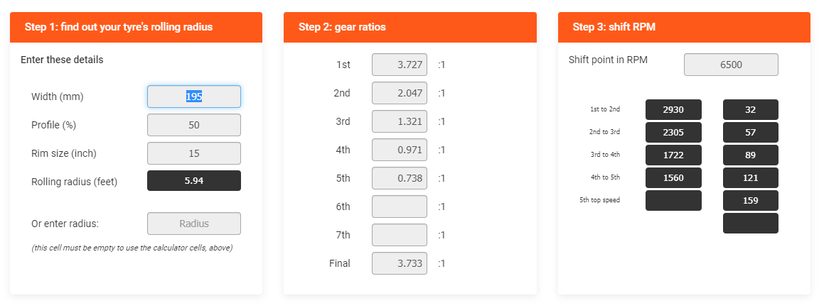

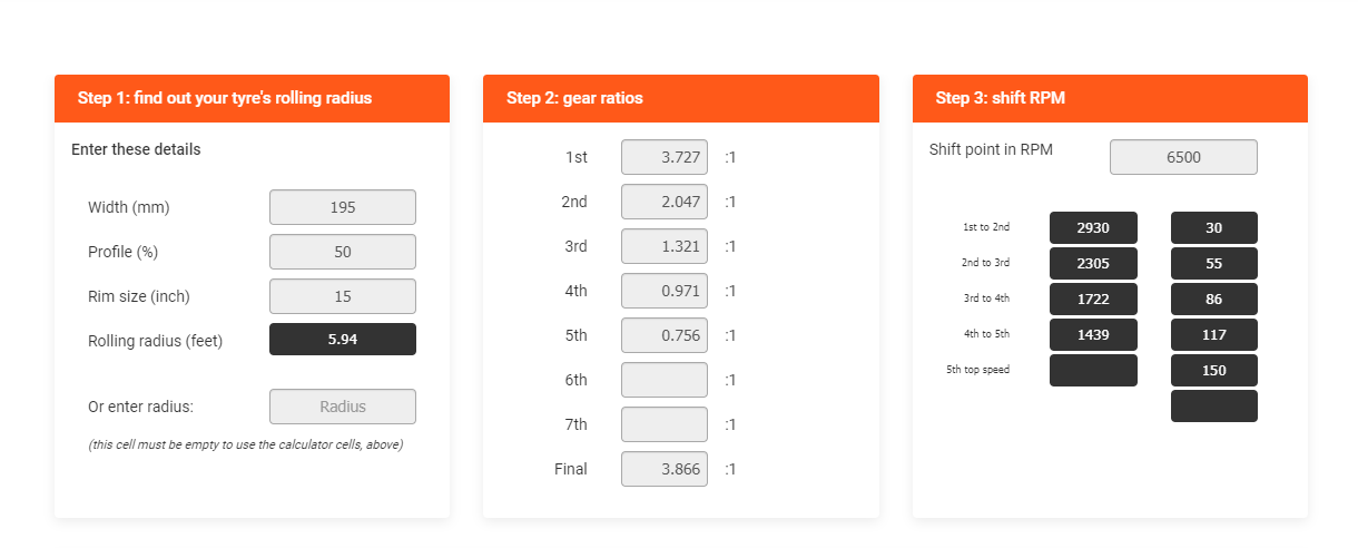

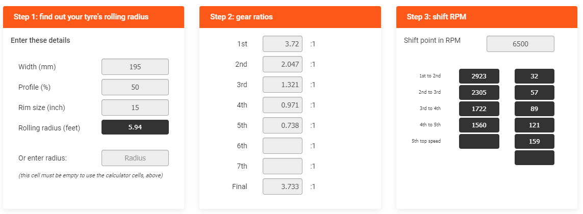

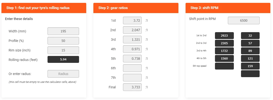

the box also has the same style driveshafts as the GT so they should slot right into place too meaning no expensive custom driveshafts. The diesel box has also been selected for its ratios as the turbo engine revs low compared to some of the petrol's. It should be similar gear to output as the old ph1 172 089 box bar 5th where it will have some 150+mph legs...

Now I'm not going for mad power in this as I want to keep everything in one piece and keep the costs screwed down, I think id like 230 to 250bhp at the end of it, which should shift the car along nicely and keep it reliable. I've ran the old JC5 boxes at 230+ftlb and 280bhp previously and quite a few of the turbo 172/182 people have ran more. That said plenty of Renault boxes s**t a frisbee at stock power levels lol
