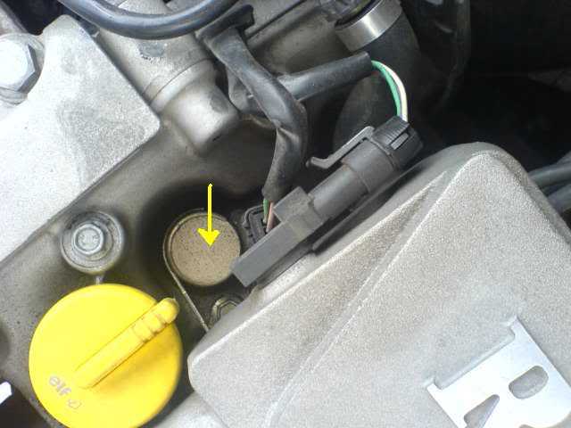

Hi Ben, VVT is Variable Valve Timming Right?
Do You know how it works and the symptoms in case of bad function?
Is controlled by this solenoid?
Regards
Variable valve timing yes.
It works off oil pressure through the cam centre itself as its hollow, the solenoid you have pictured is correct, and that is tripped by a ground by the ECU when VVT should be triggered. Oil pressure acts on the vanes inside the pulley to push the centre unit attached to the camshaft in advance of 16 degrees.
VVT pulleys can fail, but i've not seen one fail yet.
  RenaultSport clio 172 mk2
Thanks Ben
I ask becouse my car sometimes the engine at idle speed is not stable and in the exaust backbox (silencer) you heard tut.. tut tut tut tut and a friend told me you have to clean the VVT Solenoid is getting stocked and engine is loosing the timming so I do not know
Regards
They all idle a teeny bit rough, so there is fine line which is hard to describe over the net.
