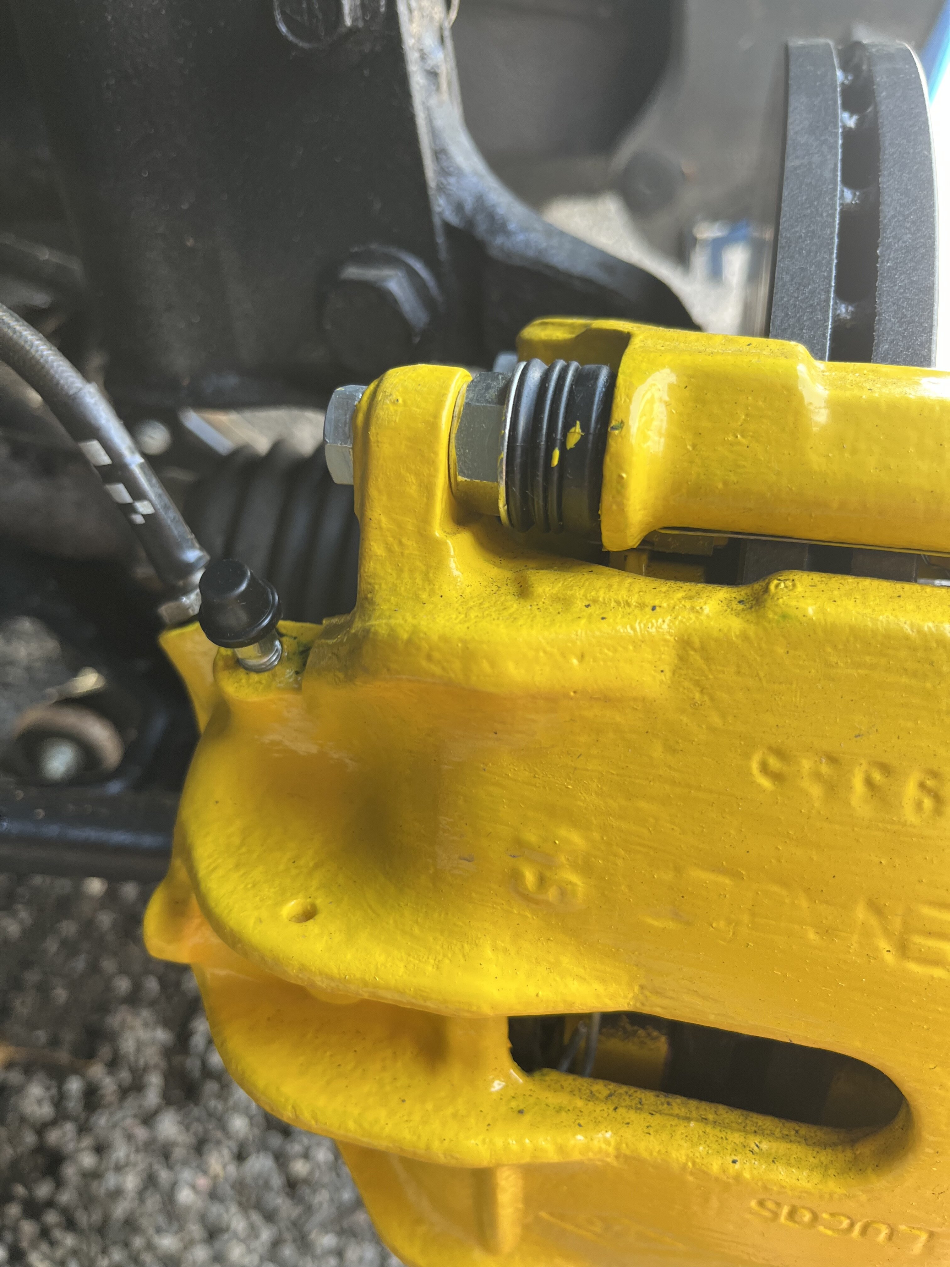

this is a pic of the most offending side (front left) showing pad to disc and slide bolts… anyone able to confirm if it looks okay? I can still see the pink bedding on surface from the new pads

When you say grinding, do you mean a bad noise or just the pads riding against the discs, like a light swishing sound?
The latter is normal tbh
When I’m turning the disc now, there’s a light swishing
Looks fine.
It should quieten down once the pads are worn a bit.
Basically the pads are right up against the disc as it's all new, with not a lot of free sliding movement until it's worn in.
