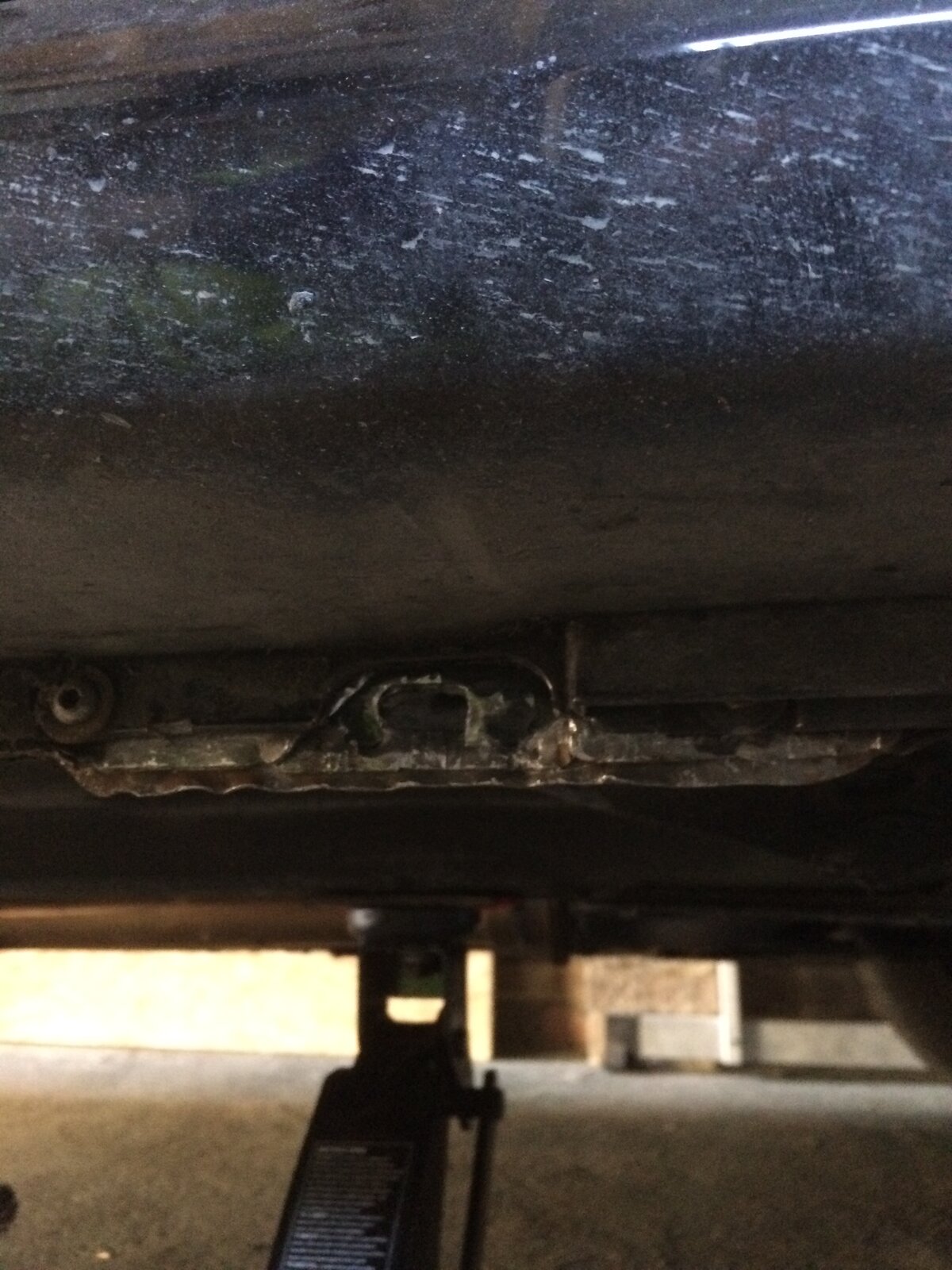

Evening all,
Probably a long shot but does anyone have a photo of a front jacking point in good nick?
I’ve just folded mine out with grips/pry bars etc. Now looks like:
Not brilliant but it was worse. It looks like I’ve folded it down too far though. Should the steel I’ve folded down be more or less level with the rest of the sill? Cheers
Evening all,
I’ve just folded mine out with grips/pry bars etc. Now looks like:View attachment 1468581Not brilliant but it was worse. It looks like I’ve folded it down too far though. Should the steel I’ve folded down be more or less level with the rest of the sill? Cheers

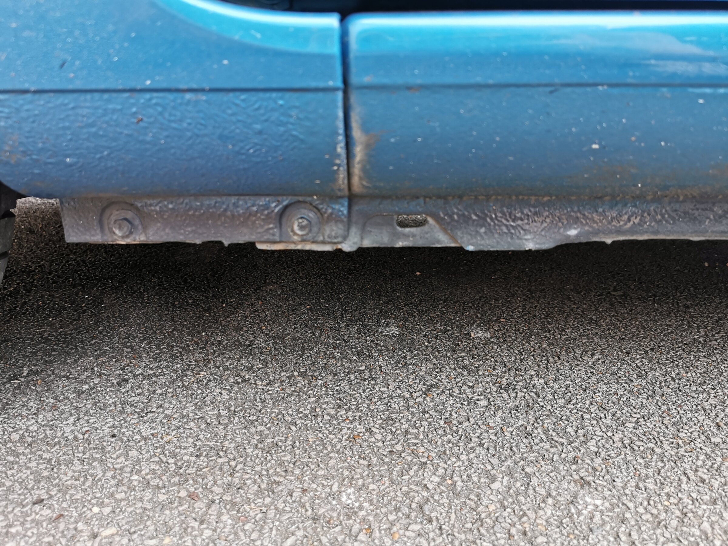

What you done is right.. The jack that Renault supply has a V slot in it which the sill sits into.. Ive bolted a 1 inch square box tube to the other side of that sill so my trolley jack doesn't fold it over again..

Sound. I thought I’d gone too far, was just looking at your solution as it happens. I’ll be trying something similar. In the meantime jacking on the chassis rail.
Thanks mate.
