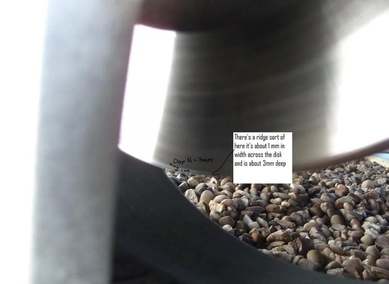

Yes... well sort of, don't quite know exactly what you mean...
I'll show a pic of what i found just.

right around the outside of the disc edge if its got a lip means they are getting worn and is most likely catching yuor brake pads causing your squeak
  1.2 Clio
So as i described above??? It is all the way around the edge of the disk. What produces this lip? Is it that the brake pads need renewing? I clearly need new discs then as they are worn, yes???
The pads don't go all the way to the edge of the disc, meaning that the bit they press on wears away and leaves a lip round the edge.
You could try getting new discs.
