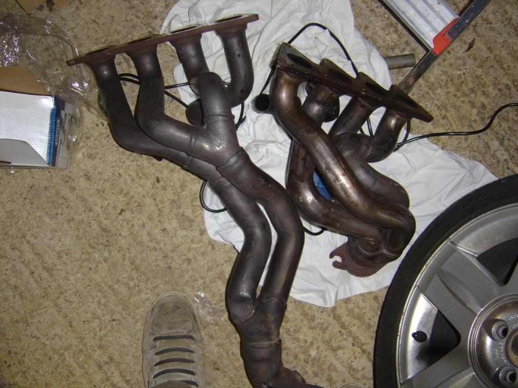

182 manifold (left)
172 manifold (right)
My foot (bottom left)
Dent in the 182 manifold is caused by slack engine mounts and the ARB. It's common

4-2-1 low-mid range, 4-1 for top end power. However you never hear of anyone with a 182 changing to a 4-1 manifold do u but many 172 owners change to a 4-2-1 manifold. Ive read about this debate before and ppl defend the 4-1 manifold like crazy but like i say y dont 182 owners swap 2 a 4-1 if its that good?

I thought that the 172 (4-1) manifold provided better torque and better low mid range and the 182 (4-2-1) provided more high end power....

Thats what they say, depending on which threads you read lol - I found the 182 gave better top end. Just felt a lot better overall than the 4-1.
Happy with my torque level from the 182 mani anyway, would the 172 be even better?....who knows

There obviously is a benefit from fitting the 4-2-1 because out of the factory the 182 is producing more power allegedly than the 172 and the only differences I'm aware of on the 182 engine are the Exhaust manifold and a different ECU map... So someone fitting a 182 4-2-1 with a henk RS Tuner remap would make gains over the 4-1.
