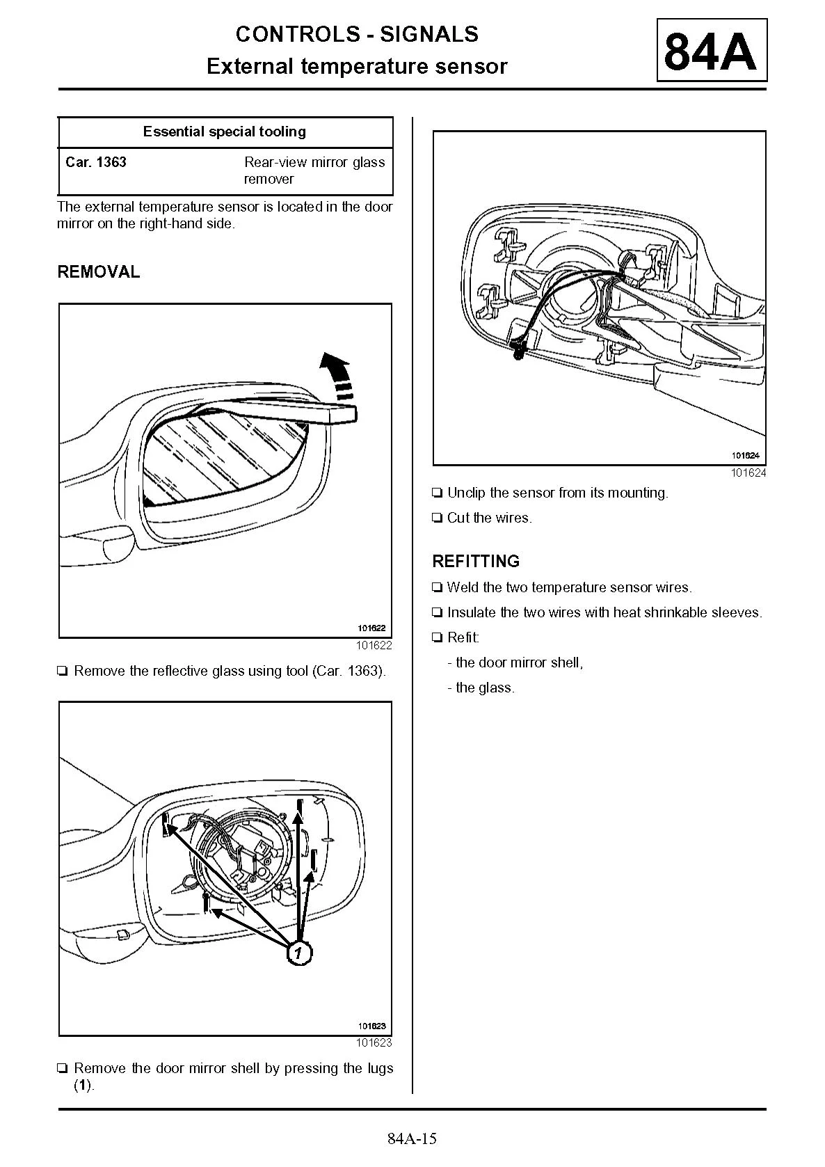

is it the same sensor as this extract from a megan o&m ?
mike means the external temp display on the bit with the clock/radio display!
