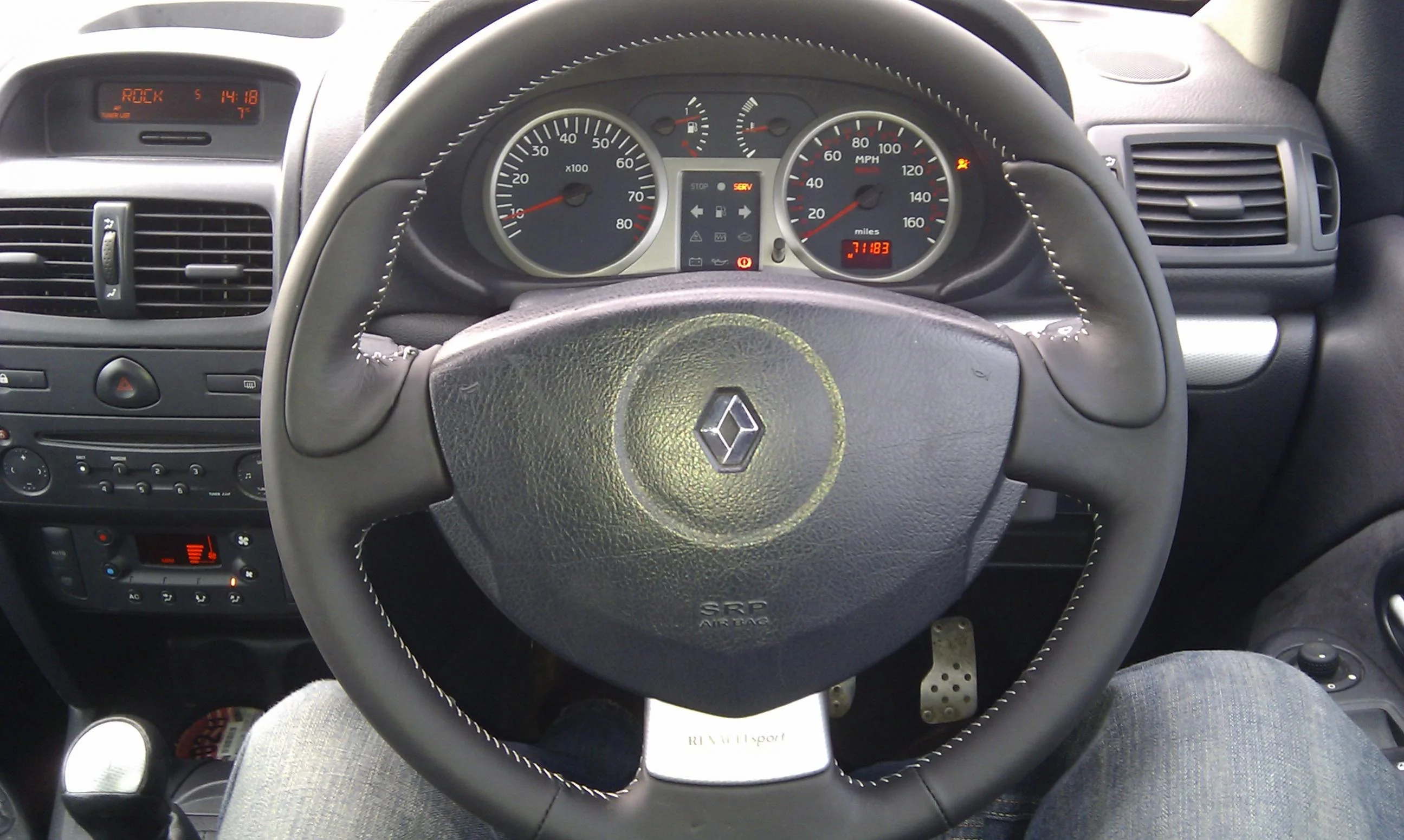

New wheel (before airbag fault resolved):
