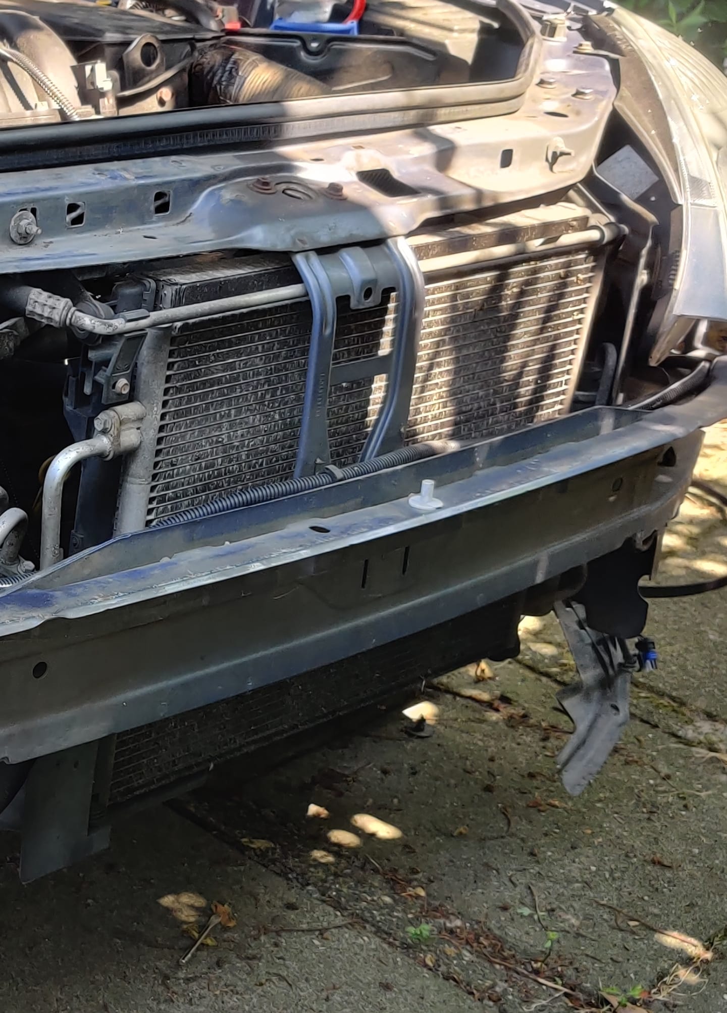

I think the condensor is the culprit. Its almost 20 years old and the fins are crusty. A few days ago i had the bumper off for aux belt replacement.

Is it doable to do it myself? for sure i have to let a garage pull the refrigerant and regas it. Are there tricky bits that i need to know before i would do this job? Garage prices are absolutely mental here and like to save some cash.
Just shove a screwdriver on the input first and see if it even has any in.
Leave the screwdriver accidentally on too long until it has none in.
Yeah it's doable, just prepare to need a new radiator as it'll likely be collapsing too.
JamesBryan
Easy enough to do on a Mk2.
Don't forget that the two bolts behind the crash bar only need loosening to remove the top slam panel, as the holes are slotted allowing you to pull it upwards.

Most garages empty free of charge so not really any benefit of chugging whatever is in there in the atmosphere 🙄

A full system of R134a is roughly the CO2 equivalent of burning up 10 full tanks of fuel. Wouldn't hurt the environment that much right? XD
But sure, i will let a garage do the emptying.
I've made the following shopping list for this job:
Nissens condensor (8200757789)
Nissens radiator (7700428082)
Seals kit (7701207465)
PAG 46 oil (SP 10 equivalent)
Mounting rubbers for rad
Coolant ethylene glycol based yellow/green stuff
I will first go on vacation and then i will buy the parts and do the job.
