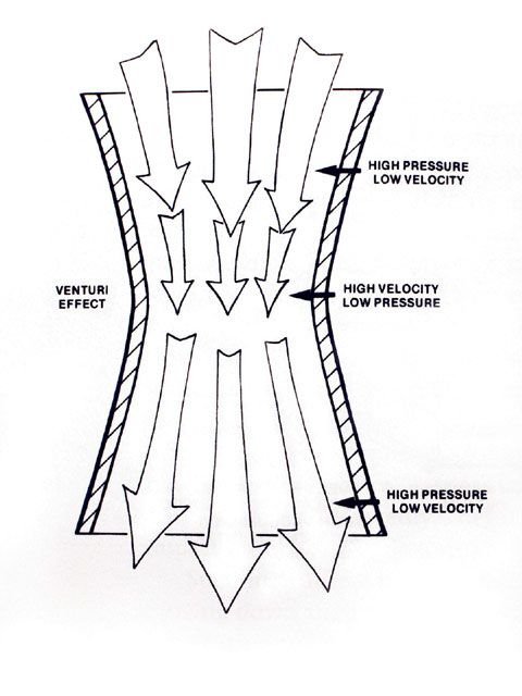

The venturi effect:
The high velocity air is needed for responsiveness.
Notice the shape is similar to the inlet of an ITG Maxogen? (which DOES drive well)

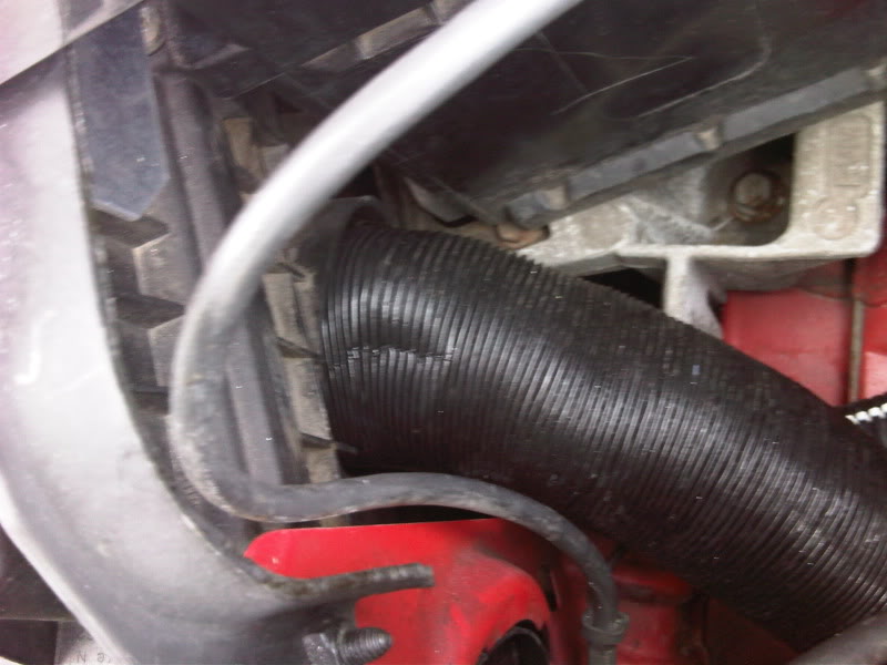

With the focus on response and cheapness, after experimenting with a lot of configurations I've gone for this:
Standard airbox with standard fitler (they aren't BAD filters, but I'll be changing to a KTR panel filter just for the cheapness of it!)
Acoustic calve removed.

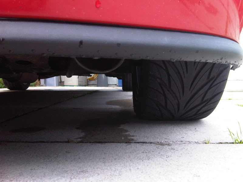

Upper cold air feed removed and replaced with a loosely fitting caf running from the floor.
The theory behind it is to bypass the need for a finely tuned inlet port (maxogen) and ensure the inlet pressure and air supply flow rate are high enough so as not to cause restriction.
The ram effect esque caf does this. The high speed air ensures there is plenty of cold air to be sucked through the filter, and its loose fitting to the airbox ensures that the length of the caf wont cause a restriction when driving at low speeds.
I've also put a samco induction elbow on partly for looks and partly due to its constant diameter.
So, all in all I'm verry happy with this setup and I wont be spending any more on induciton kits. (unless someone buys me a JMS RS2).

could you not reroute the air feed to the grill so you dont have the problem if you go through a big puddle?
  Saab 93 Aero Wagon
Any significant amount of water that gets through into the combustion chamber will end up breaking something.
Water doesn't get on well in there.
  Saab 93 Aero Wagon
Having a cold air feed pipe that low to the ground is asking for trouble when it comes to deep water regardless of the filter set up.

With regards to puddles, I very much doubt the water would make it all the way up the caf. Even if it did, and it managed to get into the airbox, it would have to overcome gravity and make it through a paper filter in an un-atomized state. Can't see it happening tbh.
  Nissan 370Z
Can you not move it so it fits behind the grill?
aucky
But it has happened. Search on www.306gti6.com
Can't comment on the setup they use, don't know the first thing about them. But im guessing the exposed caf is the only feed, making it more possible. remember there are 2 feeds on the std airbox, the modified caf is not sealed so any suction is negligable. Its more about the velocity of air from the car moving equalising the pressure accross the filter.
If any water does make it up there, there should be some sitting in the airbox because i drove through a monsoon on the way home form fcs. I'll check later!
  Saab 93 Aero Wagon
Od course it can happen! Why do you think proper off road vehicles run with snorkels?

In theory this works in the dry then, and I think i'll still do some tests to detect moisture because the caf in question doesnt have the direct suction of gti6 setup, it basically just points.

Just checked the airbox, no sign of water.
But iv removed the caf anyway because I'm now paranoid and didn't consider it when I first did it. Pointless exercise. Delete thread?
Nothing wrong with the theory of what you are doing mate! It is however a massive risk putting the intake there - trust me!
