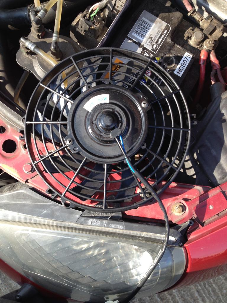

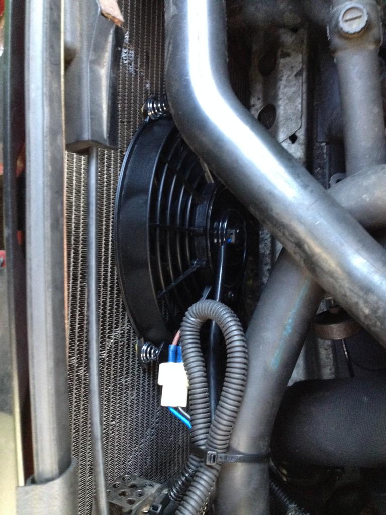

Yesterday I had this little thing turn up.
Fitted, looks bloody tiny. Picking up a proper plug for it today if I get chance.
It's only for the aircon, as the coolant temp has never ever got above half way.
Will get the aircon regassed tonight/tomorrow along with alignment again and then it's basically ready for Llandow/Wales!

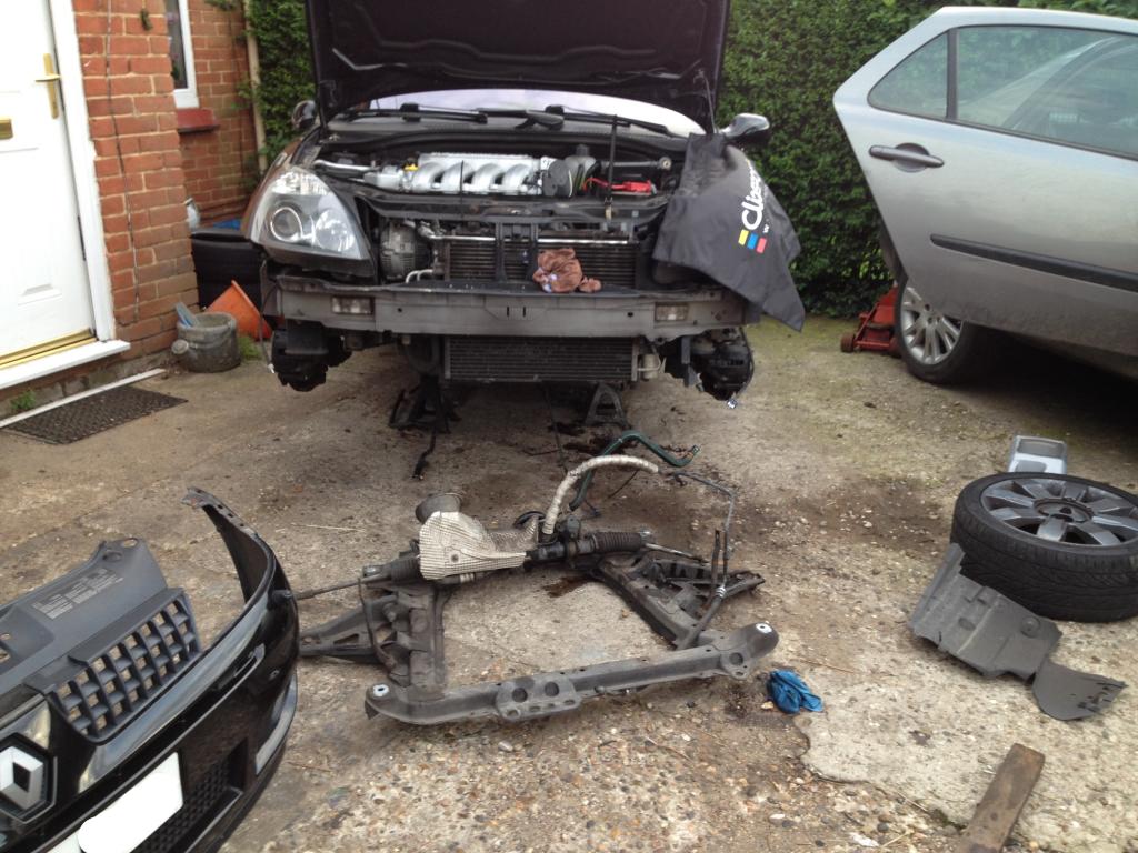

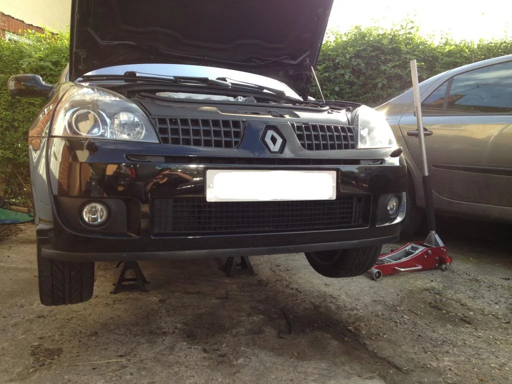

Got it up nice and high...
The lot of stuff I've gotta fit...

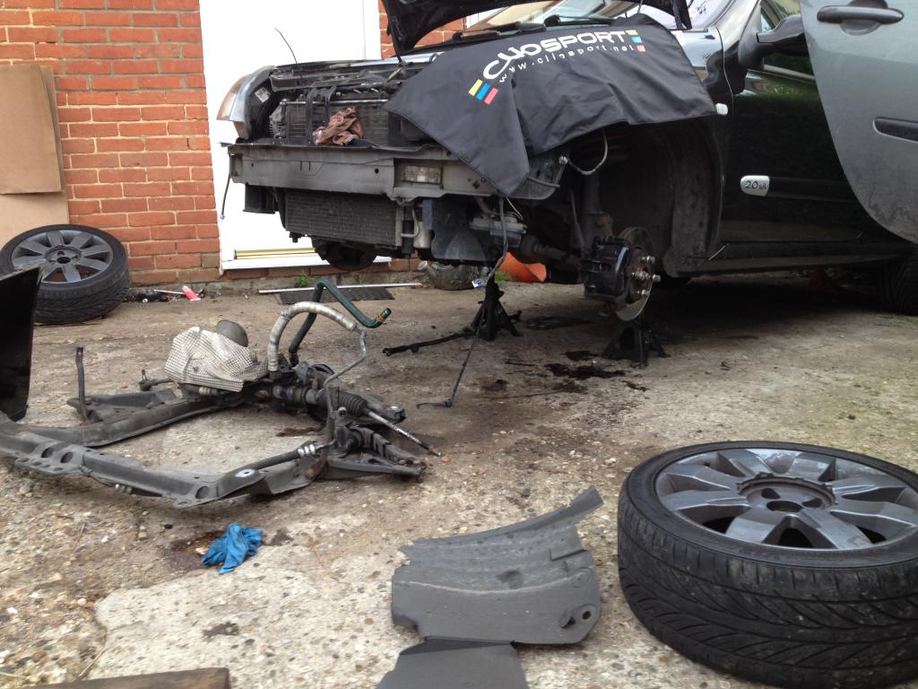

Then pictures stopped lol, Got everything required to get the subframe removed, off. Inc the four main bolts, which thanks to Guy's WD40'ing a little while ago, made them come out pefectly easy, Superb! Subframe out, with steering rack attached as its easier.

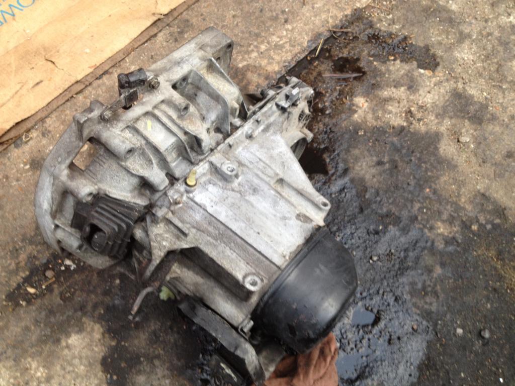

Cleaned up the replacement gearbox, as it was dirtier than the gearbox I'm taking out!

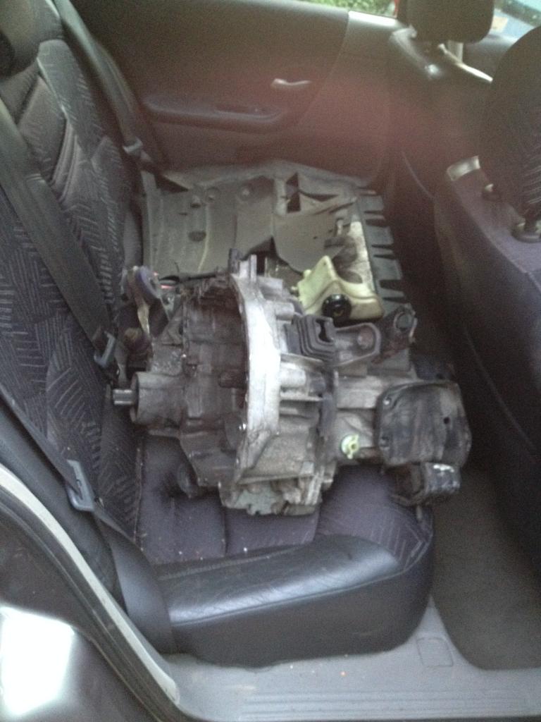

And heres why I love having a car I don't care about (the Laguna), You see back seats, I see gearbox storage..

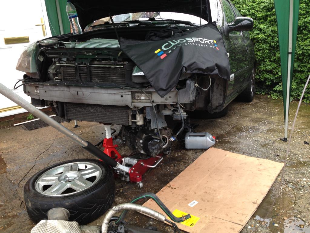

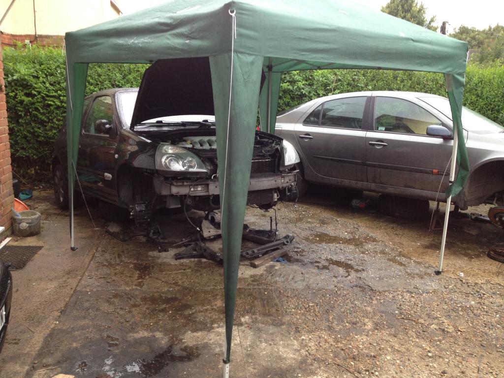

Tidied up last night, and got back to it this morning... Lovely weather, so gazebo time.
Again, no more pics until the biggy.

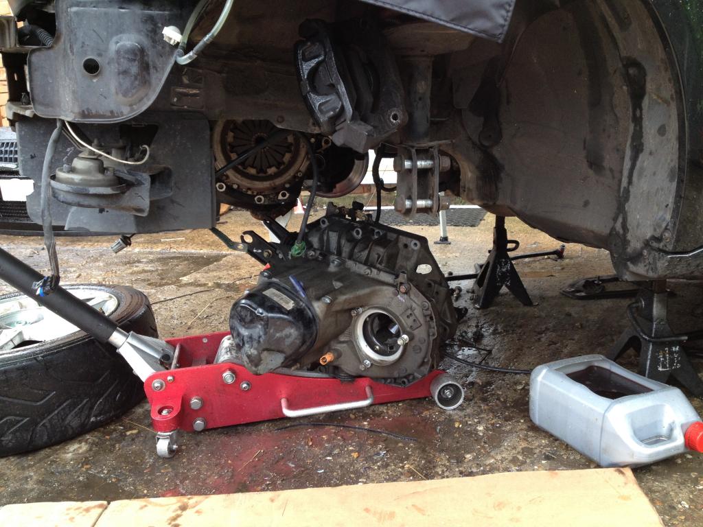

Starter popped off, gearbox oil drained, and all the bolts removed then gearbox carefully lowered (after I'd supported the engine, obviously)

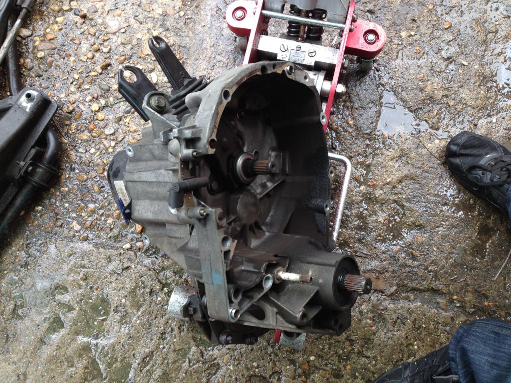

Clean gearbox, Shame it whines!
Clutch isn't that worn at all, no signs of heat either, always good.
As I've noticed a couple of oil leaks, I'm going to inspect the rear crank seal (behind flywheel), so thus replace flywheel bolts, and order a pair of inner ARB bushes as these have seen better days, and what a better time to do it. I'll also fit the new Track rod inners & outers (probably later today)

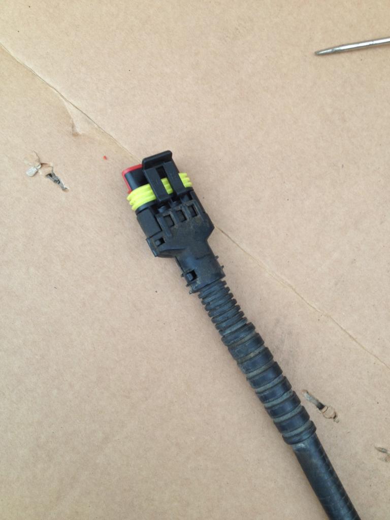

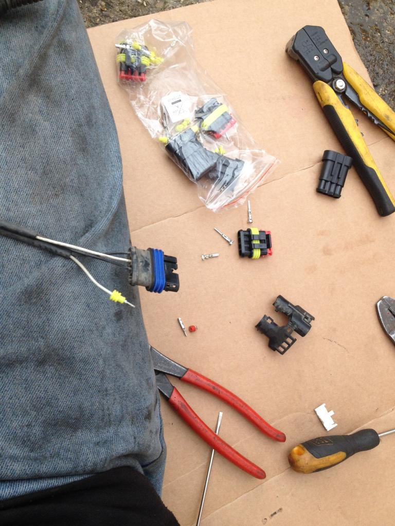

Fitting new plugs to my ABS loom (that runs from front to rear), finished item, did the same on the other side of the plug obviously.
Finally sorted the ABS issue I've had that could be solved by wiggling the plug lol.

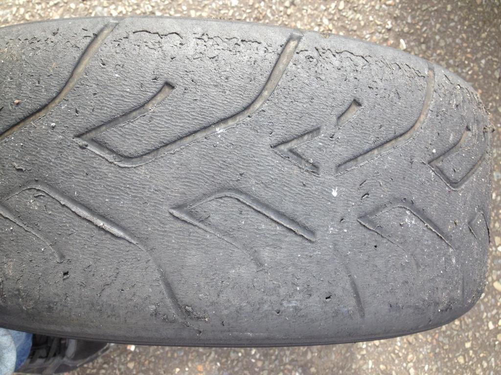

I bloody loved the whole day, Destroyed the front left tyre...

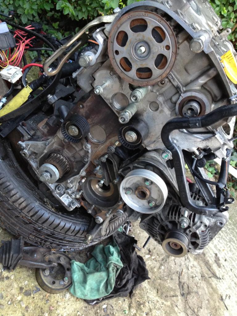

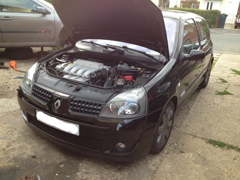

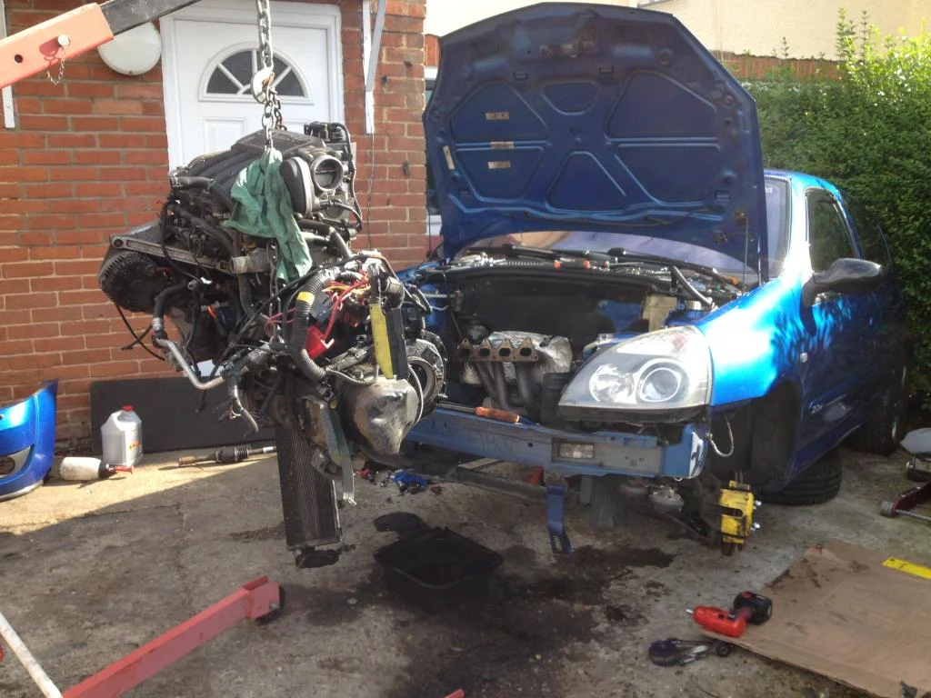

This week, I have scaryopa 's Clio 182.

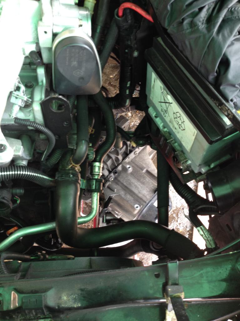

Gearbox is fucked, Dephaser is rattling and I've already found a couple of other small issues, so its having cambelt kit, Dephaser, Clutch, Gearbox rebuild by Agency and whatever else I find!
I was pretty s**t at getting pictures, because I wanted to get it done and I had some help by a mate.

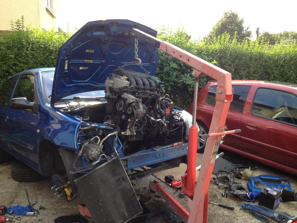

But... Engine ready to come out..
Thanks to trails for the borrow of his engine hoist after I got let down on my mates one.
Out.
Will make a start on stripping cambelt etc off tomorrow, and cleaning the engine bay.
Will get more pics as it goes back together, I want it done within a week, which would be easy if I could work on it all day everyday! and If I wasn't waiting for Agency to do the box.
More soon...

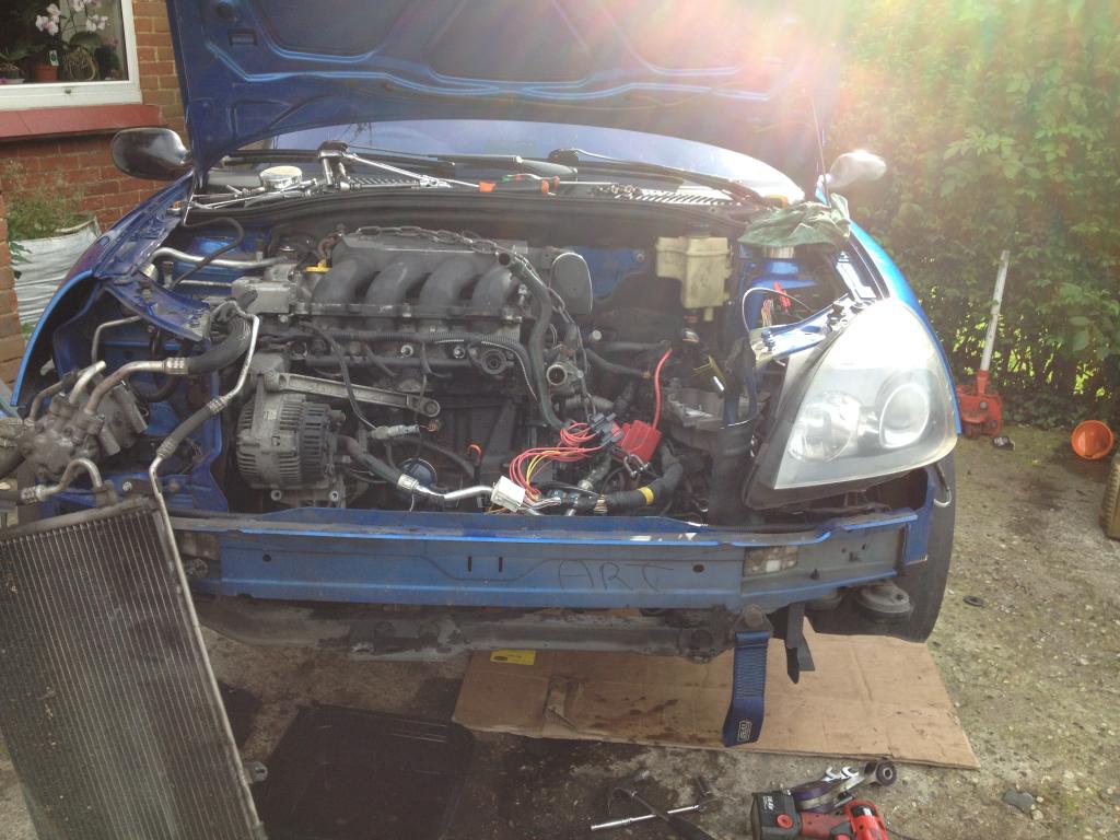

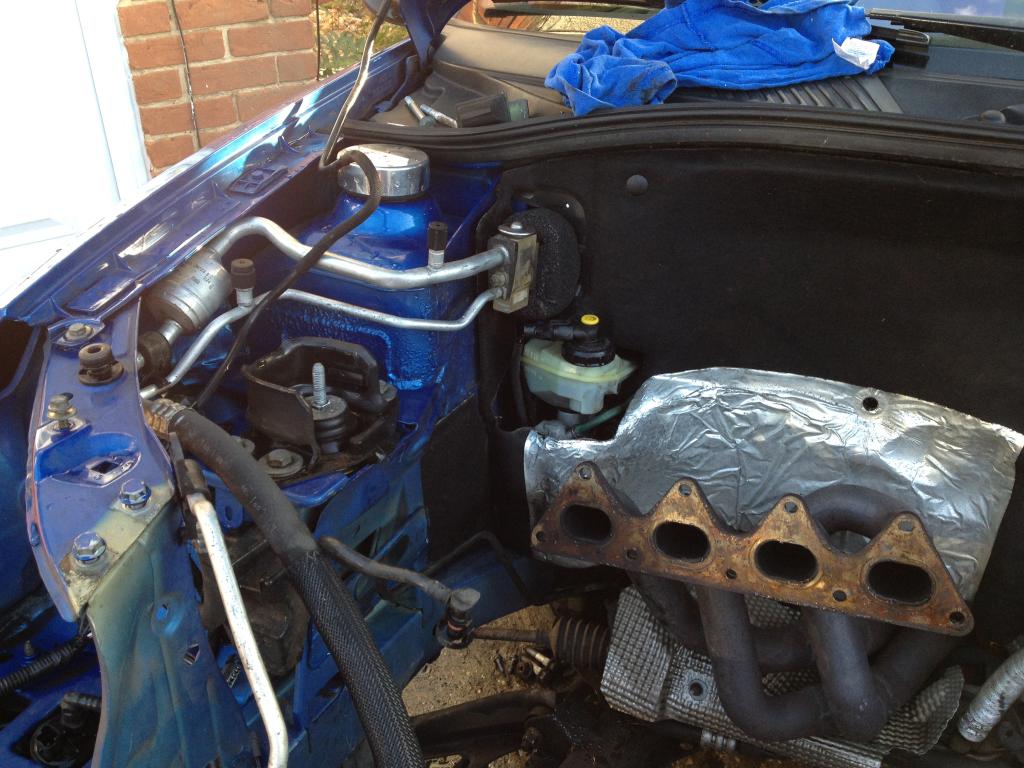

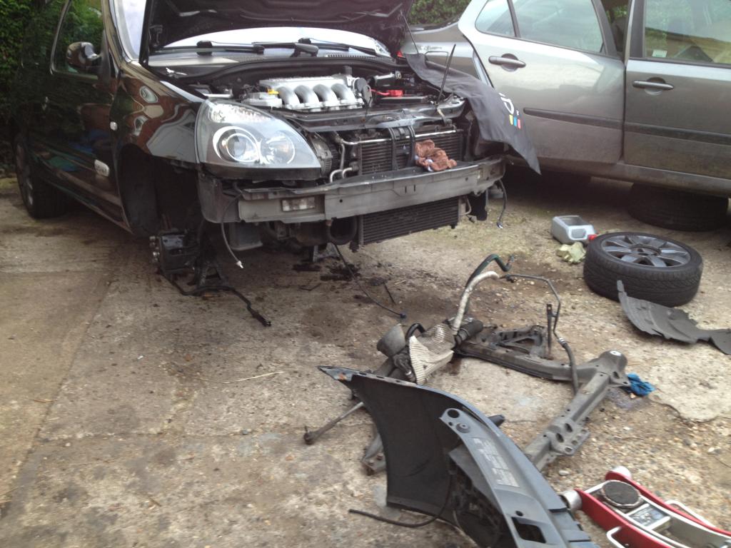

Gave the bay a clean
Got everything stripped off monday night, before the bits turned up Tuesday.

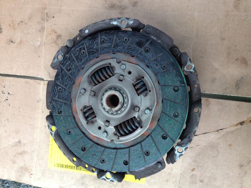

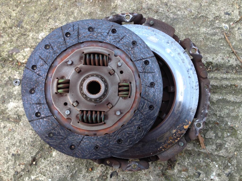

Clutch was quite worn..

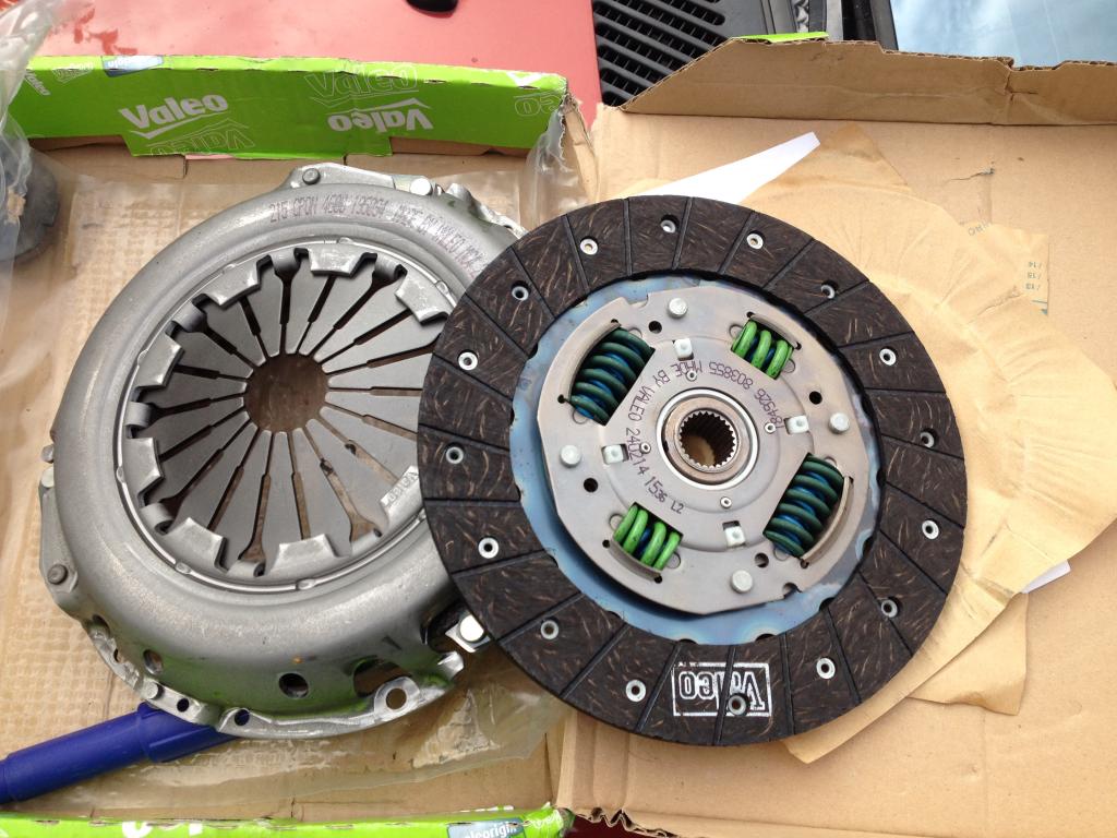

New clutch is much better

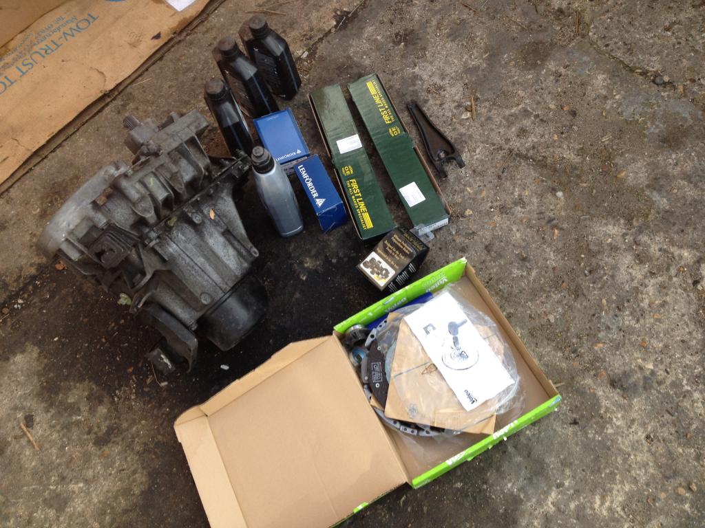

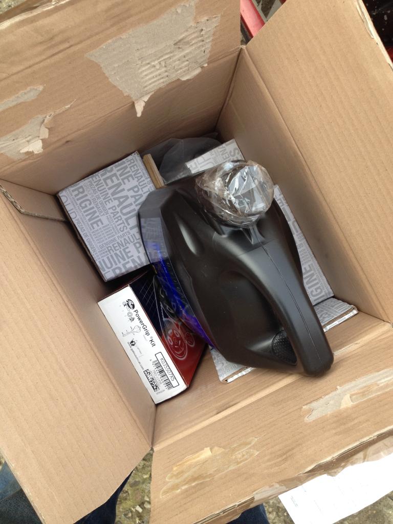

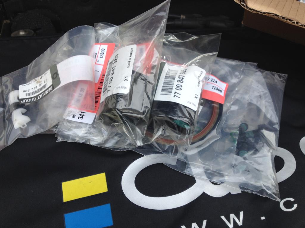

Got some nice new bits from Renault etc
And then thanks to Agency, a nice shiney gearbox to go back on.

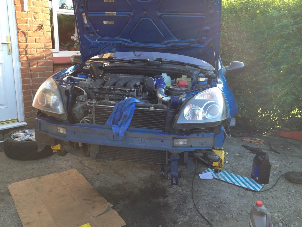

That was Wednesday, midday ish when I got back with the box, then this pic is about 5pm, I had been too busy to get pics.
Hour later
Box is perfectly spot on now, Martin at Agency is nicer than I expected, and the dephaser, is obviously, quiet like it should be.

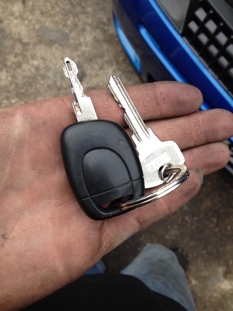

Only had one issue during the whole thing, I lost the key for my DCi, turns out it was wedged in the 182 between the subframe and the radiator, must have put it on the battery and then knocked it off. Lucky it stayed there!
Genuine relief was felt holding these keys.

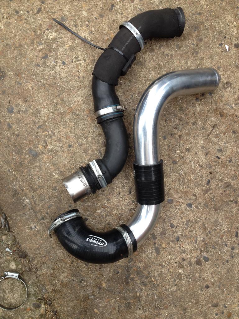

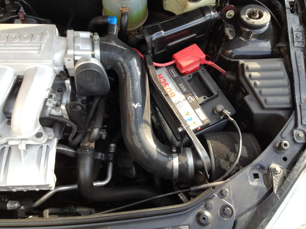

Then tonight had a look at my boost pipes, I've wanted to get rid of the standard pipe, and the dodgy adaptor for a while, so bought some pipes a while ago, figured it all out tonight, just waiting on a reducer, and I'll get that on, hopefully before Castle Combe next week.
Still got plenty to do though!
