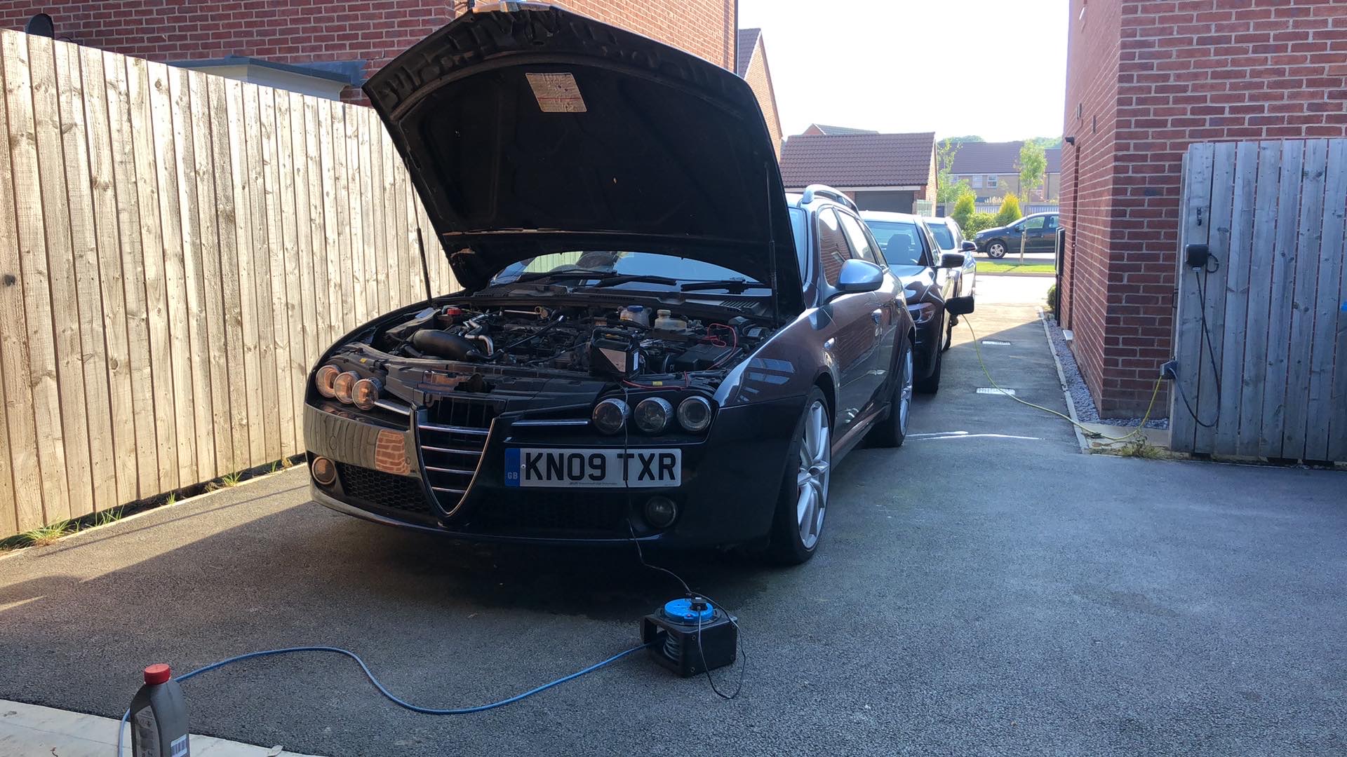

Day 15.
It’s being an Alfa again. Warning lights on for both my side lights, which were fine for the last 2 days...
I’m also getting a weird noise when first making boost, but only at around 1bar, at 1.6bar it’s not there.. Will check all the inlet pipe work I had off first. Worst case is a turbo...but they are only £200. Winner.
Other than that it looks so f**king awesome, I love it.

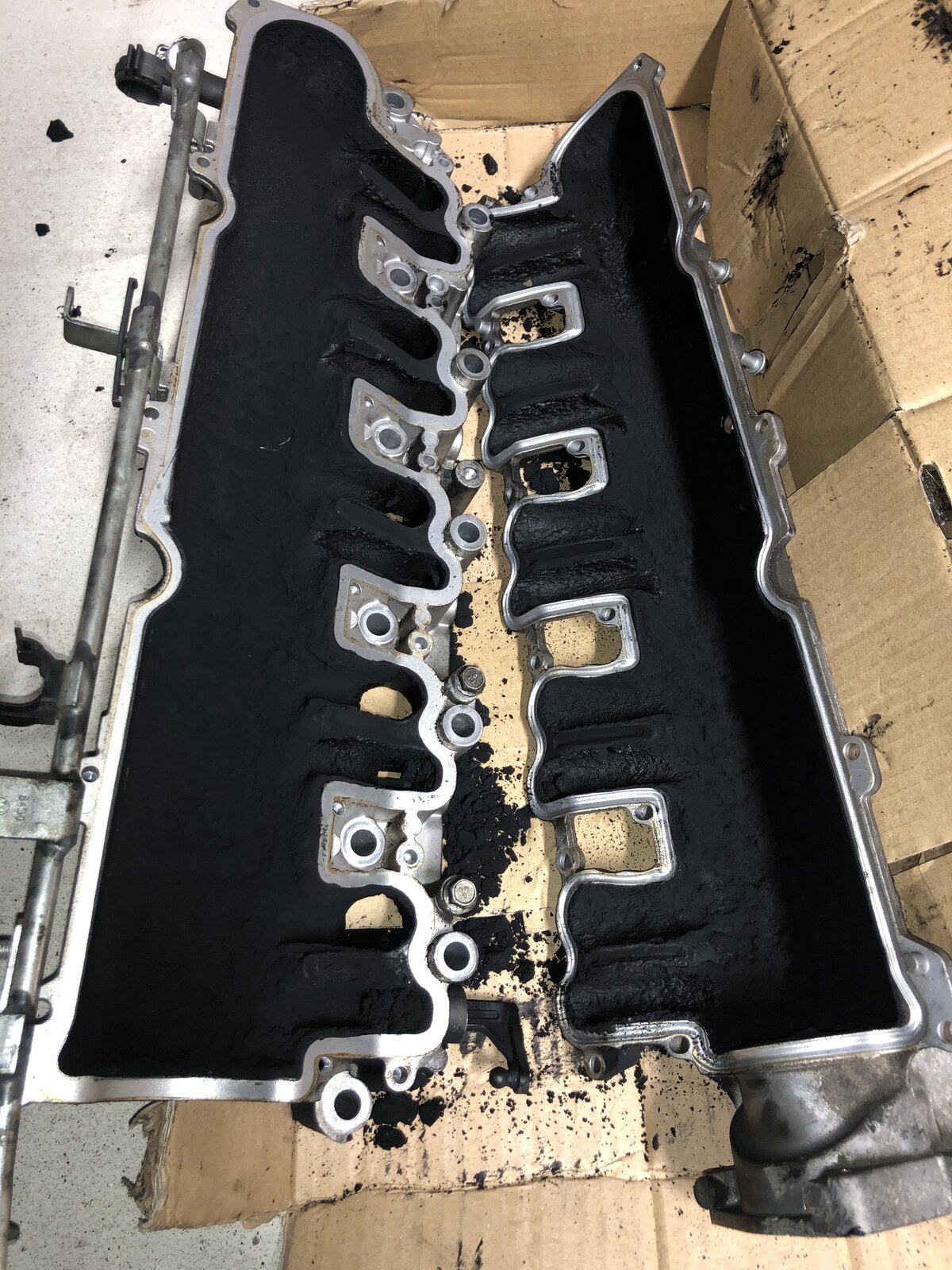

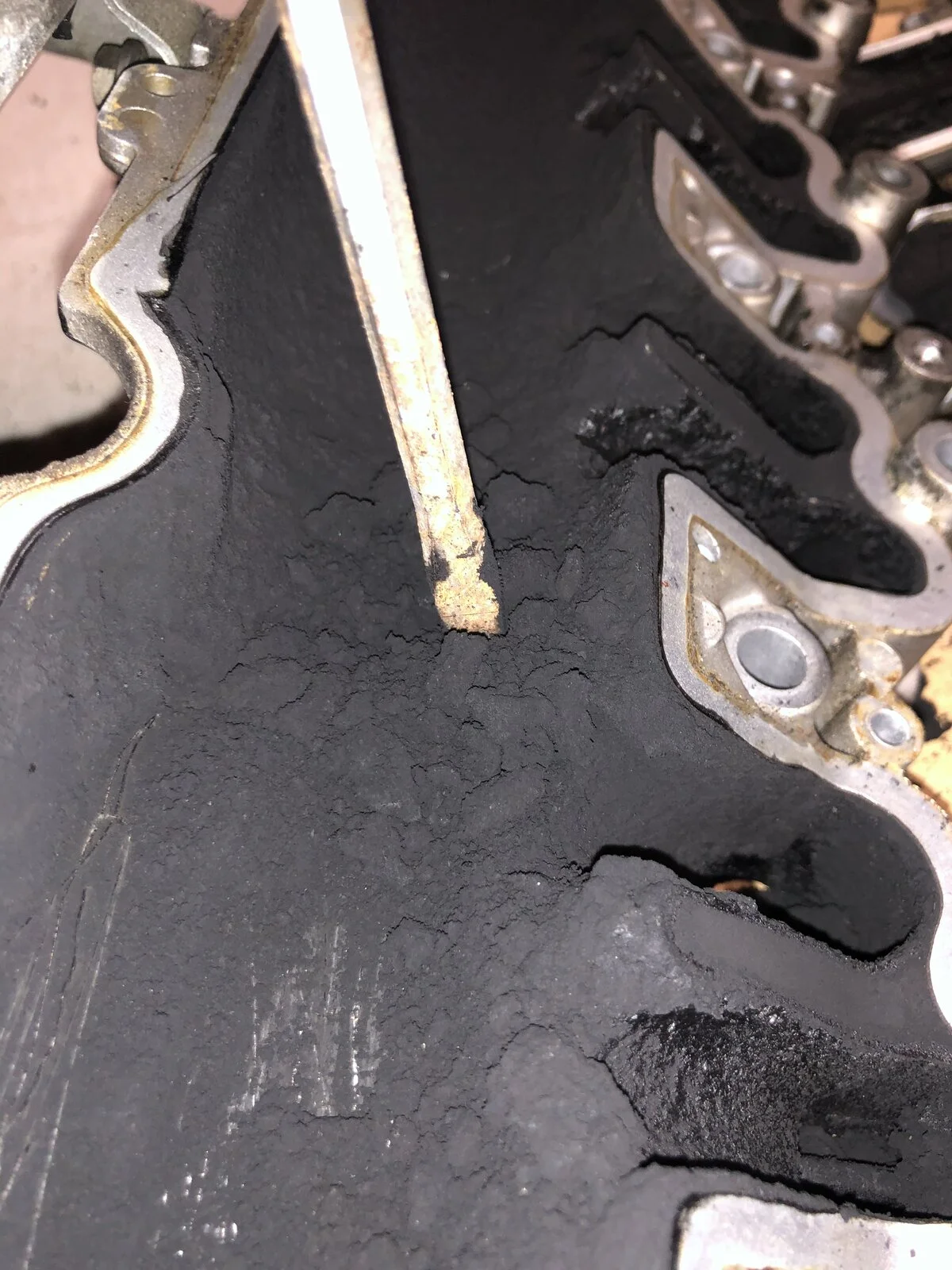

Bought a used inlet manifold. Split it open to see the state they get in!
Just look at it!!

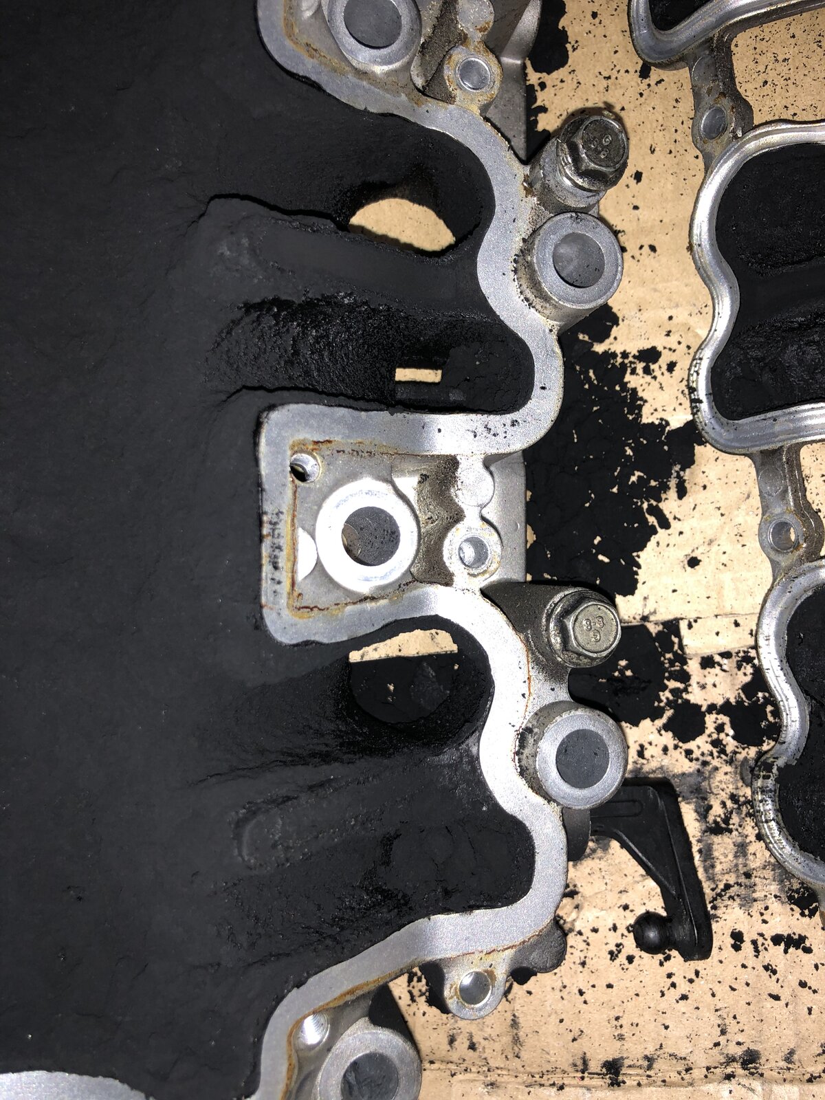

The total inlet should be 48mm, this one was down to 28mm at the narrowest.
Also the swirl flap ports which are needed for the cold start are totally blocked!
Can’t wait to get this one cleaned up and on mine!
If I can throw my two pence in, DONT do a swirl flap delete. Done plenty of them at work aswell as owning a few 1.9cdtis ( same s**t less 1 cylinder ) and they loose low down torque and abit of fuel economy.
Fit the EGR restrictor plate from fiat ( has 4 holes in it as a pose to a full open gasket ) will help keep the s**t down
  • Like
Reactions: Gus
It already has the 4 hole EGR plate.
It’s pissing boost out of the swirl spindles, so I don’t think I’ll notice the loss in torque.
Get it welded then , the bungs that you glue in ain’t really 100% reliable.
welded , face skimmed and new inlet gasket will have it sealed a treat.

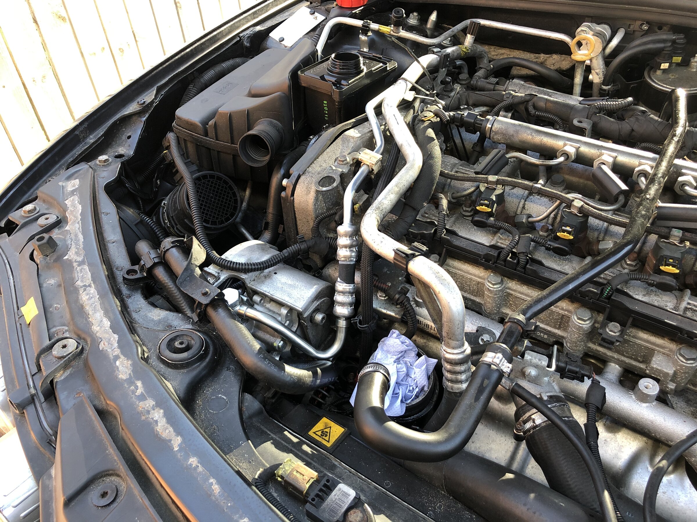

Day 25:
Checked PAS fluid, it’s not there.... f**k sake.

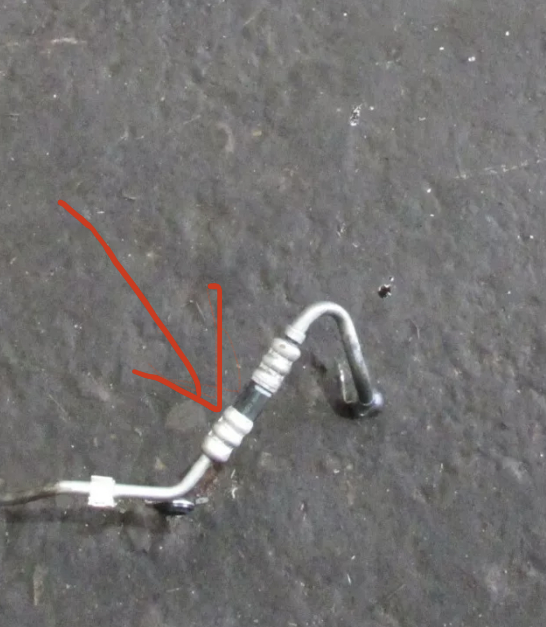

Of course it had two leaks..... so now I’ve found it...
This bit of hose between two hard lines, it’s only 2” ffs!
Since the arrival of the Aplina this hasn't been used much.
Just ordered a new PAS line, so I can finally fix it and get it sold.

Leaking PAS line taken off it, what a fucker that was, now have to wait for lock down to end so I can take the line to be fixed!
Day 100ish
Not moved for 9 weeks. Been on axle stands all that time. Waiting for a genuine pas line to turn up.
Fitted it. Which was an utter c**t of a job. The battery is totally dead, so I can’t do much with it sadly...... fucker
