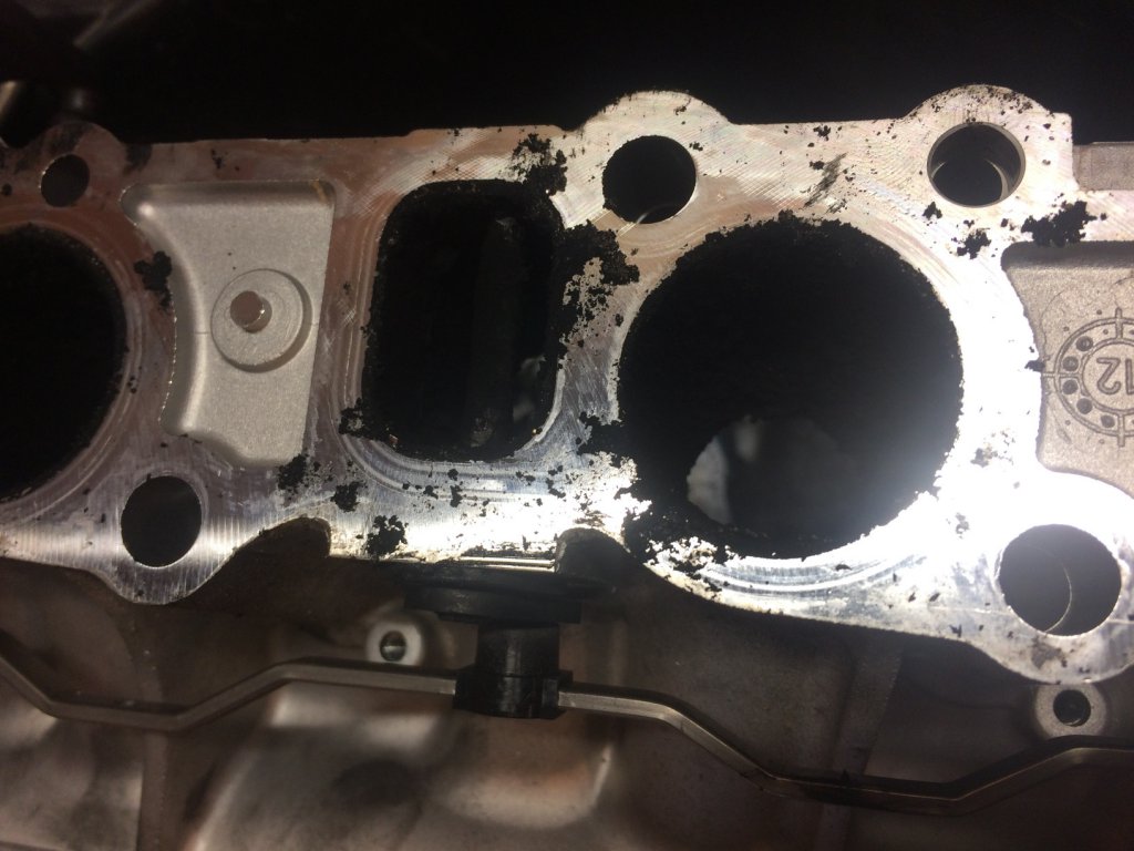

Popped the bar off the actuator and manually held them open.
This is a photo of a carbon'd up one with the swirl valve open!
So as you can see, even with it open they are basically blocked. No point getting it off to clean with the EGR still active either.

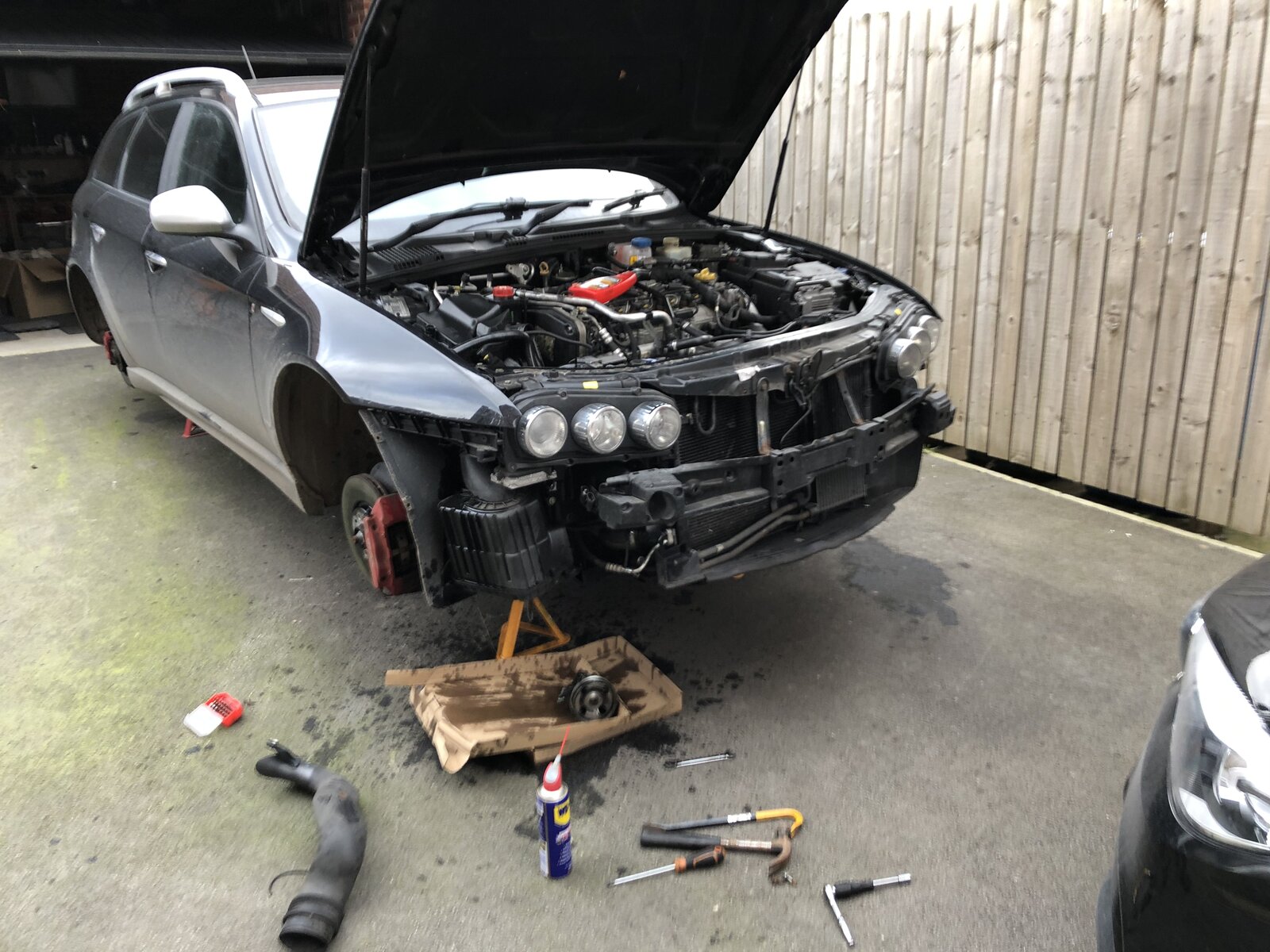

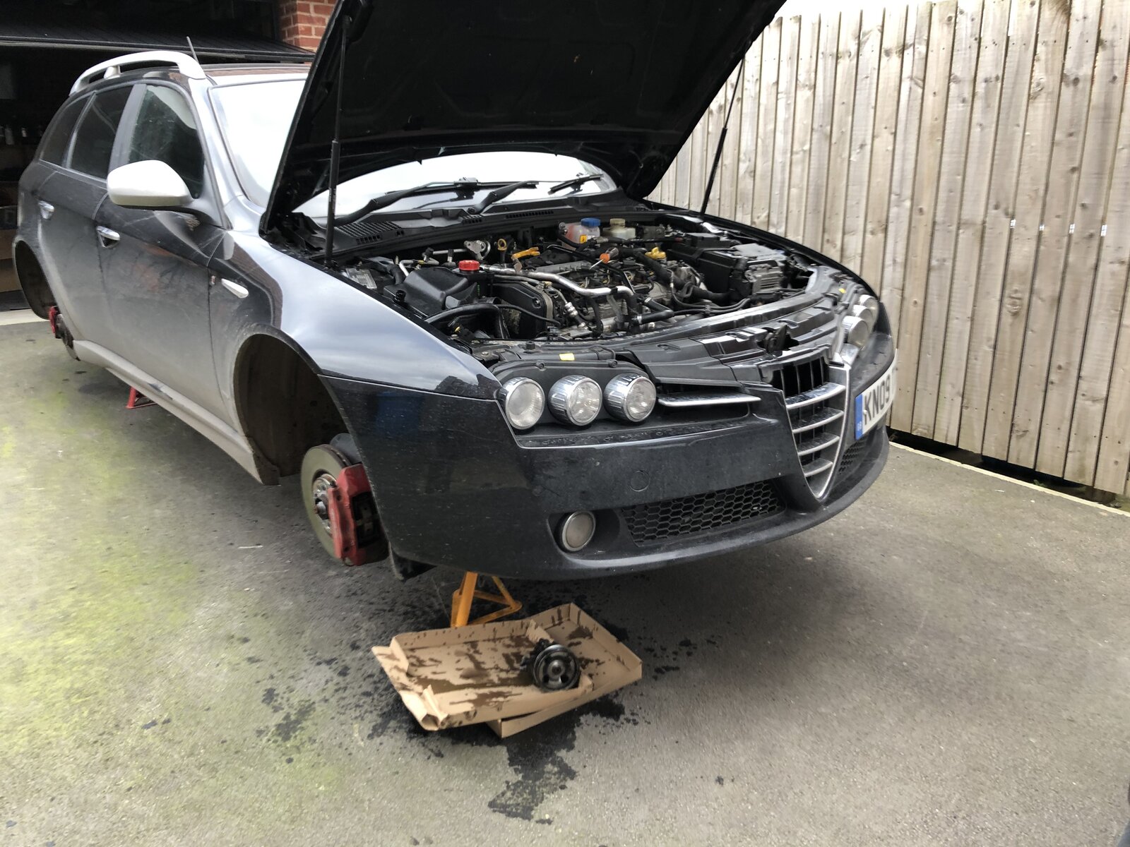

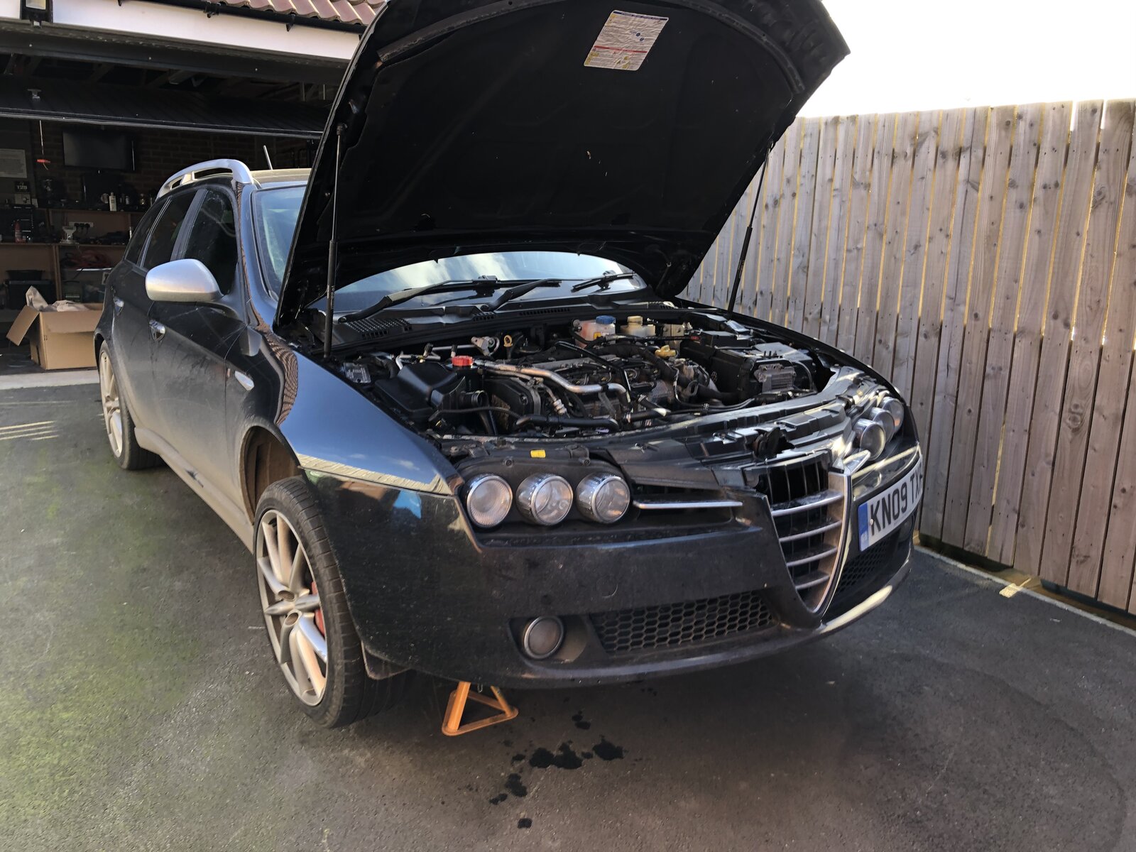

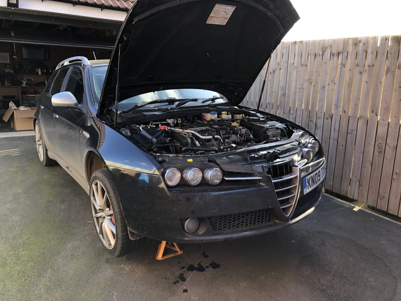

So.... plan for next week as it won't be used:
Saturday:
Onto axle stands
Wheels off ready for re furb
Clean brake disk bells up and paint
Aux belt off
Aux idler off
Power steering pump off
Stupid huge broken aircon pump line off
Cut those stupid crimp clips off everything
Sunday:
Get annoyed at all the fluids on my drive
Buy a s**t tonne of Jubilee clips to replace all the crimp clips I've cut off
Monday:
Drop wheels off for refurb
Spray everything in the engine bay with degreaser
Tuesday:
Fit new aircon line
Fit new spacers
Wednesday:
Fit new PAS pump
Fit Refurbed wheels
New Aux belt and Idler
Fit the s**t tonne of jubilee clips
Thursday:
Drive it again.... see what breaks next.
