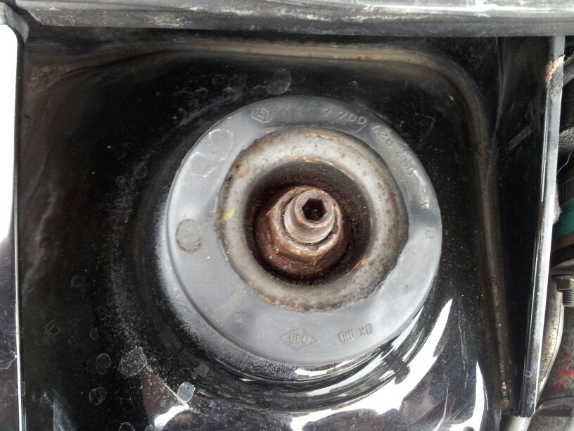

Tried to put my sportlines on today and the allen key snapped in the strut top :(
Any ideas on how to get it out or get the strut off?

Yeah I almost did the same, popped up to my local garage and asked them nicely to buzz it off for me :)
Clean sheared off and it's recessed into the hole about 2/3mm.
Tried to drill it out but it's too hard for the drill bit to cut into it.
I'd imagine its turned a little when trying to loosen the nut and now its wedged tight? Very small chisel and gently tap it back round to release it. Failing that, £51 for a new damper. Or if youre lucky, the impact gun will remove and refit the nut with no issues.
DOes it look like its rounded in?
Yeah basically
tack weld something to it or just get a better drill bit ;)
Better drill bit probably haha
Top with snapped key in

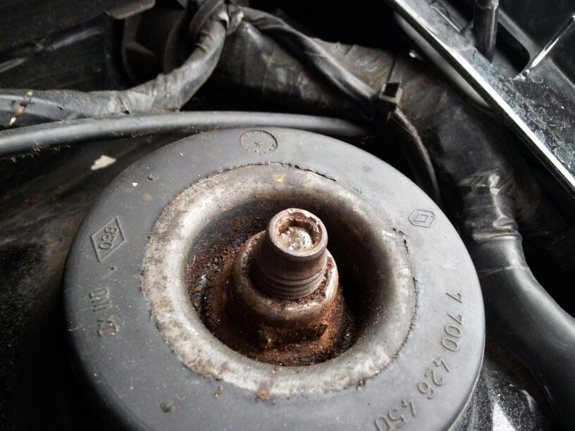

Other strut top without anything in it
Si I thought I was going to help you to do these? Wouldnt of had such problems if you'd brought it here ;)
