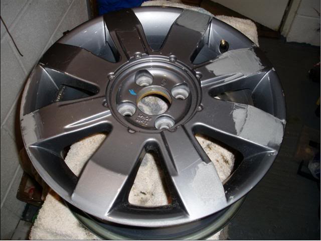

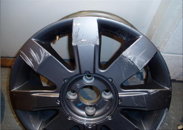

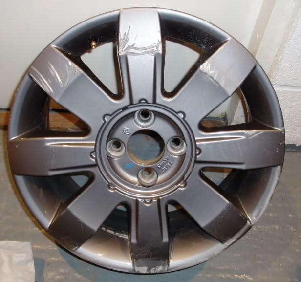

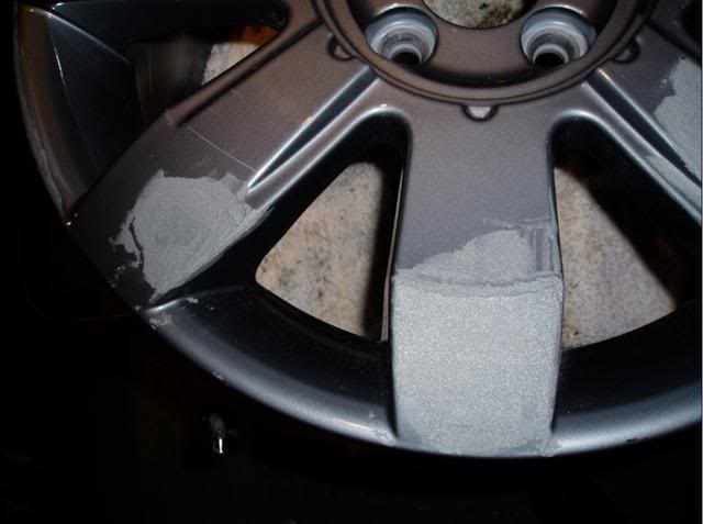

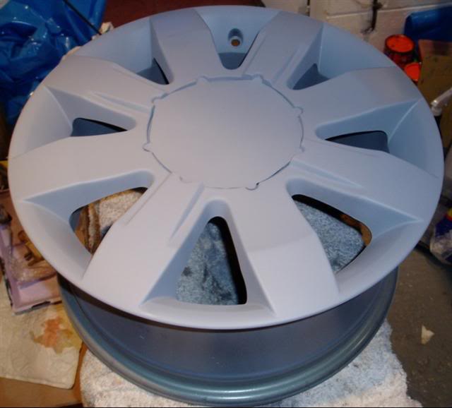

It's quite a few years ago I refurbed this wheel I bought off ebay as a spare. It was quite badly scratched , nothing too deep but needed filling. So i used Isopon metalik filler.
As others have said , prep is very important . Keeping the the wheel dust/grease free. Also like @M90SR advised , keeping the floor area wet keeps the dust down and also the use of one of those aerosol can guns makes it easier to control .
