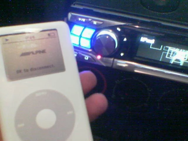

alpine 55r problem.
Iain C
Well my alpine the cost me a bucket load of cash dont work properly.!
I cant seem to pick up radio very often so i asume the ariel isnt working.
Ive checked the connections and it all looks ok.
Also the screen doesnt fold away! It kinda just hangs out and rattles.
Great.
On top of that its the most complex thing ive ever brought. Doing my nut in!
Anyone got any ideas?
