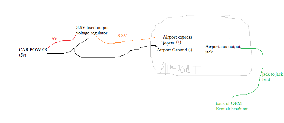

I dont want to replace the head unit becaue i promised myself that I wzsnt going to modify the car, as it is such great shape i plan on selling it for a reasonable price.
The airport express takes 12V from mains power, then there is a voltage regulating subsystem within the unit itself which converts this to 3.3V. By replacing the entire system with one 3.3V fixed output voltage regulator, i can connect it to a 5V cigarette lighter-USB conversion socket.
The total cost to me for doing it this way would be about £6 for the aux cable and 50p for the voltage regulator, i already own teh other components, so its also a s***load cheaper than a new head unit
Heres a diagram to explain it better

Bit confused - your diagram shows 5V from the car but your post says it takes 12V?
Best way to get 12V is by running your own wiring from the fuse box. I did this on my other car to wire in a dash cam. You could install a piggyback fuse to something that is ignition live - like the rear wiper.
I confused myself by writing it out, basically, i get 5V if i plug the airport into a USB port attached to the car (USB power), the 12V is what i am likely to get anywhere else
