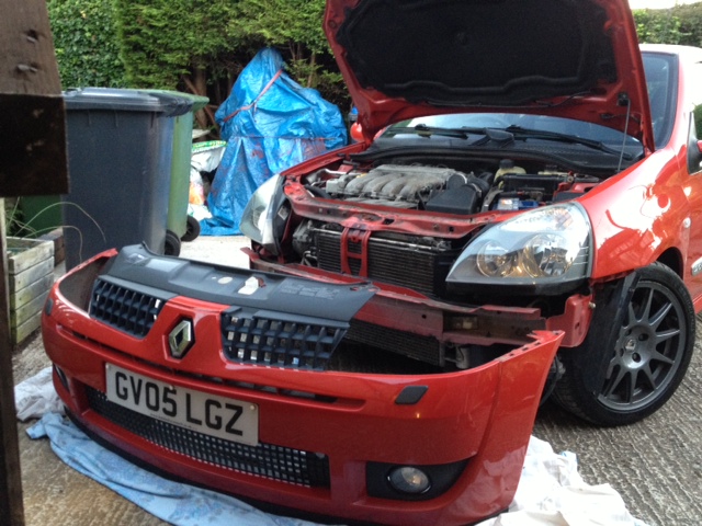

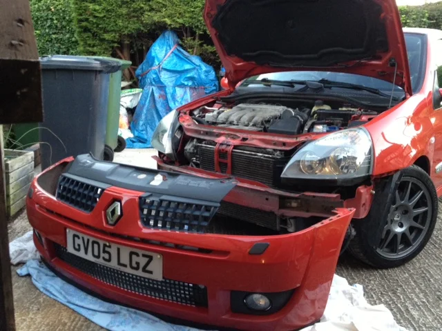

Thanks for your tips everyone. CHecjked connections, and no joy, so fairly sure it will be alternator.....Hmmm... Sounds involved!
Last night in the half an hour or so I had before it got dark, I got the bumper off, which is a start!
Done! What a b*****d of a job! Releasing the aux belt tension was a mission! Resorted to a pry bar in the end (pikey I know). But all fixed! Now to start tweaking and returning the suspension!
