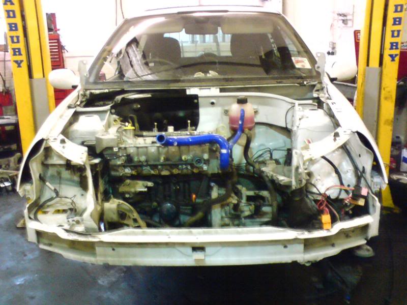

Can I get a pic of a few peoples alternators in their engine bay?
I think something is up with mine and Id like to know what I'm missing...lol.
Please!
thankyou....:cool:
best i can do
Ah I see, mine had no nut on it whatsoever....
Bloody thing, wondered why it squeaked.
Put a normal nut with a Nyloc nut ontop.
Do you guys think this will be sufficient?
should be fine. it's the tensioner adjuster, just make sure you undo ALL the alternator bolts before adjusting, else you WILL snap the adjuster. (i know i did it!)
