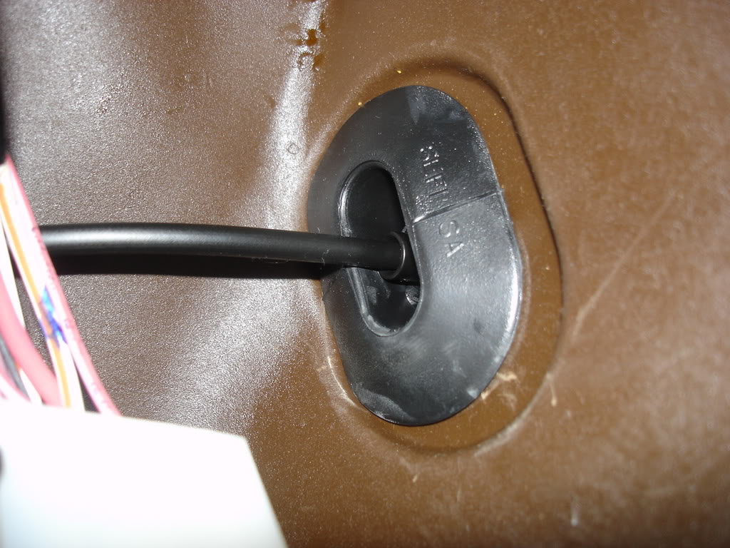

It goes through the grommet in the bulk head (where a big bunch of wires are)
Start at the engine end first & work to the back of the car. Once it's in th eboot then tidy up.

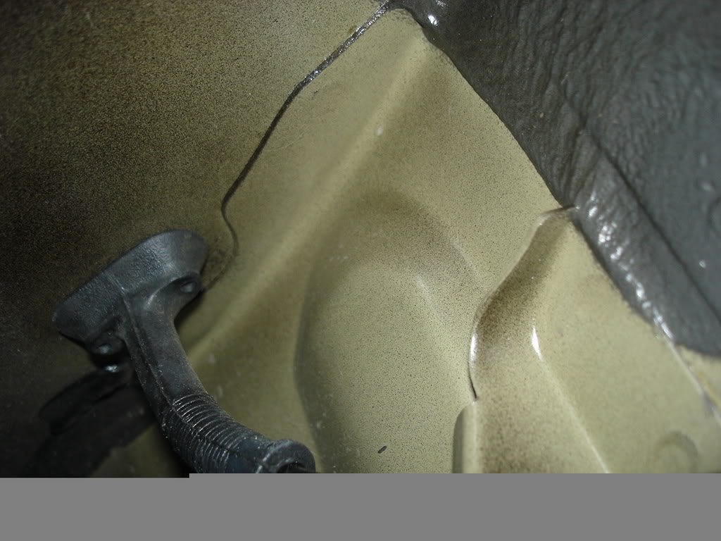

Where the bonnet release is on the passenger side, follow the cable, and it'll come to a gromit. Pop a little hole in that grommit, and it comes out in the engine compartment.

heres the gromit
engine bay:
footwell:
Its fooking tight so your best bet is to tape it too a screw driver and push it through with that. I tried the washing line method but that didnt work.

Get a short stanley screwdriver and tape the wire to it with electrical tape, really tight and it will work. I thought it would be impossible because the bonnet cable was so tight but I got it through in the end.
Was a nightmare indeed, managed get 8 gauge through, but also got a 4 gauge going through now and didnt even attempt feeding through the grommet!

I got a wire coat hanger, pushed half of it through the grommet(making a enw hole) then taped the power cable to the end and pulled it through.
A little bit of vaseline goes a long way ;) to helping push it through :D
