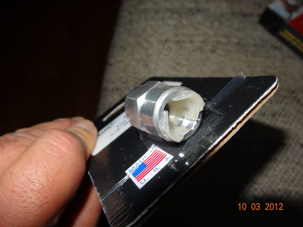

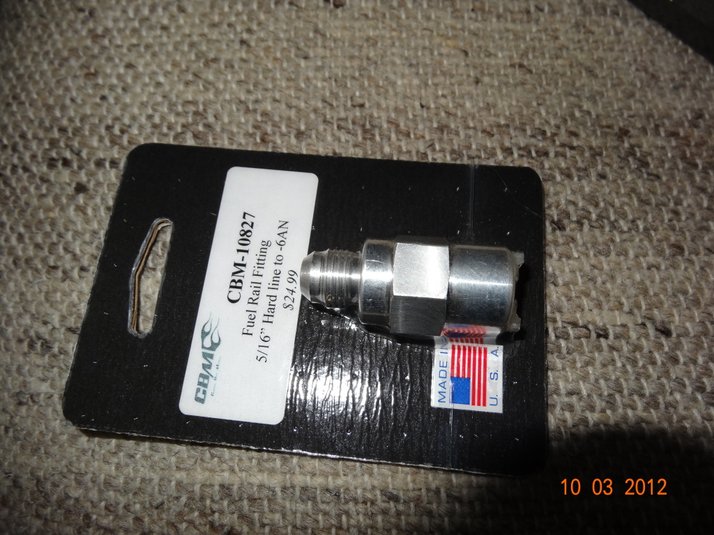

Got the main fitting today, this is to connect the AN fitting ot the fuel reel, It is for 5/16" inlet, may need a slighty modification:
