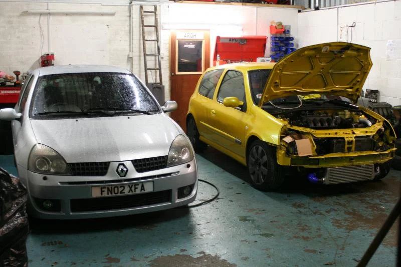

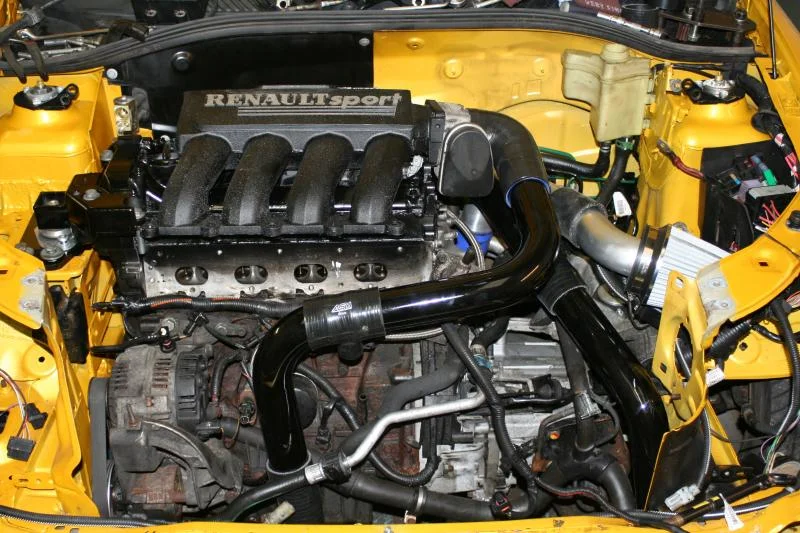

Few pictures at the minute all may i add are just mock ups and nothings fixed.
Engine Spec.
Wossner 9.0.1 Pistons
PEC Rods I Beams
Garret Gt28 Disco :)
Uprated Valves
Ported and polished Head
Helix Paddle Clutch
Clioturbo Custom Fuel rale and set up
Uprated 255lph Pump
Balanced fly wheel & Crank Shaft
ACL Bearings
Refresh of Oil Pump,
Clio 197 Cams advanced
Ported Inlets and polished throttle body

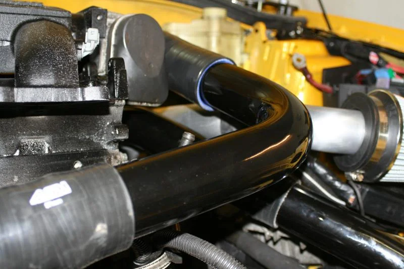

Intercooler kit and Pipe work painted in BG :)
ASH air filter and feed
AP front Breaks
Megane 225 Water bottle and fittings
Adaptronic ECU ( obviously ) :)
Megane 225 Injectors
3 Port boost Solenoid
We will be mapping at around 1.1 Bar and should see the golden number we want :)
Koni Adjustable dampers and springs
P Zero Nero Tyres.
Recaros from a Trophy
Poor Photos but just a little tease for you lot :) P>S awaiting black hoses for thse that are blue
