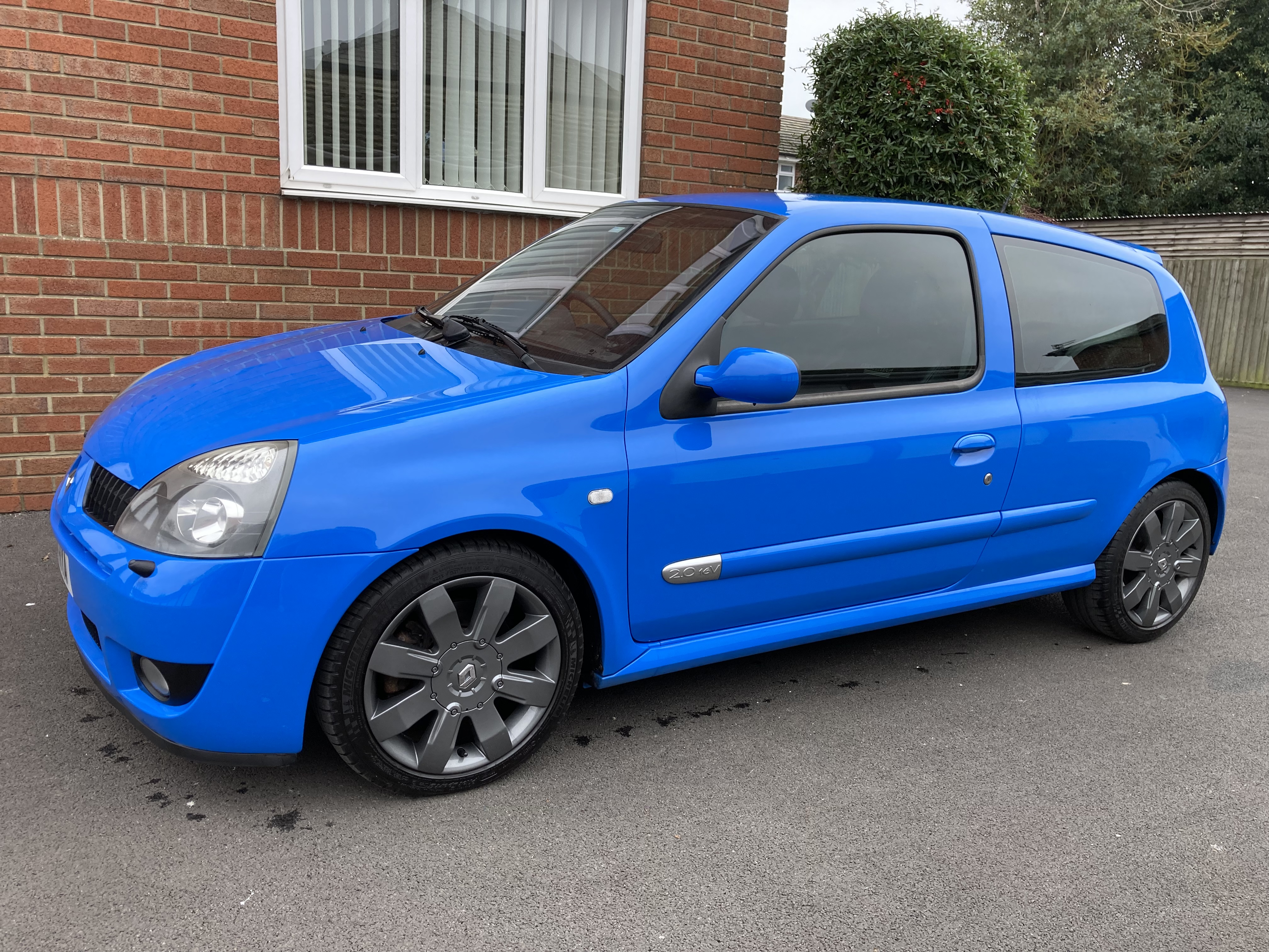

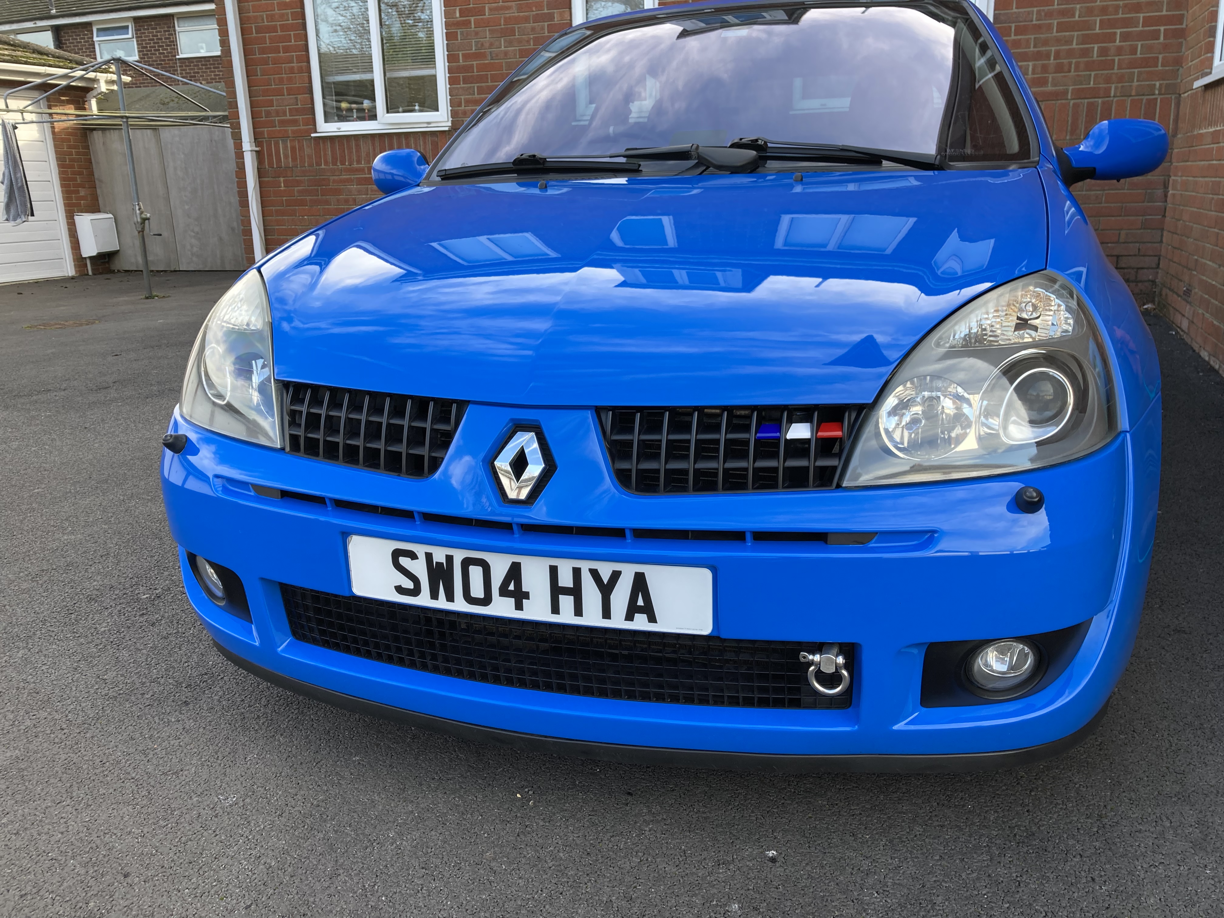

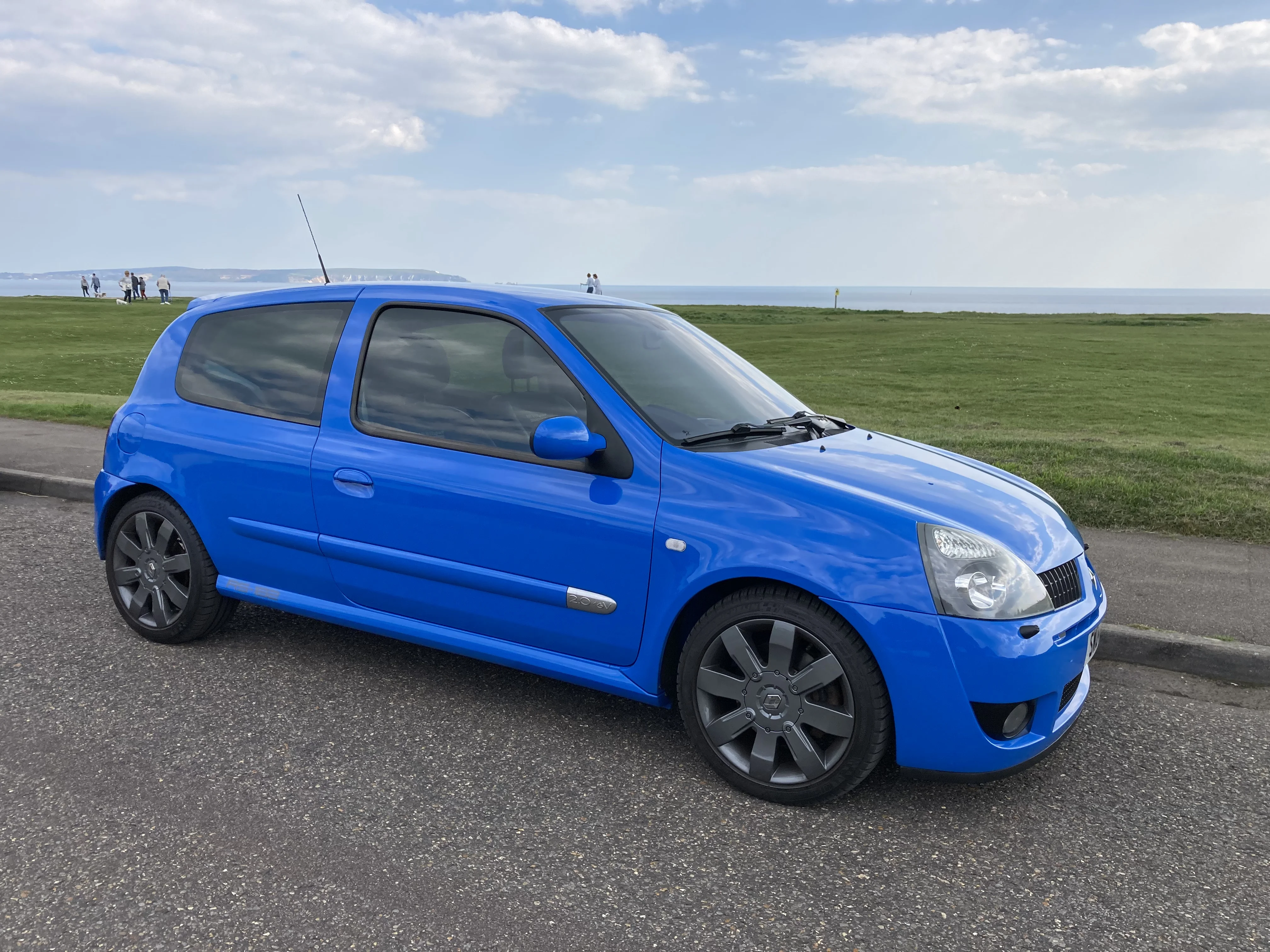

I took this picture when I first arrived, took her out for a test drive and the deal was done.
The deal also included some new Oem shocks, top mounts and exhaust mounts.

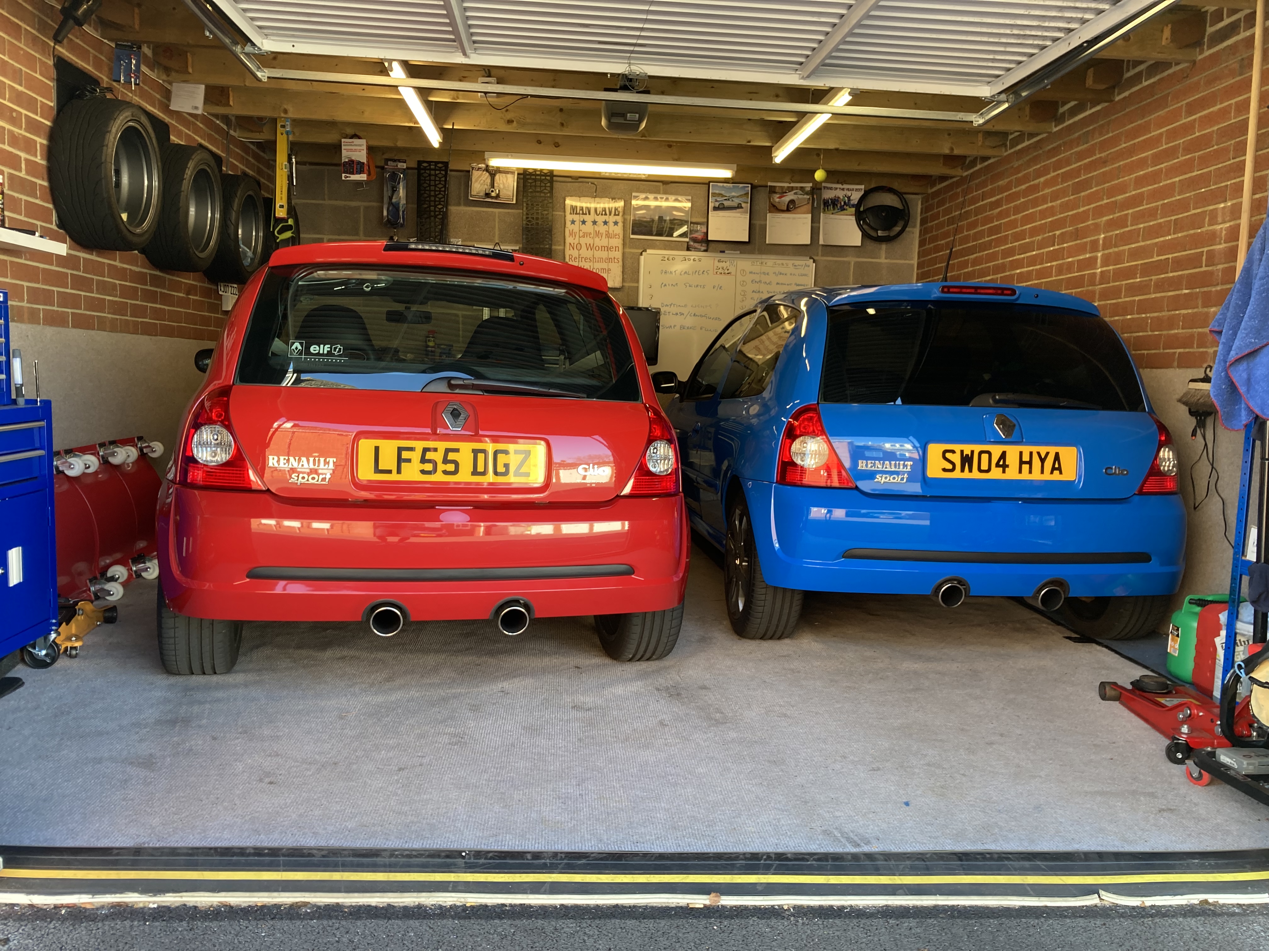

It’s now lunchtime on Saturday and I’m over 500 miles from home and I’m in an18 year old Clio! Splitting the ride home into 2 shifts seems the way forward so I booked myself into the Holiday Inn at Warrington (pattern forming here)! for a couple of beers and a well earned kip.
Got back to Bournemouth lunchtime today gave her a quick wash.
She is in fantastic condition but I have plans to future proof the underside, the suspension components, enjoy her as a all year evening/weekend car and save the Trophy for just the Summer months.

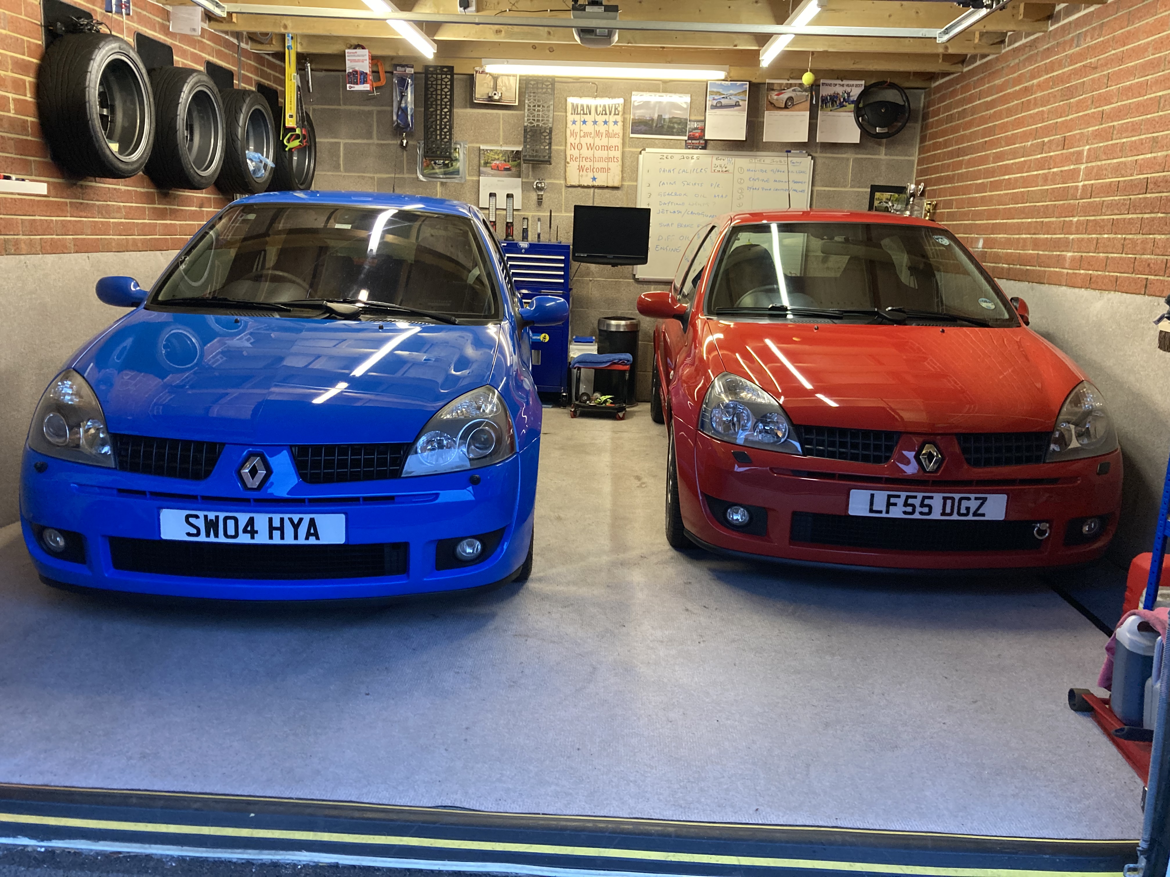

Mr Underhill
Love it. I've been called crazy for owning 3 Clio Sports so it's nice to see there are other lunatics in the asylum 🤪
And you're right, better to stick with what you know. Looking forward to the updates.

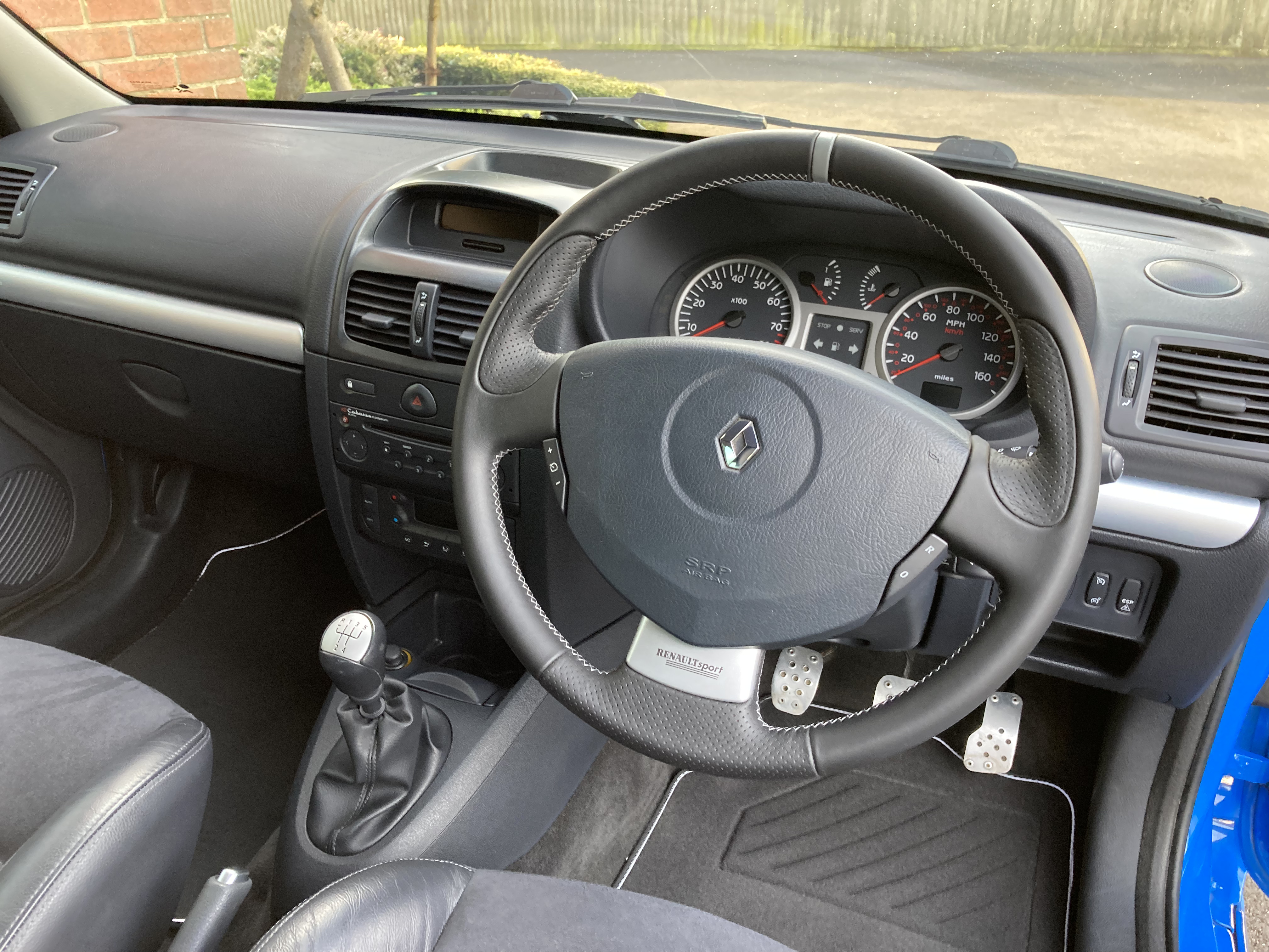

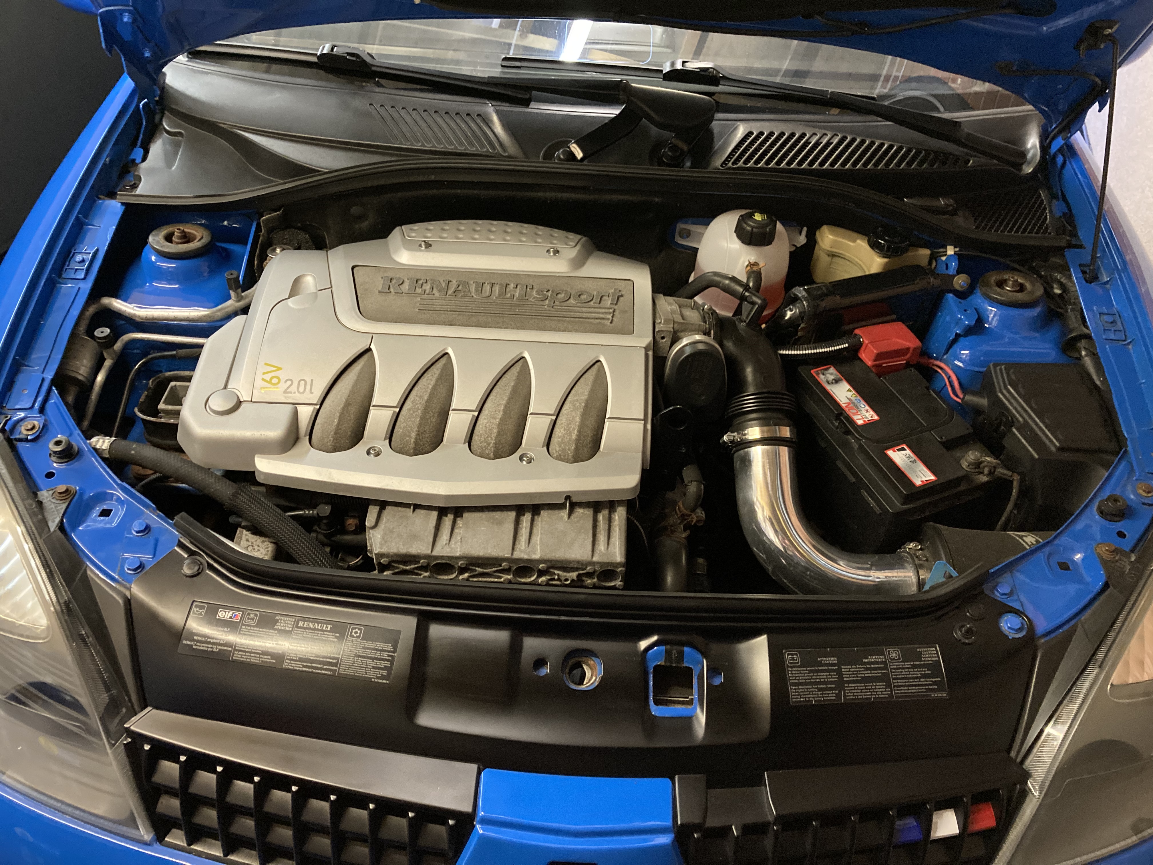

I managed to find some time today while the wife was at work and as I said before I’m not going to go mad with this car as I want to use her all year and not make another garage queen.
The interior is really good especially the sticky dash which is almost perfect.
The only thing that let the side down was the steering wheel which was like a crocodiles back!

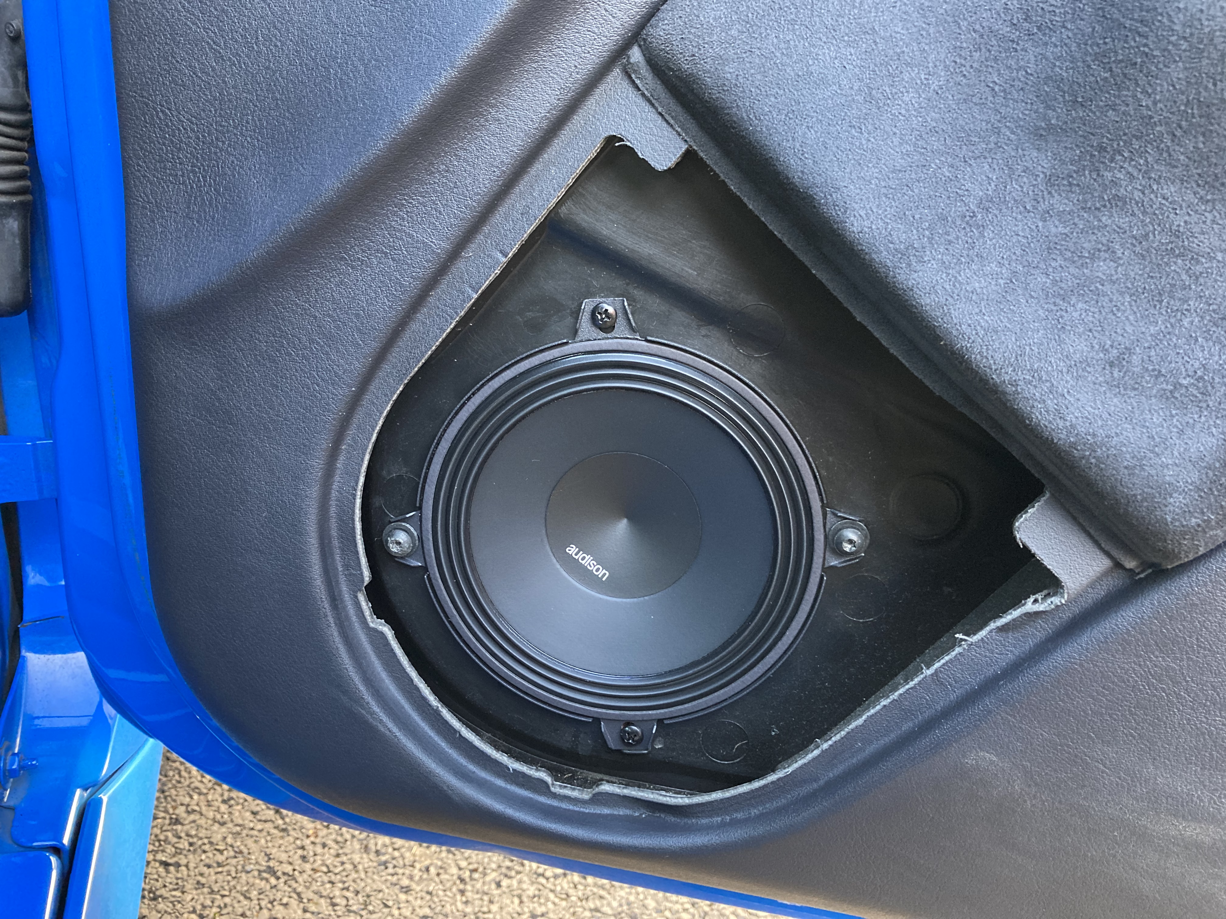

A good detail, a set of new RS mats, 4 new Audison speakers, a Snappy wheel and I’m happy enough.

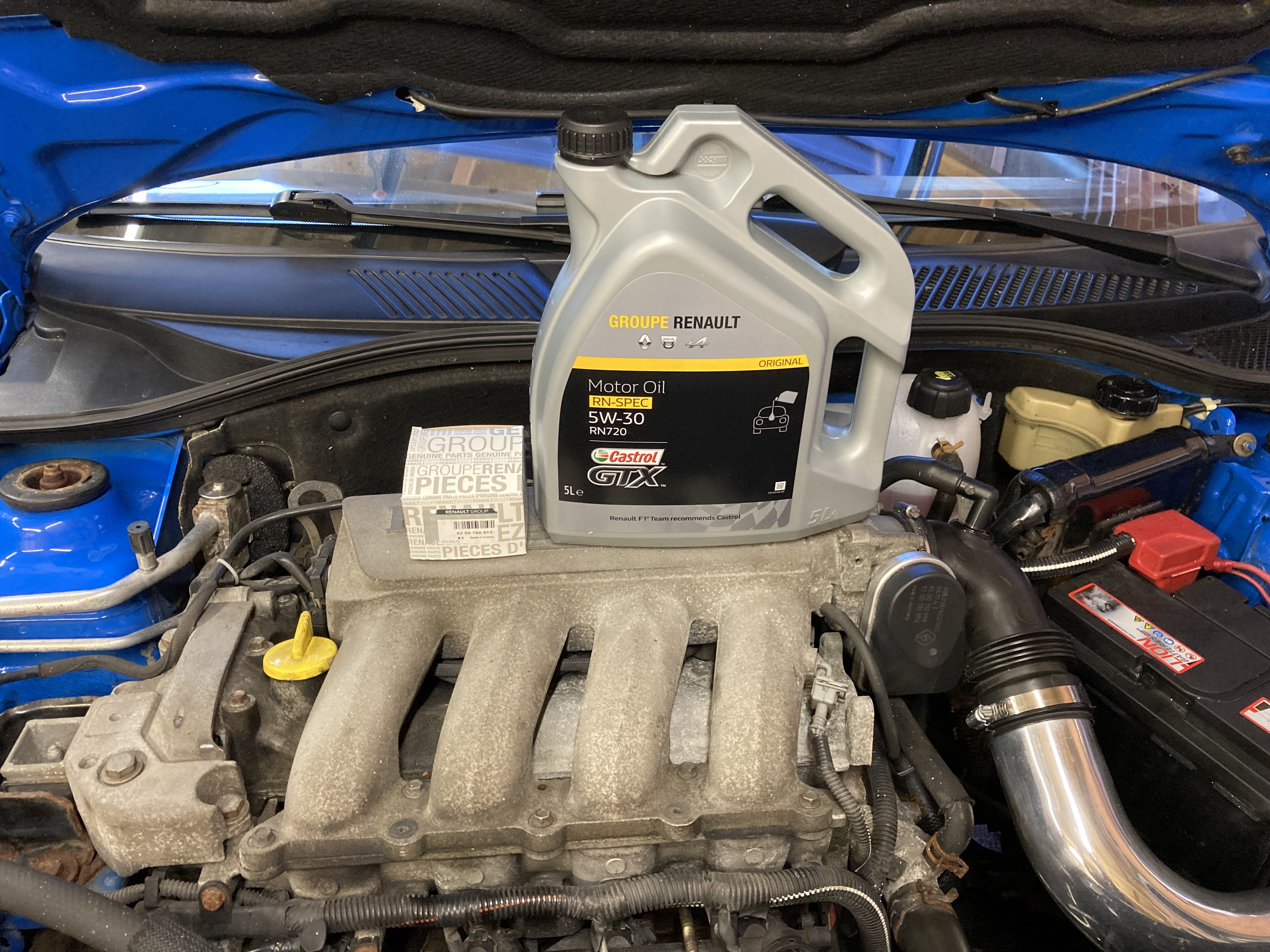

Dropped out the oil, filter, changed the expansion bottle, wiper blades and gave the bay a clean.
Not sure if I’m keeping the induction kit yet as might go back to stock but the noise is rather addictive!

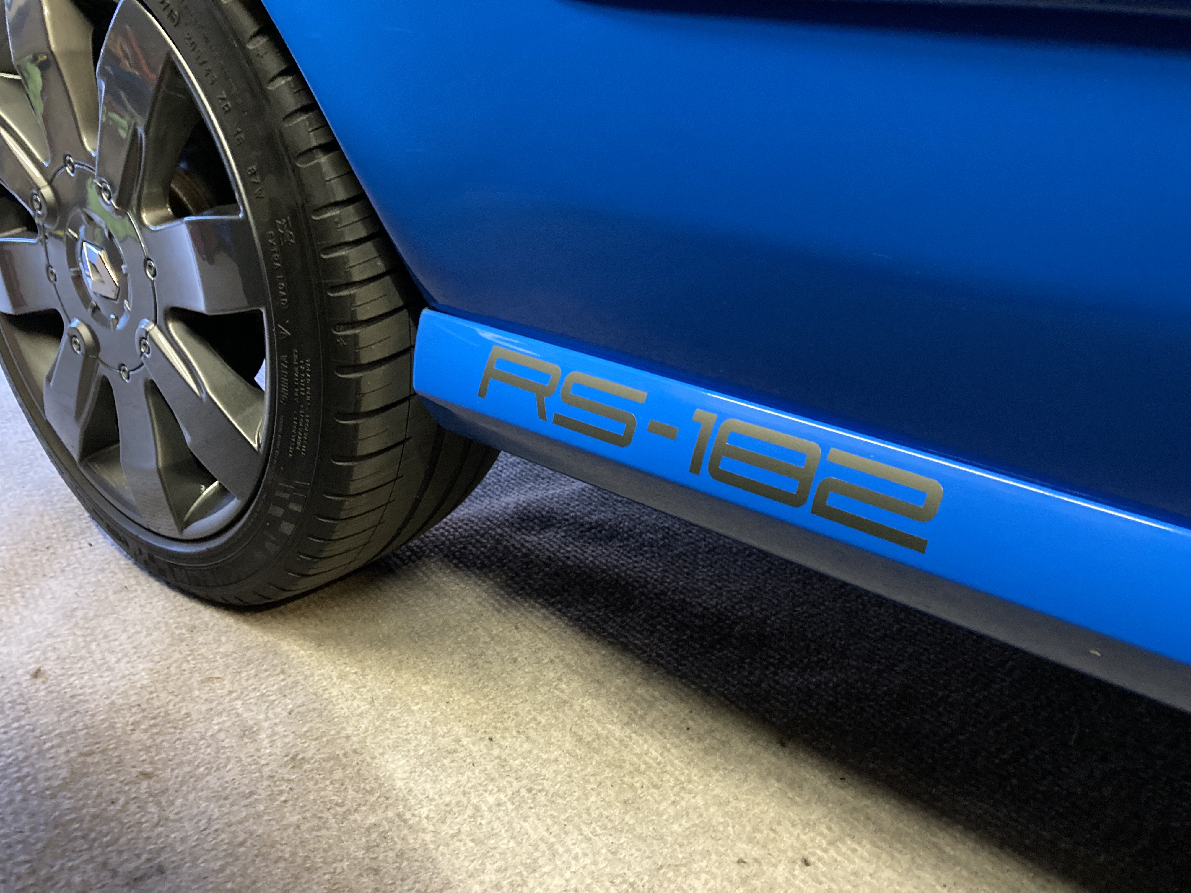

The previous owner had the front bumper painted so i fitted the missing black inserts. Also I added the RWB detail and a tow eye.
I liked the aftermarket cill decal I had on my 182 so put this one on.
Jobs in the pending tray are front dampers, top mounts, rear discs/pads, painting the calipers and replacing the exhaust brackets.
Thanks for reading. Andy

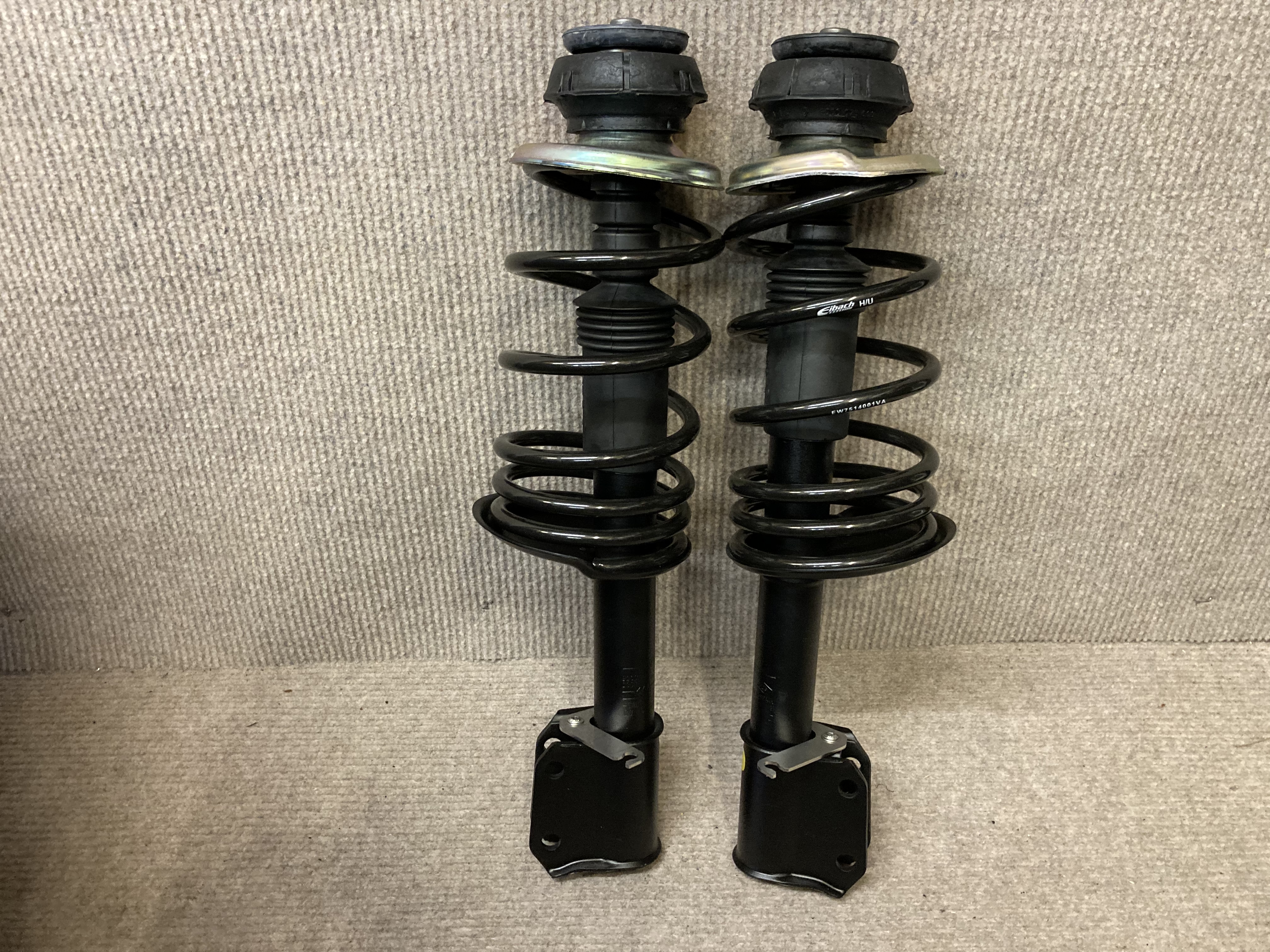

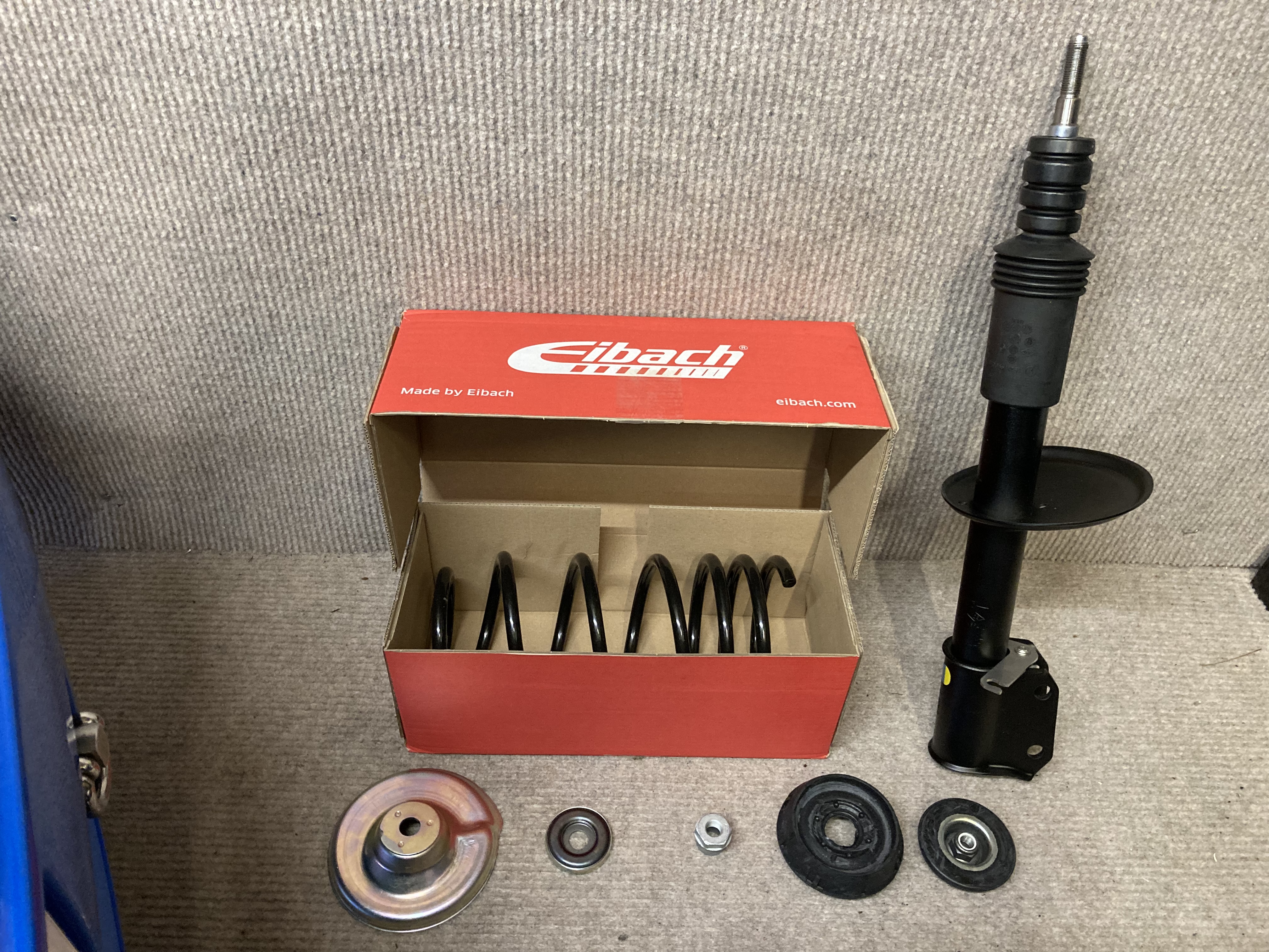

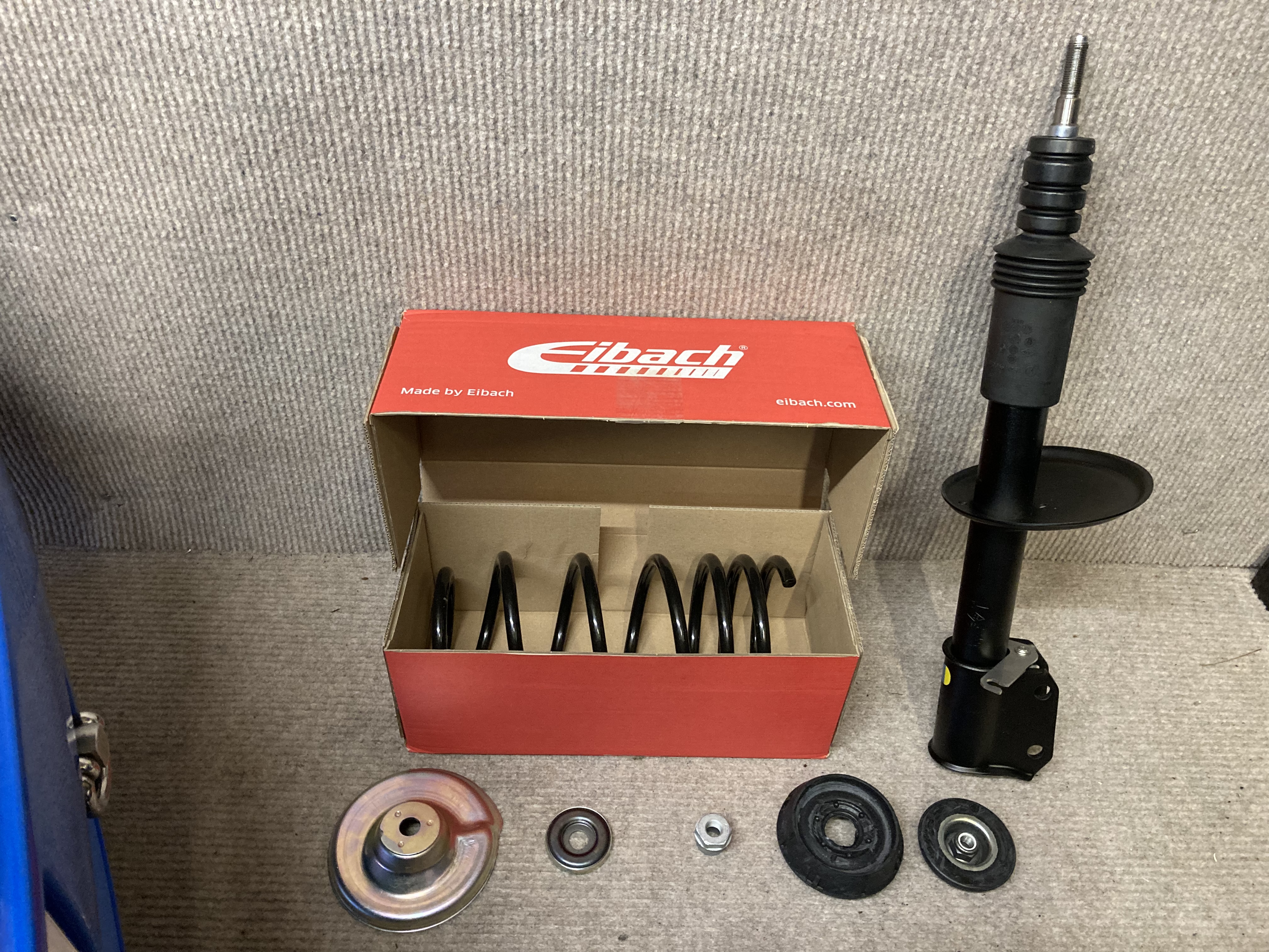

Rained off today and my new springs turned up today from Autodoc.
Assembled the new front shocks with all the other Oem parts including the arb bushes, brake lines etc.View attachment 1582590View attachment 1582591
Lots of wrestling under the front end to come.
I was suprised how nice and compliant the ride is with those Eibach's when fitted with new dampers. I've had Cooksport, Grams, Apex (worst springs ever made) and just couldn't get away with them.

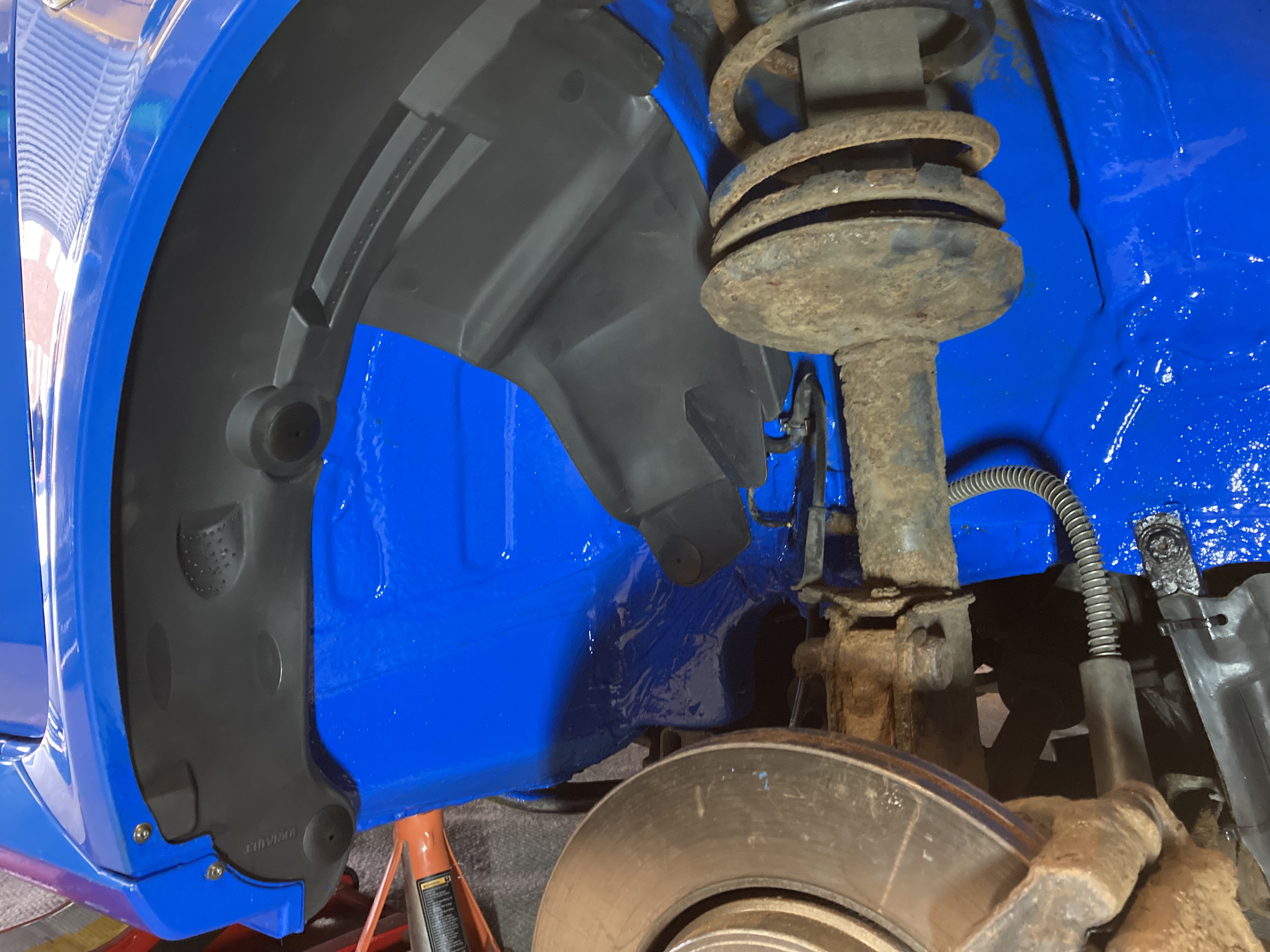

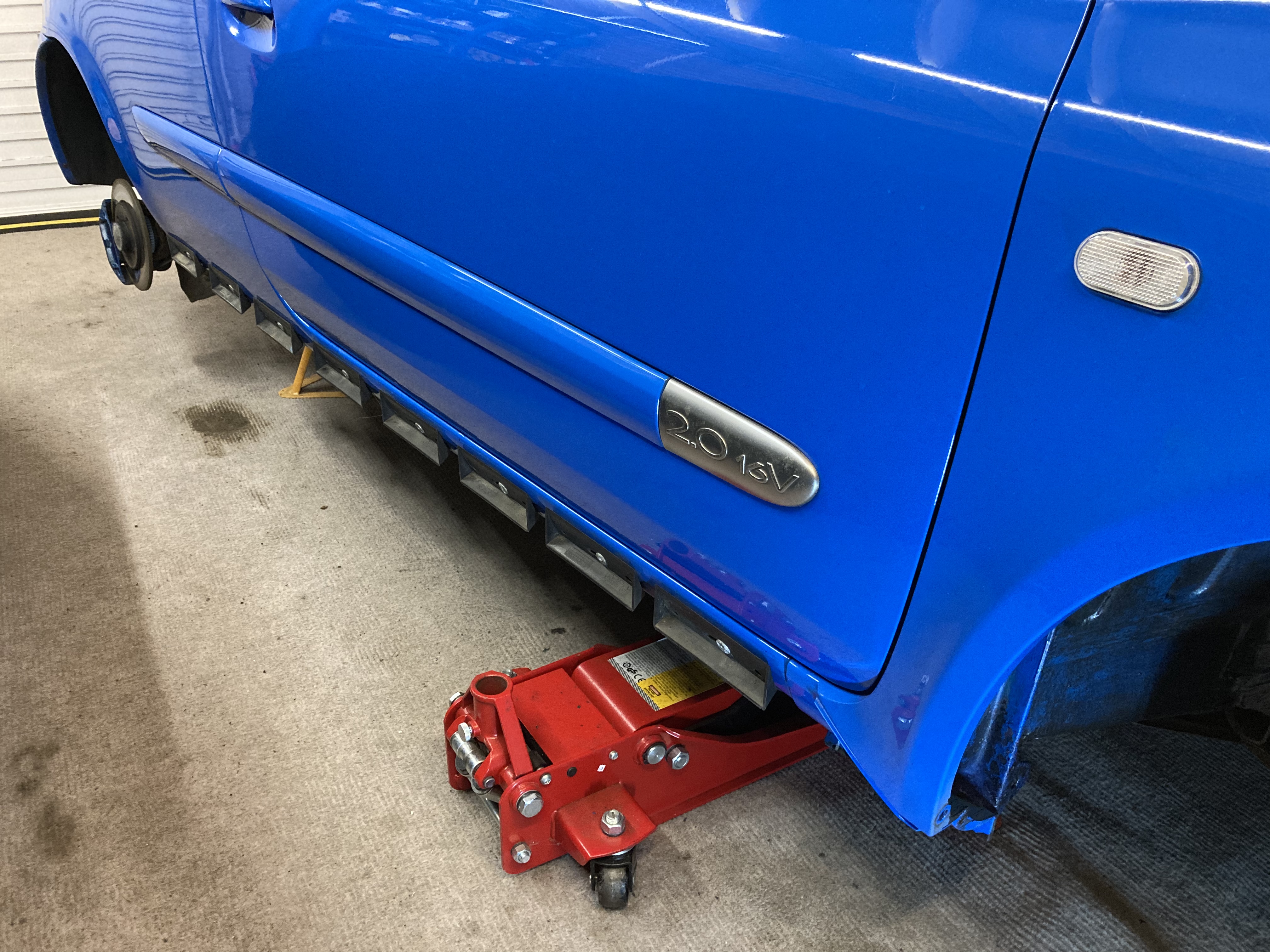

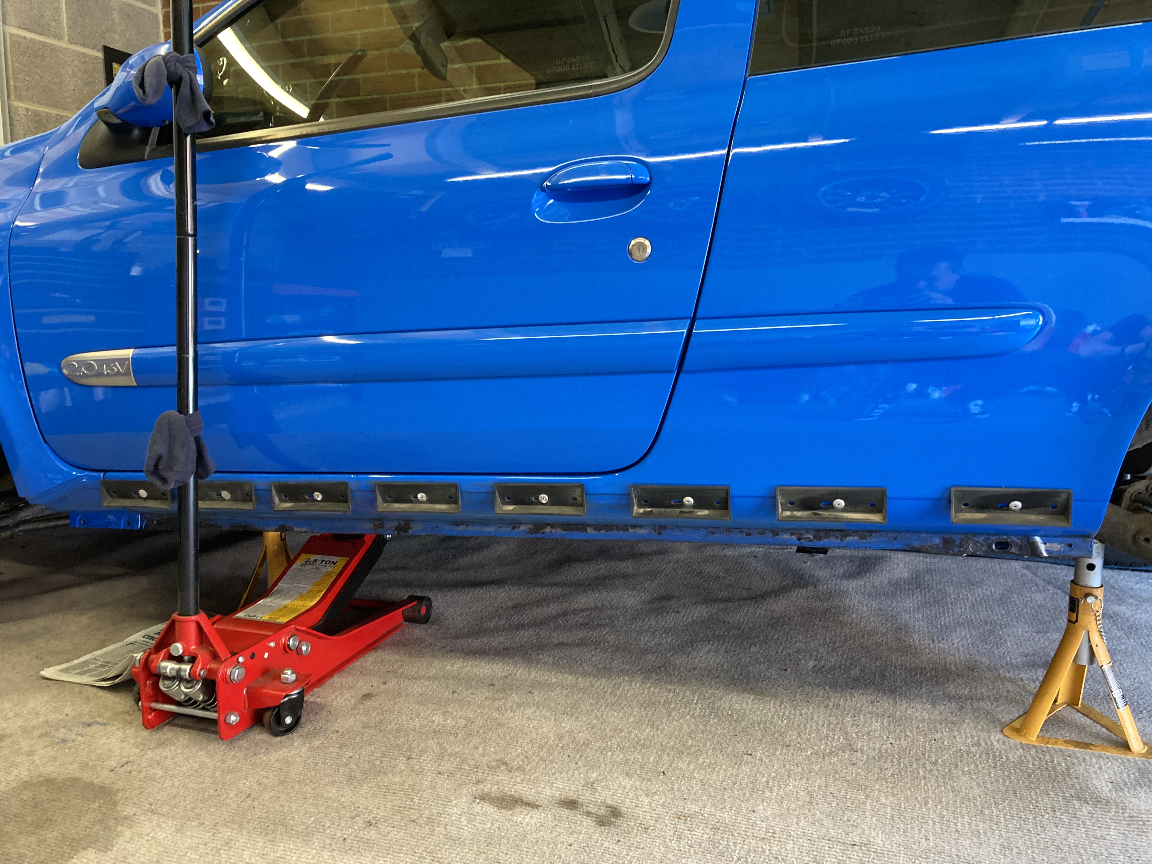

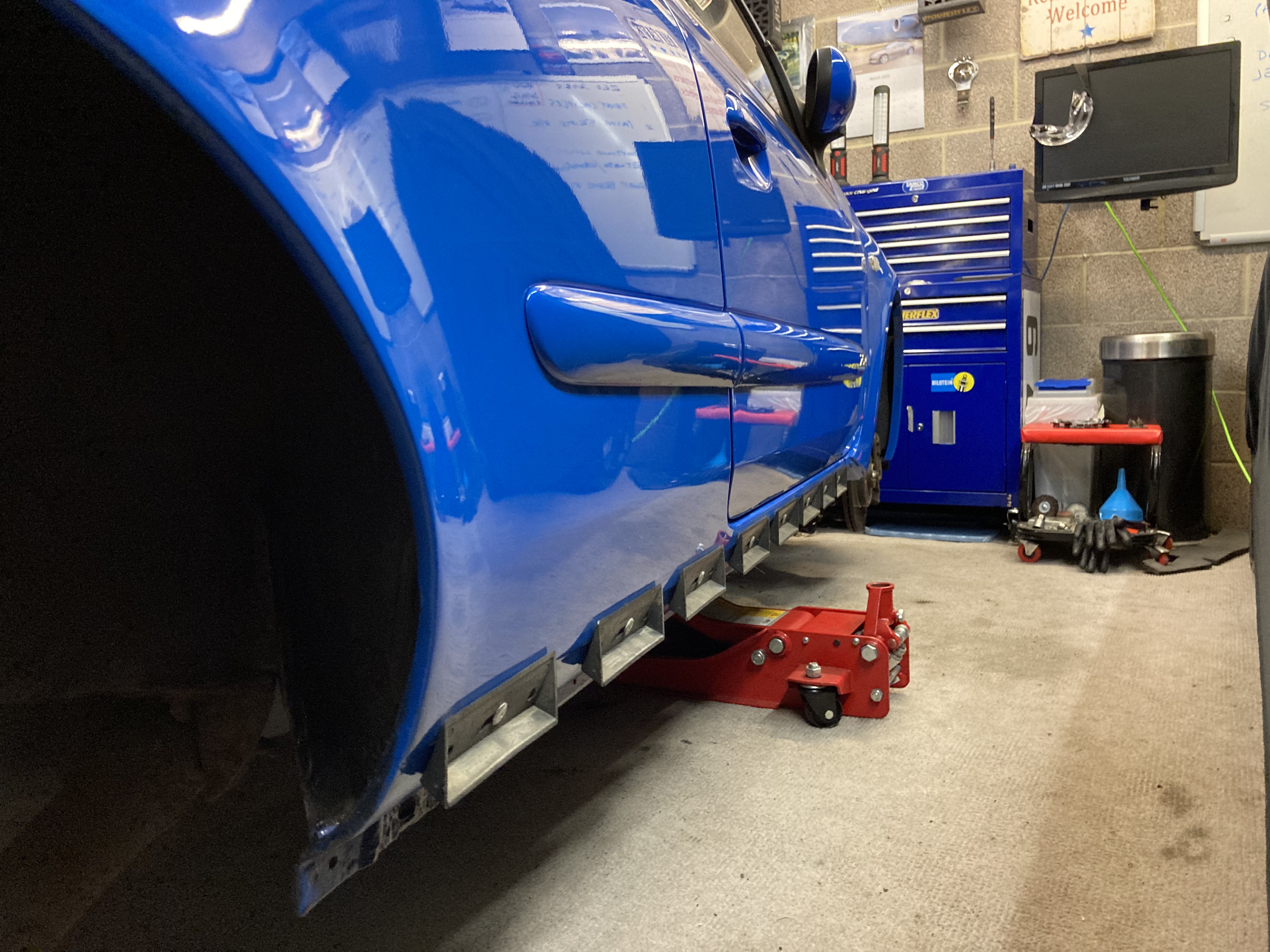

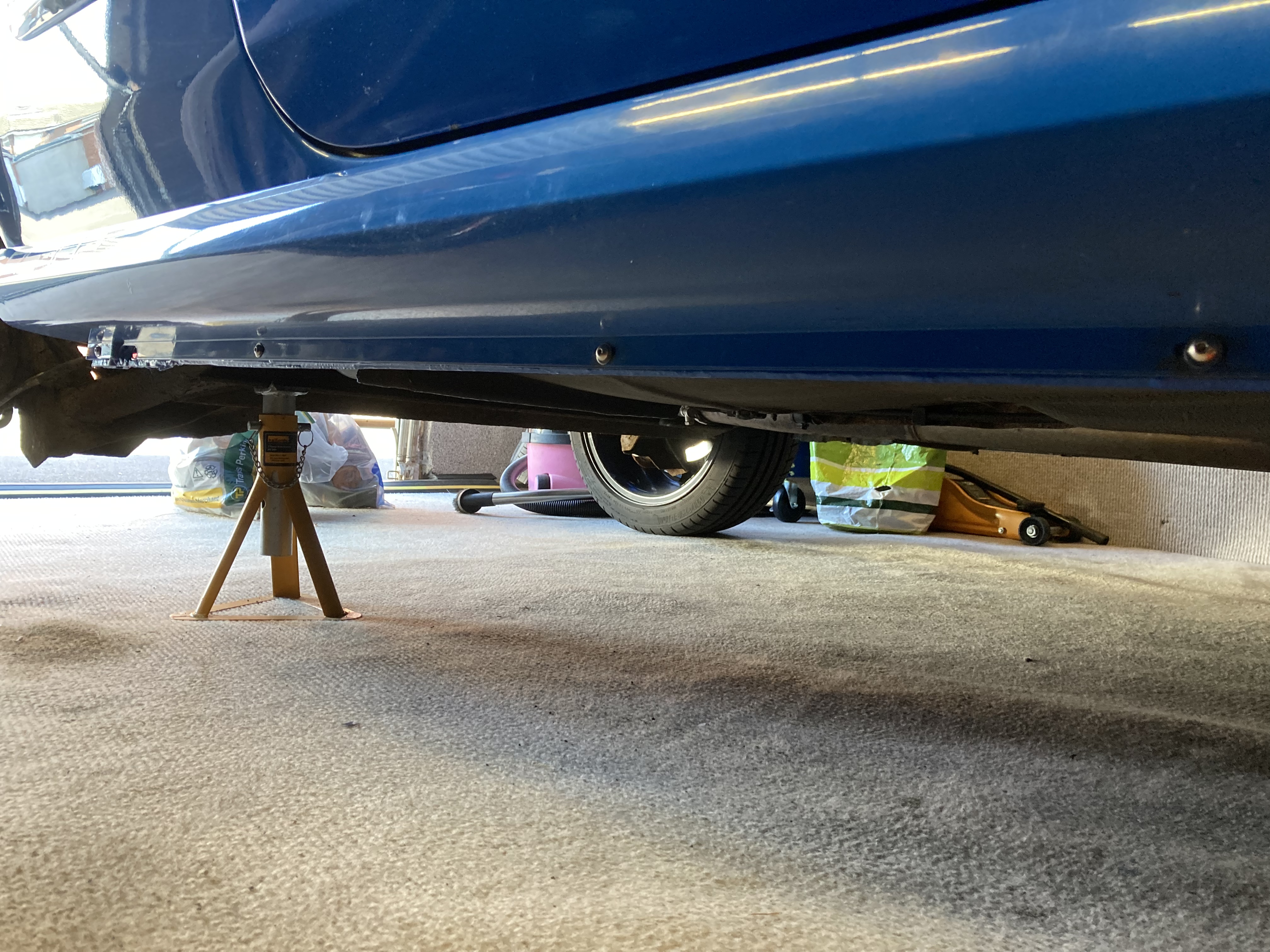

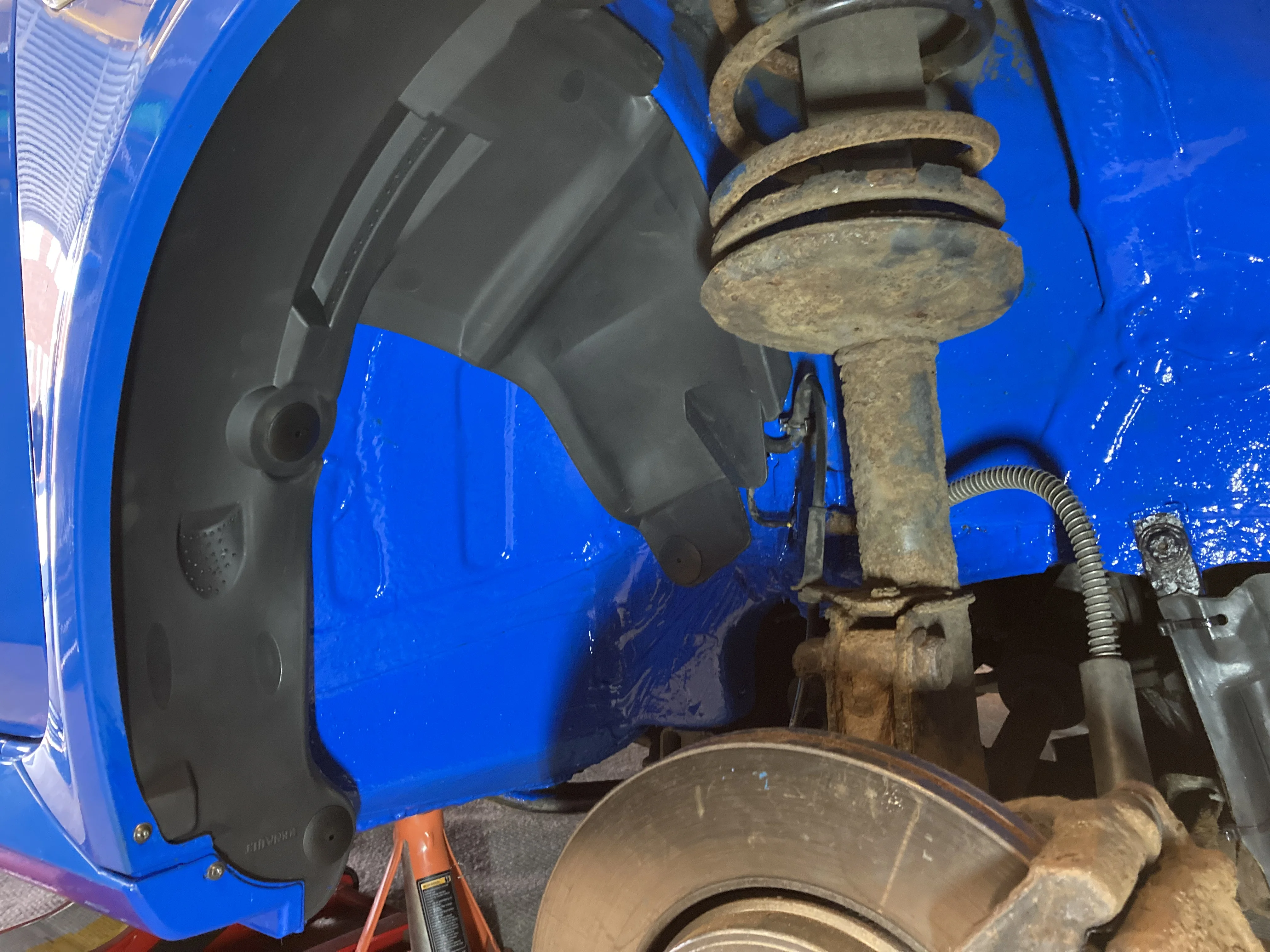

Sneaky afternoon off so decided to bite the bullet and do the usual wheel arch liner and side skirt removal.
They have never been removed for 18 years so I drilled out the rivets, pulled the fir tree stoppers and yanked the whole lot out.
Bearing in mind this car had spent its entire life in wet and salty Scotland I was relieved to find lots of mud and not much rust!
A quick coat of Hydrate 80 on the jacking points and a few areas of the inner arch, primer, top coat over the weekend and that’s one side done.

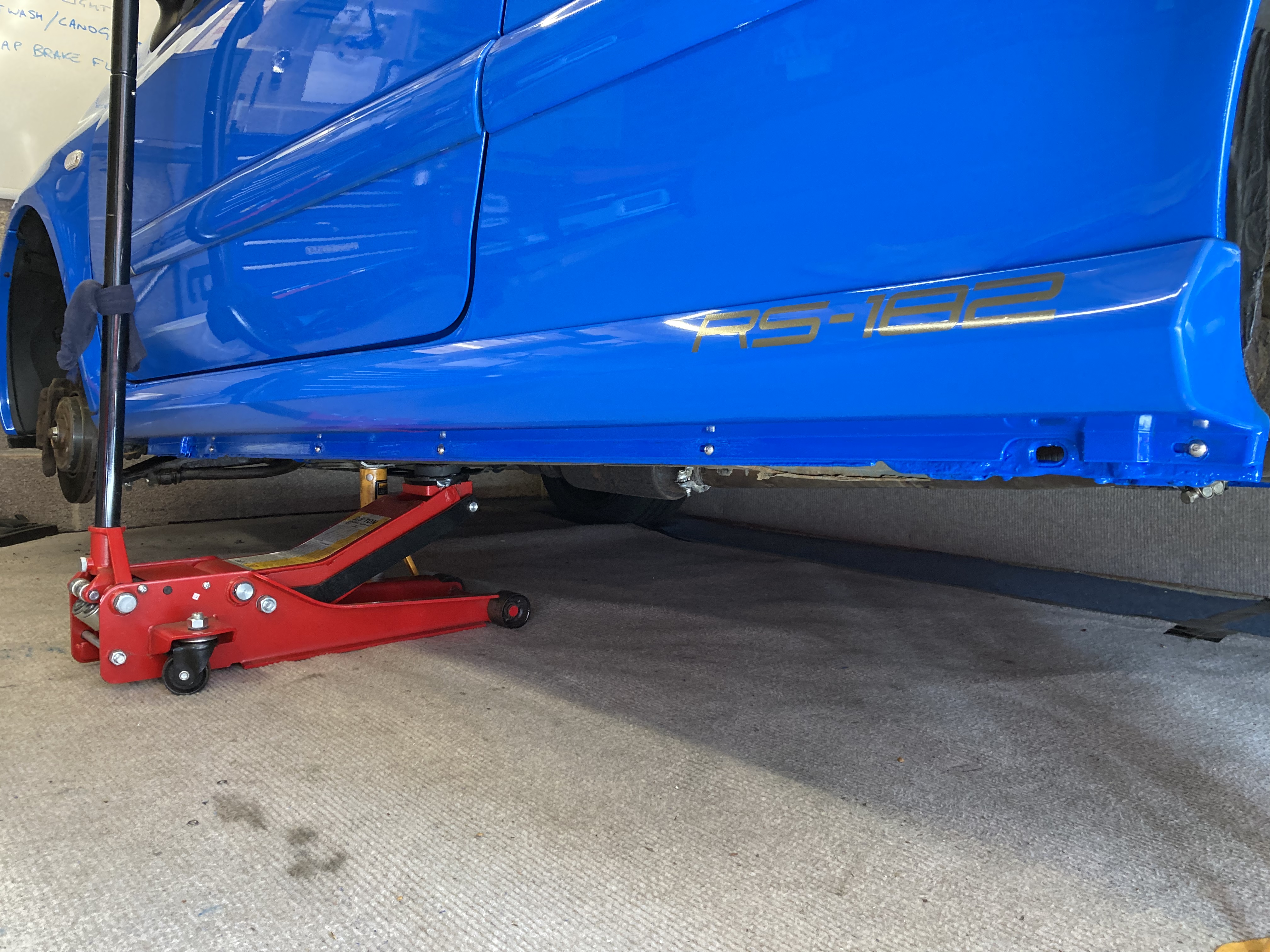

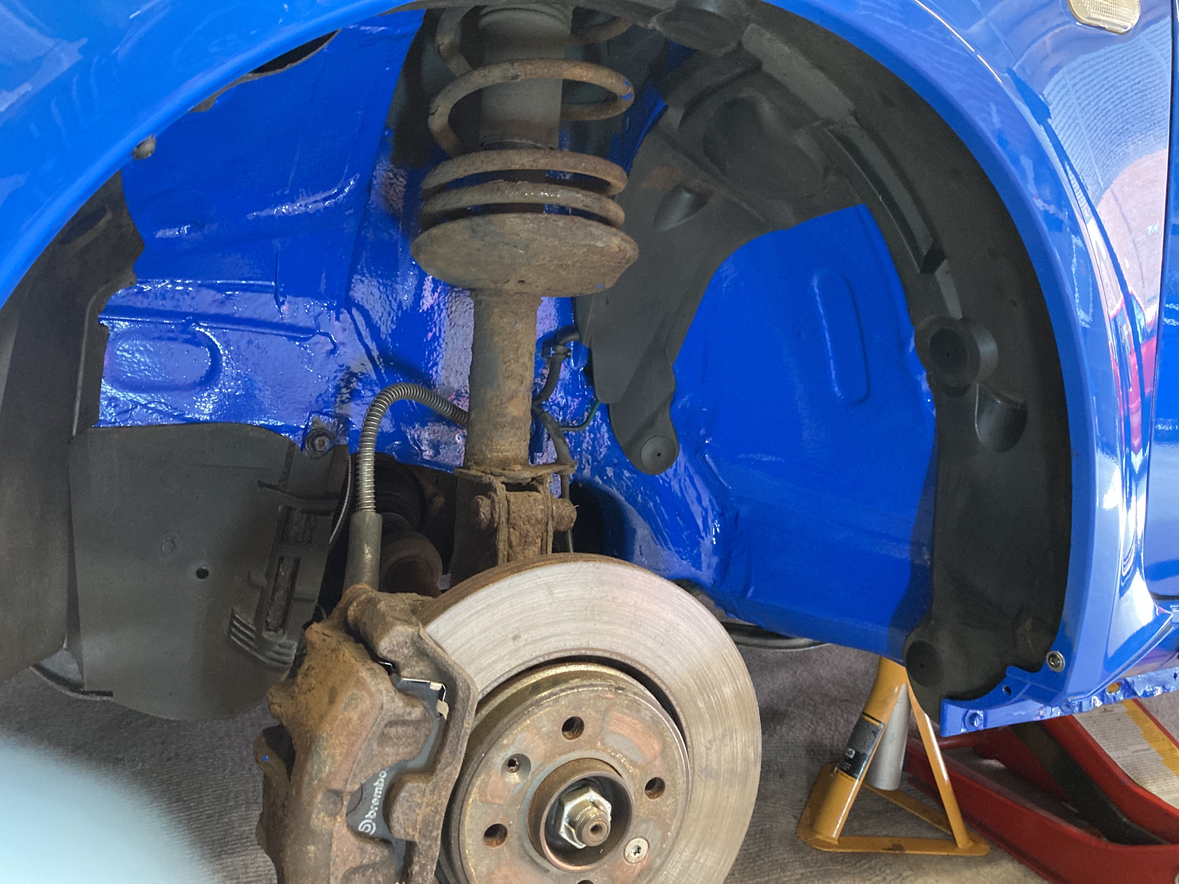

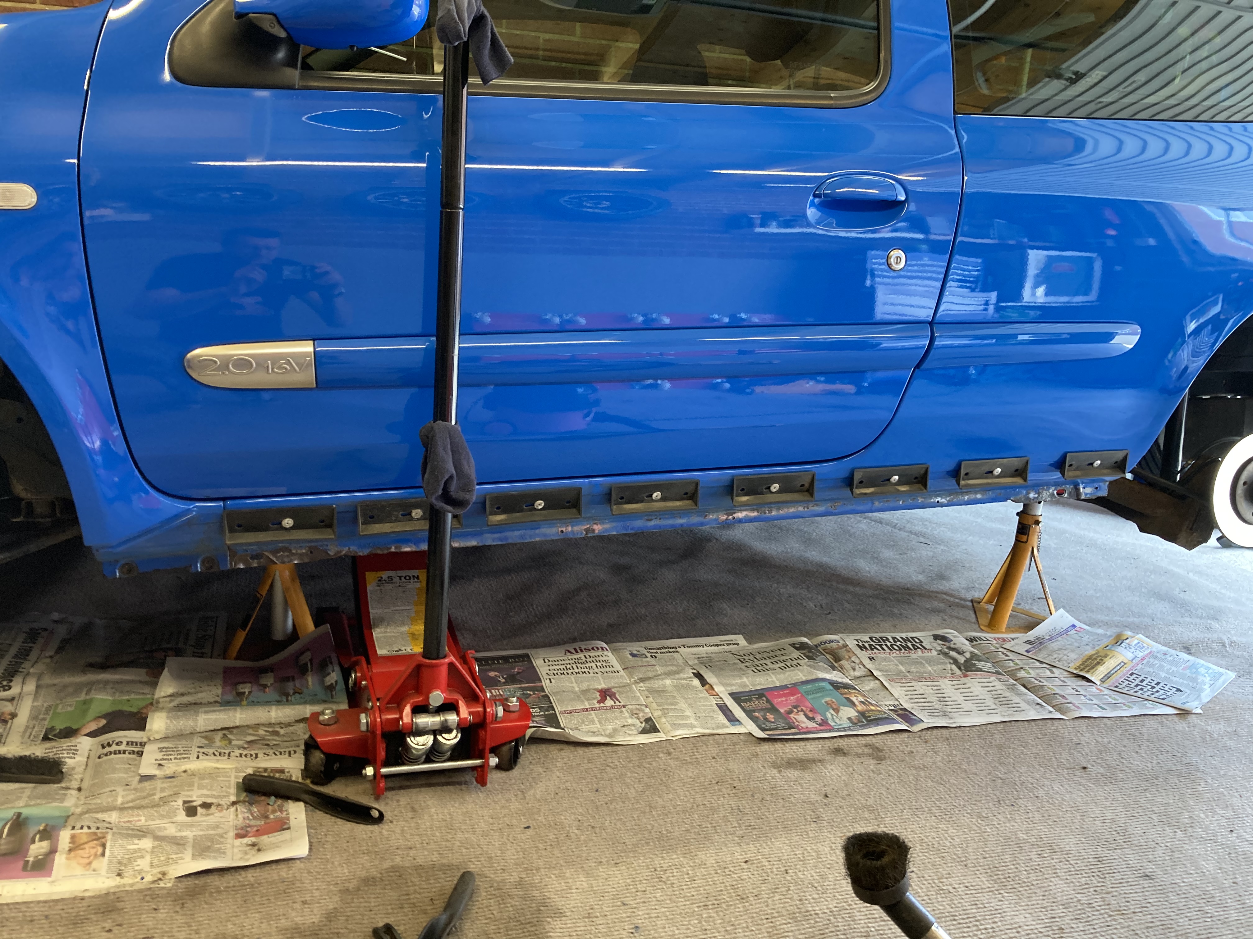

Sneaked into the man cave over the weekend.
Primer, top coat to sills, inner arch. Refitted the side skirts with stainless button top bolts along with a new Oem arch liner.
I Know it’s not factory looking but I’m pleased with how well protected the arch looks with a decent coat of J45 paint put on with a brush! This will not be a show car but one I want enjoy and last me out!

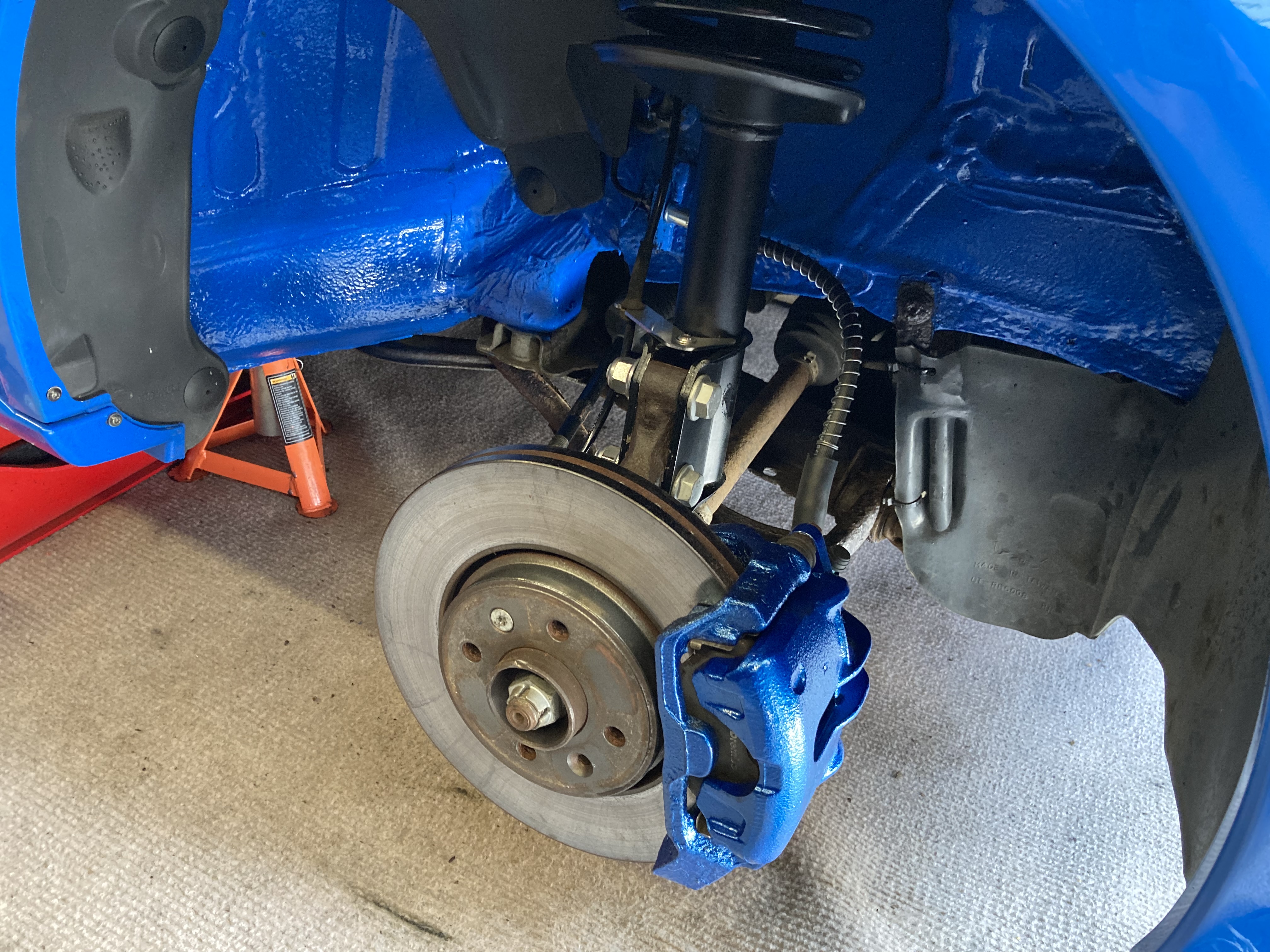

We’ll that’s a corner done!
I’m going to repeat this for the near side and then sort out the calipers, new shocks, top mounts, roll bar bushes and brake lines.
Luckily the previous owner had just replaced the steering tie rods and lower ball joints.
Once I’ve done this I will start on the rear of the car.
Thanks for reading. Andy.

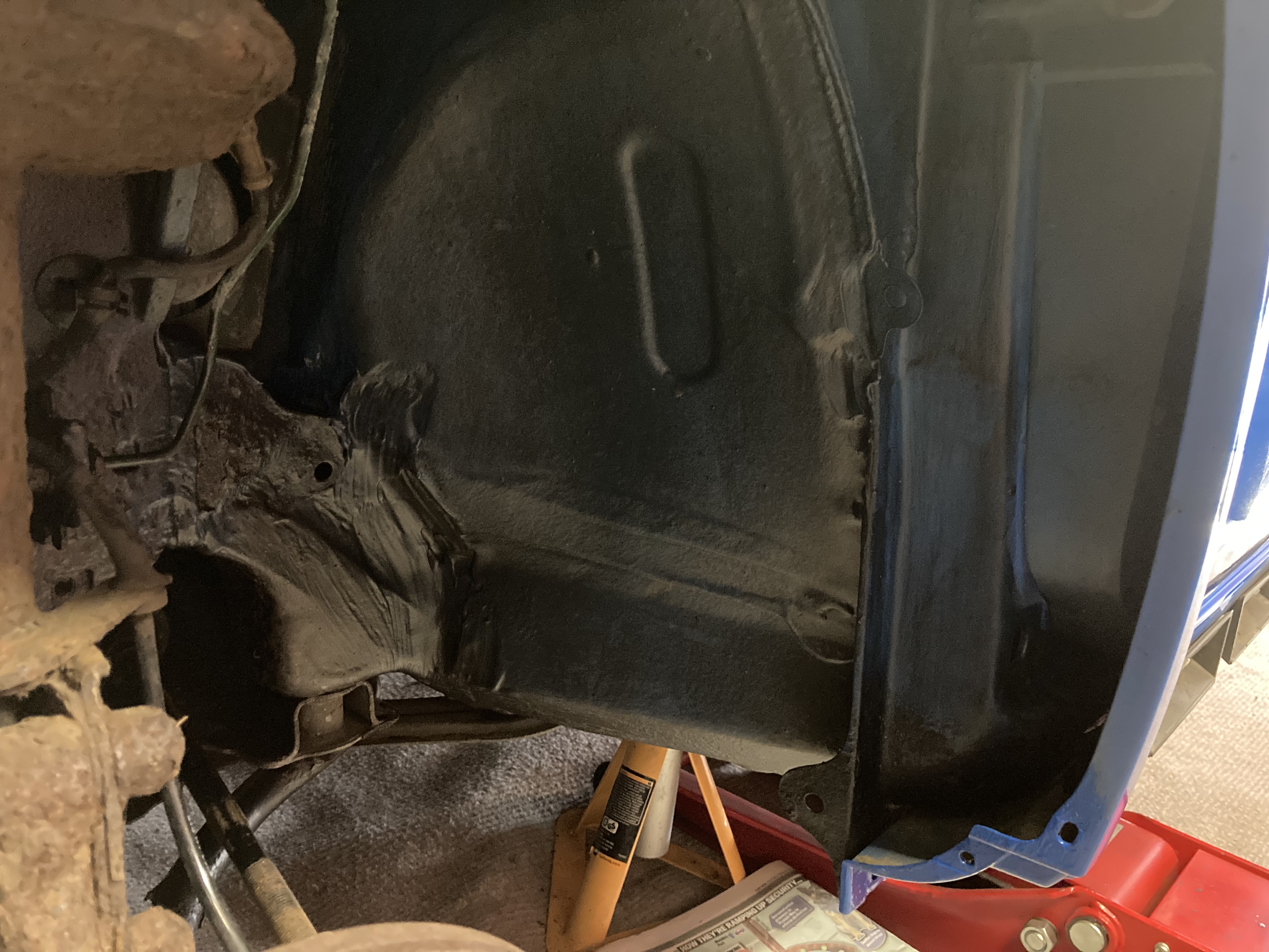

Removed the nearside front arch liner and cill which for obvious reasons would uncover the worst corrosion.
Nothing here to worry about apart from about 2 kilos of dry dirt and some surface rust which I removed and then treated with Hydrate 80.
Undercoat and paint as per offside to follow.

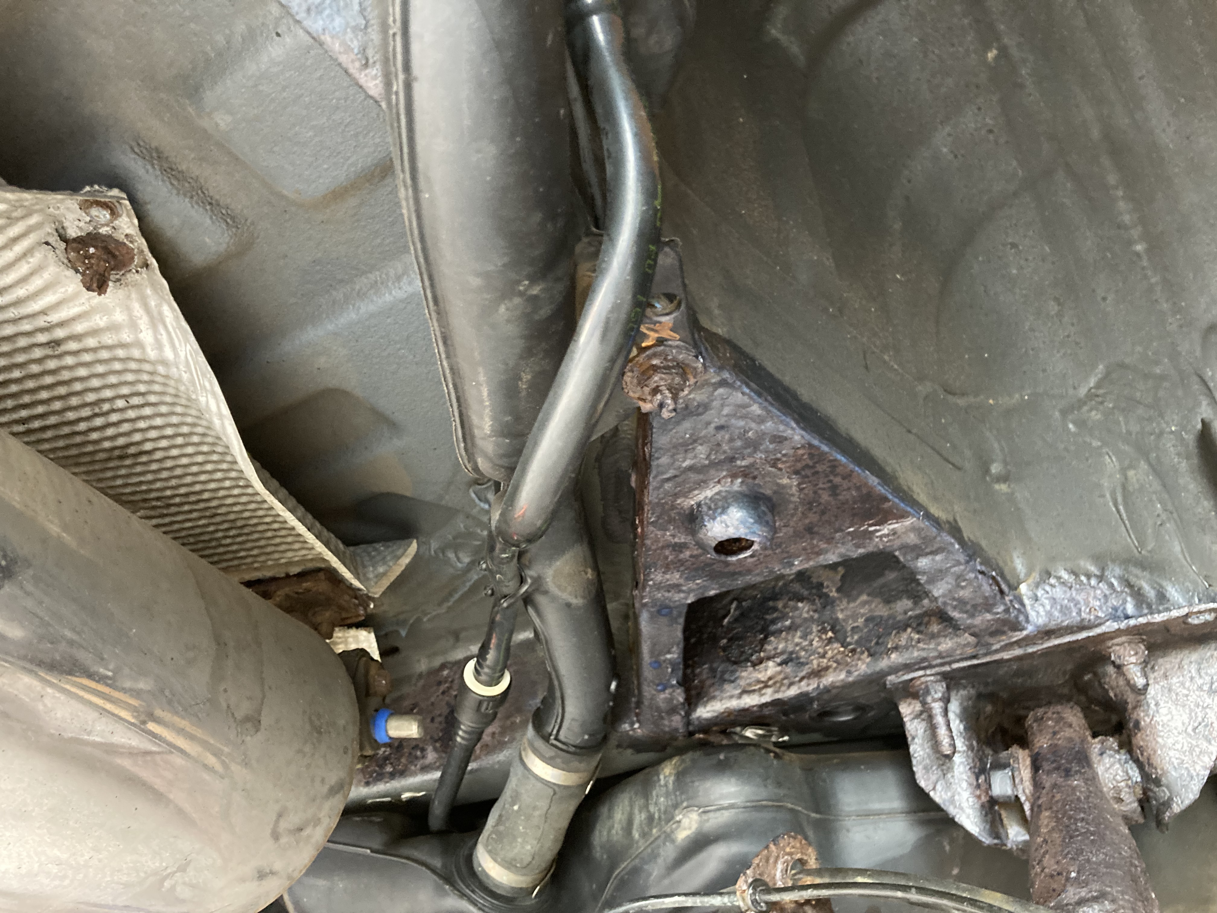

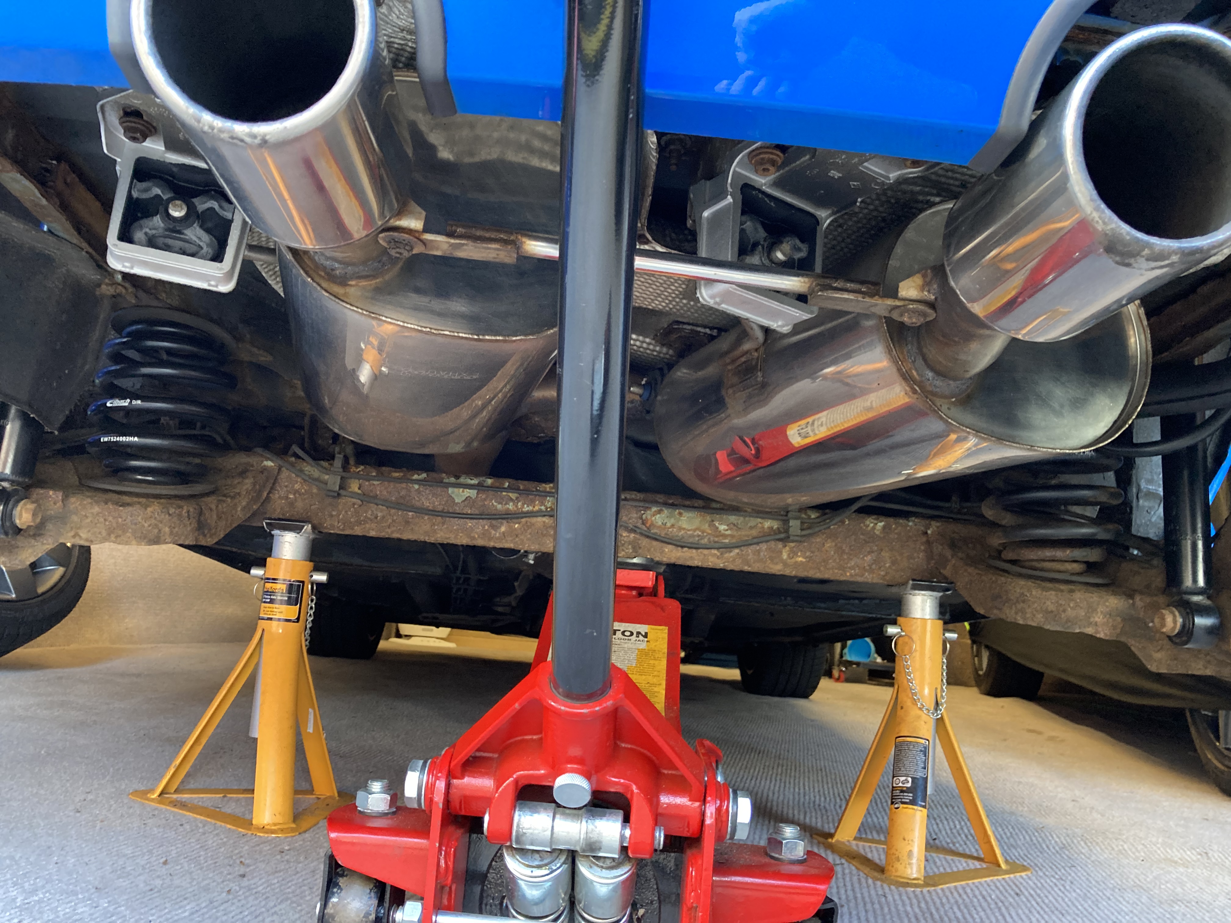

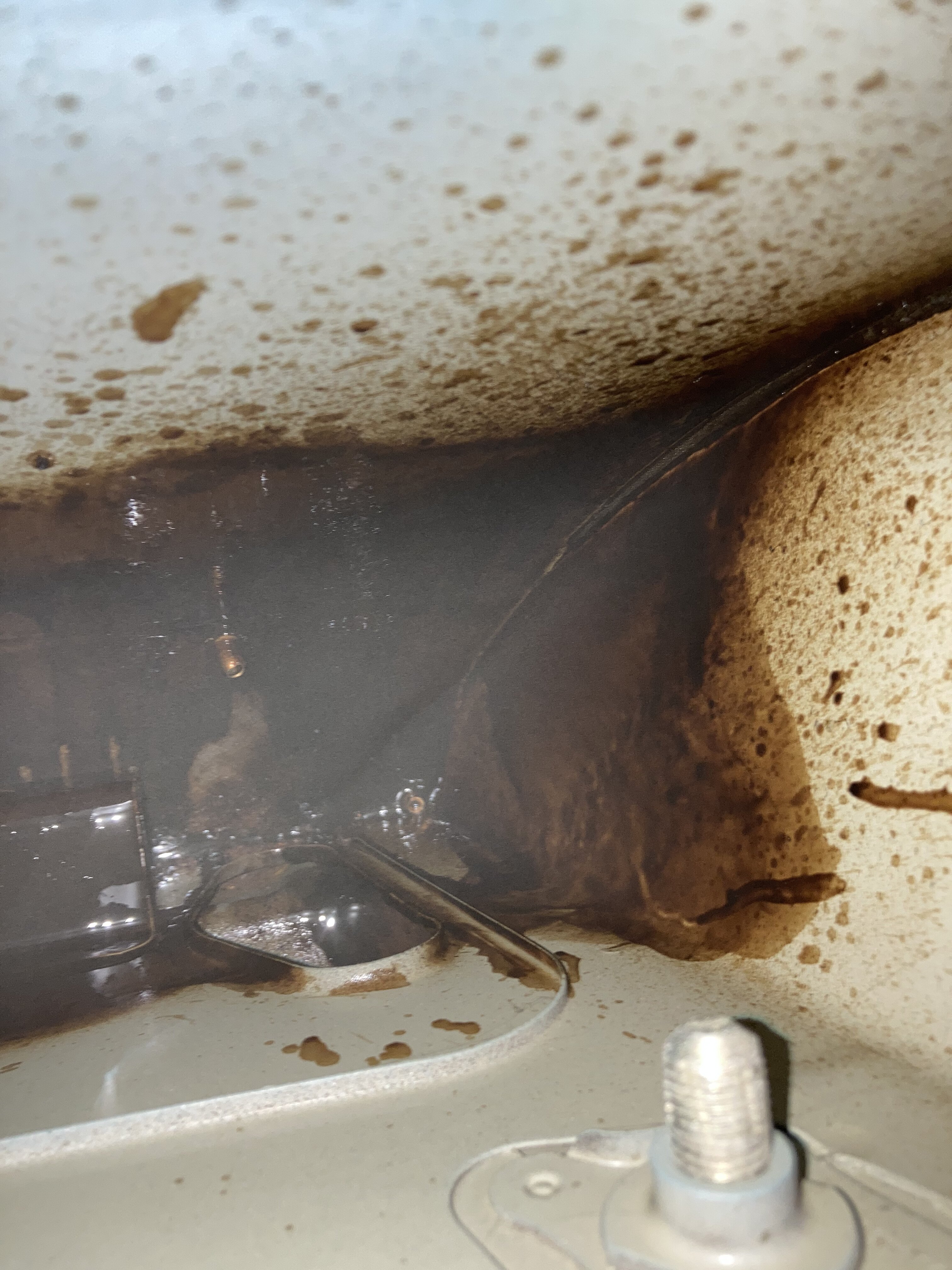

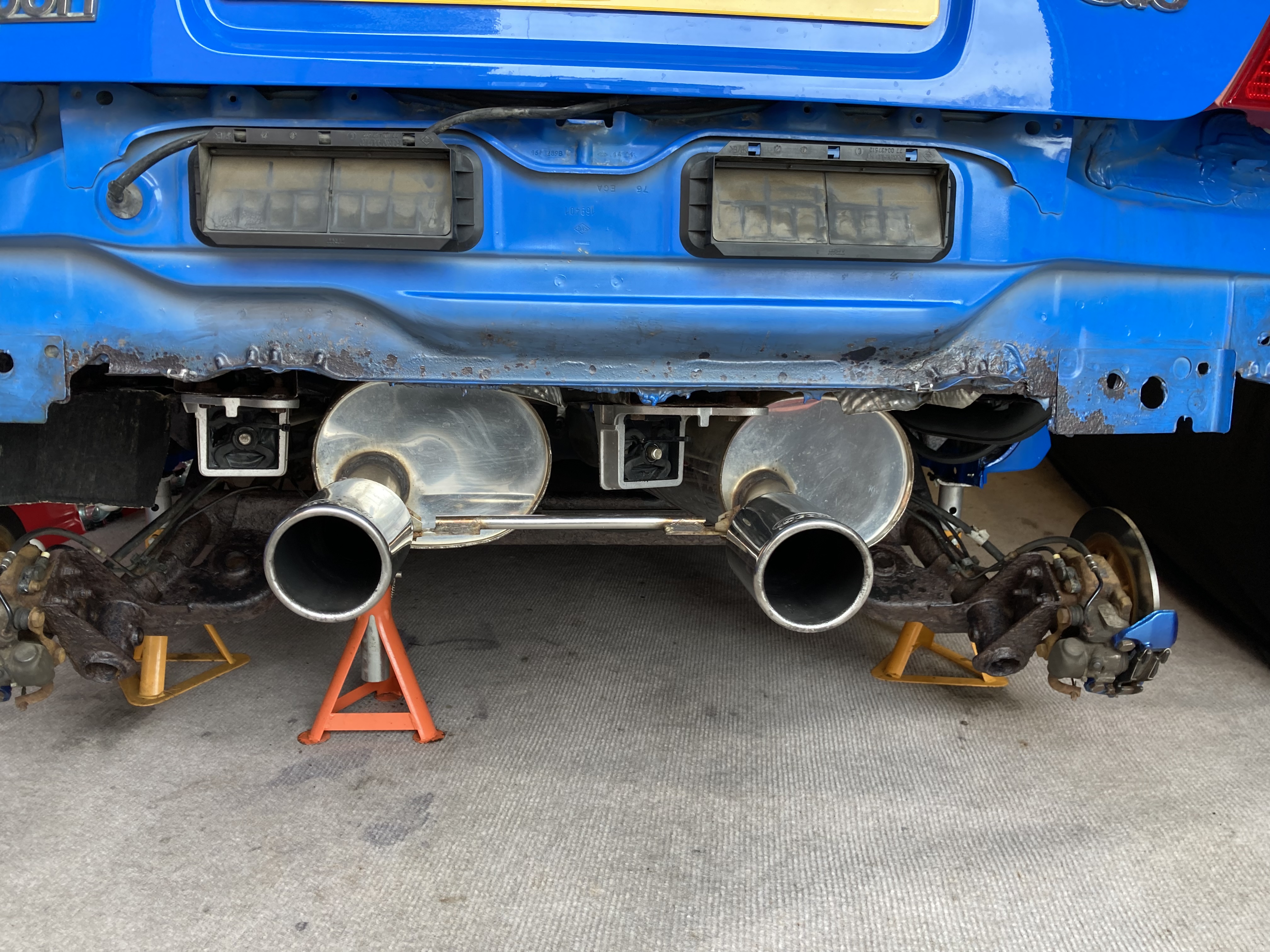

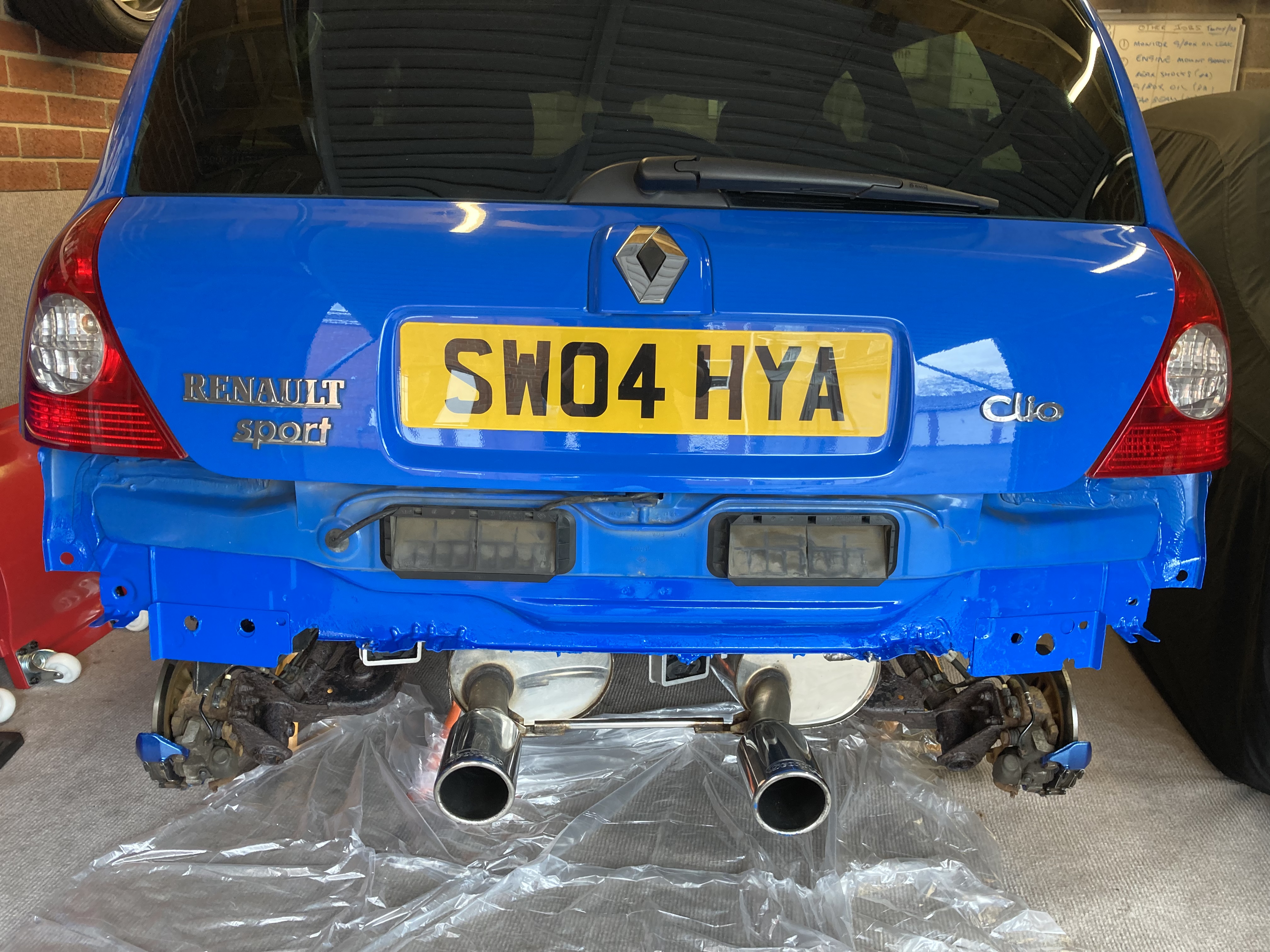

Right.
Bumper off, along with the aftermarket dampers and corroded springs.
Spent most of yesterday morning sanding/wire brushing on my back removing all the mud, crud and rust which thankfully was of the surface type. Upper spring mounts are very sound along with rear beam brackets.
Coated everything with Hydrate 80 to stabilise.

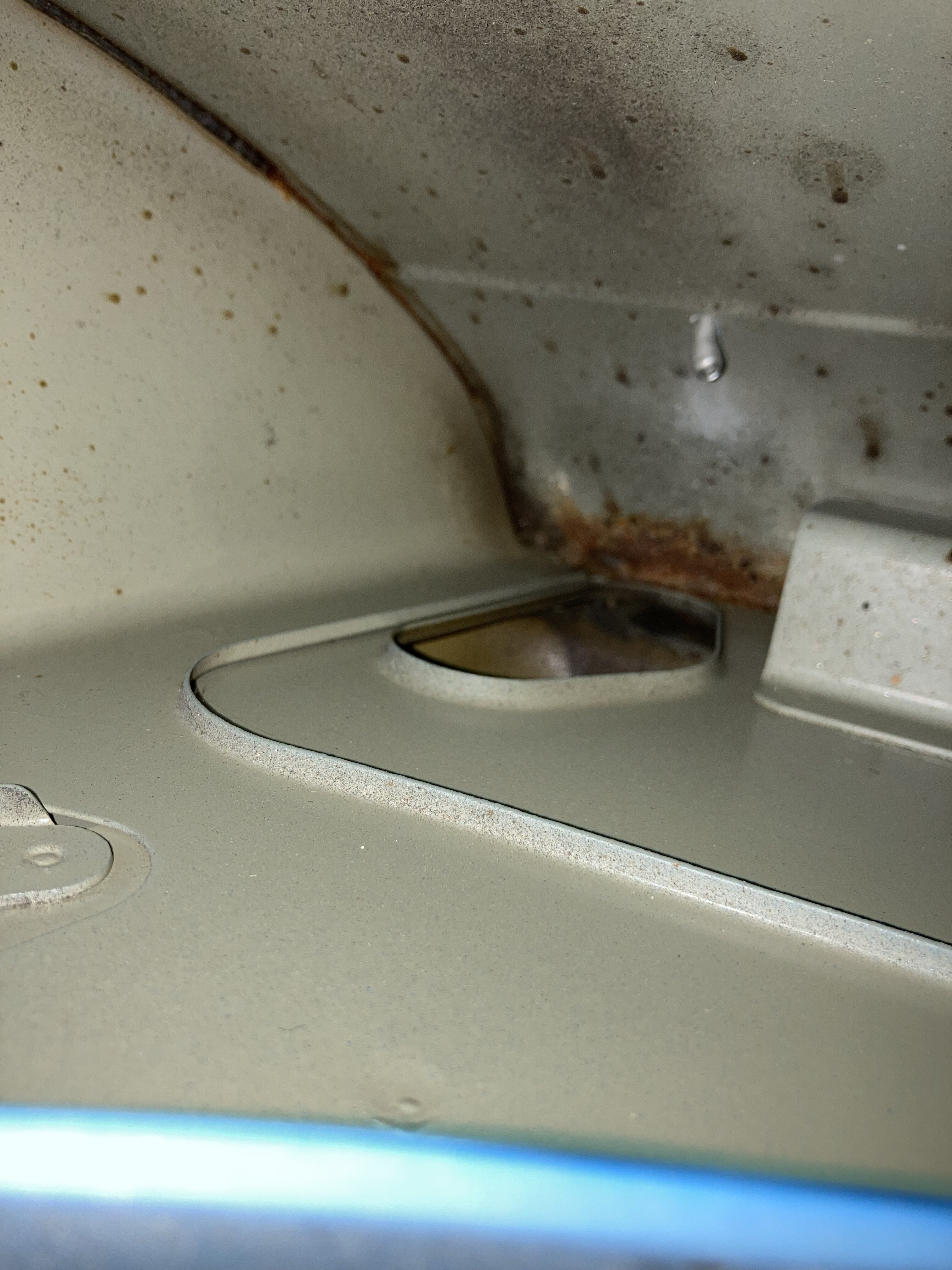

Did the dreaded peak through the rear speaker hole with a camera to see what the tin worm had done to the rear arches and she don’t look too bad! Got out the jumbo can of Dynax S80 with the extension tube and gave her a full blast. Should do the trick for a few years!
Rear panel primed and hand painted with RB top coat which I know is not the Concourse look but it’s bloody thick and will protect the car for years to come.
Primer and underseal to the axle and underbelly so I can fit the new shocks and springs.
Thanks for looking. Andy

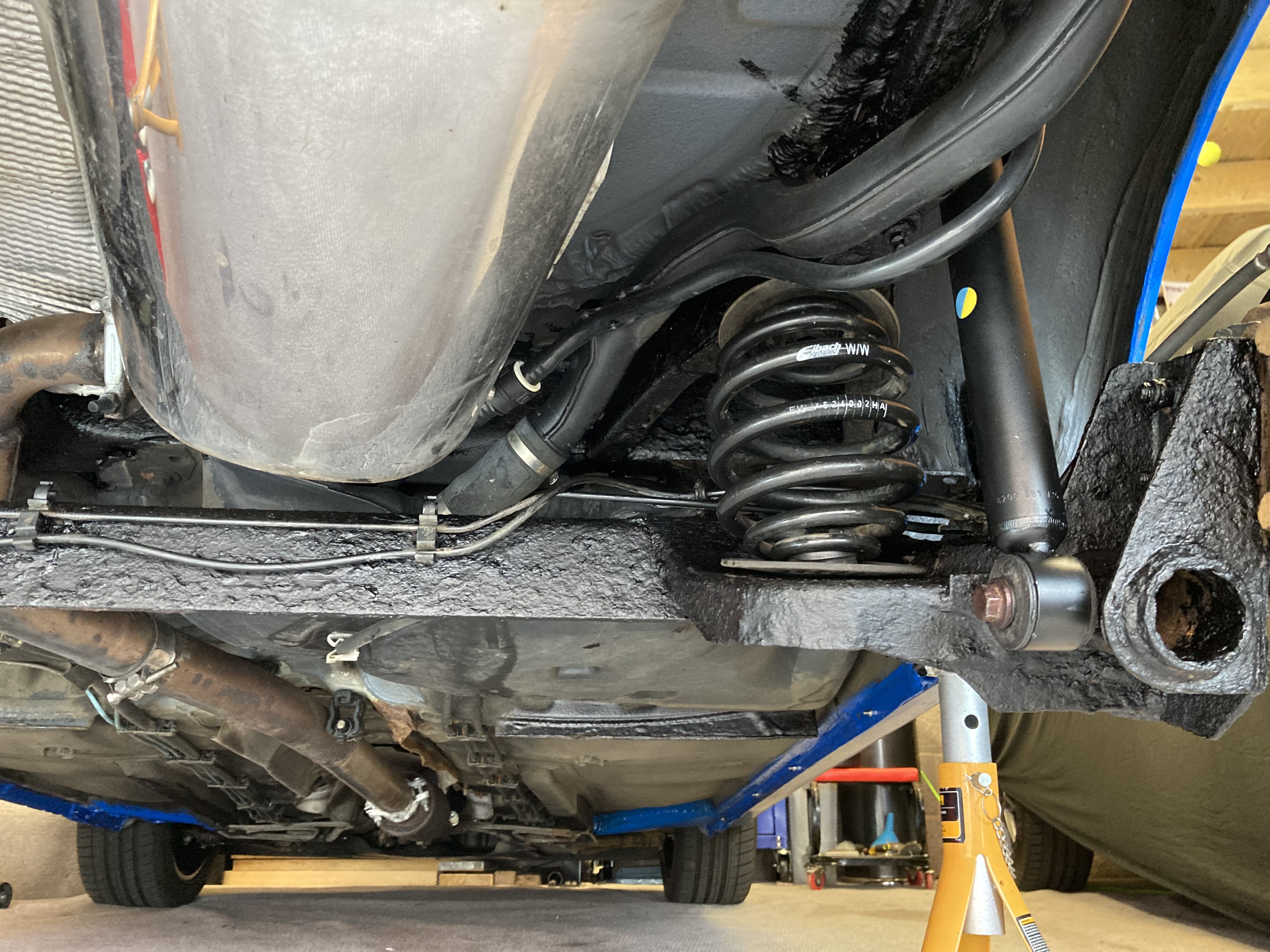

Back end now done and reassembled.
I wanted maximum protection with the underseal and wasn’t bothered about the look so I hand painted on Hammerite under body seal.
This stuff goes on as thick as you like and makes you as high as a kite!

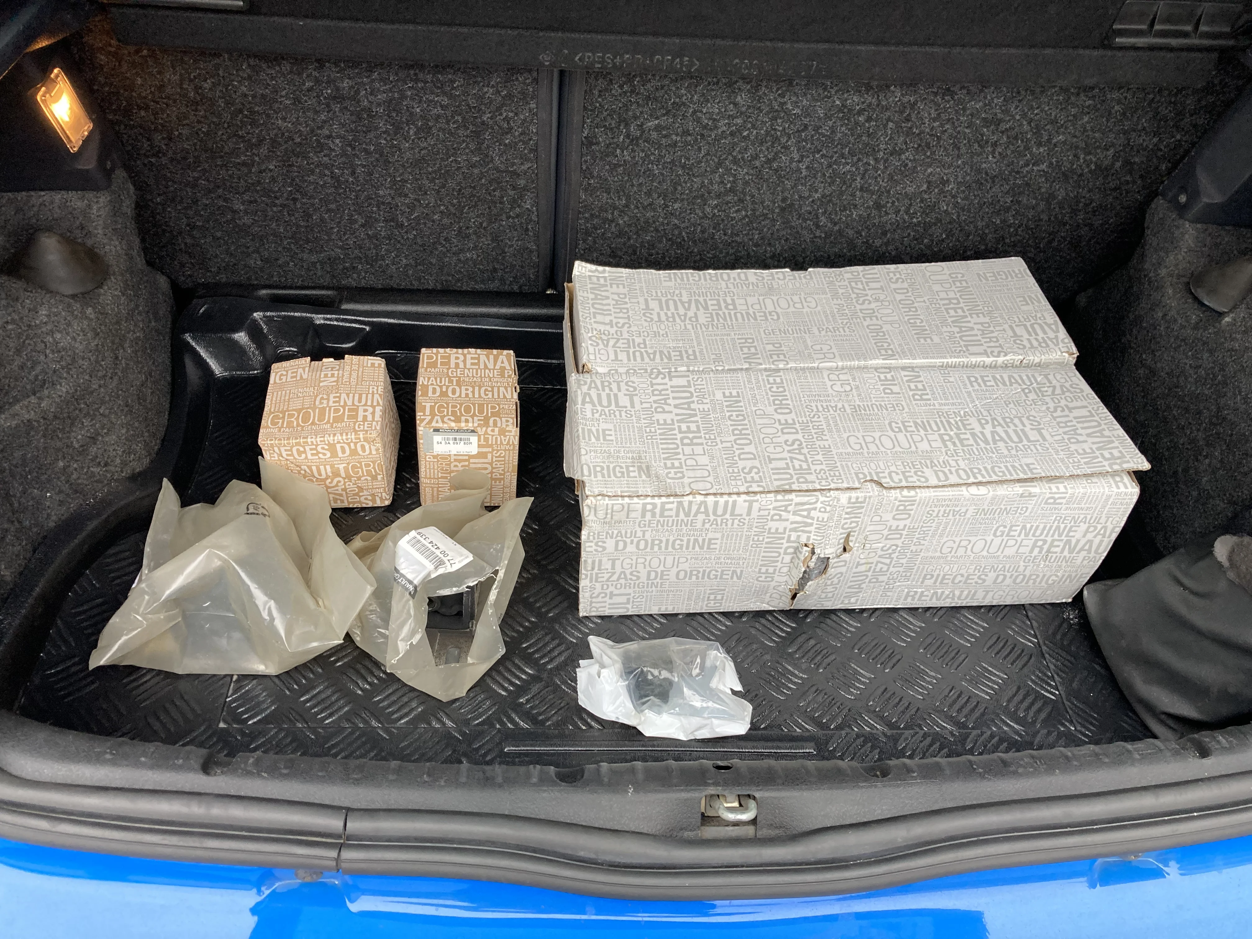

Next chapter is fitting the new front suspension and also I’ve cheated on the budget and bought 2 new front calipers as I can’t be arsed to strip and refurb them. Maybe it’s the fumes! Lol. Thanks for looking. Andy.

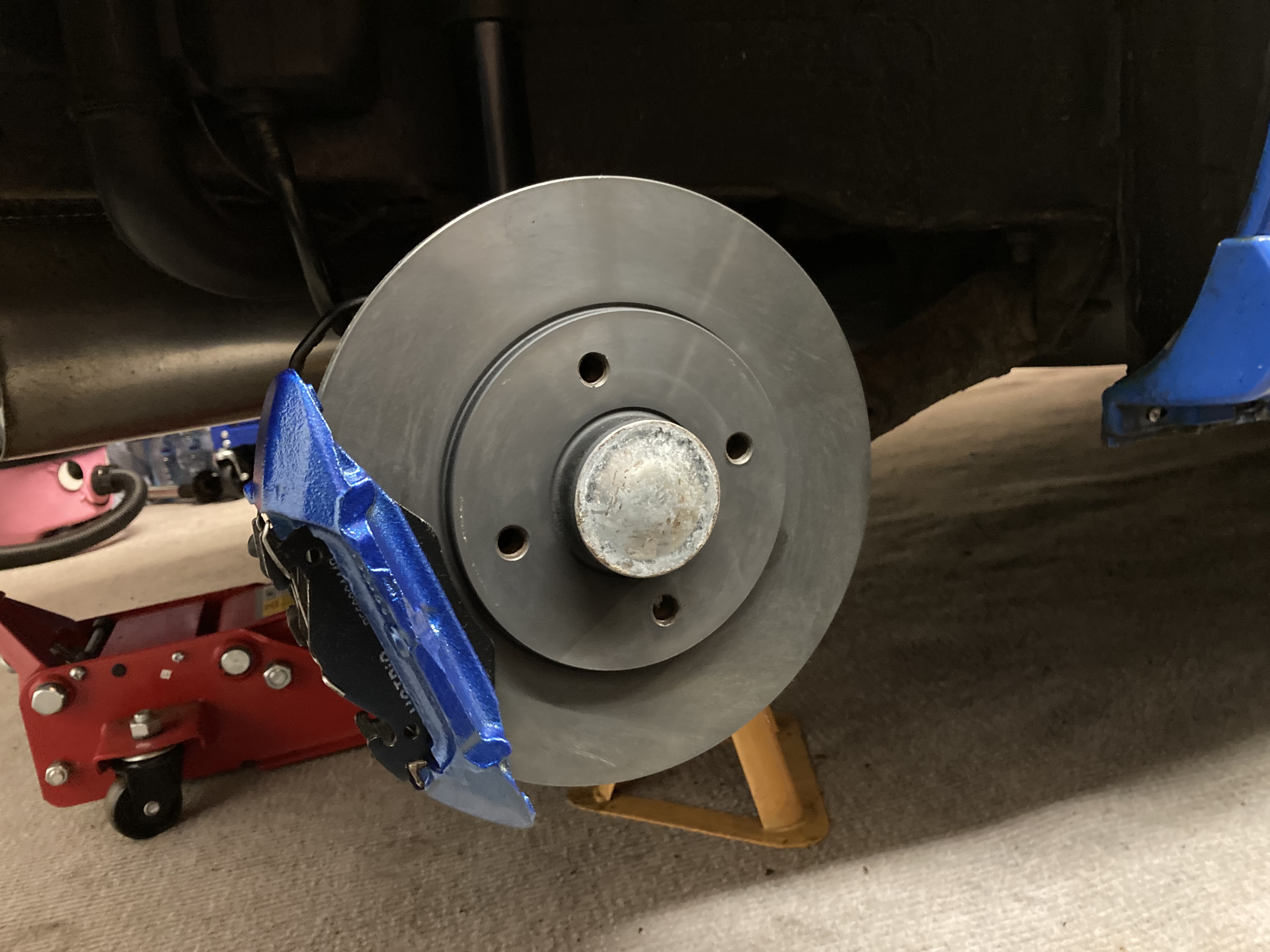

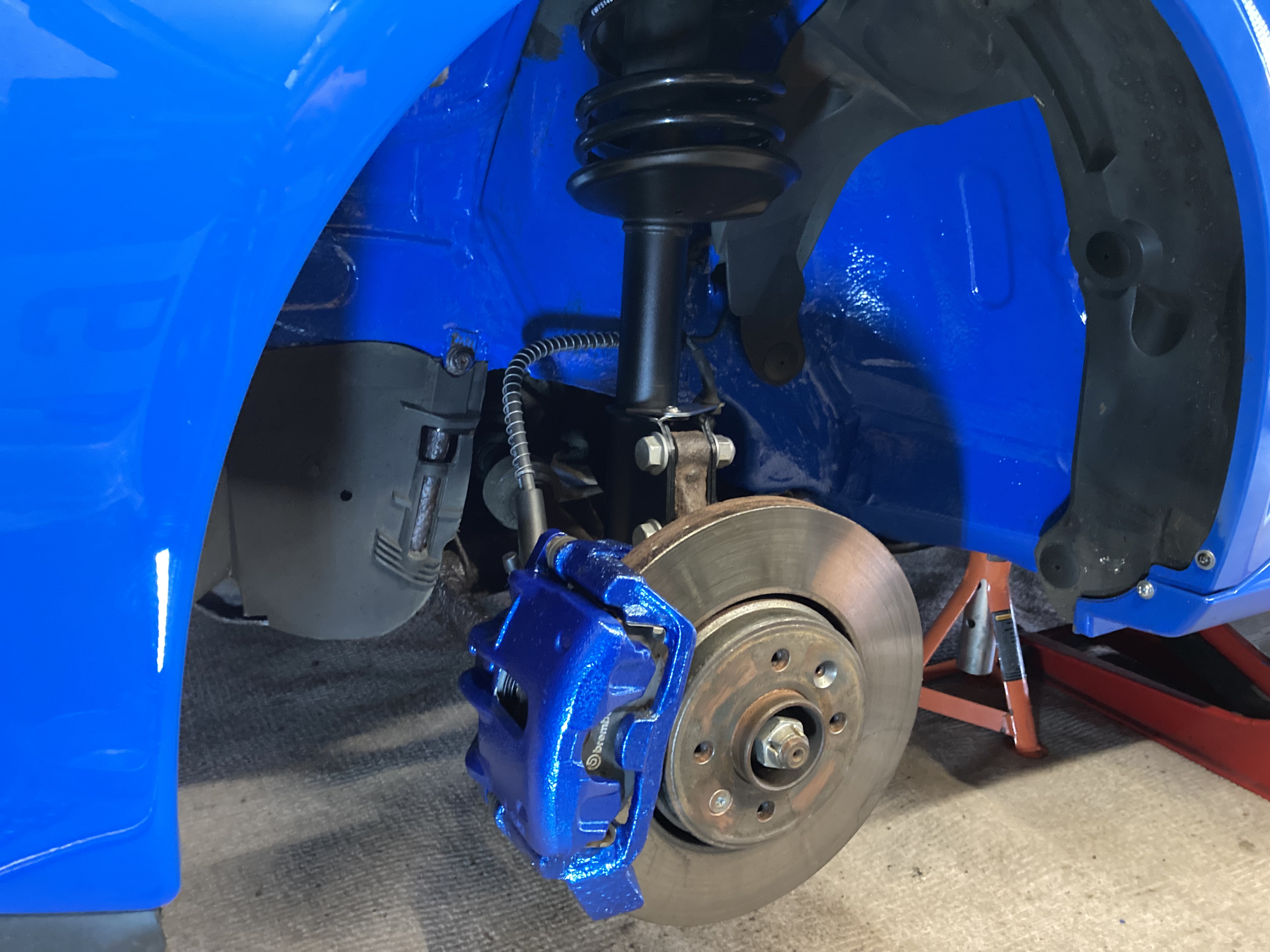

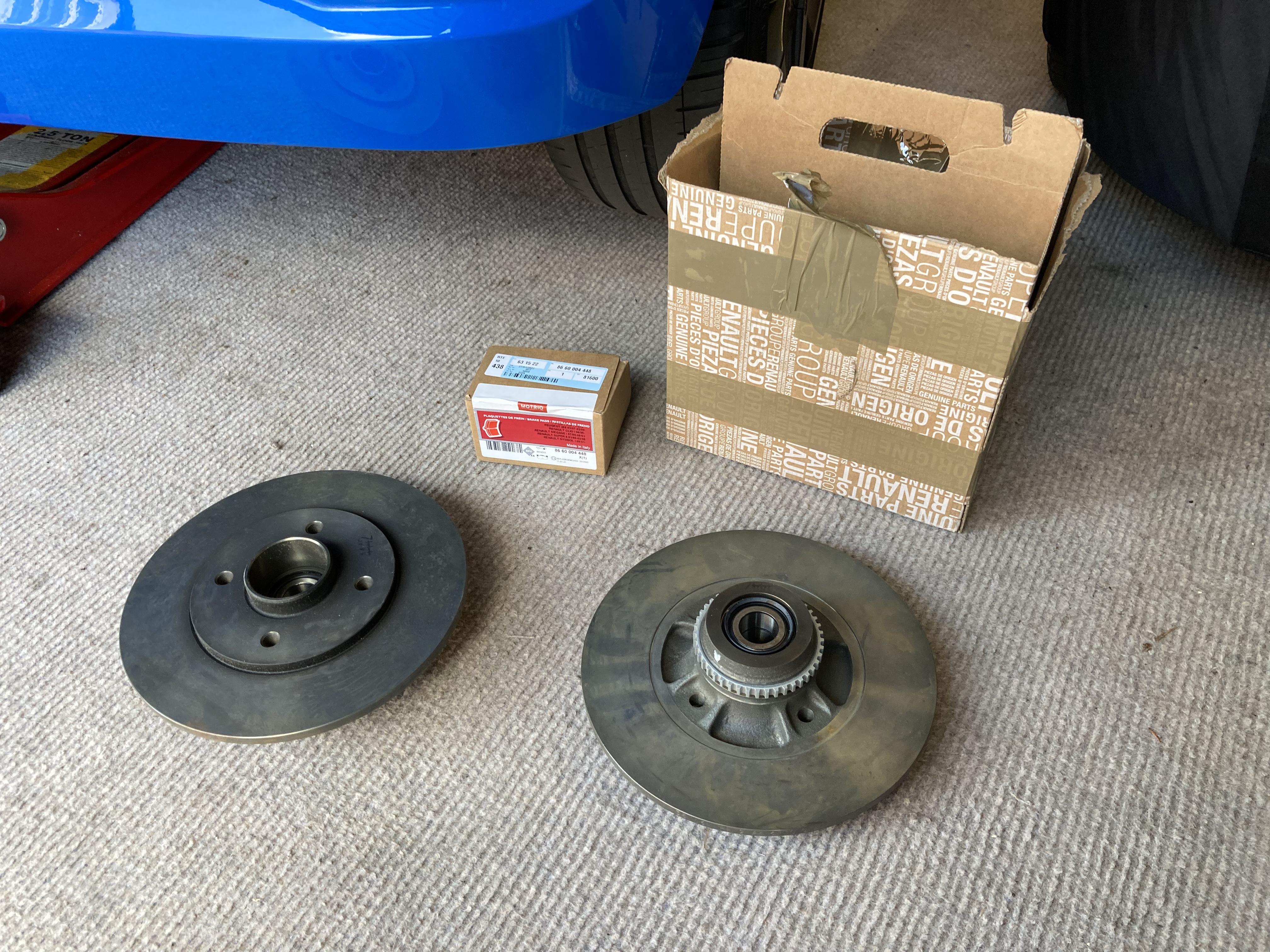

For the benefit of the build thread the near side is now done.
Now the brakes look fresh I’m going to fit my spare set of Turinis to see if I like them over the cup wheels.

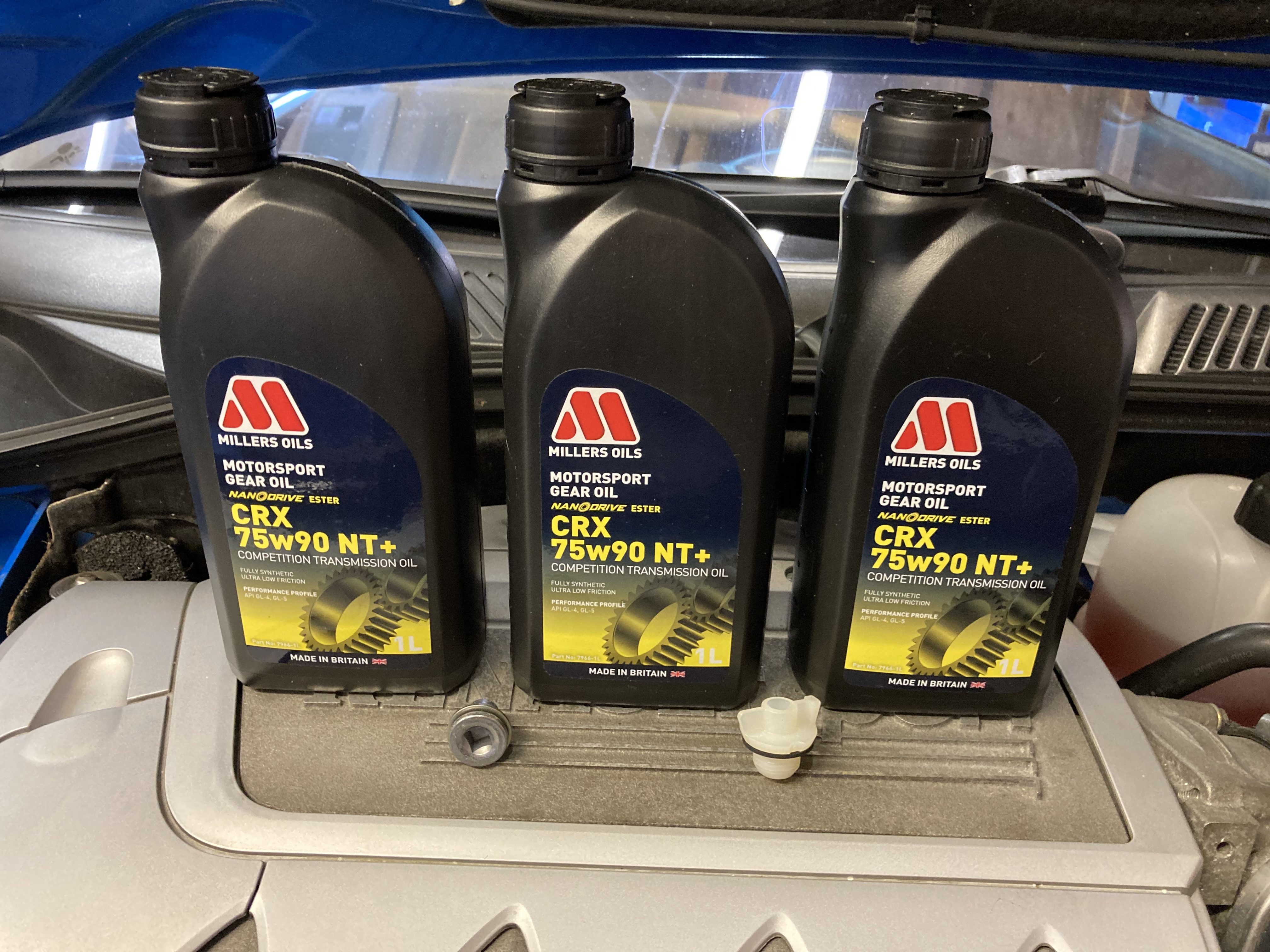

My next job Is to change the gearbox oil (Millers CRX) when it arrives.
Time to enjoy the car for a while on her new suspension and stoppers!
