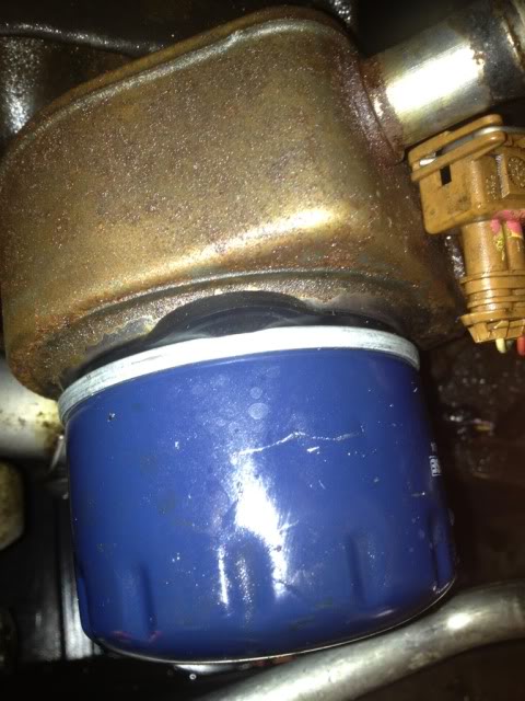

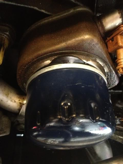

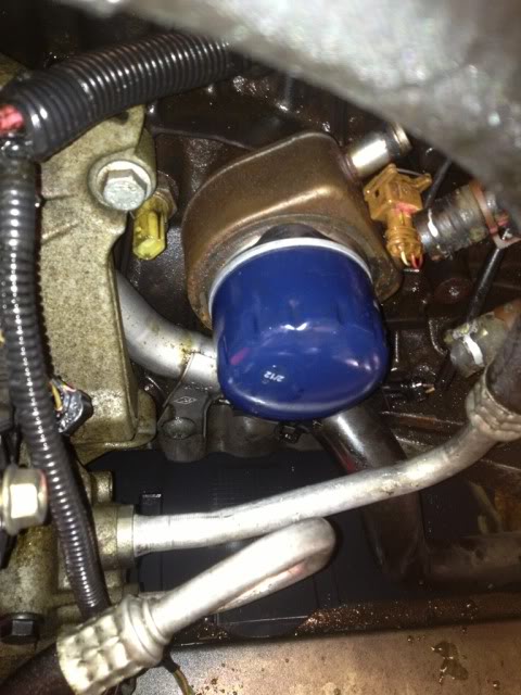

Renault R26 - Engine oil filter fitted during a service by a well known "specialist".
We will not be naming the particular company who carried out the work on the car. If the customer decides to name and shame, that is up to him!
Engine has completely seized solid!

What do you think is poor workmanship about that?
Obviously looks bad the rubber hanging out but to me it looks potentially like a symptom not a cause, I've seen them do that when the oil pressure relief valve has seized, the rubber is the first thing to yield when far too much pressure goes through it.

That is an option, we couldnt rule it out. However having stripped the pump, everything seems operational. Also the engine war perfectly healthy before the service, travelled a short distance after, only for this to happen.
Like I said, its a possibility the relief valve was stuck, but its fine now.
Its a possibility chip, but given the information in hand... I know where i would put my money..

I don't mind people doing name and shame threads. But I just don't see how there is any hard evidence of anything being done wrong here just from those pictures, especially as like I said I have personally seen the same happen when the filter was done up correctly but there was a fault elsewhere.

I have no experience with Megane's.. Is the section of the filter visible from the top?
If so, it's either a **** up and the cause or a reaction to a failure elsewhere..

I refuse to get into an arguement over this. We have stripped the engine, and we KNOW what we are looking at. Gaining credability....over what.. noticing it?
Of course there is always a possibility that something else caused this, just most faults on a car. However it is MUCH more likely that the filter was fitted incorrectly as I know the distances travelled since the filter was fitted.

You said on the last page there was a possibility it was a symptom not a cause now you are saying the opposite and you are certain what happened. sorry but I'm just not convinced you actually know what happened. It's not uncommon for the pressure relief valve to stick for a bit and cause a problem and then to unstick, seen it all before and I don't like it when people just point a finger at the first thing they see, made the same mistake myself years ago when this happened to me on a car, saw the rubber out an thought "oh my god I can't believe I didn't do the filter up properly, I would have put money I wouldn't make a mistake like that"
I then fitted another filter and you can imagine how thorough I was about it that time and guess what as soon as the engine revved it did the same again.
So I fitted an oil pressure gauge, and ran it up again with a 3rd filter and this time I could see exactly what the real problem was, pinged straight off the end of the gauge when the revs went up. Stripped the pump and by then the valve had unstuck again and looked ok. Fitted new pump, problem solved.
So I honestly don't believe you can say with certainty what happened there unless you used a time machine to go back and check the oil pressure when it happened if the engine seized and hence couldn't be tested.
