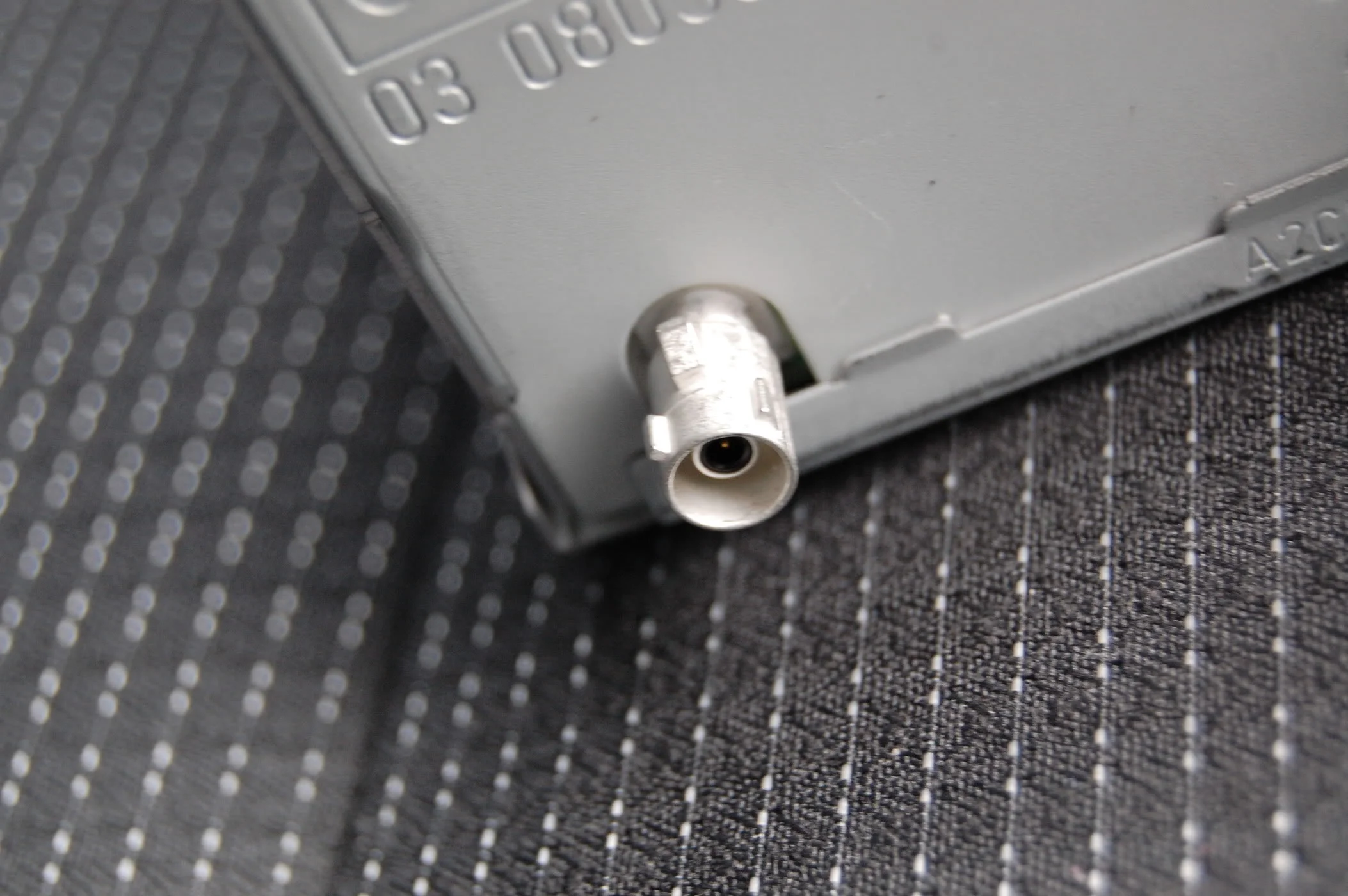

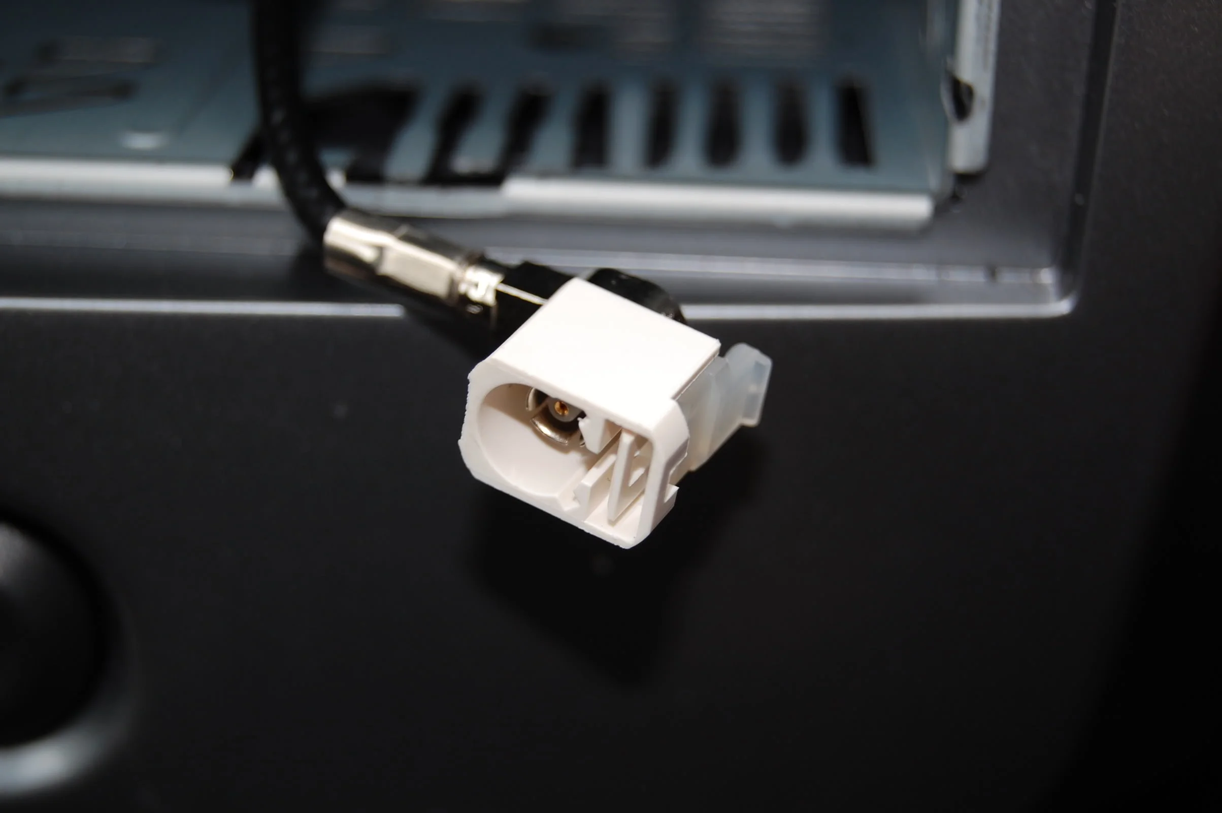

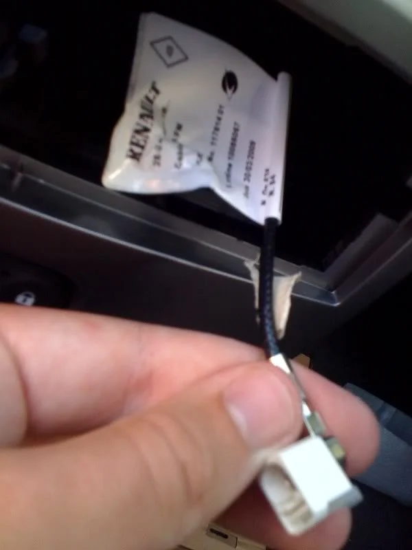

Okay so I got a new Alpine head unit. And it's fitted and all is fine. However what is the adapter for the Antenna i need. The HellFrauds system (and members on here) say the Mk3 needs no adapter. Evidently the Mk3 Ph2 DOES. Here's an iPhone pic of the what its got, i will take a good quality one tomorrow...

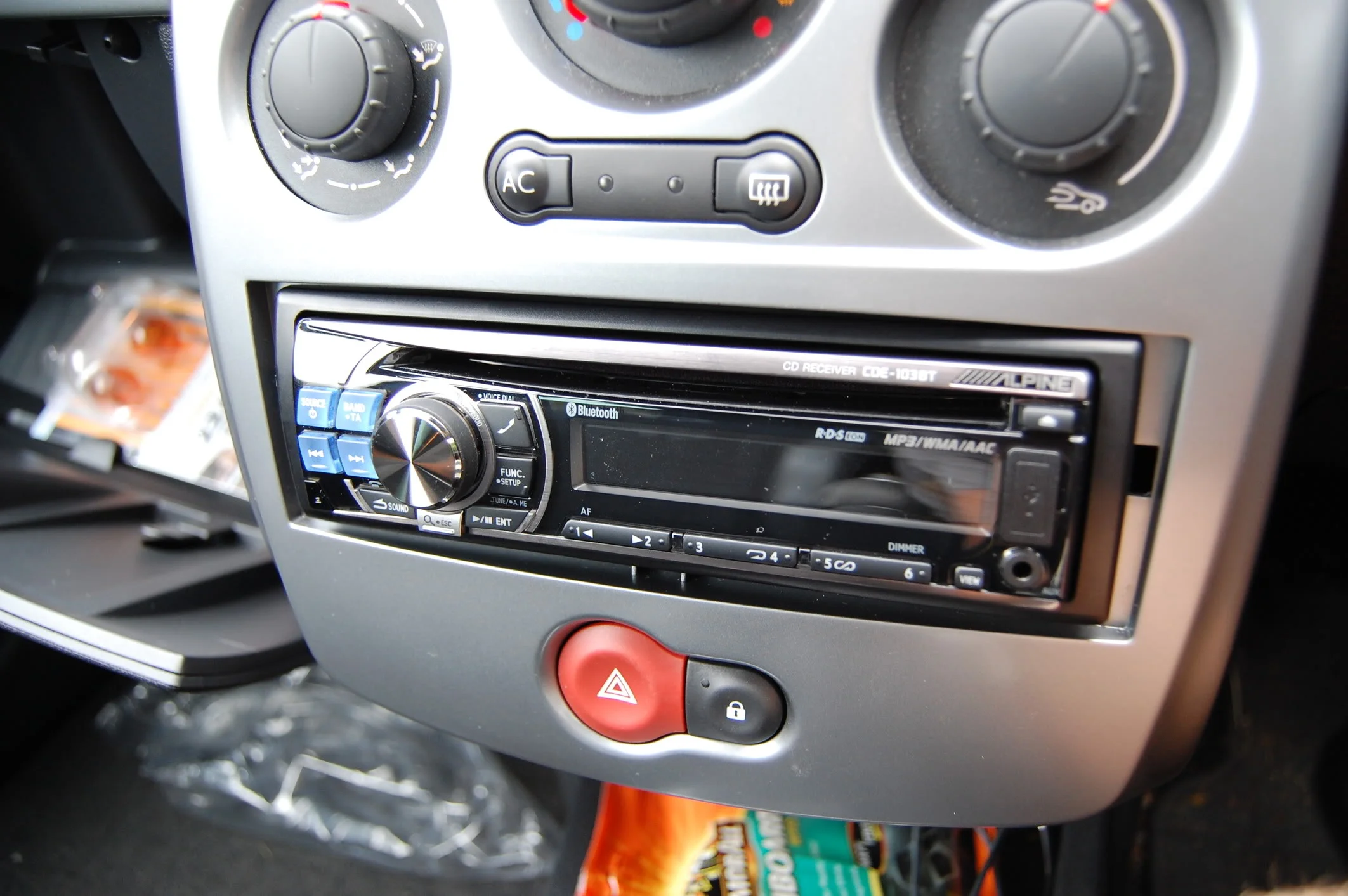

Secondly. The Head unit has a gap all around the outside. Theres no fascia adapter for this? it doesnt cause a problem just looks untidy :(

Go to halfrauds, tell them you need an adapter, show them this picture, and a pic of the back of the head unit, bobs your monkhouse, they'll know exactly what one, as there is very few. Will only be a few quid. As for a facia, pic of what you mean?

Actually for the Fascia i believe the one used on the megane 2 should work :)
  Homo spec mazda
Yup megane 2 is the right one.
As for that connector.... Wtf. I work in hell too and havent seen that before

I really do not understand wtf it is, its almost like the one for a BMW/Mini iirc. So i will look at that :)
So now i have to take the cage out again for this fascia. SIGH.

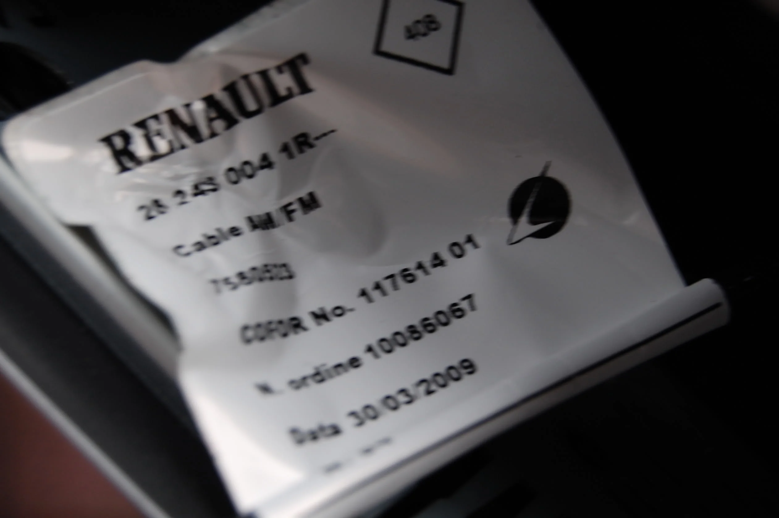

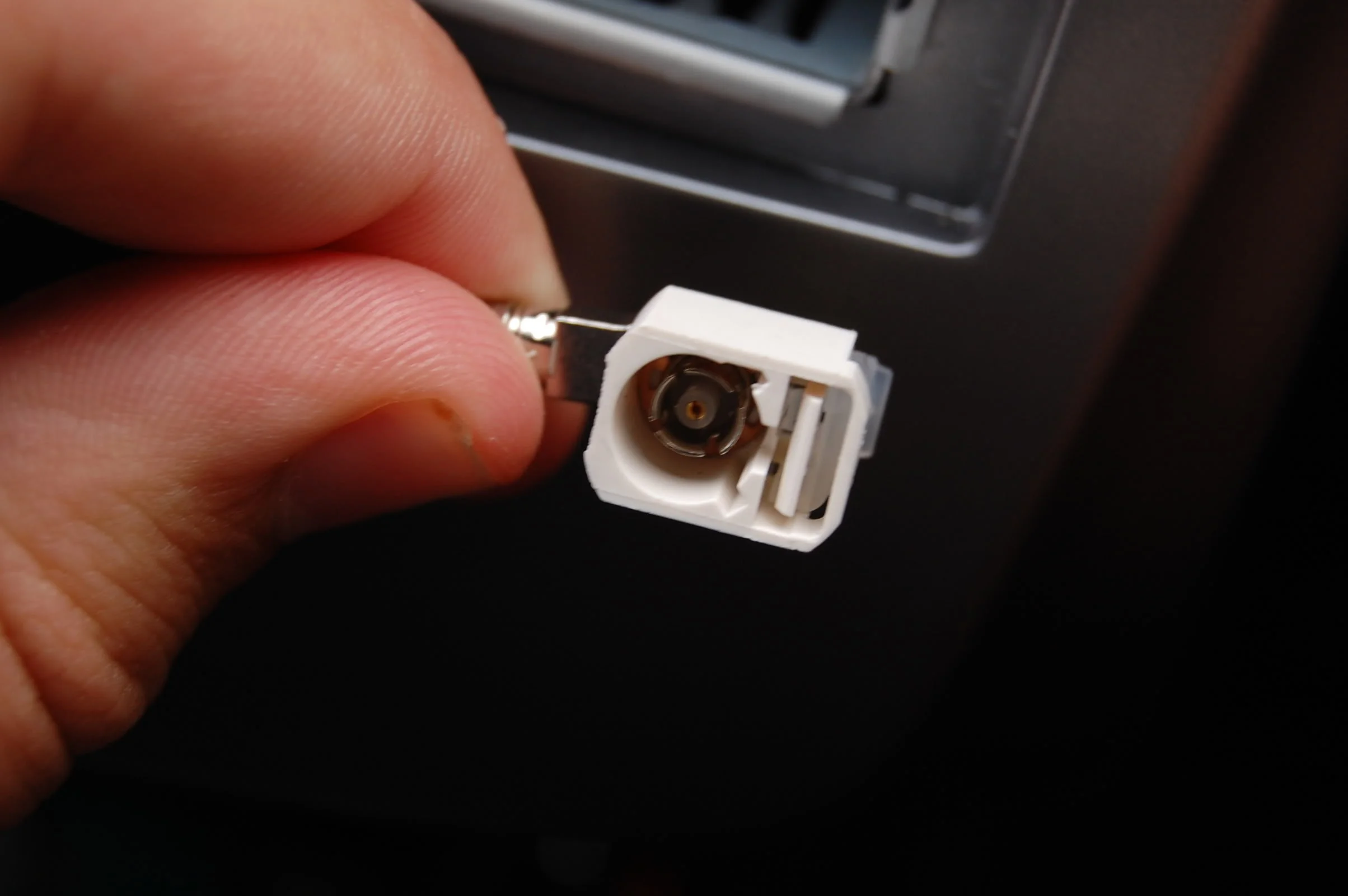

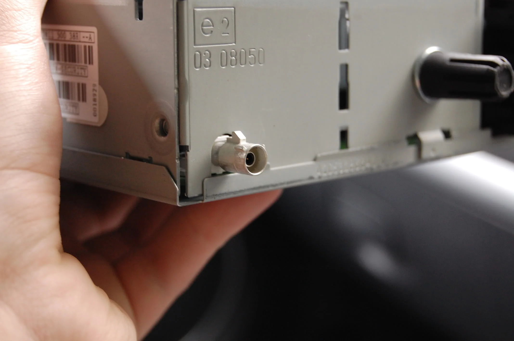

Okay took some detailed pics with the SLR...
This is the Label on the wire...

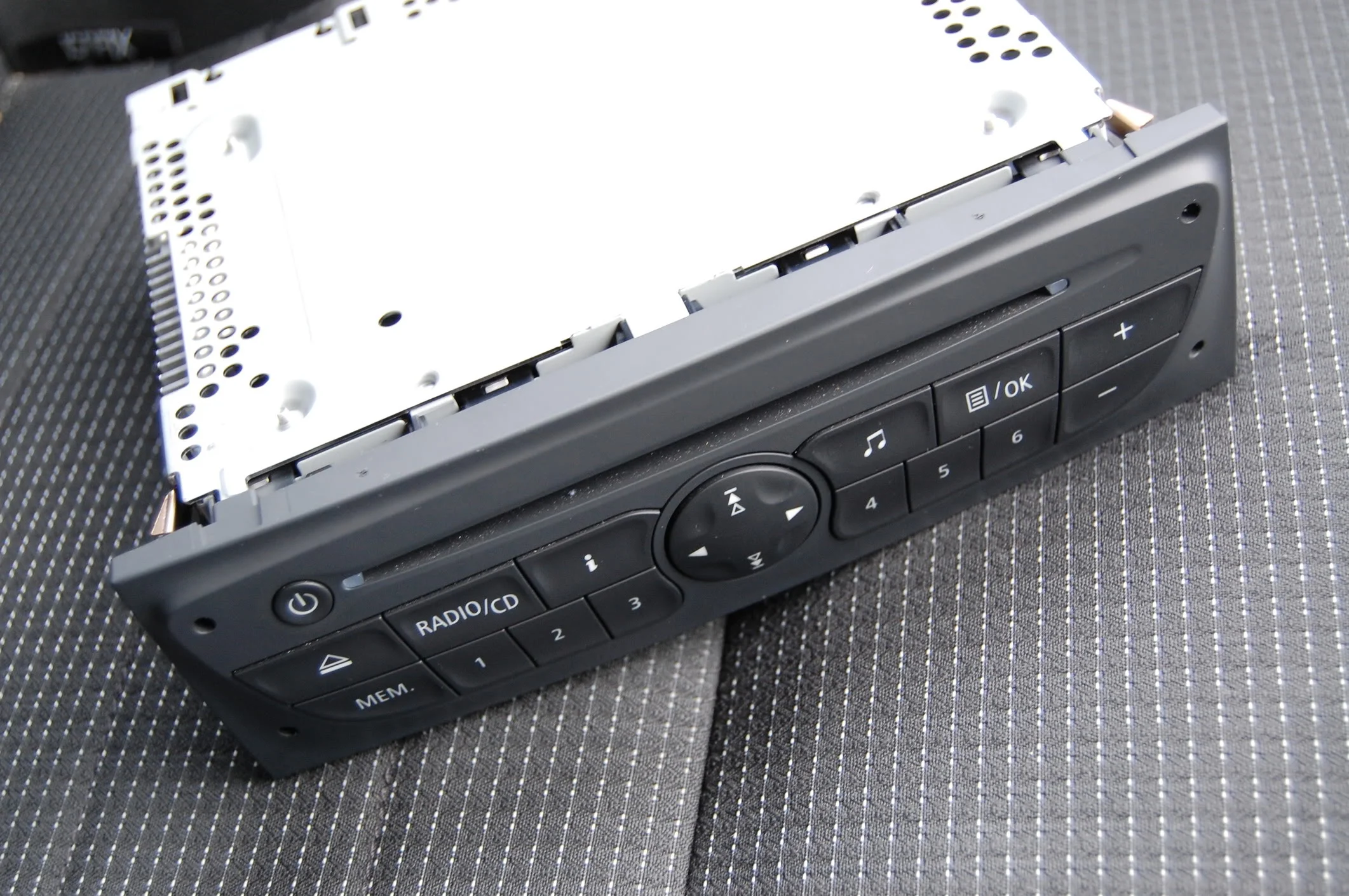

The back of the Renault HeadUnit.
The Renault HeadUnit
Alpine HeadUnit

FOUND.
ATTENTION NEW CLIO OWNERS
The adapter you WILL need is the same as the one you get for BMW/MINI 01>. Its PC5-100 (in my case PC5-101 because of the Alpine unit)

Here if you work in halfrauds then steal one of those adapters out of a dension i-pod adaptor after a fit. 50% of the time they arent used and they end up with a pile of them
  330Ci (Fail)Sport
Why did Renault change that?! My mk2 172 was the perfect connection fitting for the aerial.
