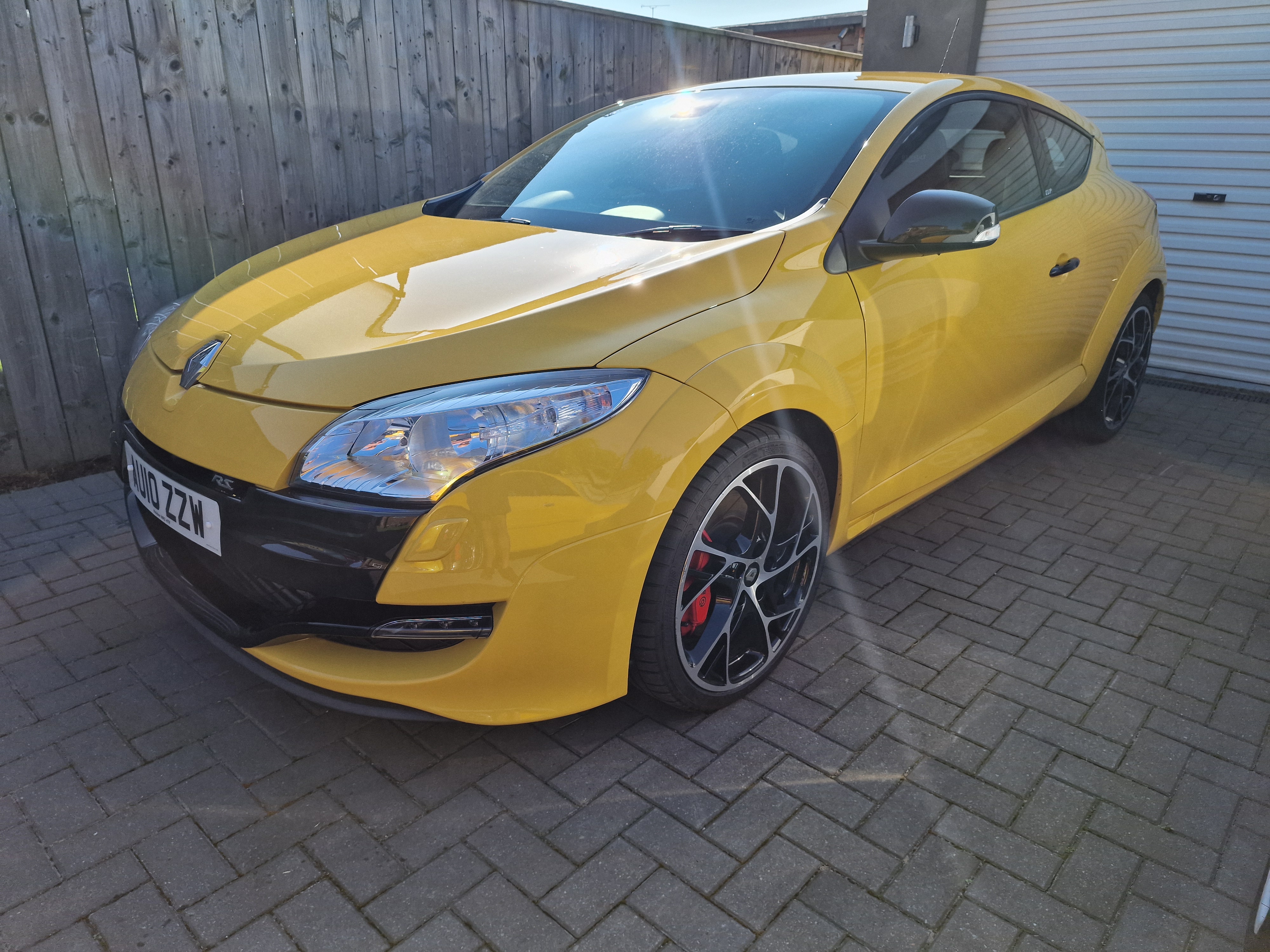

Another car in the collection and its another meg 250 cup.
Mrs fancied it and bought it. It was too good to turn down as only one owner from new, 17k on the clock, well specced with yellow dot recaros and a couple of mods, 3" ktec exhaust, forge intercooler, itg drop in filter and mapped by rstuning 325hp/360ft/lb.

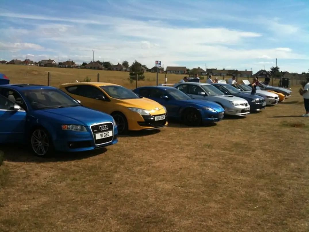

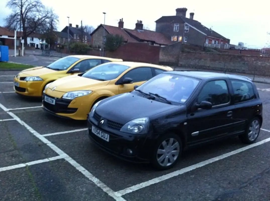

Browsing meganesport group on facebook in 2018 we see a pic of another sport yellow 10 reg 250 cup with 17'000 miles on, 1 owner and it looks mint and the owner is flirting with selling it, its garaged and laid up. We both thought that it would be unreal to buy, but at the time we had just got the old mk3 250 cup and were happy/couldnt be arsed selling it to buy another the same colour.
Anyway yel cup gives us a bit of bother from the off, needing new suspension etc, fitted bc coilovers and instantly hated them. This takes the shine off the car massively but i put it right, spend a small fortune on new oem bits and then its sold August 2020.

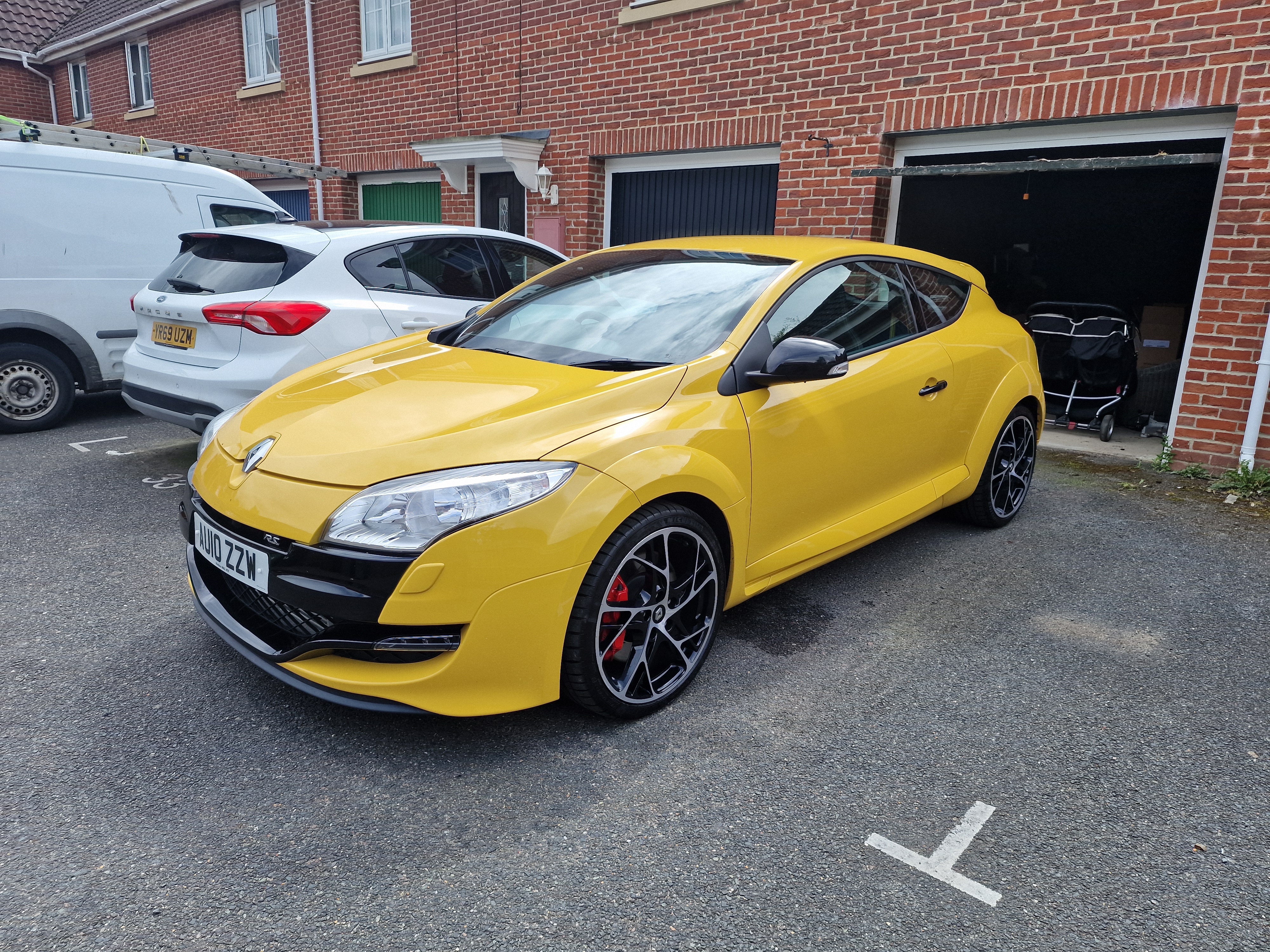

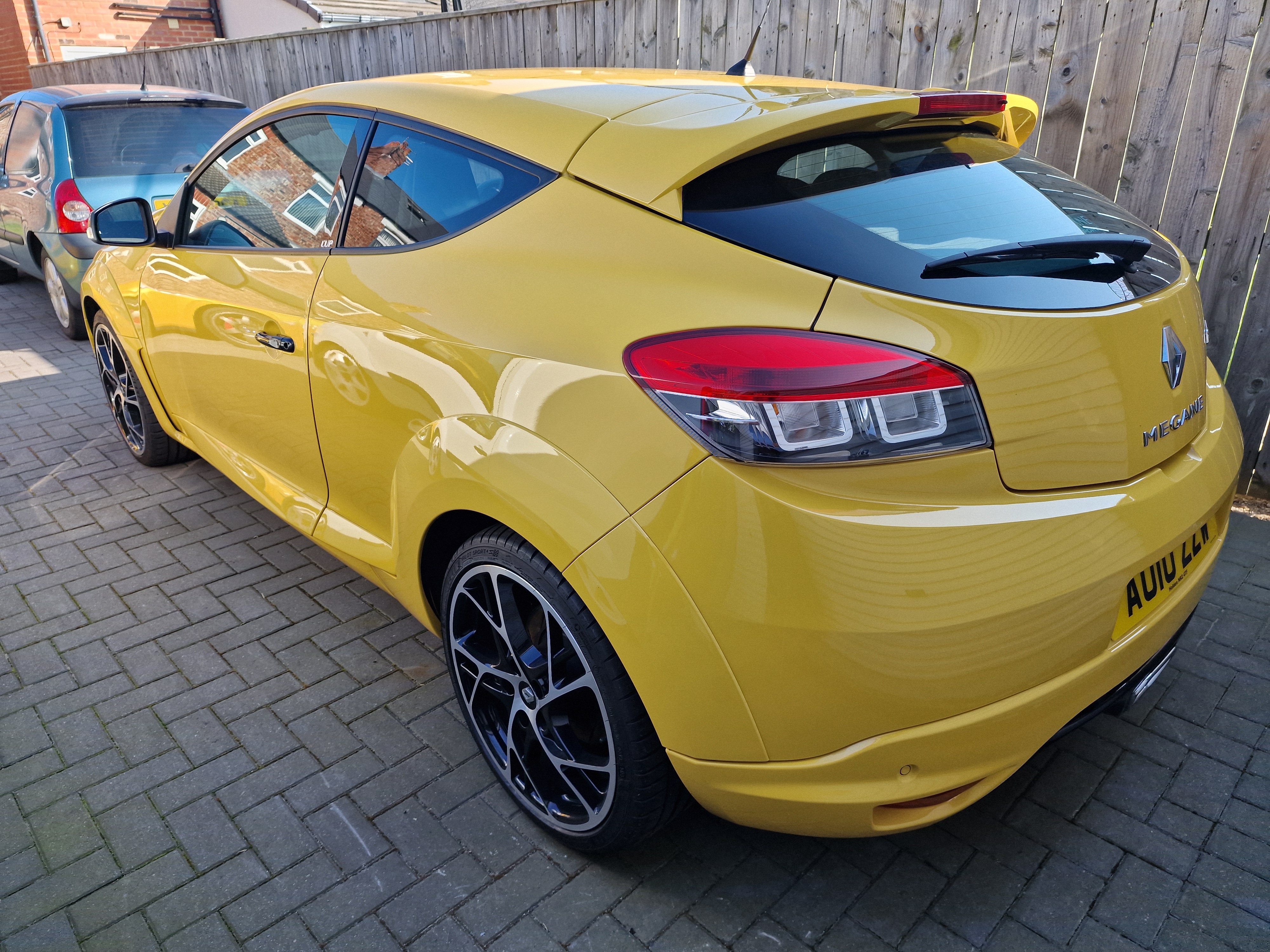

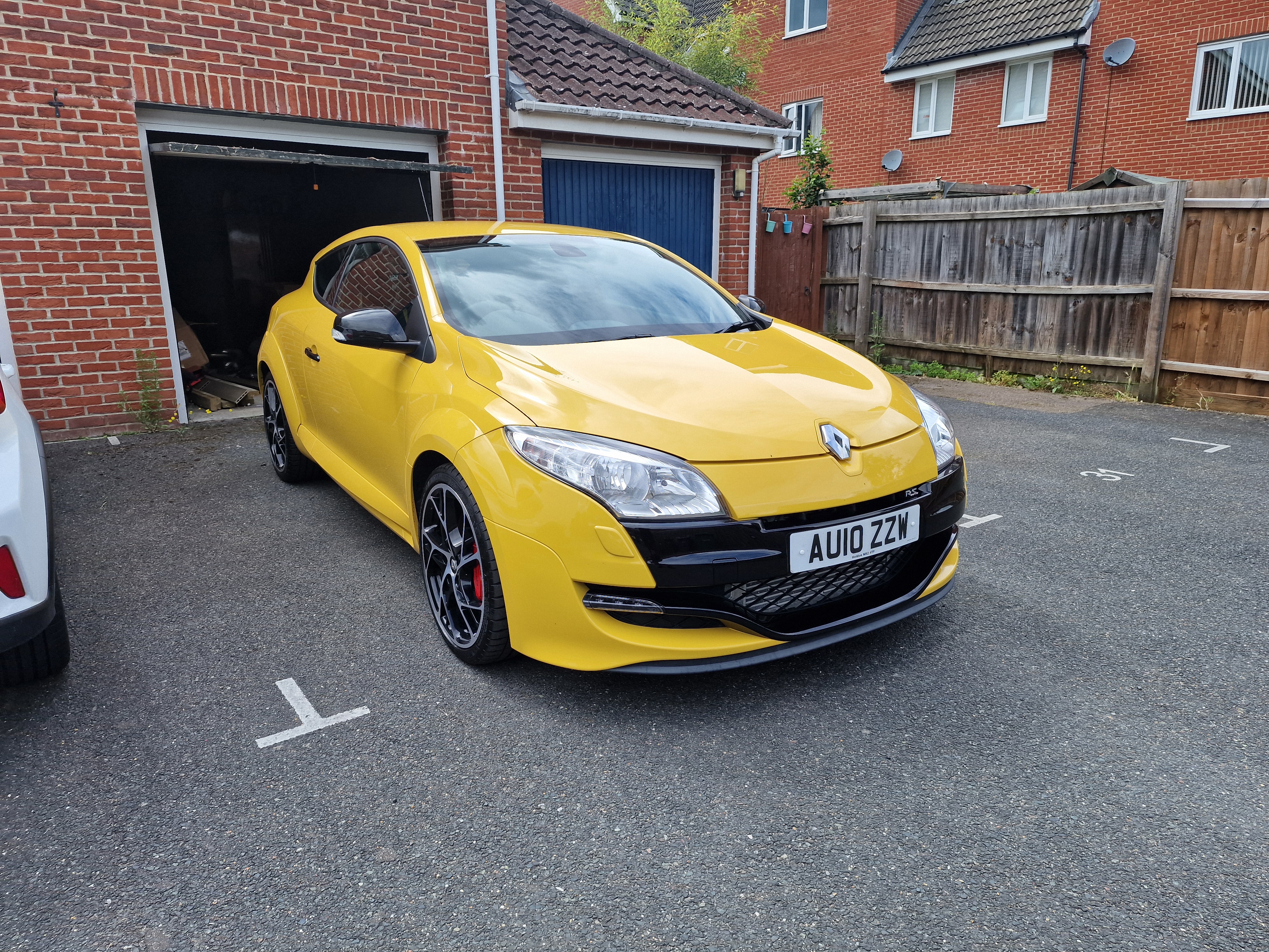

First view
Get chatting to the owner and ask for a test drive. Took it down some b roads and its just like a new car, everything is tight and rattle free. Goes and sounds loads better than the old one.
Owner says the boot has never been used. Rear seats have never been used. Hes just had it recomissioned with near 3k bill after 8 years dormant in a nice dry garage. Its had cambelt, aux kit, all fluids flushed for fresh, new battery and fresh brake pads/fluid, brand new Michelin PS4S all round and the bill in total was close to 3k for the pleasure. Hes done a handful of miles since recomission and his mrs wont get in it as she gets travel sick, and hes out of the car/renault scene so its just sat there doing nothing basically.
Looking at the paperwork and its got original bill of sale, showing options checked (all important recaros and cup chassis, floor mats, 19" Steev wheels, Rs monitor. Drl's, dual climate etc). All the sales packs that come with it are present, basically everything you get new. Its still wearing its original dealer stamped plates and key ring on the spare key. The original exhaust and intercooler are available to go with it. A price is agreed, paid for and i load up the spares into the R26.

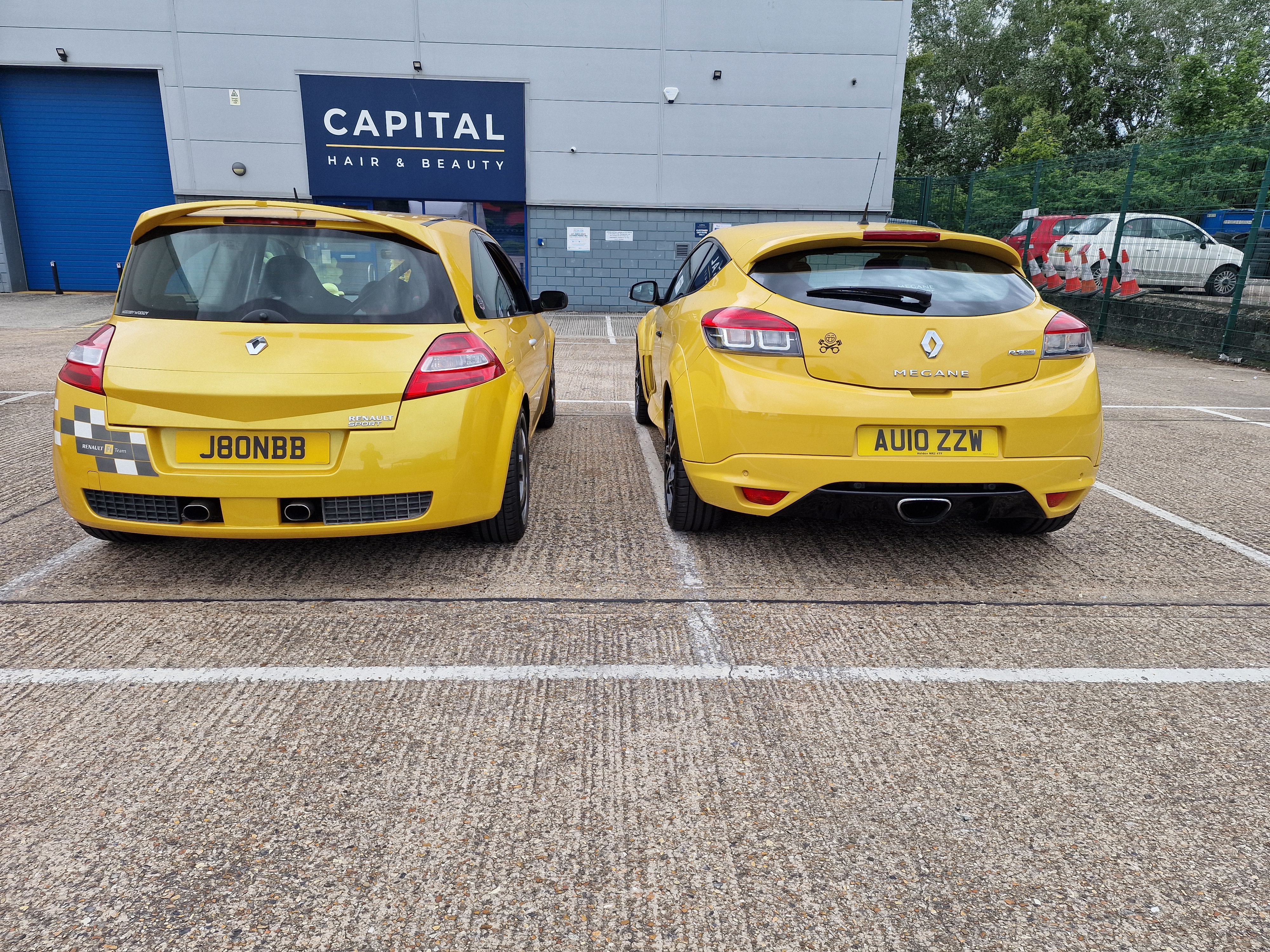

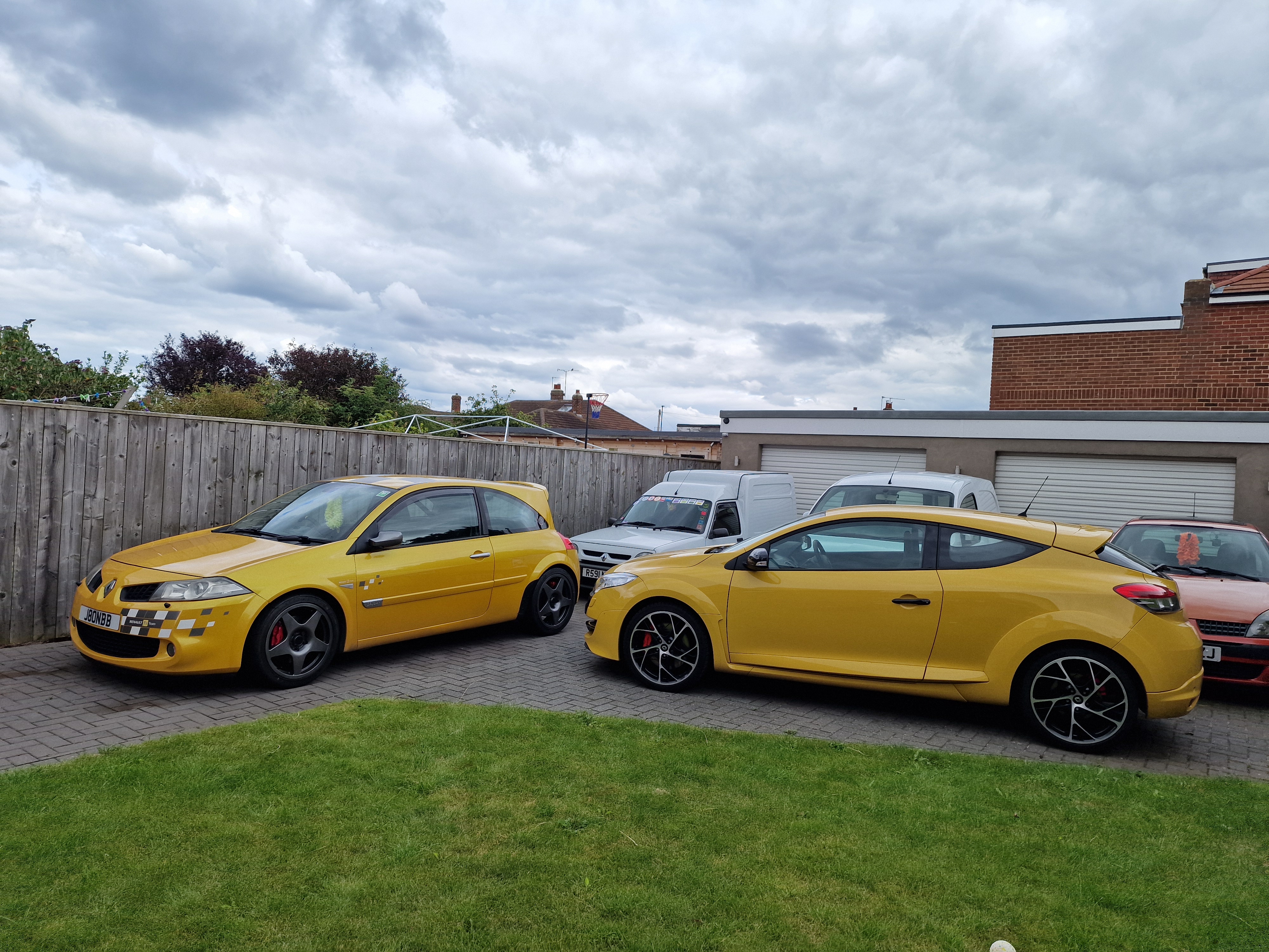

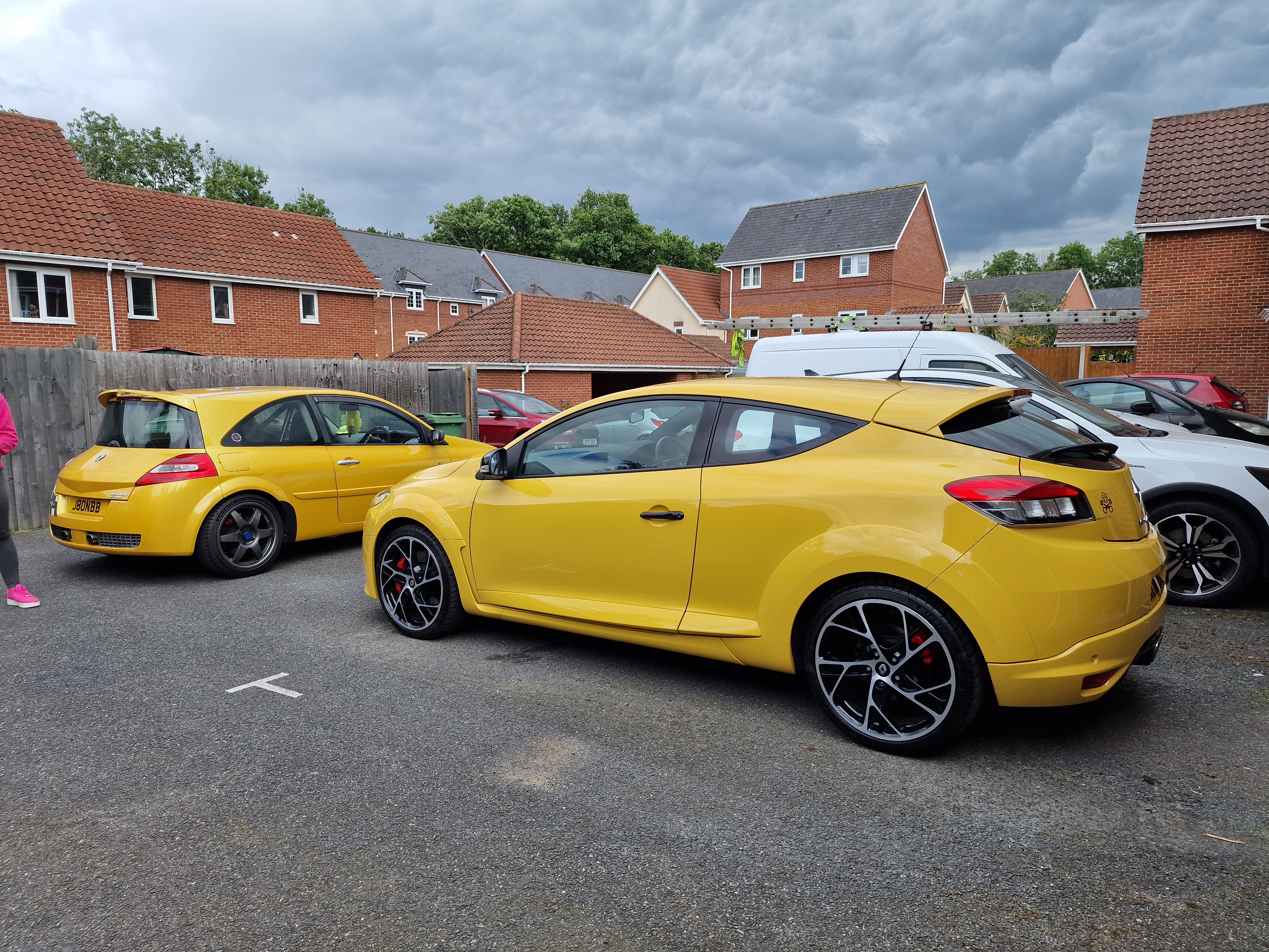

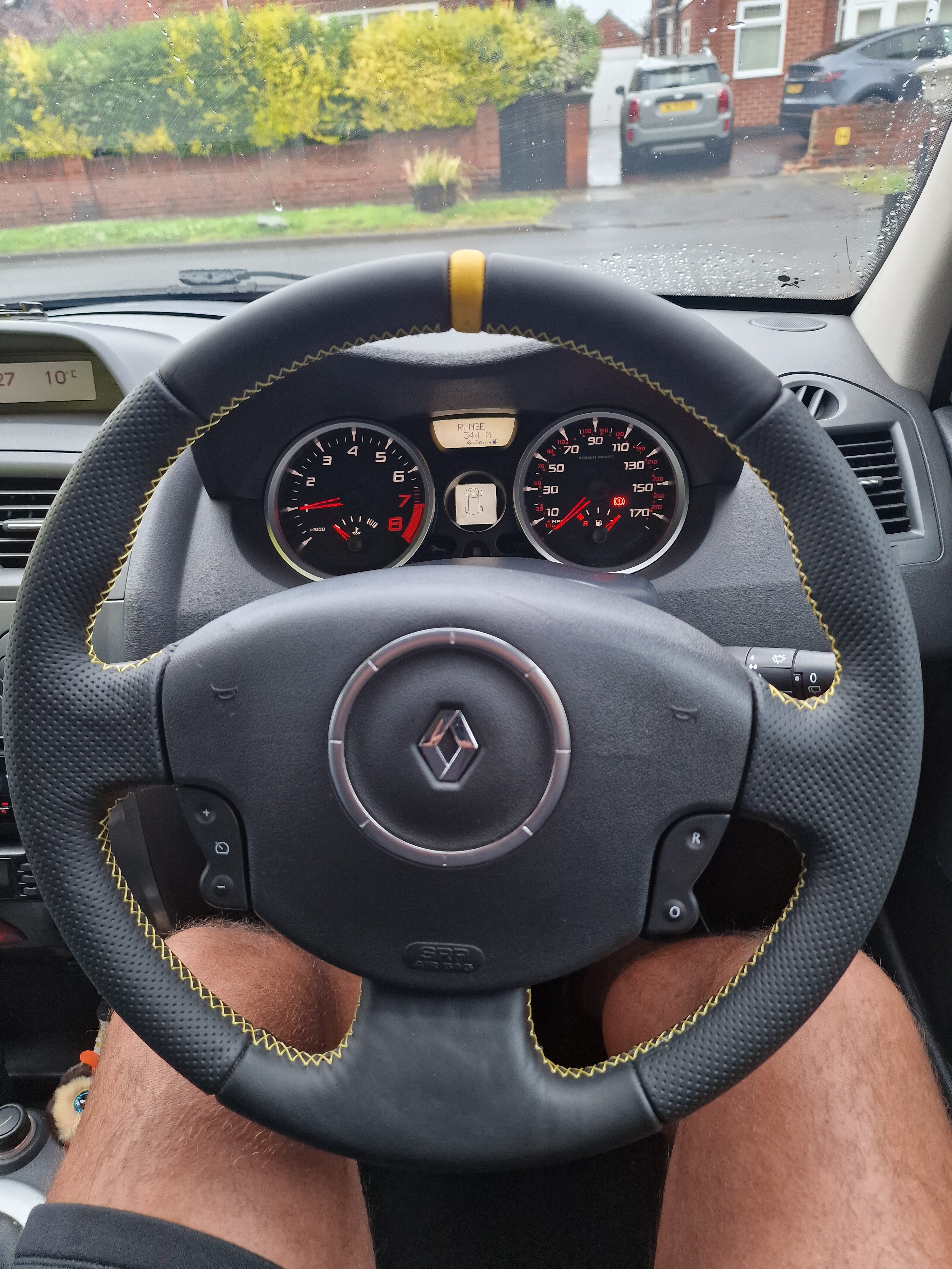

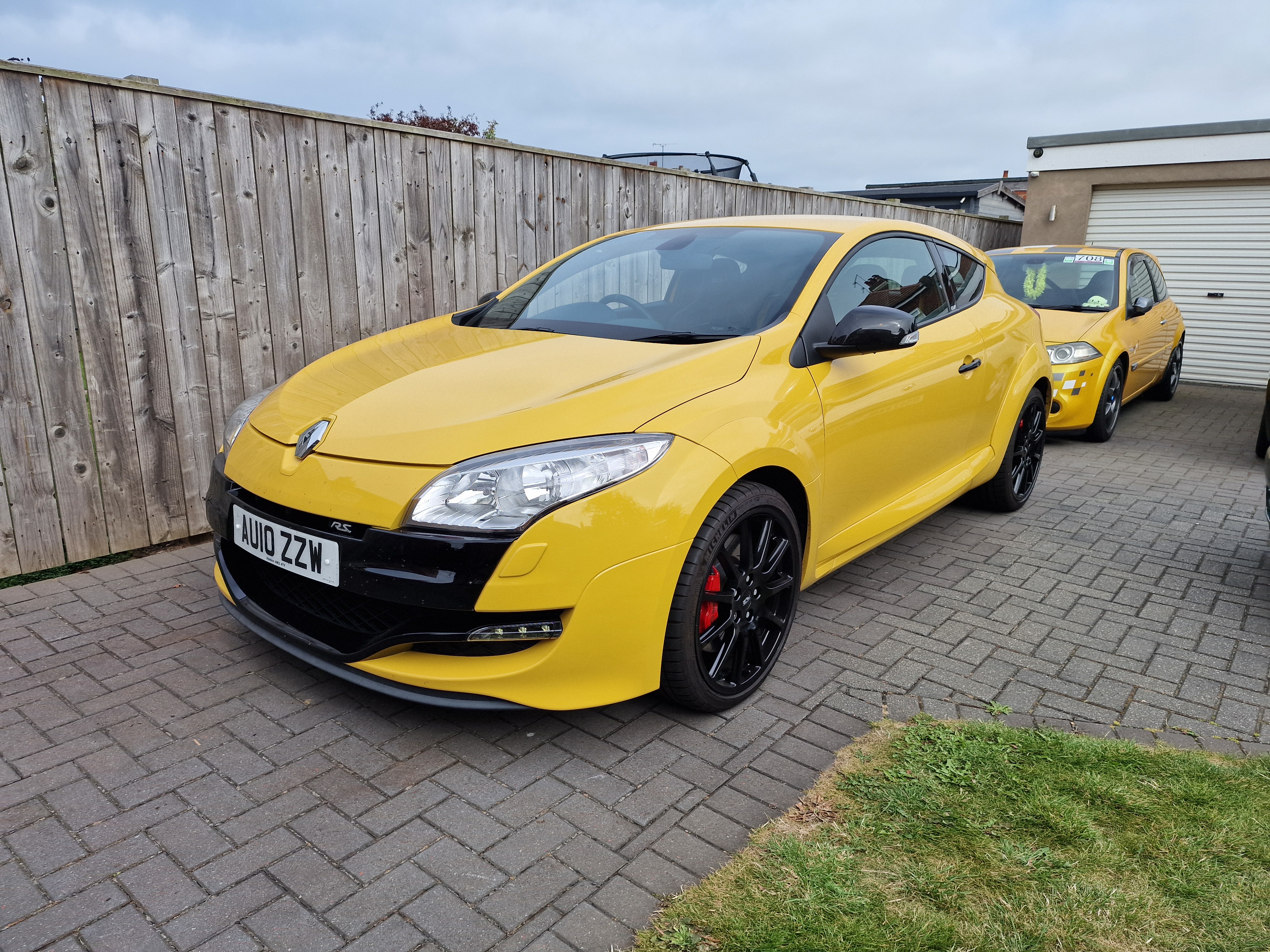

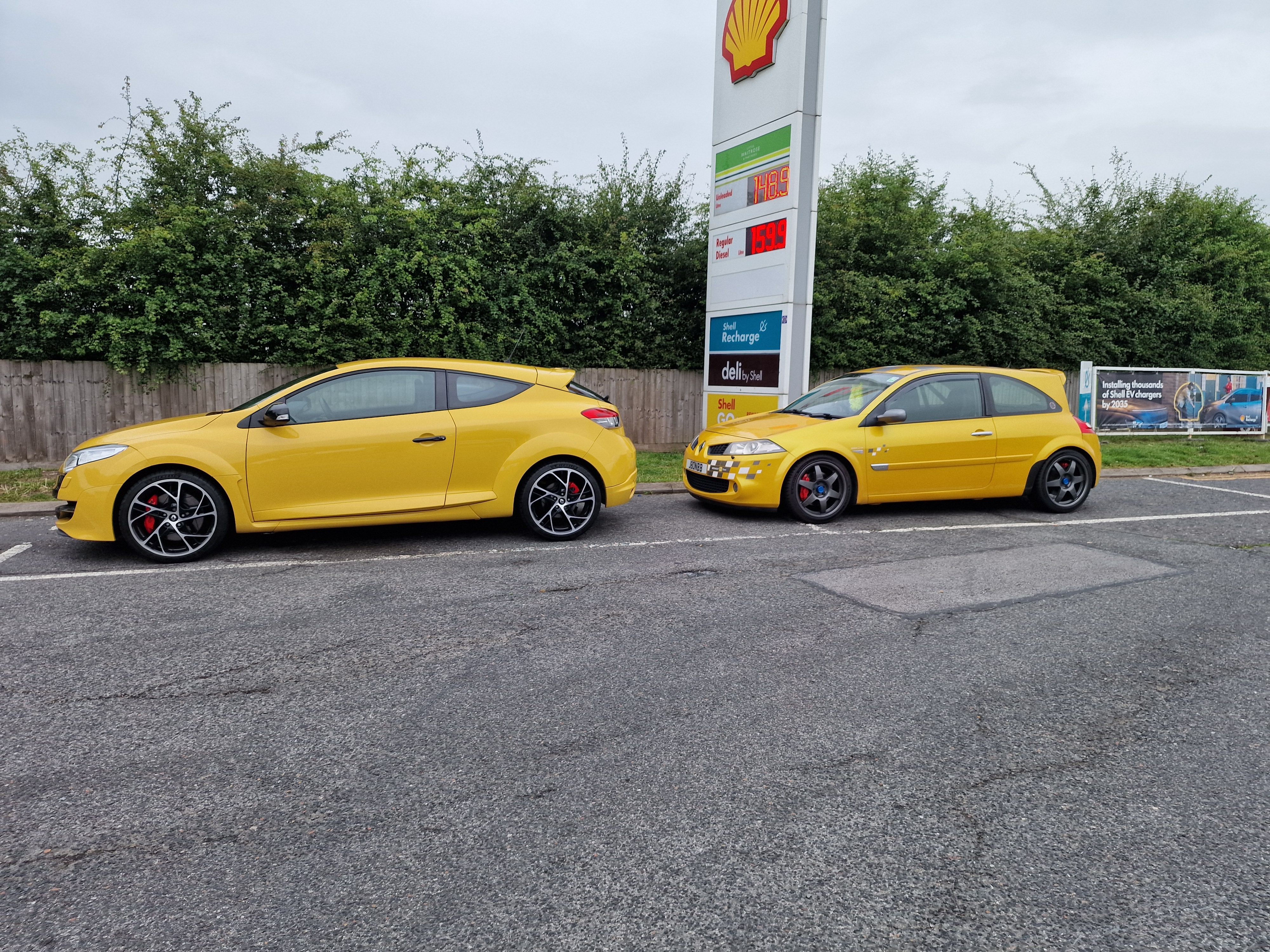

Old vs new.
Fill up with Vpower as thats all that we can find local. Journey is uneventful with a couple of stops and it returns decent mpg, exhaust on it sounds mega on boost/sport mode with pops and bangs. Goes well and effortless to drive fast. Stock cup suspension is great on the b roads.
Double trouble.
With CSF a weeks away and i have a ton of other s**t to do to both vehicles i plan on taking its parked up until time is available. Mileage stops at 17777 on the drive!
Megane train

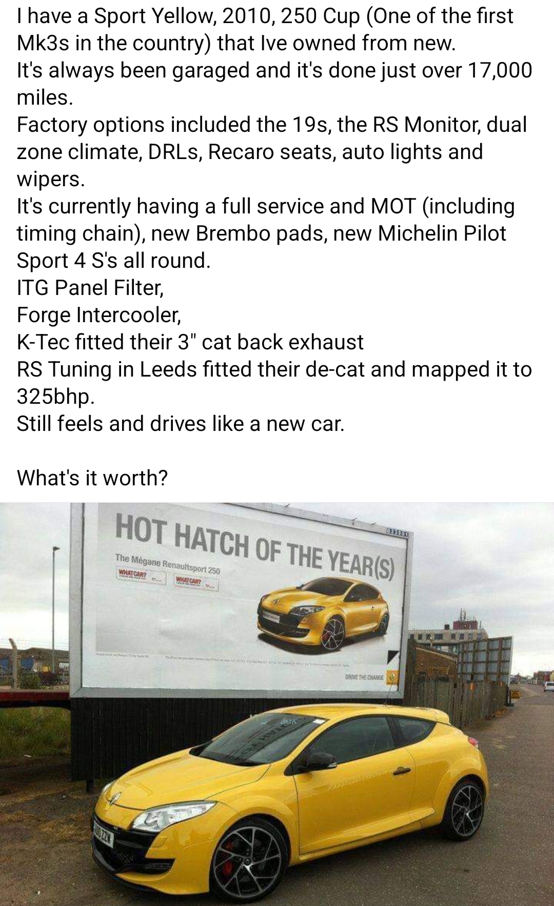

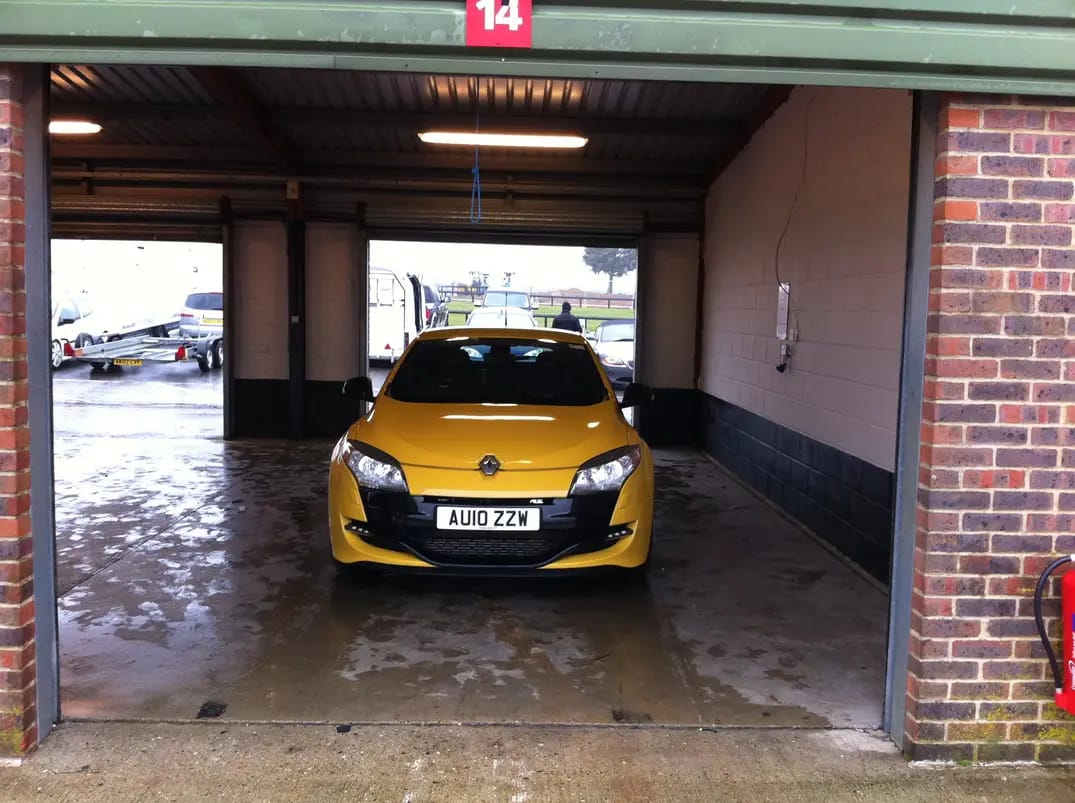

Previous owner had a ton of pics on his facebook that he let us download. Its great to know the full history from the off. Previous owner (PO) seen it on the back of the car transporter whilst at work waiting for it to be delivered.

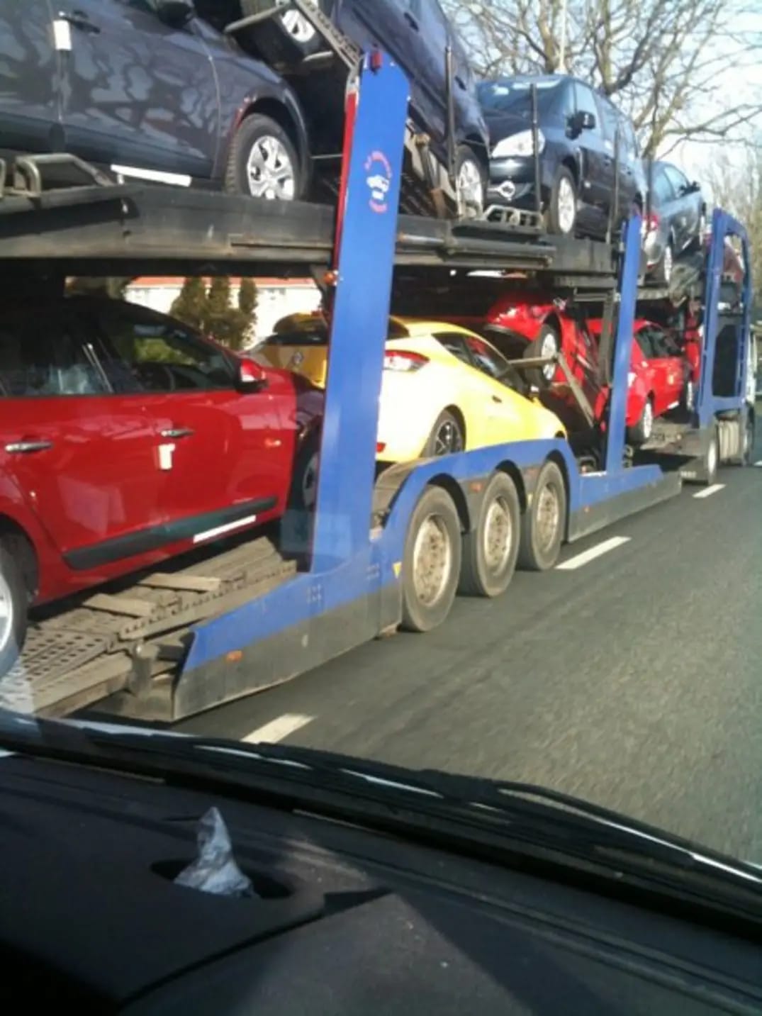

In transport for delivery. PO was waiting for delivery and seen it go past in Norwich so spun round and got a pic. How good would that be seeing your new Rs on route after waiting.

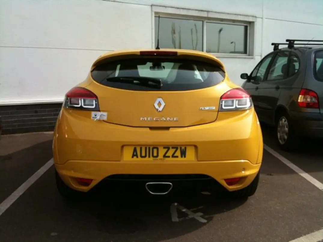

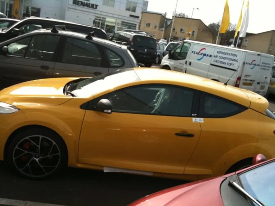

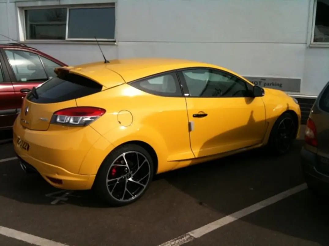

At Holden renault when delivered. Note the pre delivery protection on doors etc.

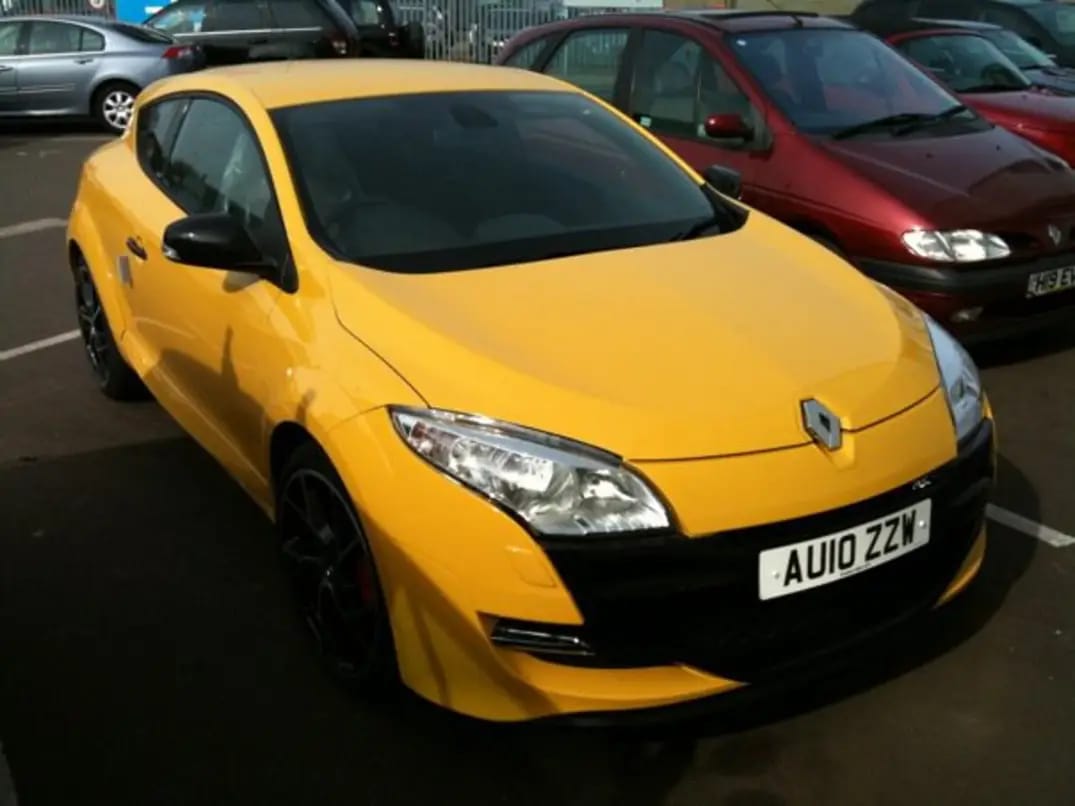

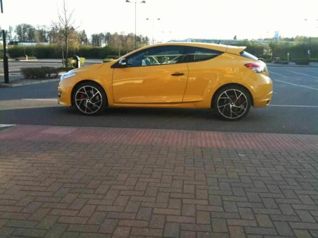

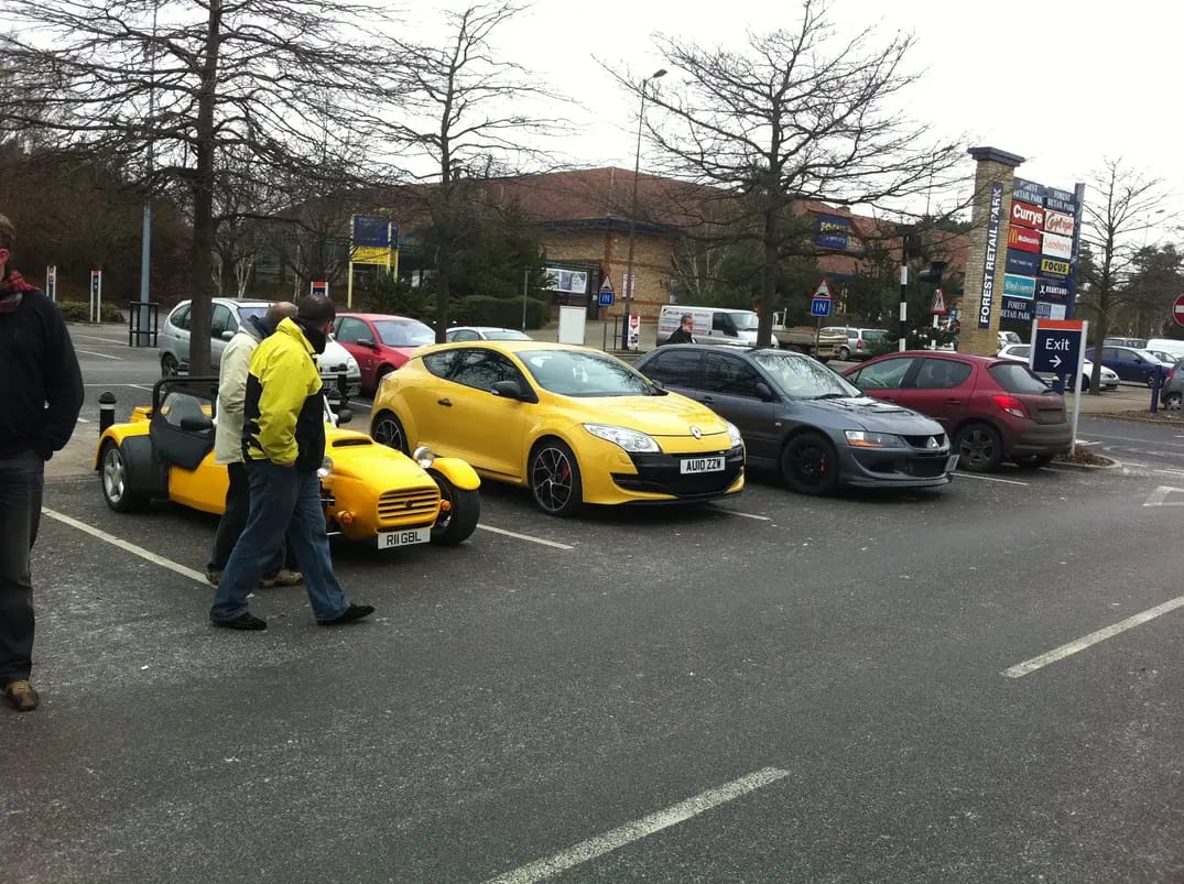

Not sure on date on this one but in the early years.

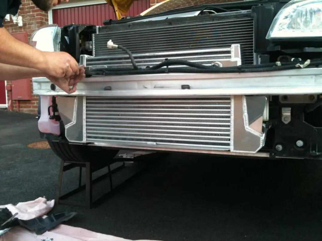

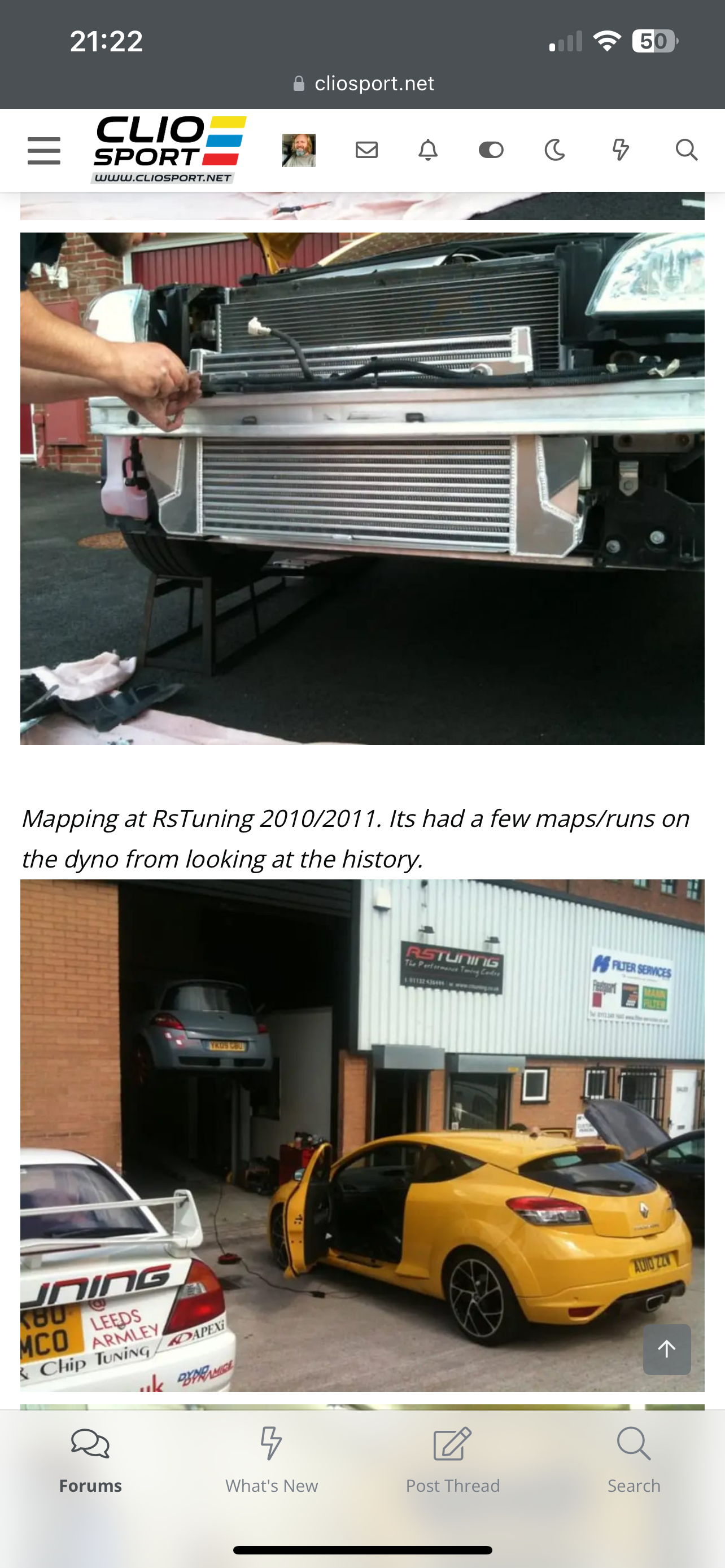

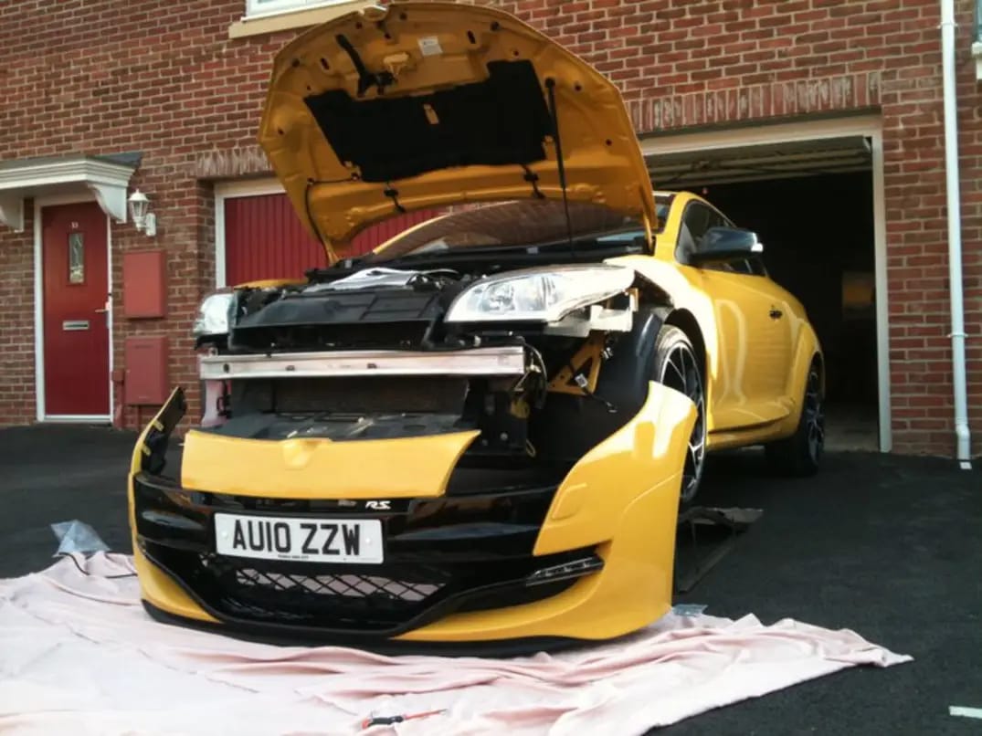

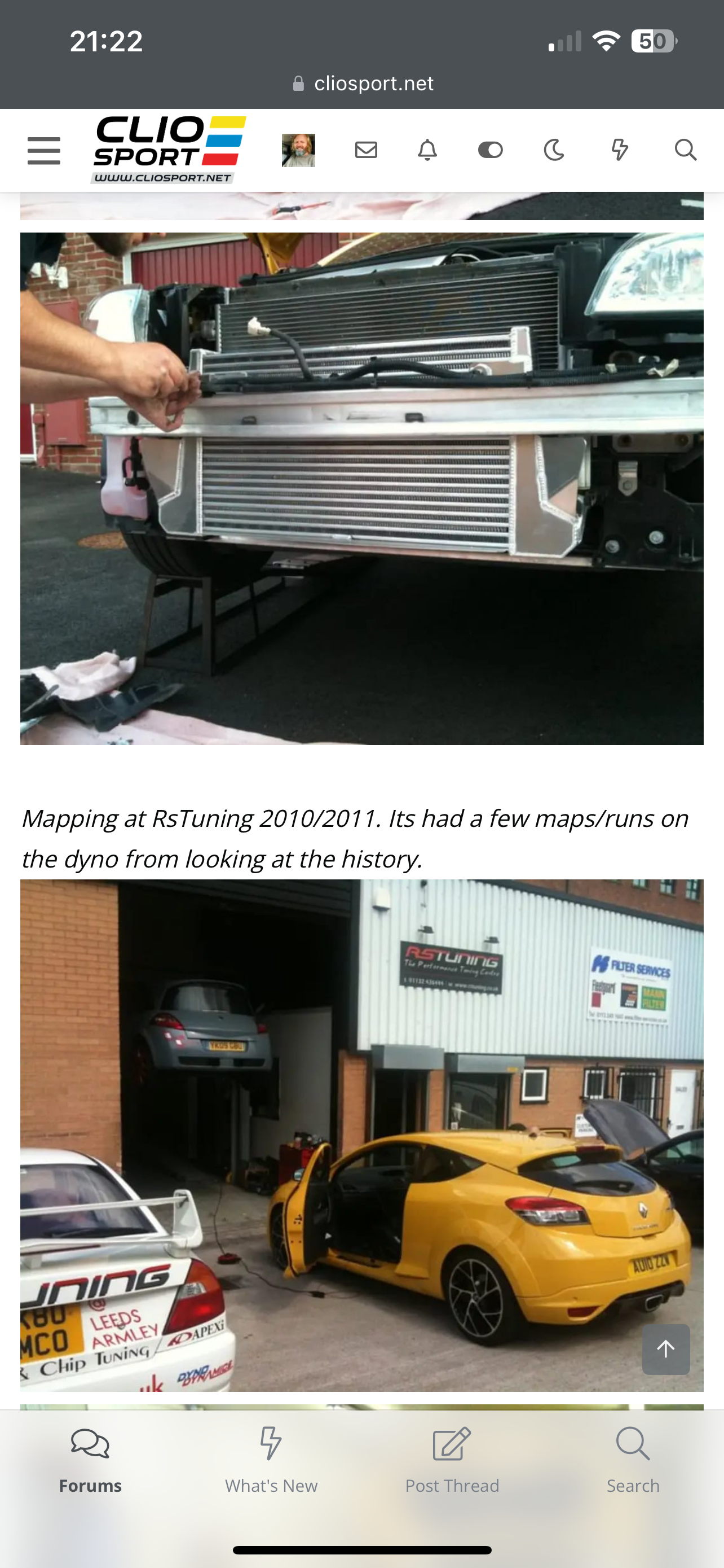

Forge intercooler fitting. PO said when this was bought/fitted years ago there was hardly any aftermarket parts as the car was only a year or so old.

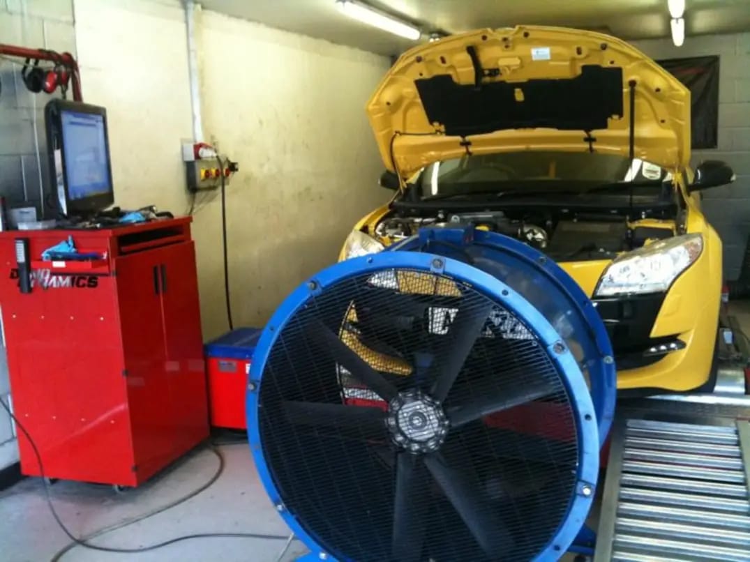

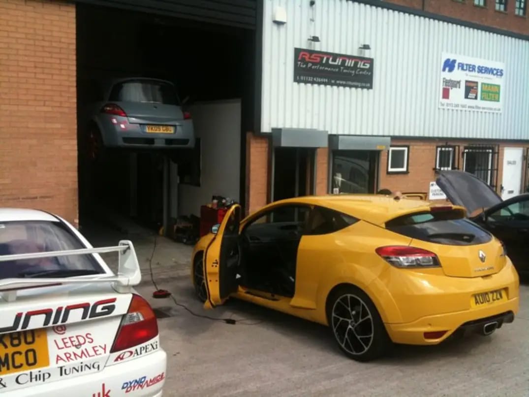

Mapping at RsTuning 2010/2011. Its had a few maps/runs on the dyno from looking at the history.

I can't imagine seeing your new car on the trailer to the dealer. Must've been a great feeling! You have a stunner there.

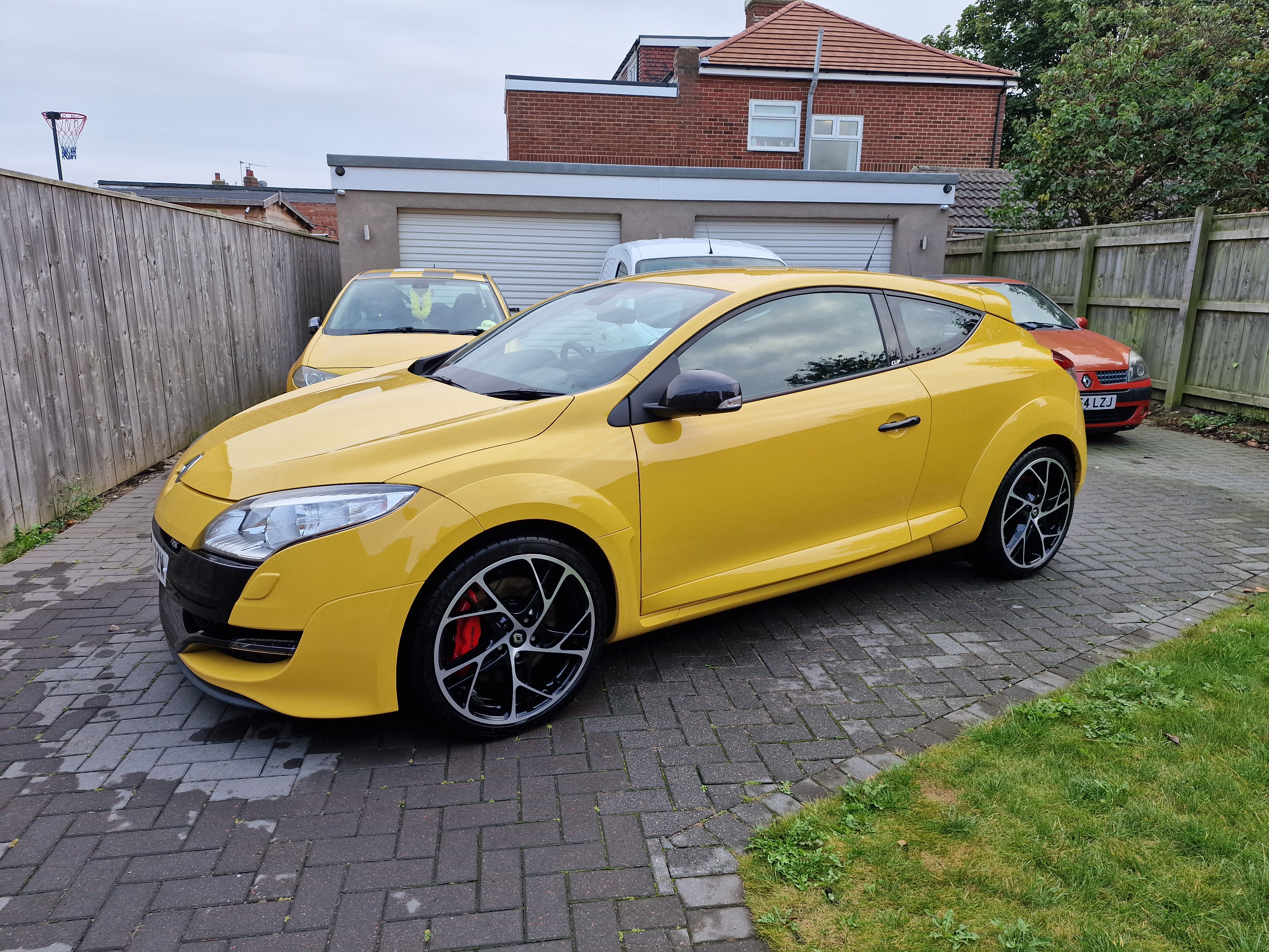

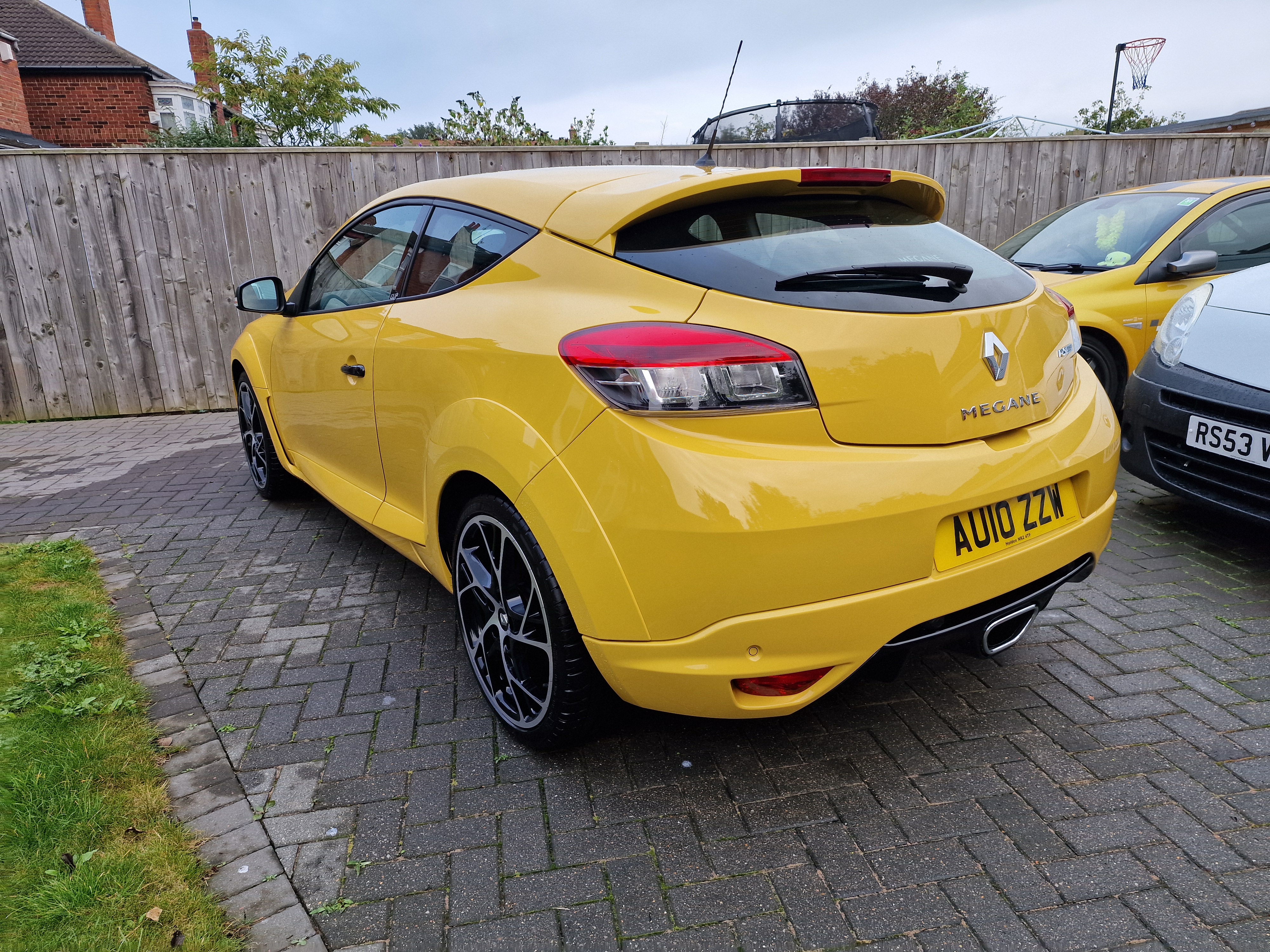

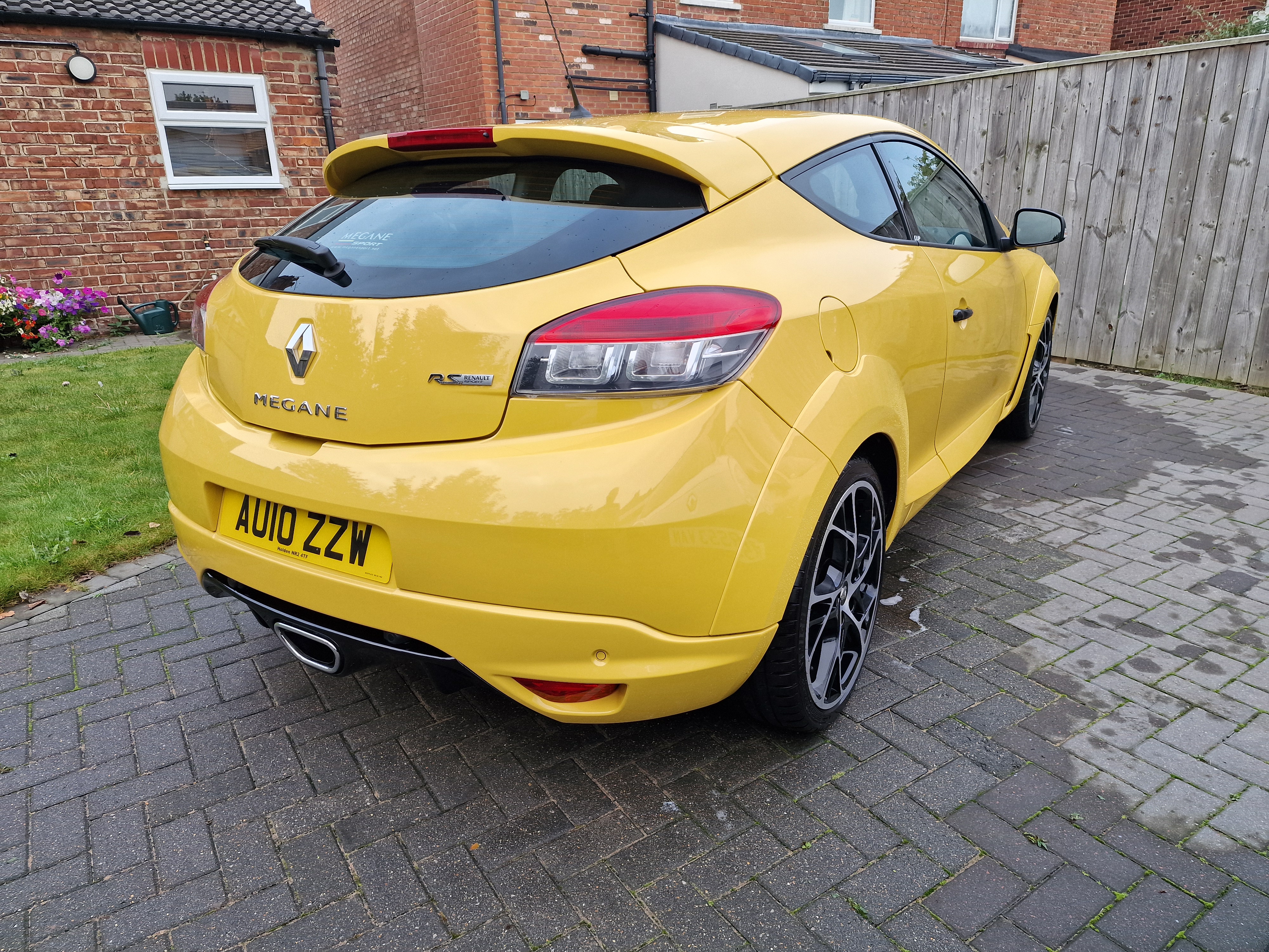

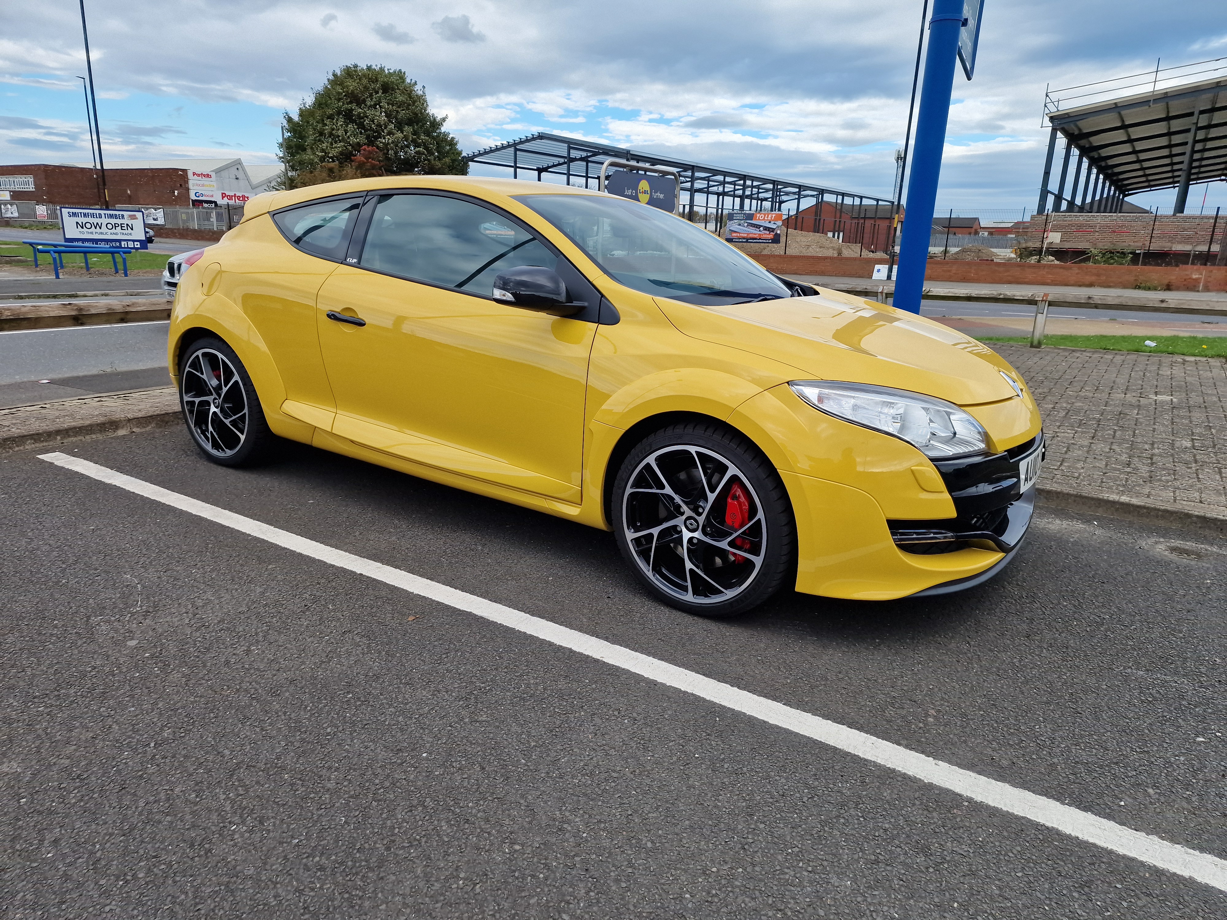

I managed to grab a hour to give it a clean earlier this week, evening wash when weather cooled off. First wash did not reveal any issues at all, bodywork needs a few bits of tar removing on lower sides and it needs some protection but will be going for a detail/ceramic coat soon so opted not to go too mad.

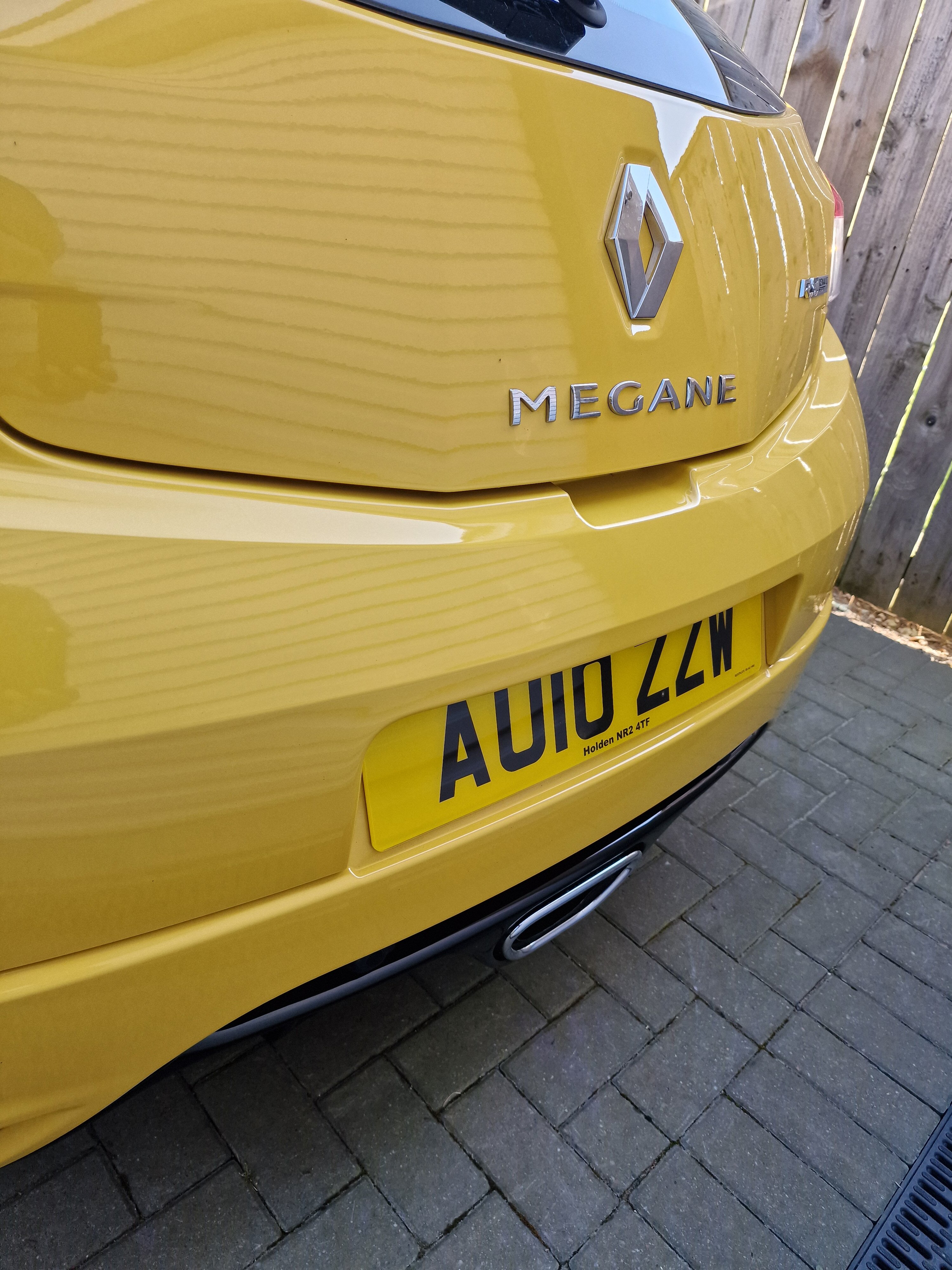

First job was remove the pistonheads sticker. I didnt mind it but had to go.
Mid sticker removal and sooty tailpipe trim.
Washed.
Brembo calipers and wheels still fresh.
Ph sticker removed and tailpipe surround cleaned.

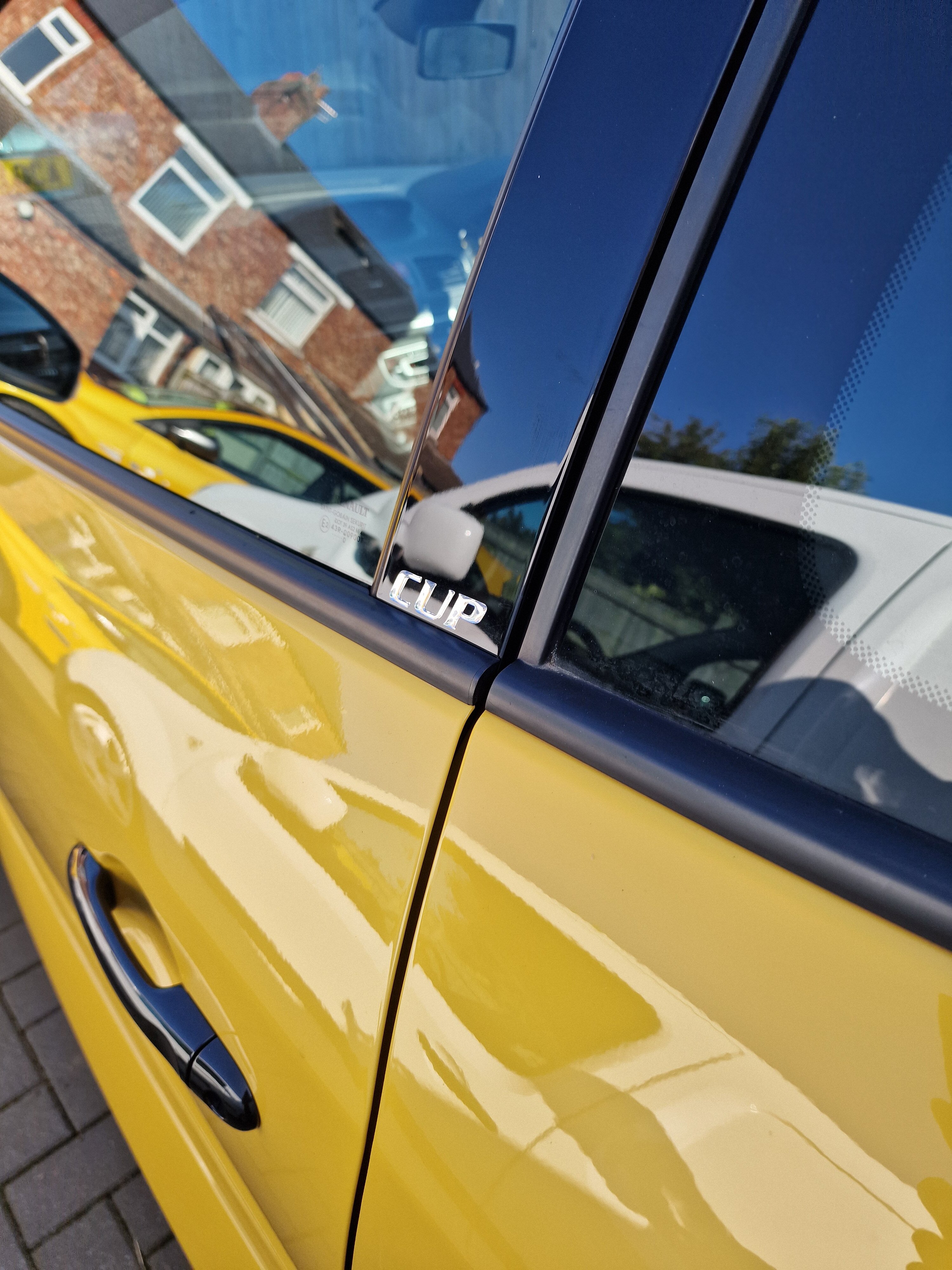

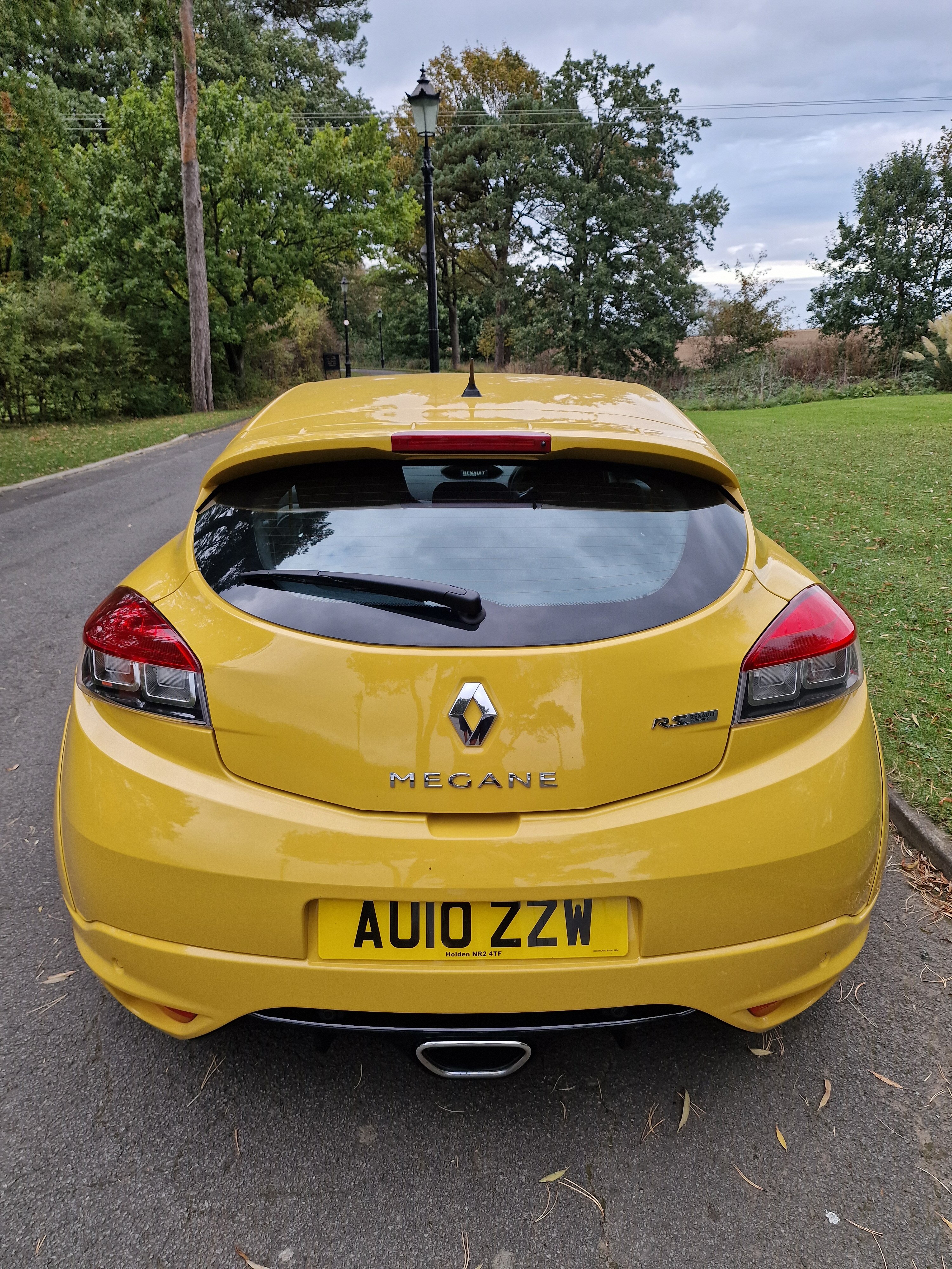

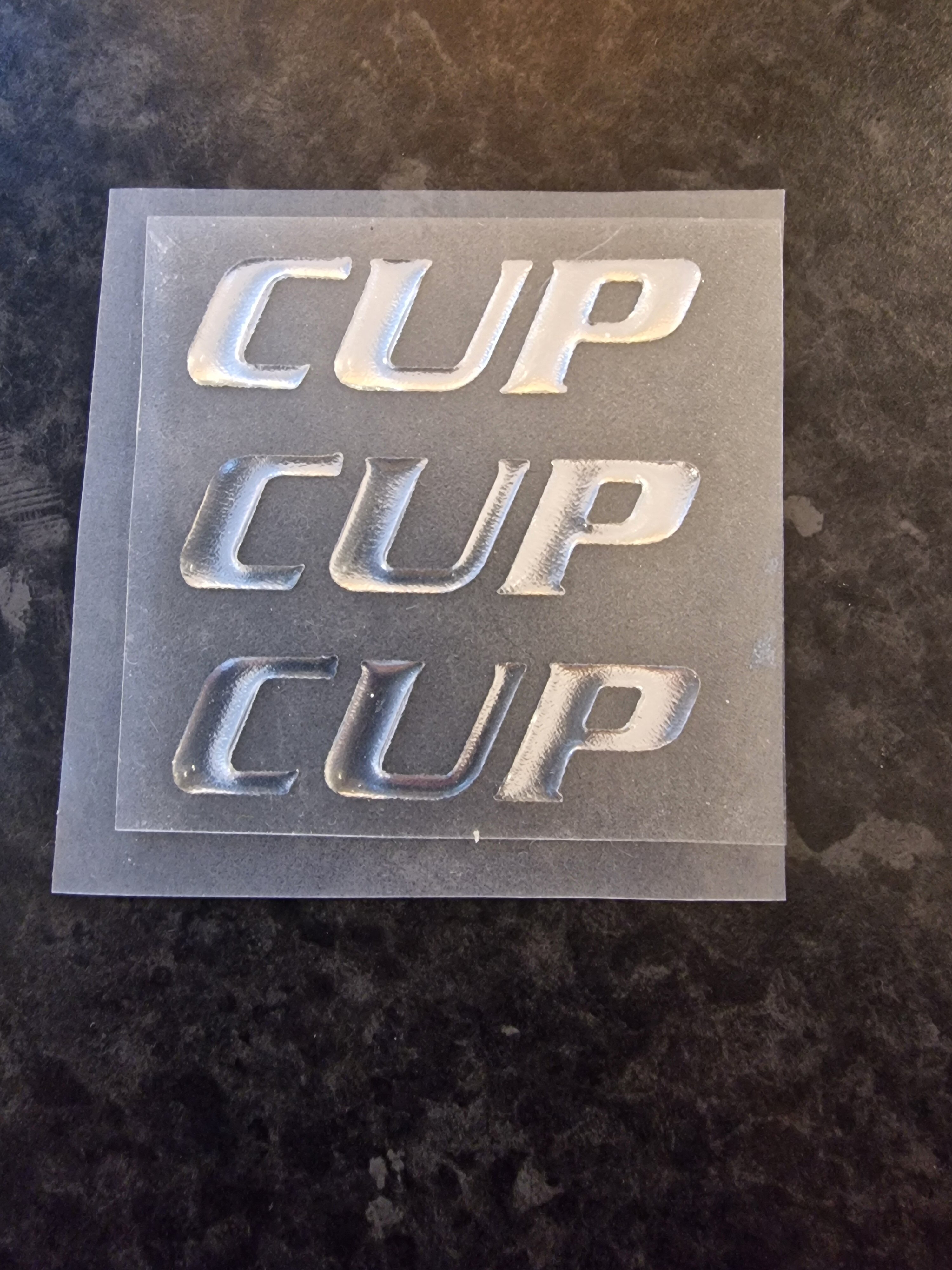

The eagle eyed might have noticed the cup badges were on the pre delivery pics but not on the pics after. Previous owner didnt like them so got the dealer to remove. We personally like the cup badges and wanted to reinstate them, however they are NLA from renault and rocking horse s**t to find.
After a bit of sniffing around i found out they are the same badge on Clio mk3 Rs200 cup. More digging revealed somebody had copied them perfectly and Taylor Made Decals were producing them. Got in touch and he had them in stock and reasonable price £20 for a pair delivered.
New cup badges.
Fitted, look spot on.

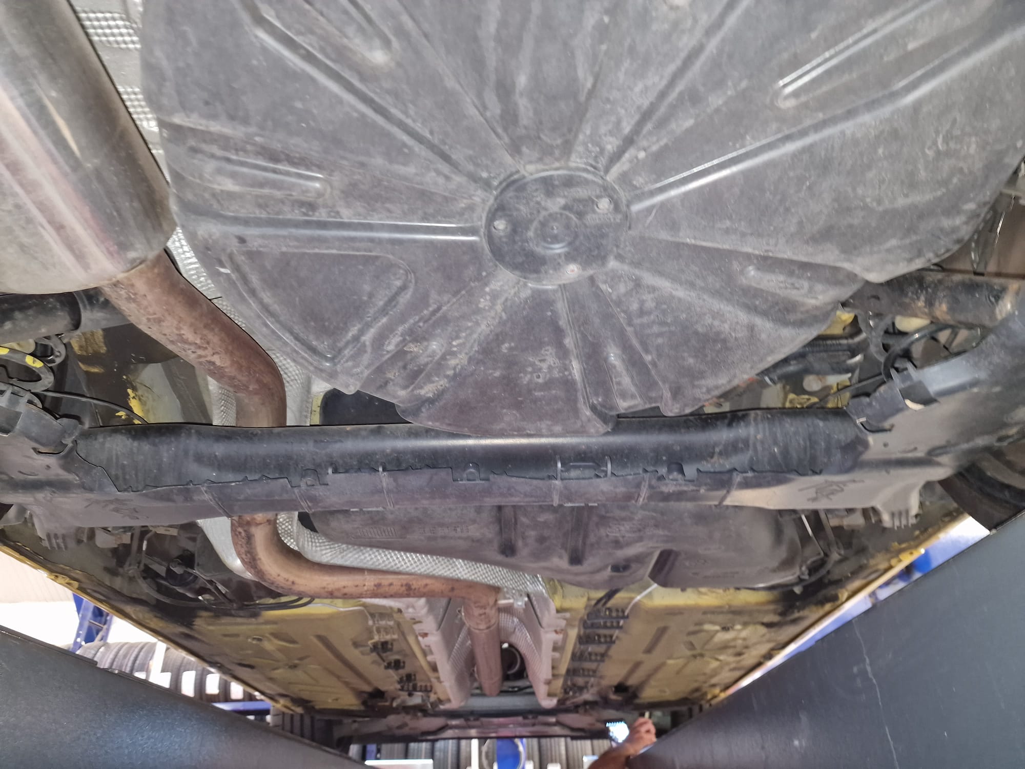

Only had a quick look underneath, its super clean. Ill wash this down on a lift and lanoguard it all to preserve.
Clean.

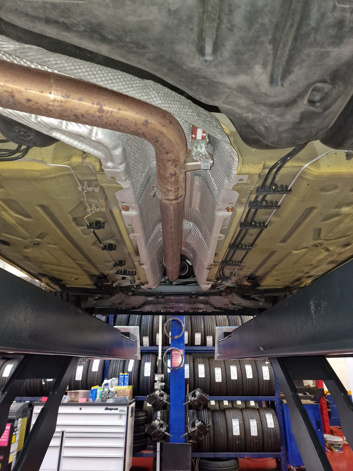

Updates.
Used the 250 a couple of times recently and all good.

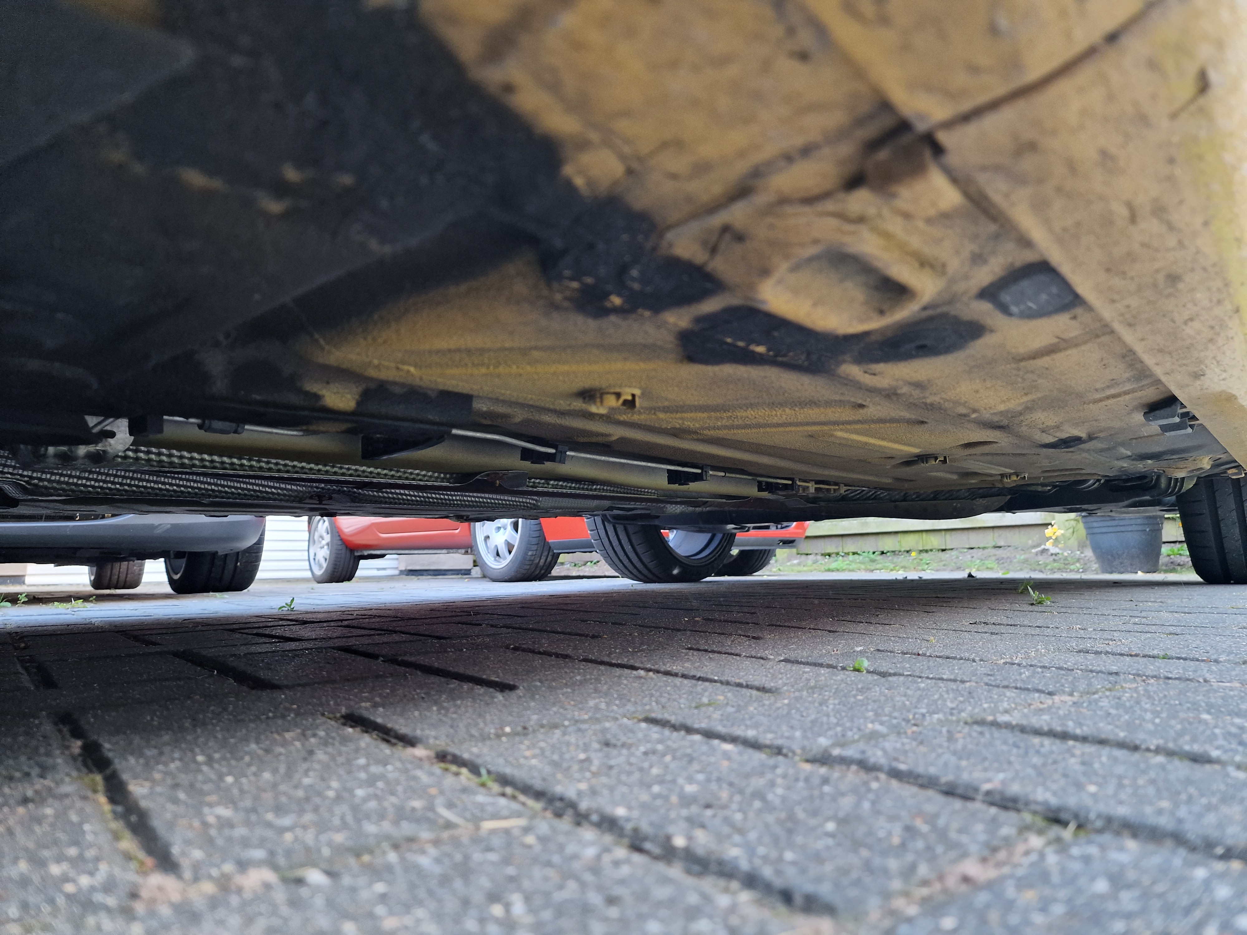

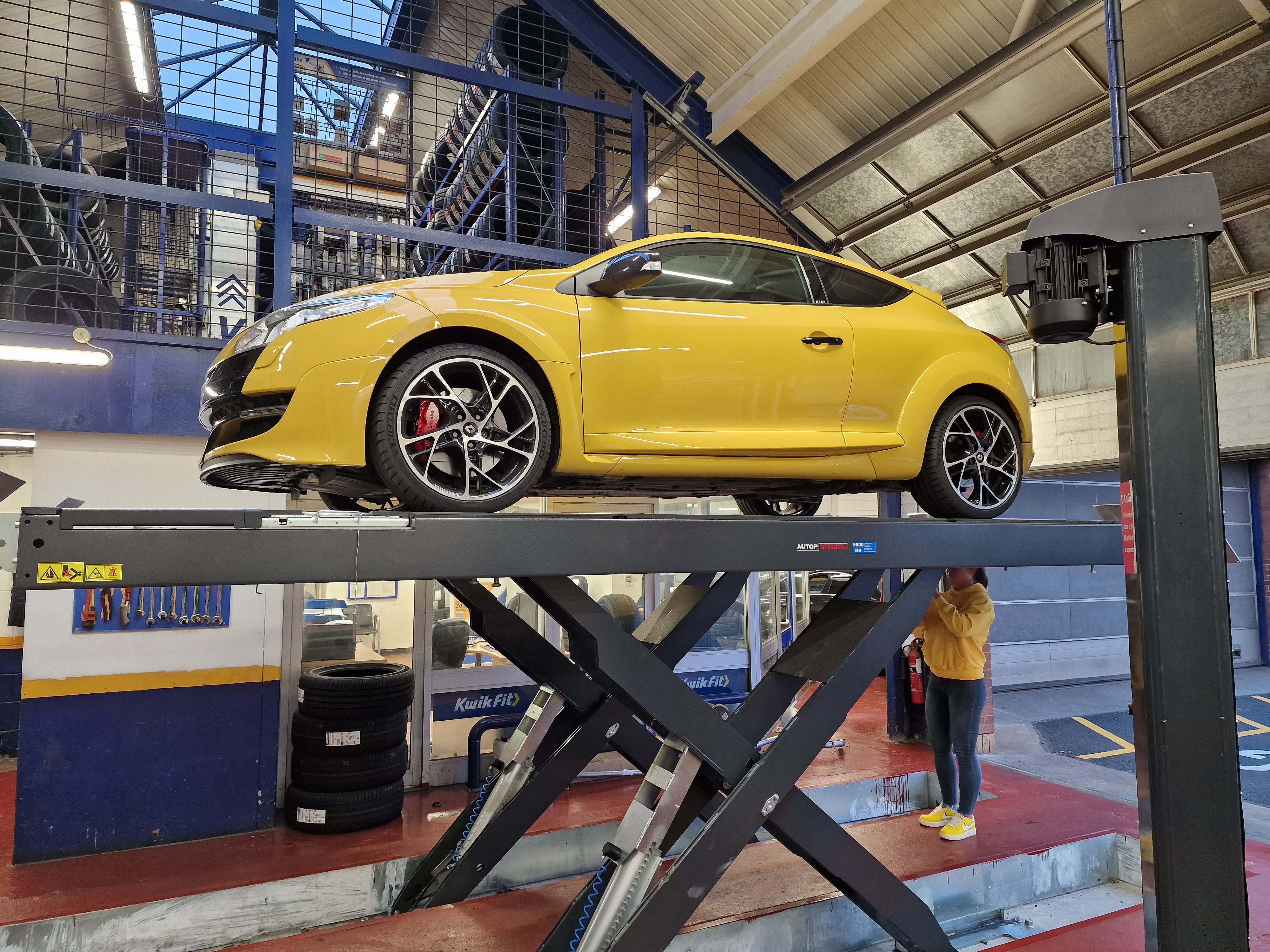

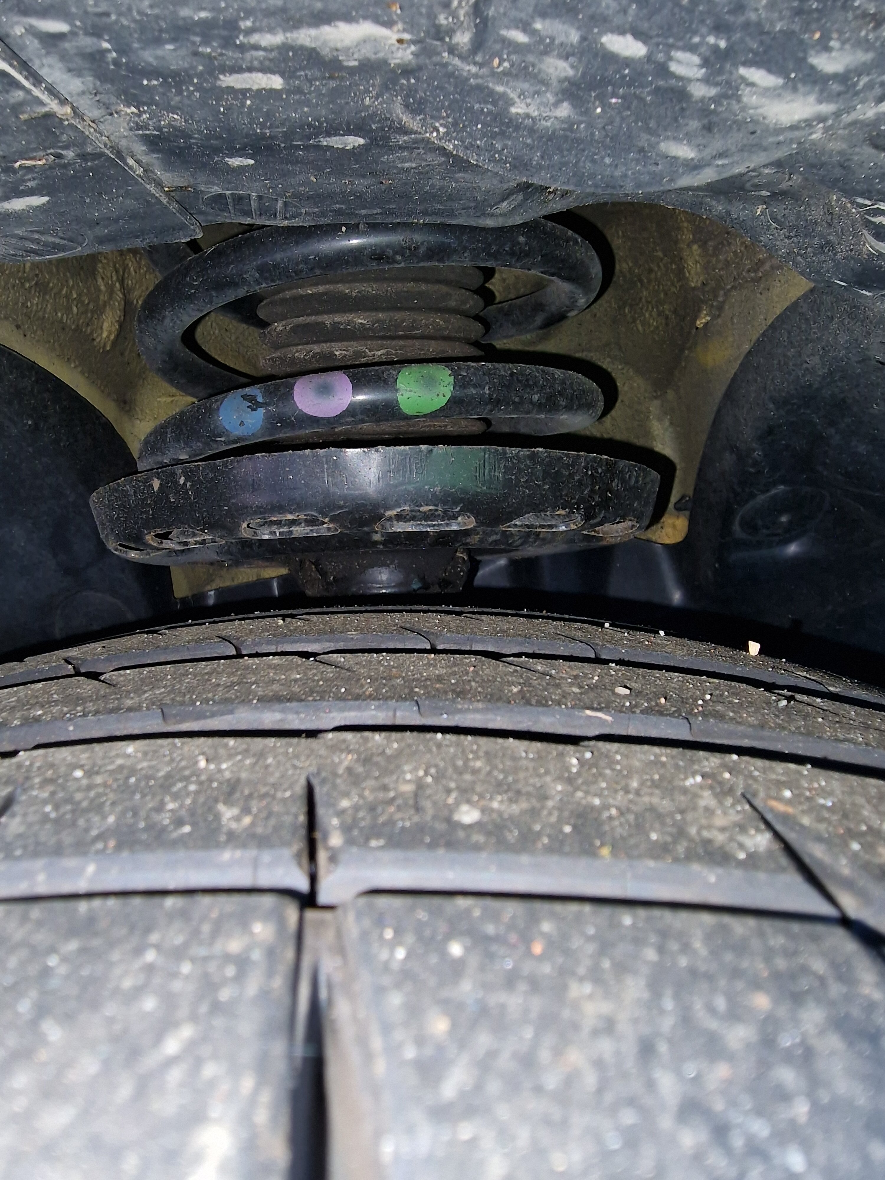

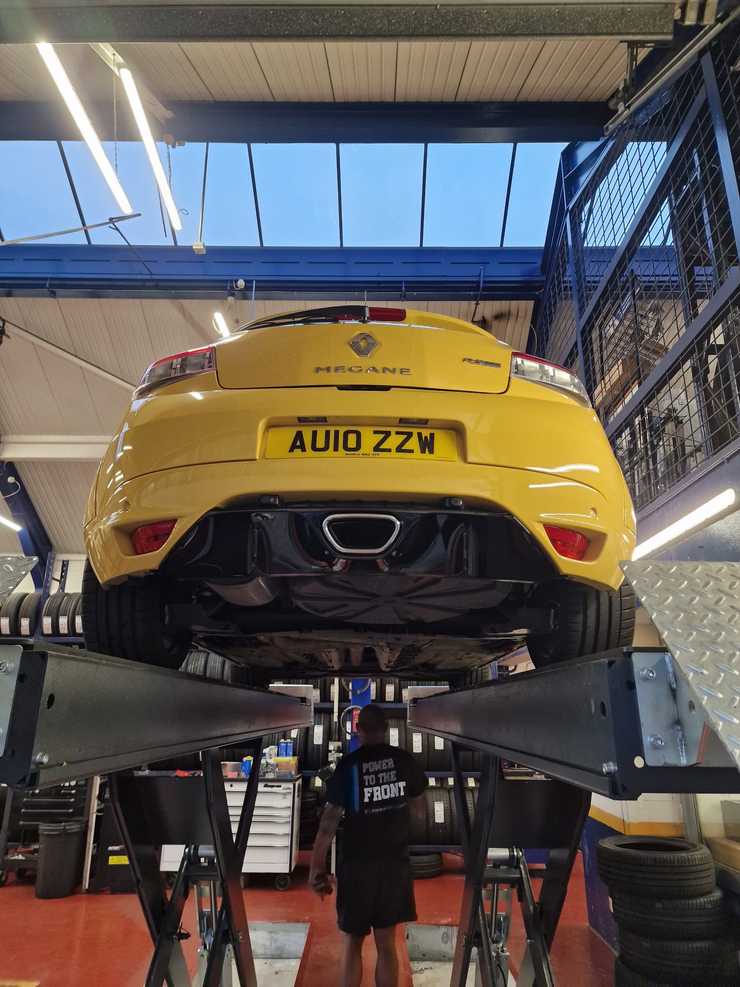

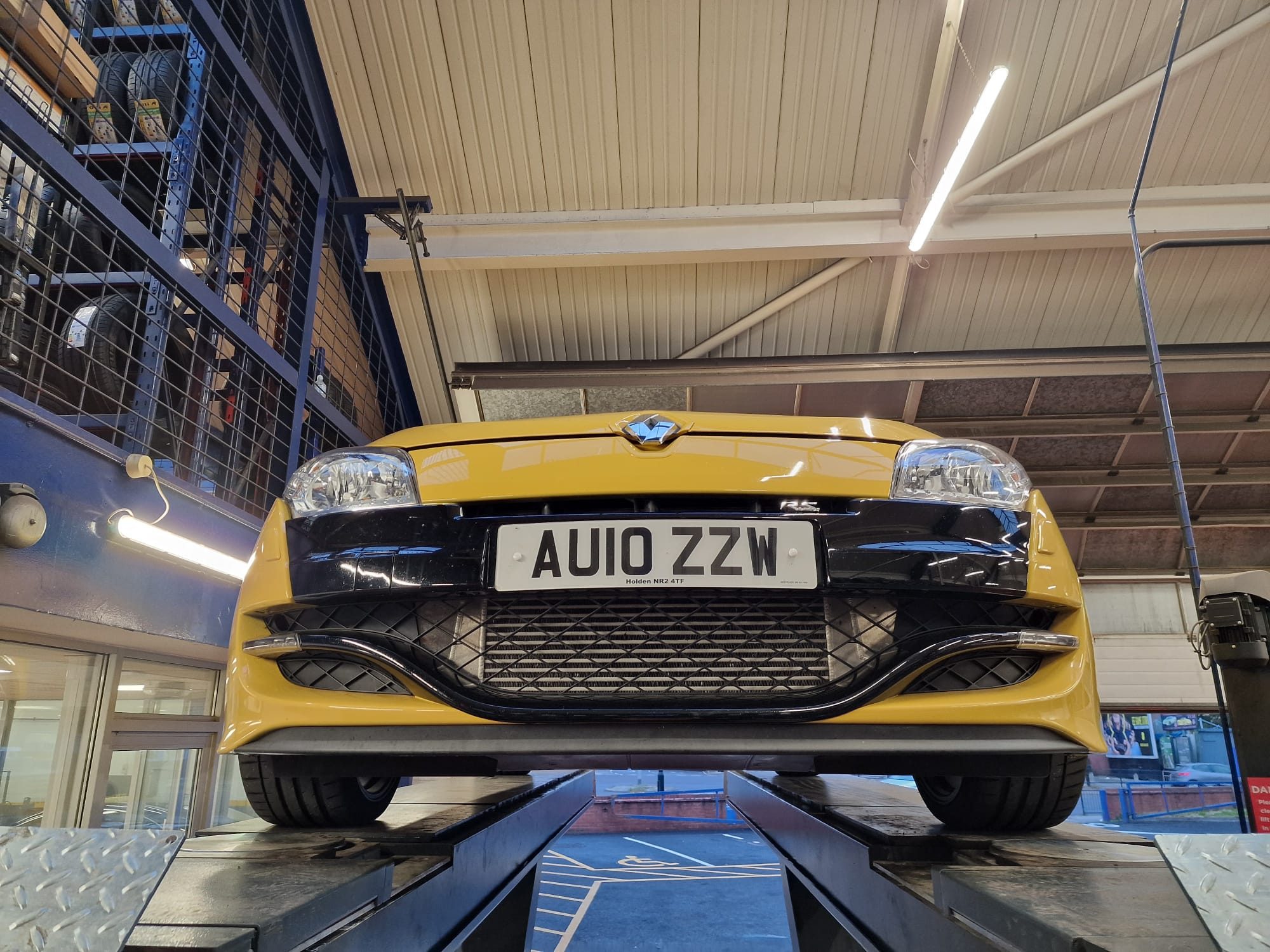

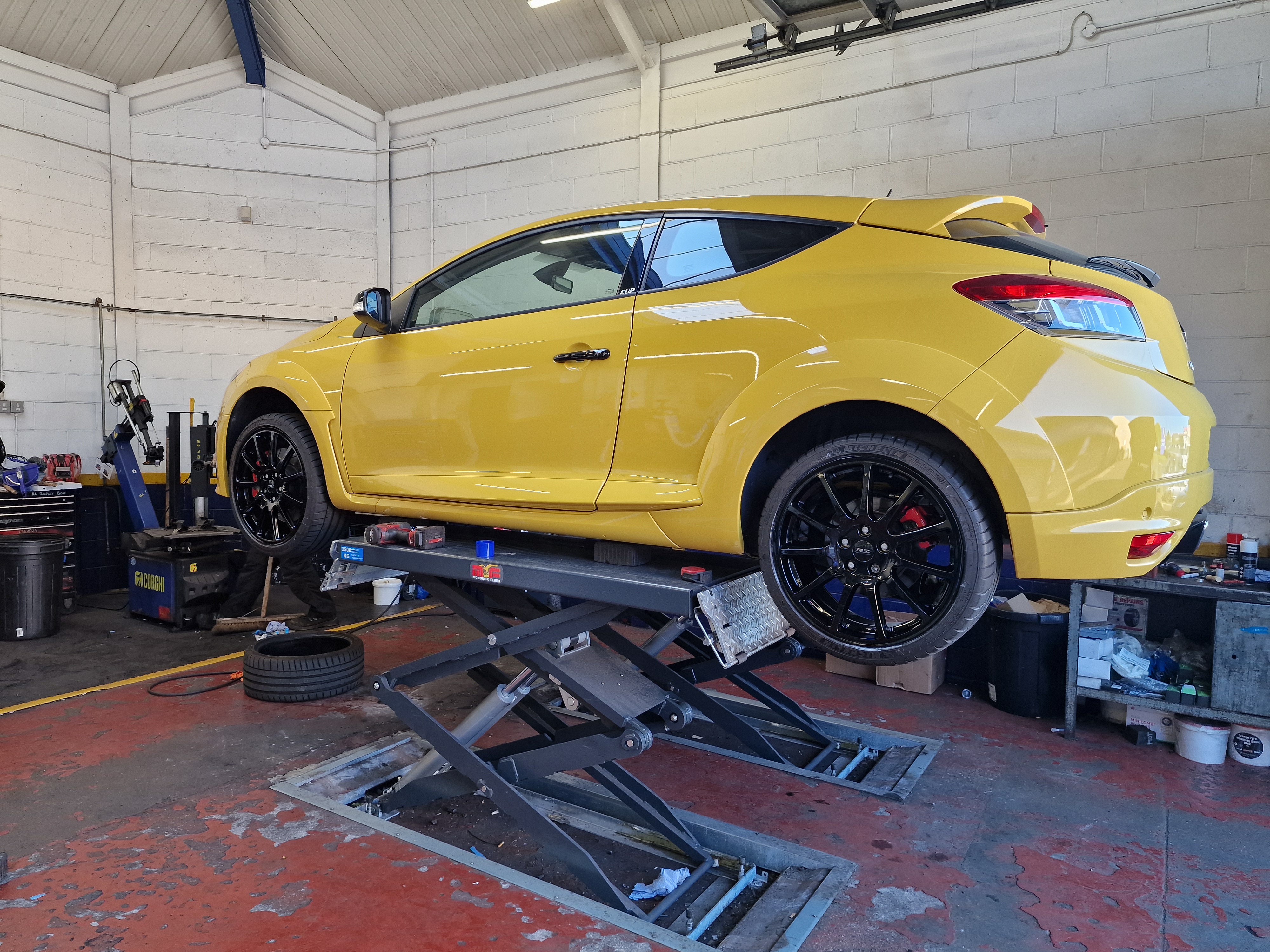

Took it down my mates garage so could have a look at the underside on the lift to see whats what. Nothing to note all looks excellent.
Will give the underside a wash off and coating of xcp rust block soon, ready for winter layup.

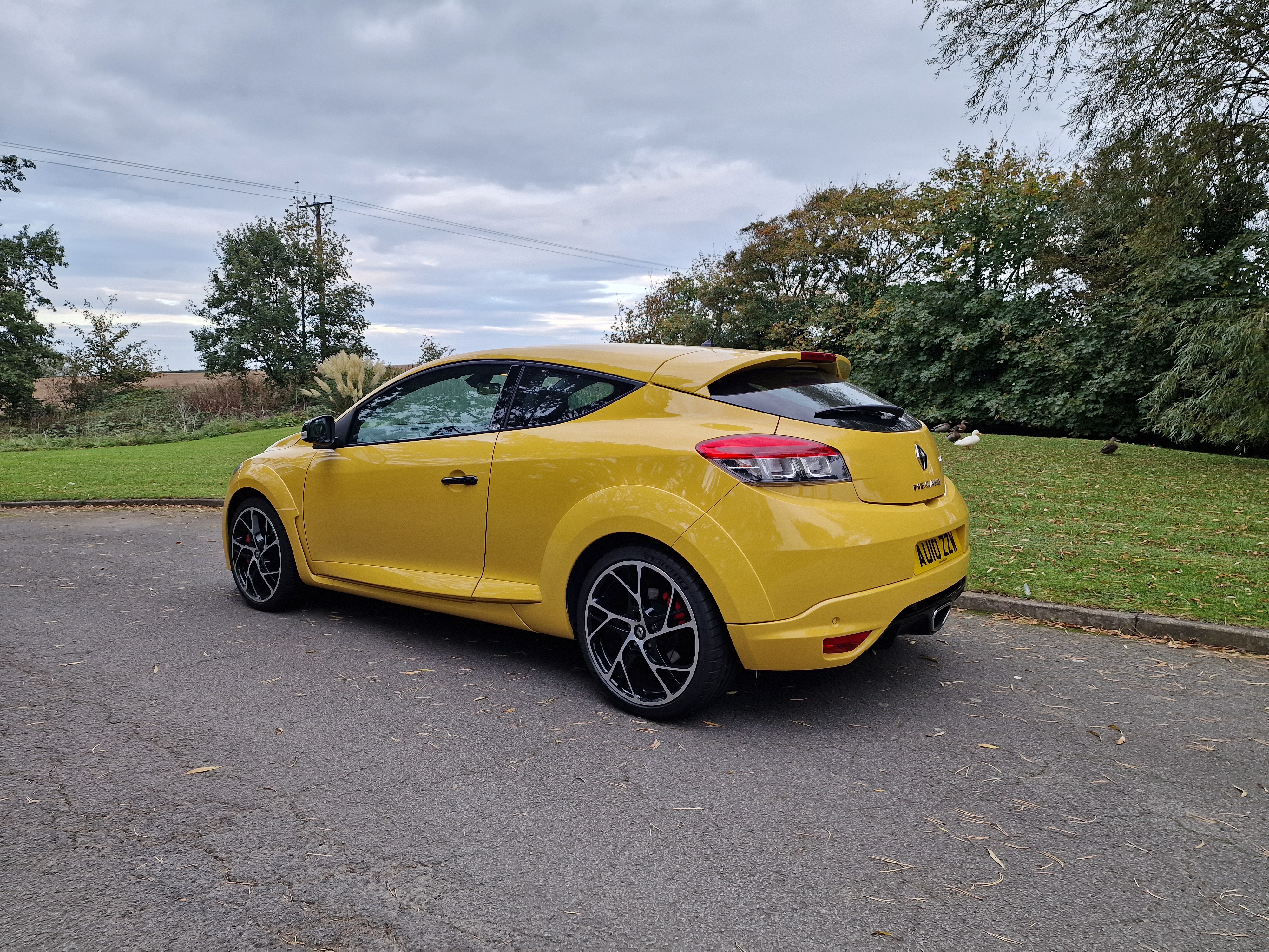

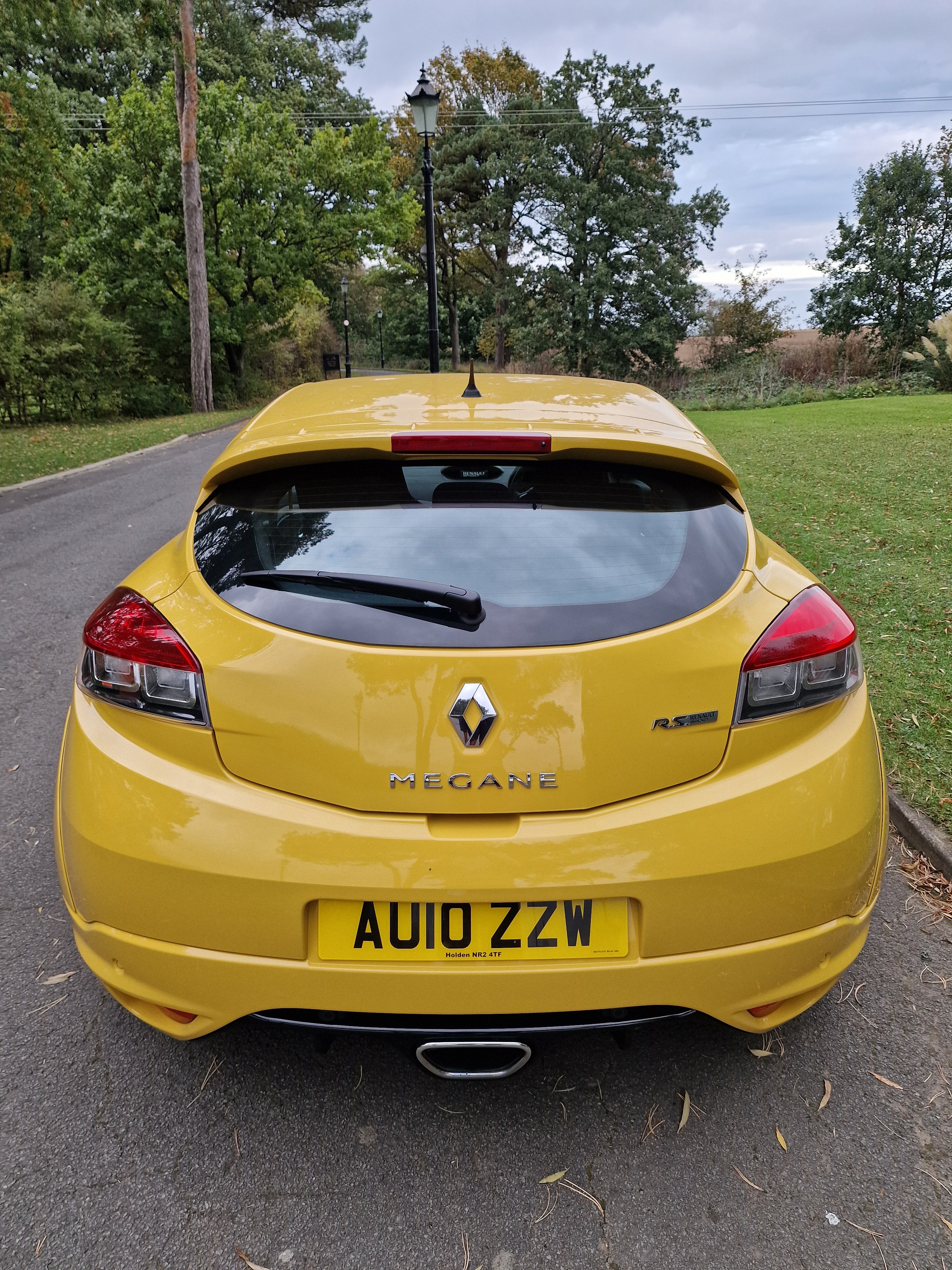

Updates.

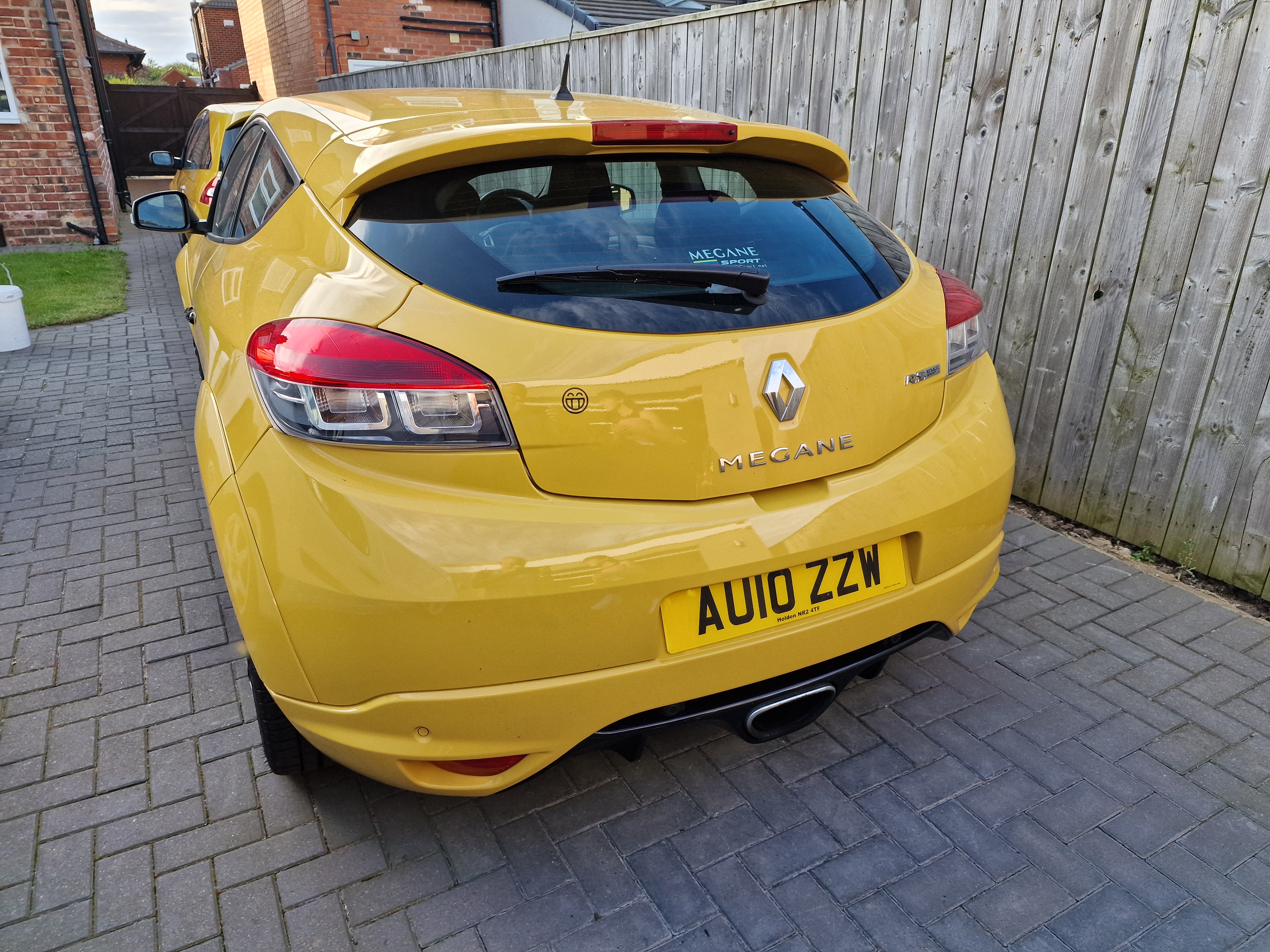

Quick clean up yesterday. There was no beading and and assume no protection on it, so give it a coating of gtechniq c2v3 to keep it going until we get it in for correction and coating next year. Meganesport sticker on rear window also went the journey after the pics.
Thanks for reading!!

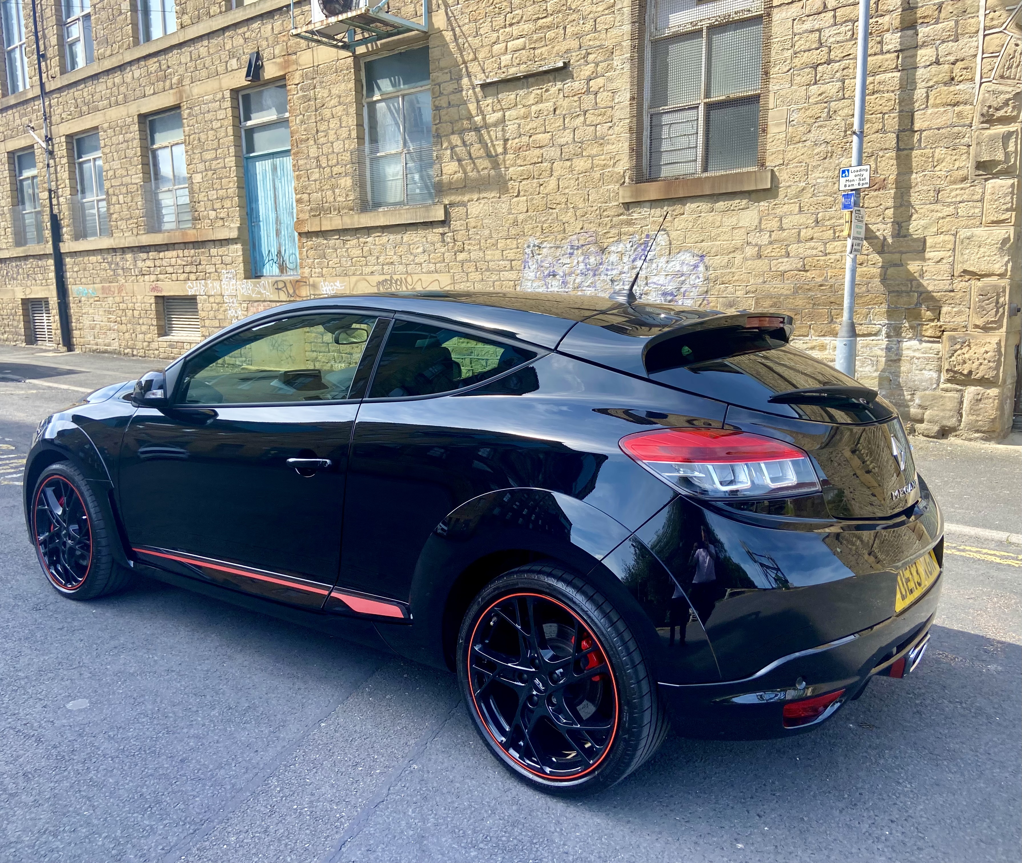

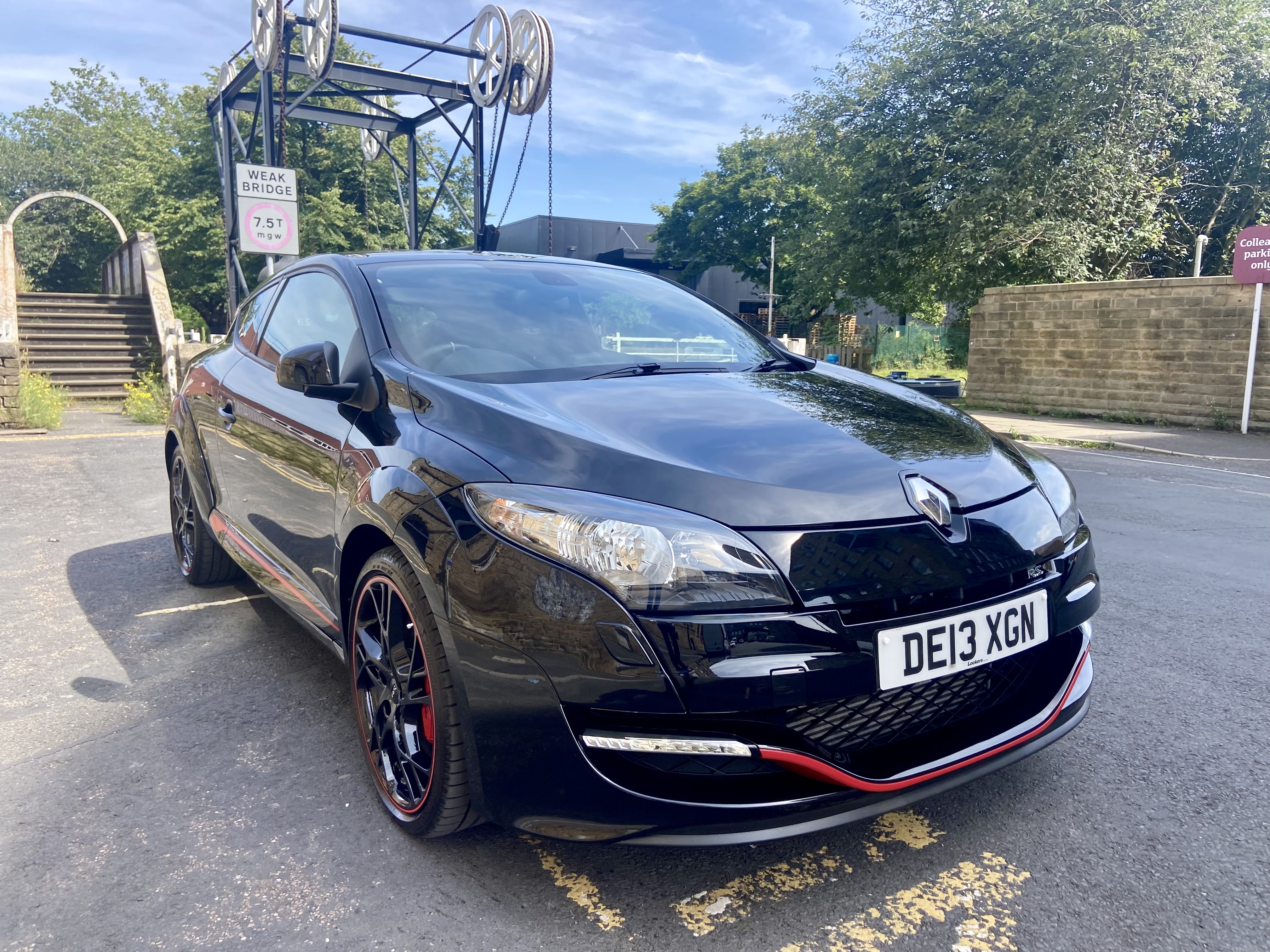

NickReilly063
  182 Trophy Rs265
Looks awesome John - I did my Megane with Ceramic coating a month or so ago - not sure it works that well, however if you Pm me I’ll send you a bottle to do yours with -

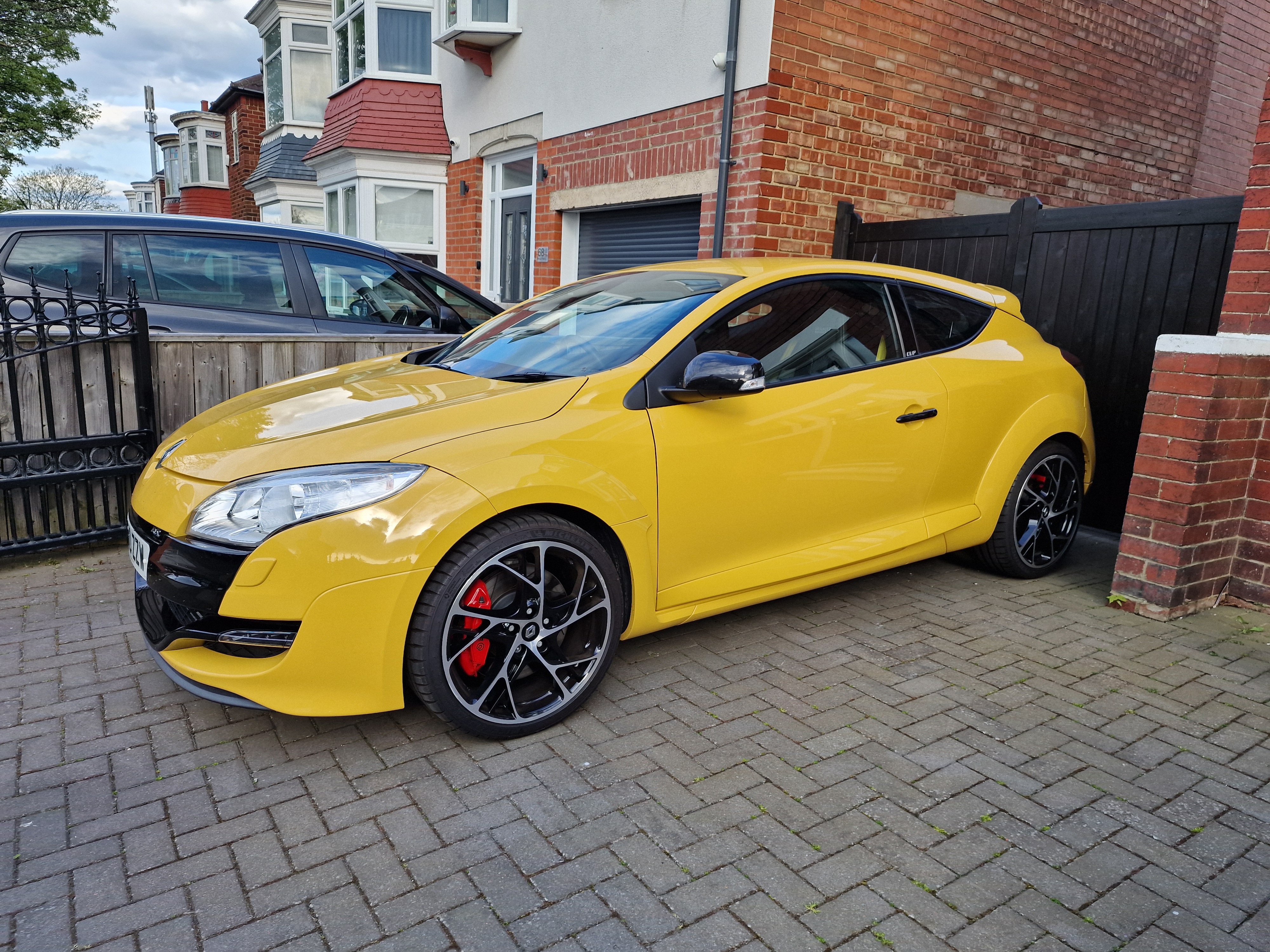

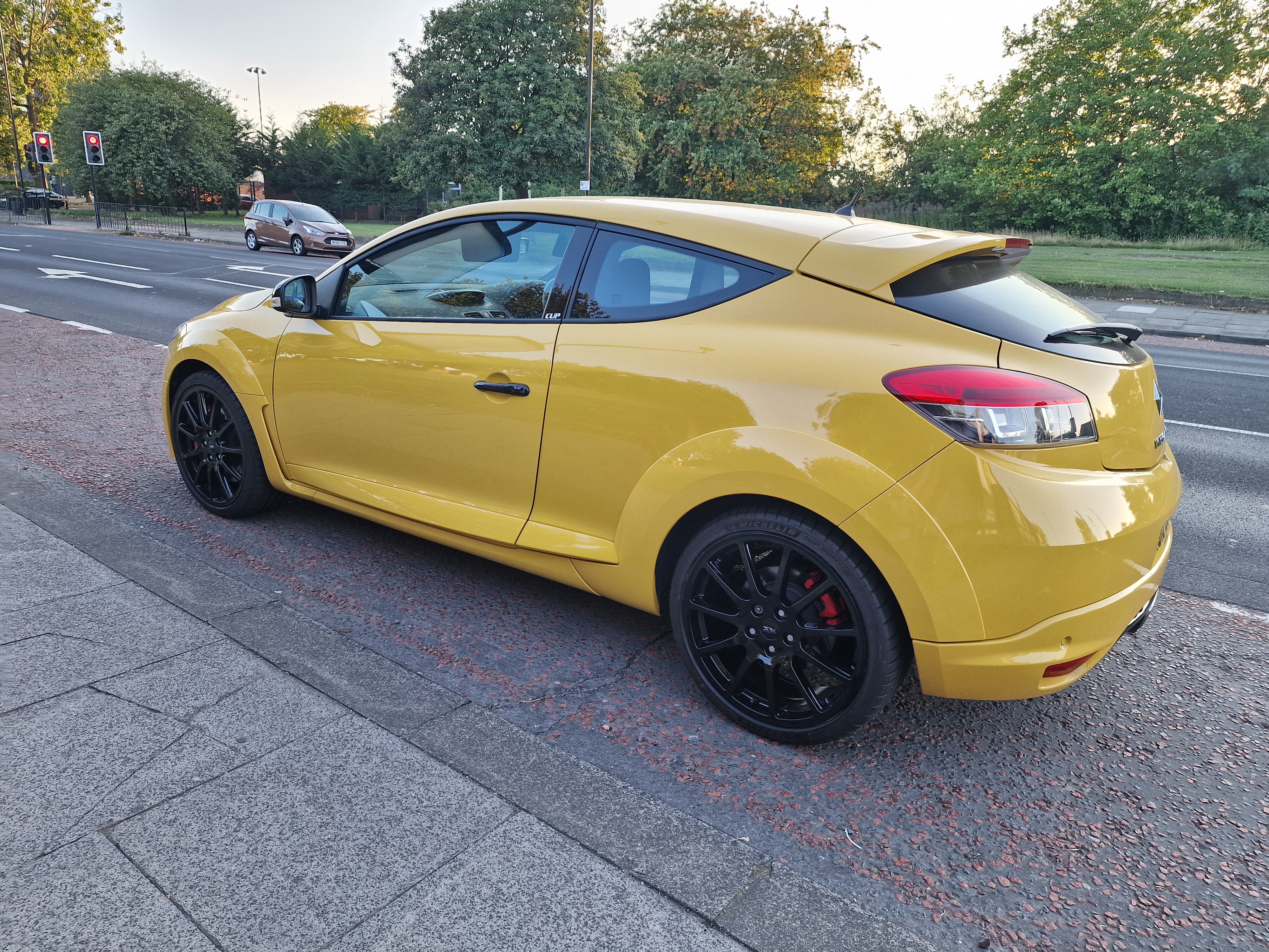

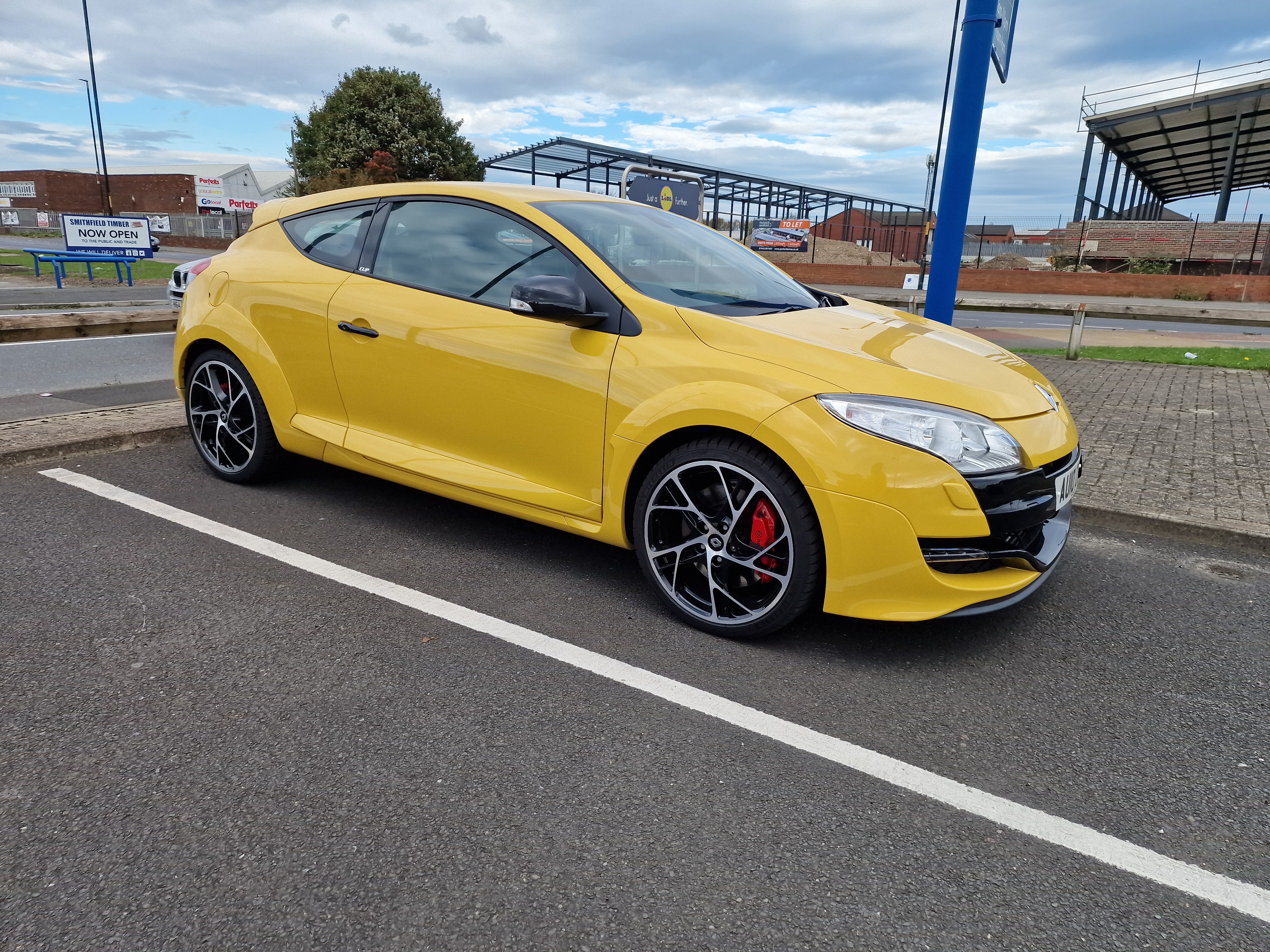

Small update.
Took the 250 out last week for a quick blast whilst weather was dry.
It feels absolutely planted on the back roads on stock cup suspension. Exhaust sounds great when on it too.
I actually feel like ive enjoyed driving this already as all its needed is fuel since buying and not had to lay a spanner on it. Almost unheard of for a megane rs.
Thanks for reading!

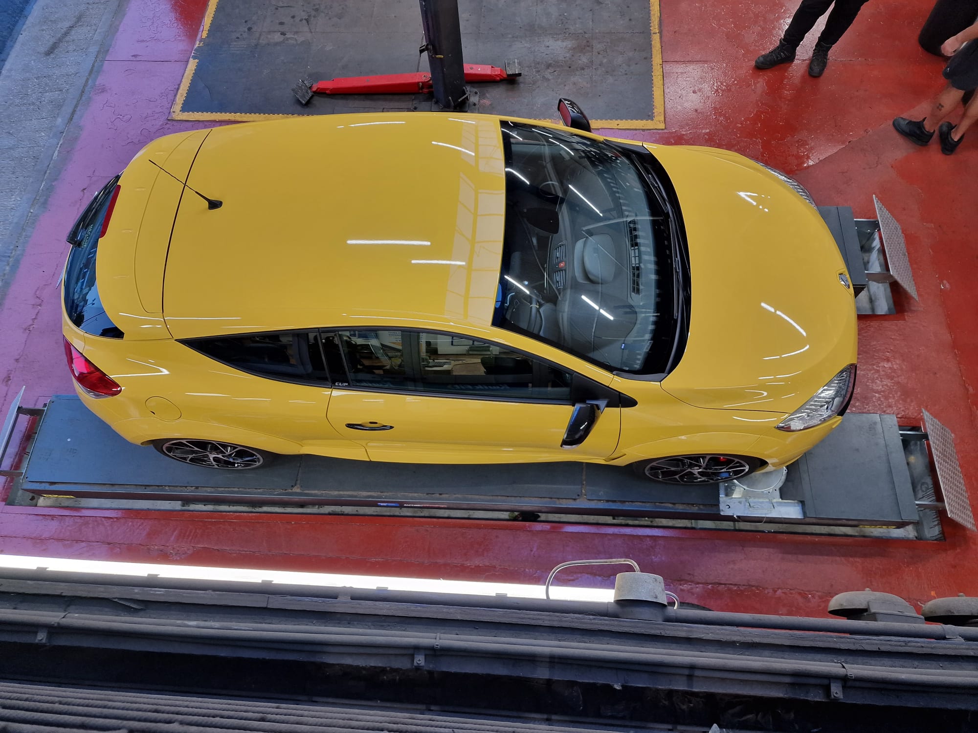

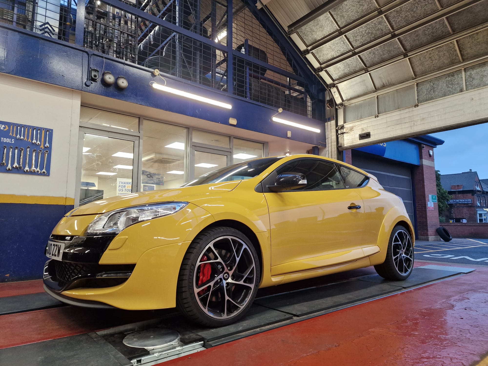

Update.
With the weather improving ive woke the 250 up. Was pretty uneventful, the garage is nice and dry so no rust on brakes or nothing. Stuck battery negative terminal back on and it fired up like it was running yesterday settling down to a normal idle. Short drive to the house and all seems fine so give it a wash to clean the dust off.
Looks loads bigger than mk2.
Done some mot pre checks and all good, nothing to note so should be a clean pass this week.

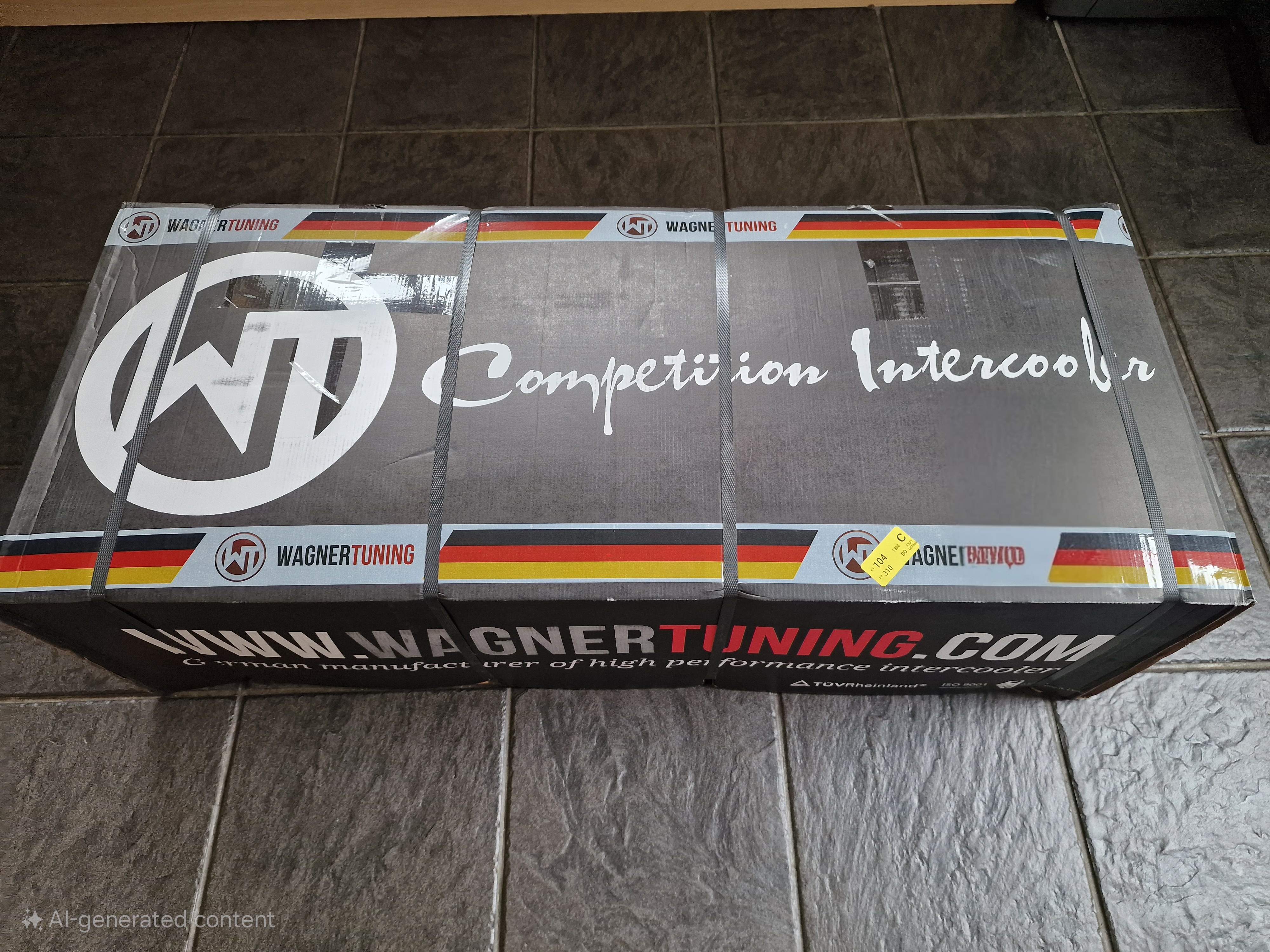

Small update.
250 used a couple of weeks ago in the decent weather.
Had rs monitor on and noted charge temps not great with the forge intercooler, lingering around 30-40deg all the time, better than stock intercooler but roughly 10-20deg above ambient which is poor in my opinion. So plan is to change it for a better intercooler before it goes in for a map at Efi. Better charge temps = more power and less chance of timing pull.
Done a load of research on the 250 intercoolers ages ago when we owned the old 250, and Wagner was suggested as one of the better ones. Cools charge well and does not block the rad/cause cooling issues. This wont see a track so coolant temps prob not an issue on the street but dont want any issues on the occasional high speed drive.
Ordered the wagner on Sunday and it arrived today. No pics out of the box but it looks pukka.
Depending on weather this weekend might stick it on.

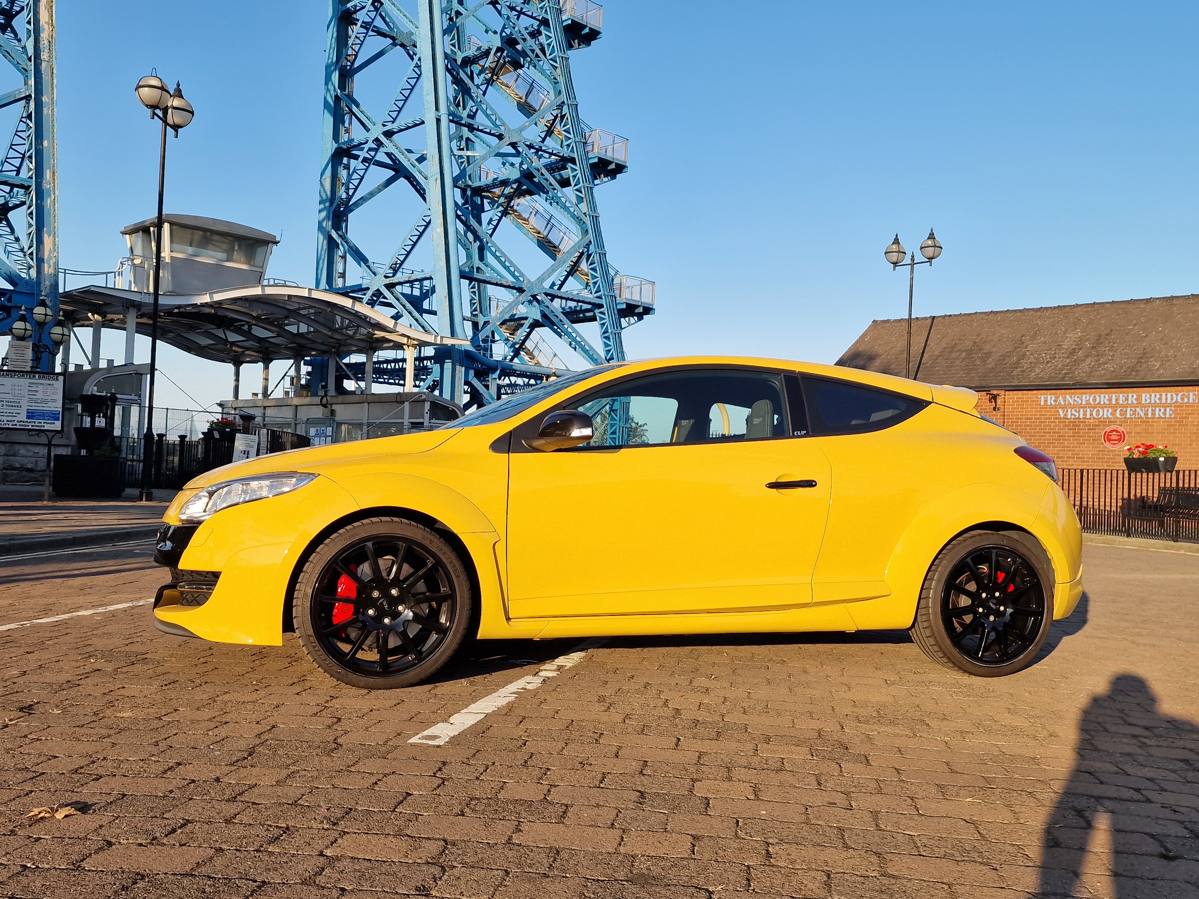

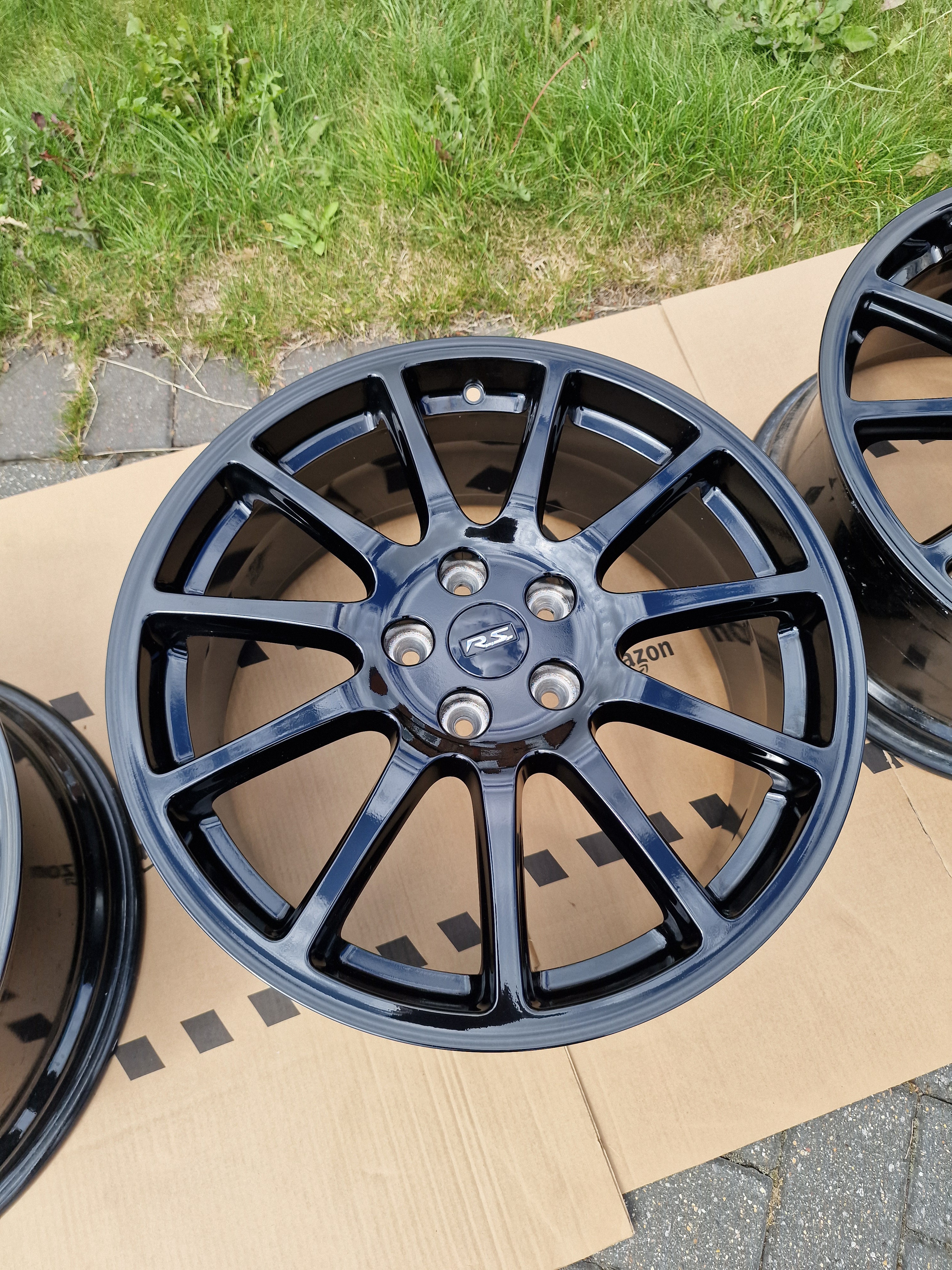

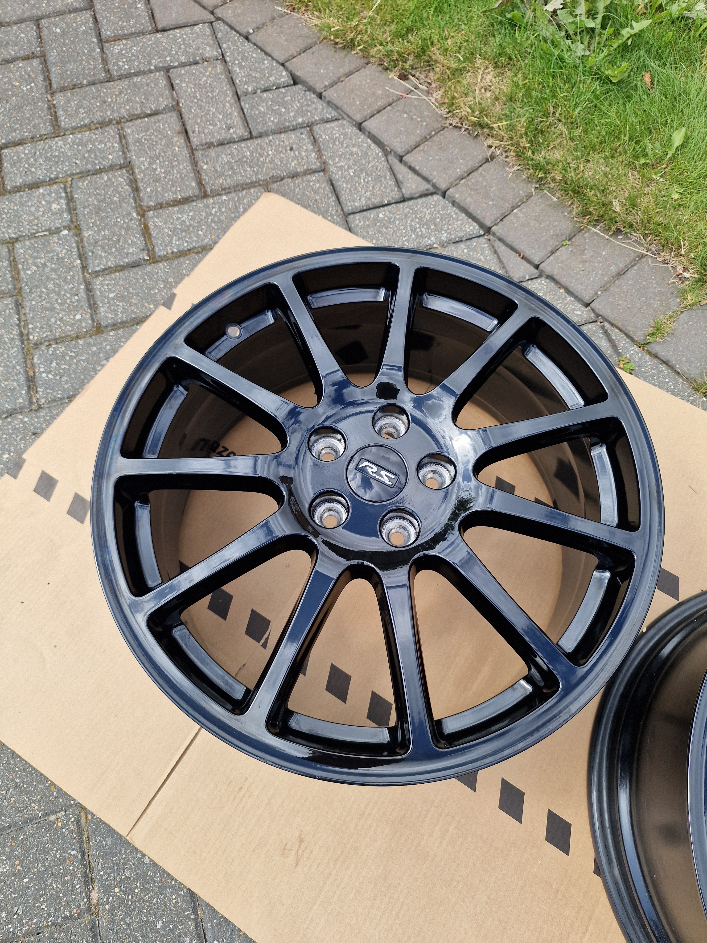

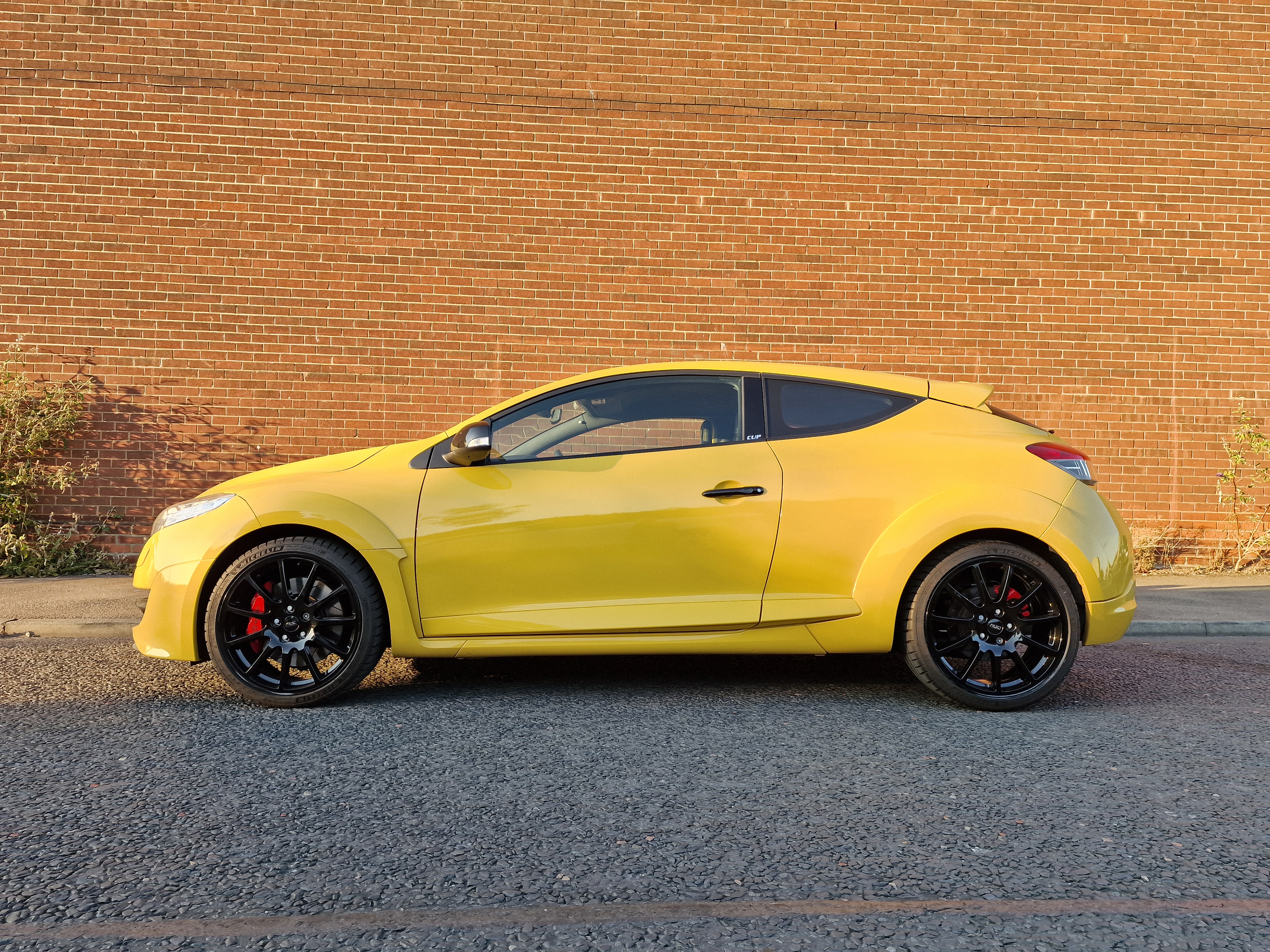

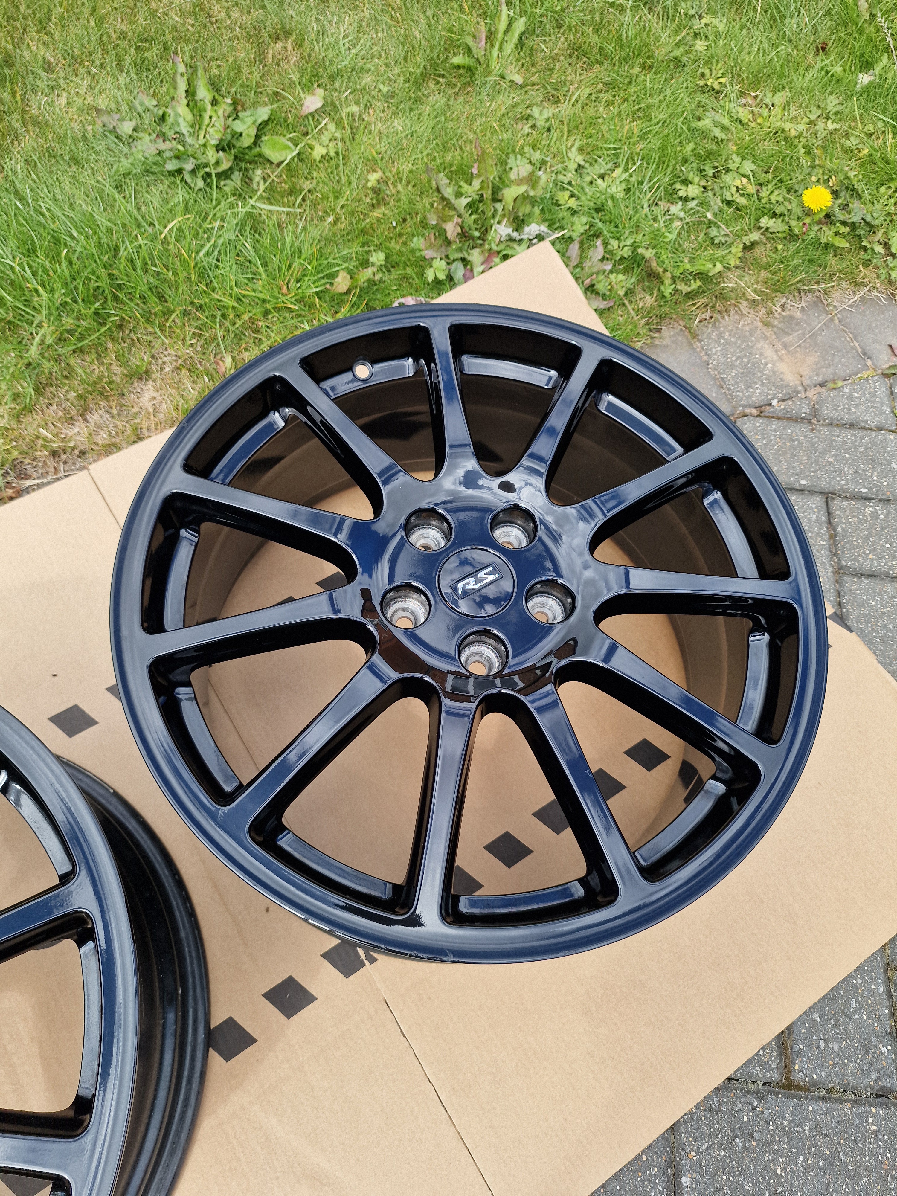

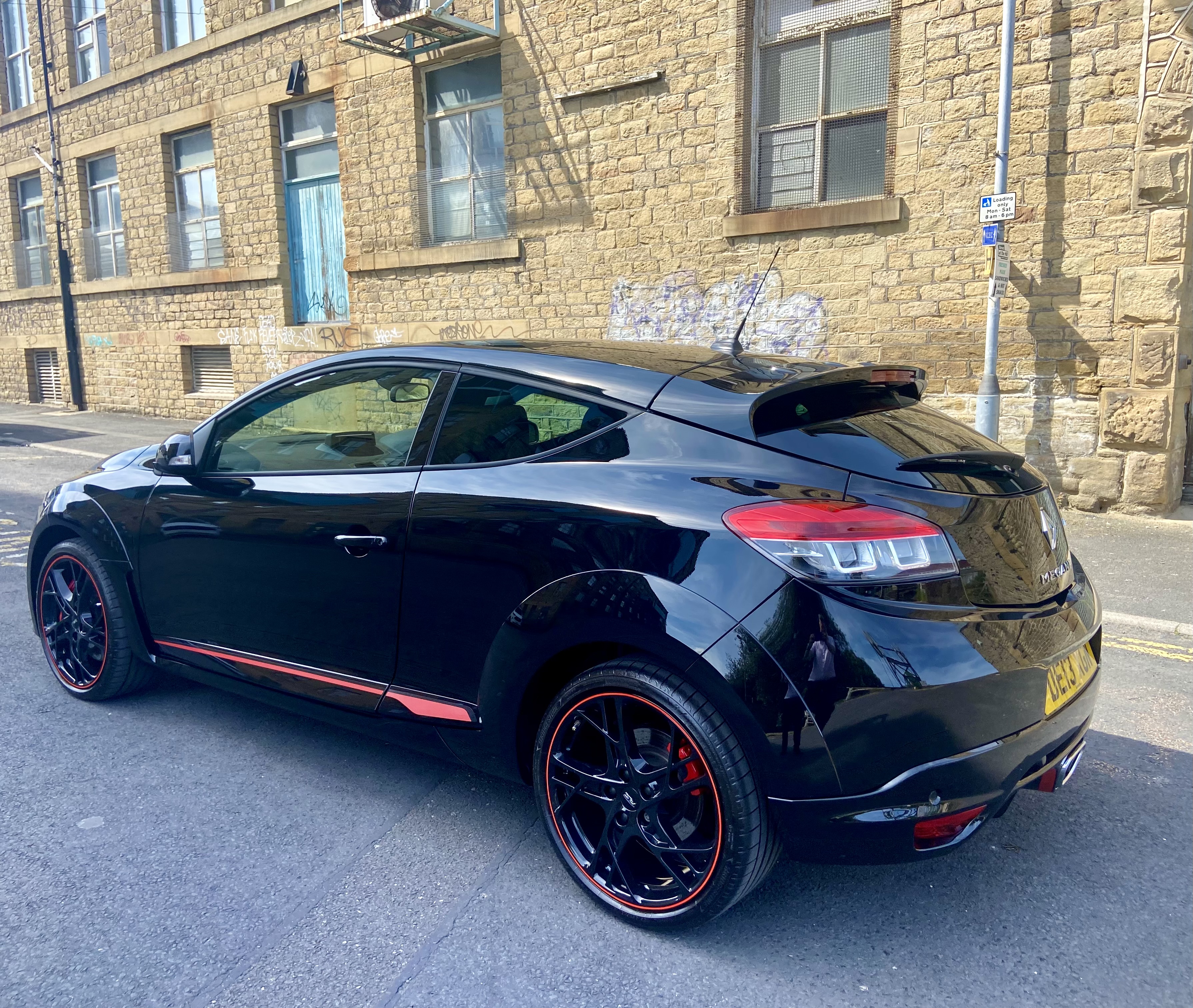

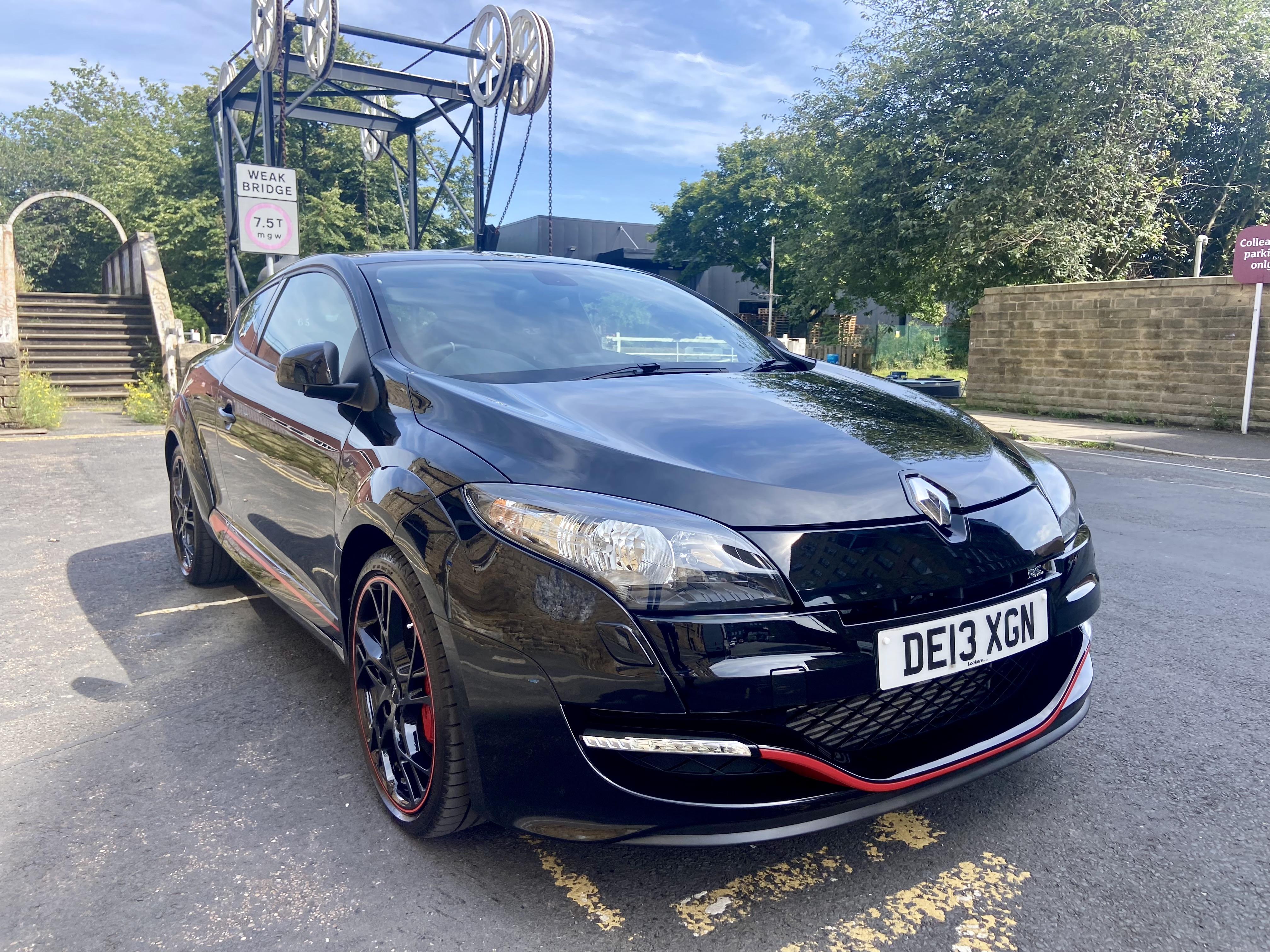

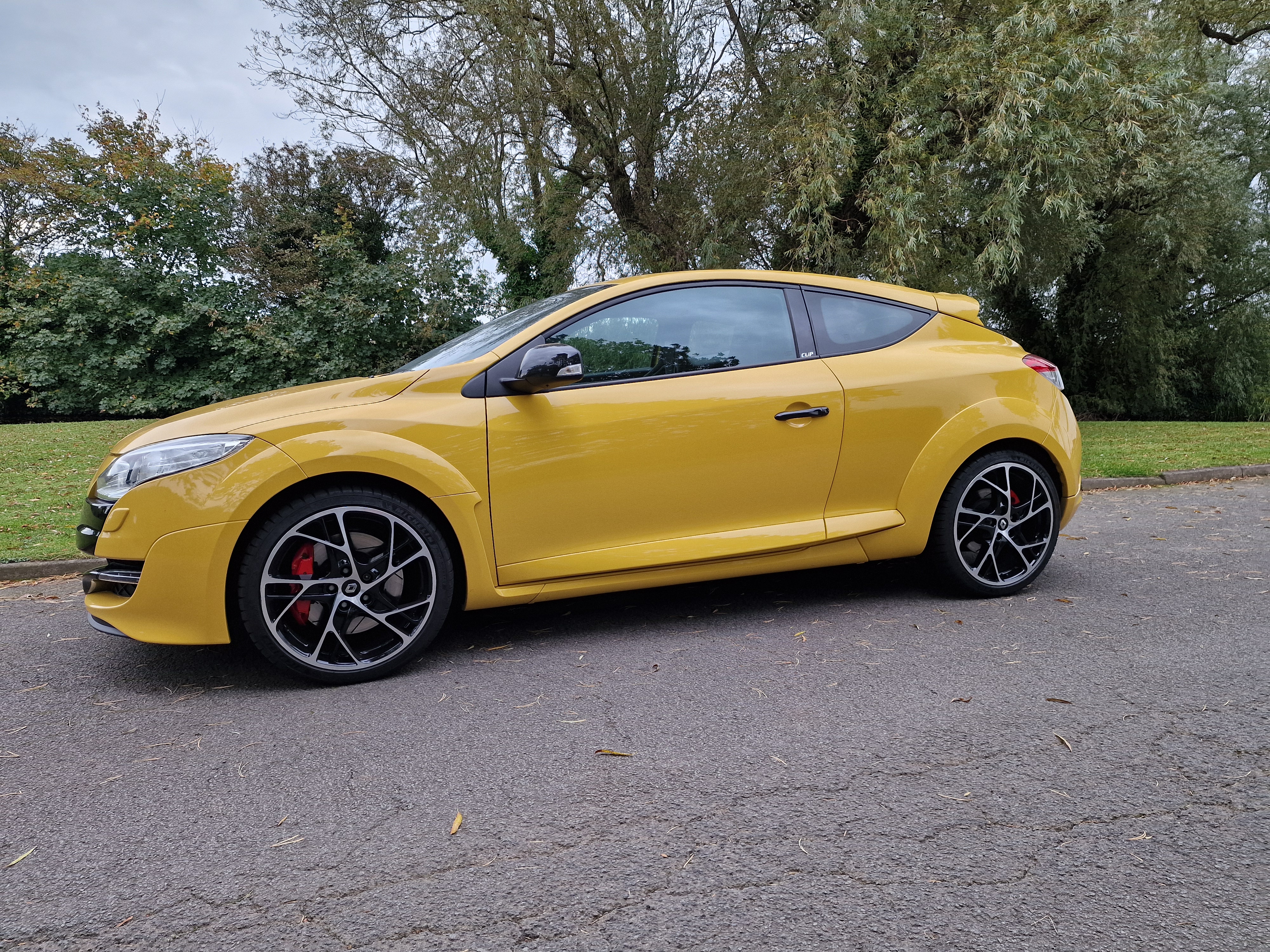

One thing ive never been too keen on is the 19" steeve wheels on the 250's. I dont hate them but dont love them, not keen on diamond cut wheels and the non symmetrical/directional look of them. They very much remind me of some late 90's aftermarket wheels. The ones fitted are in great condition that was the only saving grace.
Anyway been sniffing round for a nice replacement. Wanted compomotive mo6 and was making enquiries on a new set, but only offering was 18" et40 which was way too agressive for stock suspension..i cant be arsed modifying it loads for a wheel swap. Did ask for a custom set but no joy.

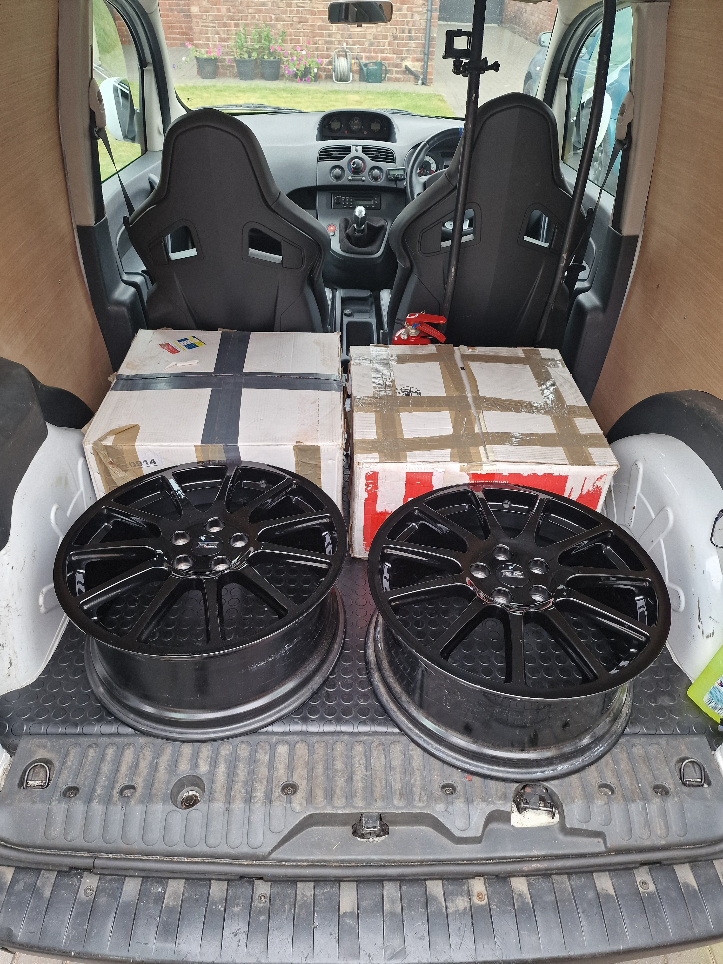

Anyway back to looking and seen a set of mk3 Trophy R 19" turini's up for sale. These ticked the box as correct offsets so no hassle fitting.
Made a few enquiries and next thing were picking them up.
Kangoo doing the business.

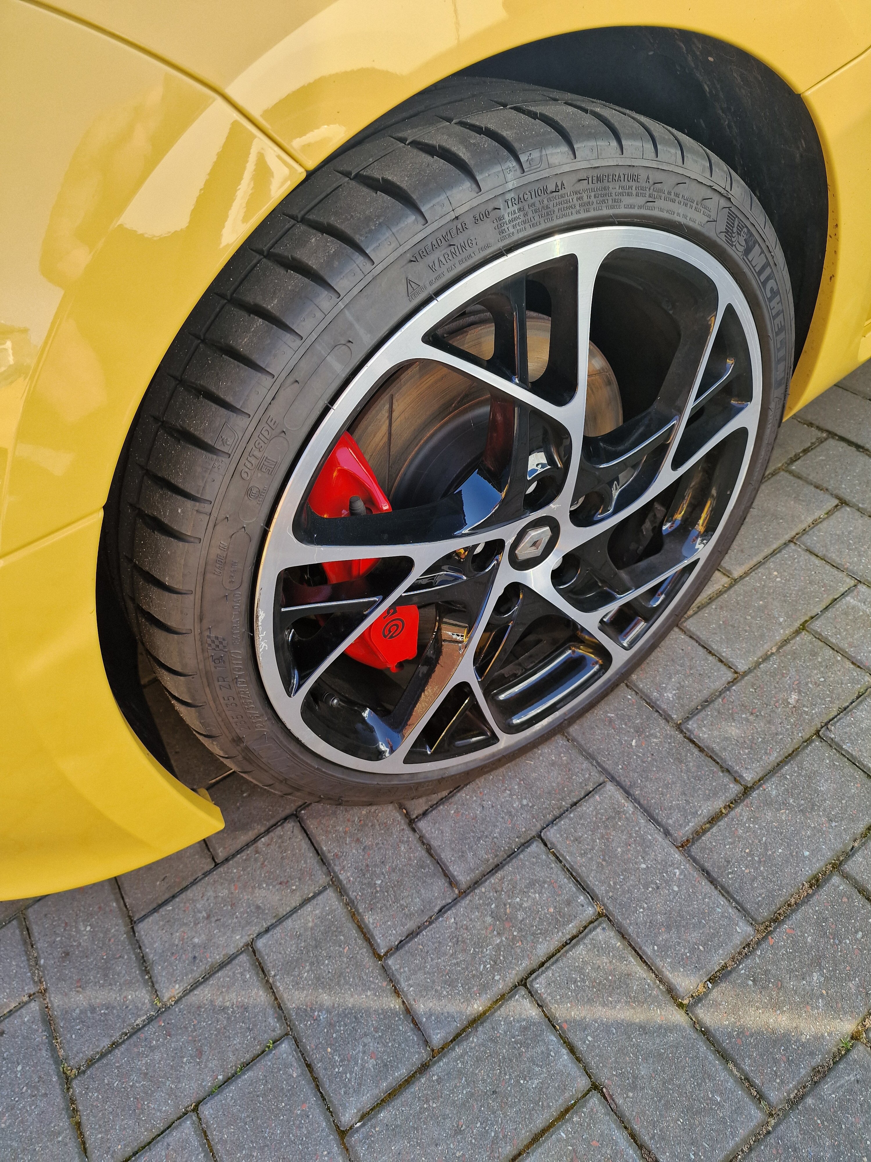

The wheels were off a low mileage mk3 trophy r which had been modified and the owner had sold the car. He undersold the wheels as needing a refurb so planned on getting them done but upon looking, 2 small storage marks on a couple of spokes which literally came off with one light pass of the d/a with cutting compound. The wheels look like they could have been bought new from ren and had the tyres removed and stored and not used.

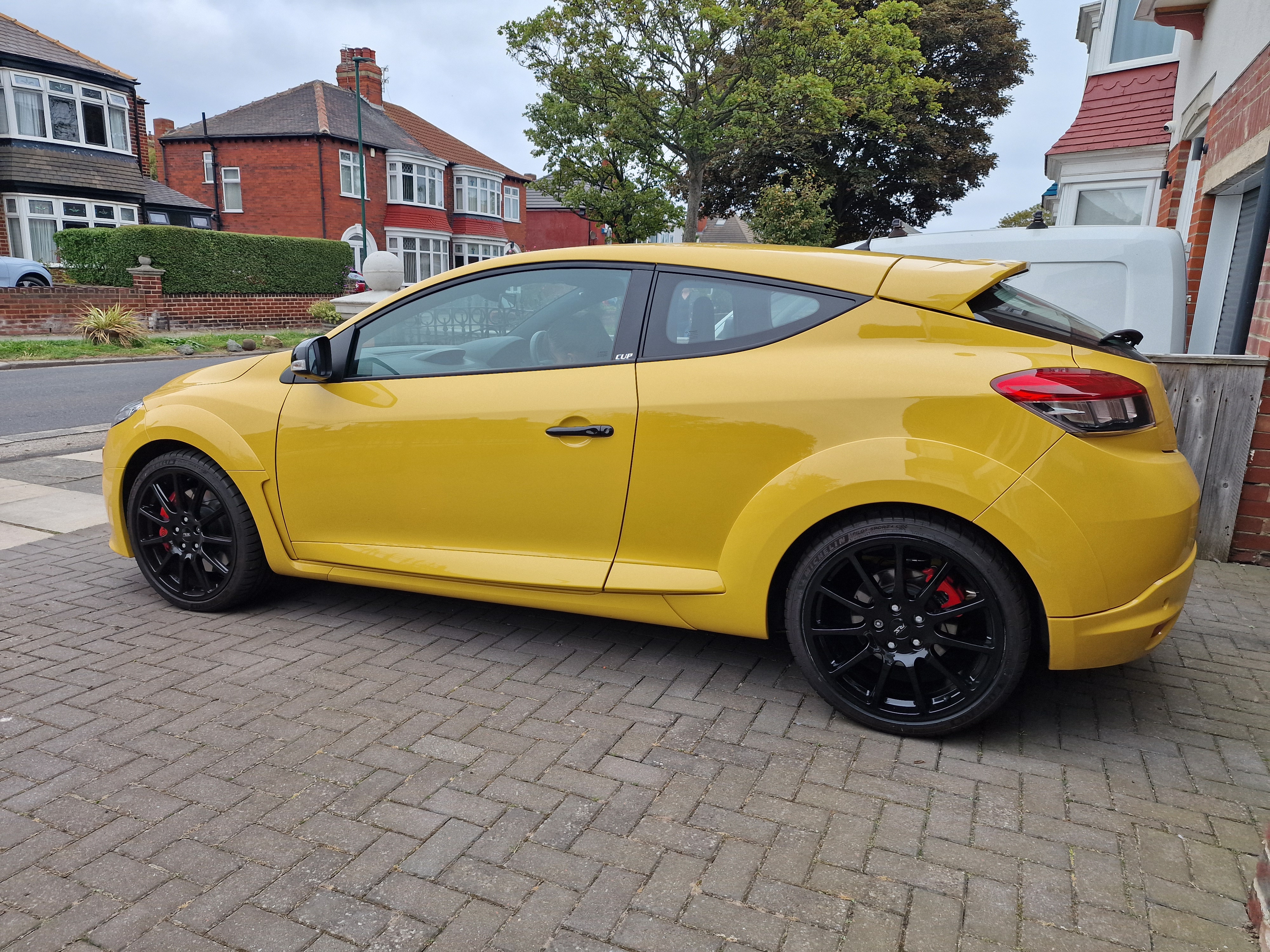

Took it down my mates garage yesterday to get the nearly new ps4s swapped over and get them on. Straight on with them being oem renault, no hassle.
Look so much better than the original steevs.

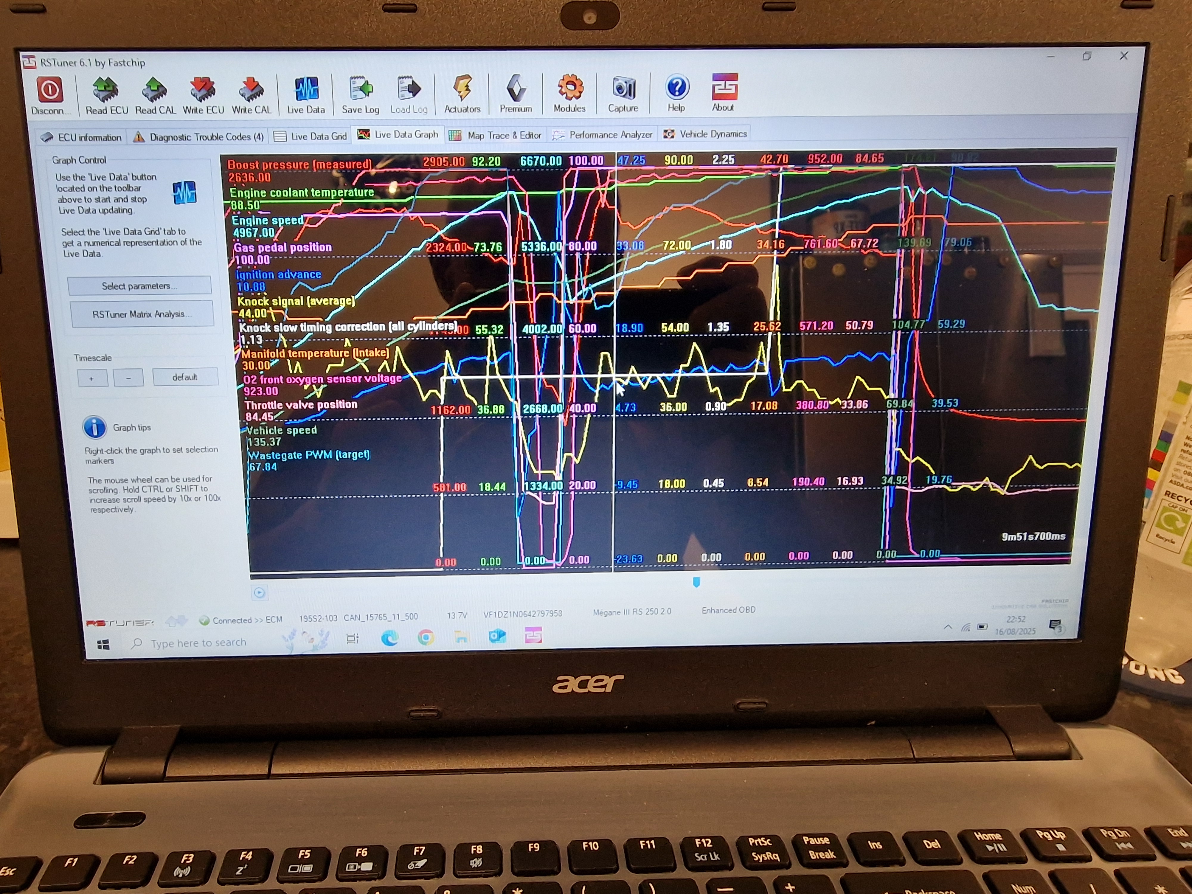

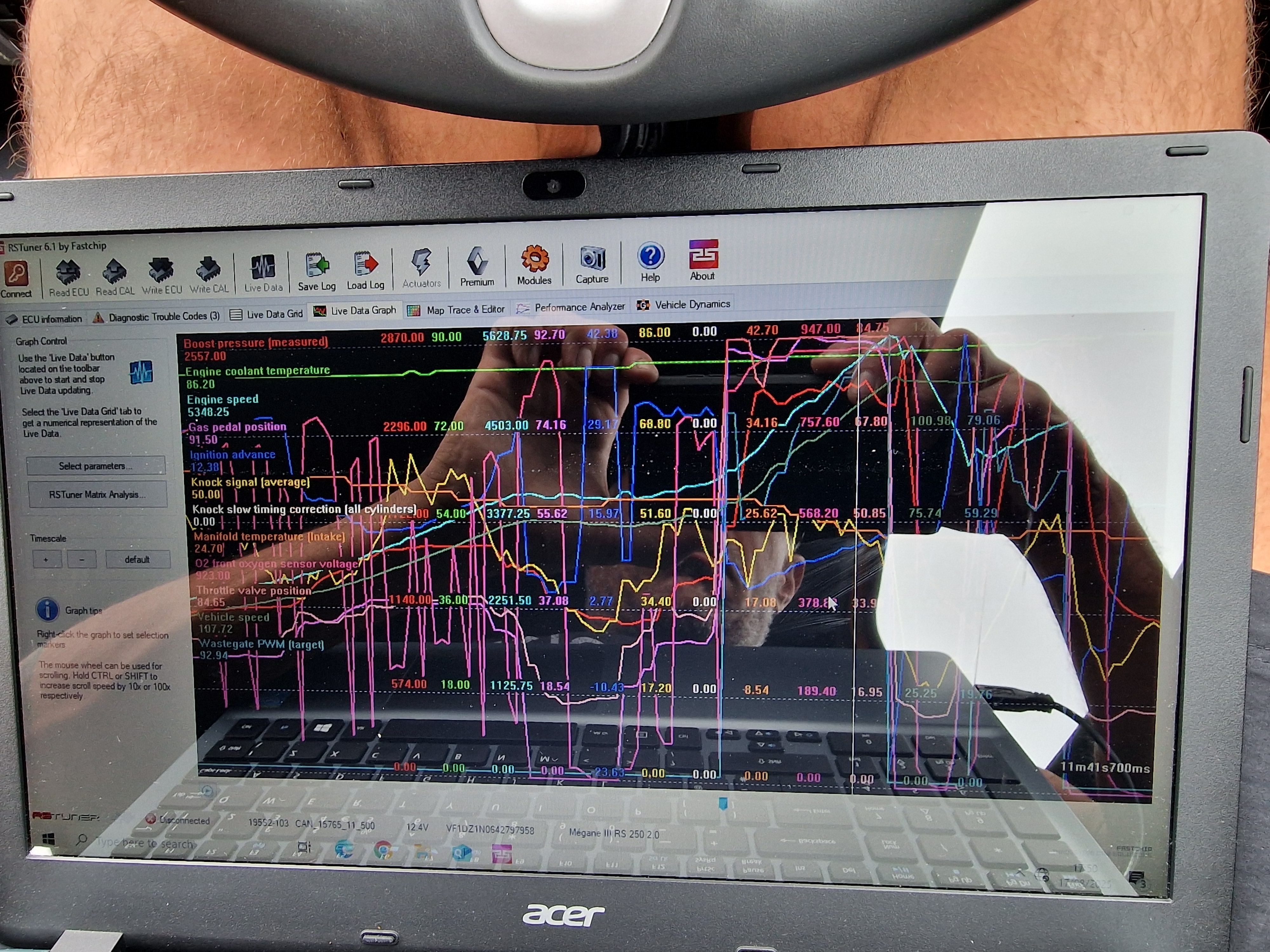

Also stuck rstuner on it yesterday to do some pre logging before fitting the wagner intercooler today.
Was a bit shocked to see its pulling ign 2-3deg, for whatevever reason. Dont rate current map on it so itll be getting booked into Efi asap to get this resolved. Its a good job ive not really drove this hard, obvioulsly ecu is doing what it needs to but yeah, not great.

Loving the wheels. All over them like a rash. Well Jealous.
Been after a set for ages but I am a bit adhoc on looking.
When come up either over priced or needing a refurb.... or both together.
If you decide to move them on let me know.
Matt Cup
  Iceberg 172 Cup
Wheels look superb 👌 Renault go one or two ways with there wheel design/choice. They either look mega or utterly shite, no middle ground.

Cheers all. Well happy with them has transformed the look of the car.

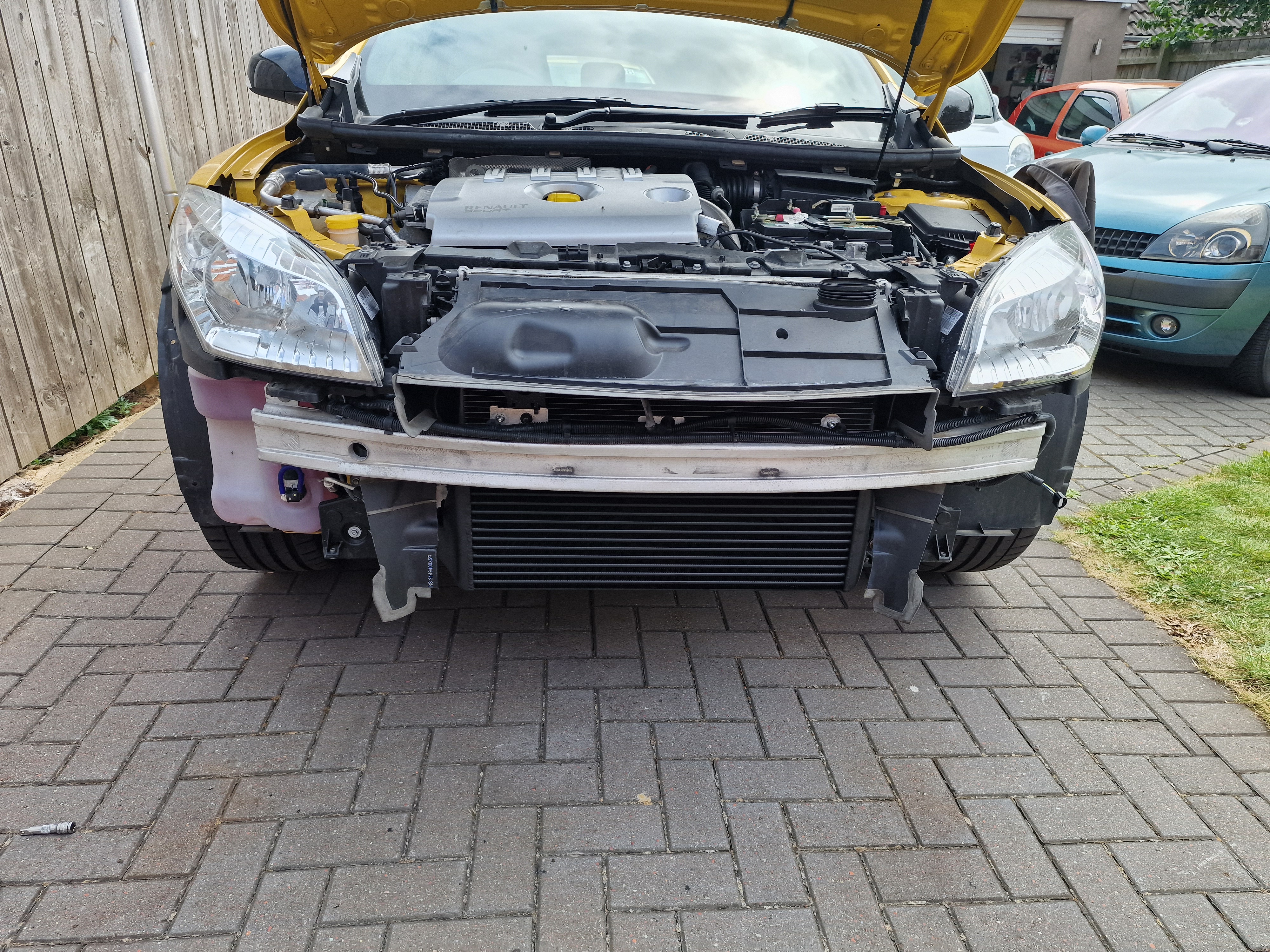

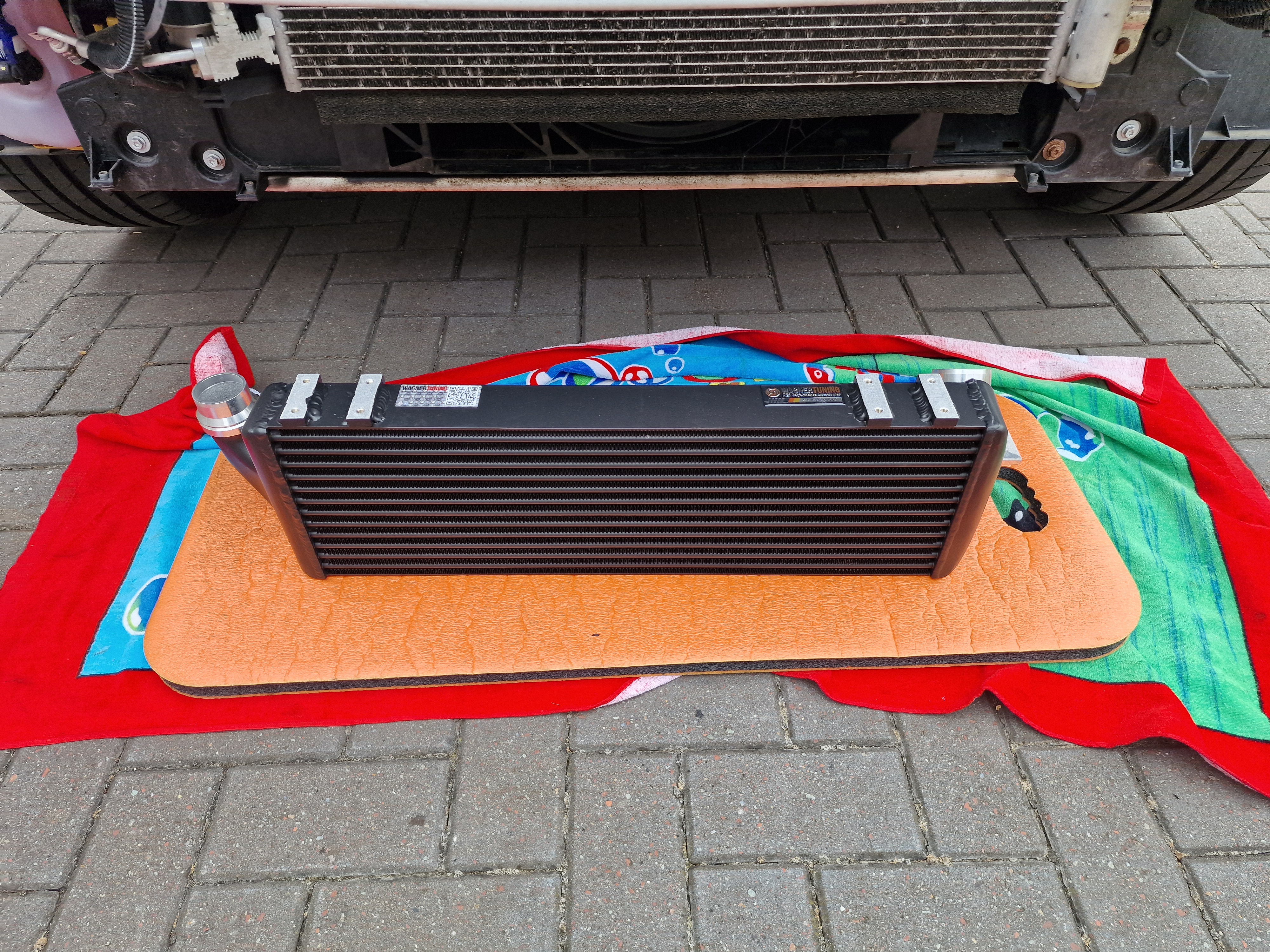

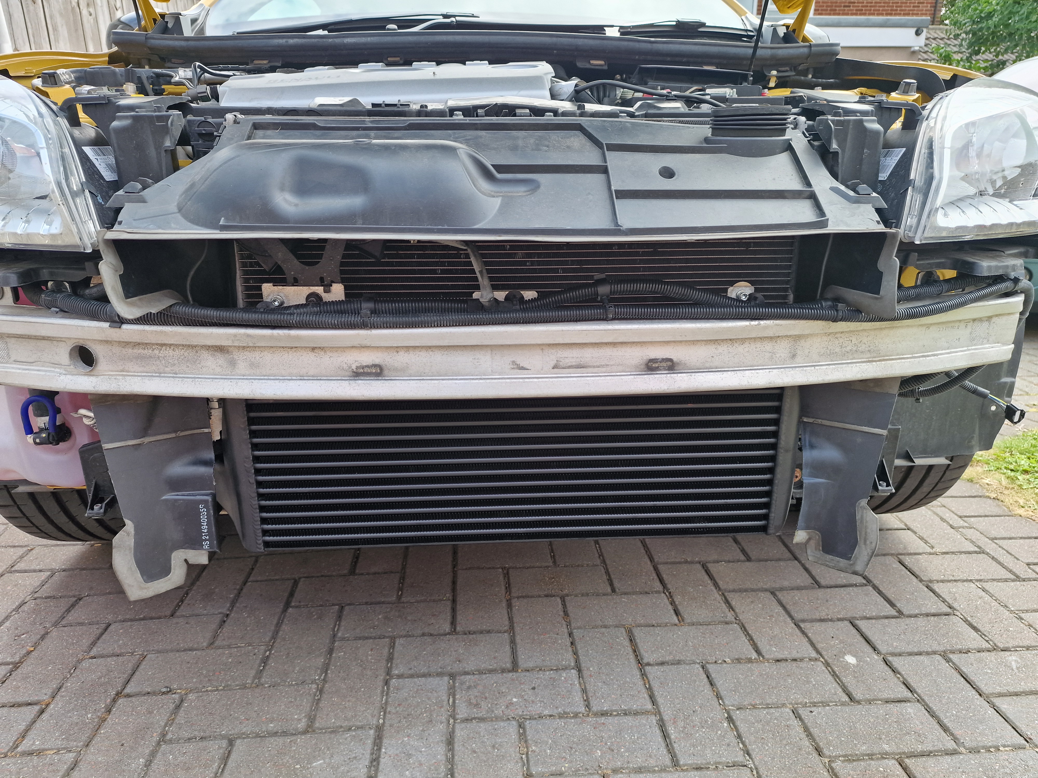

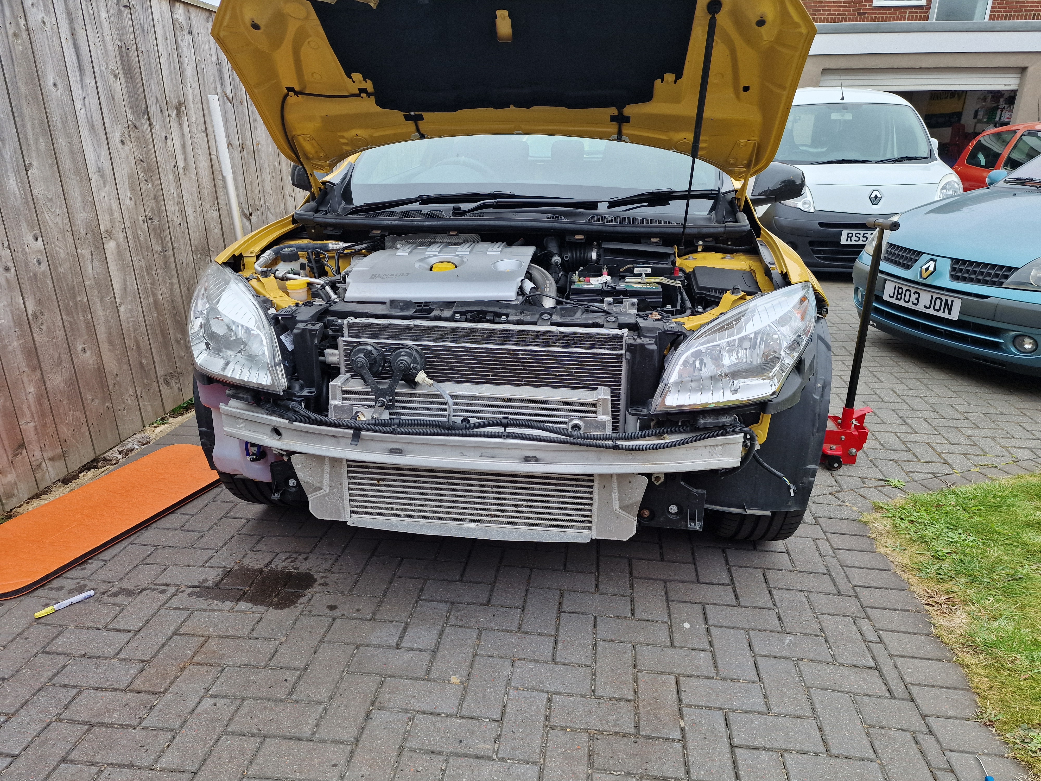

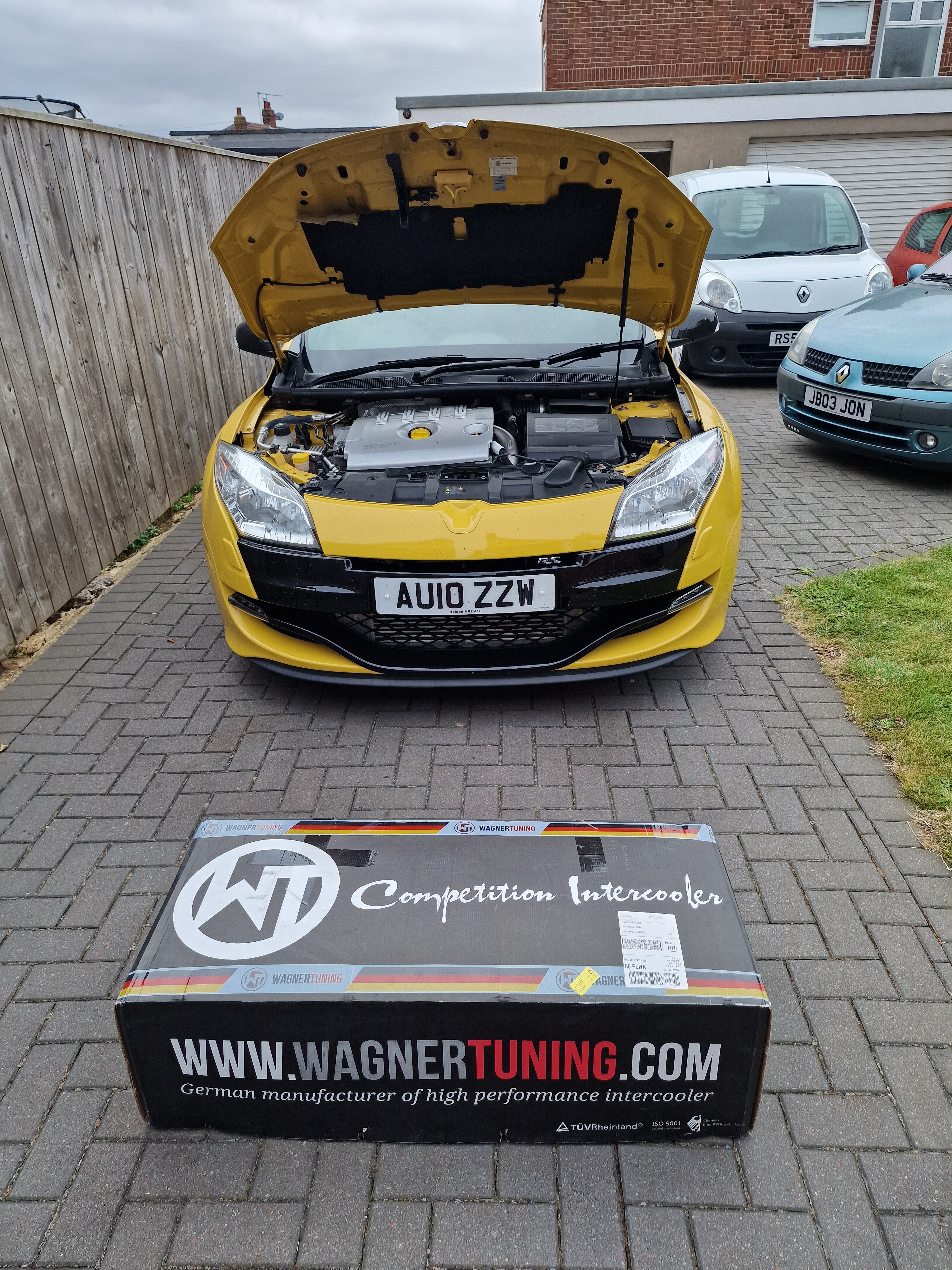

Fitted the Wagner intercooler today. Had this for ages but finally had some motivation.
Pre start checks.

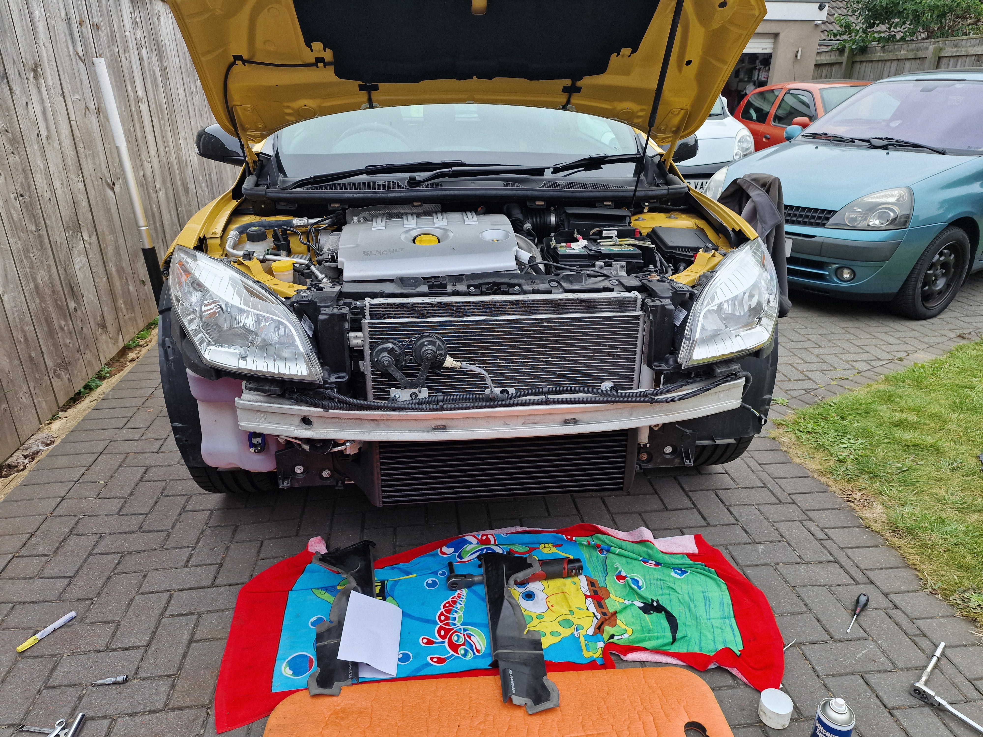

Bumper off revealing old forge ic.

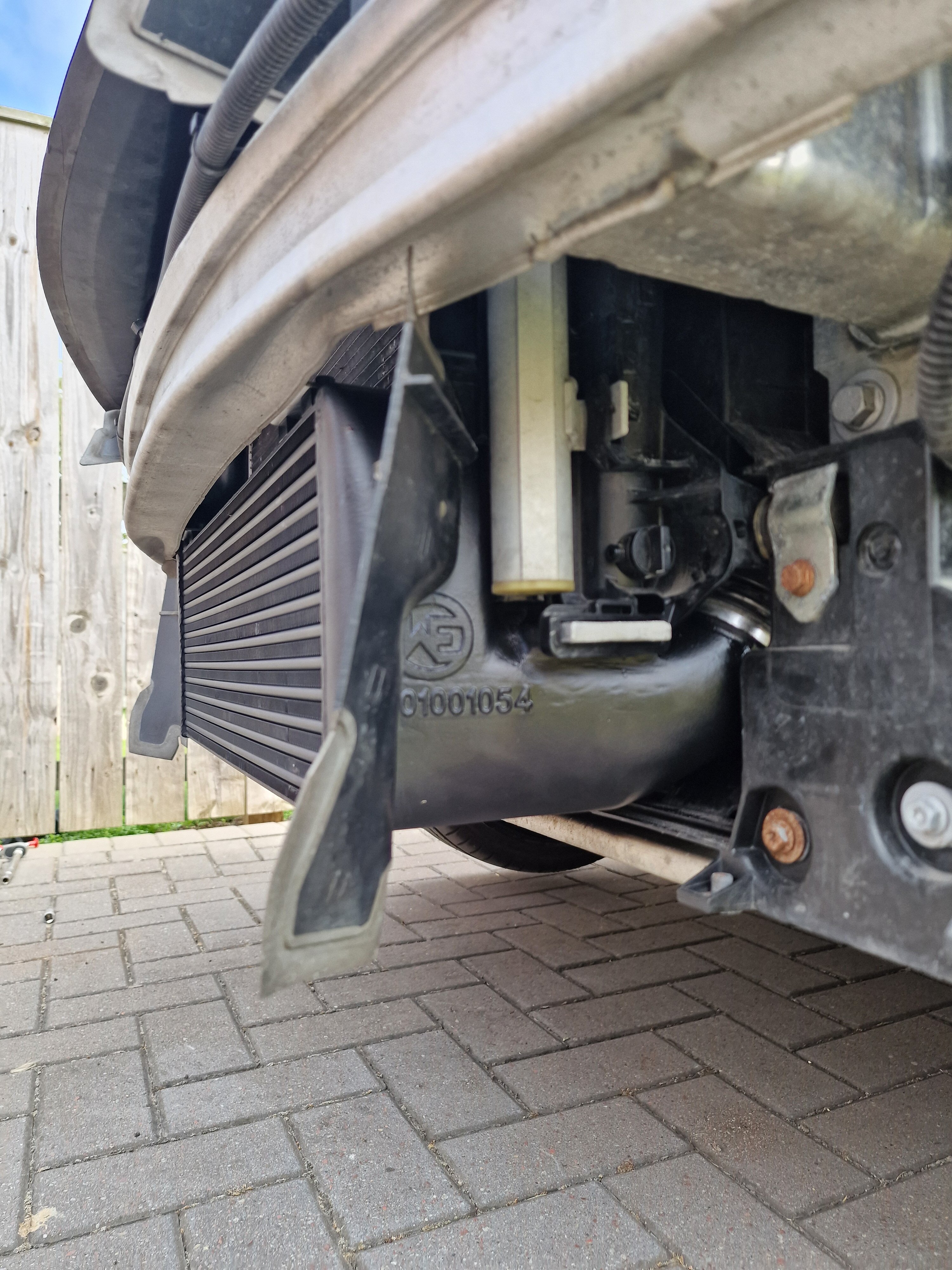

Forge stripped off and Wagner ready to fit. Its a thicc boy as the intercooler is L shaped and goes under the rad. Neat way to do it.
Fitted.
Oem air ducts scribed and refitted as were left off with the forge ic.
Wideboy.

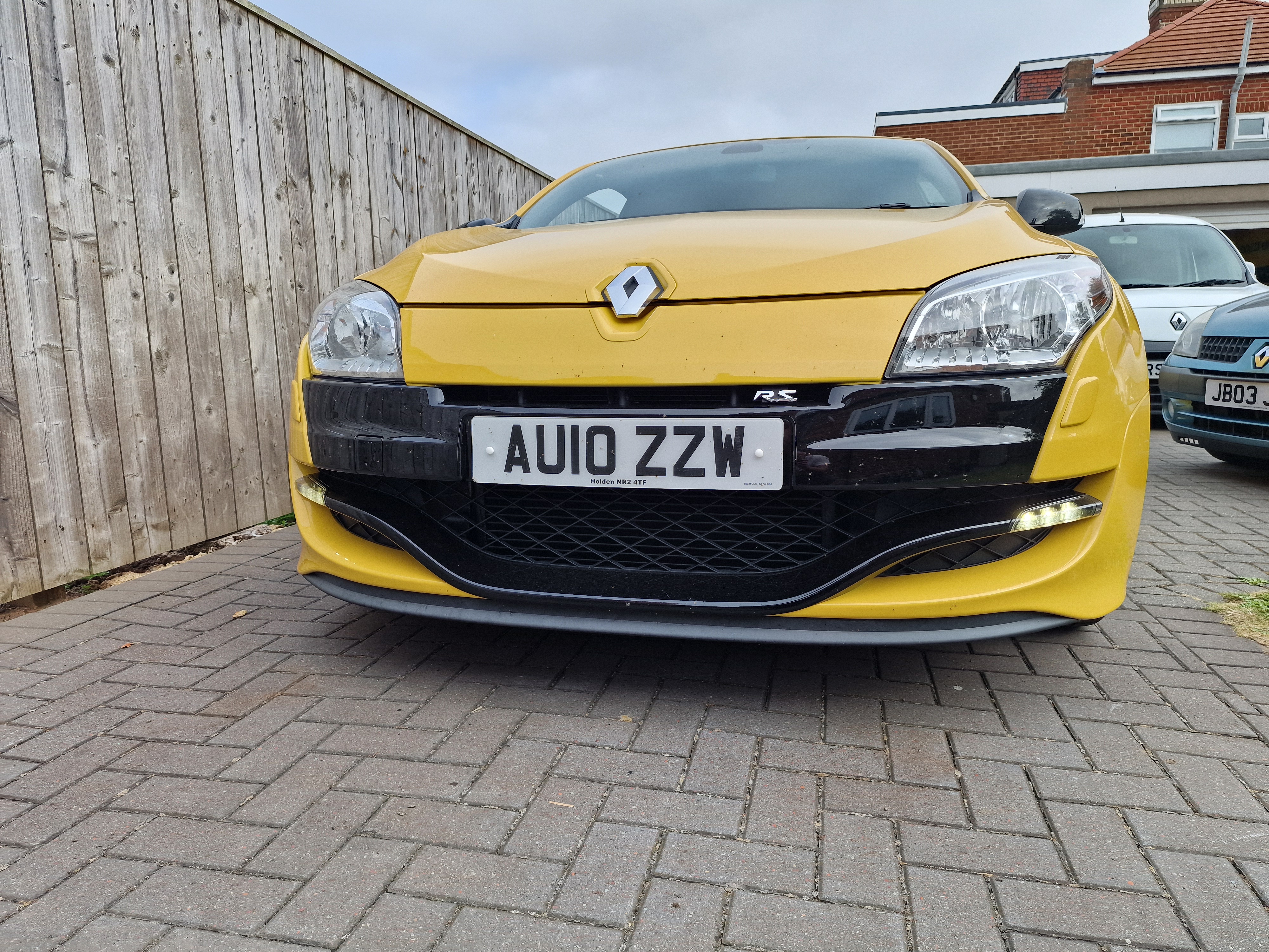

Finished. Prefer the discreet black intercooler.

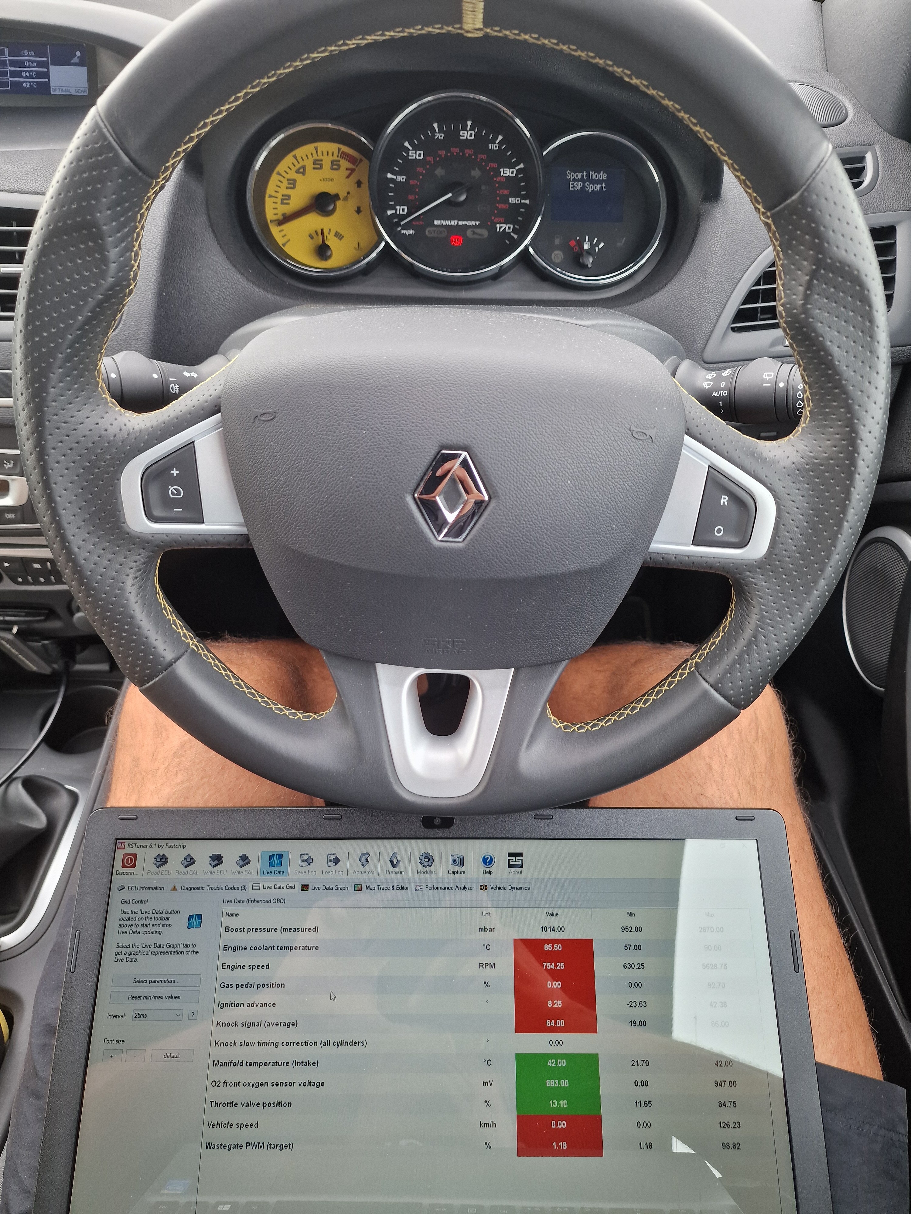

Took it out for a test drive with Rstuner on to datalog and it works miles better than the forge.
RsTuner.
The forge was not totally s**t as it was miles better than oem, but it lingered around 30deg on boost occasionally going up to 40ish degrees so overall not great. The wagner in comparison is in the 30s when driving normally and instantly drops straight down to low 20s when on boost.

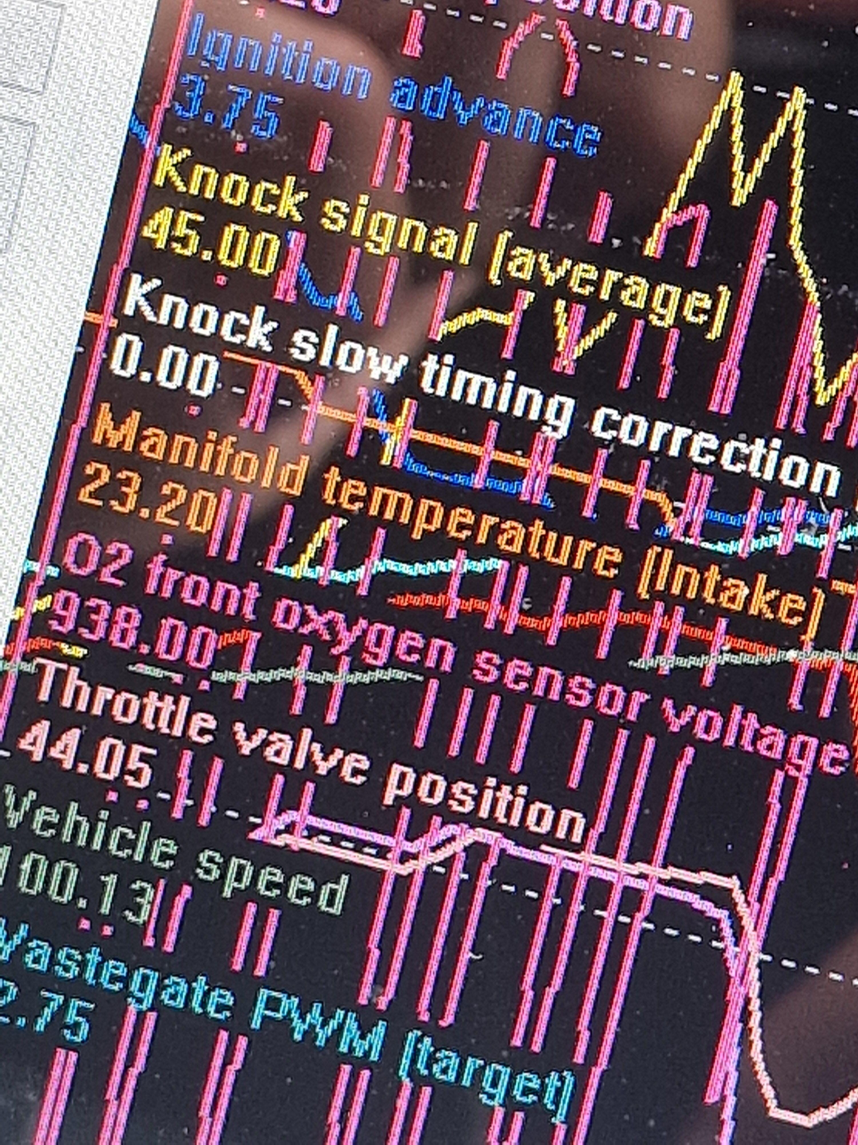

Another day another datalog.
The info you want to see. 23deg iat on boost and no timing pull.
Note no timing pull whatsoever today. I think it was pulling ign due to the higher charge temps yesterday. Boost pressure seems to be there or there abouts so could prob do some full 4th and 5th pulls it as is, but played safe and will get it booked into Efi for a map asap.
Need to change the oil and filter and its good to go.
