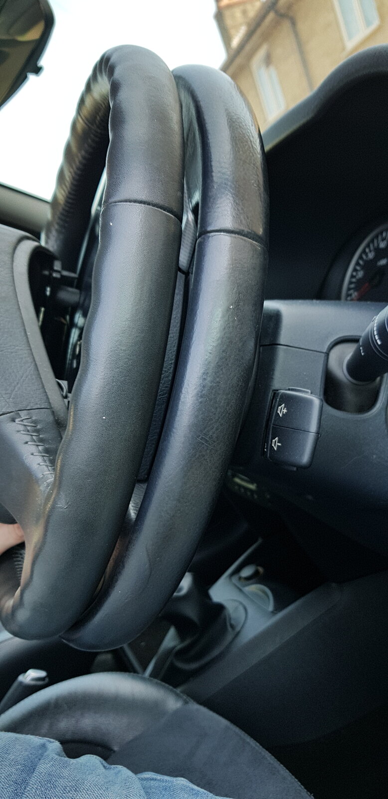

Well I've just received a 197 wheel through the post and it's almost exactly the same diameter as my 172 wheel. It's got some nice bumpy bits on the back, and the leather is in better condition, but i was expecting something a bit smaller?
Have i bought the right wheel?
They are the same size

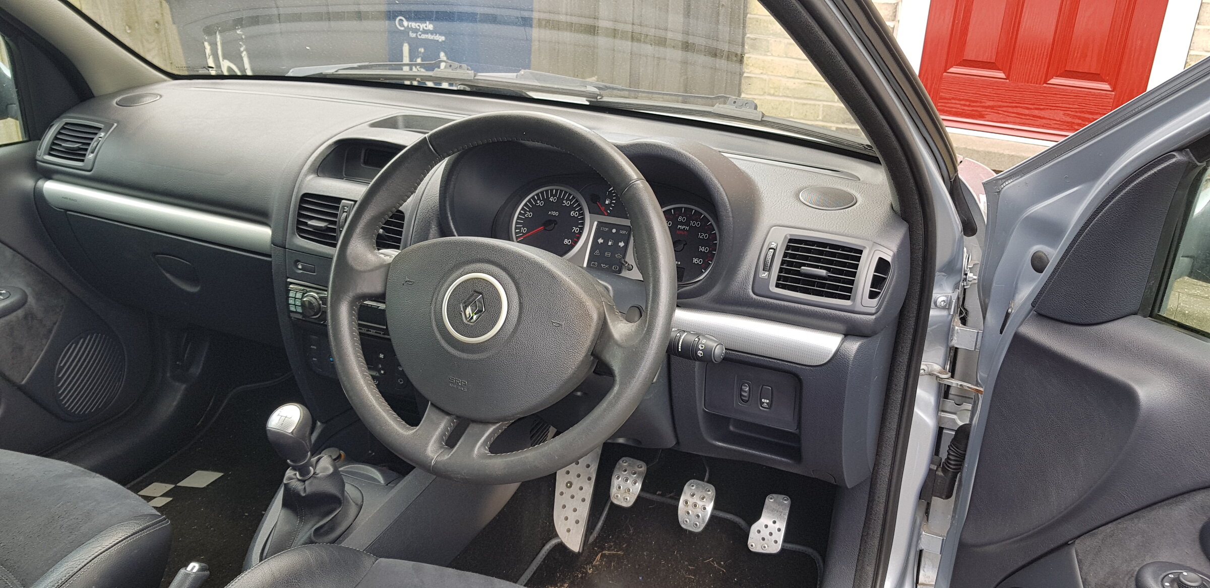

Feel 10x better when you're driving though
Done. Good to see that Renault put a key into the splines so you can't put it on the wrong way up, even if you try.
