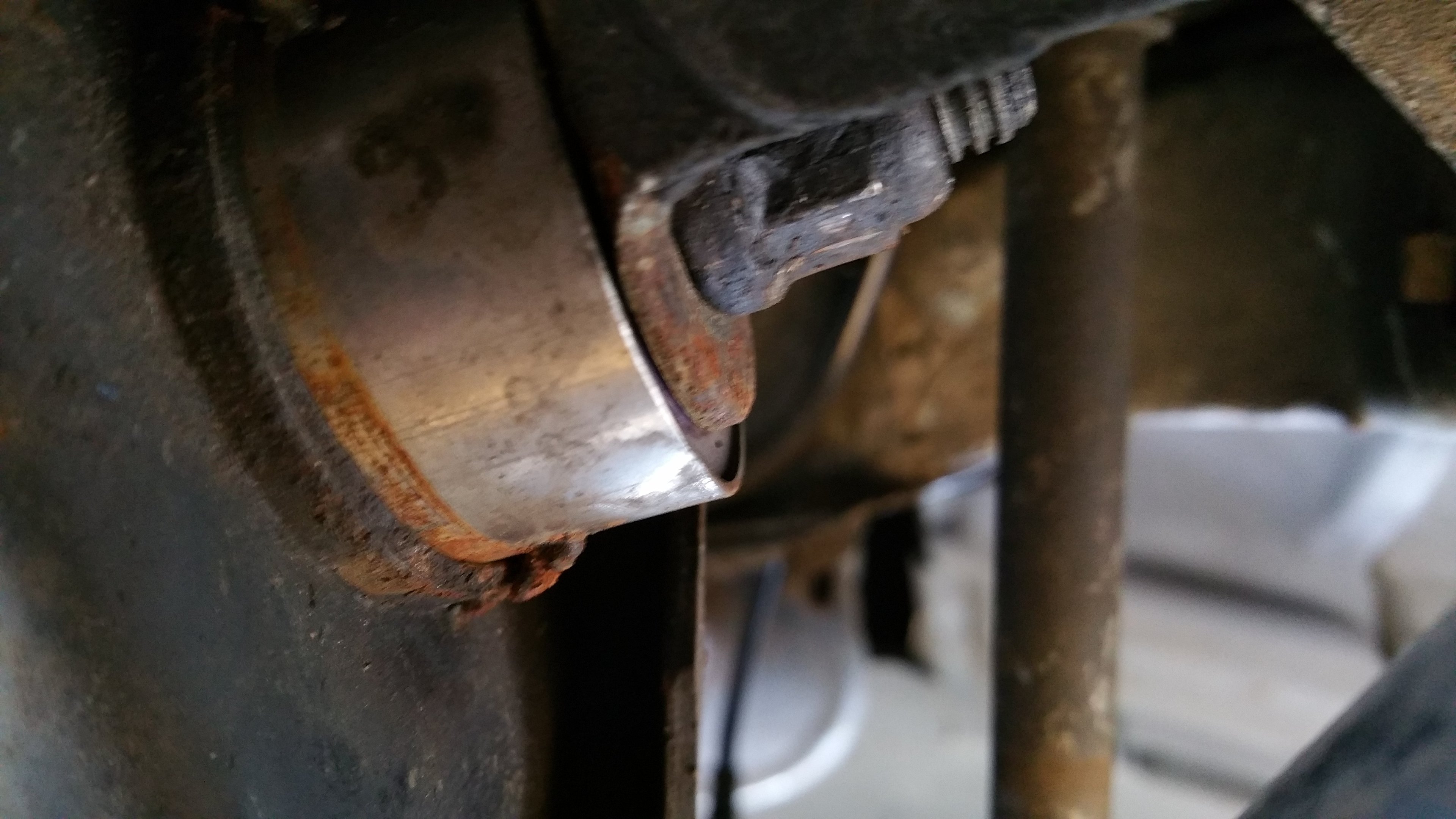

I have a knocking when pulling away and stopping. I got under the car and checked all the bits and bobs I have changed and I found that the wishbone bush metal sleeve on one has broken it's welds.
these are the powerflex ones old style.
I was wondering if there is any way to fix this without having to dismantle the whole wishbone setup. Just had the tracking done and if I do that I will have to redo it!
Please see the pic. You will see what I mean as the rust on the sleeve shows its moved.

It's not all doom and gloom really, they're press fitted into the wishbone and it's not unheard of that they move... Some guys put a tack weld on the bush after fitting to keep it from moving... Not with the rubber in tho as that will melt it..
I actually think your tracking will be fine... The movement back and forth would affect your caster I'd have thought...
These were tacked into place, looks like a pot hole may have knocked this one loose.
The bush itself hasn't moved as the thicker side is stopping it. But the sleeve has moved which is annoying as it was a pain to fit in the first place.
I have a knocking coming from that ares, so I'm presuming it's that causing it. I will buy the new tyre powerflex and when I can I will replace them.
