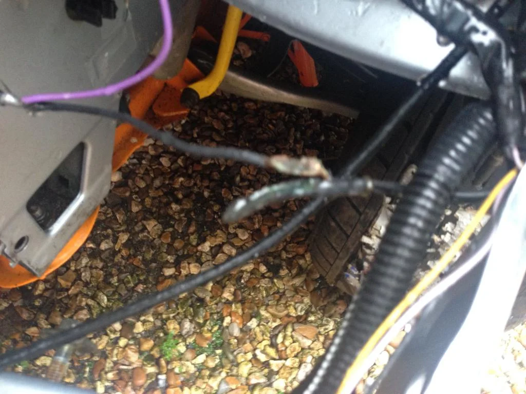

Yeah I have connected them but one is not looking so Great .
could this be the issue ? How do I repair this earth ? Could I solder a new wire and bolt to the earth point ?

No I haven't Modified the loom .
