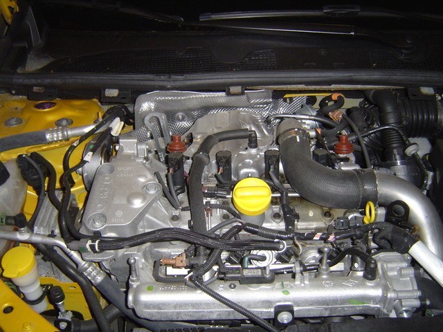

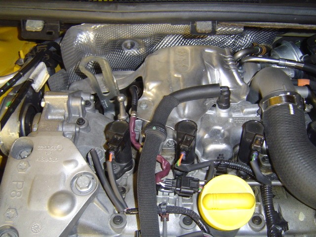

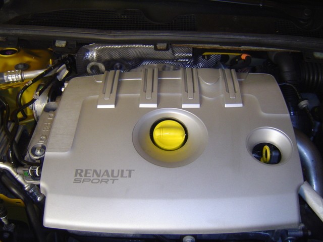

here we go: engine cover off:

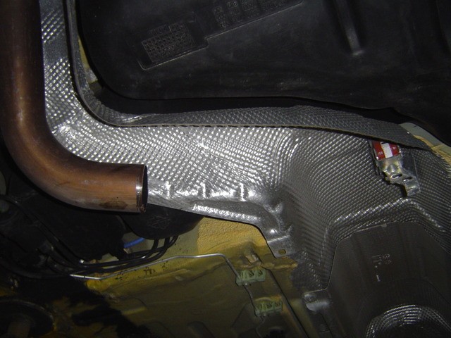

before that, cut the pipe between middle and last silencer:

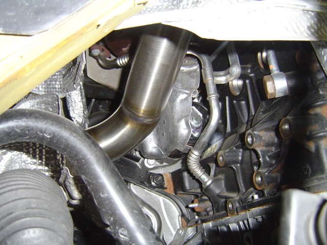

and now to the install of the mrs3 n4 rally exhaust system.

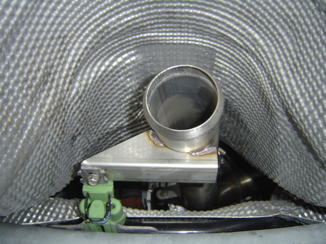

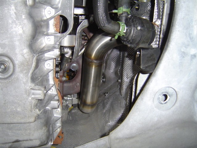

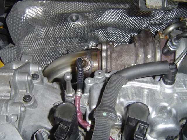

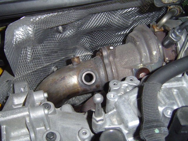

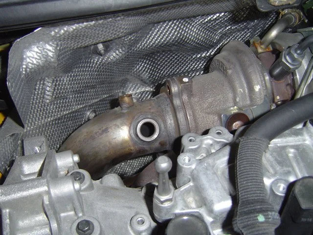

downpipe fixed to the turbo,install the lambda sensor and plug in:

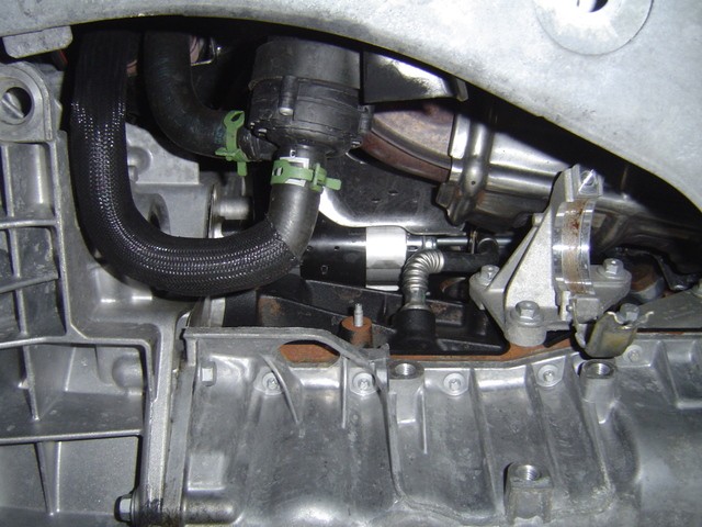

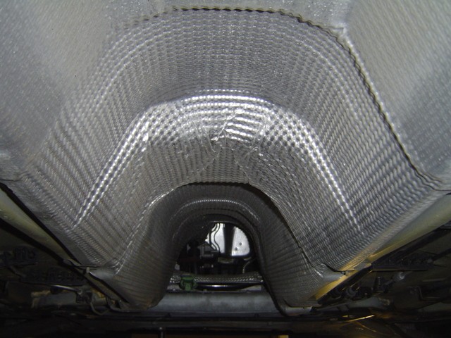

without the original catalyst, there's a lot of space:

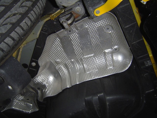

mounted the shield from the top:

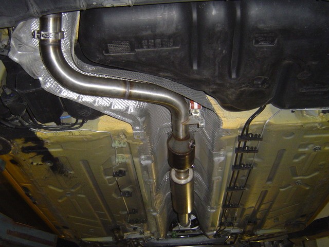

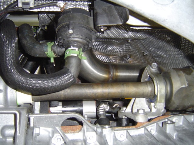

mounted the middle pipe with silencer and metal cataylist:

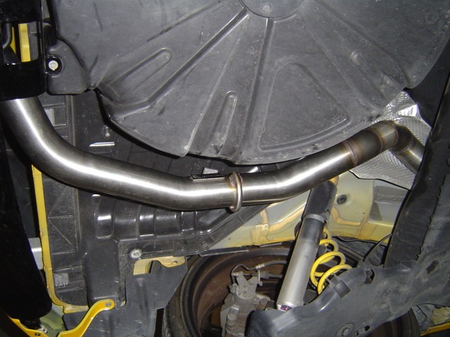

mounted the rear pipe:

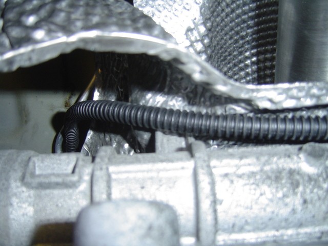

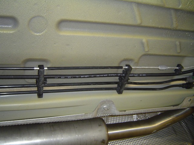

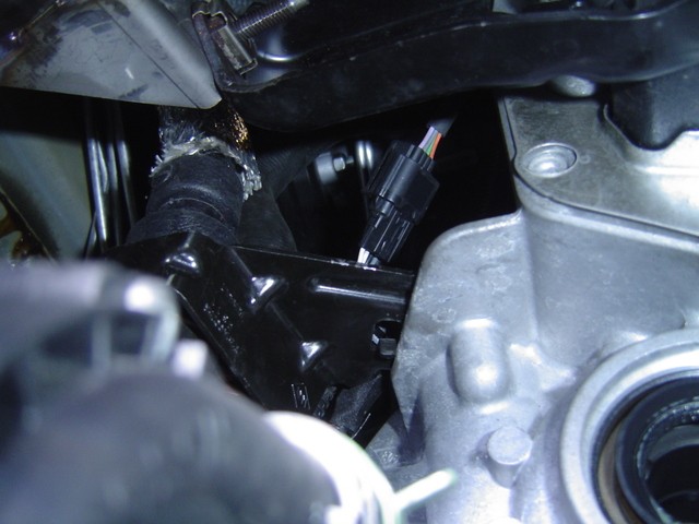

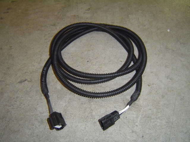

because the second lambda sensor is mounted further back,
I have made a plug&play extensions cord with original connectors on it:
near the gearbox reconnected:
past the steering gear:
clipped in the original conductor holder:
to the second lambda sensor:

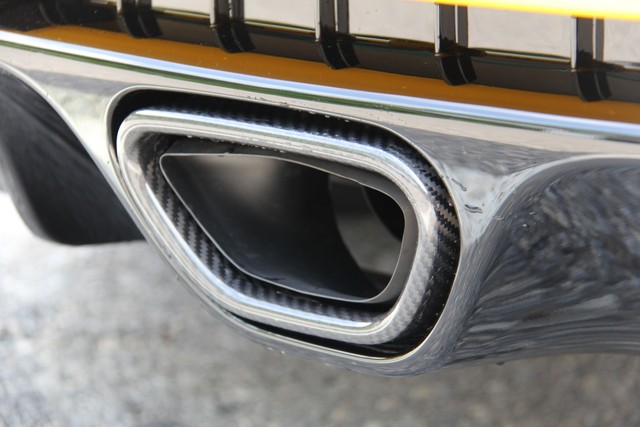

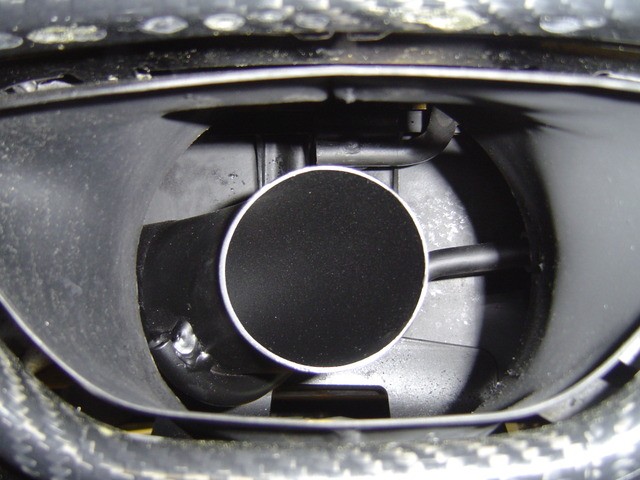

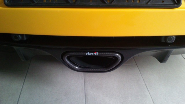

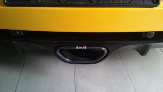

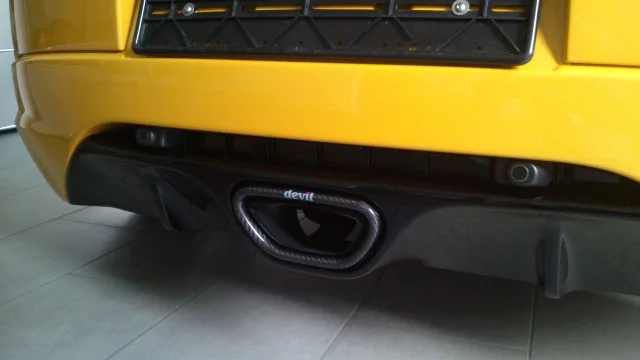

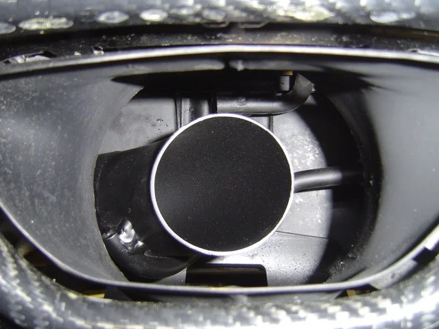

the hole mrs3 n4 rally exhaust sytem fits perfect. also the tailpipe fits exactly in the middle of the carbon cover without adjustments:
[ATTACH=full]1206197[/ATTACH]

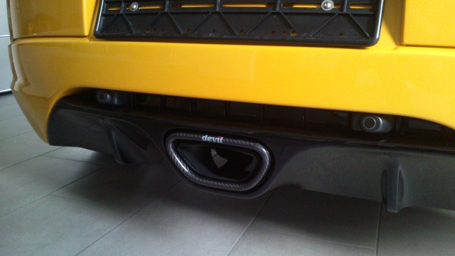

finish:
from the outside it looks nothing. only small hints point to something other sound and performance:
