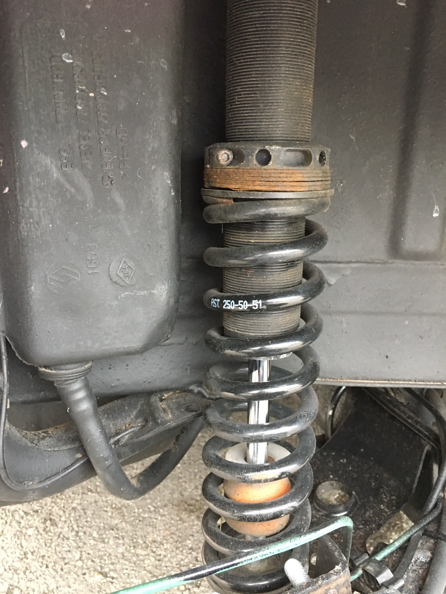

I’ve got this 5100 setup..I’m not 100% sure but think they are 455lb front and back.
Last time I was at Thuxton the instructor said the car was overly stiff!
He even made me come in and back all the dampening to the softest setting.. he still said it was stiff 🙈
@Simon@ASTUK can you shed any light?
Soz to op for high jacking... obviously my tears are 250 x 50 x weight ?

@Simon@ASTUK can you shed any light?View attachment 1354795 View attachment 1354796 Soz to op for high jacking... obviously my tears are 250 x 50 x weight ?
As has been mentioned, thats a road spring setup and will be shimmed as such. 65/50 we now do 70/40. but not much in it at all.
Interesting as it's gonna depend on the preference of the driver. Take it round on really soft setup and it bounces around out the back at full throttle, you are going to unsettle the car. I can see the logic in not wanting to run hard though, a stiff rear could slide and you may not want that. Then you have to consider losing out at the complex potentially getting it right in the fast sections.
As usual it's the bum dyno. Try a few changes and see which is the fastest for you.
