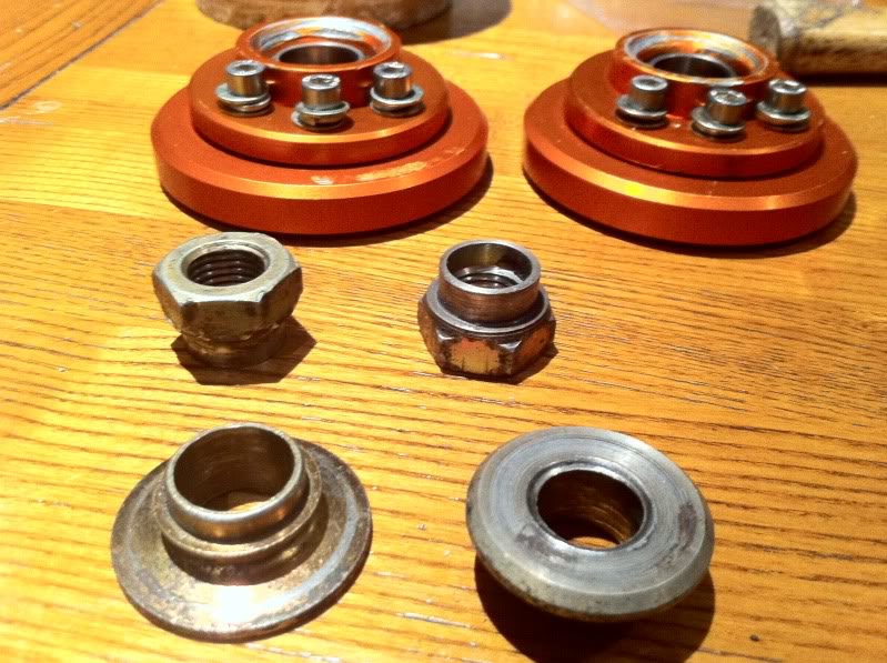

I purchased a secondhand set of AST Top Mounts that came with all these bits:

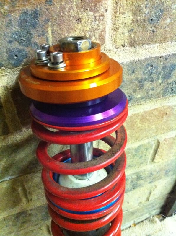

I've mock put them onto the coilovers with a KW tophat that i've got hold of:
Should there be a bearing between the top mount and the top hat? Am I missing that bit, or is it part of the top mount?
I've tried to call AST but never get through.
isn"t the bearing inside the top hat, I haven't got a set but would expect it too be mounted in there making the mount solid.
Yeah, you are right cheers. I got through to AST in the end. I'm missing the plastic bearings.
