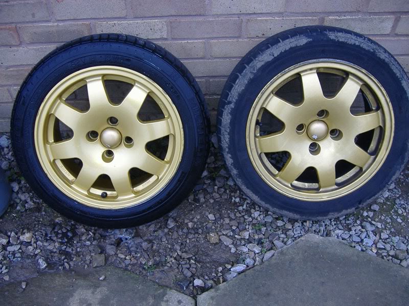

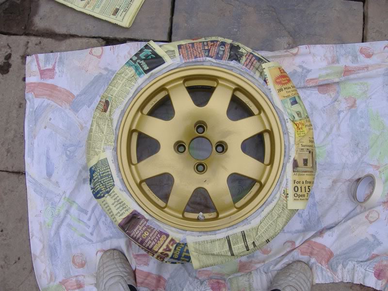

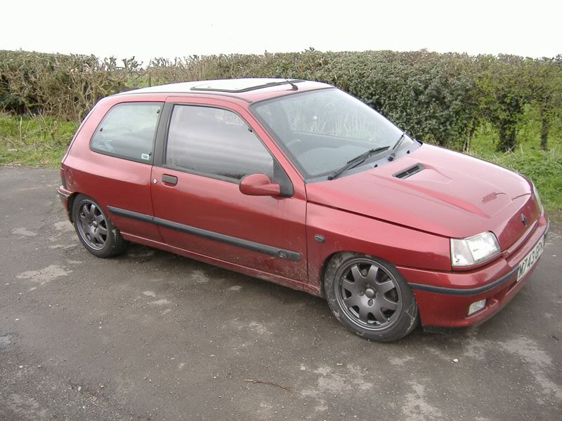

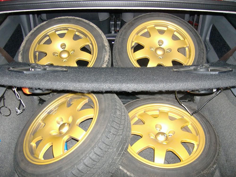

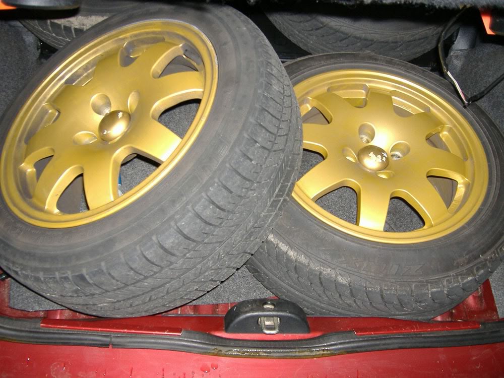

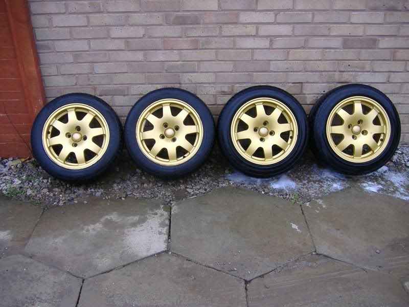

Picked up my set of willy wheels tonight, will update the thread as i go along with new pics, doing a home refurb on them:)
Can't complain for the price with 4 good tyres:cool: In a very manky shade of gold though:dead: Still that doesn't matter as they'll be sprayed, at least they're not curbed.
Resized the pics but not enough lol:o

is that a photo of my mate petes valver?!
edit: actually no it isnt as he hasnt got an exhaust like that
but hes got a lowered naples valver on black willy wheels, with a polished lip and black renault badges.. LOL

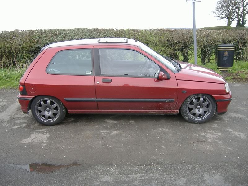

nope, its a shop of my valver outside my house lol
i'm unsure whether or not to polish the lip on them thoguh.
hopefully will be rubbed down and primered if it's dry tomorrow mate, harldy need much sanding tbh :)
My mates just refurbed his willy wheels at home and put a polished lip on them and they look the bee's knee's...was hard work doing them though!!

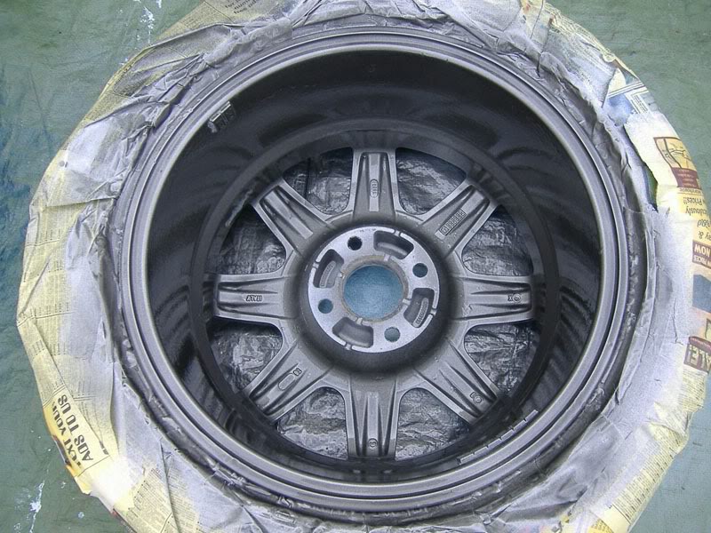

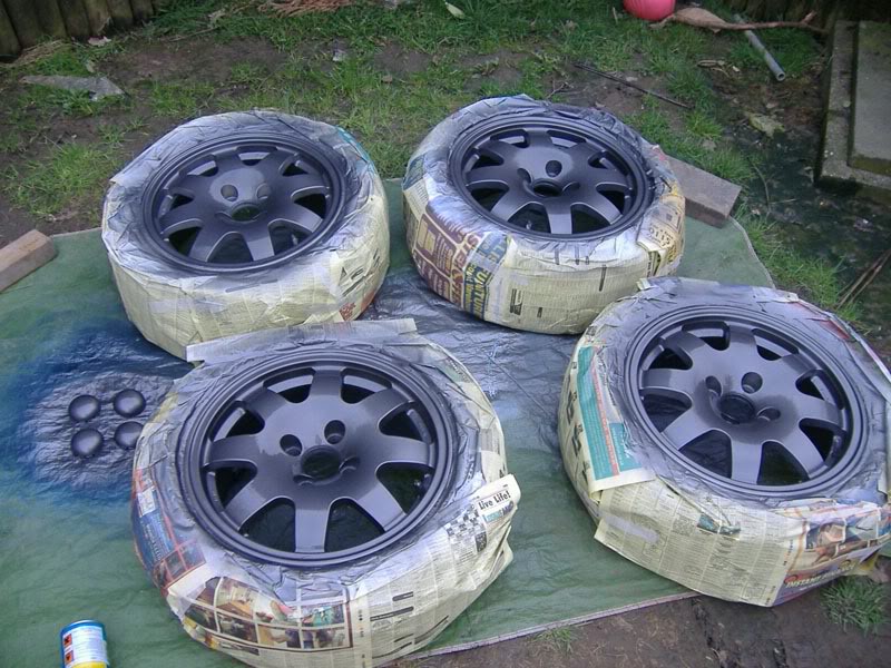

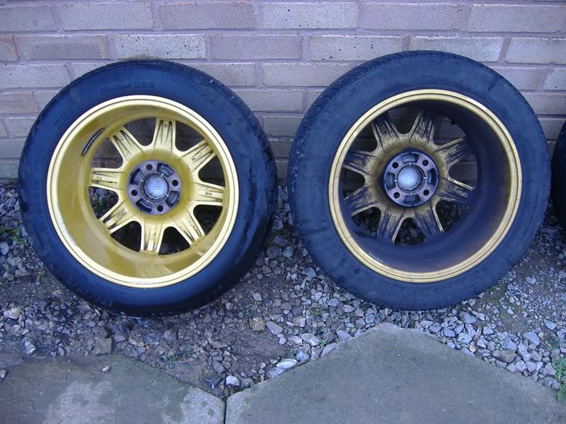

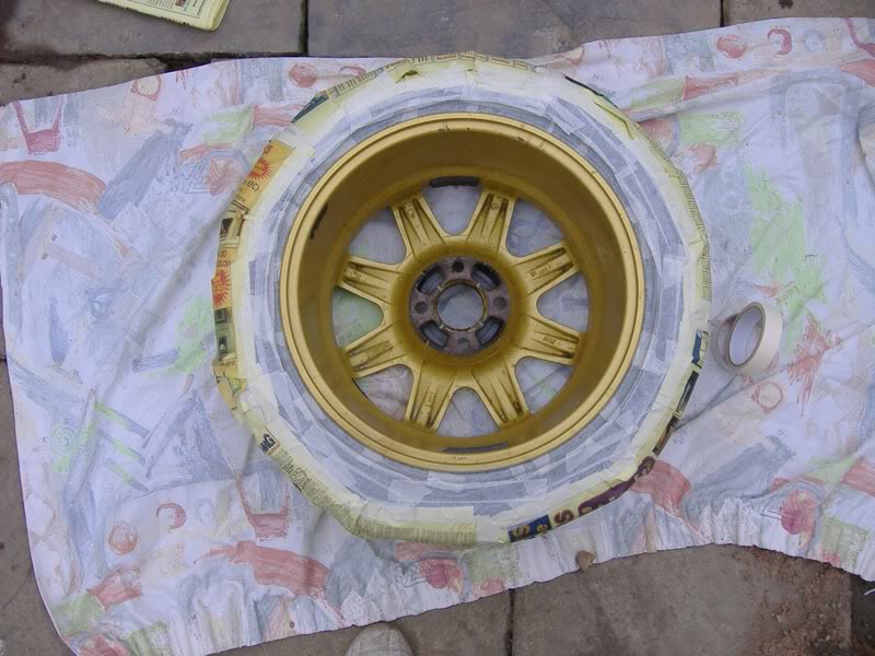

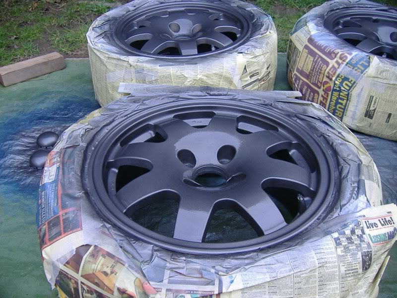

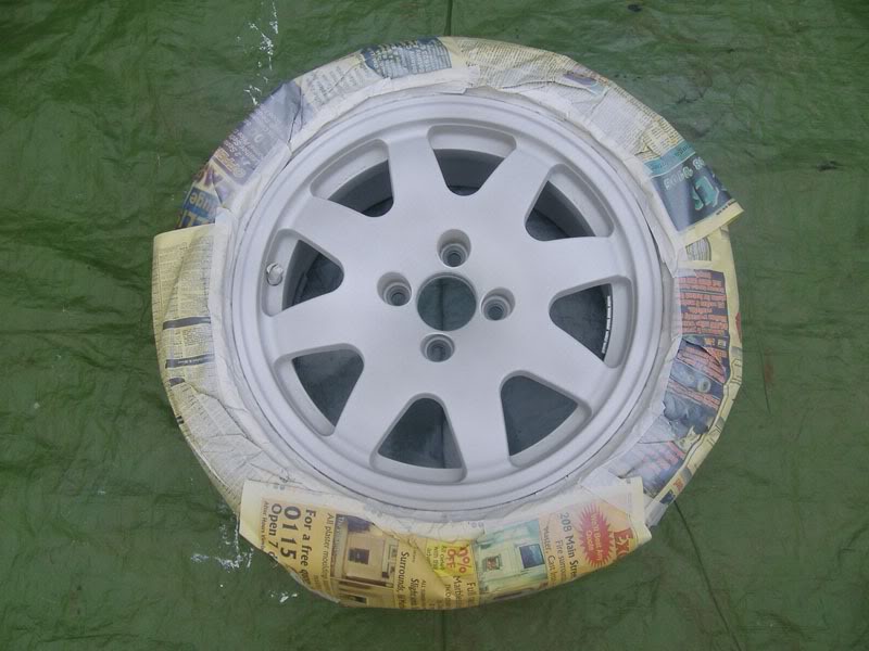

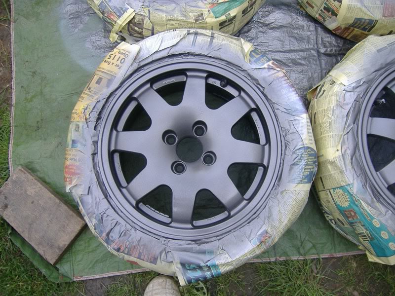

Been busy today, was up at the crack of dawn, wheels have been cleaned of all sh*te and brake dust. Sanded smooth, two coats of primer, and 3 coats of Gunmetal Grey (rover shade:o ) Now i'm going to give them a few coats of laquer, pics so far of todays effort
Clean & dirty
Clean & dirty
All clean
Masked and sanded
Rear
After 1 coat of primer

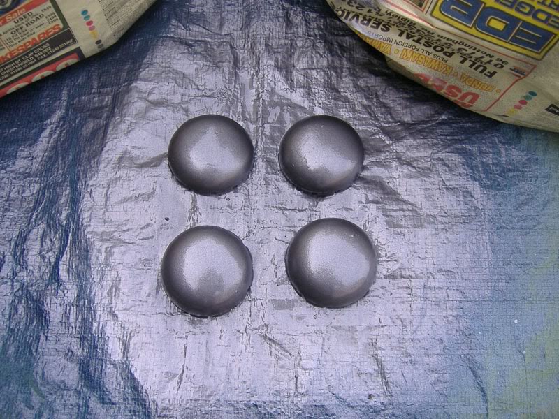

Centre caps painted
Close up, front after 3 coats

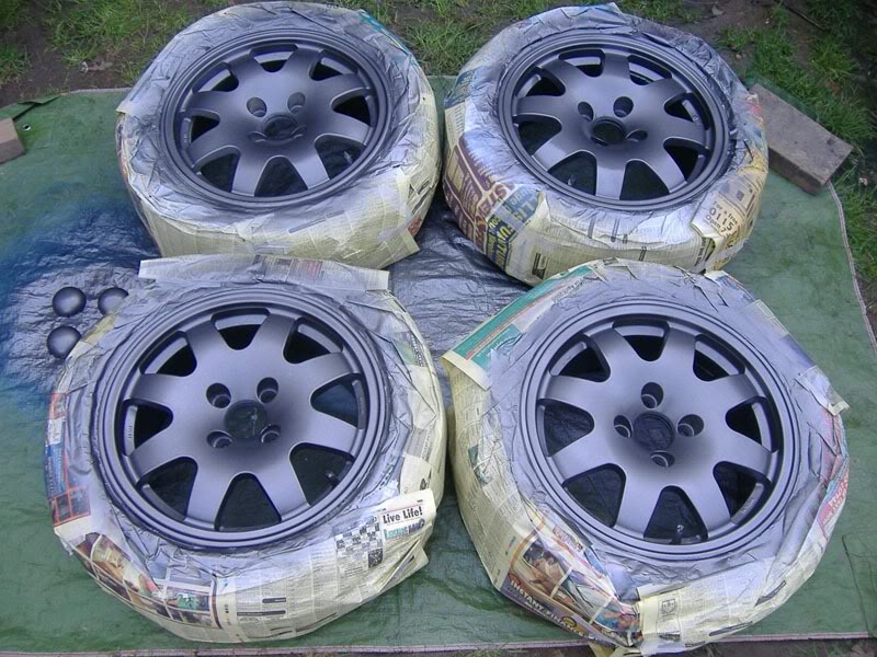

All 4 painted, ready for laquer:D :cool:

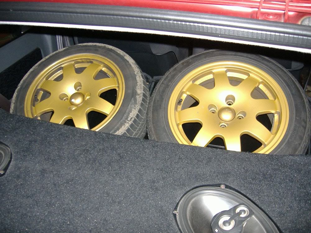

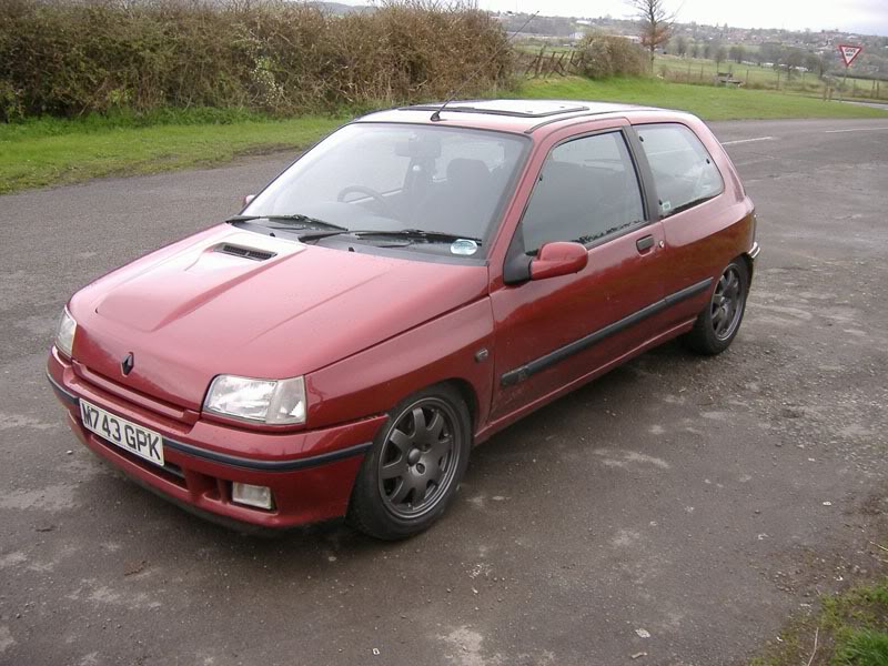

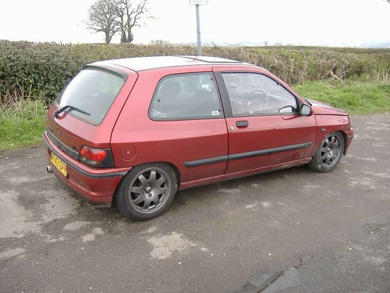

lol i admit it, i'm too tight to pay to get them taken off and put back on and also too impatient as i wanted them on the car today:o they're on now:cool:

Great job mate, looking very good. Guess you didn't wait for coats to fully dry?
Cheers, i left them so that they were dry to the touch but couldn't be doing with leaving them 24hours inbetween coats etc:clown:
looks mint :approve: the muds a nice touch ;)
one other thing, dont u think the paints a bit fresh to put them on the car? should imagine it'll chip really easily cos i know u're meant to leave the paint 24 hours to cure anywaY?
yep it probably is lol, i'm gonna give them a few more coats of paint and laquer over the next couple of weeks anyway i rekcon, cos it's a bit thin and i chipped it with the wheel brace :( looks allright for now though :)
