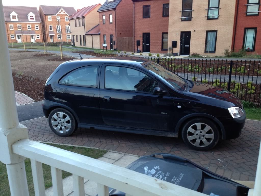

Picked up an 03 plate run around corsa that which is probably best thing I've done in all the build no more rushing everything

I got a 1.2 corsa C a couple of years ago off my mum with 30K or so on it, its on 105K now and ive hardly had to touch it, epic little car and SO much easier to parellel park than a clio for some reason!
Beast!!
I had a 1.3cdti as my first car, awesome little run arounds and so so easy to park i do agree!
How long till Dan drops a zlet in the corsa? :P
If it's a 1.2 like mine it has the same Ecu as a zlet so its an easy conversion. Been tempted a couple of times but at least this one is harder to get points in than the clios (still got a few though. Lol)
