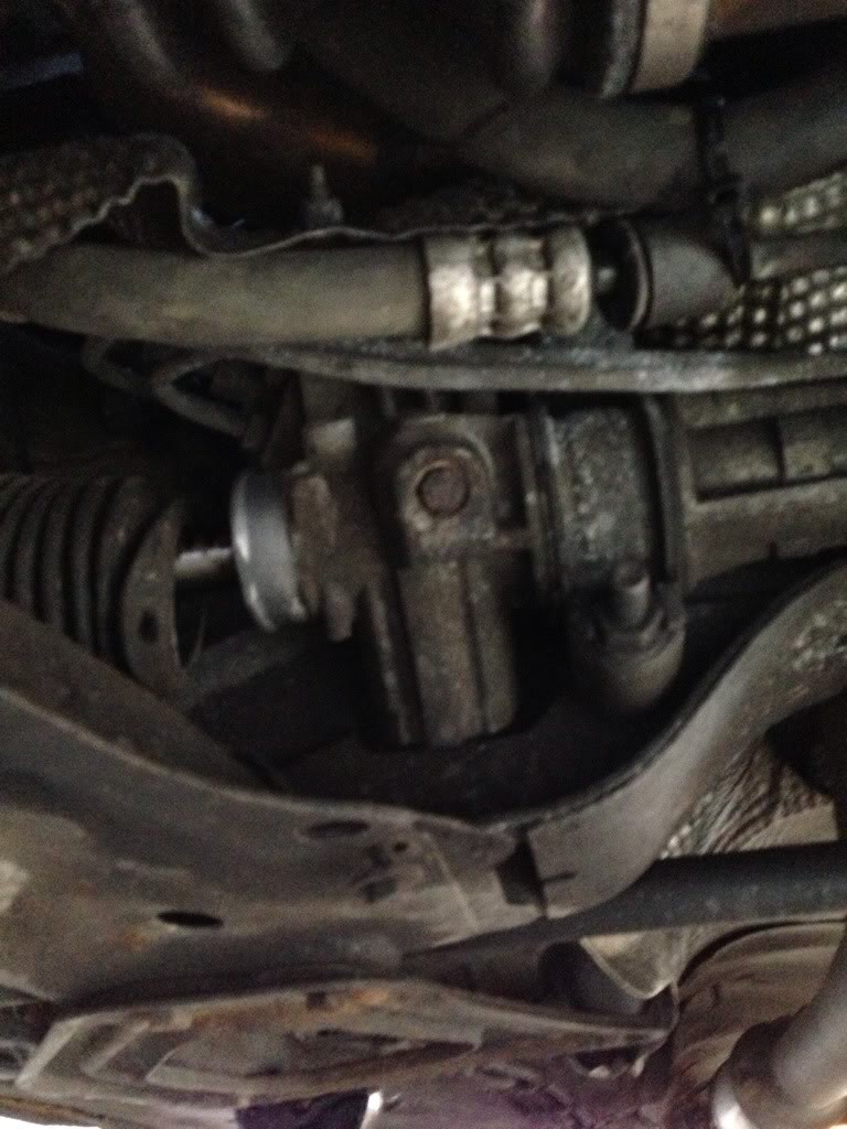

To the steering rack issue this is the bit the squelch noise is coming from i undid the gaiter btw:
You cant hear a single thing in the cab though the only way i can tell theres something wrong is the sharp steering is ever so loose and sways.
I think im going to go for a new rack and see how i get on
