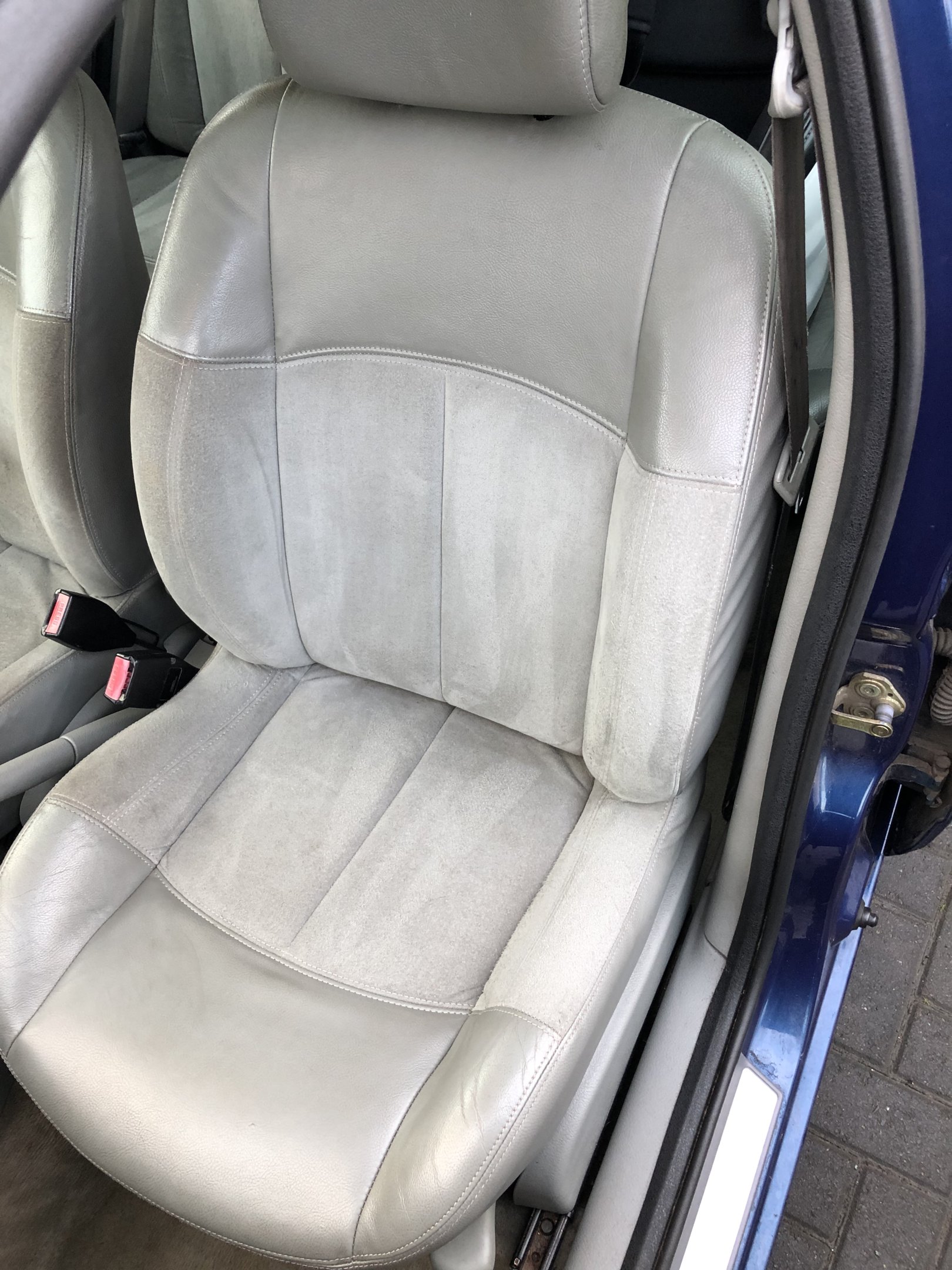

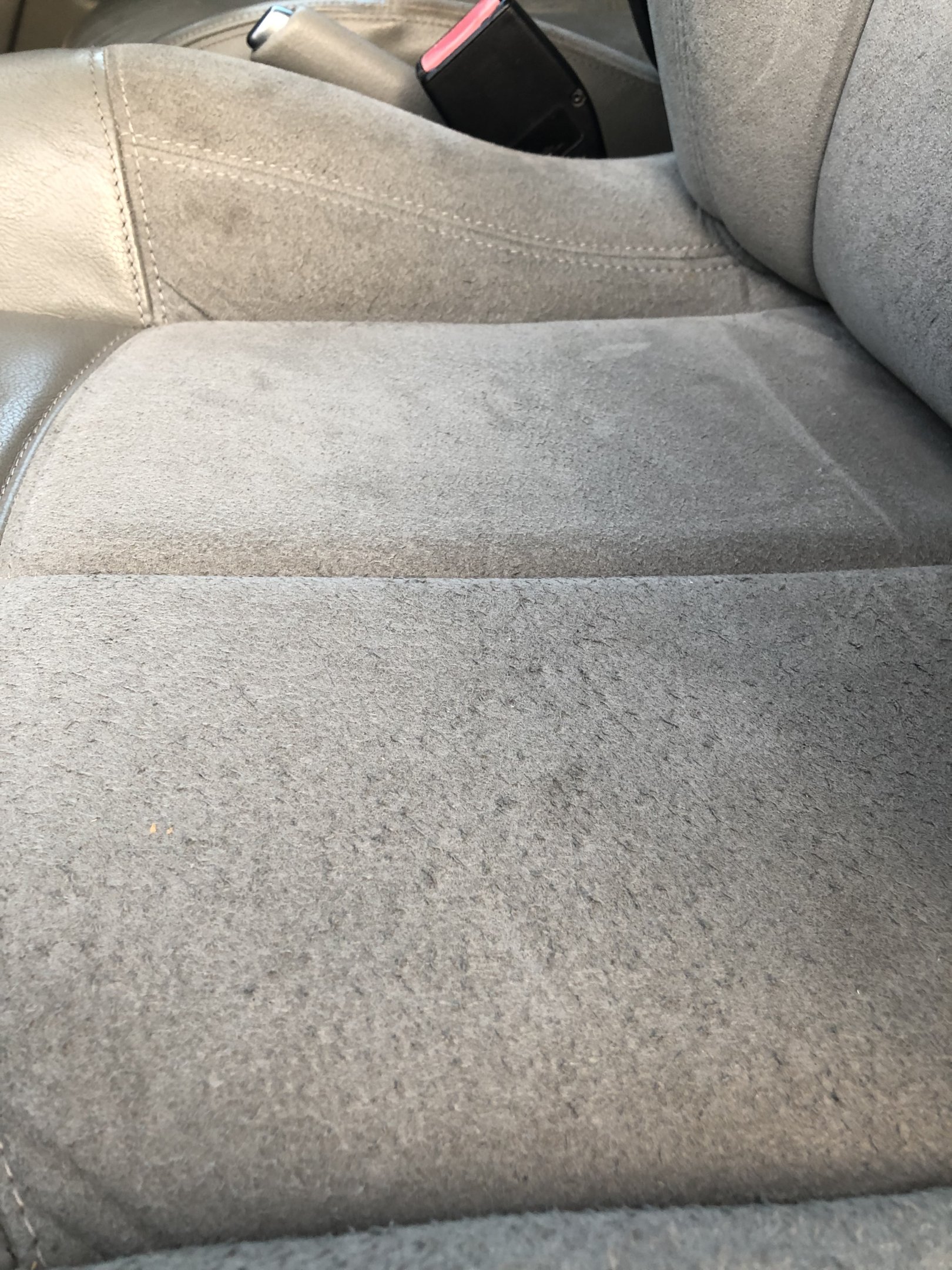

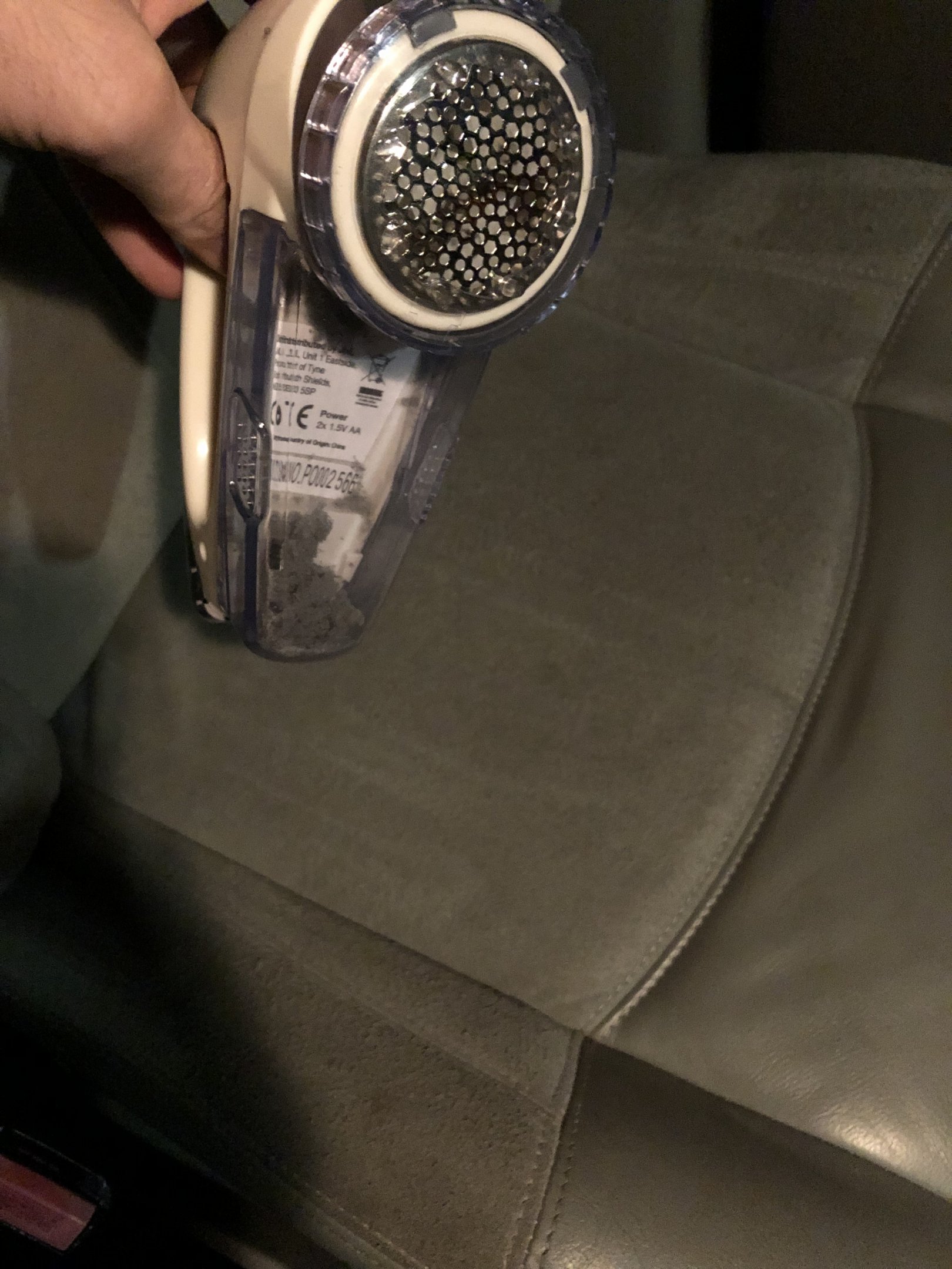

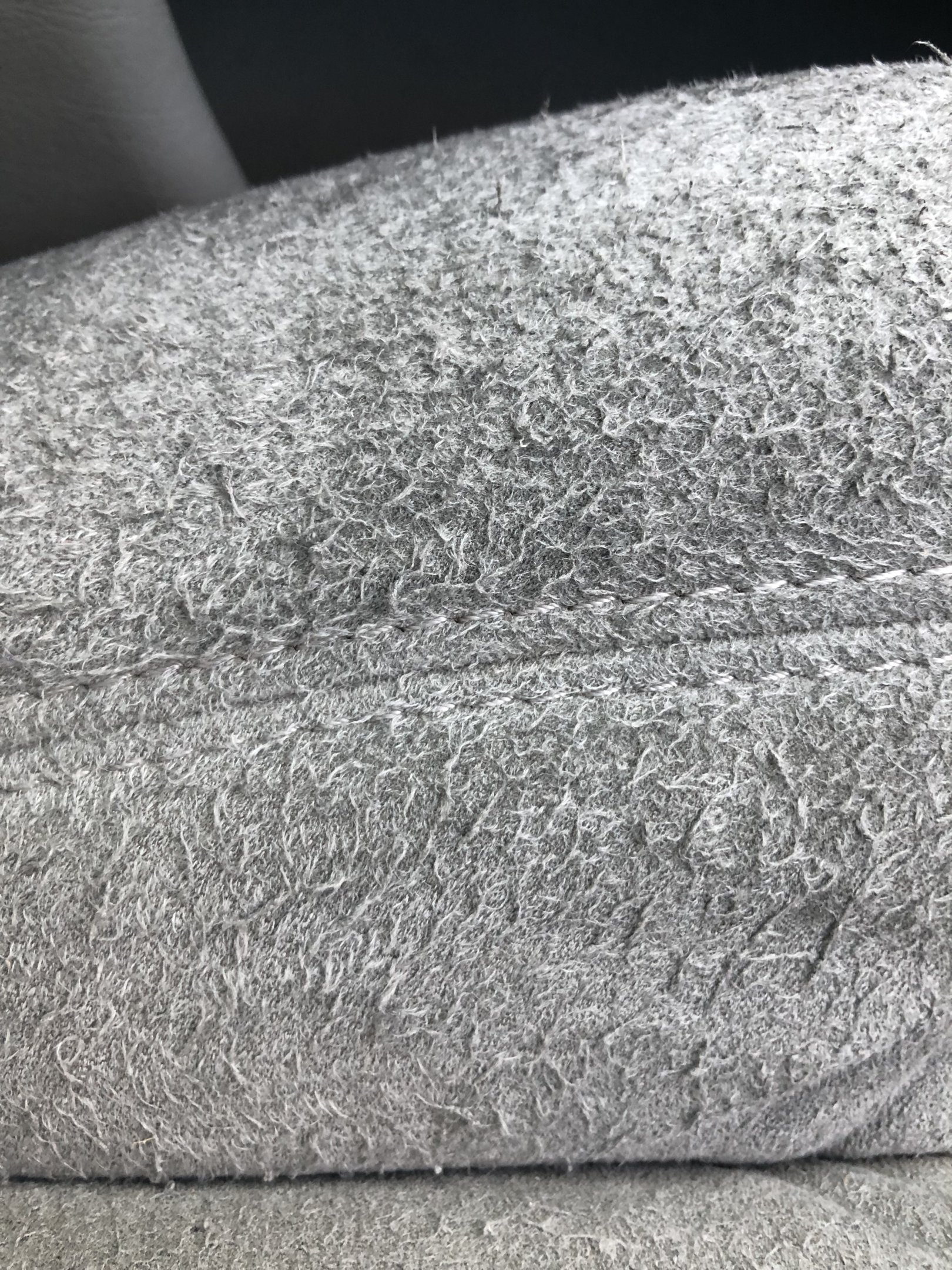

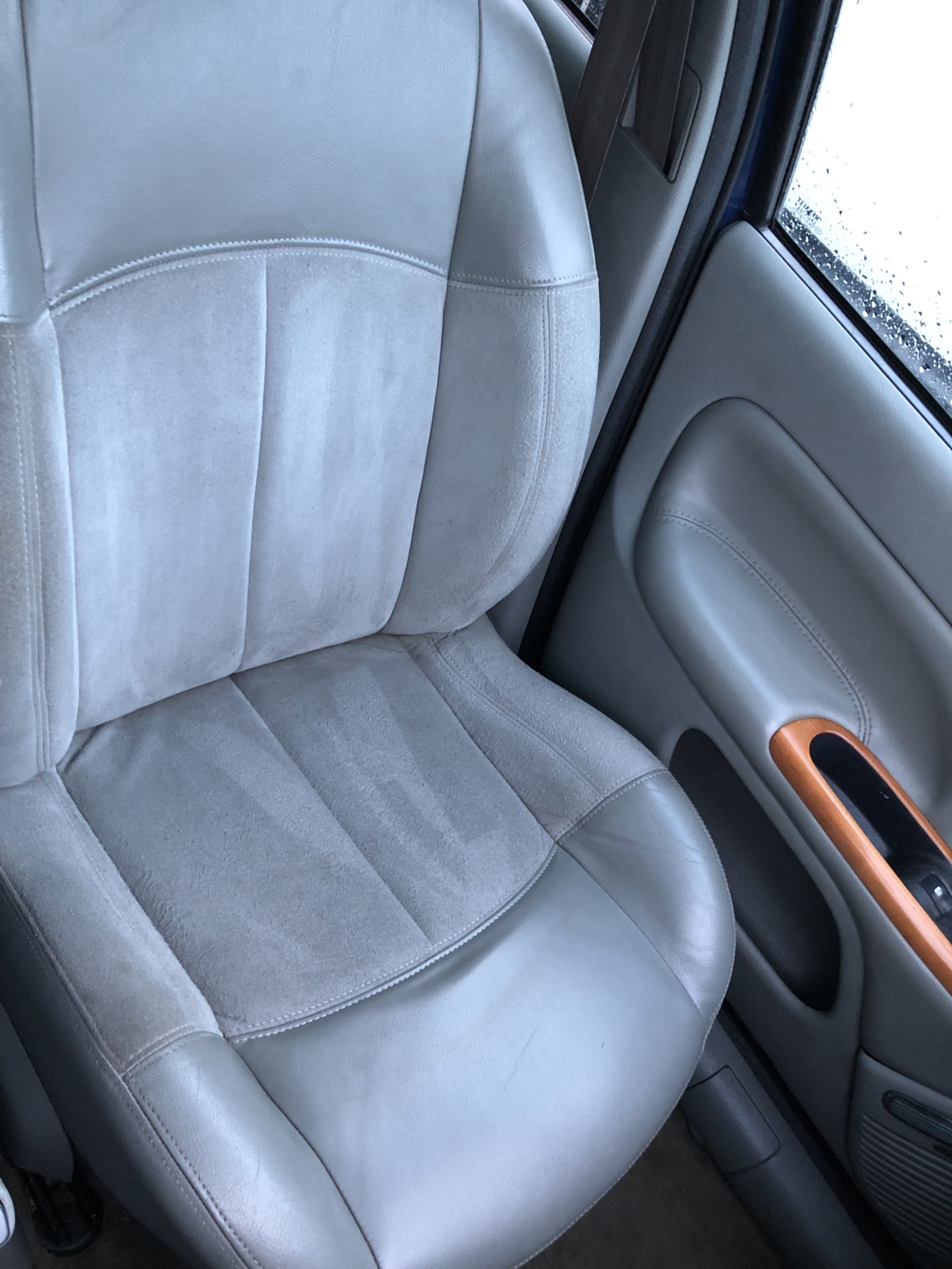

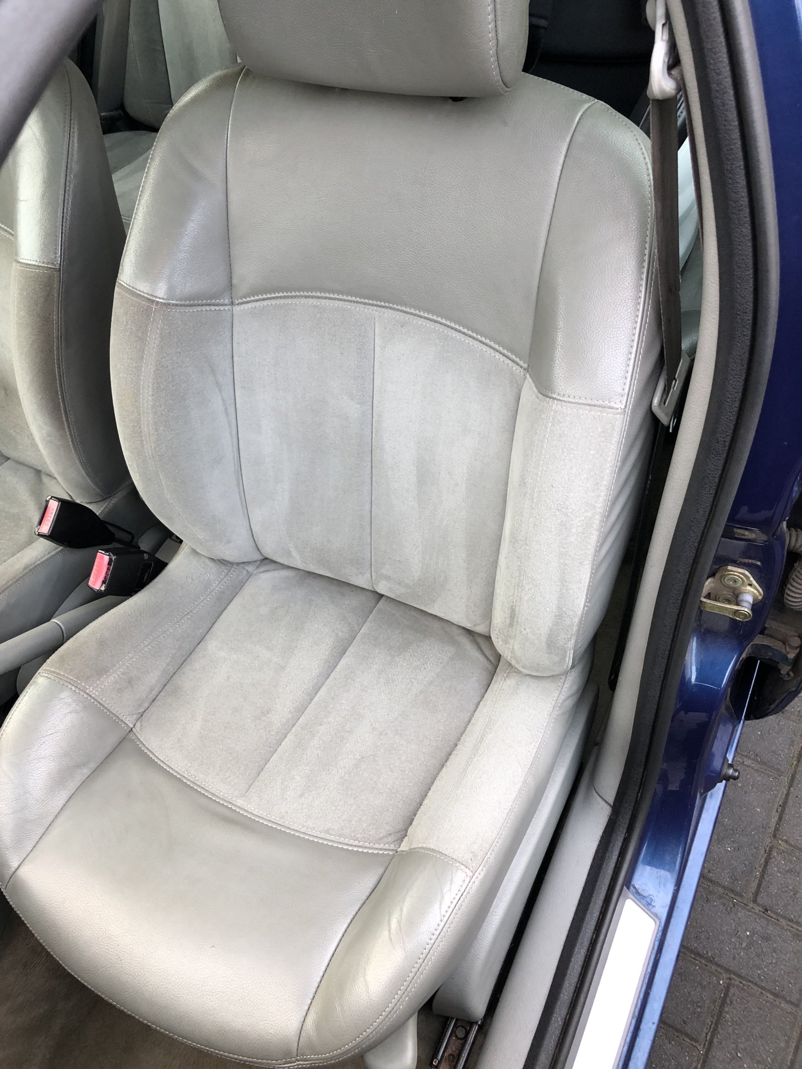

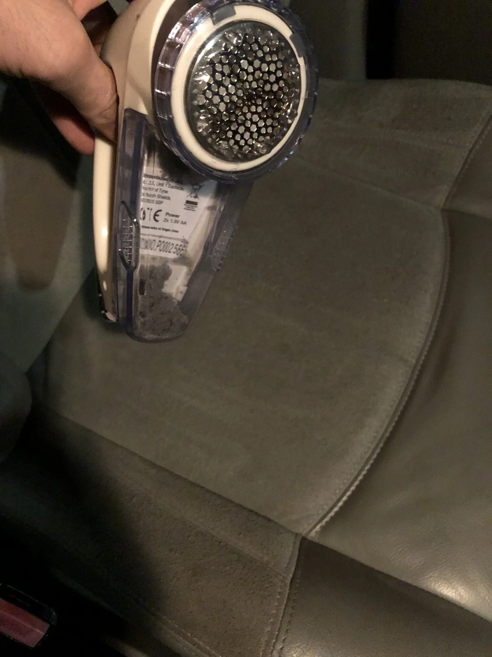

Im desperate to give the Initiale a good clean, but the weather is putting me off. The interior is filthy, the carpet needs a wet vac but will have to wait until we have warmer weather or it wount dry out. At the minute im focussing on mechanically getting the car sound. I need 2 front tyres, and although I would never buy part worns, im considering it as I want to keep the cost as low as possible at the minute. (Part of the £200 bargain fun im having).
In the meantime, I remember years ago reading about a shaver type devise that takes the bobbles off the 1*2 seats. I had a quick search on here, and managed to get one in the local asda store. It has already inproved the seats 100%, so when I actually clean them im sure they will look great!

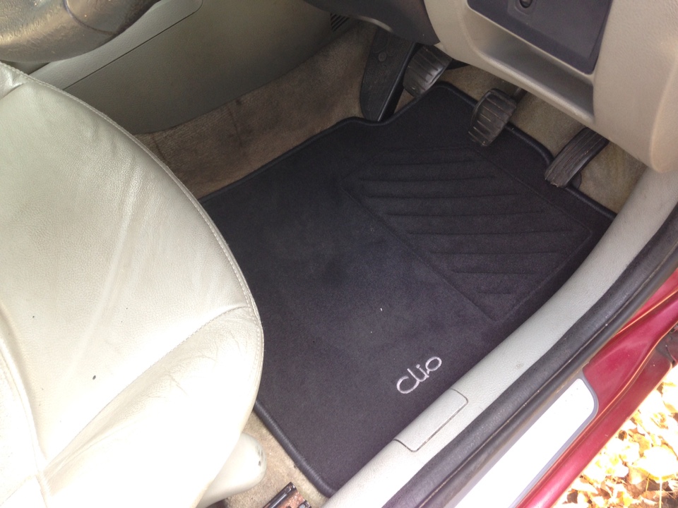

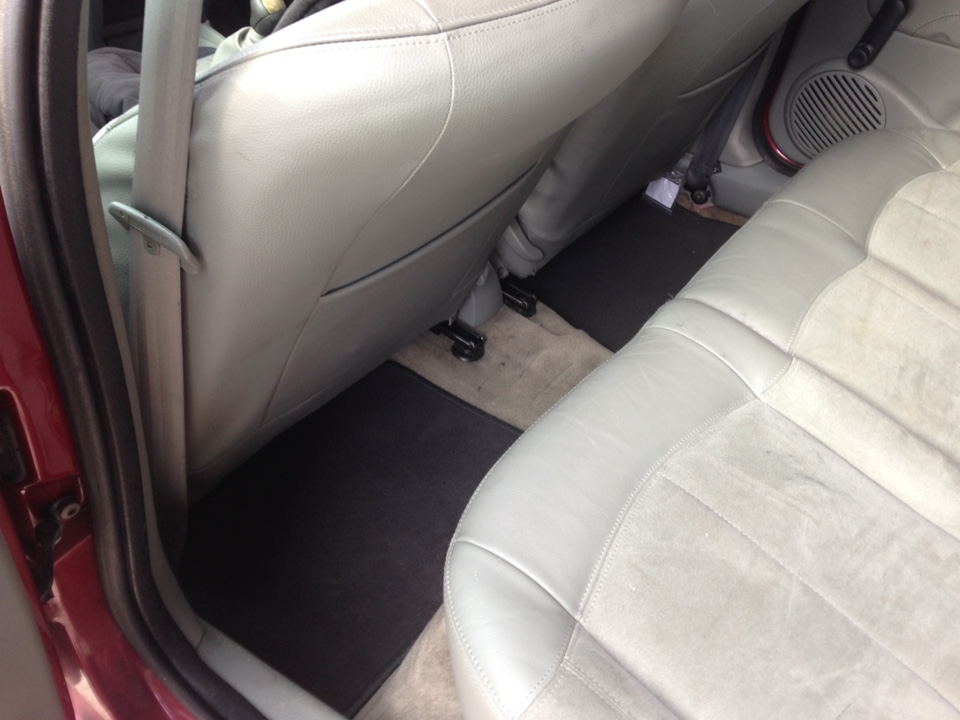

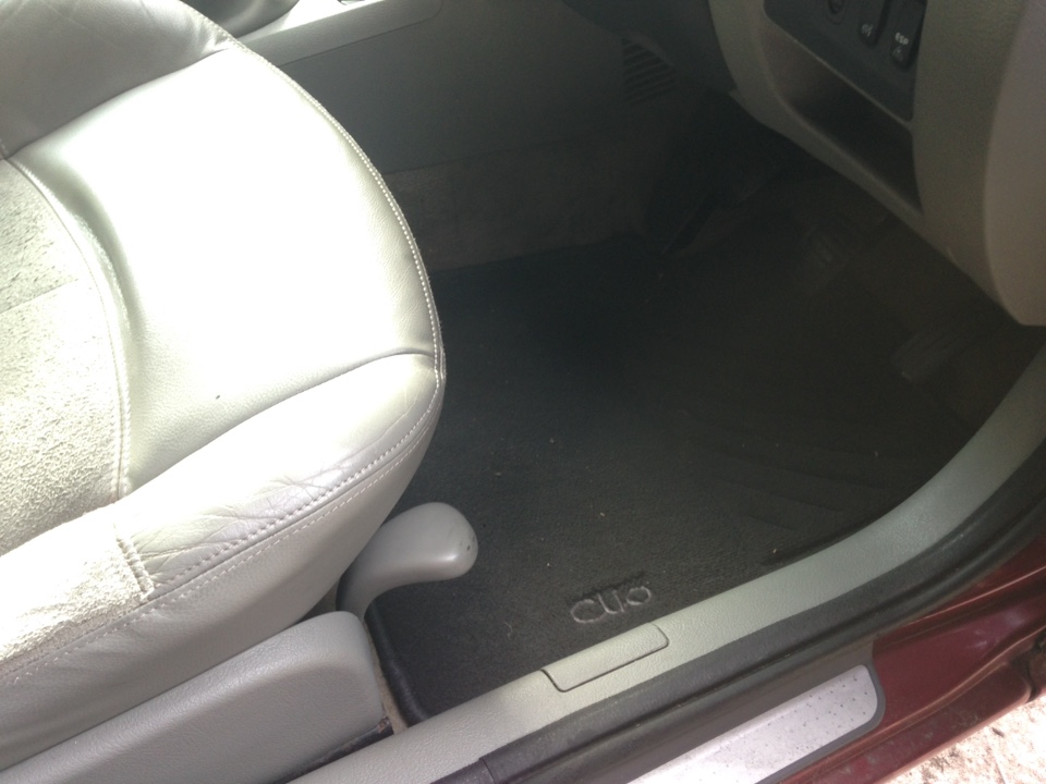

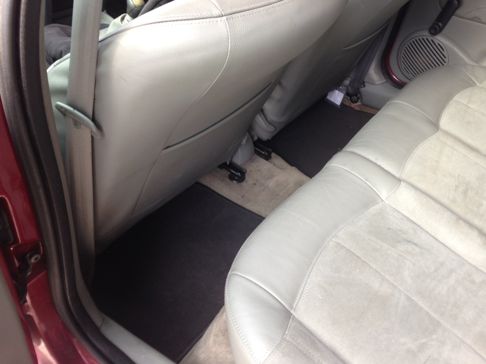

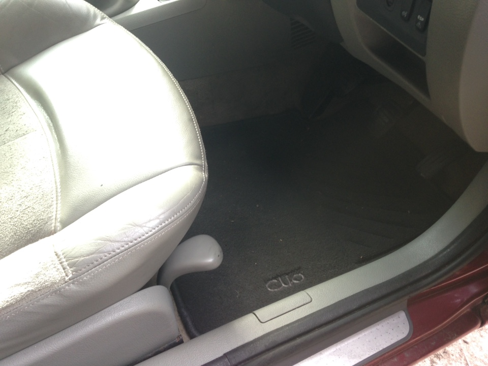

As for the carpets I'd go for brand new ones, you can get expression carpets which are black, brand new genuine for less than £30 iirc.
Thats good to know! I had no idea they would be available new and for such a good price. Not sure what a black carpet would look like against the light seats etc...
That turned out lovely! Good job

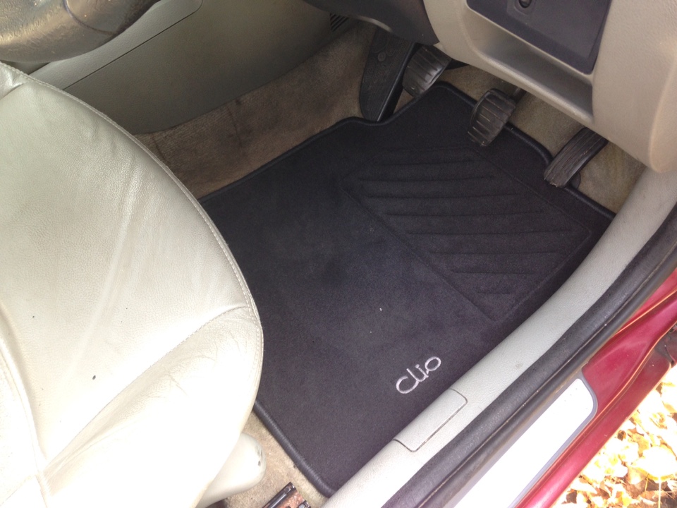

You can get expression carpets on eBay or on RPD, got mines from there, as I said about £30.
I'd rather have them black, light colored stuff always shows the dirt more easily.

Im in Durham, right up in the North East.
So do you have black carpets in yours? If so do you have any pics so i can see what it looks like? Sure i didnt see any in your thread. You are right, light colour really shows the dirt! These carpets look brown ?

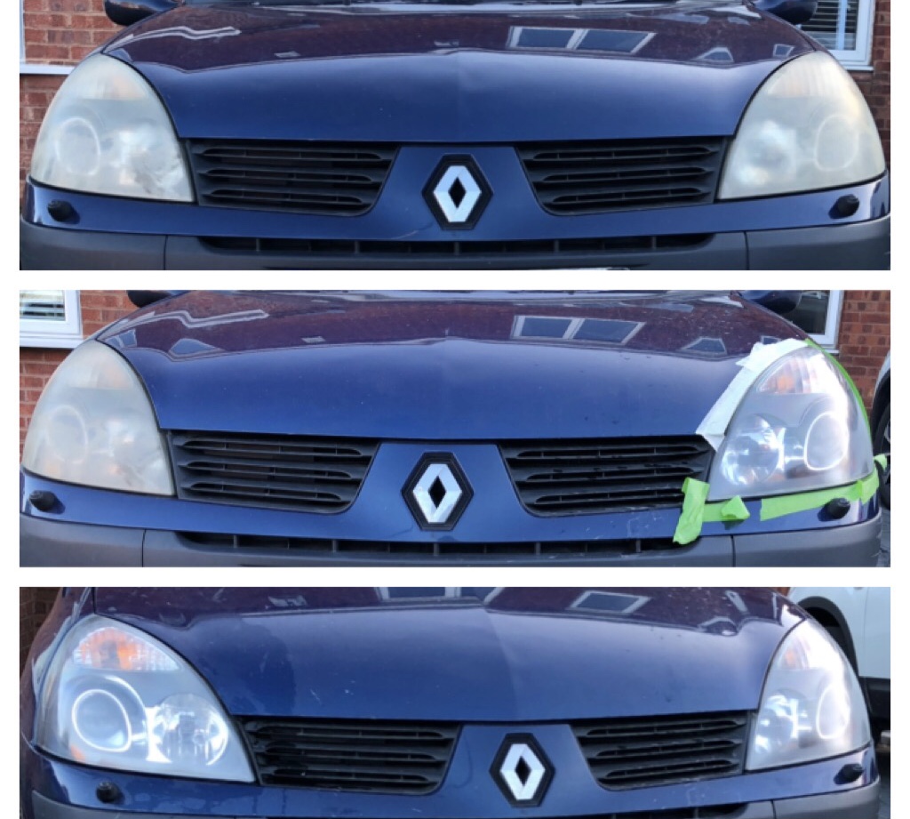

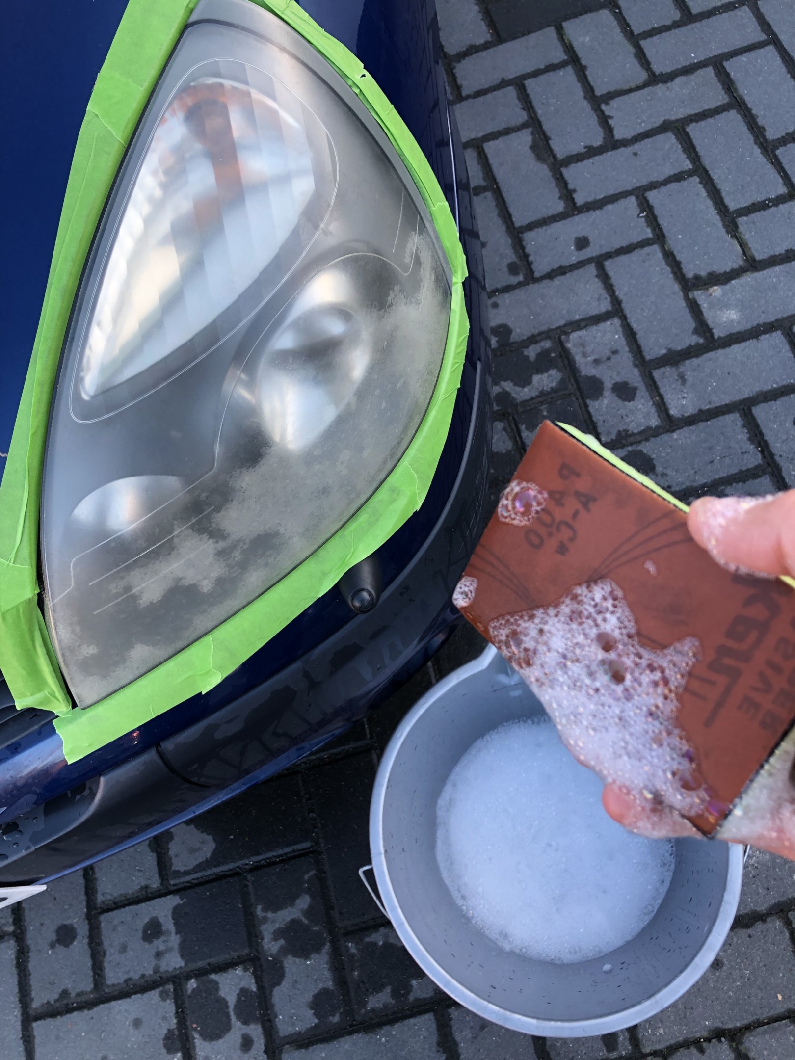

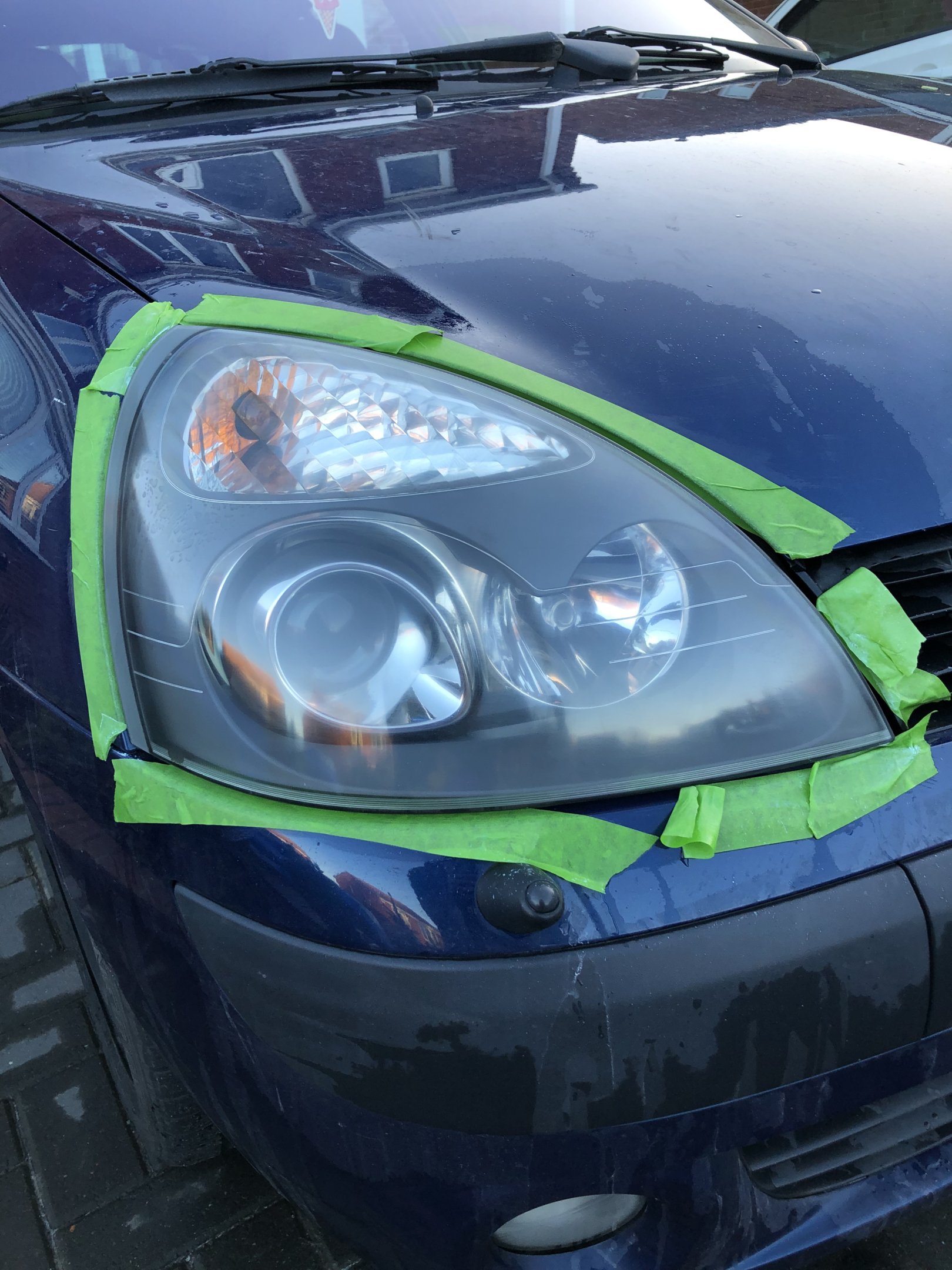

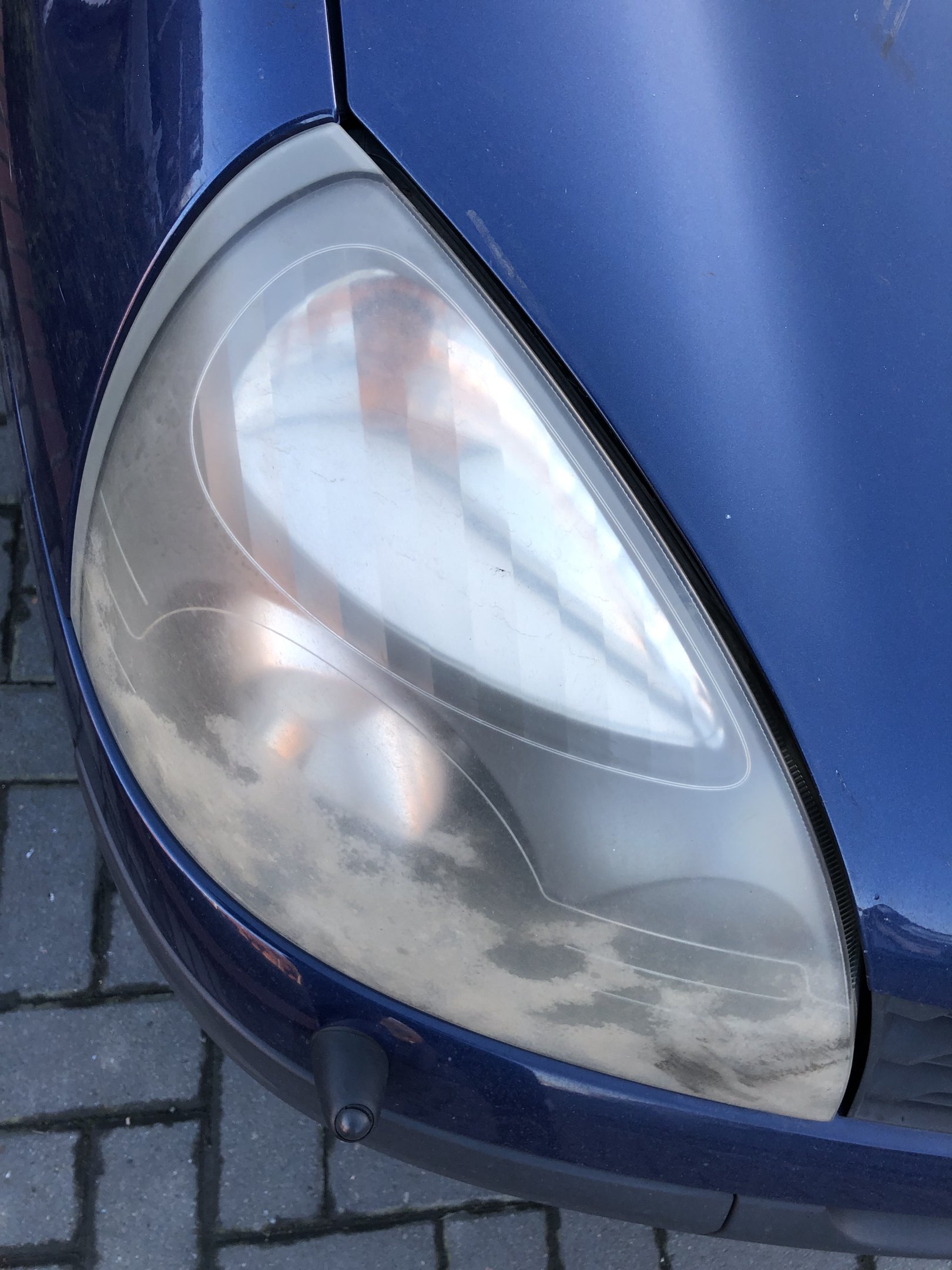

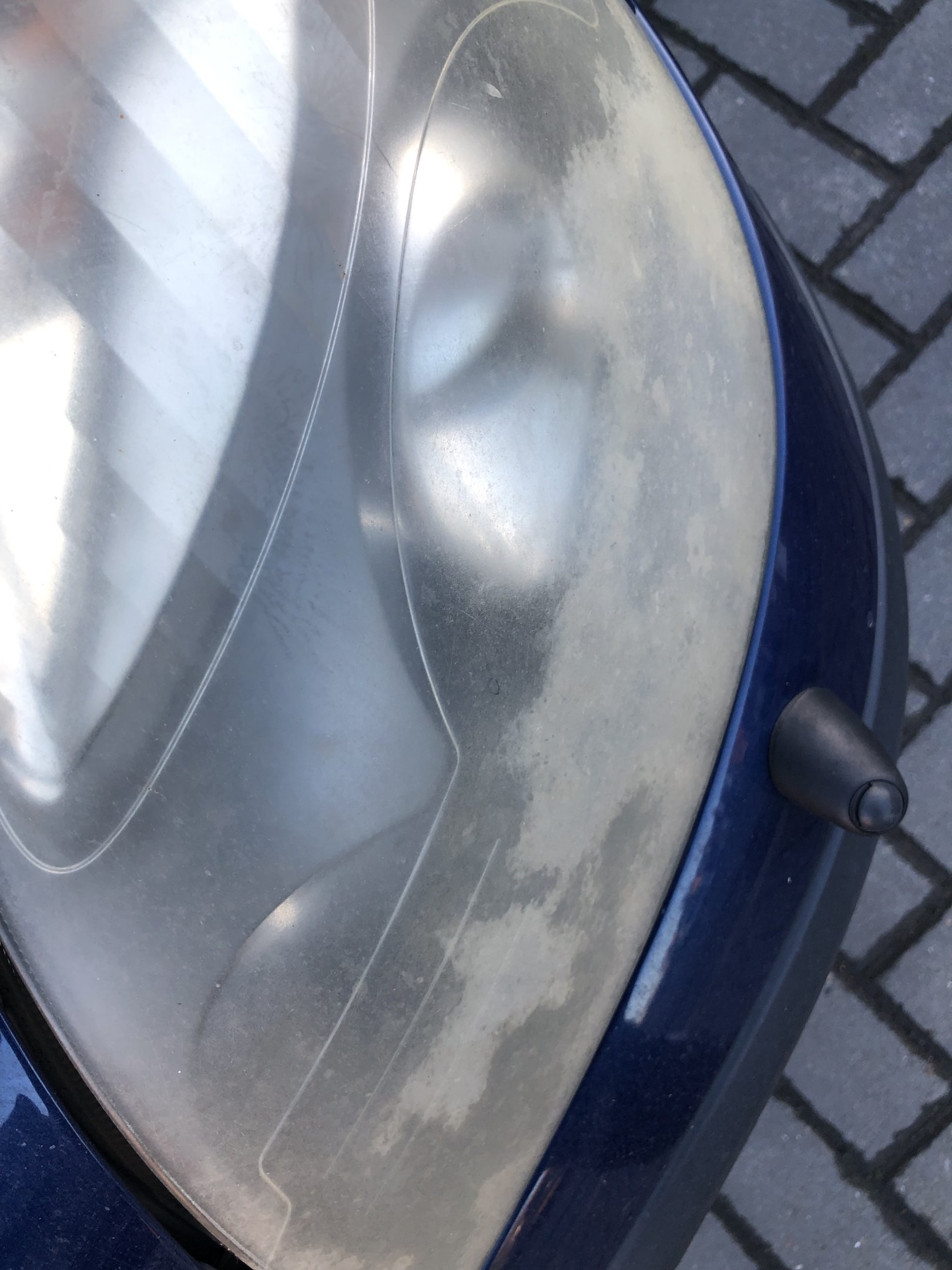

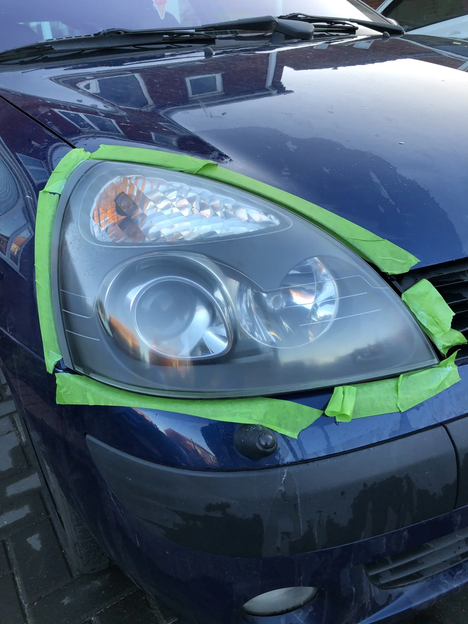

Quick update, took me 20 minutes to do...

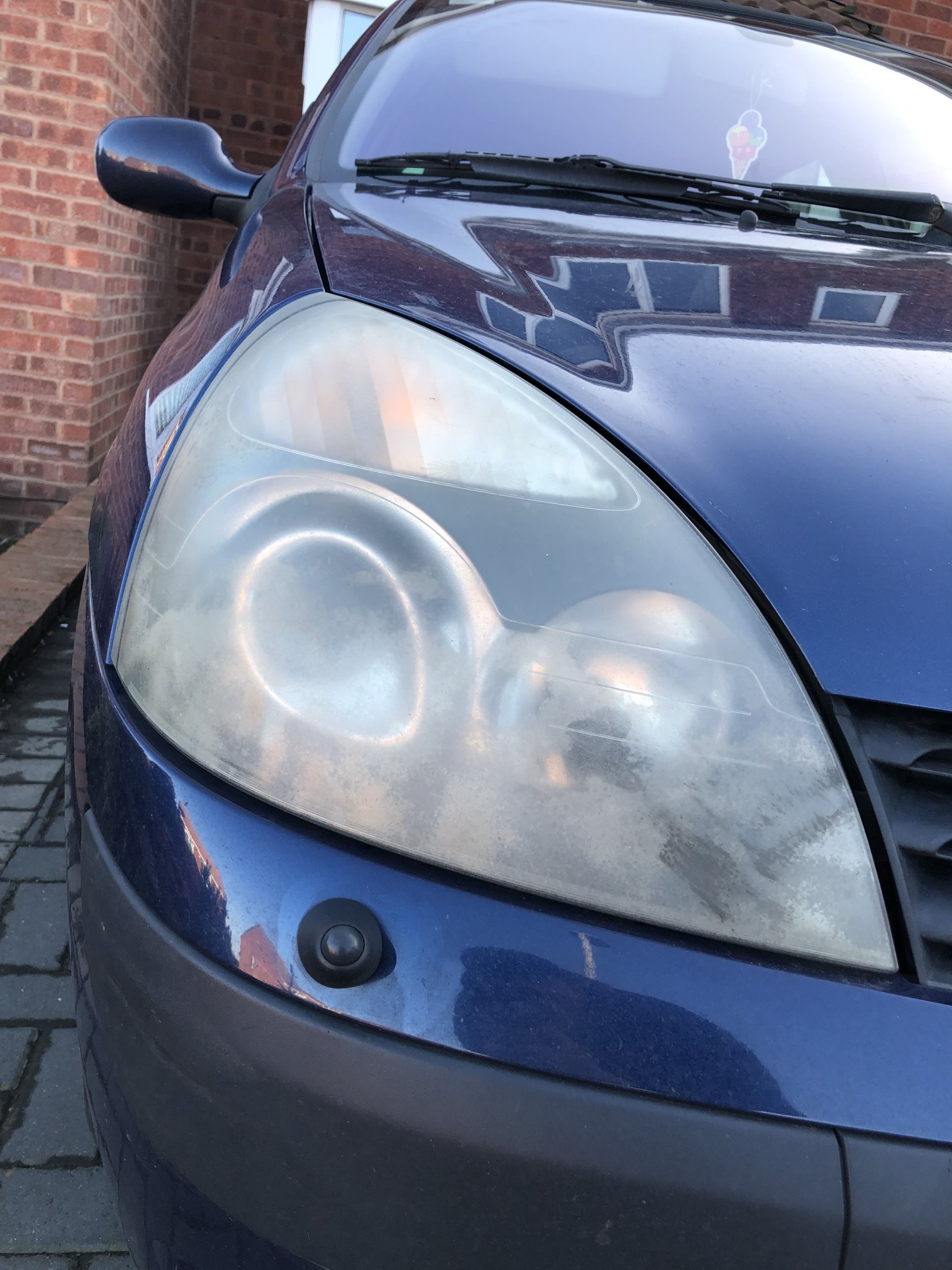

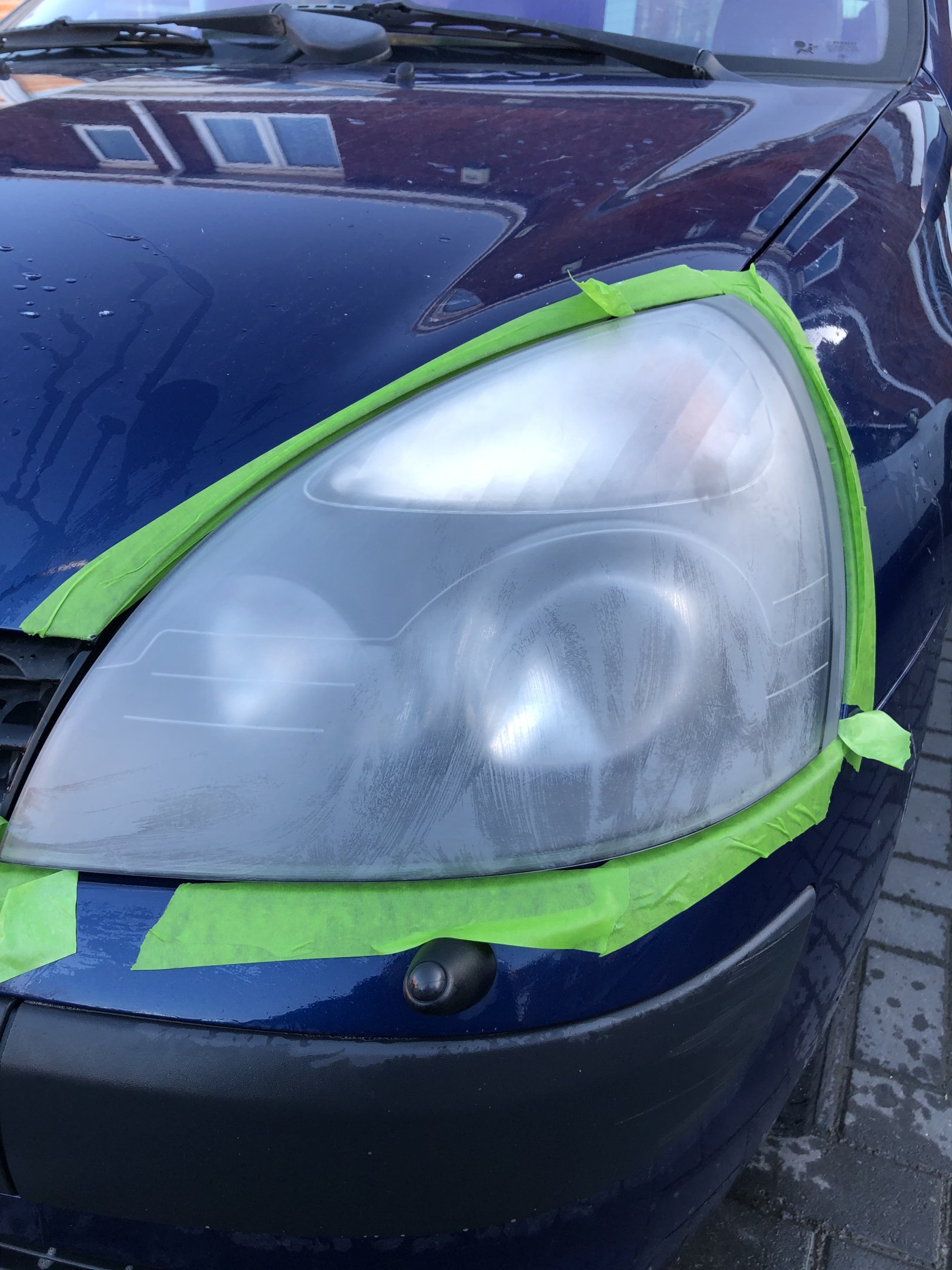

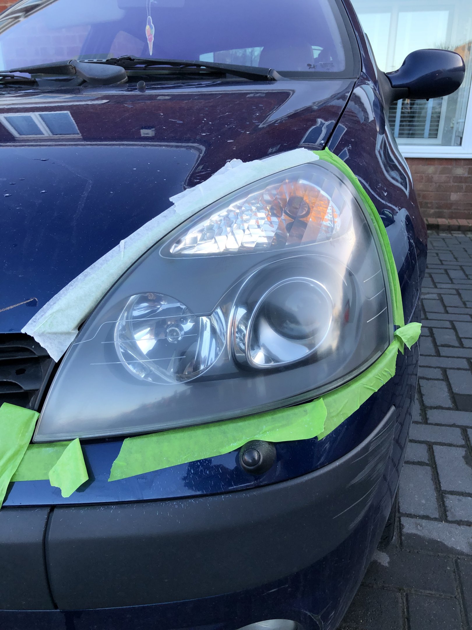

Headlights - they were the standard mess they all seem to go. I have done a headlight correction a couple times before on other clios so knew what i was doing and had the kit in the garage. The kit used was £7 from ebay ages ago and simply consists of 3 different grades of sand paper and and some compound. I did the sanding by hand and used a cheap polish pad on my drill to polish them up. I do have a da but have not yet used it. I will be testing it out at some point on the dci though.

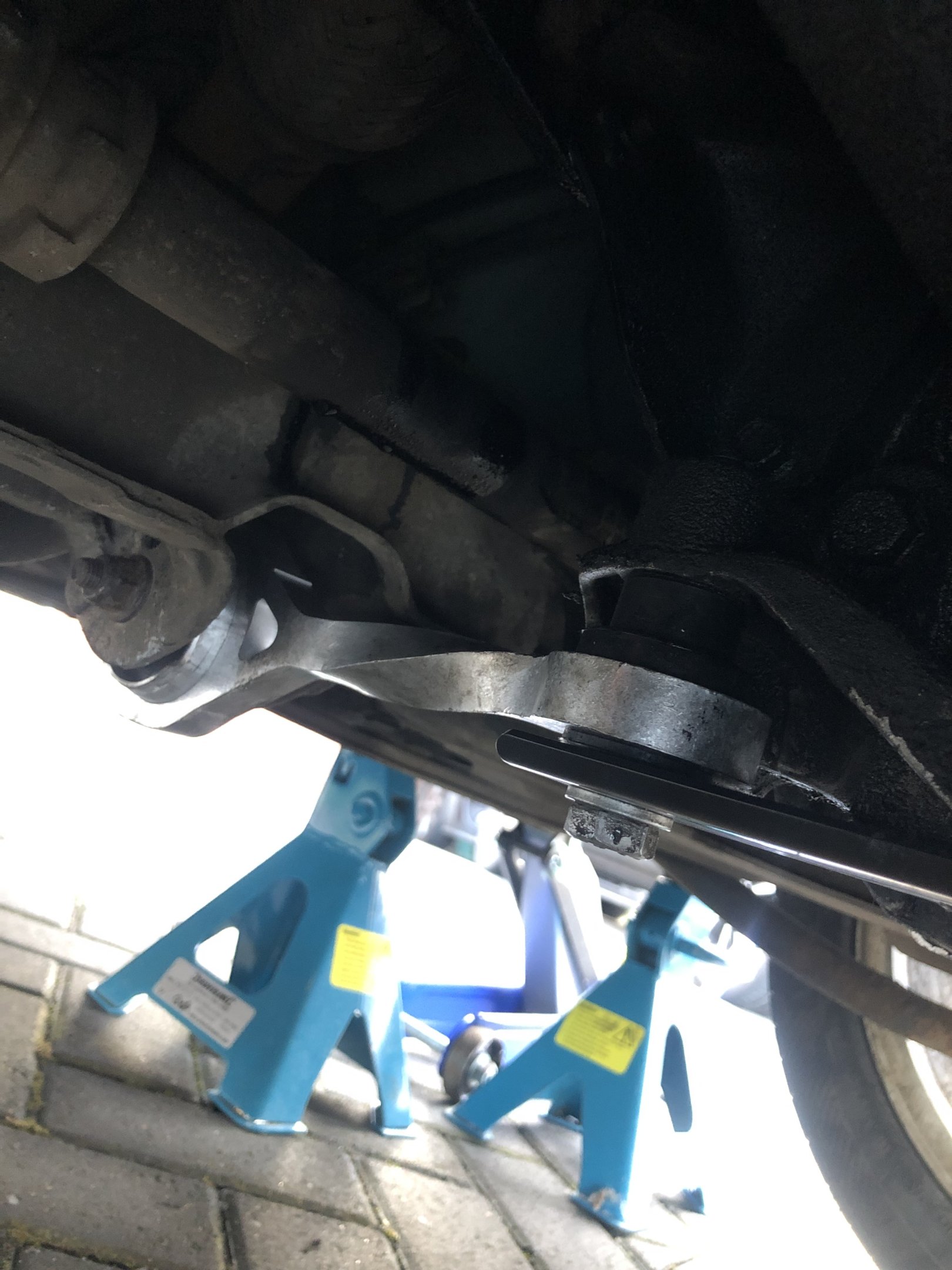

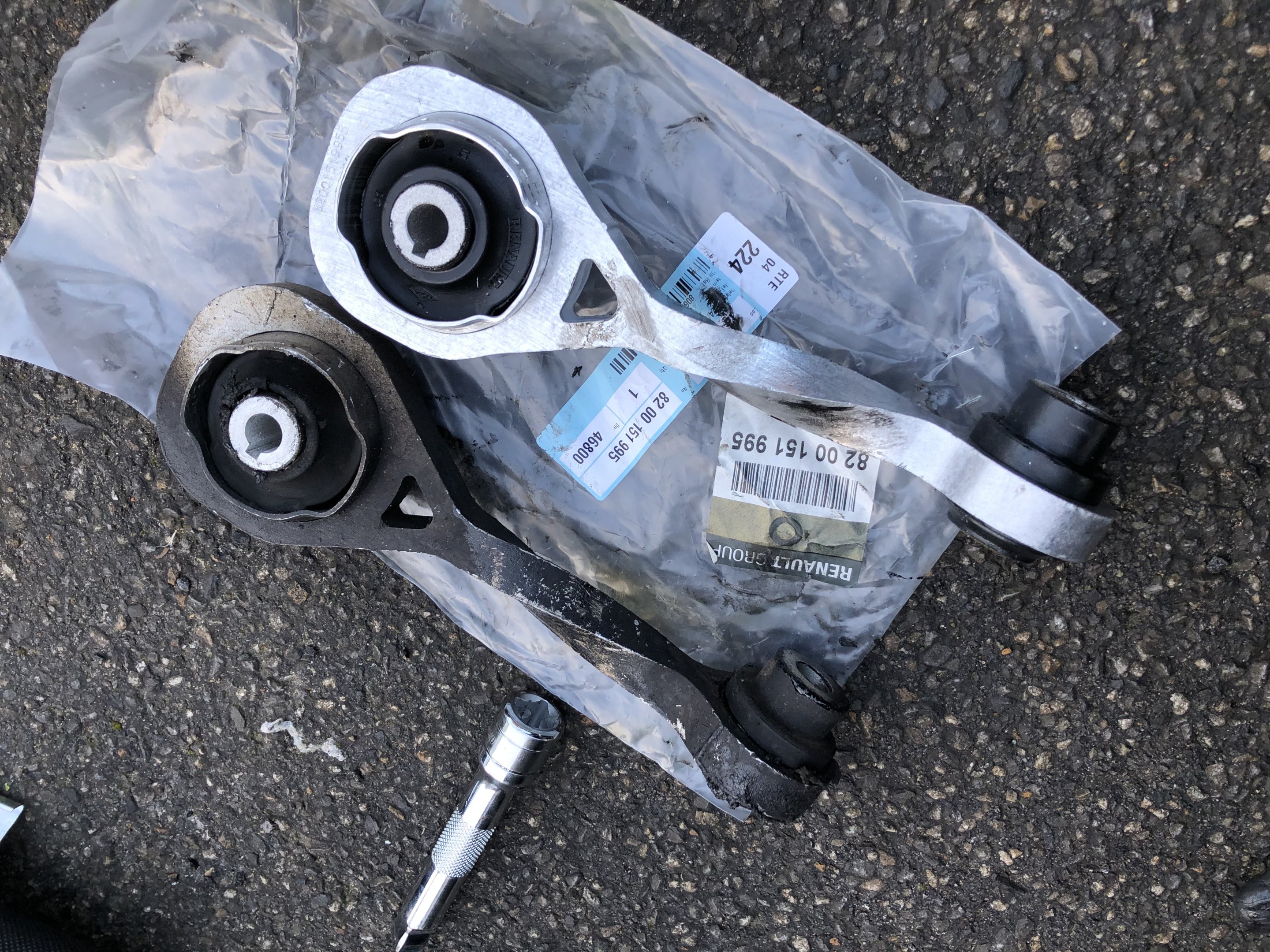

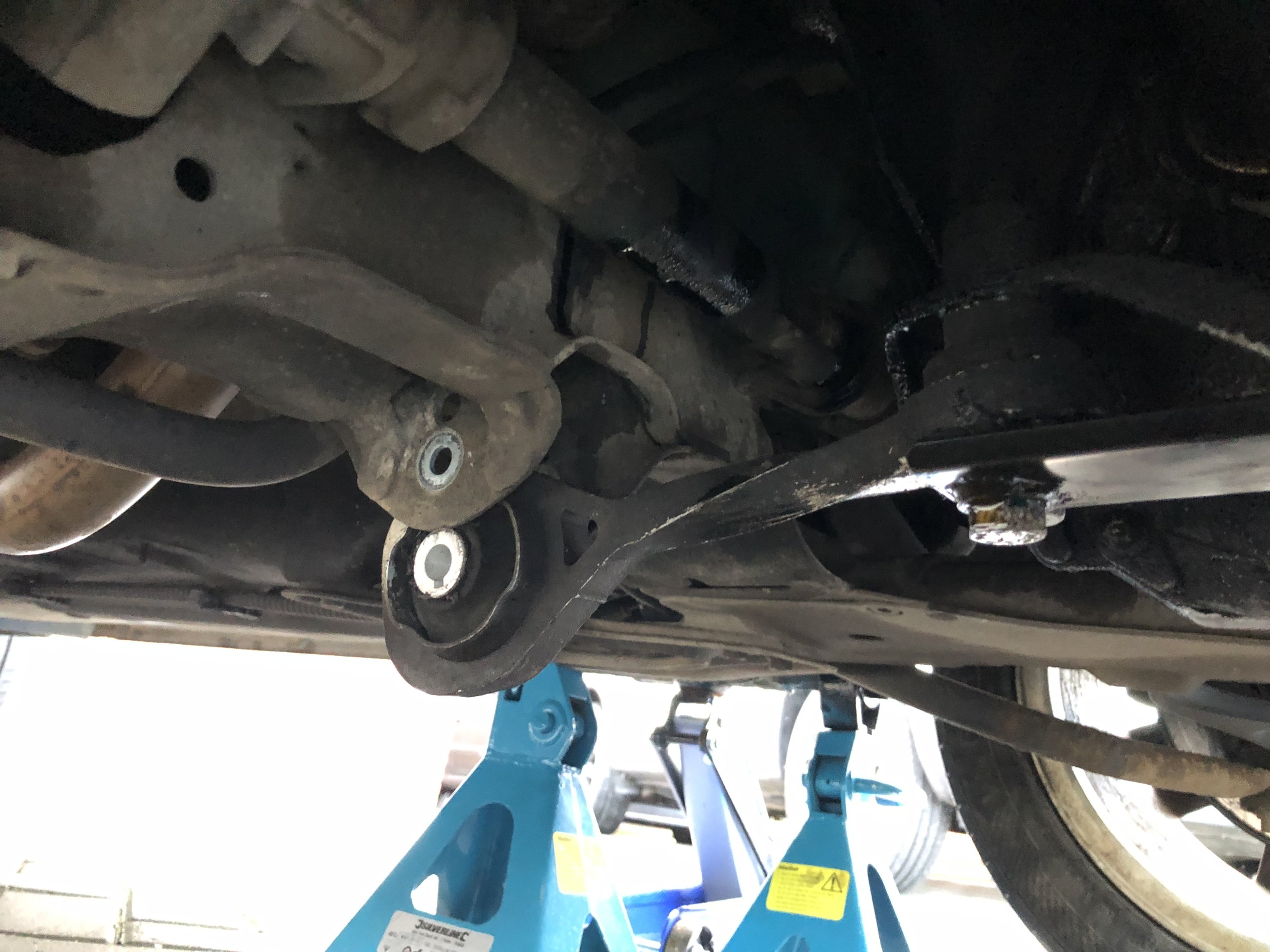

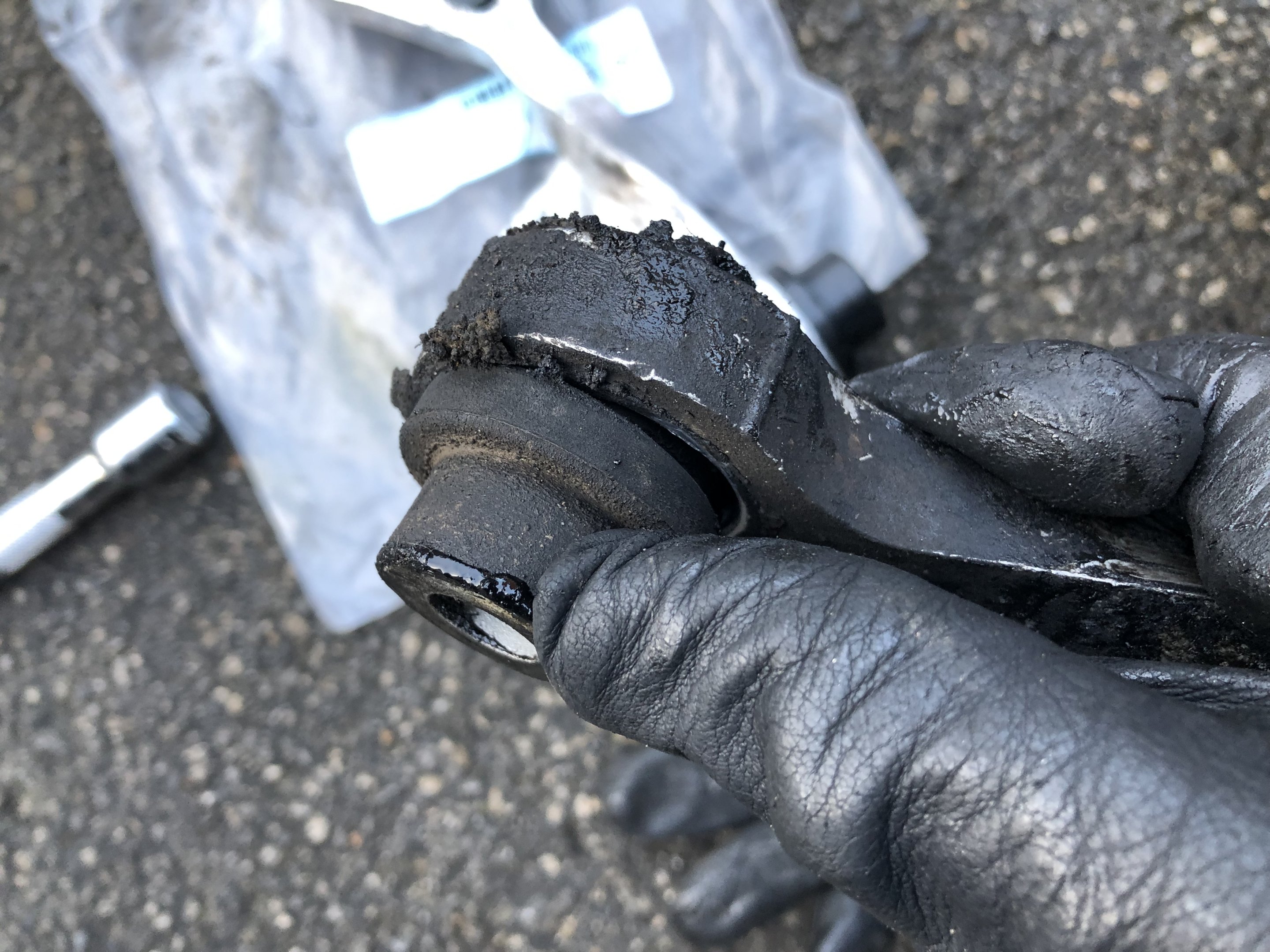

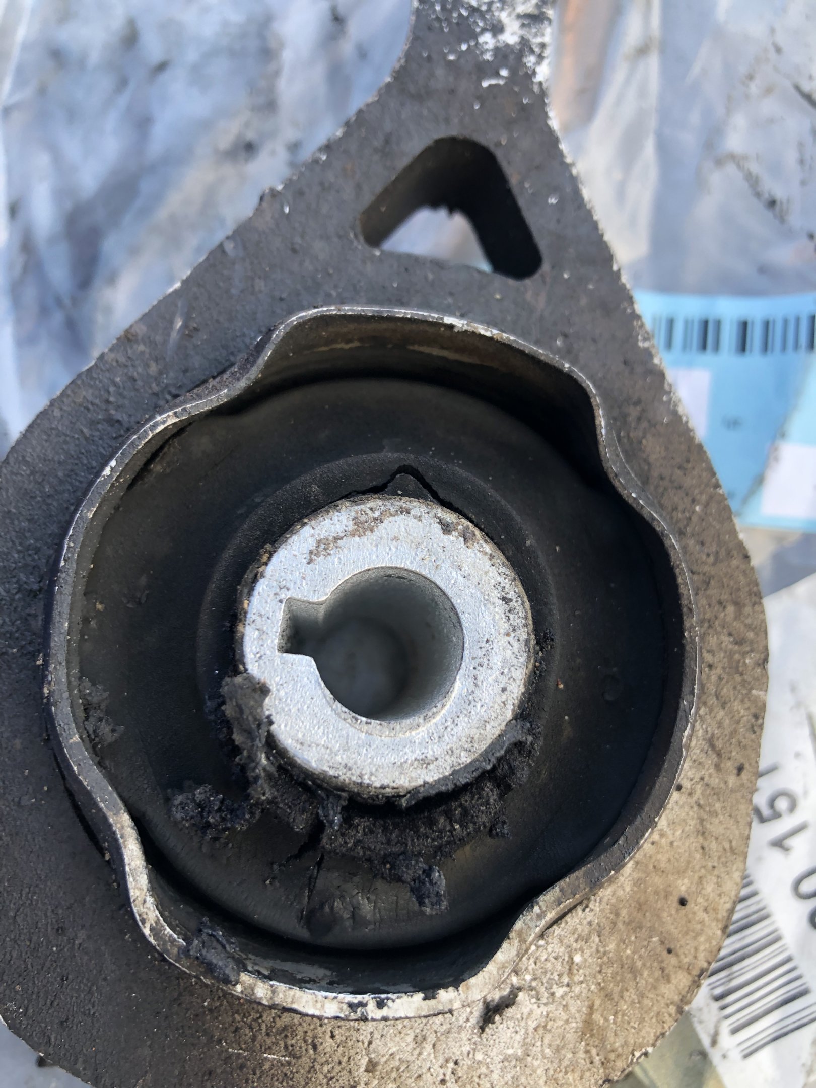

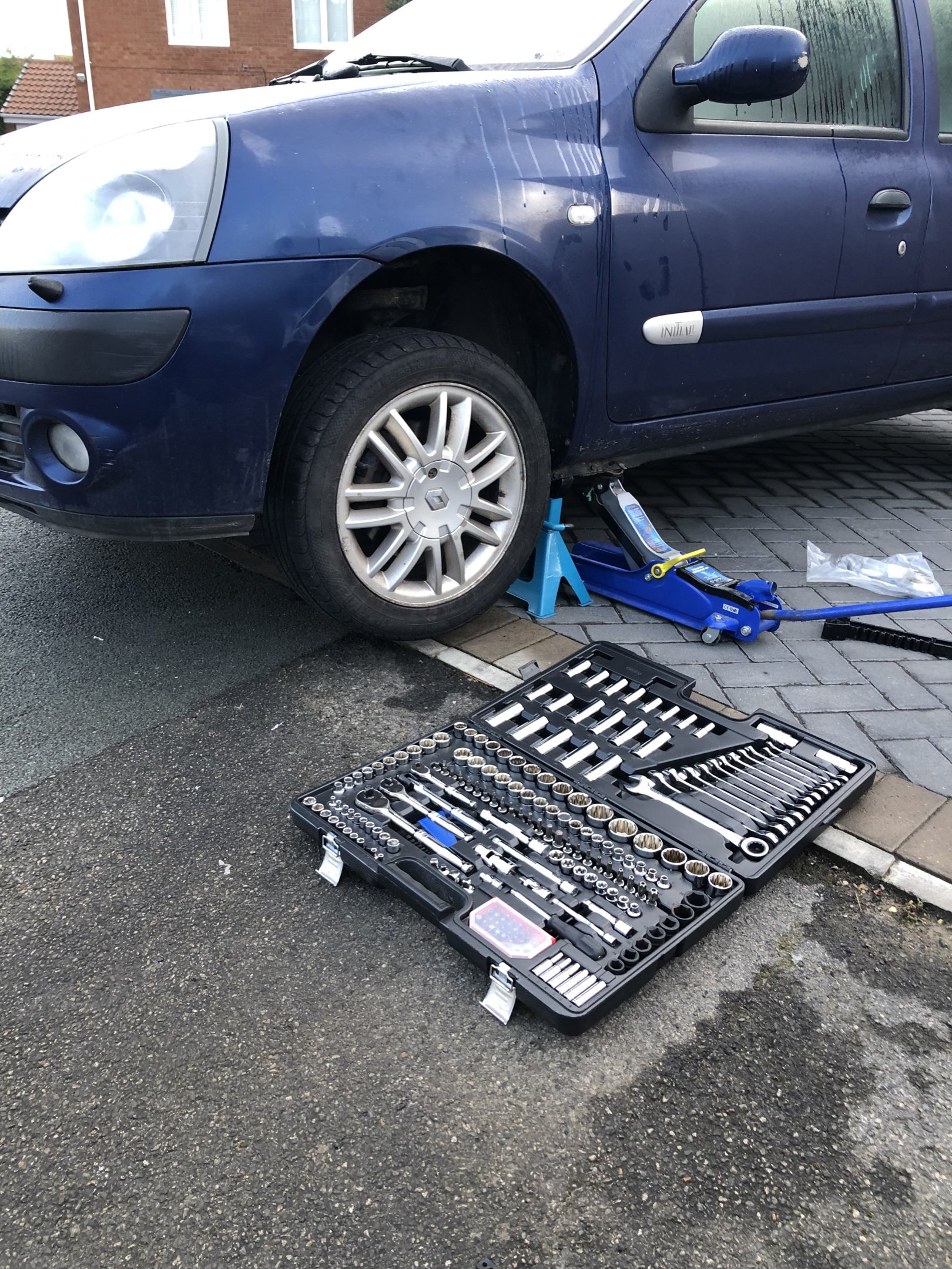

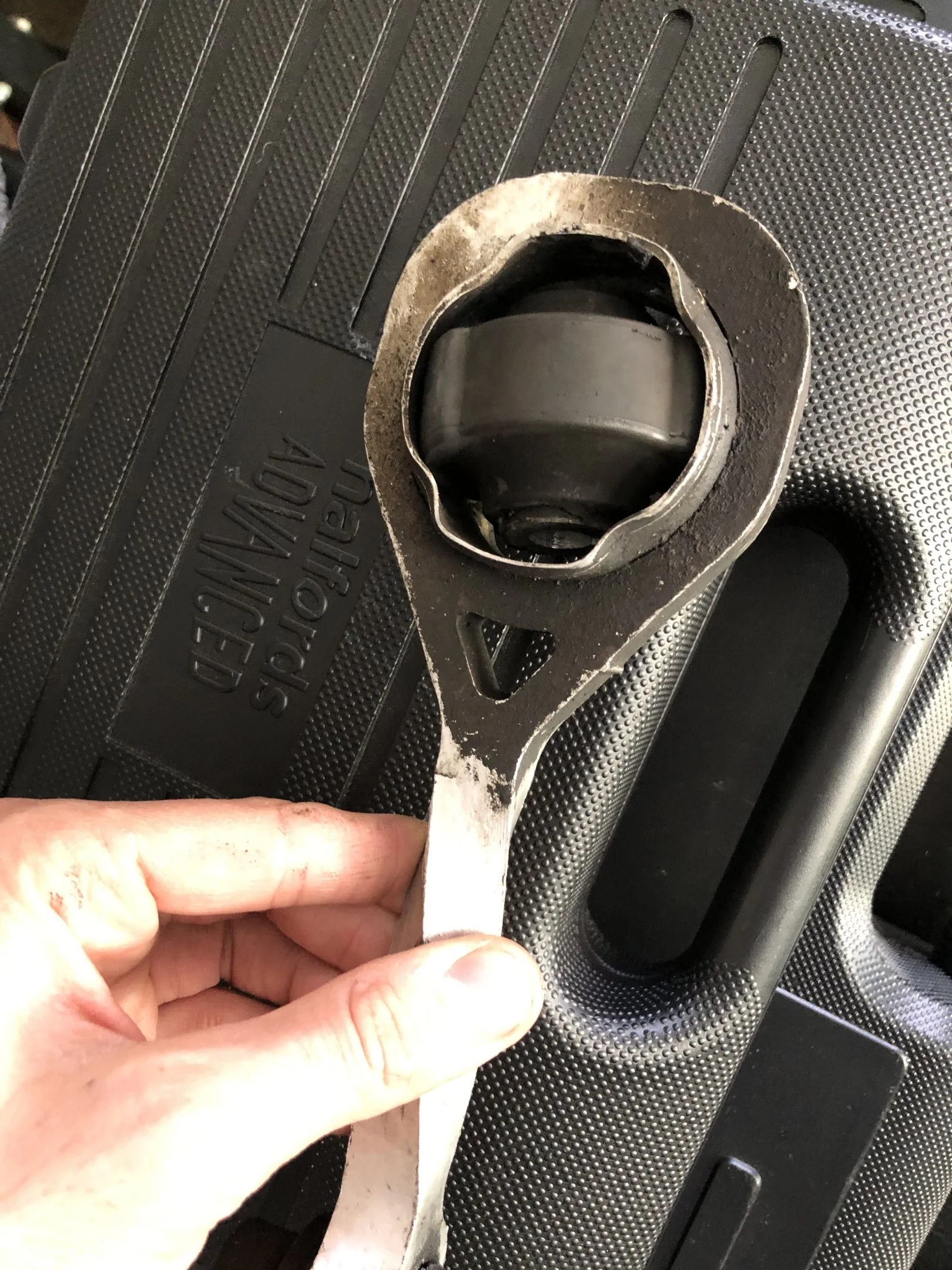

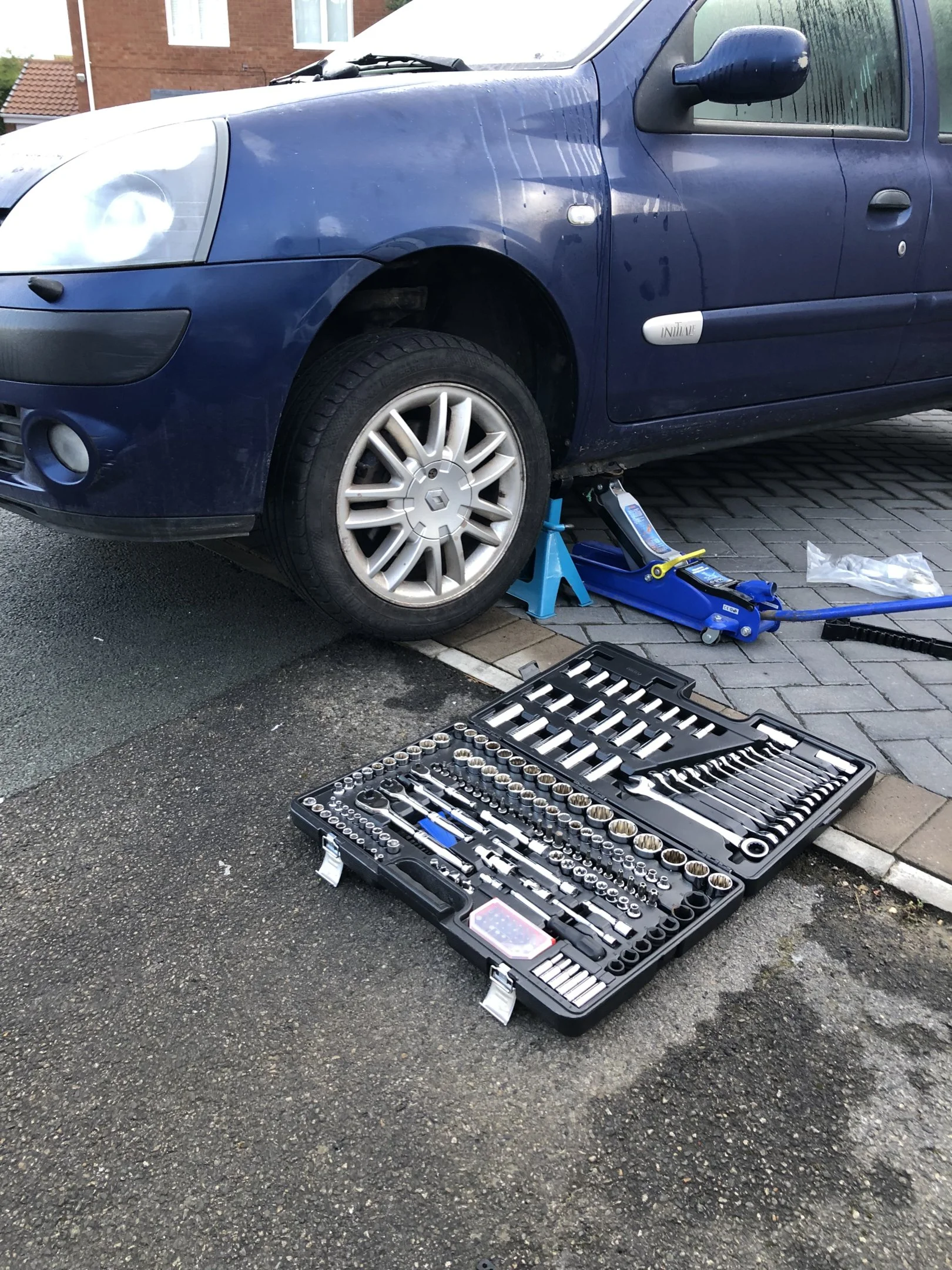

Early Sunday morning start to do the dogbone mount. It really was easy peasy to do! The judder when pulling away / letting off the accelerator and back on has now gone so it was a job worth doing. The old mount was massively deteriorated so was probably the original one!
Brigsy
  T.Turbo
Brave man jacking up on the sill lip haha, use the 2” box section that is a bit furthur behind mate, miles better. New oem dogbone makes a massive difference on the diesels, mine was totally knackered when i got it too. I briefly tried a poly version which was awful the whole dash vibrated on idle, never again on a diesel ?
  182
Pleased to read that your killed the judder with the new dogbone. I fitted the same exact part and it did nothing :(
Maybe its another mount that needs to be replaced also?
Mine was really bad so I knew it had to make a difference.
