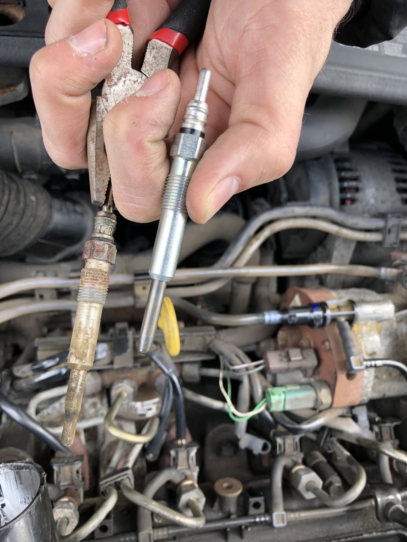

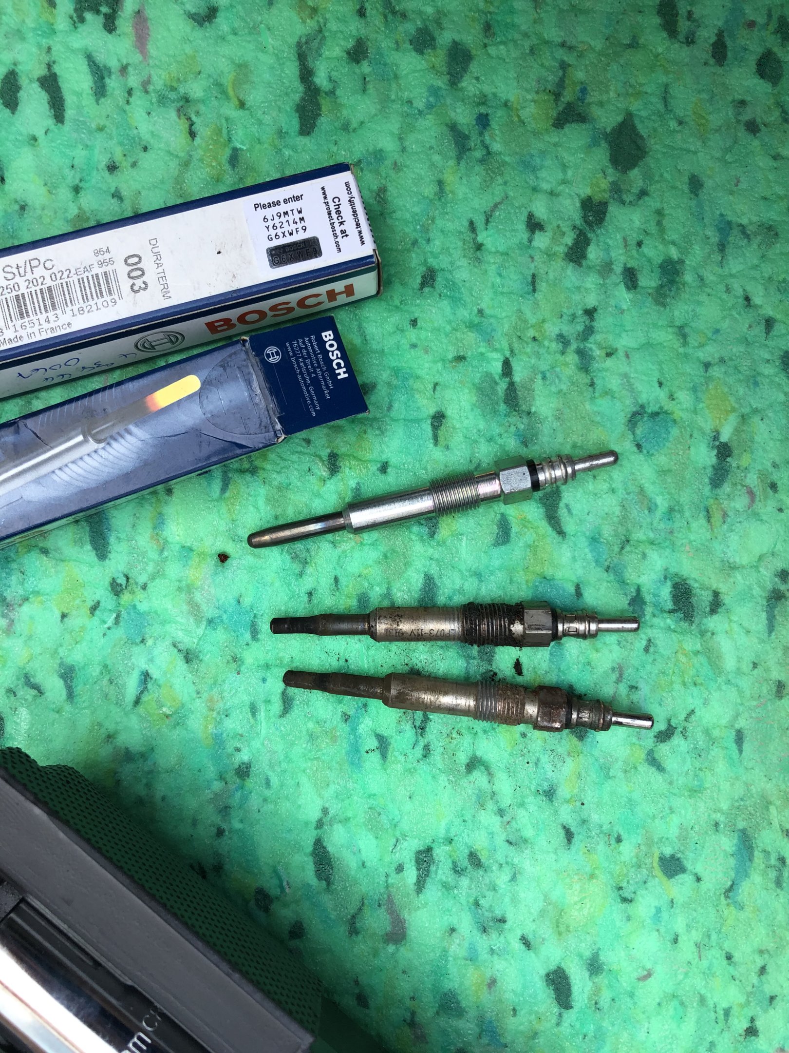

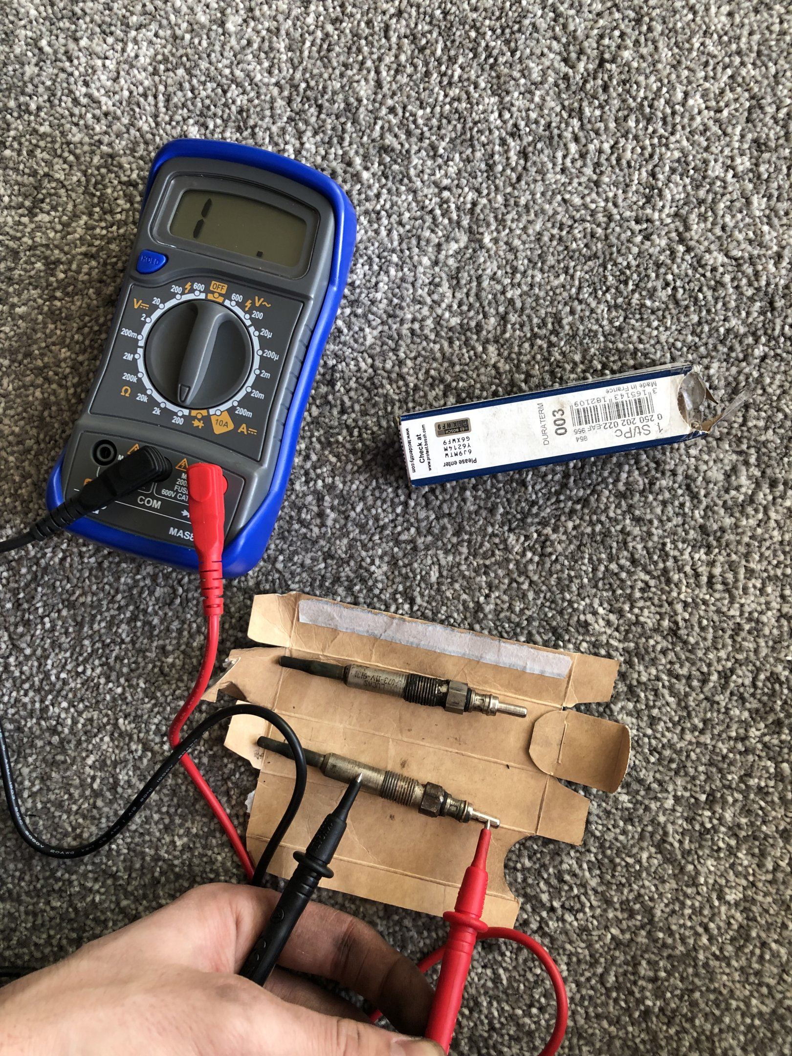

I tested the glow plugs this morning wirh my multimeter and plug 1 & 4 are gone! No reading at all. Strange because it actually starts straight up (when the whole key / imobilisher or whatever it is, isnt playing up). I have ordered an extra deep 10mm socket so I can get them changed over.

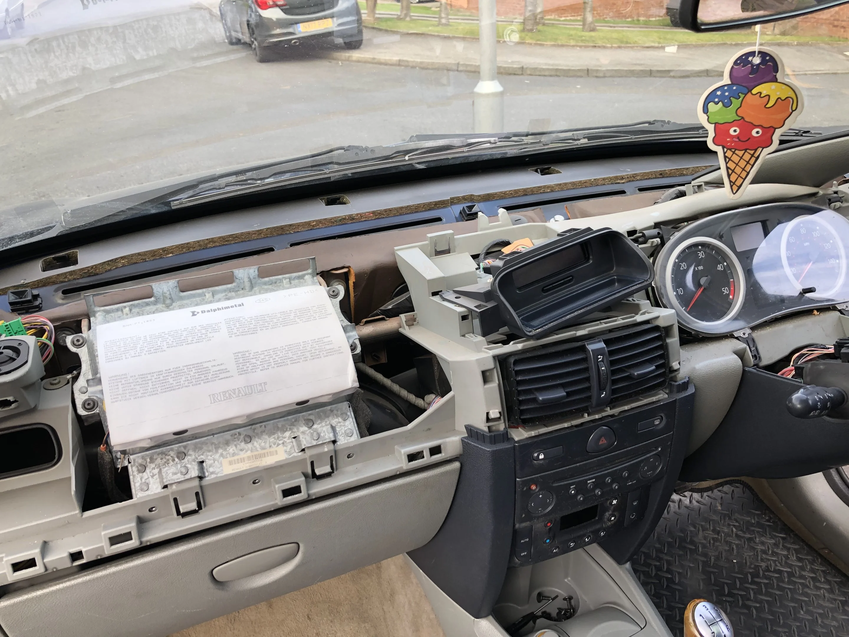

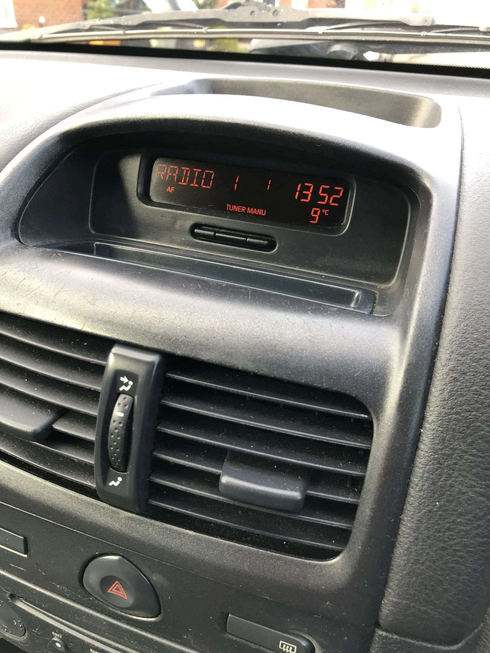

The centre console clock / radio light has never worked. I have known how to do this for years from seeing loads of posts on here about it. I knew the dash needed to come out which i had never fancied doing. I attempted it today as not having the display is really annoying, and it really was one of the easiest jobs ever. Took me half an hour max to do it all. Put 2 new bulbs in and all is working as it should be ??

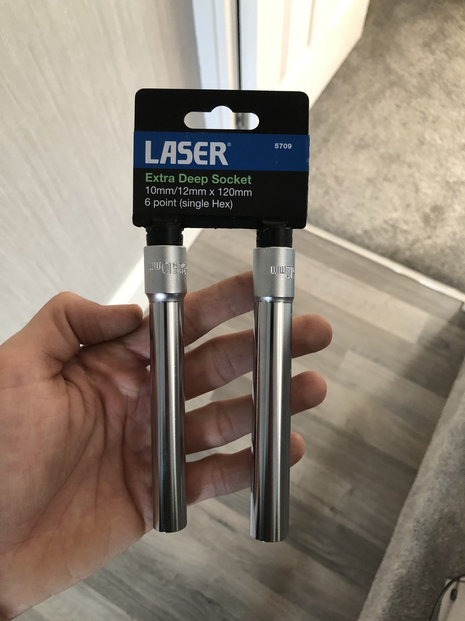

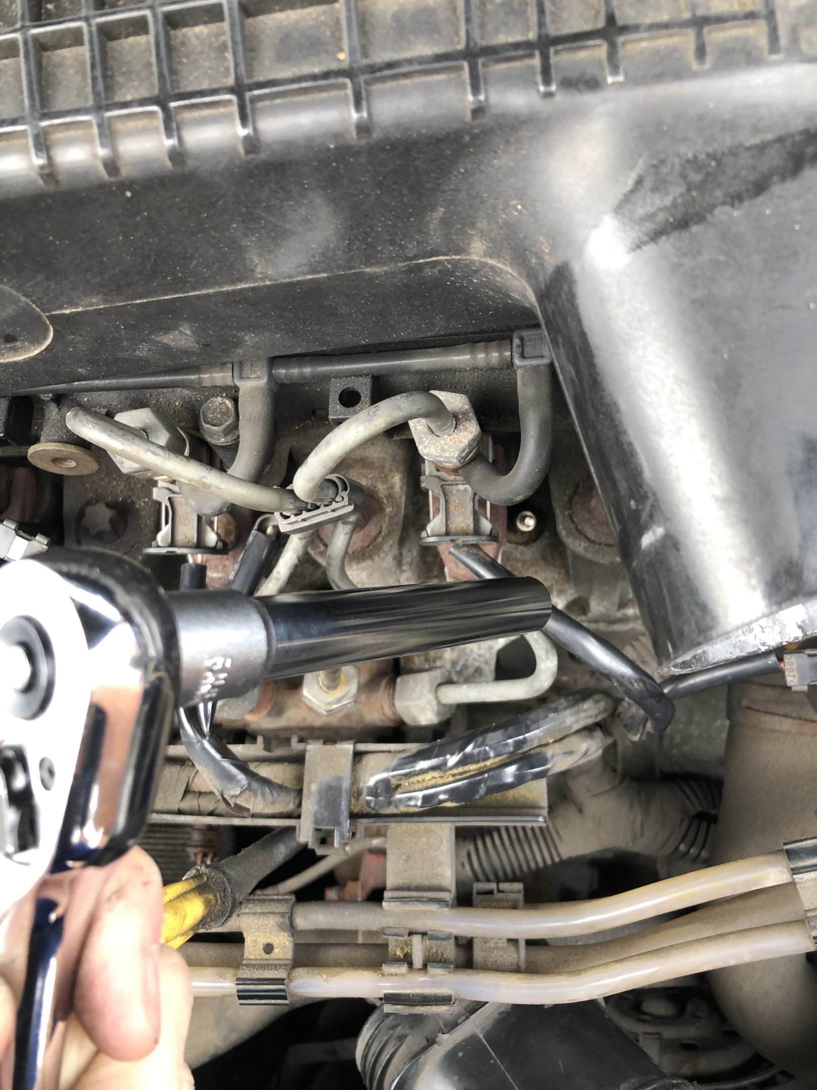

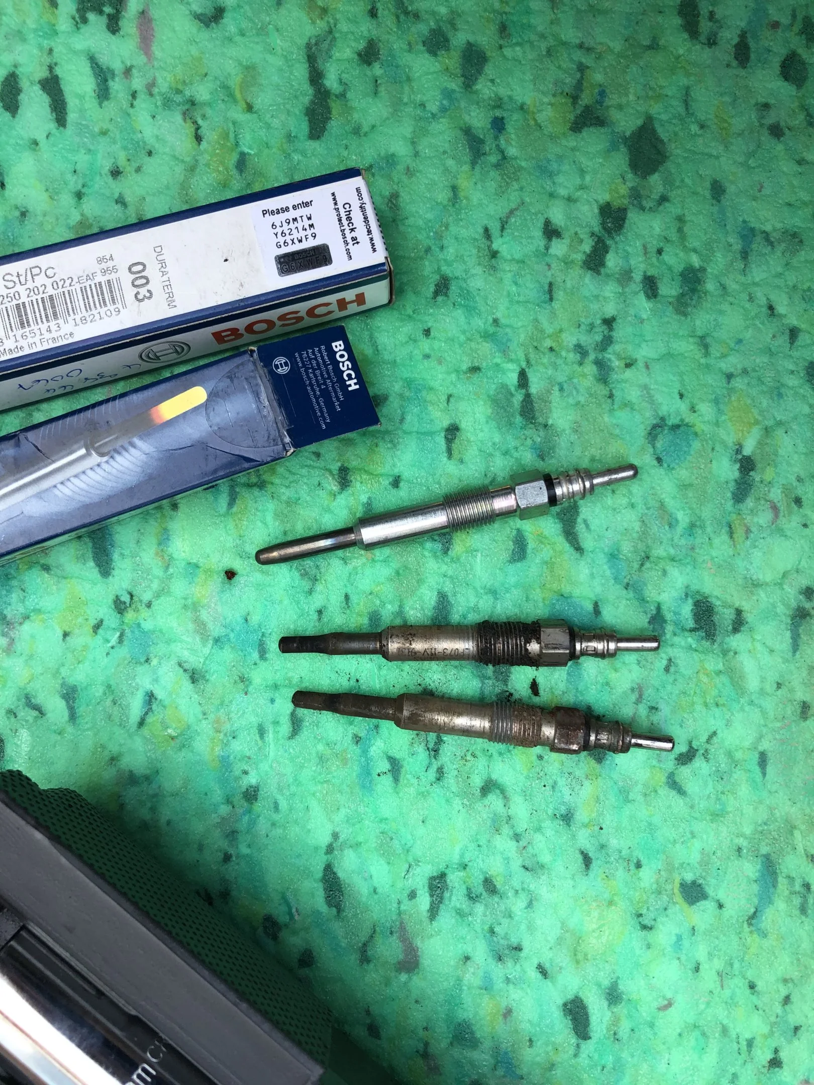

My extra deep socket areived today after the halfords one I bought was too wide.
For anyone interested, its a Laser 5709 3/8 drive and comes in a double pack, one 10mm and one 12mm. I could only get them online and it was £12.50 posted from Amazon, but they are on ebay too. Works perfect, although glow plug 1 (or which ever number it is that is furthest away from the battery) had to be used with one of the swivel type extensions from my halfords kit with the 3/8 drive.

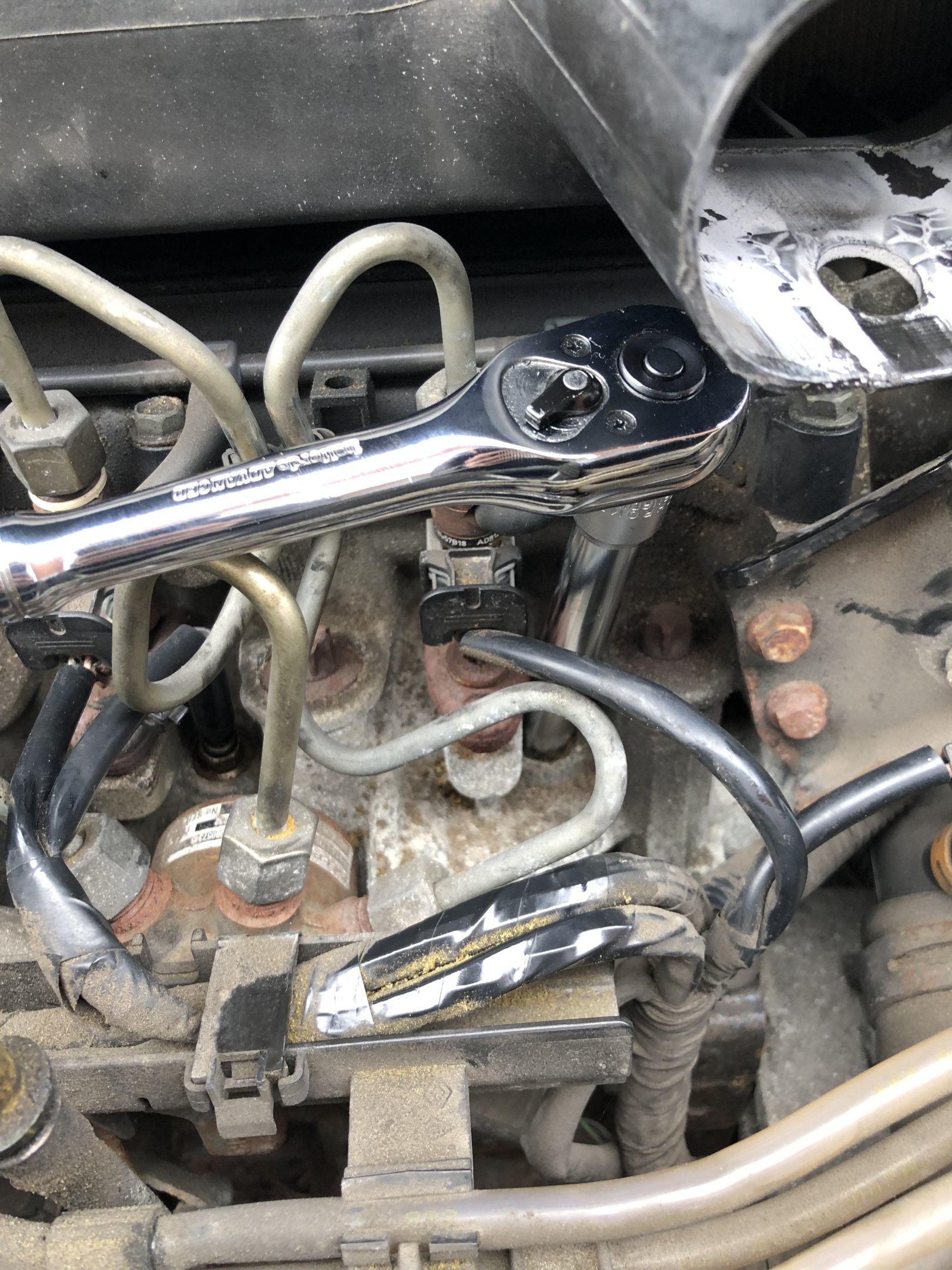

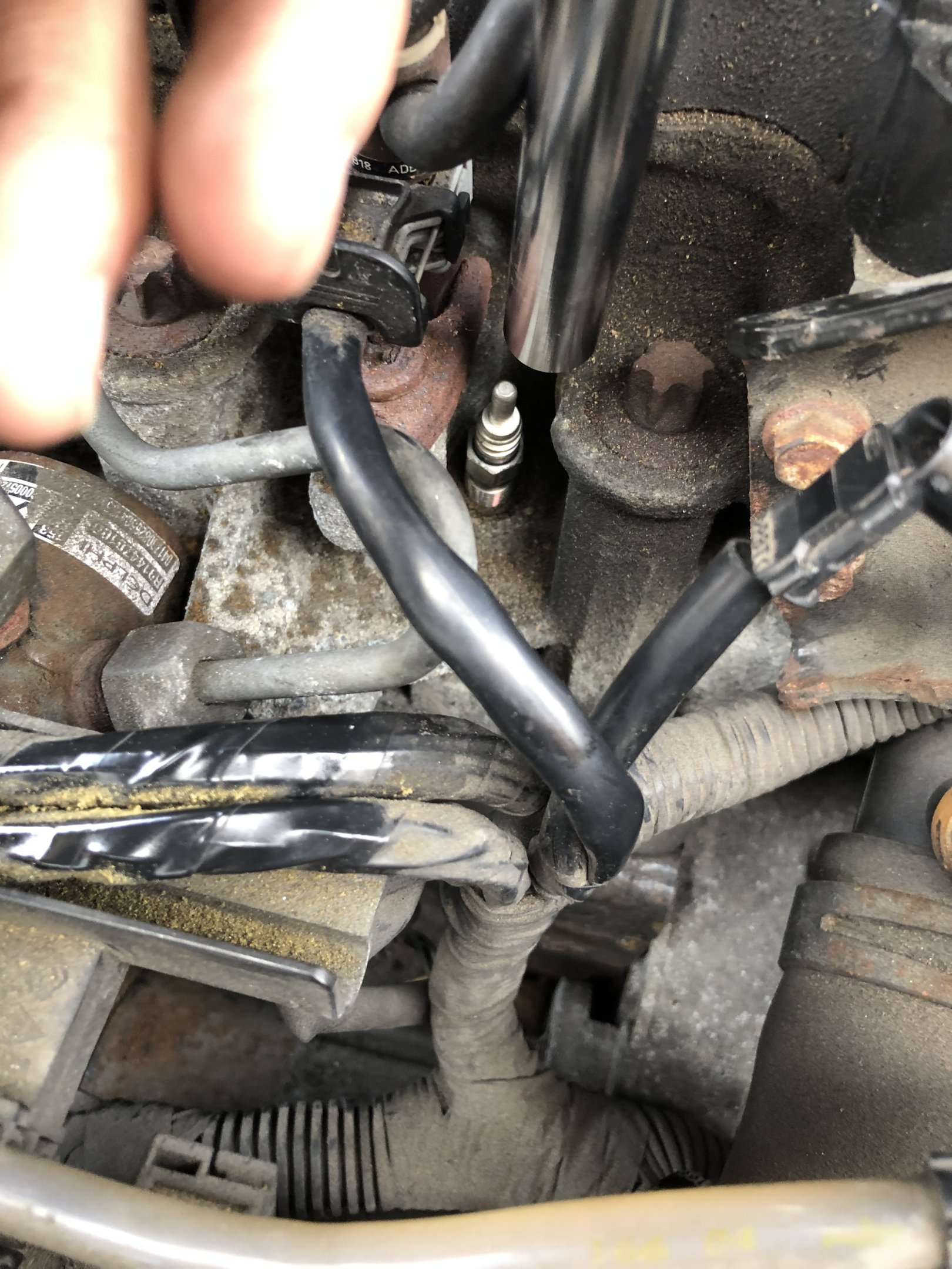

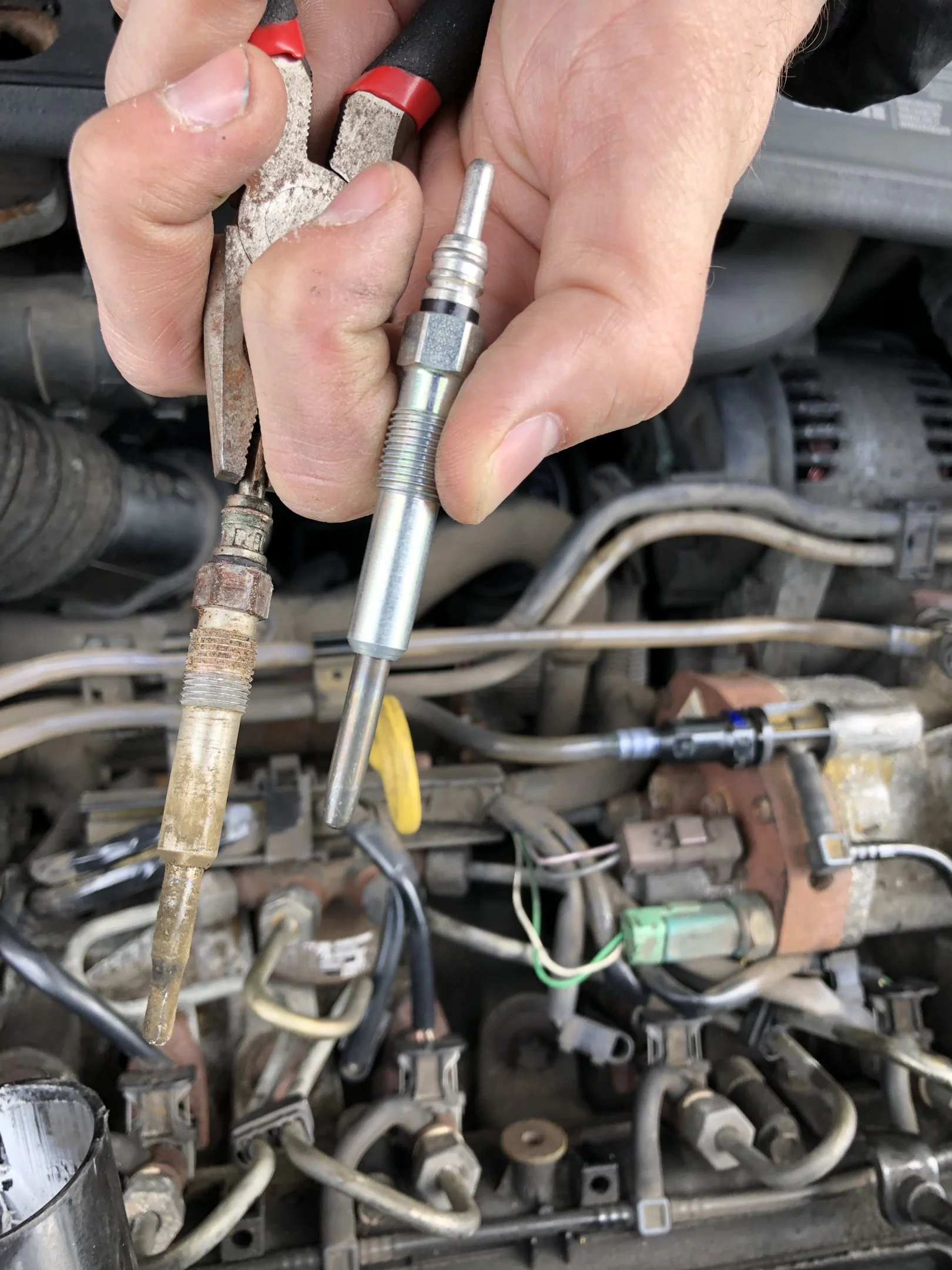

I soaked them in gt85 (wd40) yesterday and got the engine hot today just before changing them.
They came out easy although once unscrewed i had to pull them out with some pliers.
I only changed the 2 of them as yesterdays test with the milti meter indicated 2 of them are still working as they should.
Anyone reading this who doesn't know how to test them, there are 2 ways. Either in the car or off.
To test in the car, you need a multimeter, i got the one above from screwfix for £8. You set it to voltage, plug the positive red to the positive red on the battery, and the negative black to the very top of the glow plug when the cap is removed. You should get a reading of 12v, the same as the battery.
When they are off the car, you need to set the multeter to Ohms, on the lowest setting which is 200. Follow the picture above. Red to the very tip of the glow plug and black to the body of the glow plug. You want a reading less than 1. If the multimeter shows 1. As it does on the picture above, it means it is no longer working at all, and the reading is higher than 200ohms. 0.6ish is what you are looking for in a working glow plug. There are loads of videos on youtube if you get stuck.

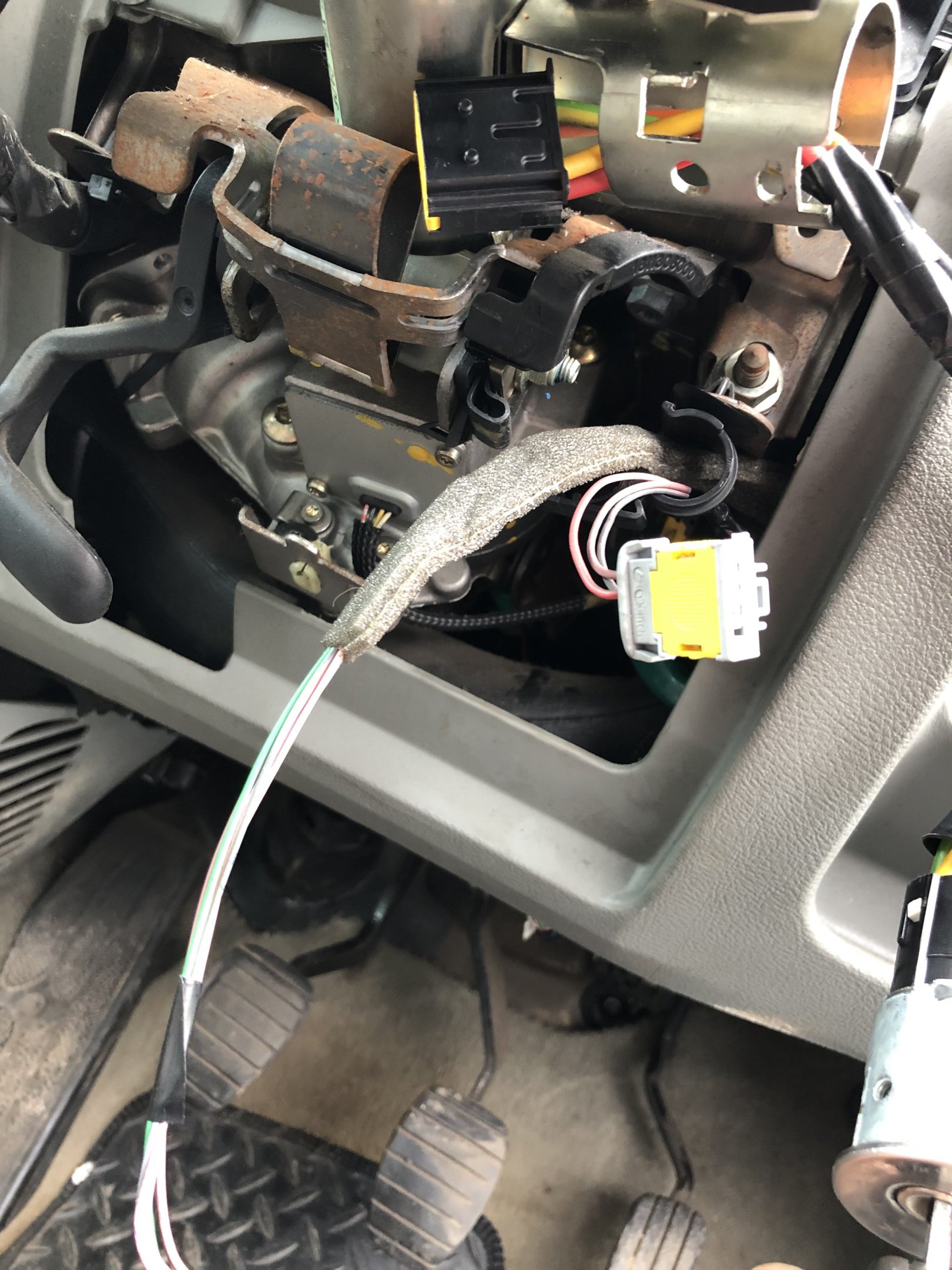

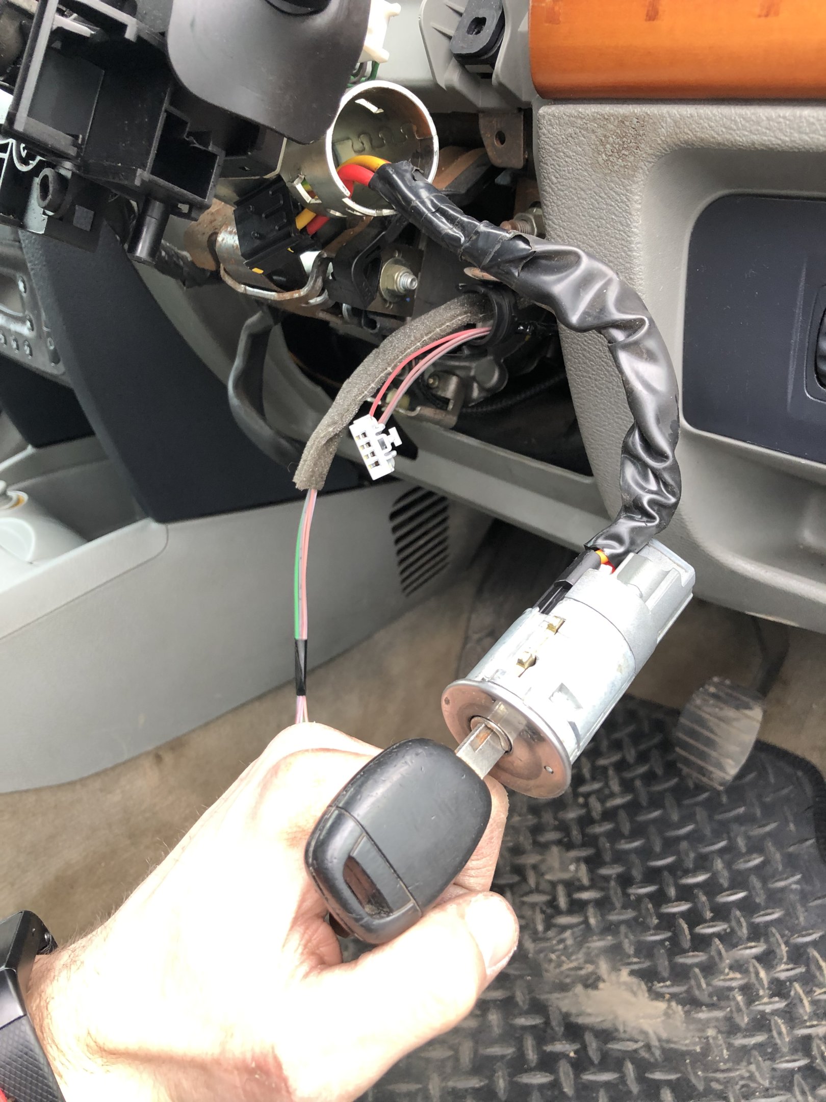

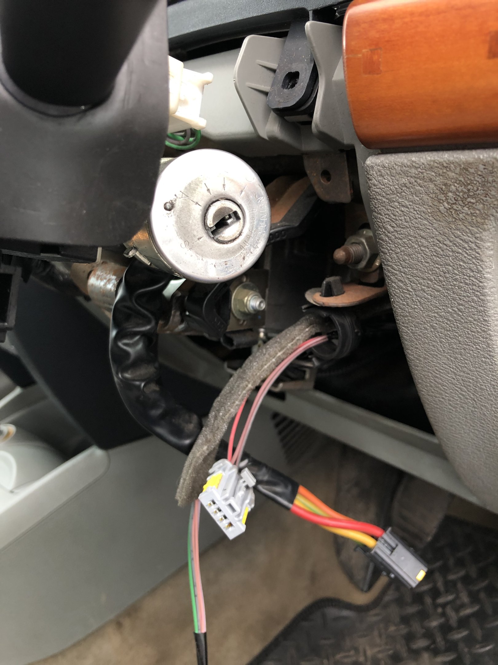

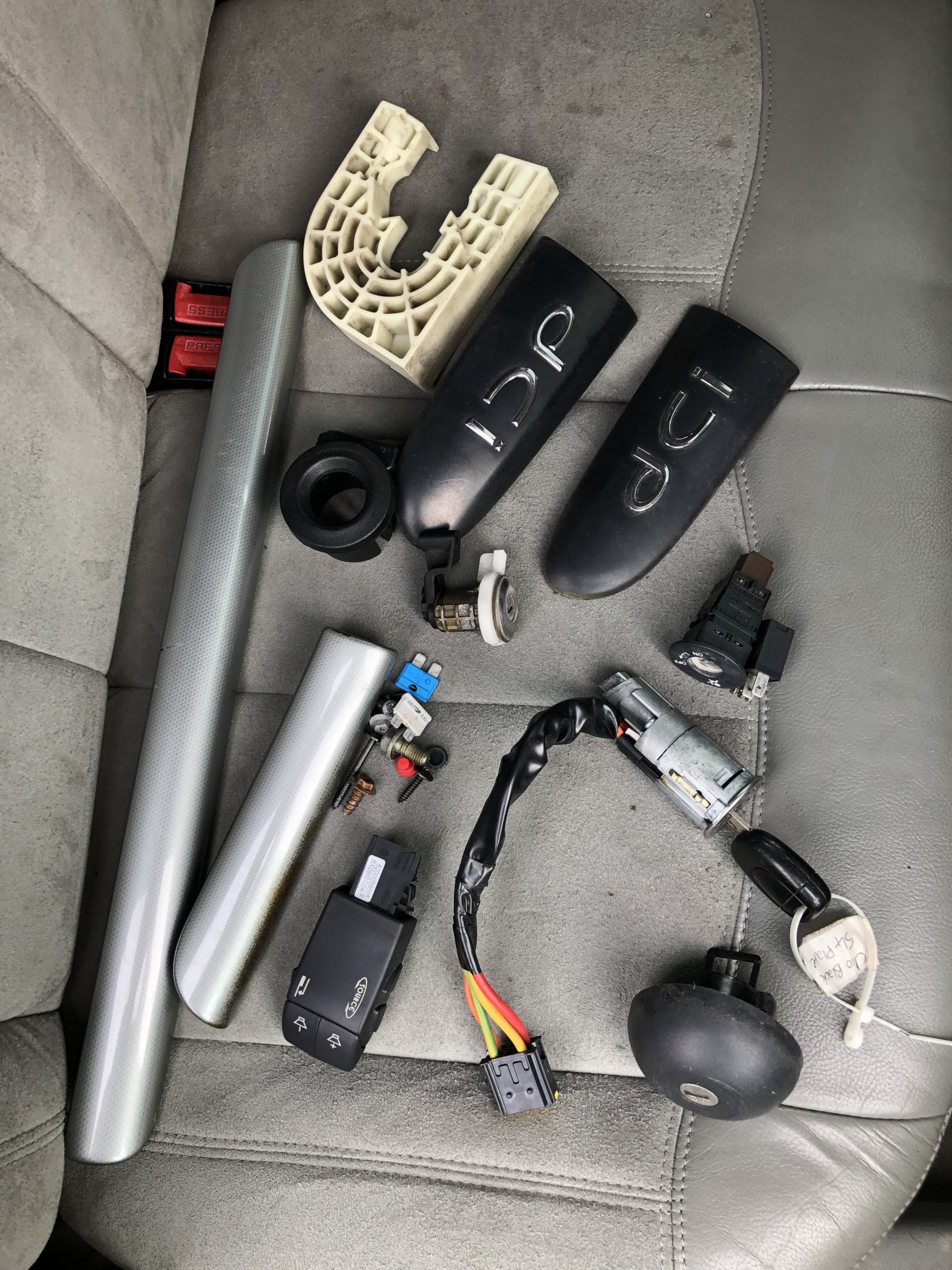

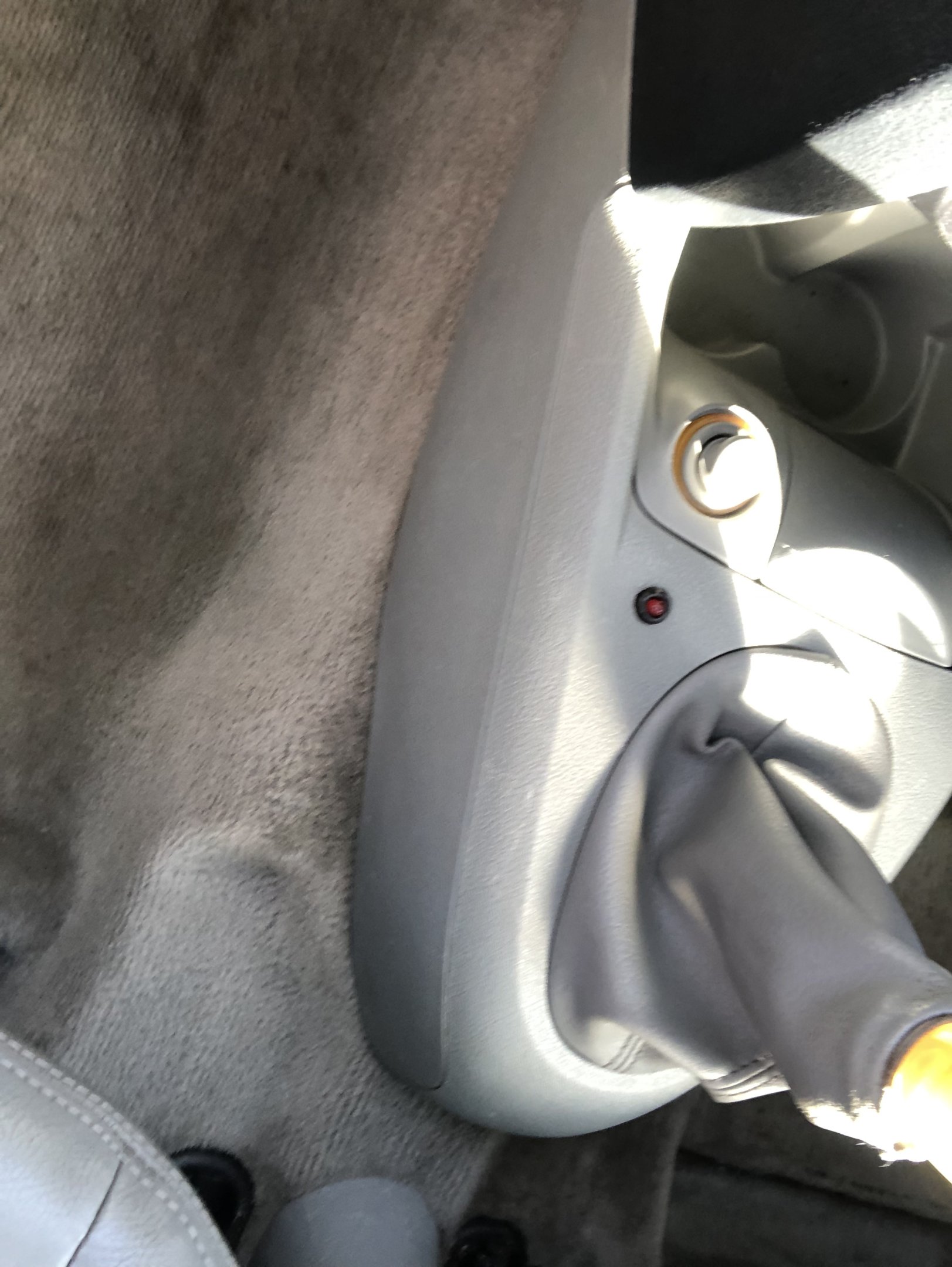

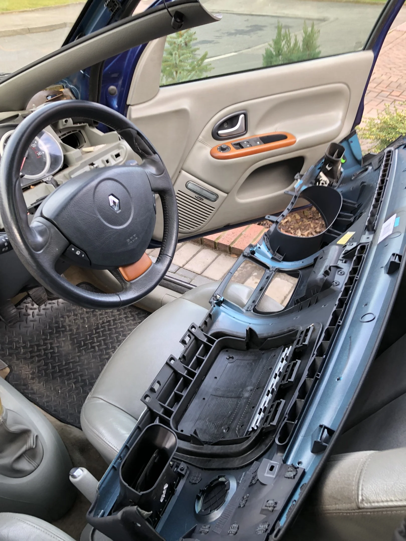

Decided to tackle the dodgy ignition barrell today. Found a scrap yard with a dci in so went and picked up the barrel and locks etc for £20. I was hoping it would have the egr valve on that i could take too as mine is still showing a code with the eml light even after cleaning it. It was on the car but smashed, so no good. The eml code for the glow plugs has now gone though after chaning all 4 of them.
Changing the barrel is another job which was a lot easier than i thought it would be. A little bit fiddly getting the plugs apart but overall a decent job to do on the drive. I changed the ignition barrel, got the door lock but not going to bother at the minute as it was a paingetting it off at the scrappy, so i will just keep the old blade handy with the car docs incase ever needed. I also changed the decoder ring just to teat of that has been the starting issue im having. And also the steering wheel radio control as the spinning part wasnt working on mine. I got the fuel cap but the new key blade works on my old one anyway!? Maybe they are generic but I had ready they were key specific... I also got the front air bag key switch but again this works with the new key blade too so dont need to change that.
Got some dash strips and standard Dci 65 side bullets to keep as spares.
The ignition now works properly as it should ????‍?

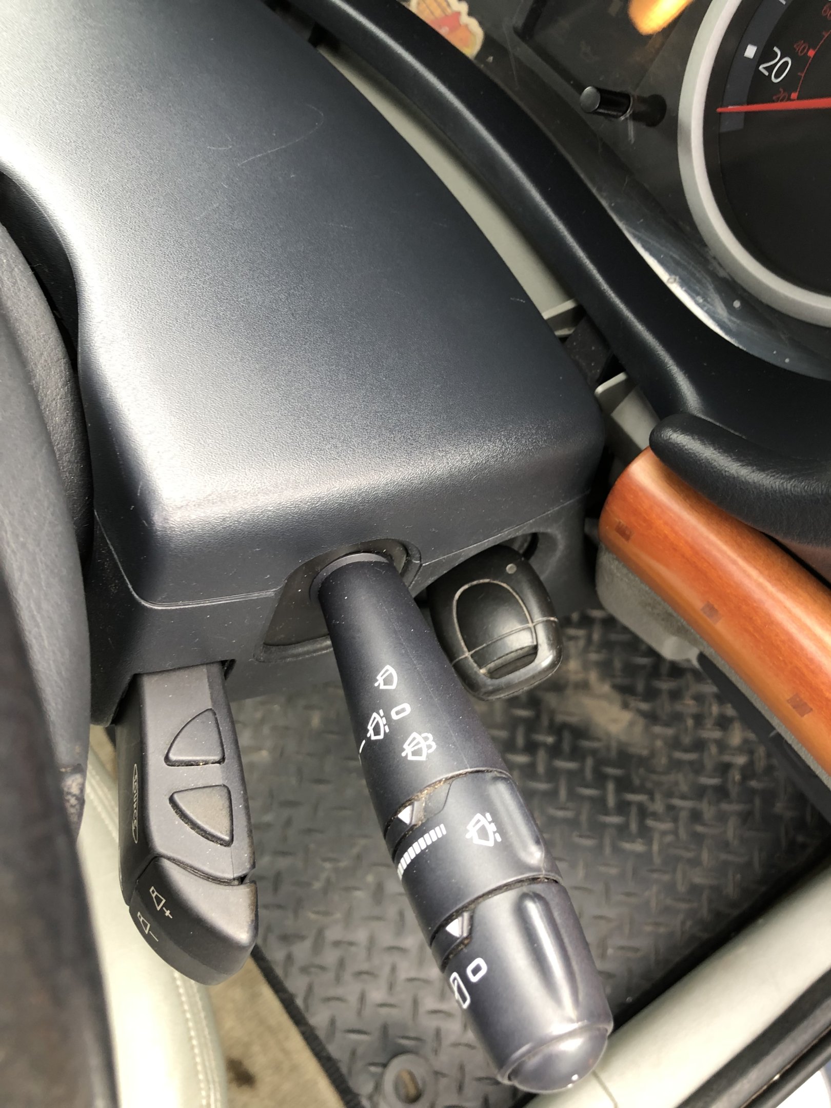

The new decoder ring hasnt solved the starting problem. Gutted about it as i have no idea what it is at all! Had it plugged into a snap-on scanner tonight and it didnt show anything! Hopefully CLIP will show what it is. Scared to hse the car bow because im getting stuck every time and it takes 10 minutes of messing around to get it to start again.
Goes from flashing red light to solid, then back to flashing againetc and eventually the loght will come on for a few seconds and go off like its meant to, then it will start.
Never had a car with electrical problems before. What a pain it is! At least with an engine problem the scanner shows what it is!!!!
On a plus, iv had both front Michelin tyres from the steelies put onto the alloys so have matching set front and back. Although all starting to feel pointless when the thing wont work!
Get a new key programmed mate, only delaying the inevitable lol
Im not convinced though mate. If it was just the fast flash then i would have already done it, but now it has a solid loght too it makes me less confident that it is the key. I have also noticed, that when it is playing up with the solid light, the alarm red light on the centre console next to the gearstick lights up too? Although not all the time, maybe once every 15 attempts of turning the key. It will go from fast flash, to steady, to fast flash again. Sometimes will let it crank, and other times nothing at all.
I agree with you that i need to just do it. Who knows, maybe it will solve it and i will kick myself for not doing it straight away, but i have a feeling it will still play up. Only one way to find out i suppose.

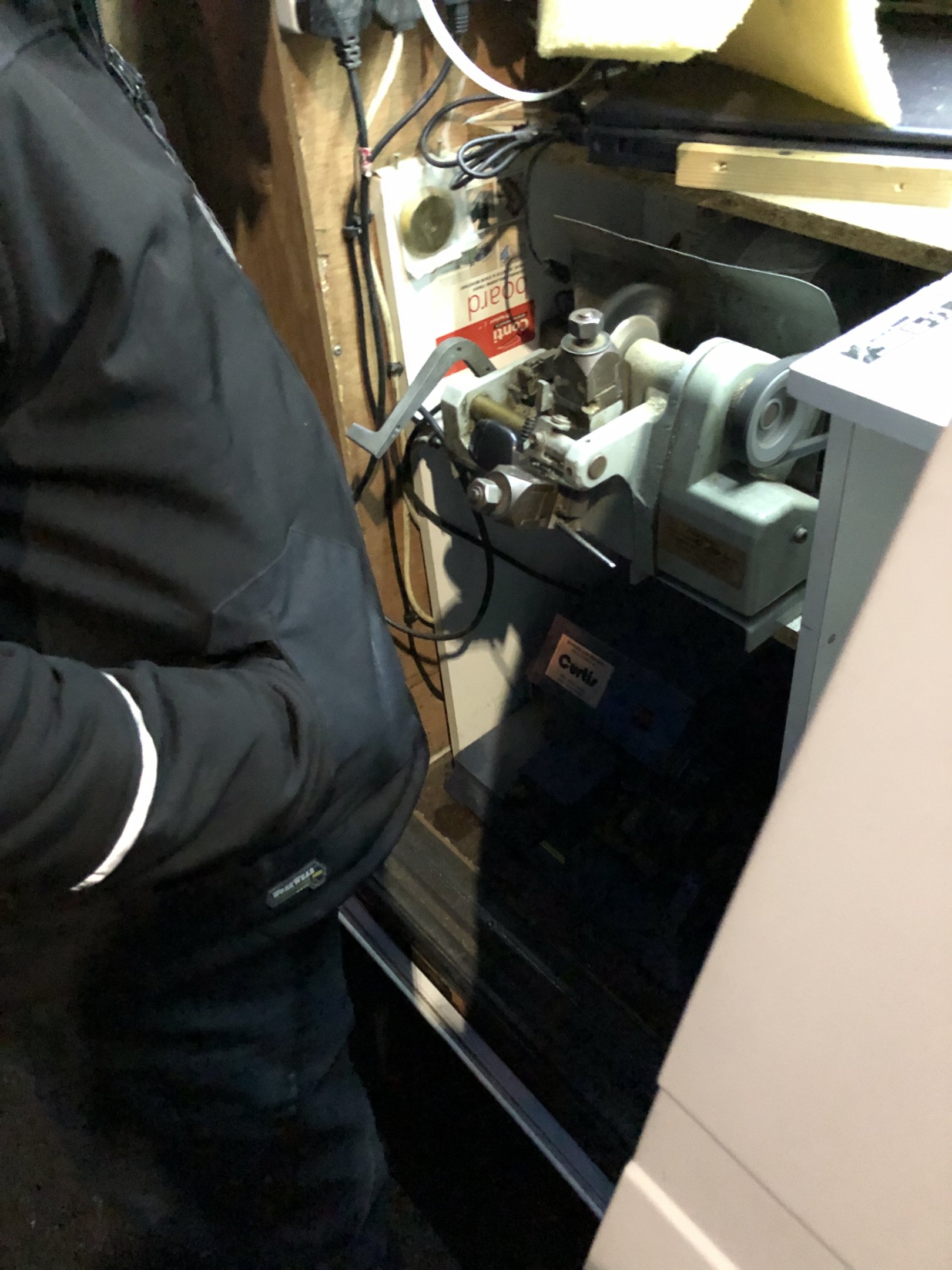

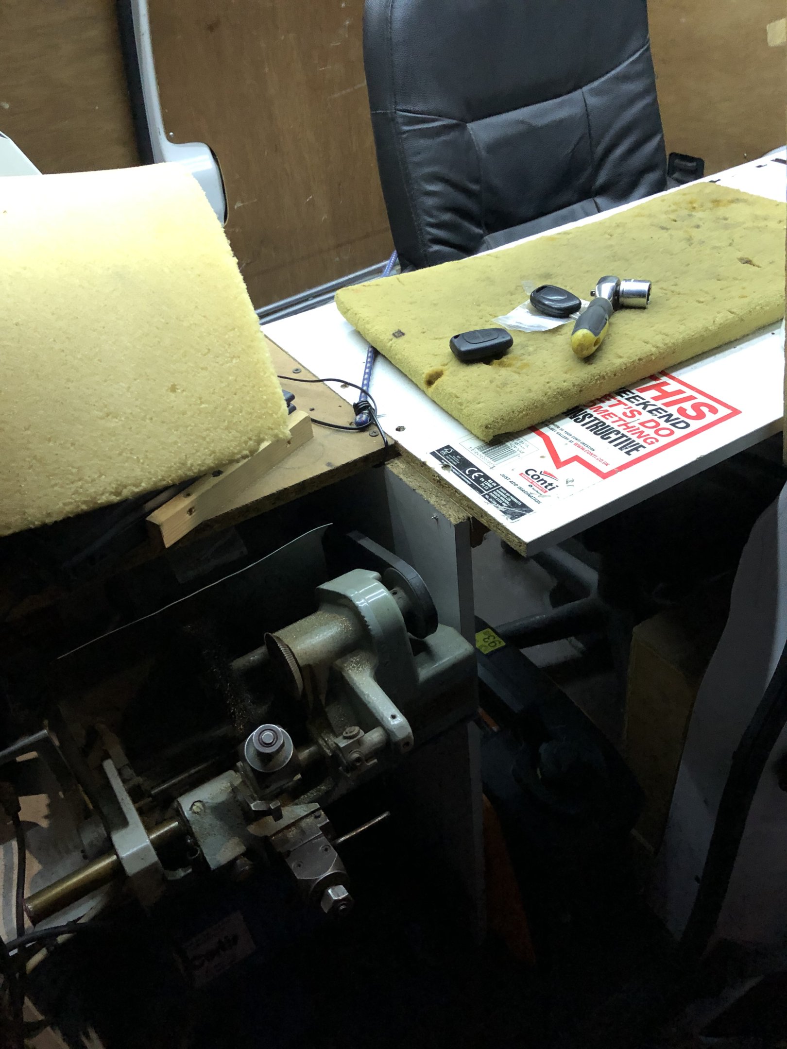

STARTING ISSUE IS FIXED !!!!!!!!
I went ahead and got a key made up. It was £80 and a bit of a risk as i was t 100% this is what the problem was, but as it happens, it was. The car now starts as normal so I am very pleased about that!

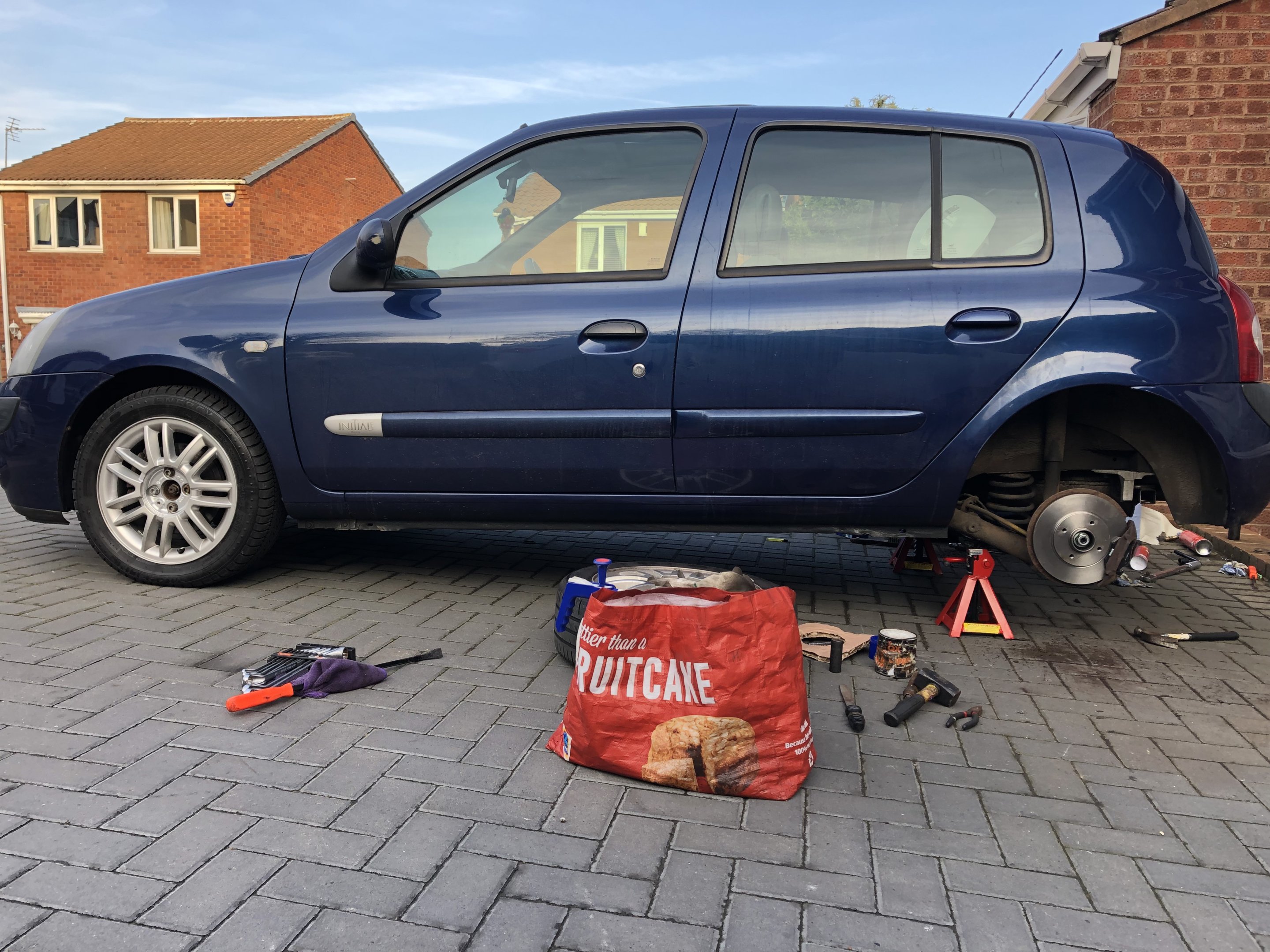

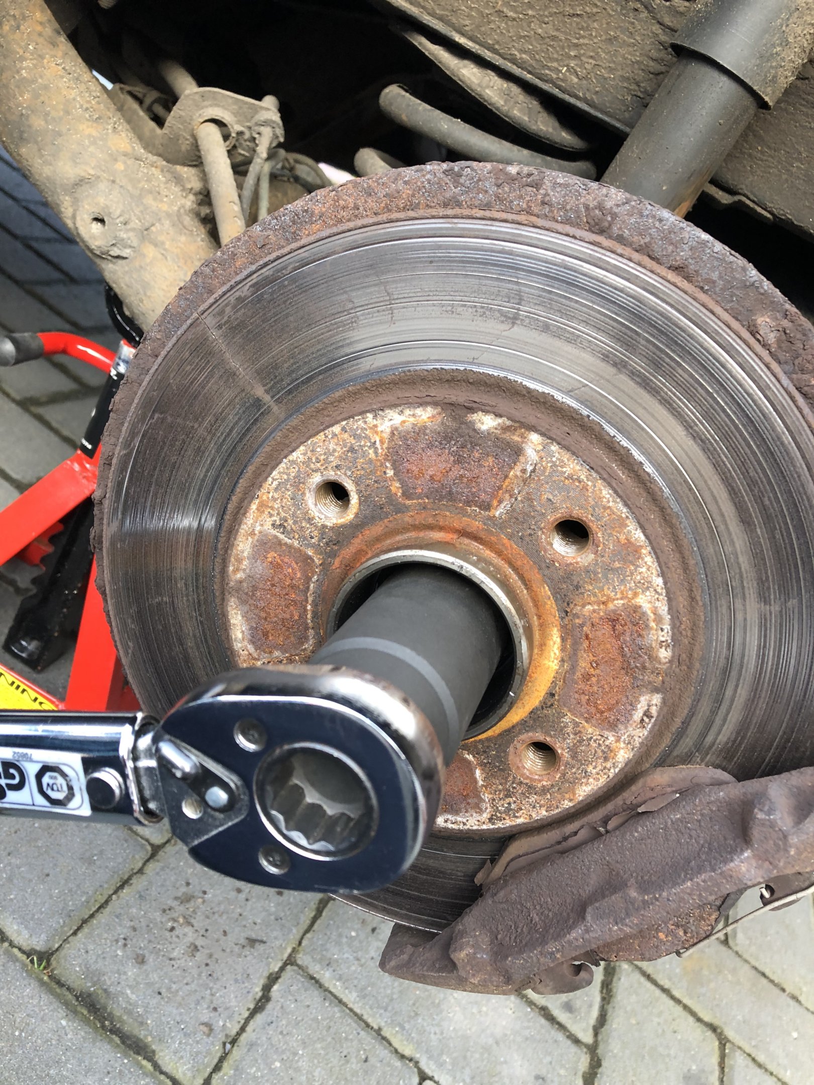

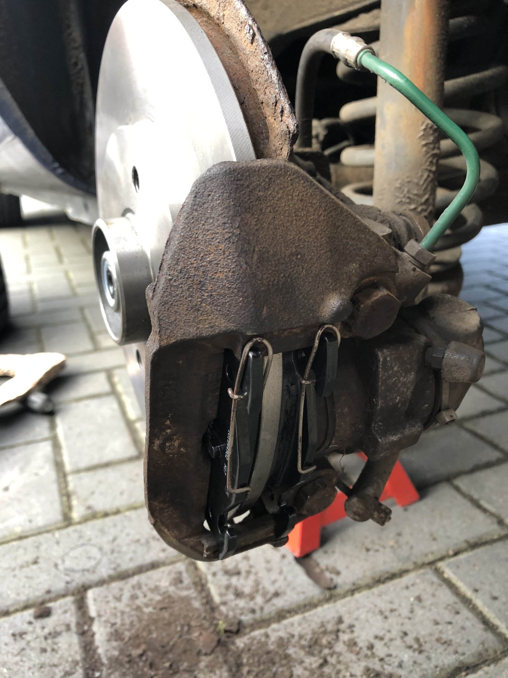

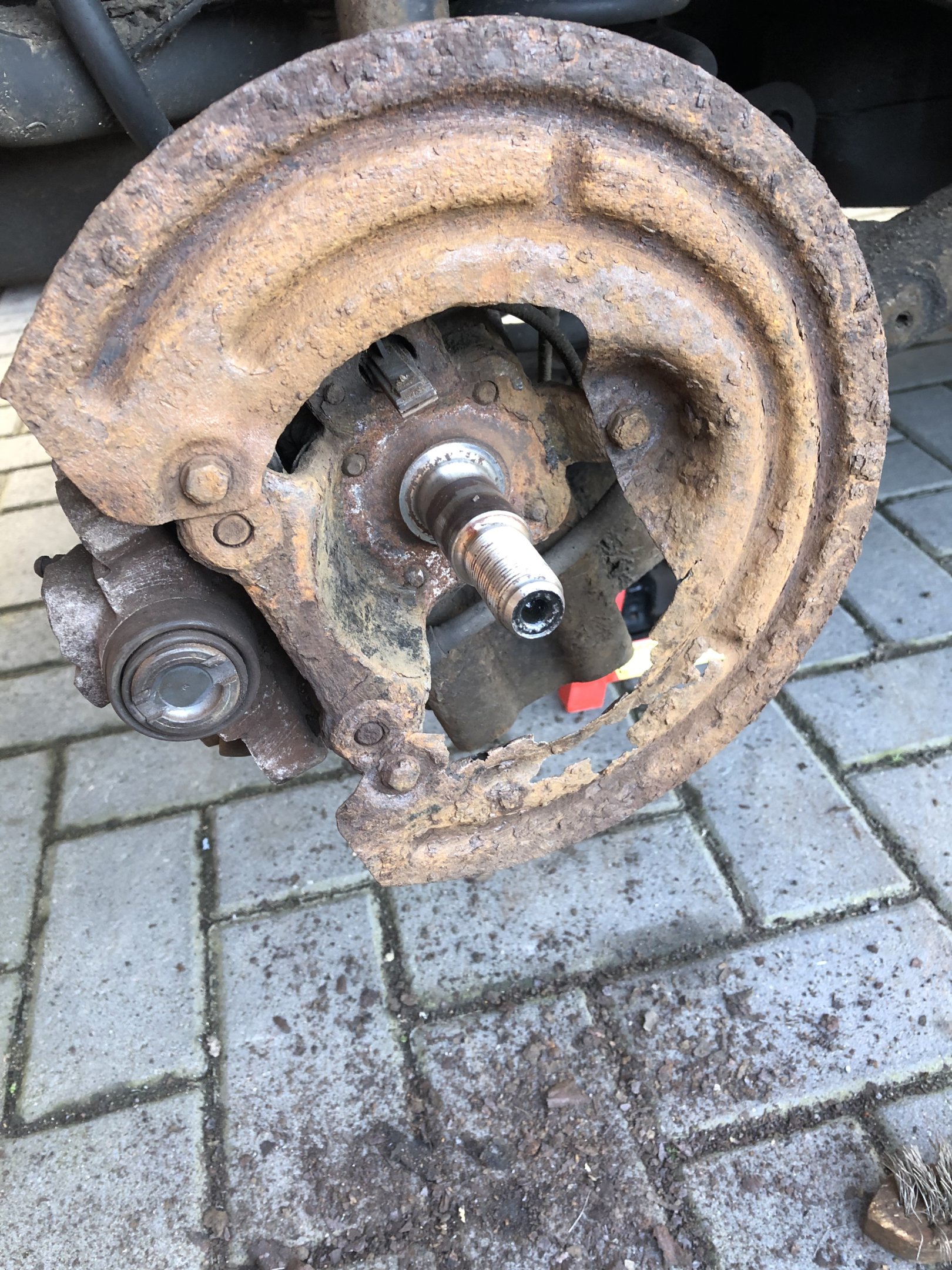

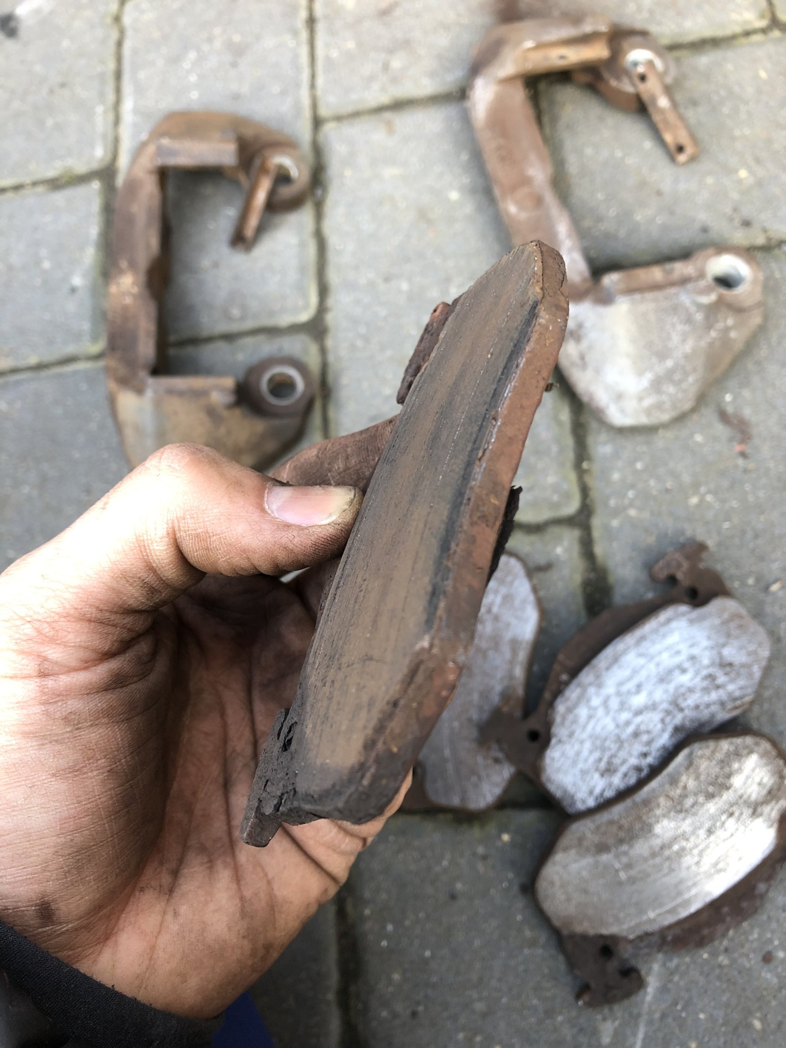

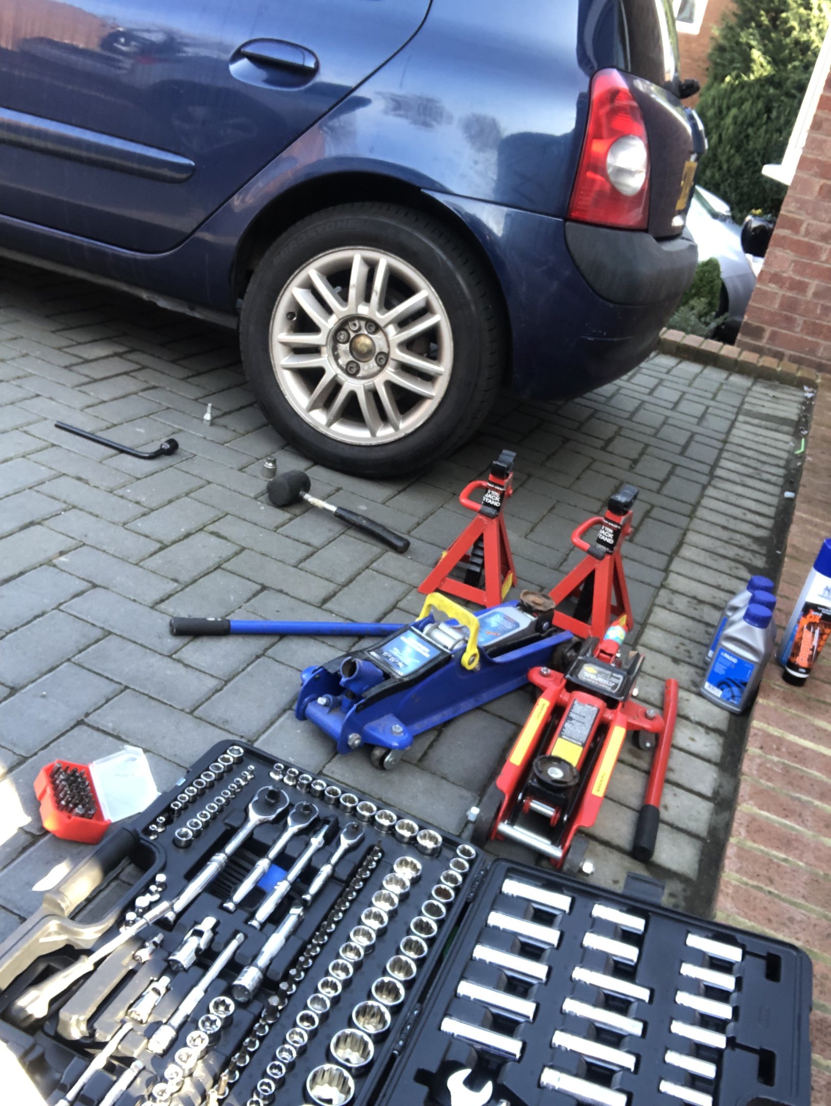

@mitch1503 offered to come and help me bleed the brake fluid and help with changing the discs. Massive problem occurred at the start which was the locking wheel nut key snapping so we were unable to get the wheel off. A local scrap yard had the exact key needed so got that for £5 and managed to get the wheel off. Due to wasting almost 2 hours we ran out of time to bleed and refresh the fluid so we just changed the rear discs and pads.
No major issues with this but the sliders holding the pads in were a pain to get out and one of the rear discs did not want to come off. Also found it has a new calliper on one side which im happy about as it indicates it has been looked after in the past and things have been fixed when needed.

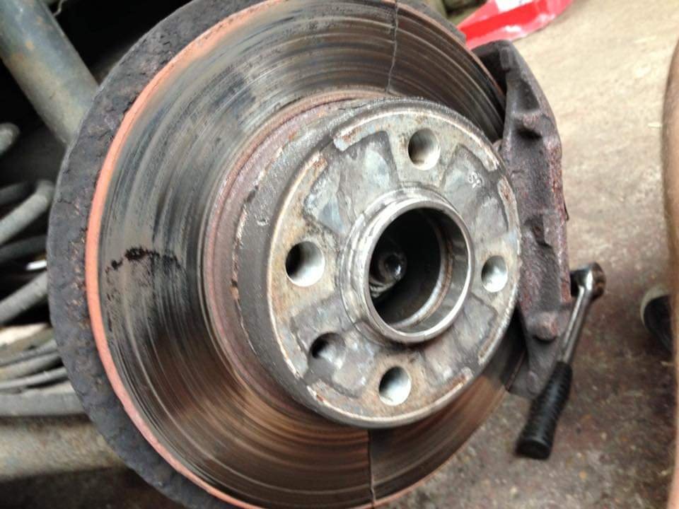

The old pads were almost all the way worn down and one of the discs had a crack through it.
Looks good now mate.
Cracked rear disc is from a sticking caliper, mine did this on the first day I got mine[emoji23] It was cracked under the spacer too[emoji50]
Mine stopped sticking after I bled the fluid out, the fluid was black too, the car rolled like a dream after that
Sent from my SM-G965F using Tapatalk
@YorkshireKyle same happened to my 182!
The sliders on this seemed to be free though and working so hopefully they will be fine. We are going to do the fluid one night during the week anyway though. Had a look inside the bottle and it does look very old so will hopefully make a nice difference.

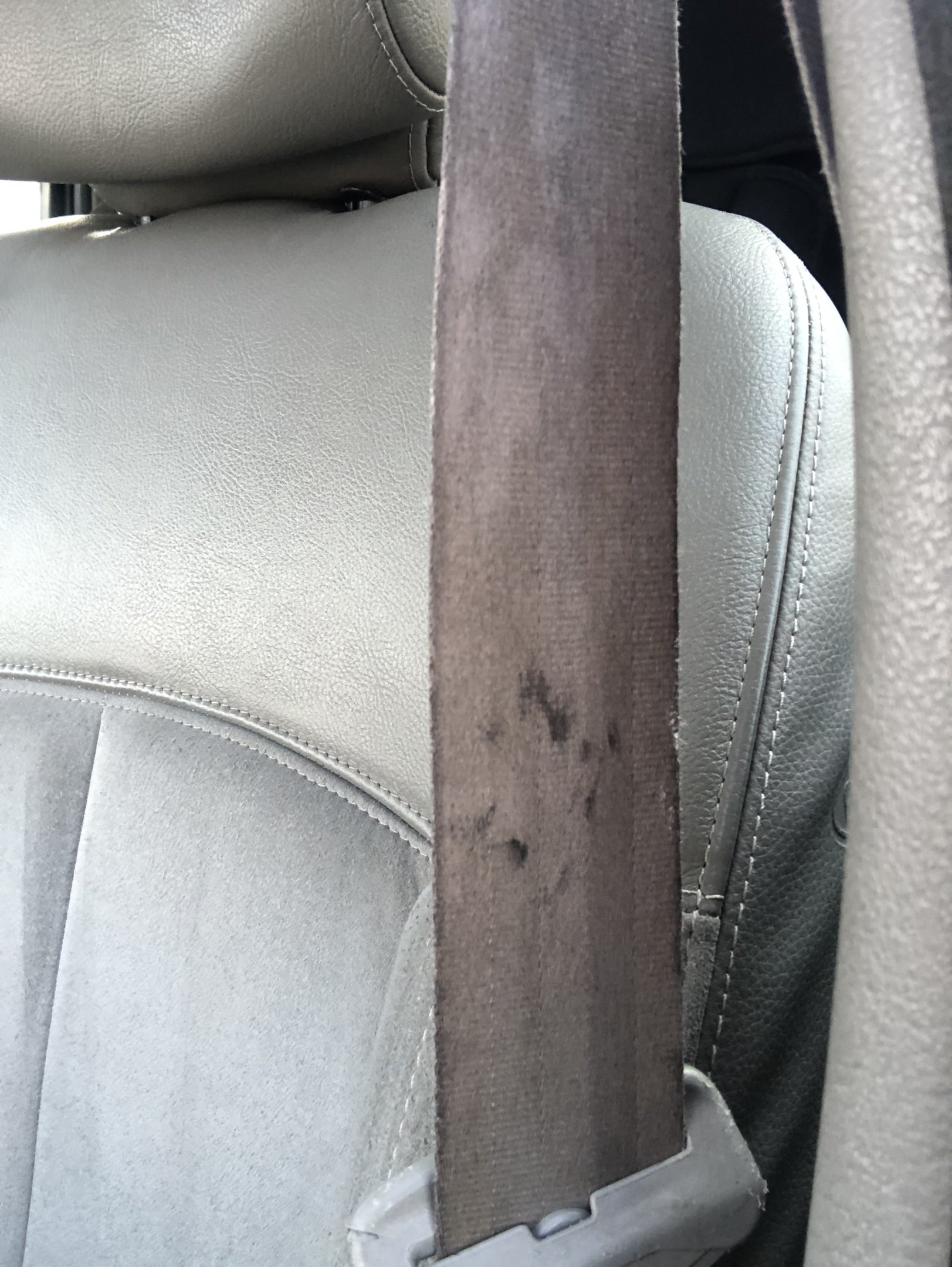

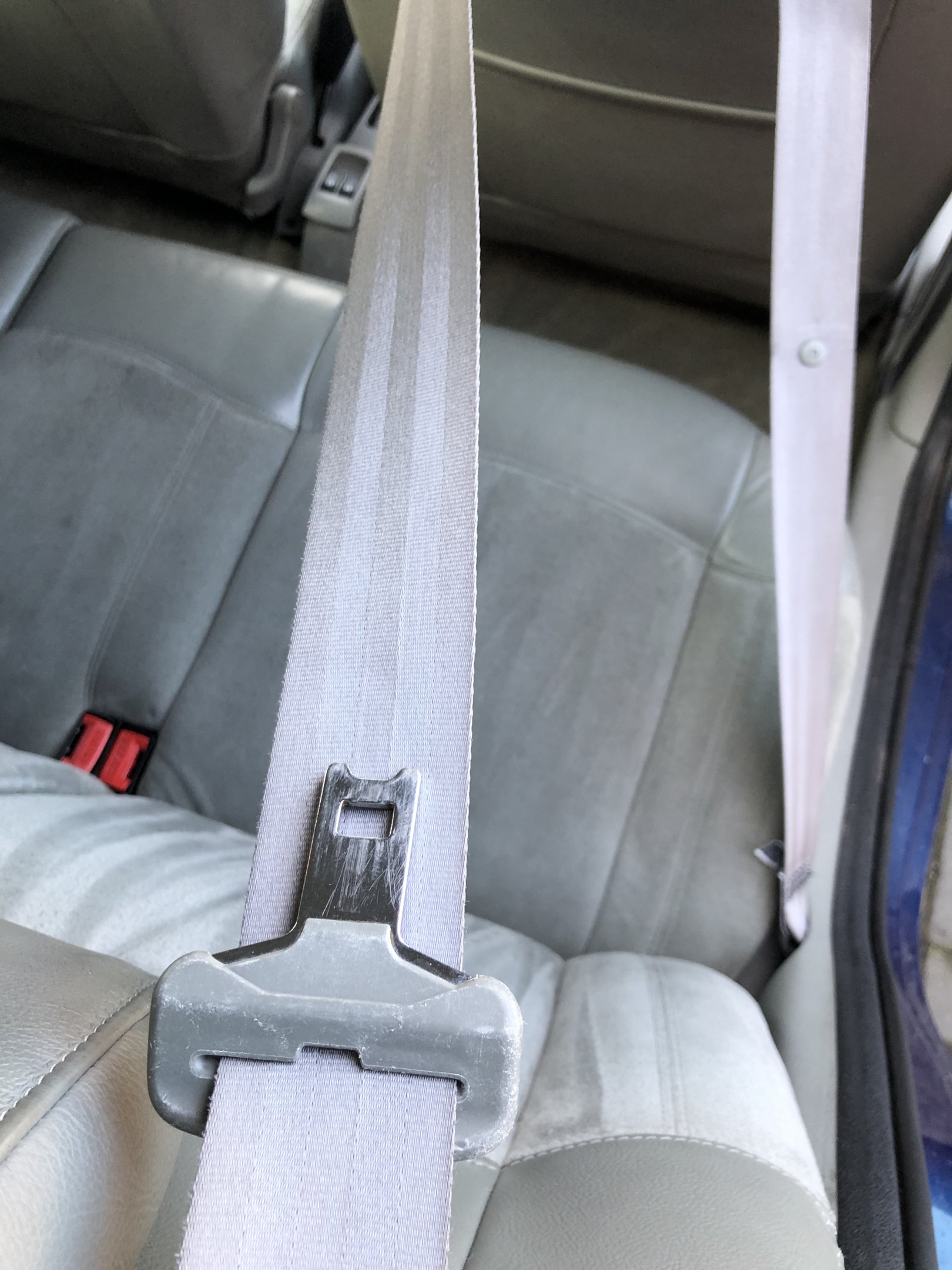

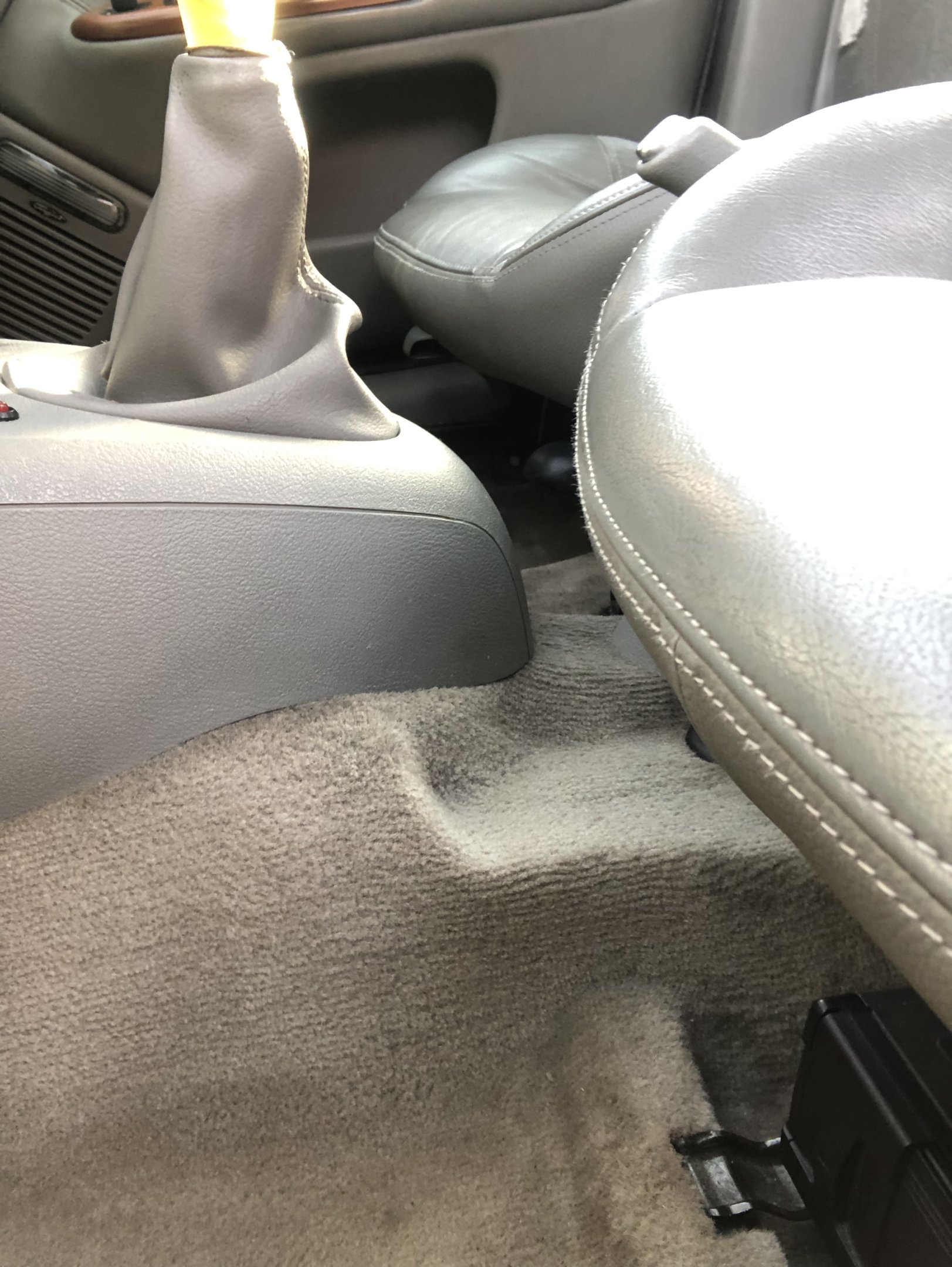

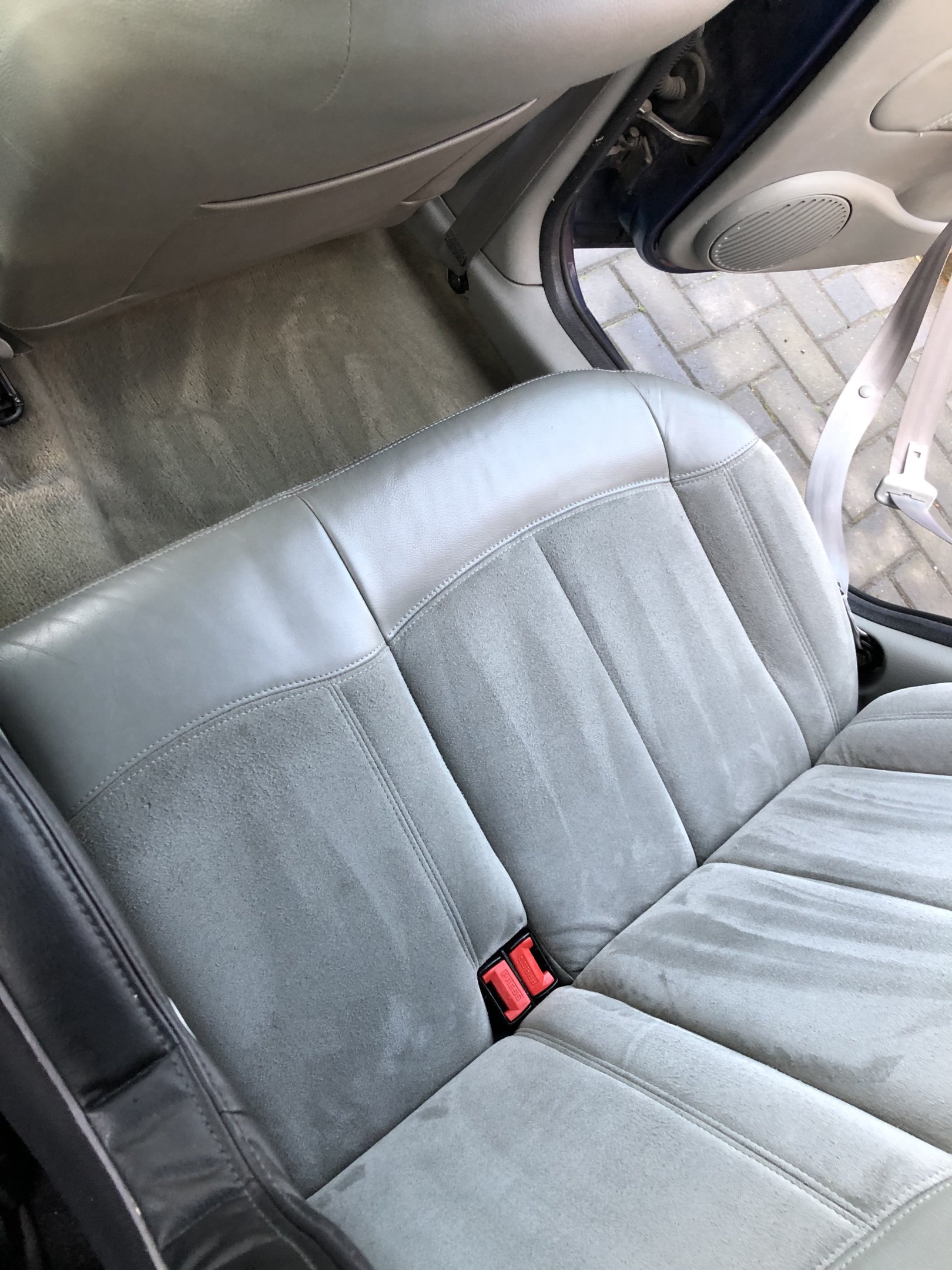

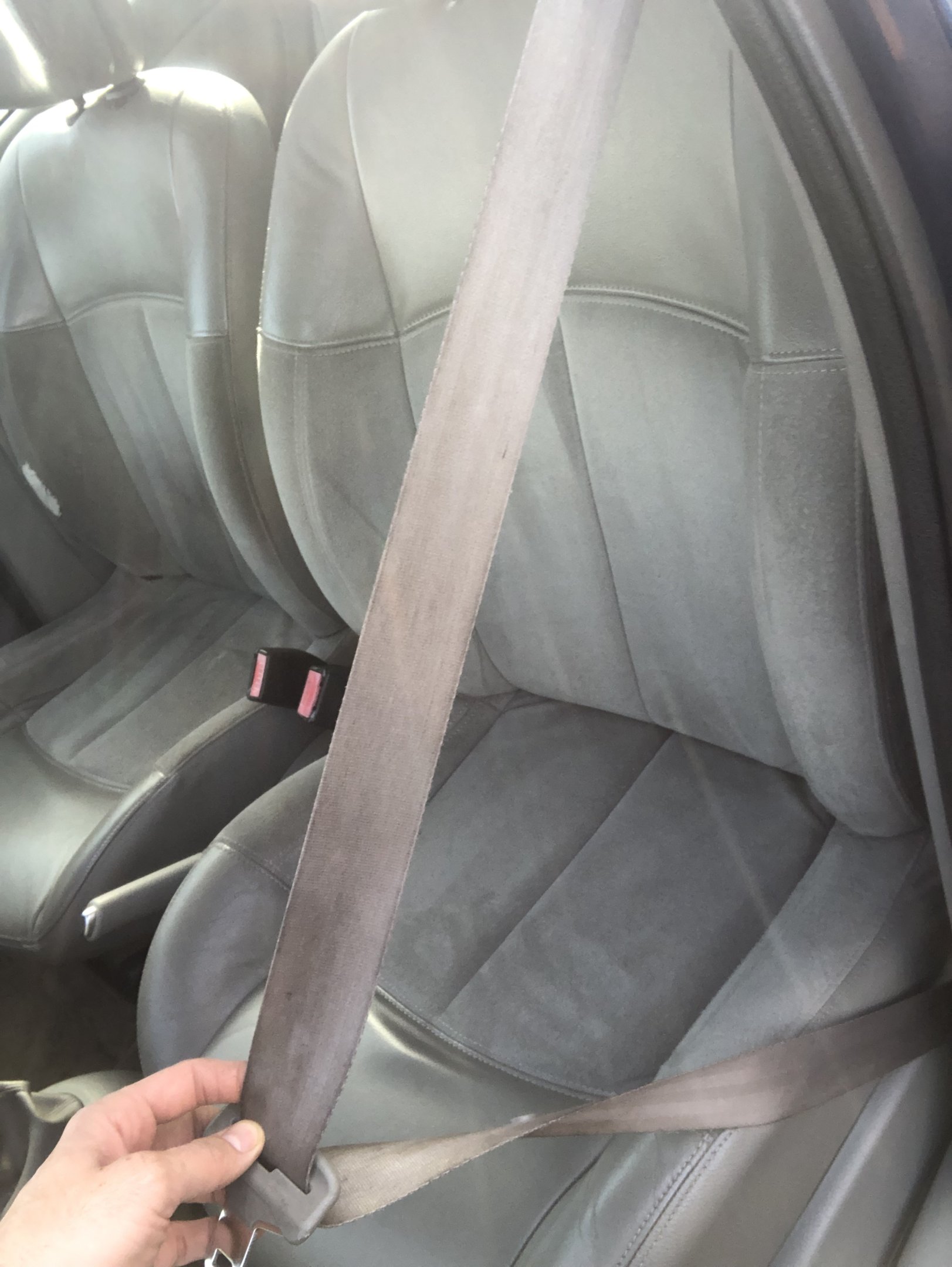

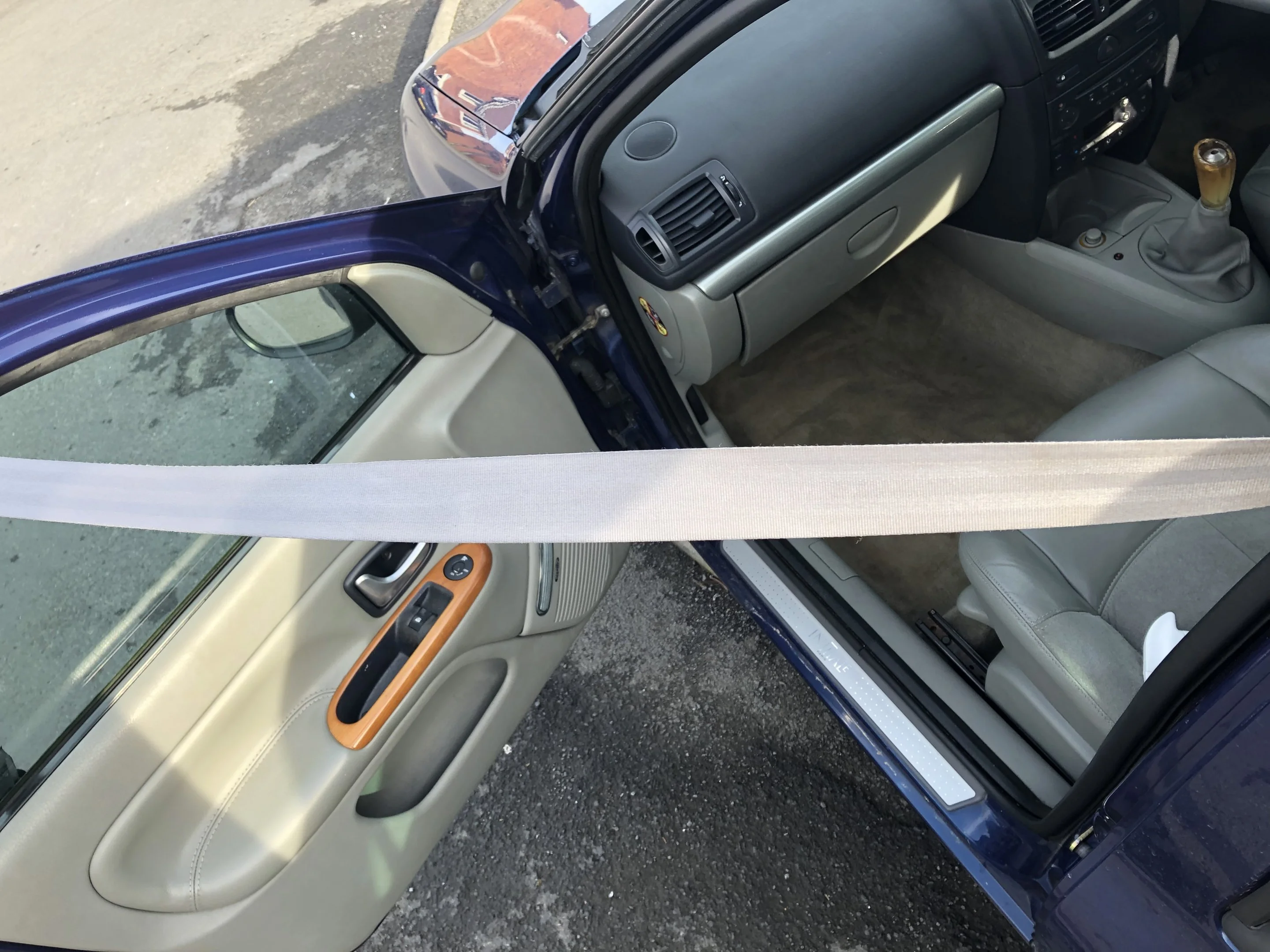

Rear seatbelts cleaned today along with the carpet and seats. Not perfect but a lot better and overall the car now feels clean.
1407741
1407743
1407744
1407745
Also cleaned the boot out and put some carpet underlay in the wheel well as the old stuff had fell apart. Spare Alloy put in place with the tool kit. Good to know if i ever need to change the wheel, it will be a matching alloy and not a steel wheel.

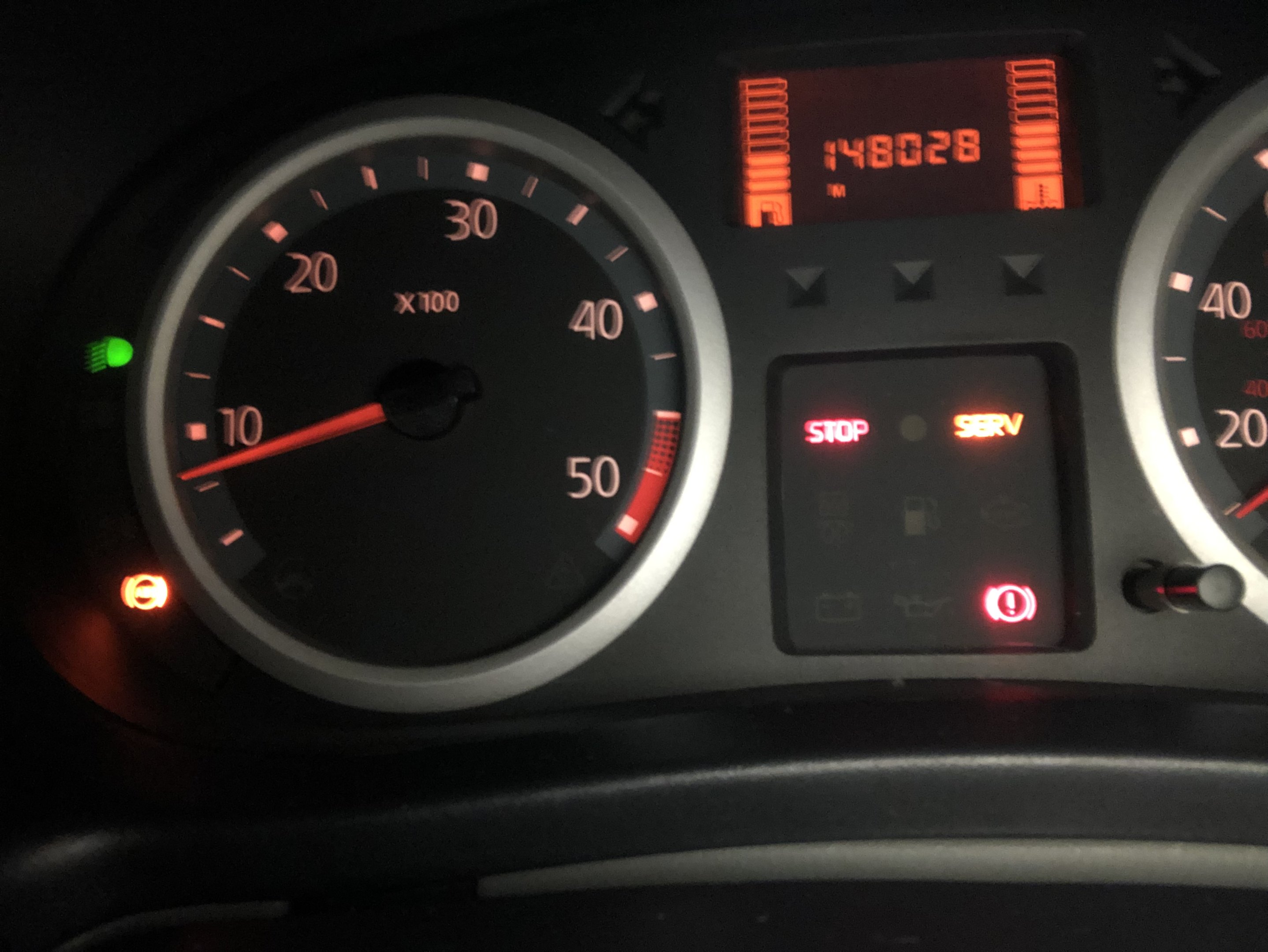

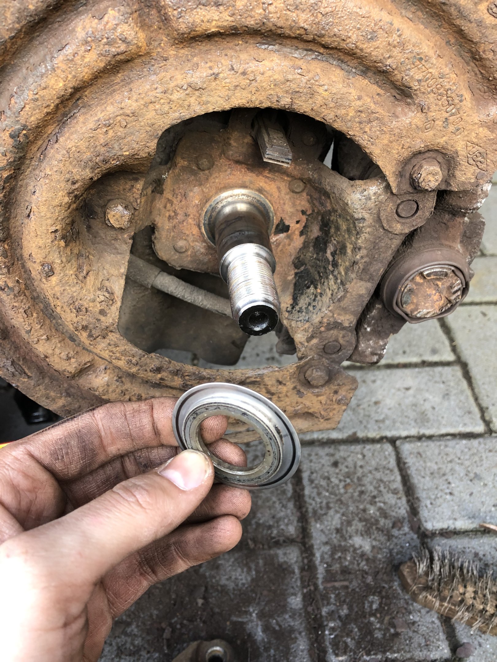

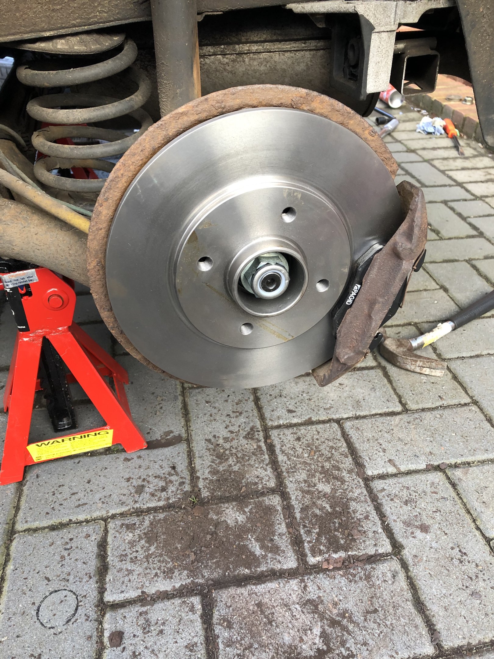

And just as I am slowly solving the problems, a new one is created! ABS fault of some kind. Im getting the kick back feeling when braking, but not everytime. I think this is either a ring or sensor. It would make sence that its something on the rear following the disc and pad change, but could also be a coinsodence and the front has gone. Only way i will know if stripping it down. I tried plugging it in but no fault is stored and the lights only appear after driving, and not on start up.
1407742
When I bought the clio it had the abs light on, and the abs itself was overly active, interfering on pretty much every little movement of the middle pedal.
it was a cracked sensor ring on a front driveshaft,
they're inexpensive but you'll have an hard time trying to put one on without removing the driveshaft from the car.
BUT
given your recent activity on the rear axle one question come up to mind: have you checked the abs rings on your new discs are the same as the old ones ?

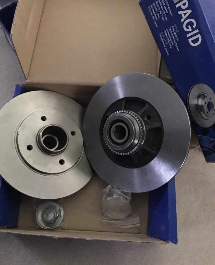

Did you check the ABS ring on this new brake discs? Count the teeth etc?
@Mazz @Rob Yes, they are 44 teeth, the same as the 1*2. I did wonder that too, but checked even before buying them. I also compared them together when off the car so they are definitely 44. I think it will be from scrubbing the heatshield with the wire brush and some has got in the sensor. Hopefully a clean out will solve it, but we will be checking the fronts while we are on as im going to put some new discs and pads on while doing the fluid change.
Edit; is it possible some are more than 44 teeth?? Im now looking at the pic of the new discs and trying to xount them from a picture and looks like there could be 48 teeth!? Hard to count from the pic.
£30 disc bargain is no longer a bargain! Wrong abs ring so looks like I need to buy another set of rear discs now!
yup, definitely more than 44 there.
Not the end of the world to change them.
get the right ones on ebay, chances are your old one will brake while trying to remove them from the old discs, and as I said before new ones are inexpensive.
heat the old ones and get busy with a chisel and hammer trying to tap it out evenly.
if it comes out alive then use it to tap in the new one, and again, a torch is your friend.
