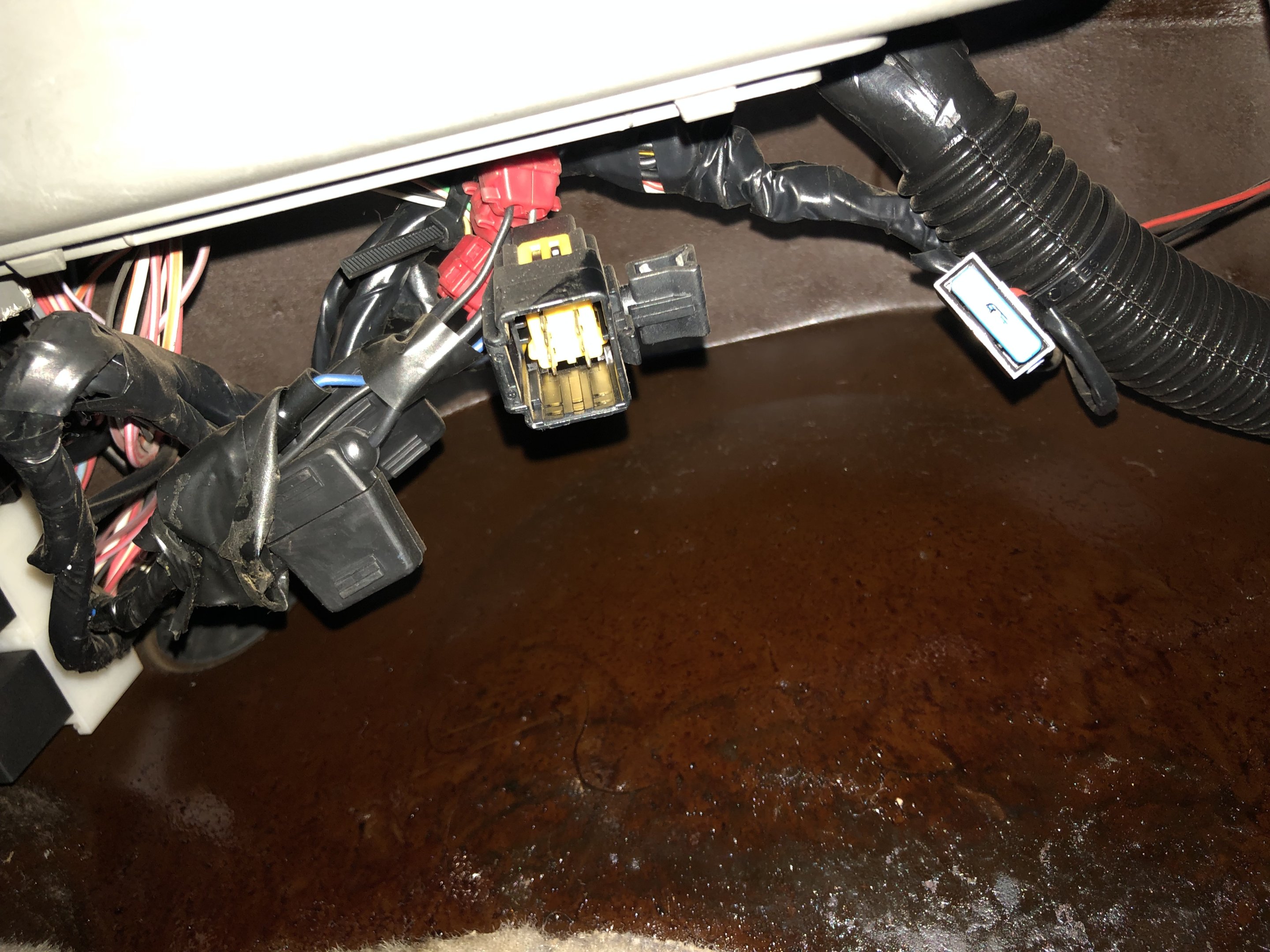

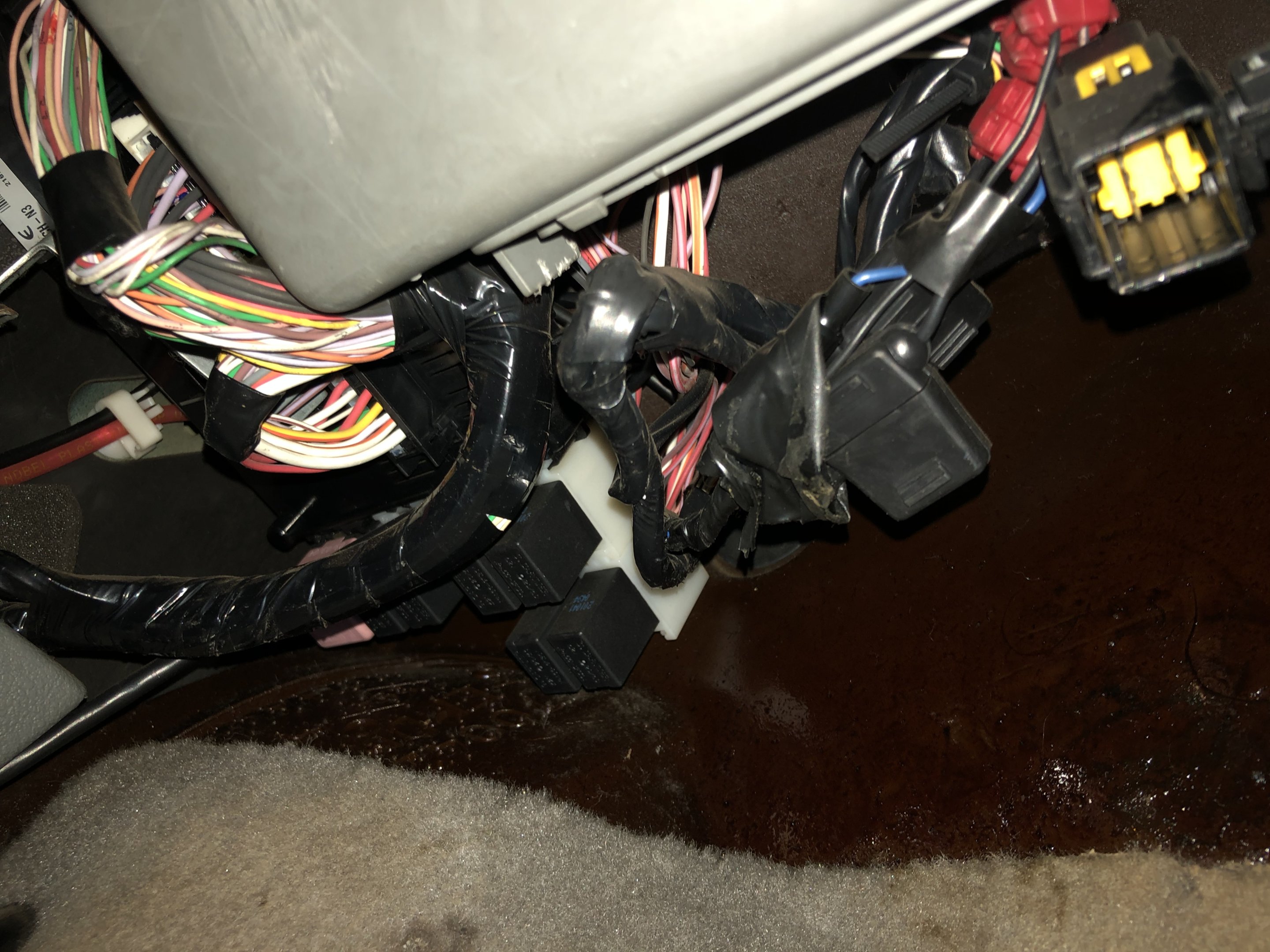

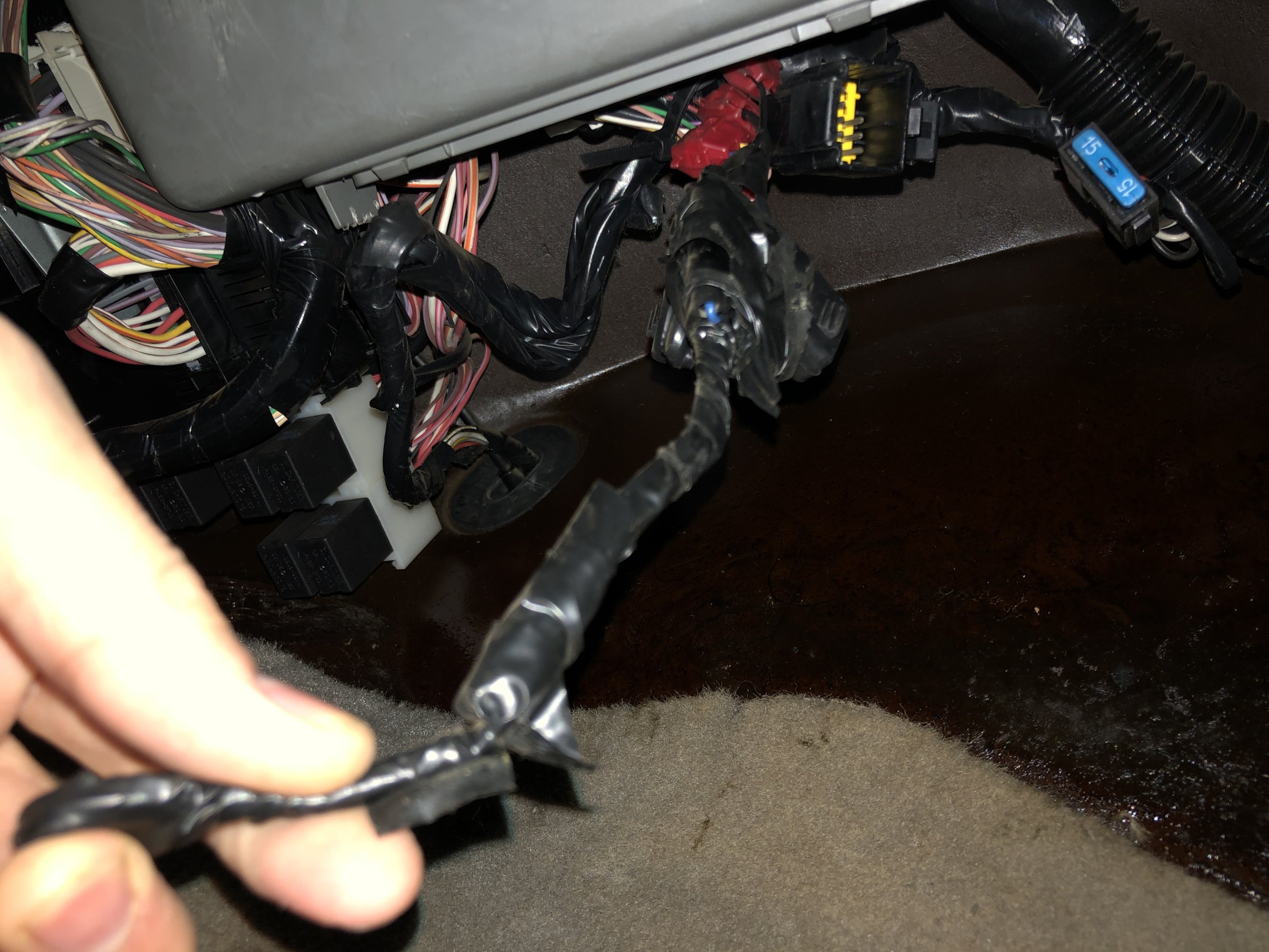

Have i stumbled across the potential starting problem here?????? After 4 days of no issues, i got the flashing red light again. I decided to look at the relays in the passenger footwell near the glovebox and have found a load of wires which do not look standard!? Maybe aftermarket alarm at some point? Anyone have any ideas or fellow Dci’ers can you compare for me?
Krarl
Really mate? Cant be lol! Its a mess!!
What about the yellow plug? Whats meant to go in that?
The cables look exactly the same as a few other 172's I've pulled apart. The massive bundle of excessive wite under the gearknob, not so sure about the yellow plug. I can check under the dash of my 172 for you if you want?[emoji23]
